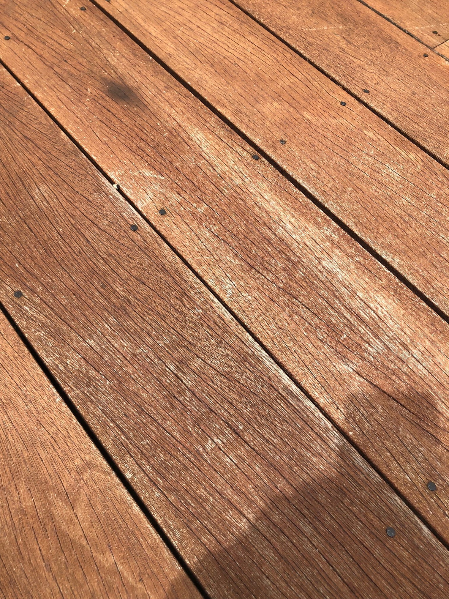

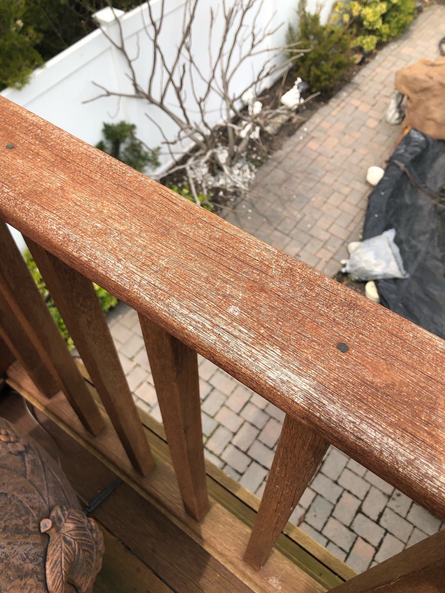

Hardwood deck stain. You list RAD but that doesn’t say designed hardwood. I have a mahogany deck. I have used Ready Seal Redwood stain, but seems that almost every year or 2 I have to re stain. I plan on using RAD Stripper on this, and then wanted to try a Hardwood designed stain, which RAD stain or any stain is best. Also in photo is some stain, not sure oil or what. I did deck 2 years ago, looks really worn. Live in NYC

The question came up because the article you posted stated that there are certain stains that are specifically designed for hardwoods, and this didn’t mention that it was specific for that purpose. I did call RAD, and actually they recommended to go with the Armstrong over the RAD for Mahogany.
Regardless, do you think the reason i had poor results previously, was that I was using Readyseal product? And should RAD stripper take off previous stain. thanks
