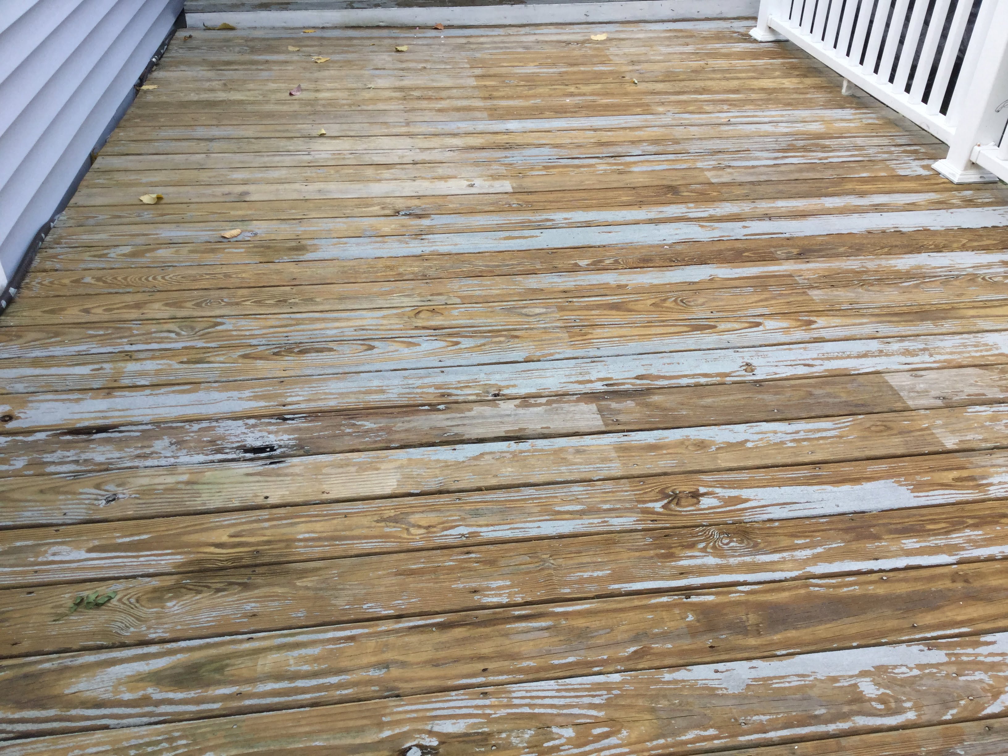

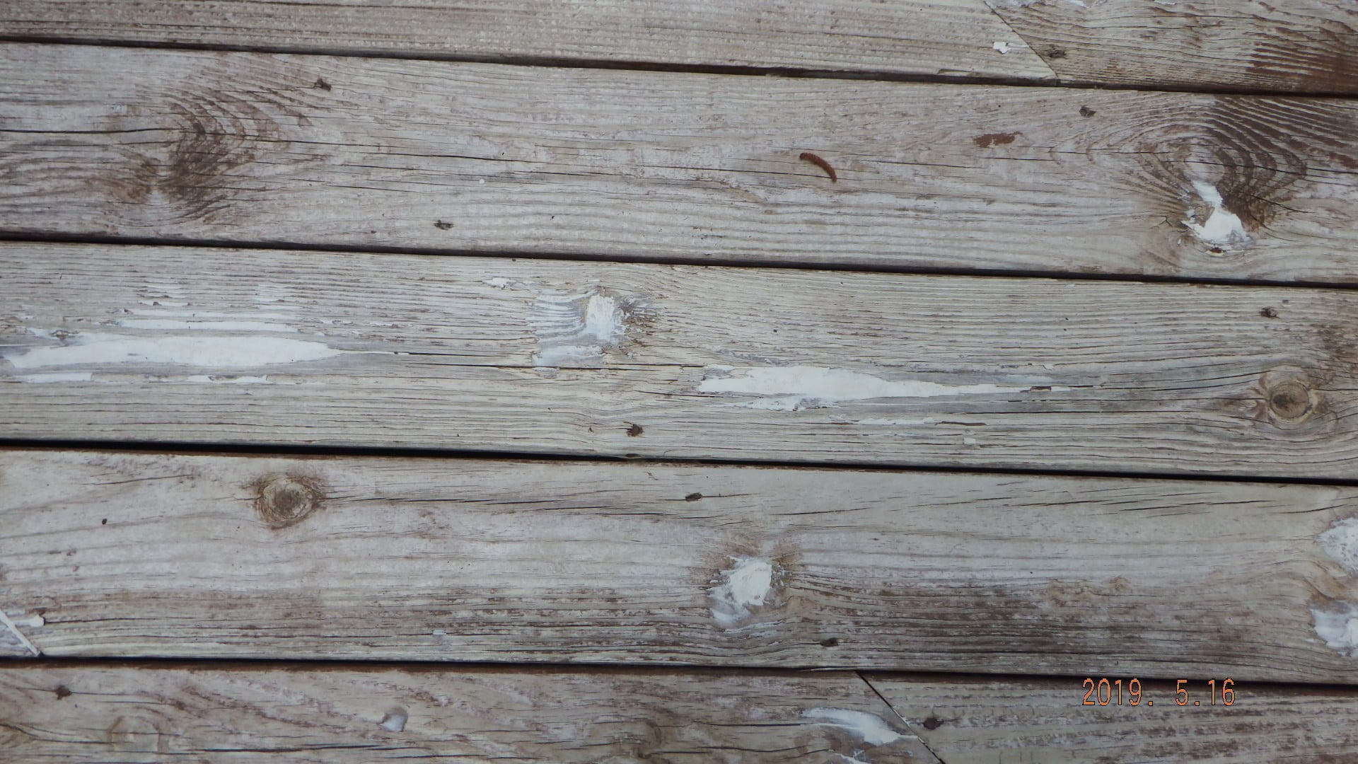

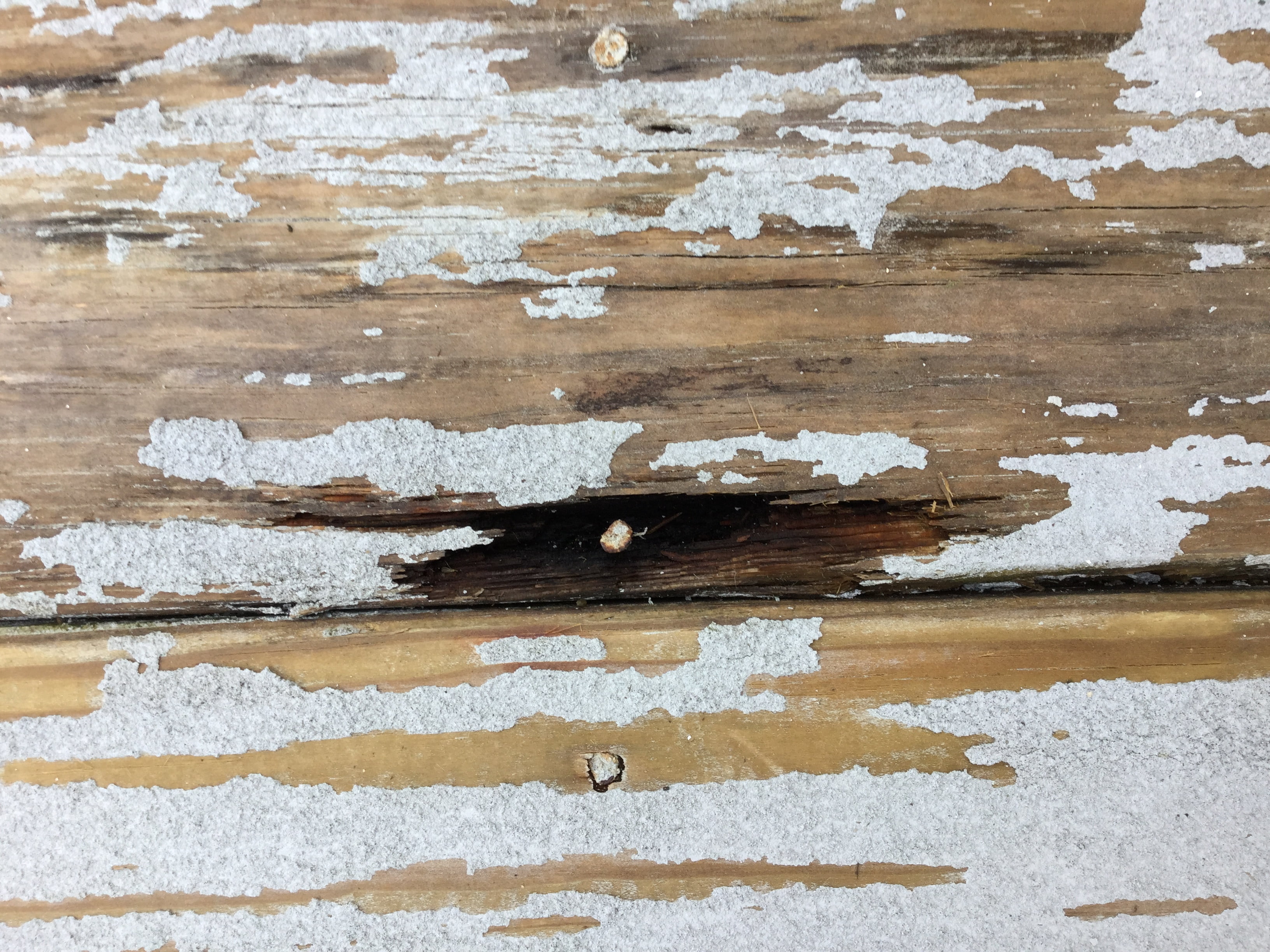

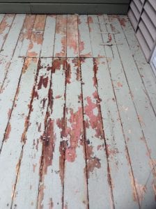

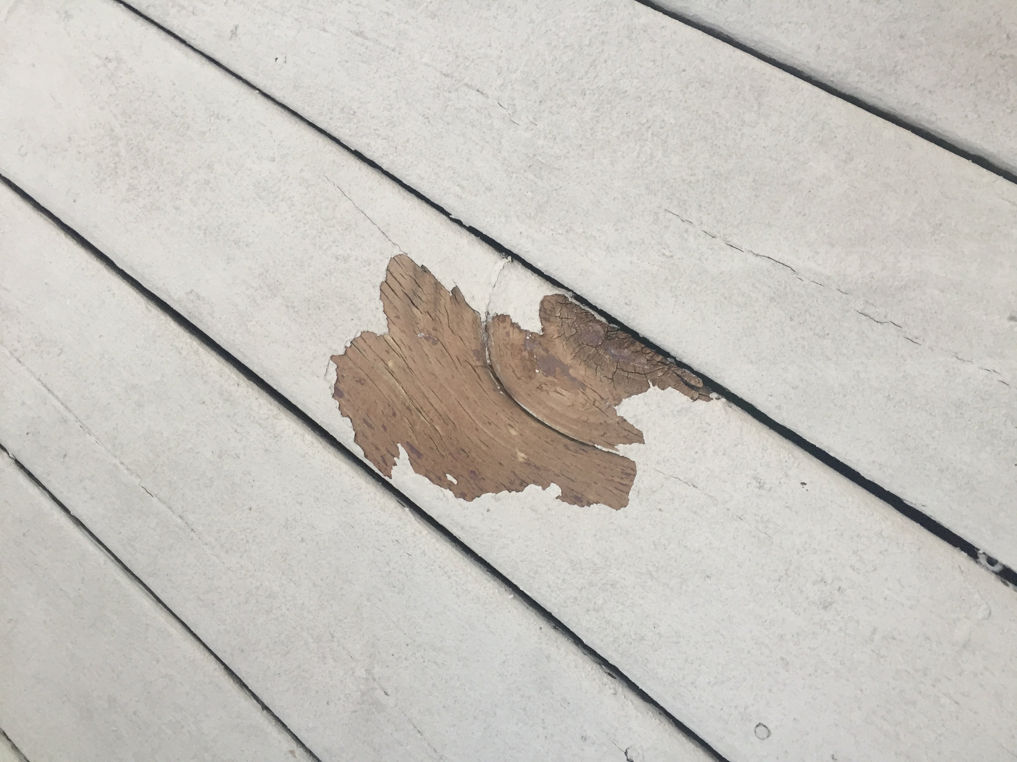

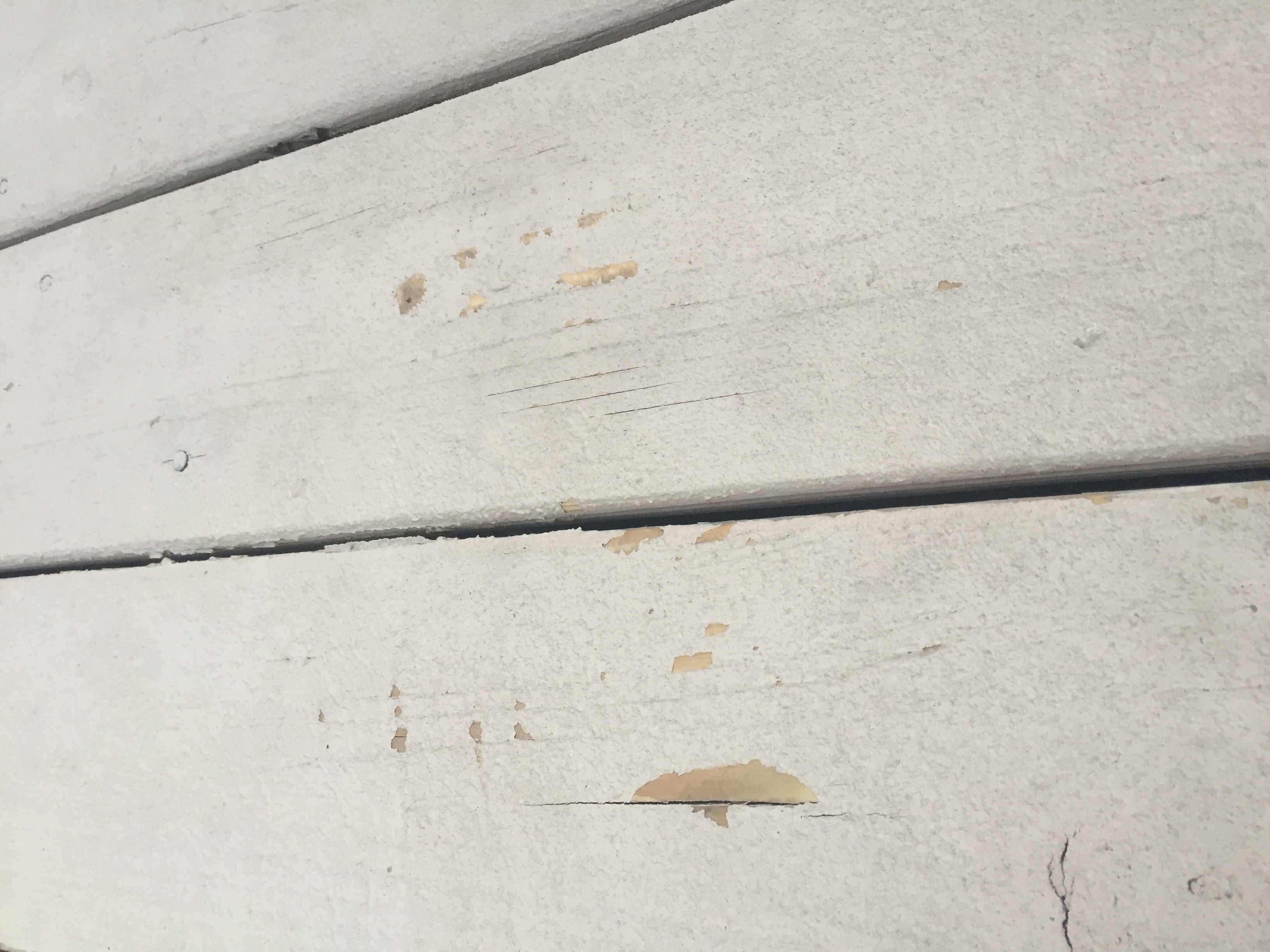

1. Deck Resurface Coatings Peel
My tests and seeing these coatings in the real world show that despite what the manufacturers claim, these products are prone to peeling. Peeling is always an issue with any film-forming product. It still seems to stand true that anything subjected to the elements will not hold up for more than a couple of years.

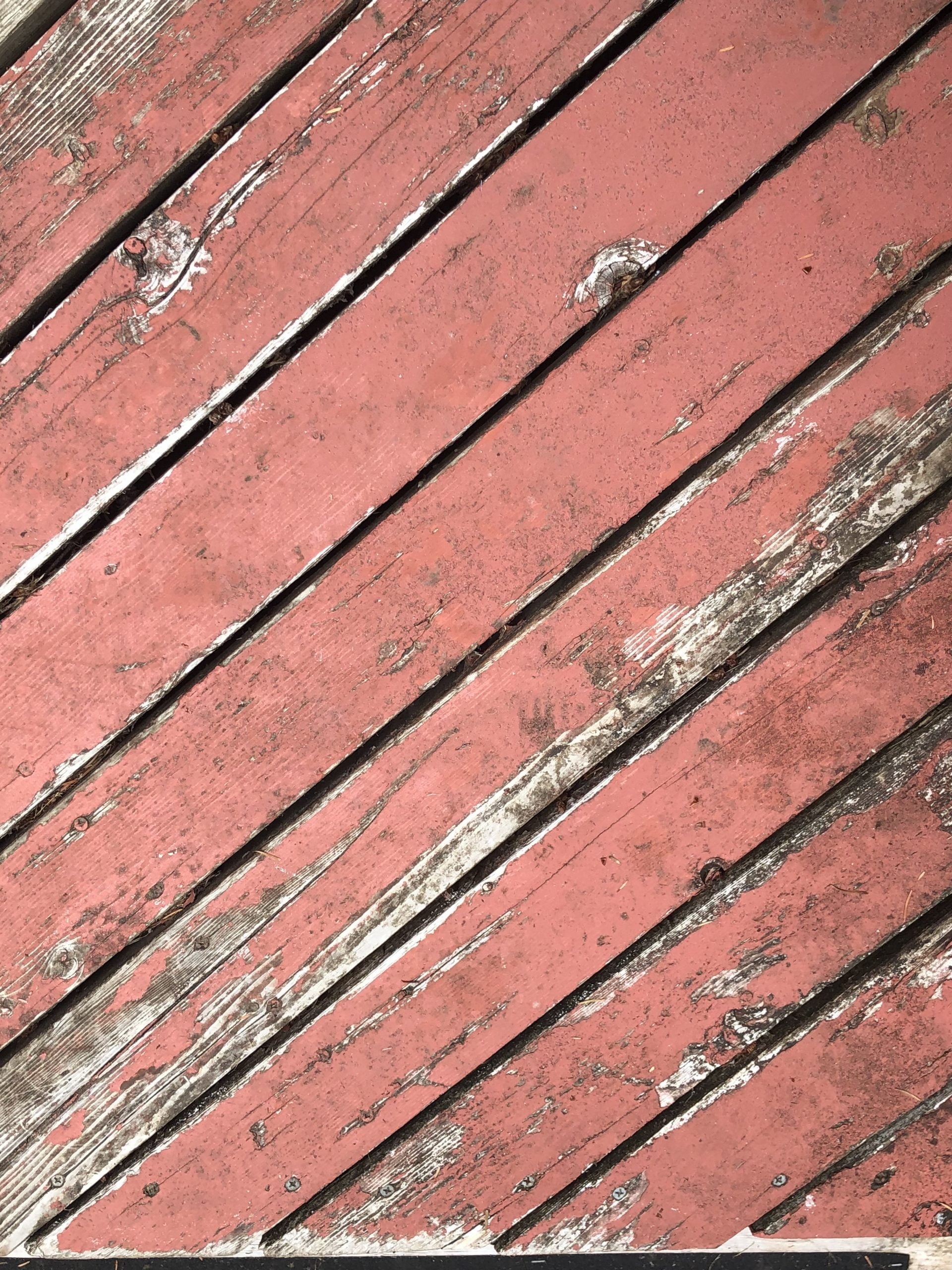

Olympic Deck Rescue-It Peeling Photos

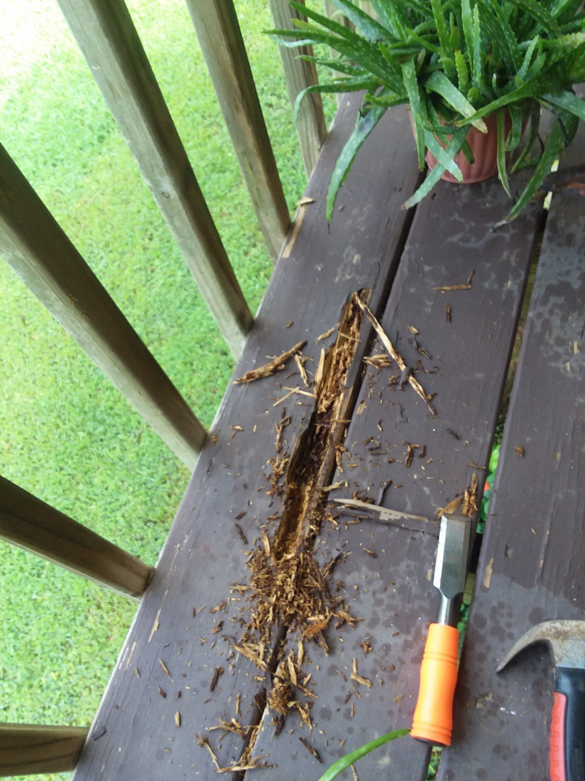

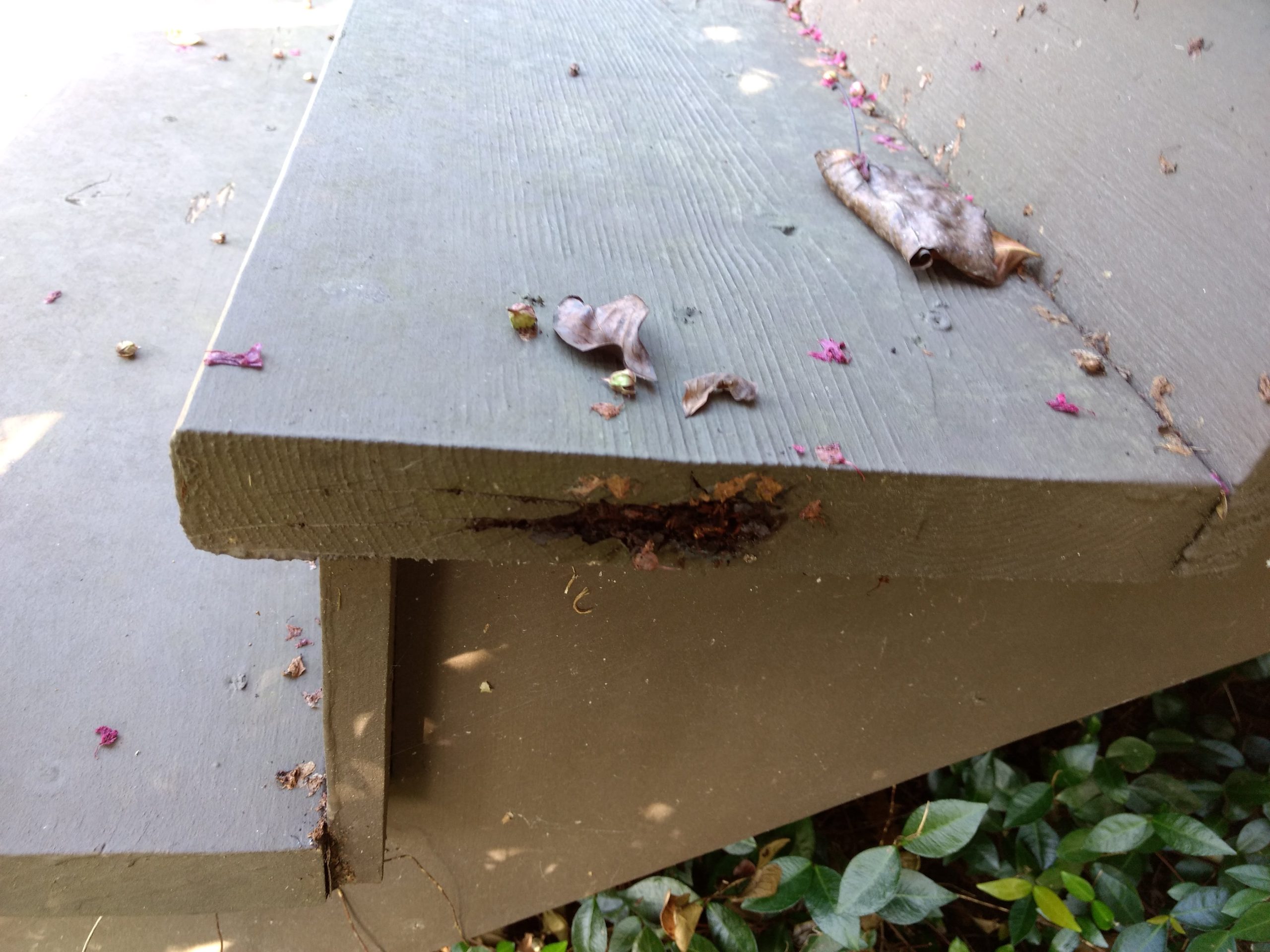

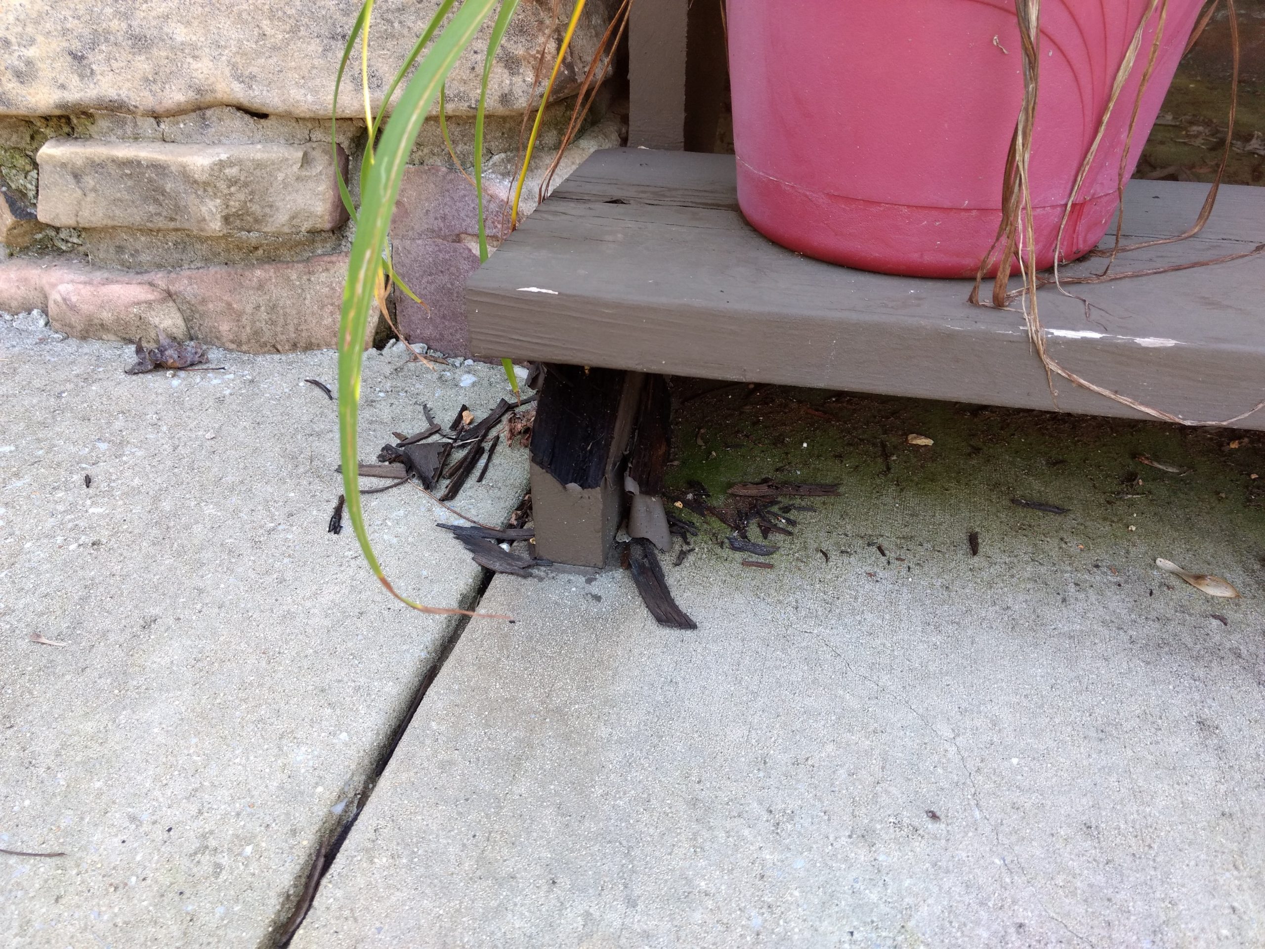

3. Deck Resurface Coatings Cause Rotting of Wood
Rust-Oleum Deck Revive RottingThe third issue is that most deck resurface coatings do not allow the wood to breathe. They coat the surface 100%, leading to dry rot and, eventually, deck replacement. When the coating cannot breathe, the rotting starts from the bottom up and traps moisture.
We suggest reading the comments below for consumers who have seen firsthand how their decking rots away, causing the need for a full replacement of the wood flooring.

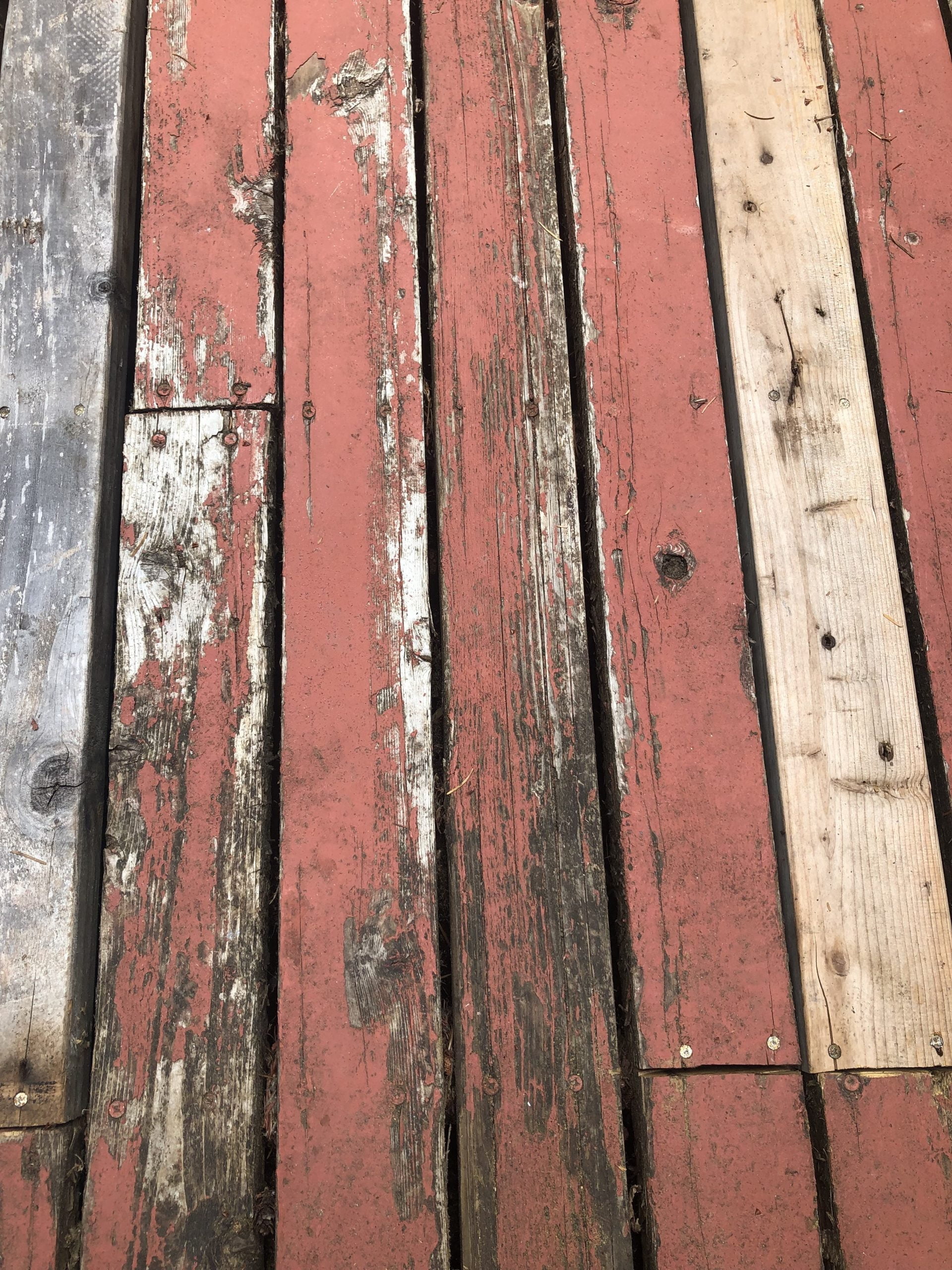

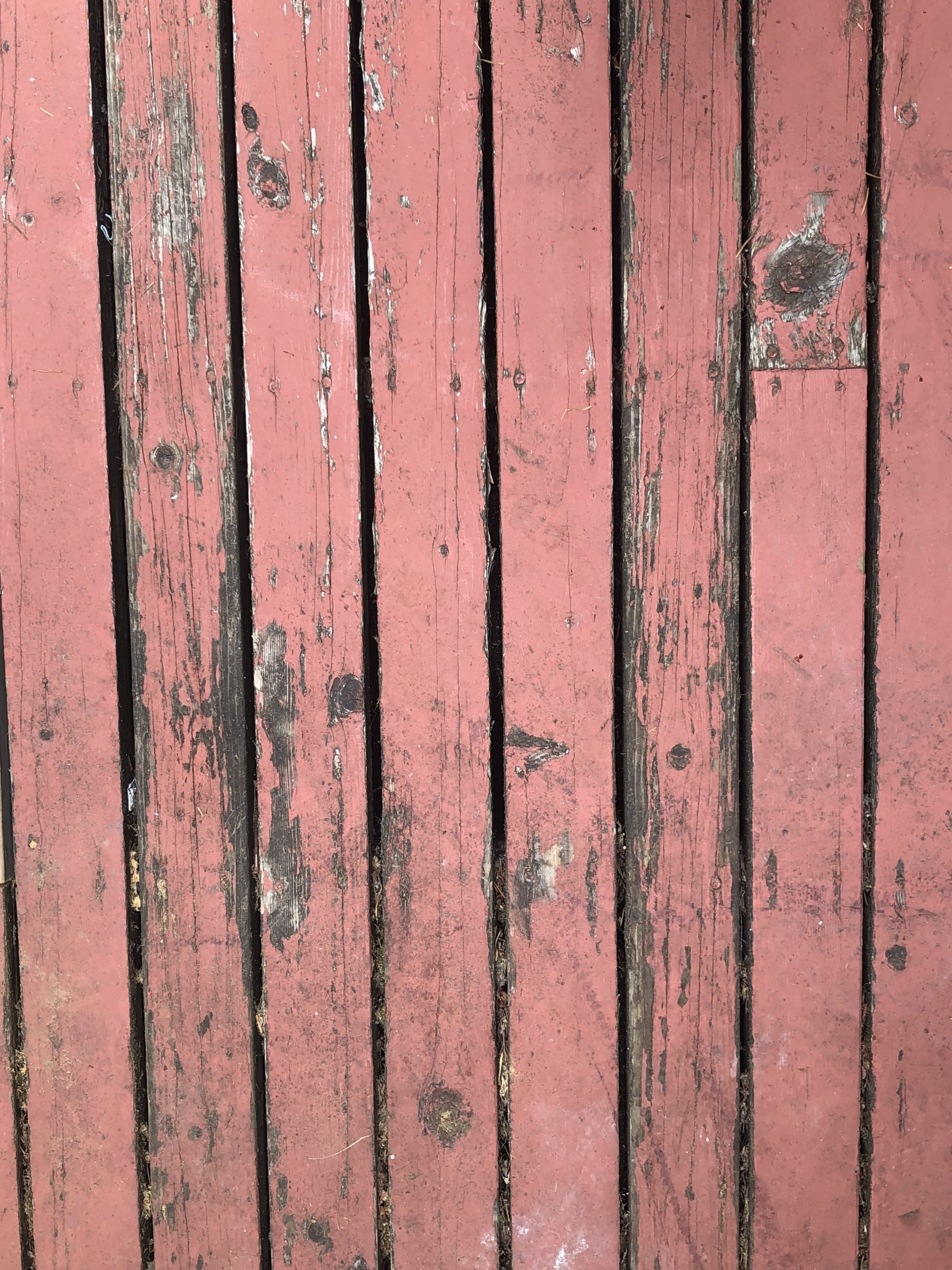

Rust-Oleum Rock Solid (Deck Restore) Peeling Photos
4. Deck Resurface Coatings are Costly
The cost per square foot for a deck resurface product is extremely high. This is mostly due to the poor coverage rate of these product(s). The average cost is around $1-2 per foot, which is astronomical compared to conventional wood restoration stains.
So, despite the manufacturers’ claims that the product lasts many years, I see firsthand that these products fail and peel within two years. They are expensive to apply, have a horrible coverage rate, create rotting wood, and are hot to the touch in direct sunlight.

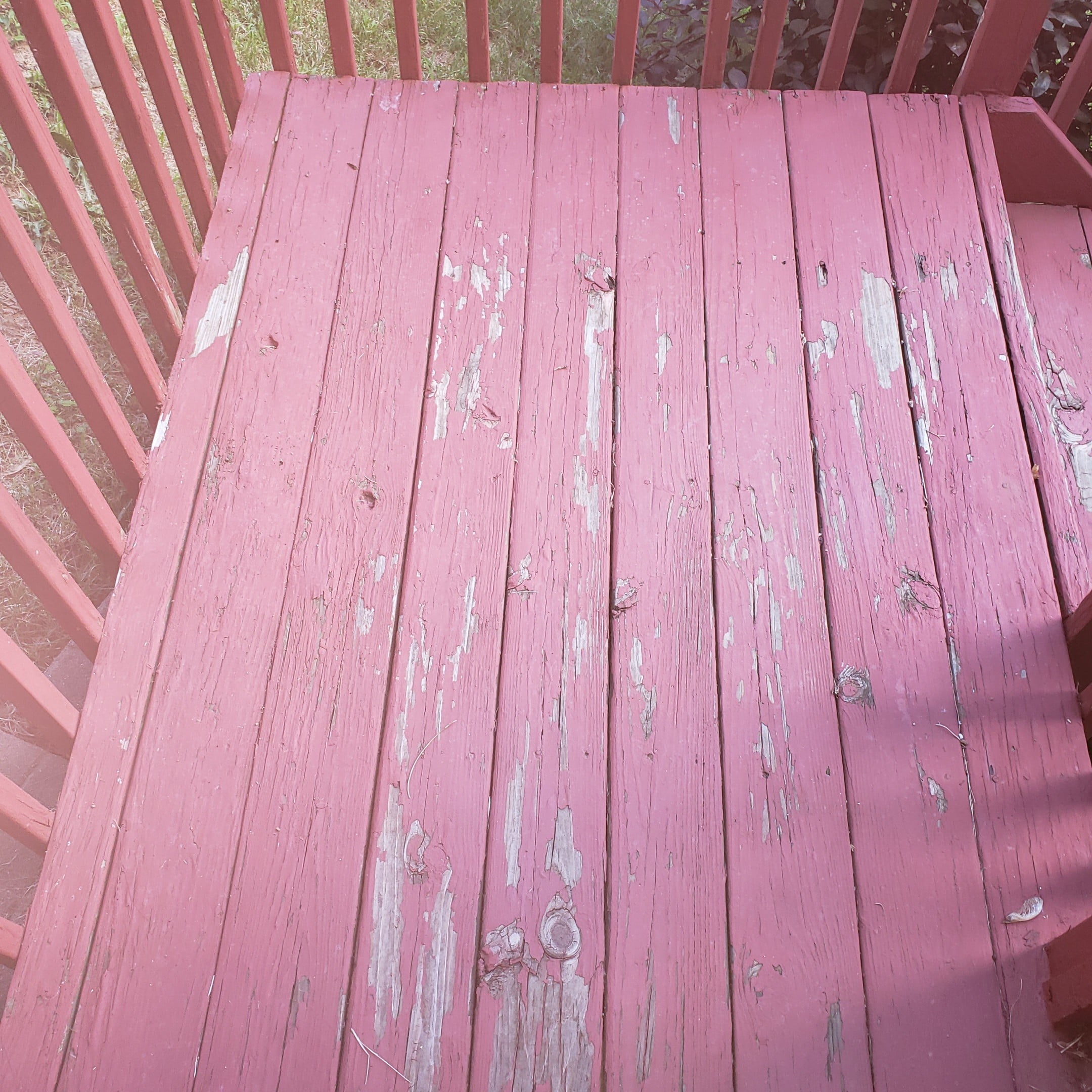

I have had Olympic rescue it on my deck for 3 years now. It’s finally starting to peel and I need to put another resurfacer down. I see you are a fan of the gulf synthetic product which I will try. How do I prep the deck that is now covered with Olympic rescue it. Can I pressure wash and paint right over it? Does it need to be peeled away and sanded?

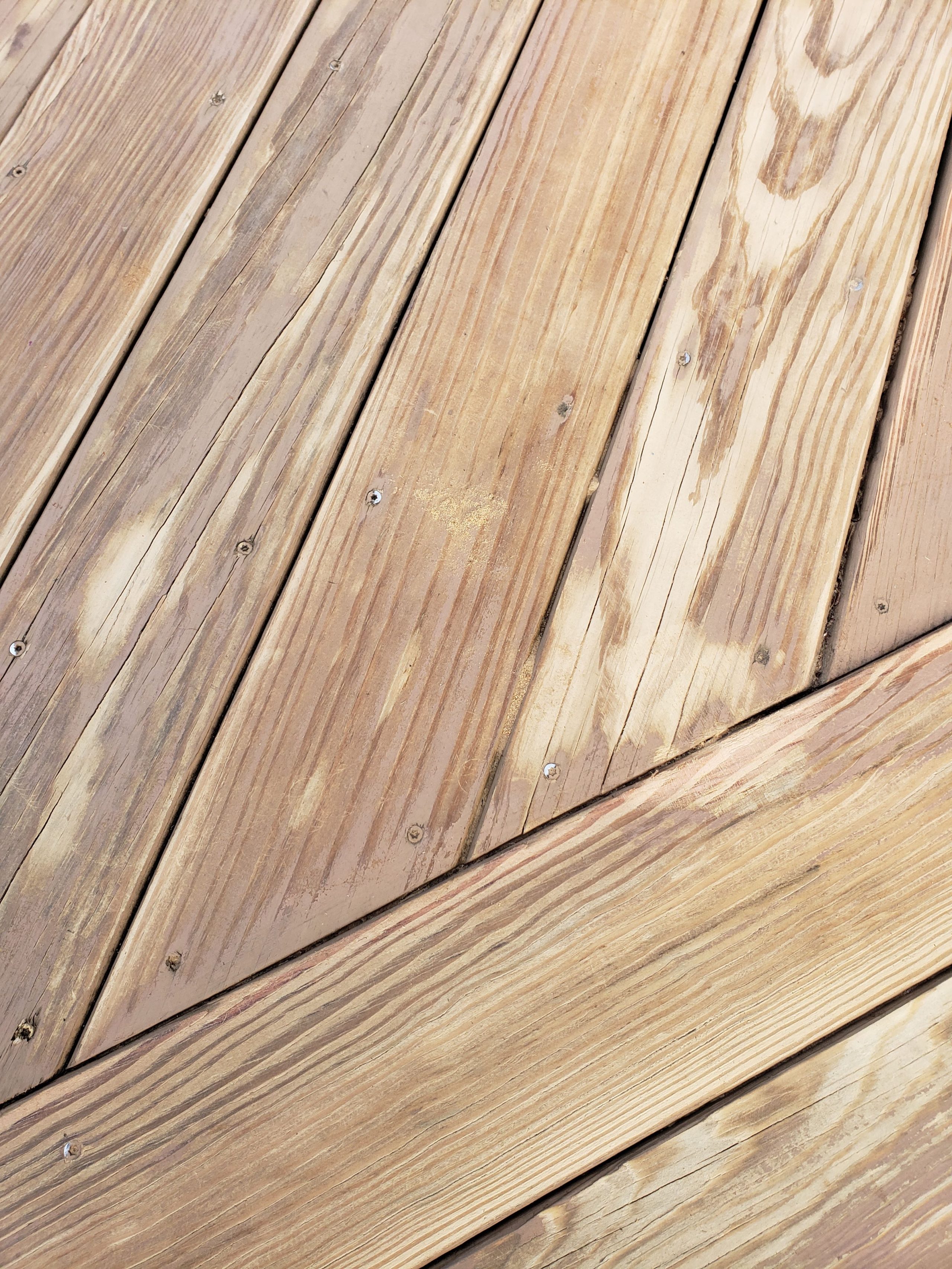

So this is our decks current condition, obviously we still need to sand it down.

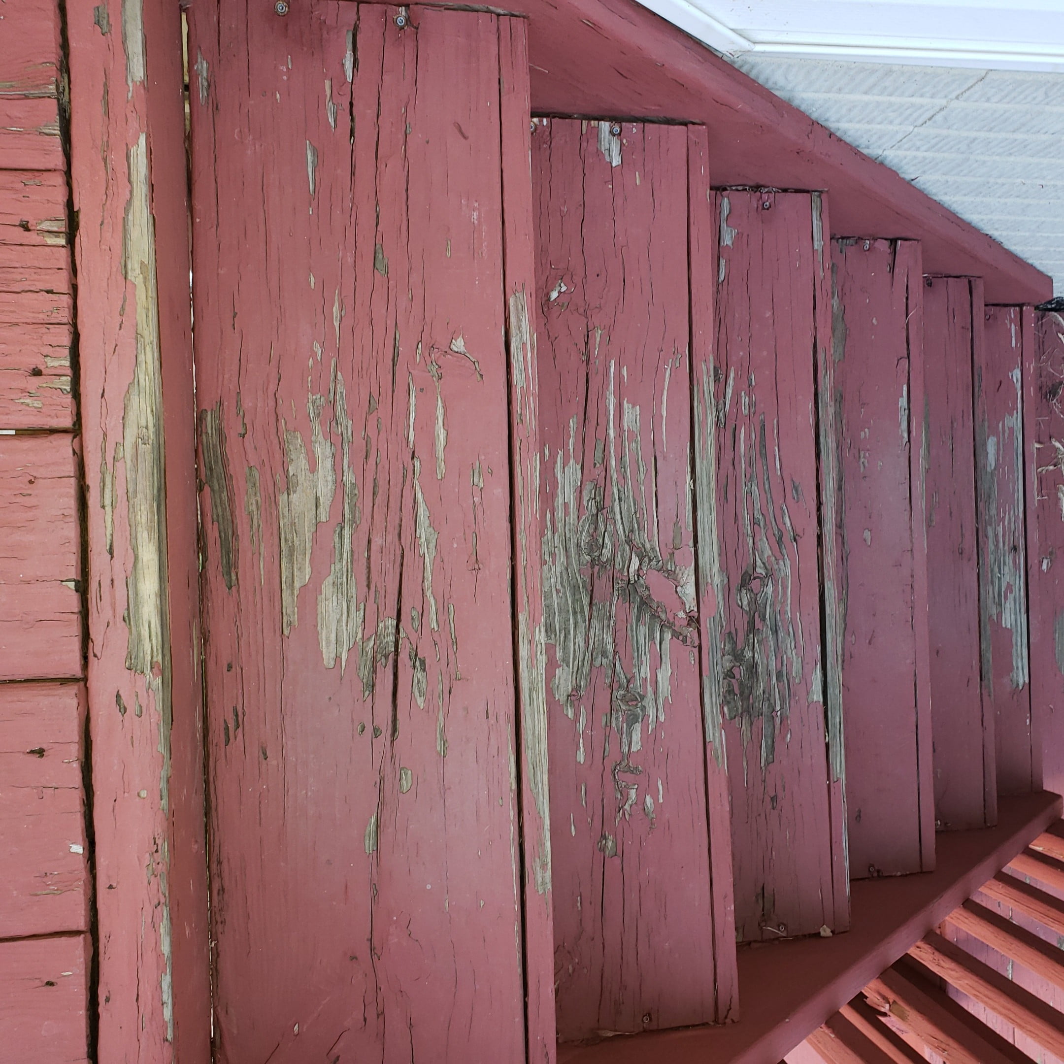

Customer used Behr Deckover about 5 years ago. Just removed, maybe, 50% by scraping and sanding using 60/80 grit on power sander. Customer wanted to put same product back over it. I told customer that this product is not recommended by most. He is open to anything. My question: would it be better to apply same product being that 1/2 is still covered with the Behr? If not, suggestions on trying to get the remaining 1/2 off? The 60/80 grit didn’t come close to removing some of the stain. Thanks.
