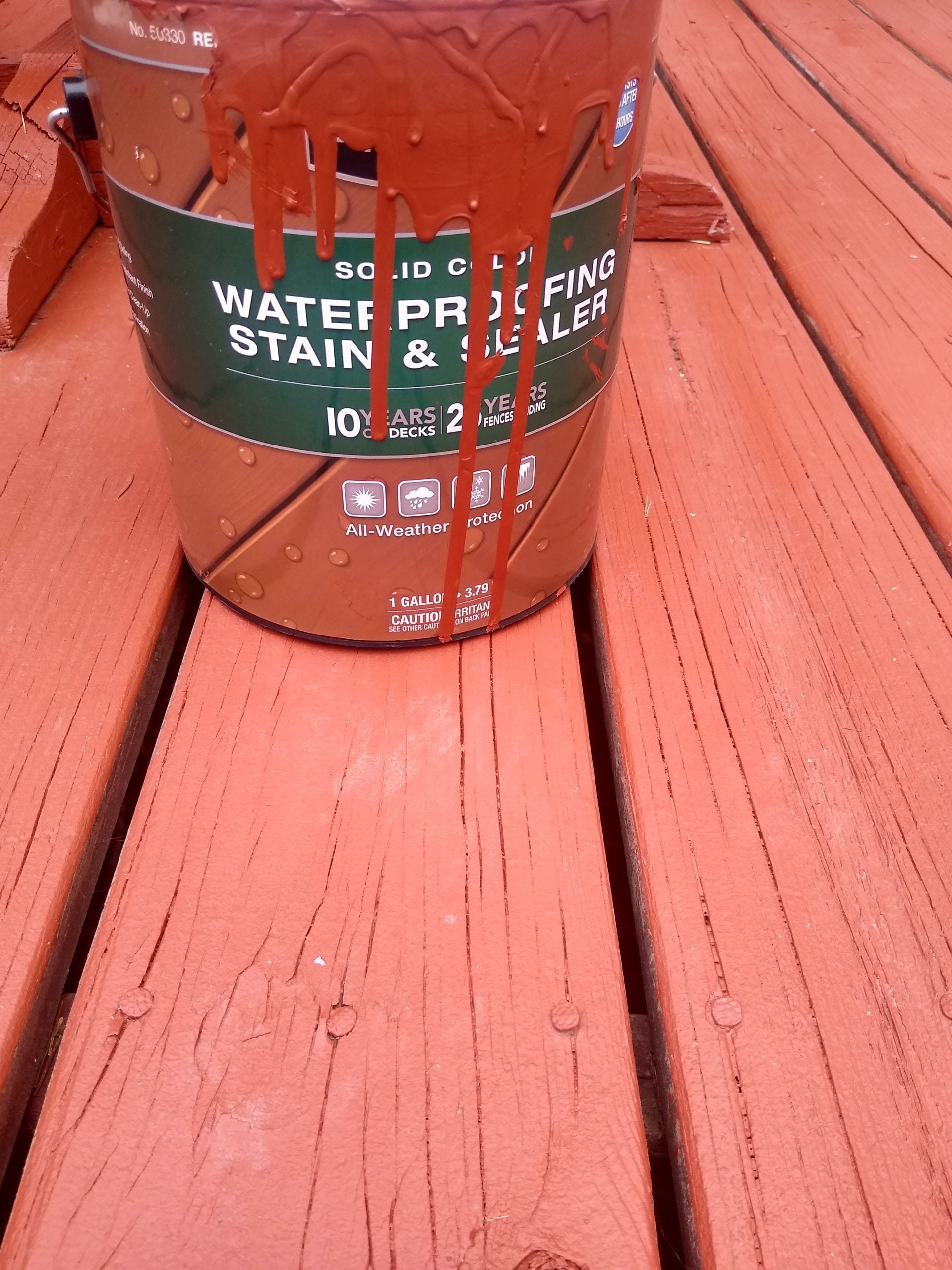

The Behr Solid color we used was custom-mixed to a red. The two coats applied to our pressure-treated pine covered nicely and did not show any wood grain, which is expected with a solid stain. Application was even, with no overlap lines.

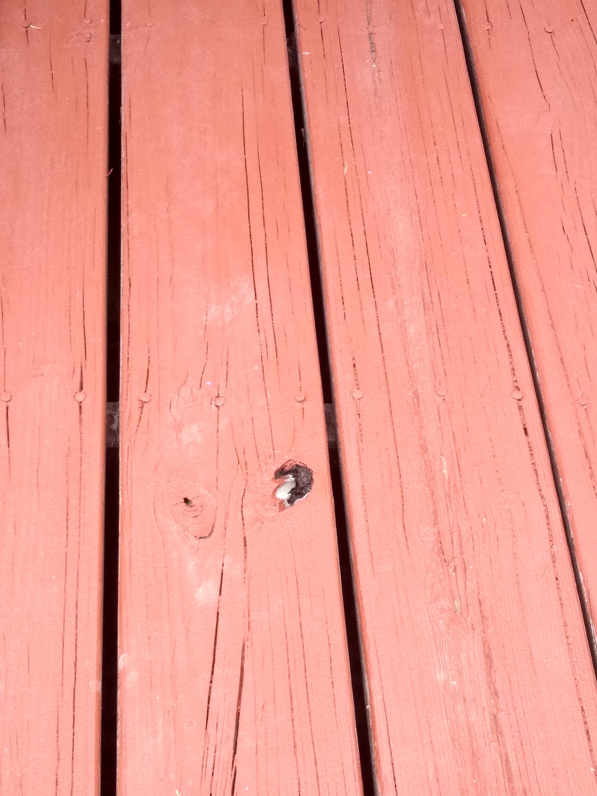

DeckStainHelp.com Customer Photo of Behr Solid Color Deck Stain Peeling
Wear/Tear and Peeling: 3
At the 2-year mark, there was significant wearing and peeling on our test deck. This matches what we consistently hear from readers — peeling ranging from a few weeks to two years on deck floors is the single most common complaint we receive about this product.
