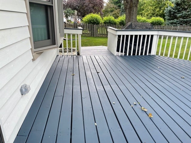

Appearance After Initial Stain Application: 5
– Similar to our first review, the Arborcoat after drying had a “plastic” unnatural look to the wood when done. The finished result was a film-forming stain, similar to a varnish.

Wear/Tear and Peeling: 3
– This product does not perform well on our tests. It is prone to peeling and wearing. After 2 years much if not all of the flooring had peeling issues. Cracking, peeling, and mold growth were evident throughout.

A local paint contractor completely sanded and cleaned my cedar deck. Arborcoat was applied, apparently easily. Almost immediately, areas in the sun began to peel. The paint contractor and an Arborcoat representative came out to review the situation. The areas that were compromised were resanded and Arborcoat was applied again. Since then, all areas have lifted and peeled except those areas in constant shade. Very disappointing.
