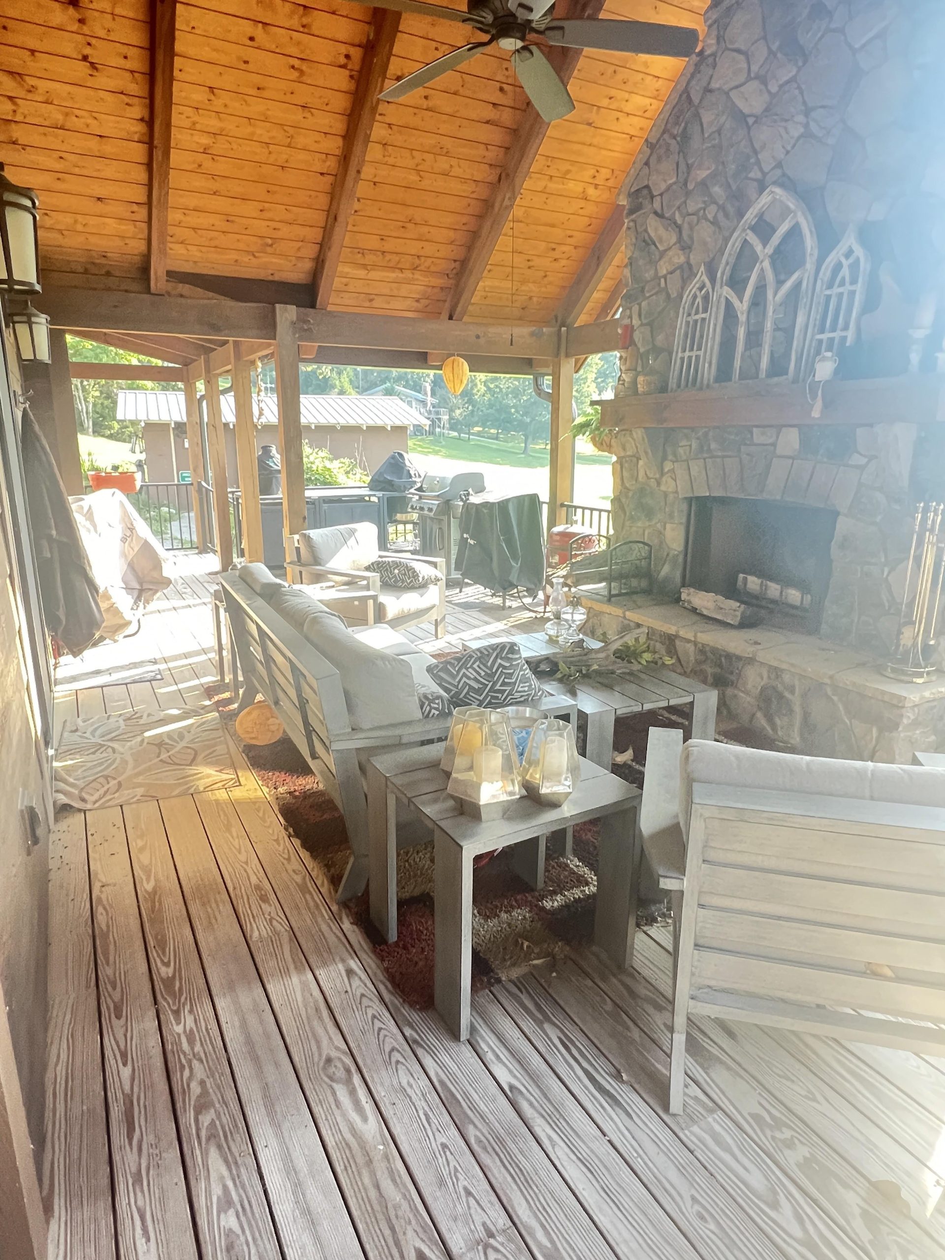

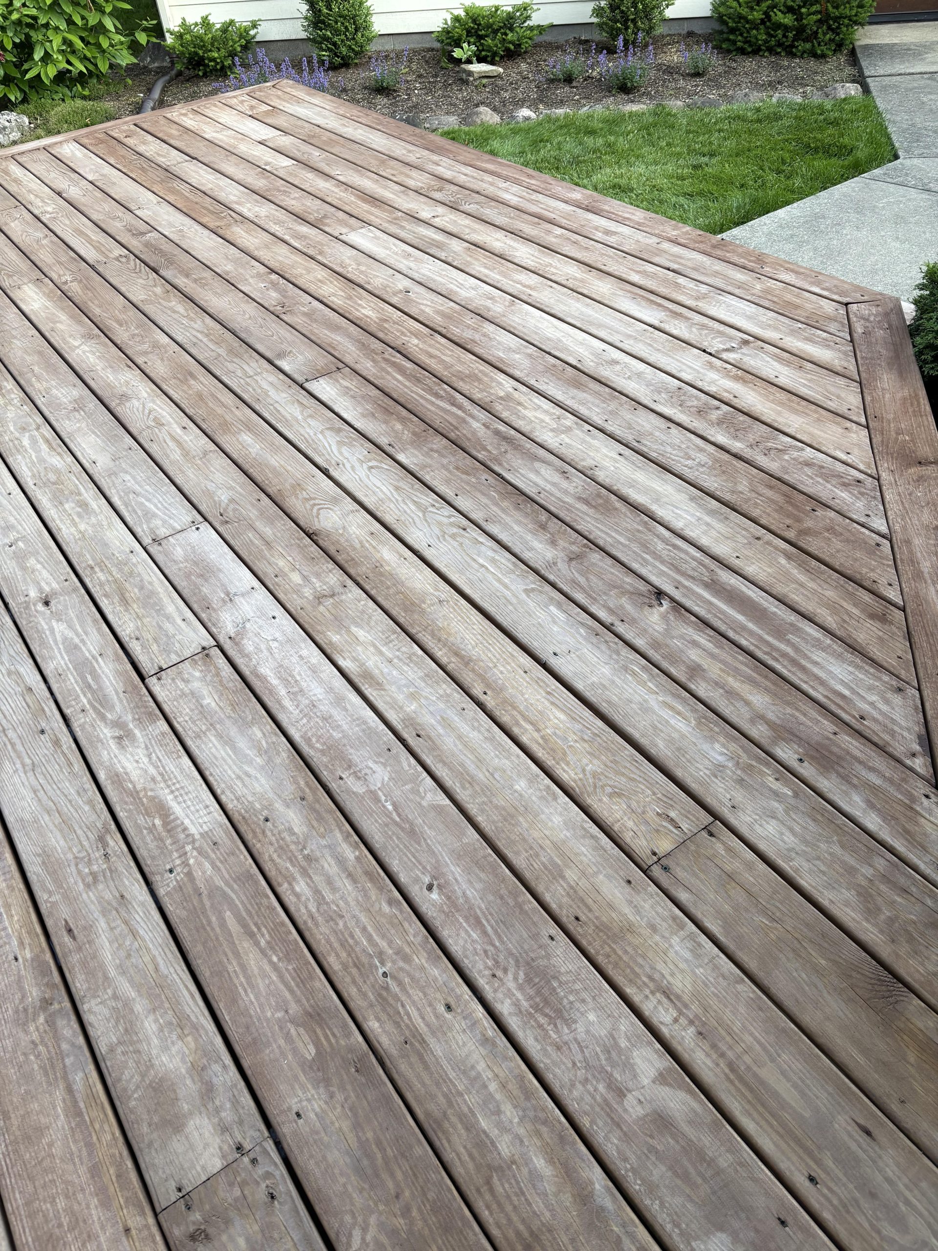

Hi Scott, Thank your information regarding when to stain our back deck, which was built in sections. We will be waiting until winter is over to stain it. Over the past month or so we noticed significant shrinkage of the wood we put down (Lowes treated lumber) and the spaces between the decking planks is larger than we would like. (Unsure of how far apart they should be.) We are now moving on to a deck on the side of the house. We switched to Menards treated lumber which is thicker, but are wondering if we should put them right next to each other so if/when shrinkage occurs the spacing will not be as far apart. Or are we asking for trouble. SE Michigan home, NW side of the house, Have pine trees lining the lot about 50m feet away, but in late afternoon the sun is blindingly bright.
Sharon
Sharon
3 months ago

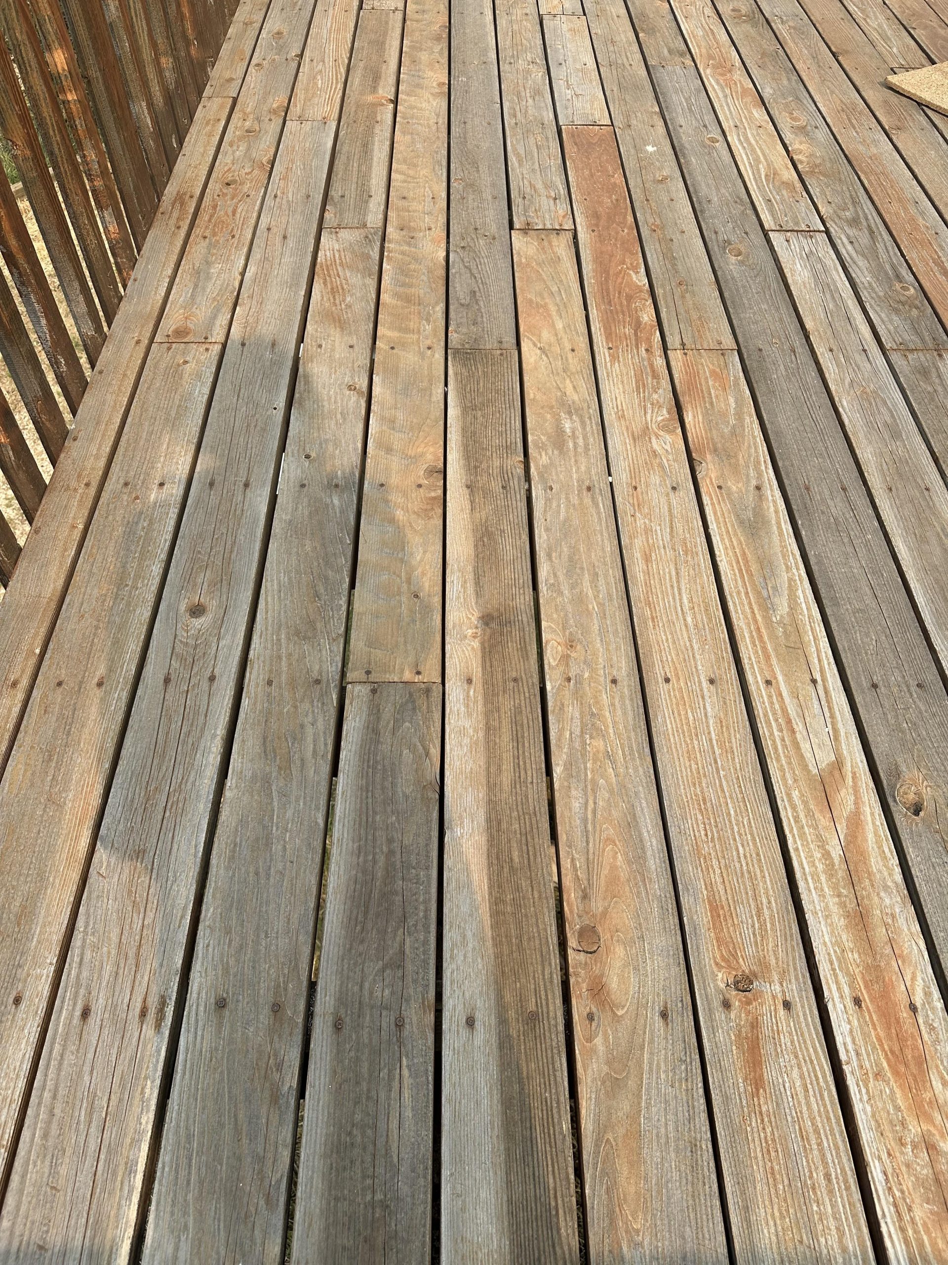

Hi, thank you for all the information you’ve provided here! I believe something was missing in my process last time around but I’m not sure what. My deck is about 10 years old. I don’t fully remember my sequence and steps from last time, but I used Behr cleaner and brightener, felt like I rinsed the wood forever, got a decent amount of wood furries, and sealed it with temps in the 50s. Two years later, I have to strip peeling semi-transparent stain/sealant off my cedar deck and start fresh. I used Behr premium semi-transparent and plan to use the same again, same color because I think the problem was me, not the product. I have some areas I planned to patch where the wood splintered off or there are knothole depressions. There is some black mildew on spindles and some decking, nothing too serious I don’t think.
This is what I’ve learned, is this accurate? I need to strip, ideally renting a pressure washer, then brighten immediately afterwards, let dry for 24-48 hours?, then sand remaining problem areas/rough spots. Vacuum thoroughly, then seal!
My questions:
Would I do patching after the brightening?
Do you have suggestions or tips for stripping/addressing railing spindles?
I have a large garden about 10′ away. Will that be at risk of the spray/stripper reaching it when I’m working on the railings and using the pressure washer?
I’m assuming it would make more sense to start with the benches and railings for each step and then do the decking/steps, would you agree?

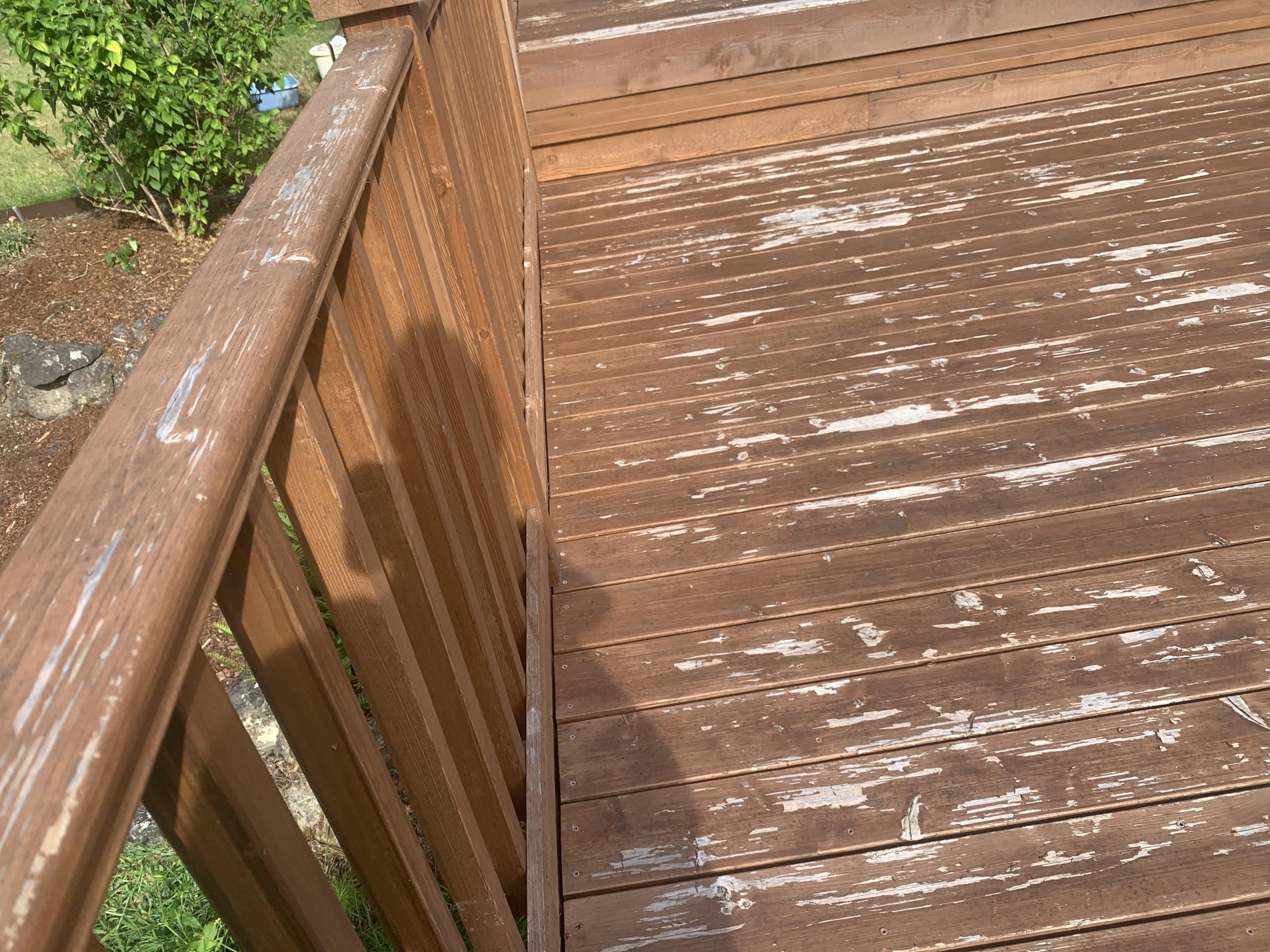

I included photos of the general decking, the railings, and a couple damage spots that show how the stain is peeling.
Thank you so much for taking the time to answer this!

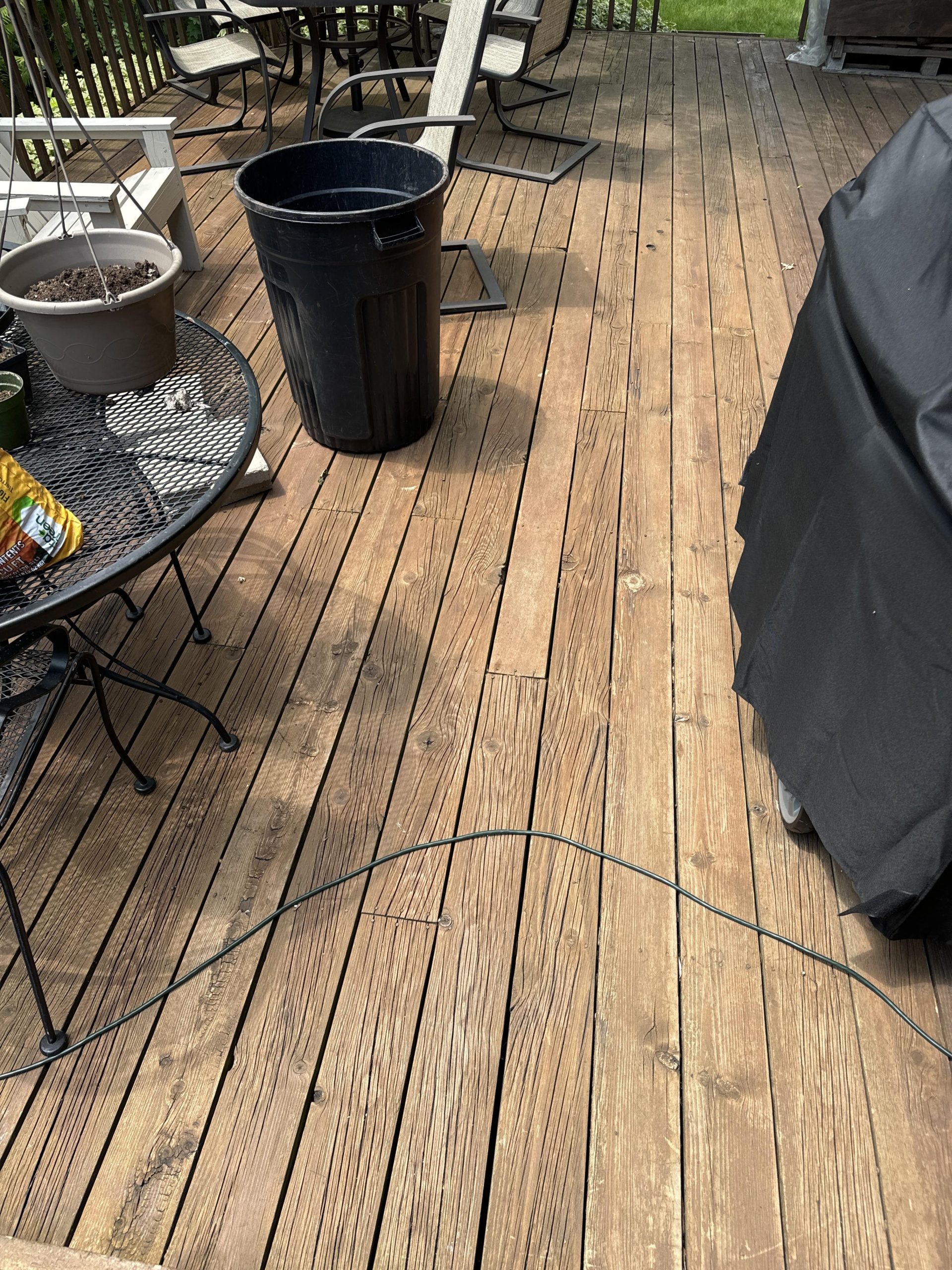

Hi Scott, thanks for your help! My deck looks exactly like the photos in your review. I’ve been very disappointed.
Is your recommendation to hire it out because of the time it would take, or the equipment I’d need, or something else? If it matters, the deck is 12×12 with a railing, a bench, a planter, and a couple steps.
I’ll check out the brands you recommended.
Thanks again, super helpful!

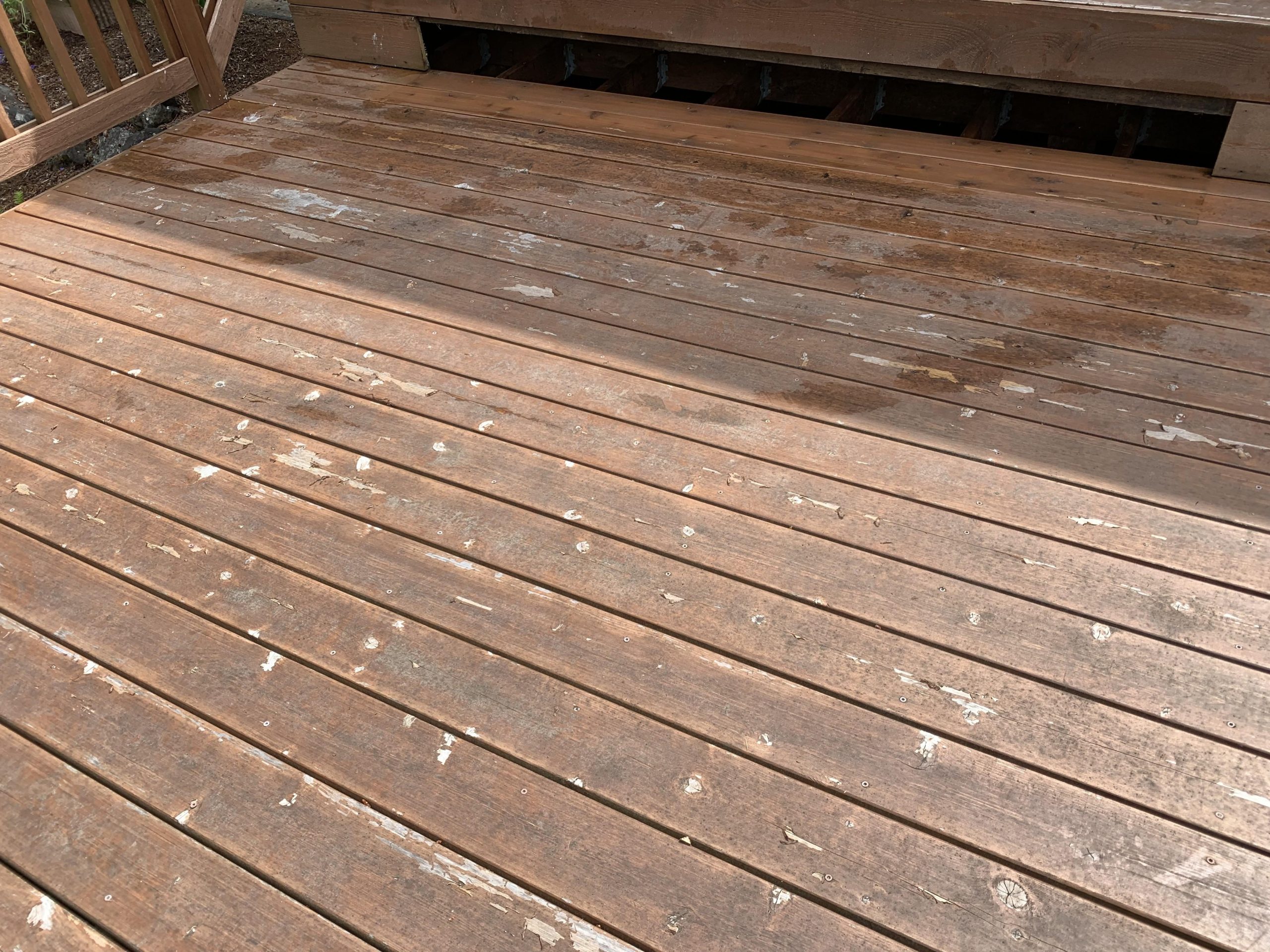

OK thank you! I plan to use RAD products,the stripper and the gel additive if needed. Would you recommend the booster as well?
Here are some new pics and I’m reposteing a couple from before. In these, you’ll see that the 4×4 posts may not have had the Behr product, which I guess I’ll still have to strip since I’m using a different stain this time. I also included a photo of the backs of the benches which have drip marks, in case that matters. Other than that, the majority of the deck just looks similarly ugly and peeling. The railings sat for 2 years untreated.
You had said not to use wood filler, so for knotholes etc, you just leave them be?

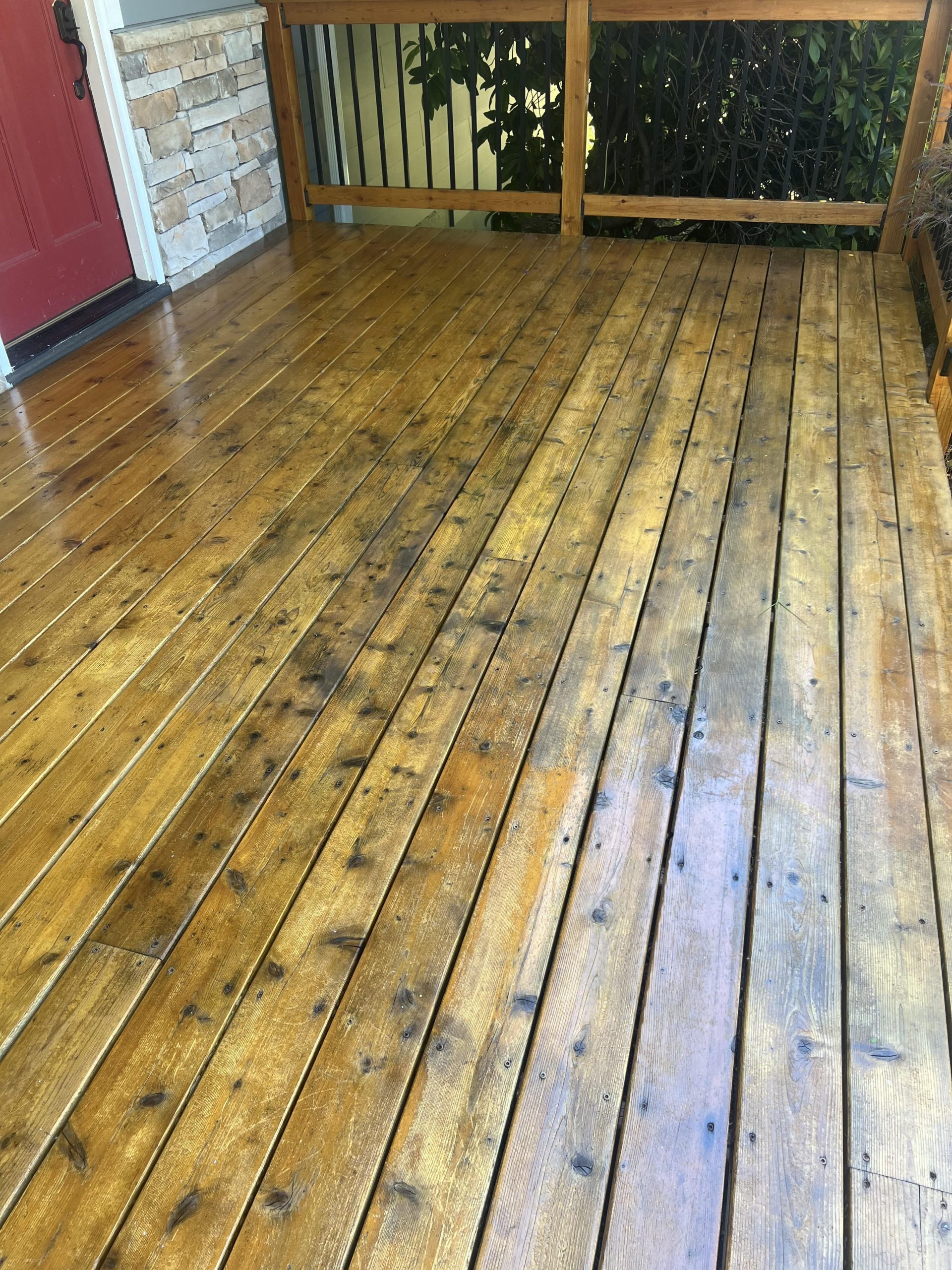

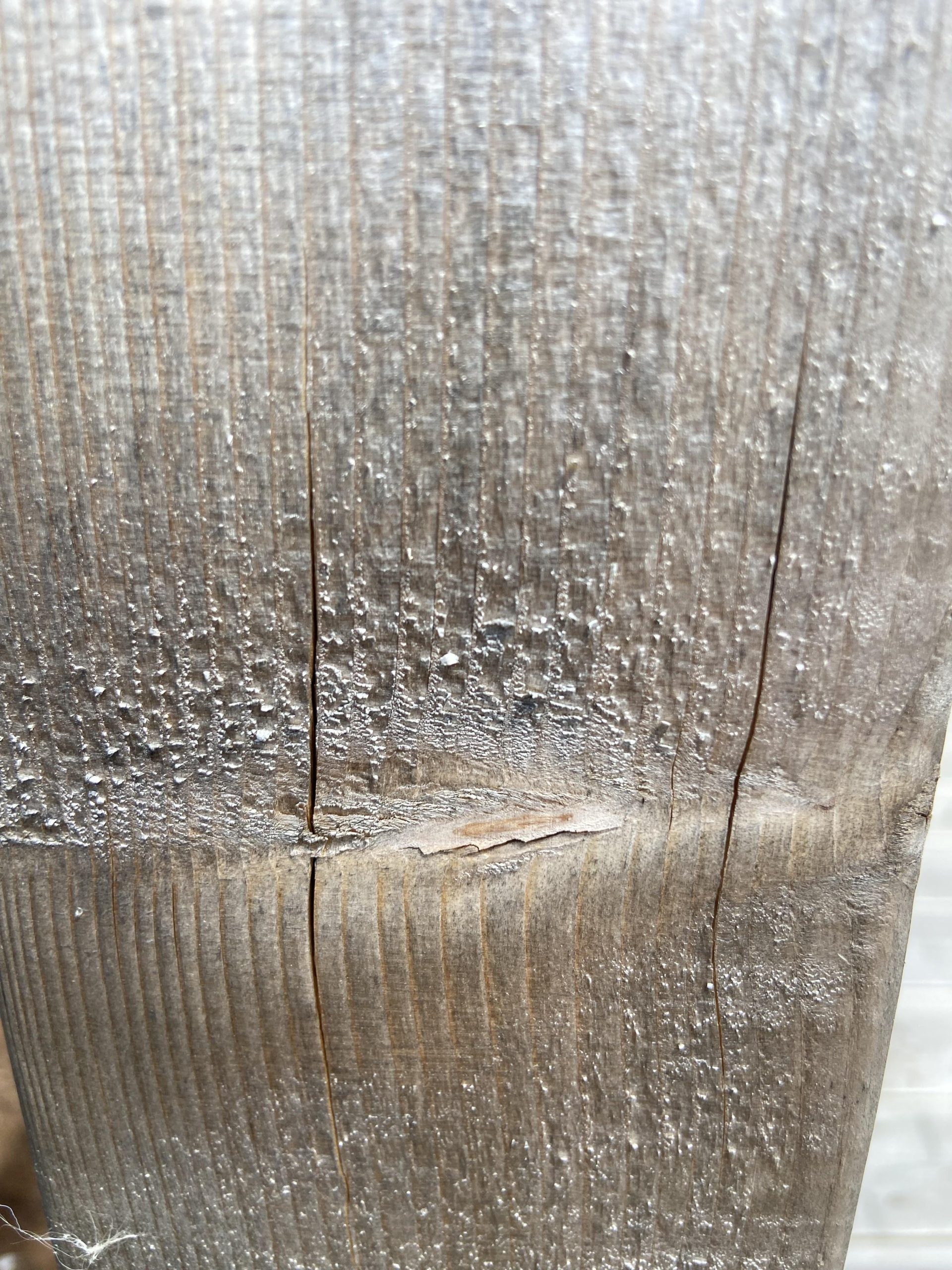

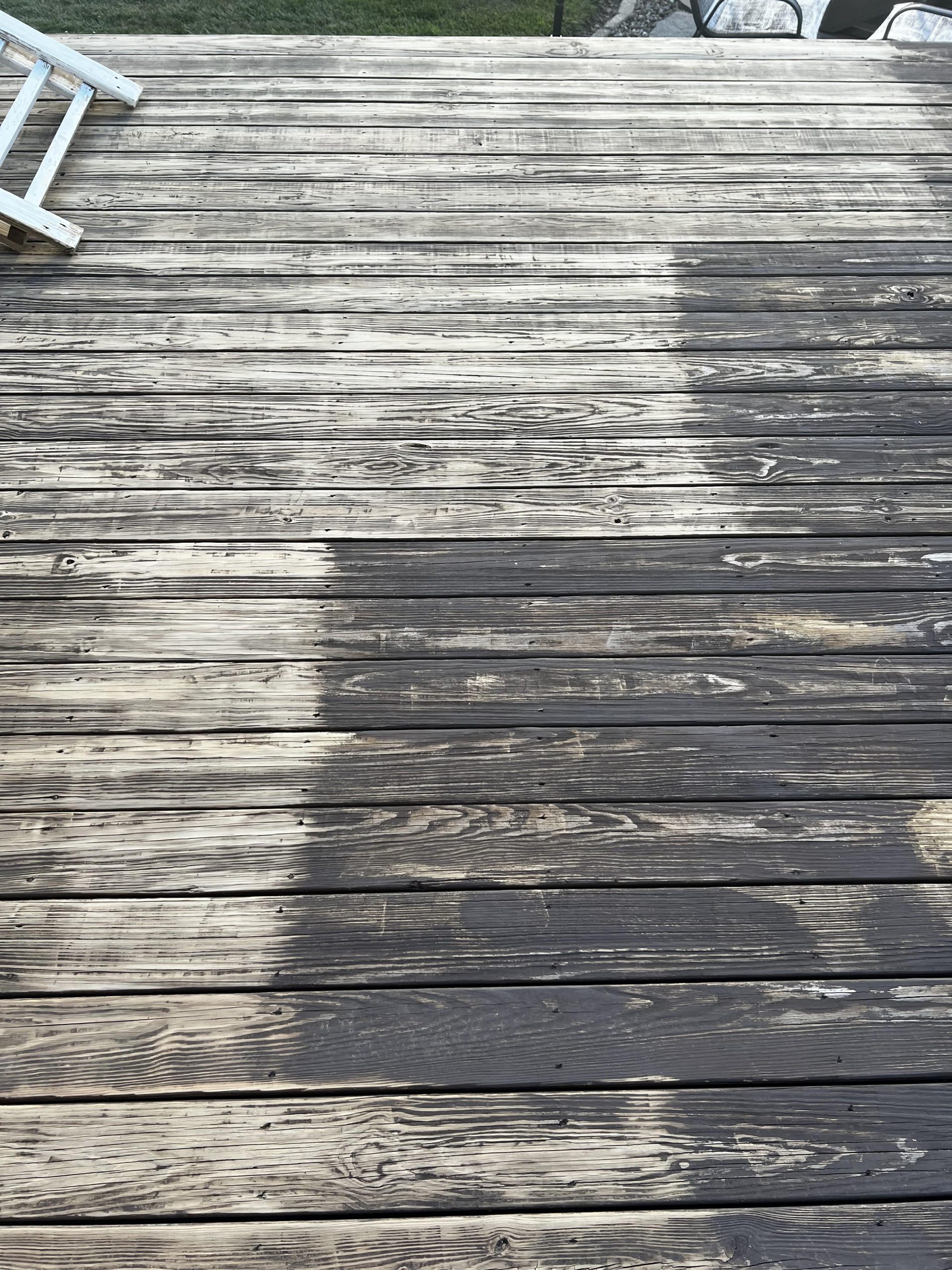

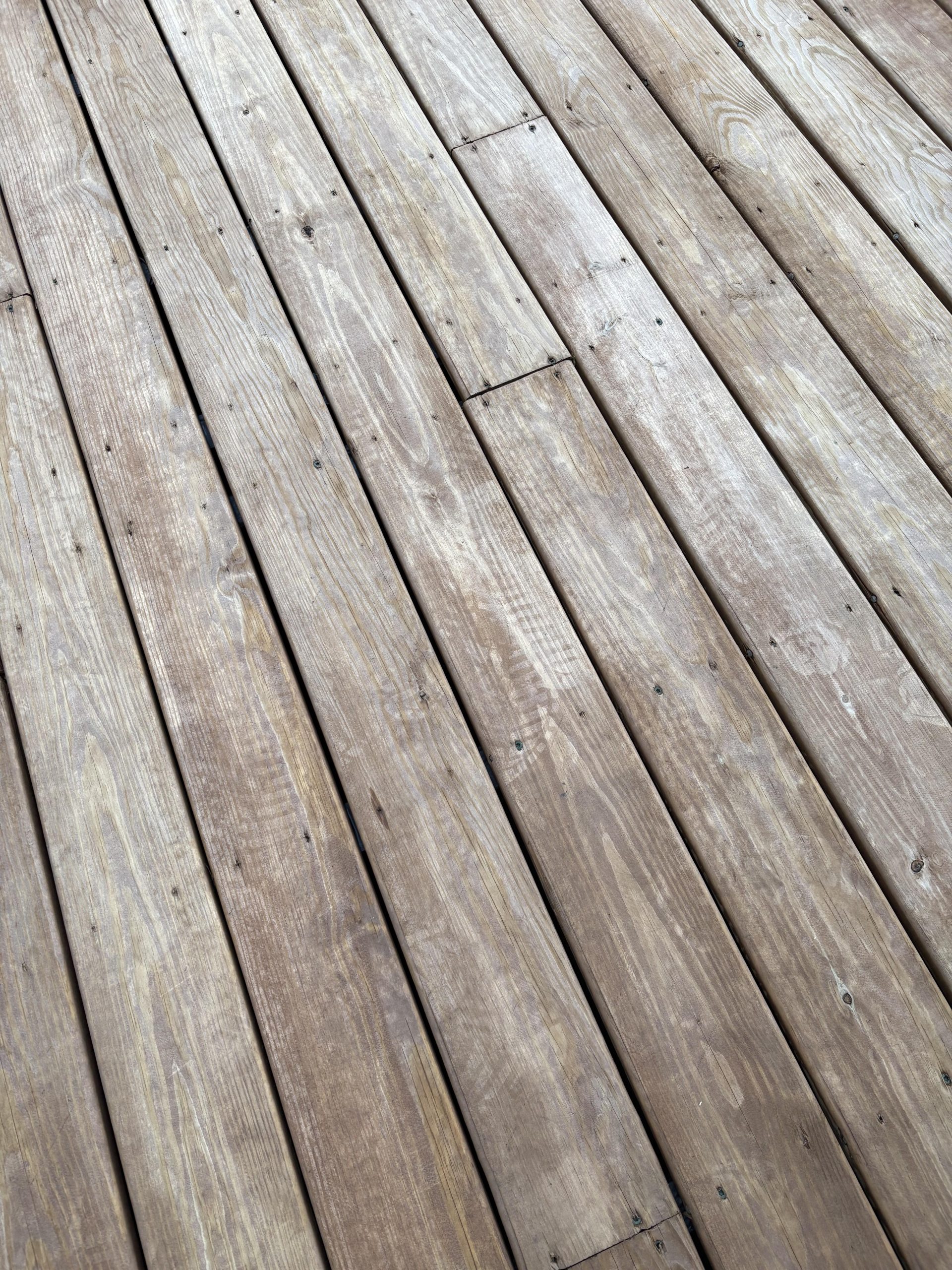

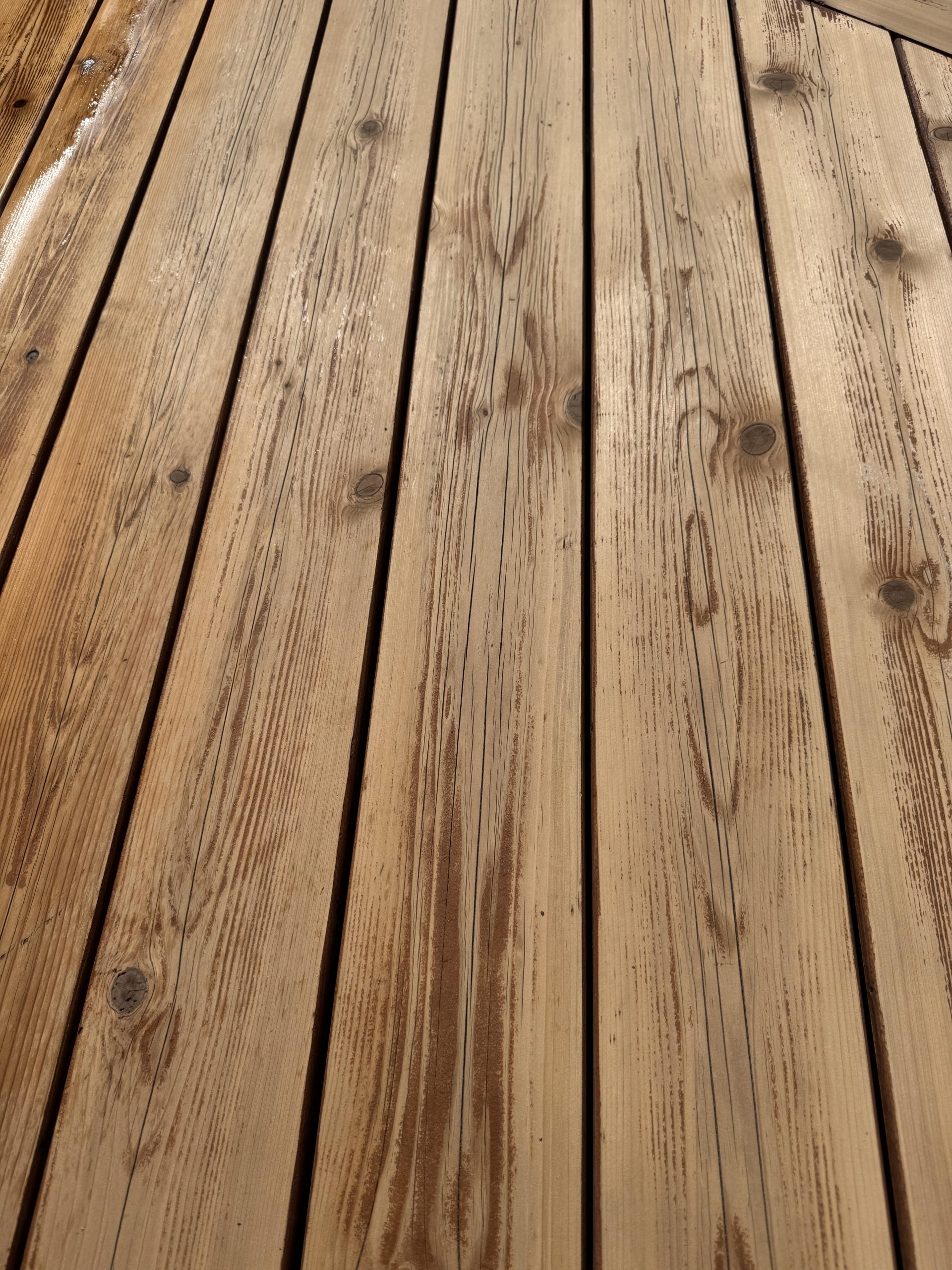

I sanded my cedar deck with 60 grit than 80. It previously had restore a deck stain on it. I’m going to restain it with the same stain. I still need to use the restore a deck cleaner and brightner. I was wondering if I should use a stripper to get the rest of the stain off. Problem is I do not have any stripper if you recommend stripping what do you recommend for a stripper in Canada
IMG_5457
IMG_5456

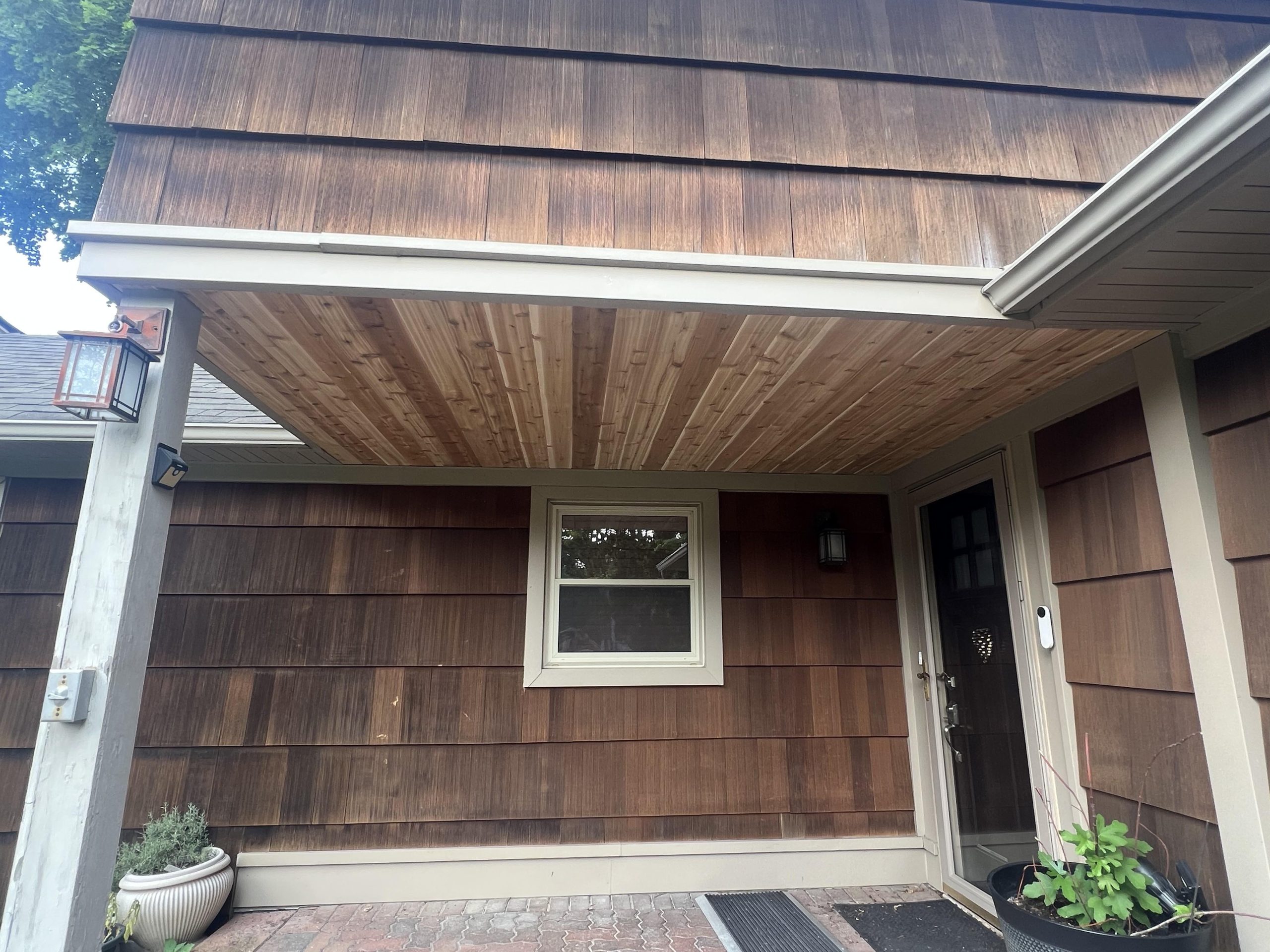

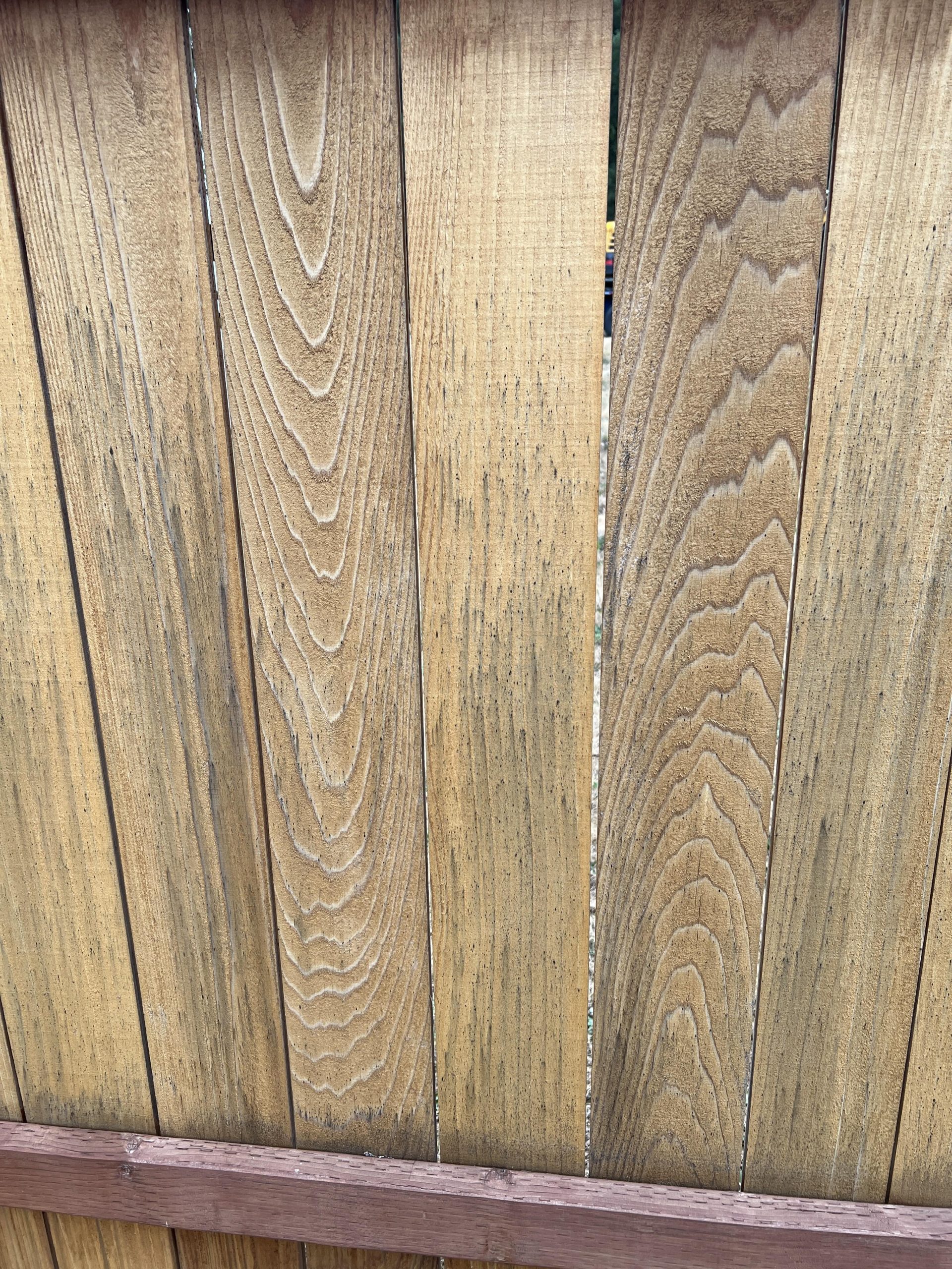

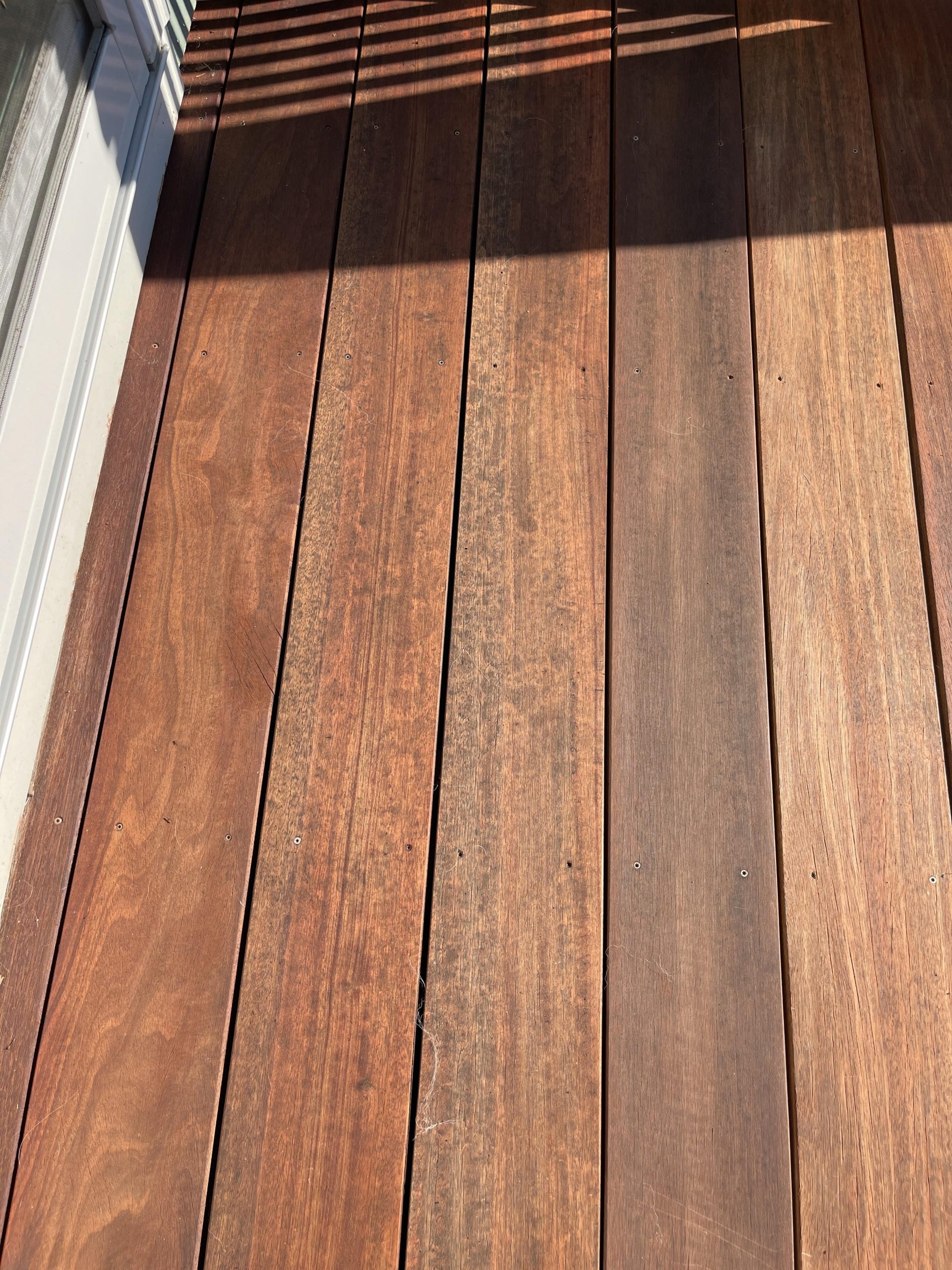

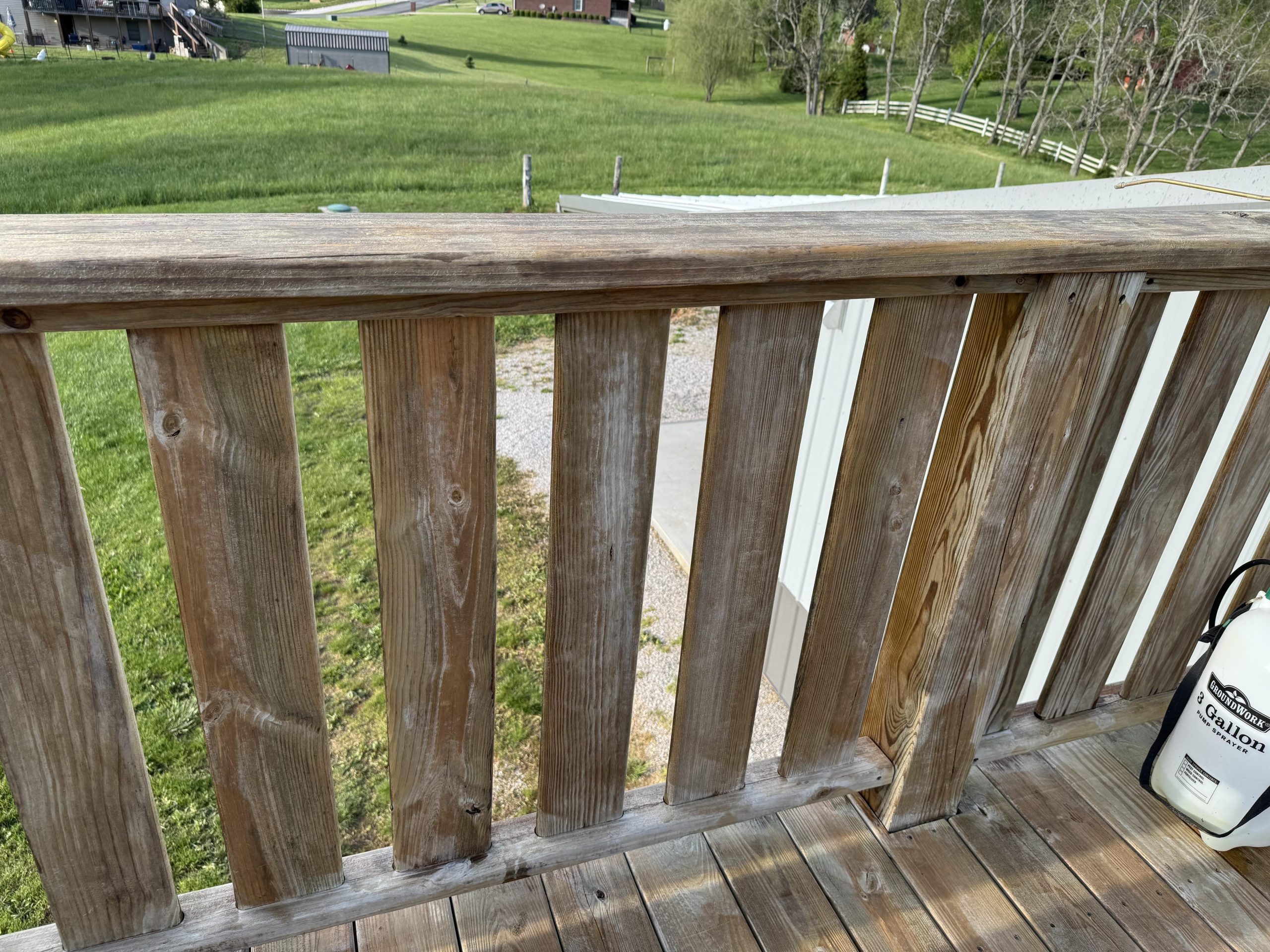

Hi Scott – thank you for sharing your knowledge!
I recently moved into this home and the previously home owner previously stained it with a semi-transparent waterproofing stain from Home Depot. I’d like to refinish this in a dark brown stain. Would you recommend stripping or sanding it? Secondly, we got some steps that weren’t previously stained – how should I handle those? Thanks a million!
IMG_7345
IMG_7346

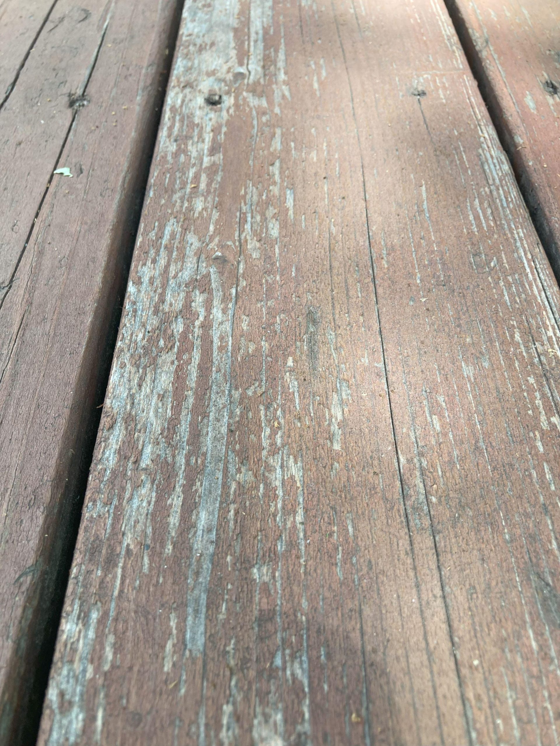

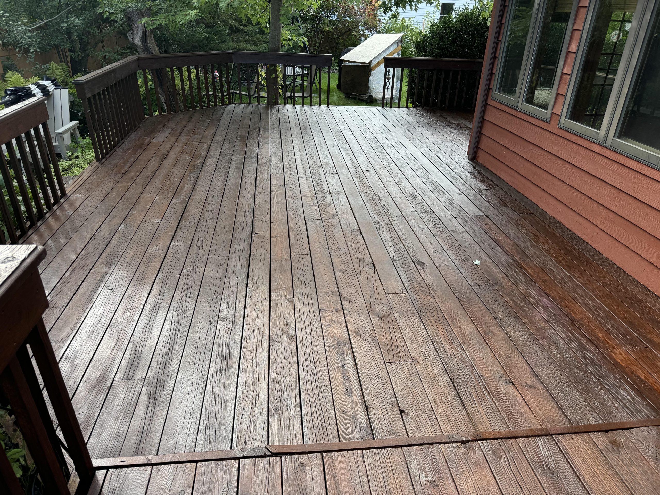

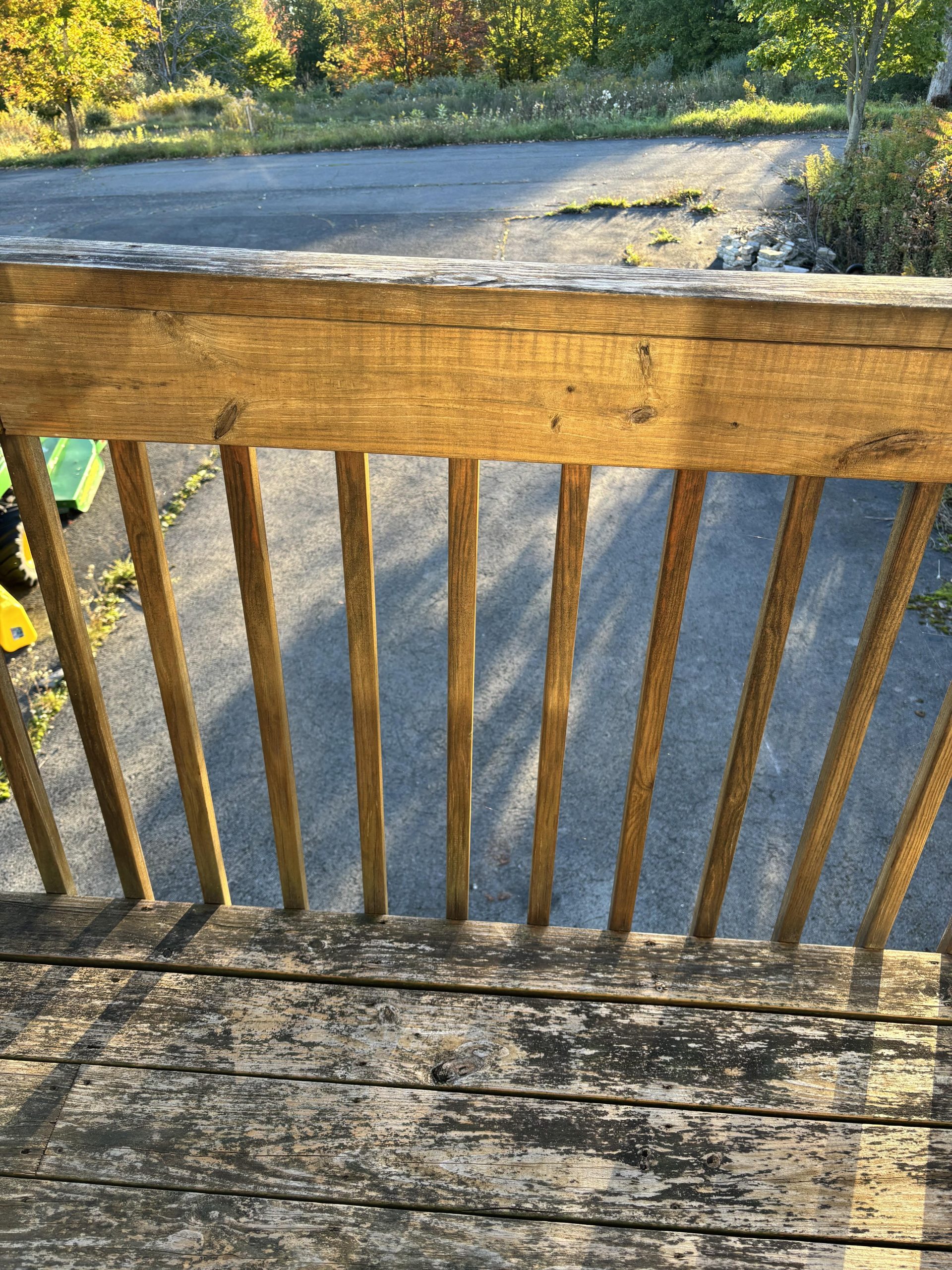

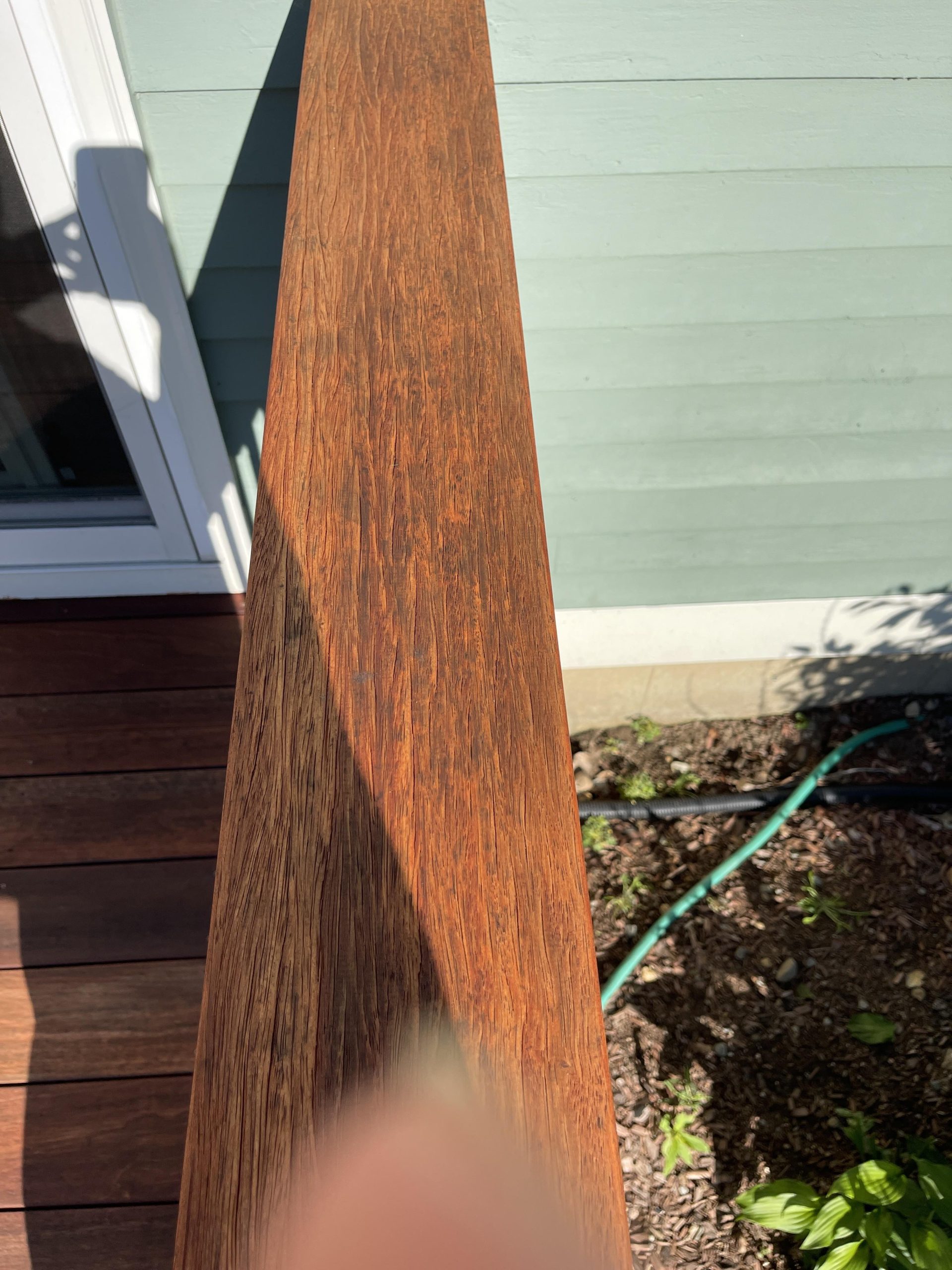

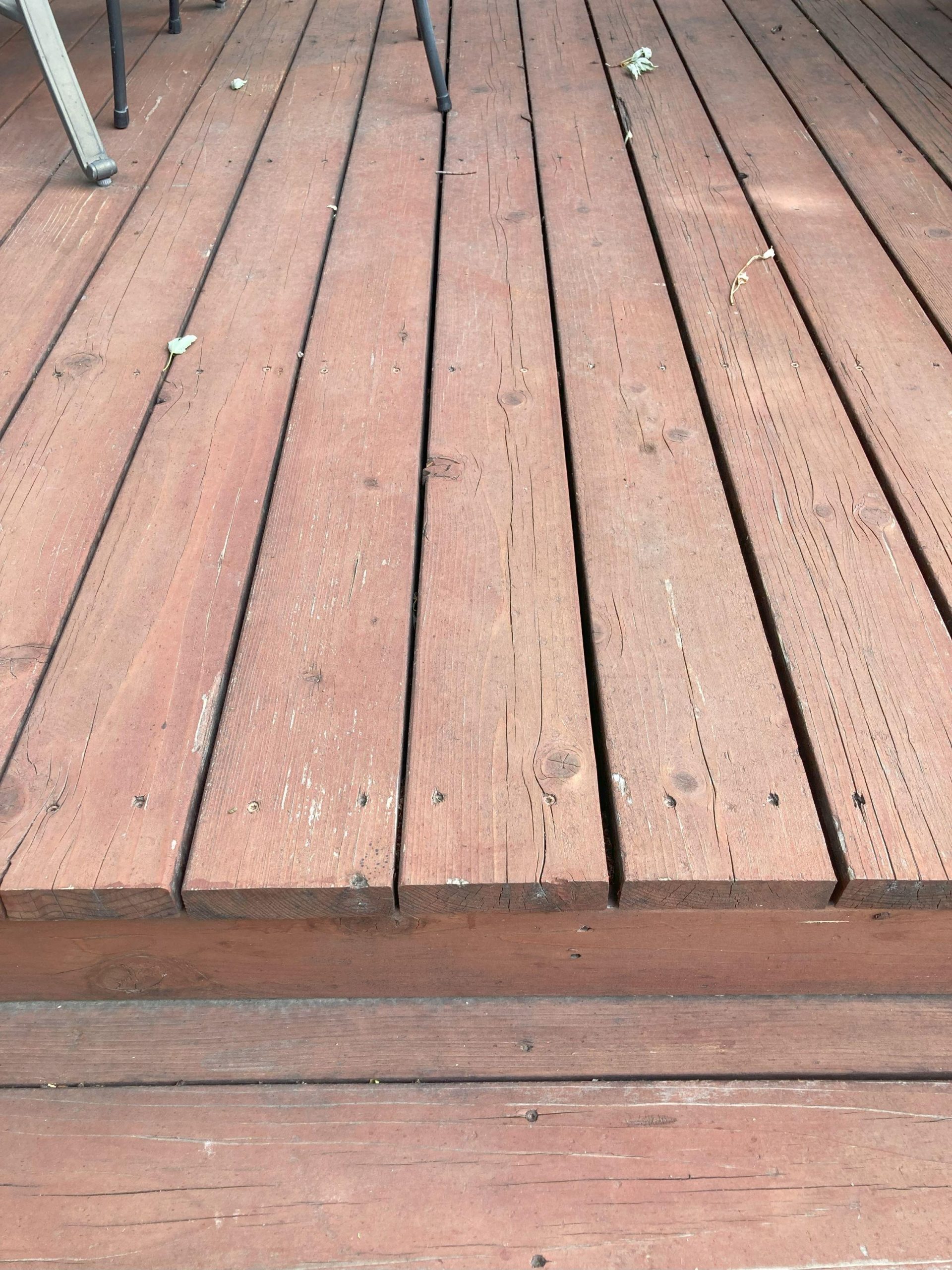

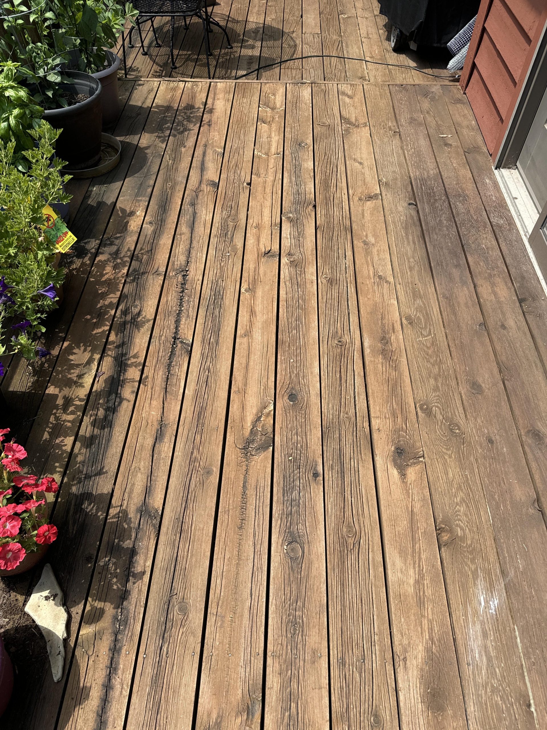

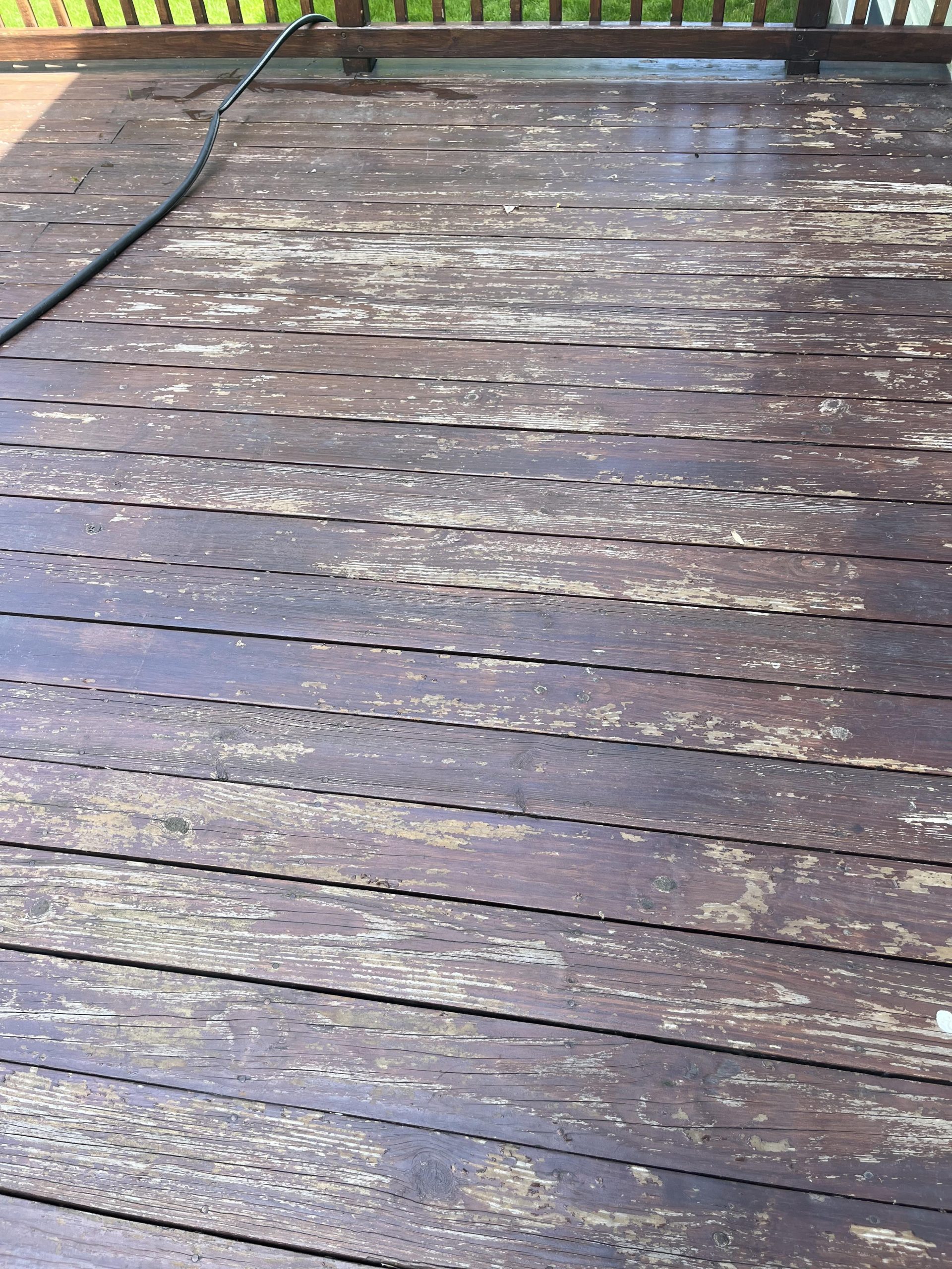

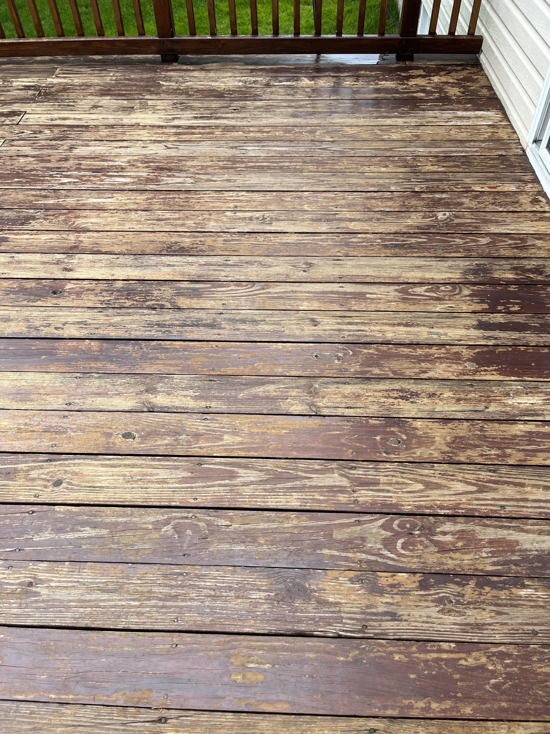

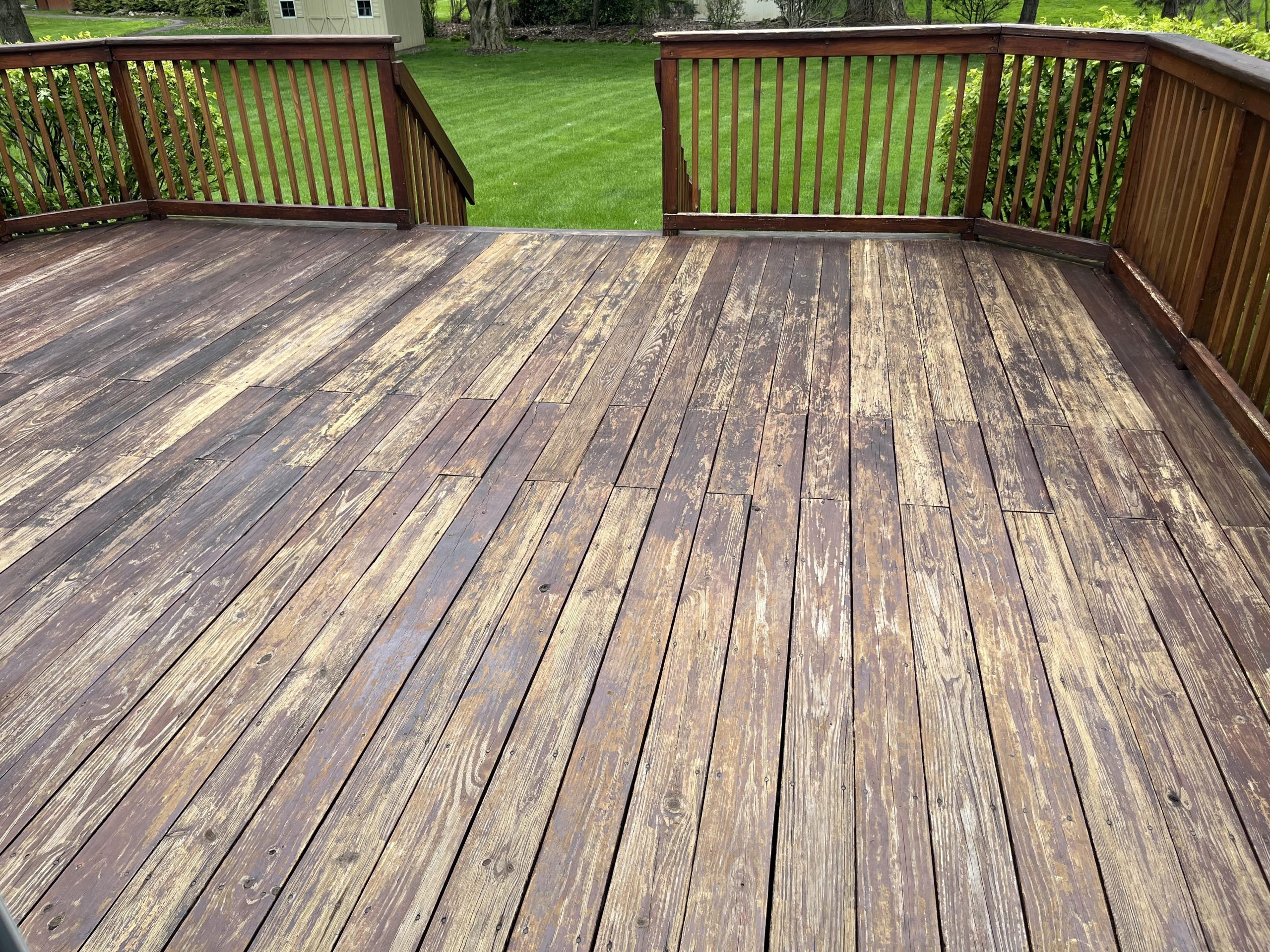

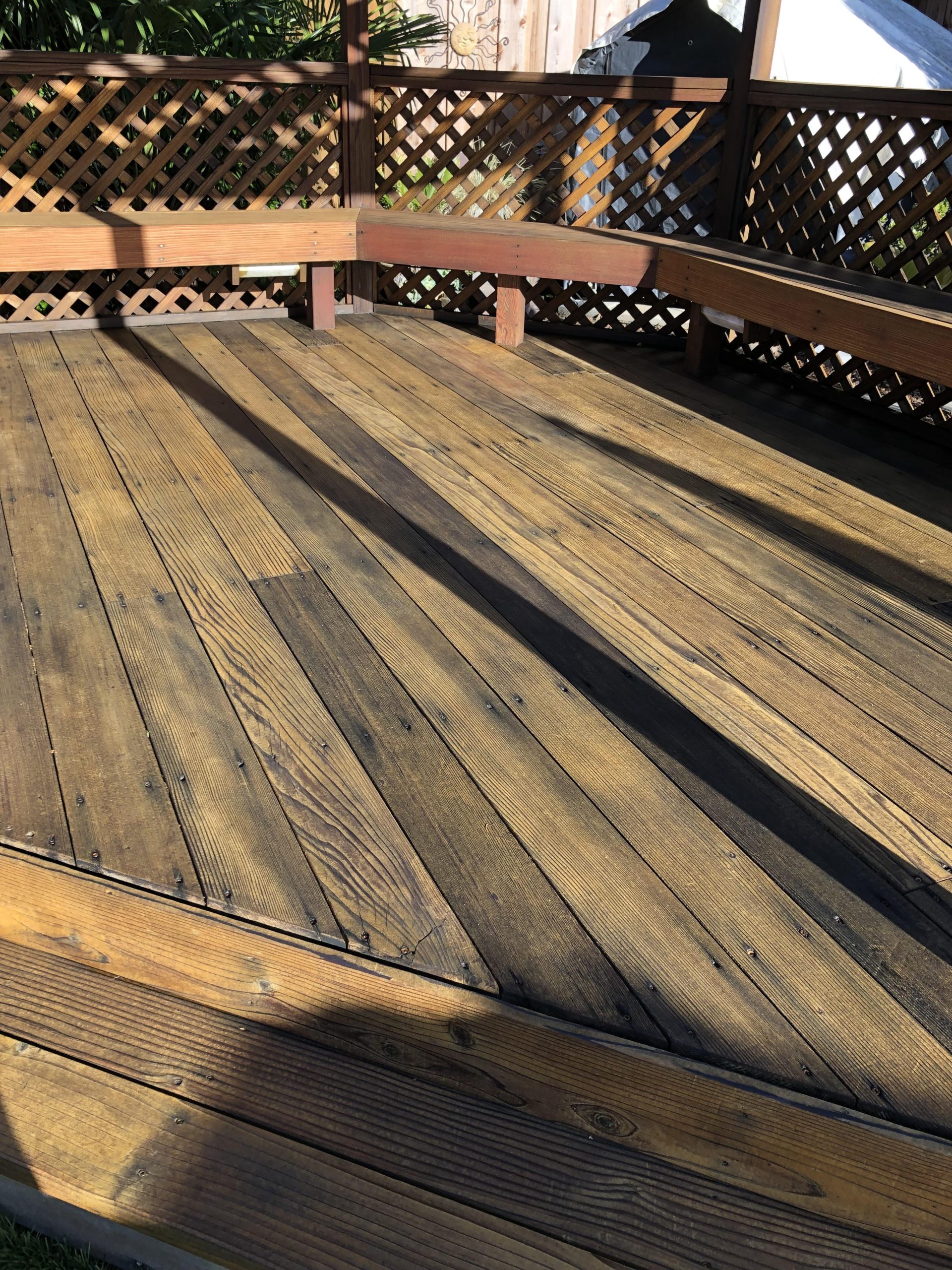

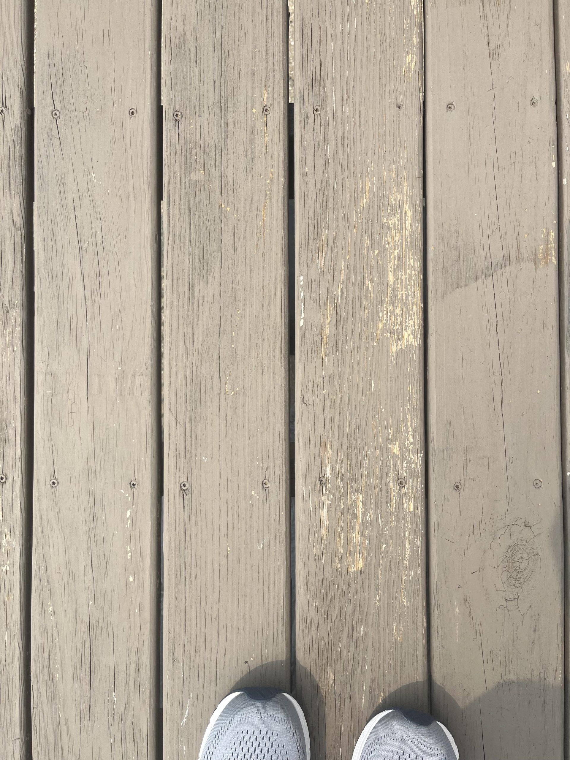

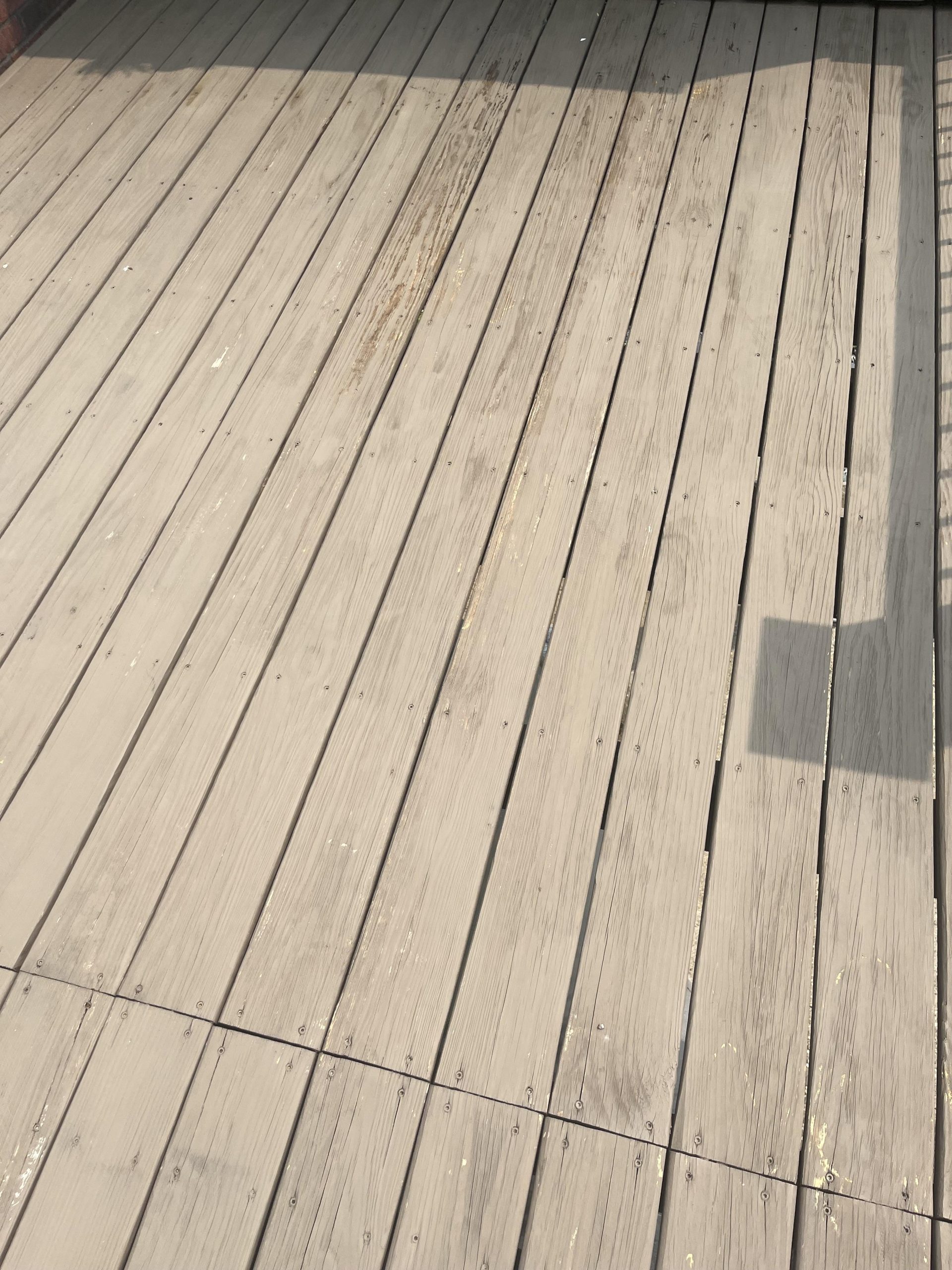

Hi Scott- Your articles are very helpful. I would appreciate advice on how best to prep and restain my deck this year so I don’t have to redo it every 2 years. I live in NYS Finger Lakes region so we have restrictions on product availability.
Made of New Wood or Older Wood? Pressure treated lumber and built 26 years ago.
Does the Deck have a Current Coating?
In 2020 I cleaned the deck with Armor deck cleaner and a power washer to remove dirt and some peeling stain. Then decided to
sand it to the bare wood with commercial floor and hand sanders. I did not use a brightener. In 2020 and again in 2022 (because it was wearing off) I stained with Benjamin Moore Arborcoat oil based Translucent (Natural) stain. In 2024 I restained with Cabot Australian Timber Oil Translucent (Jarrah Brown) oil based. Before staining I washed with water, Tide and a deck brush and let it dry a few days.
Prior to 2020 we used water based stains.
Are you Switching Brands of Deck Stain or Applying a Maintenance Coat of the same Brand and Color? That depends on your recommendation.
What is the Current Deck Stain Type? Oil based – Translucent
Mold or Mildew Issues? – No
Reason for Previous Stain Failure? –Not sure. It was peeling up in certain areas, moreso in the shady half than the half that gets more sun.
The spindles and vertical surfaces last several years. The floor and railing tops start to peel after about a year.
Photos- first one (with hose in upper corner) is before I power washed it. Other 3 photos are after I power washed it using only water to get peeling and loose stain off.
IMG_2972
IMG_2977
IMG_2976
IMG_2979

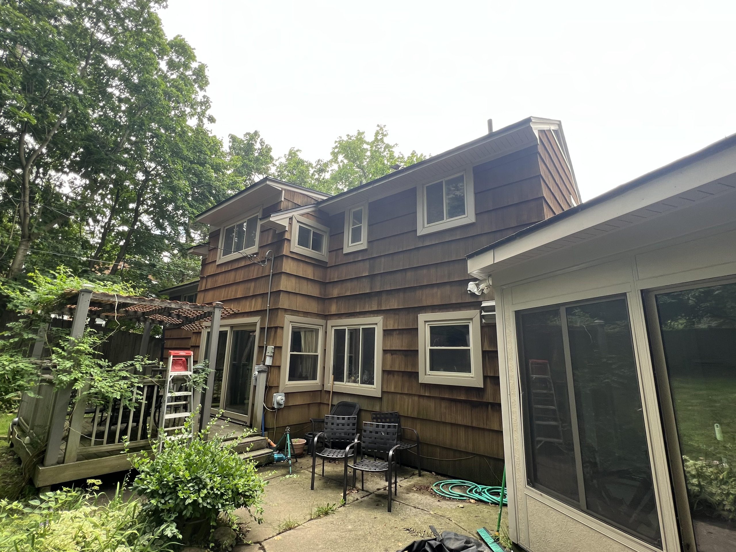

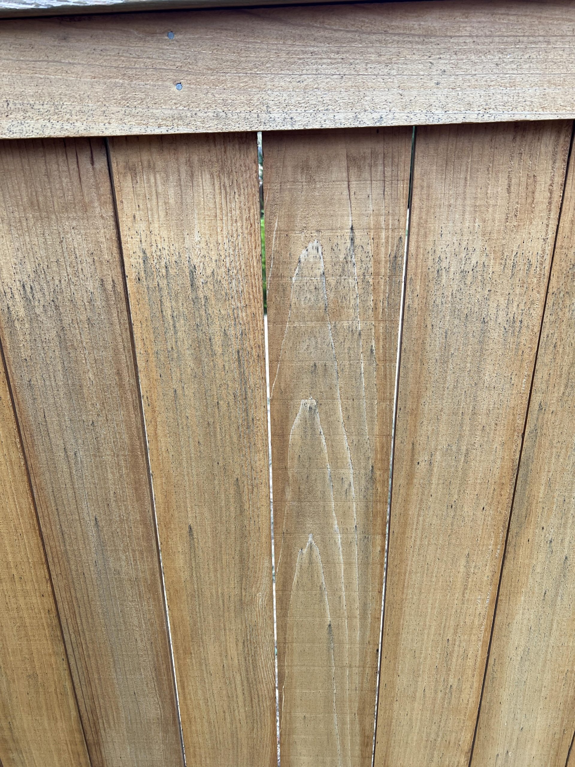

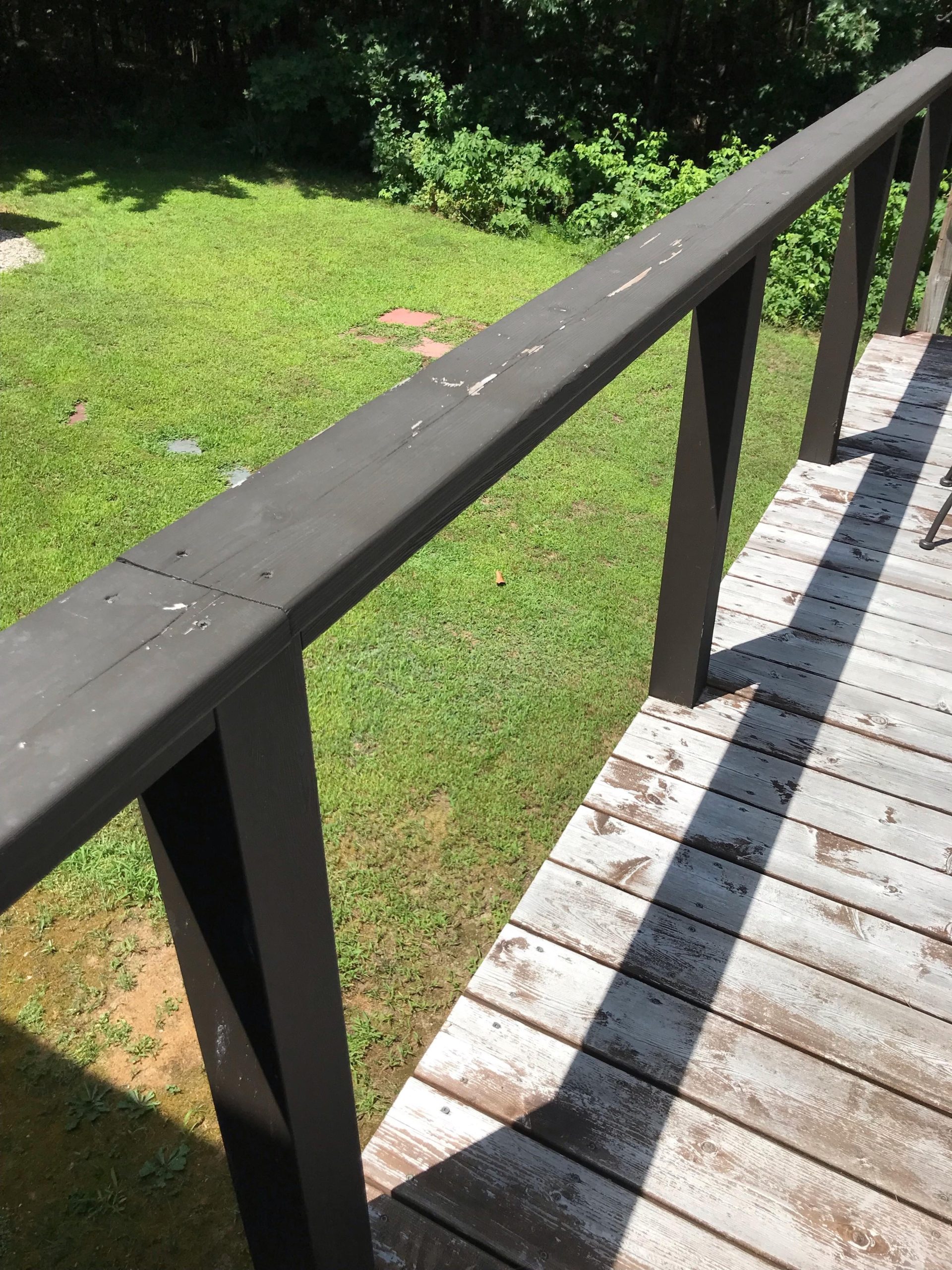

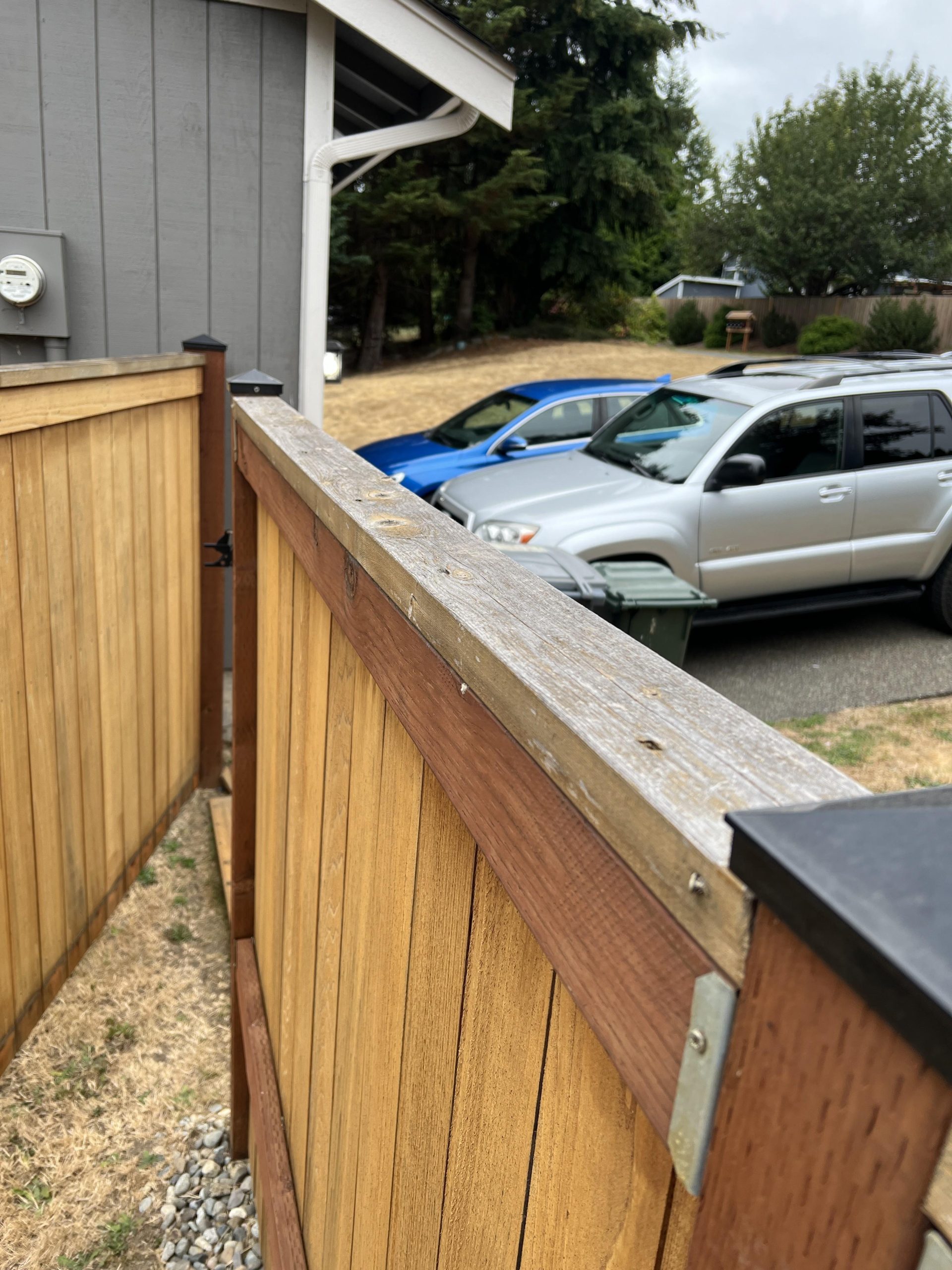

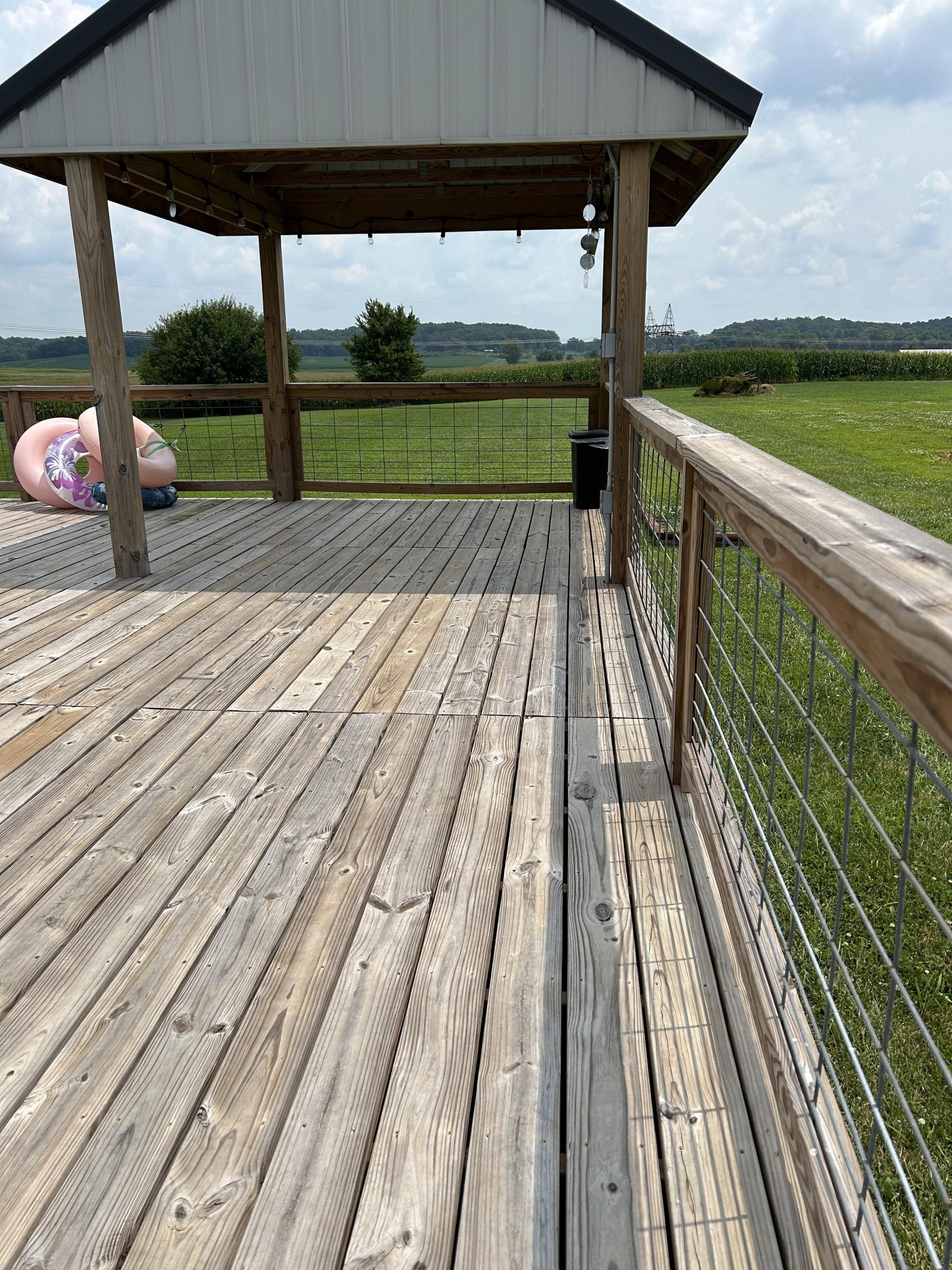

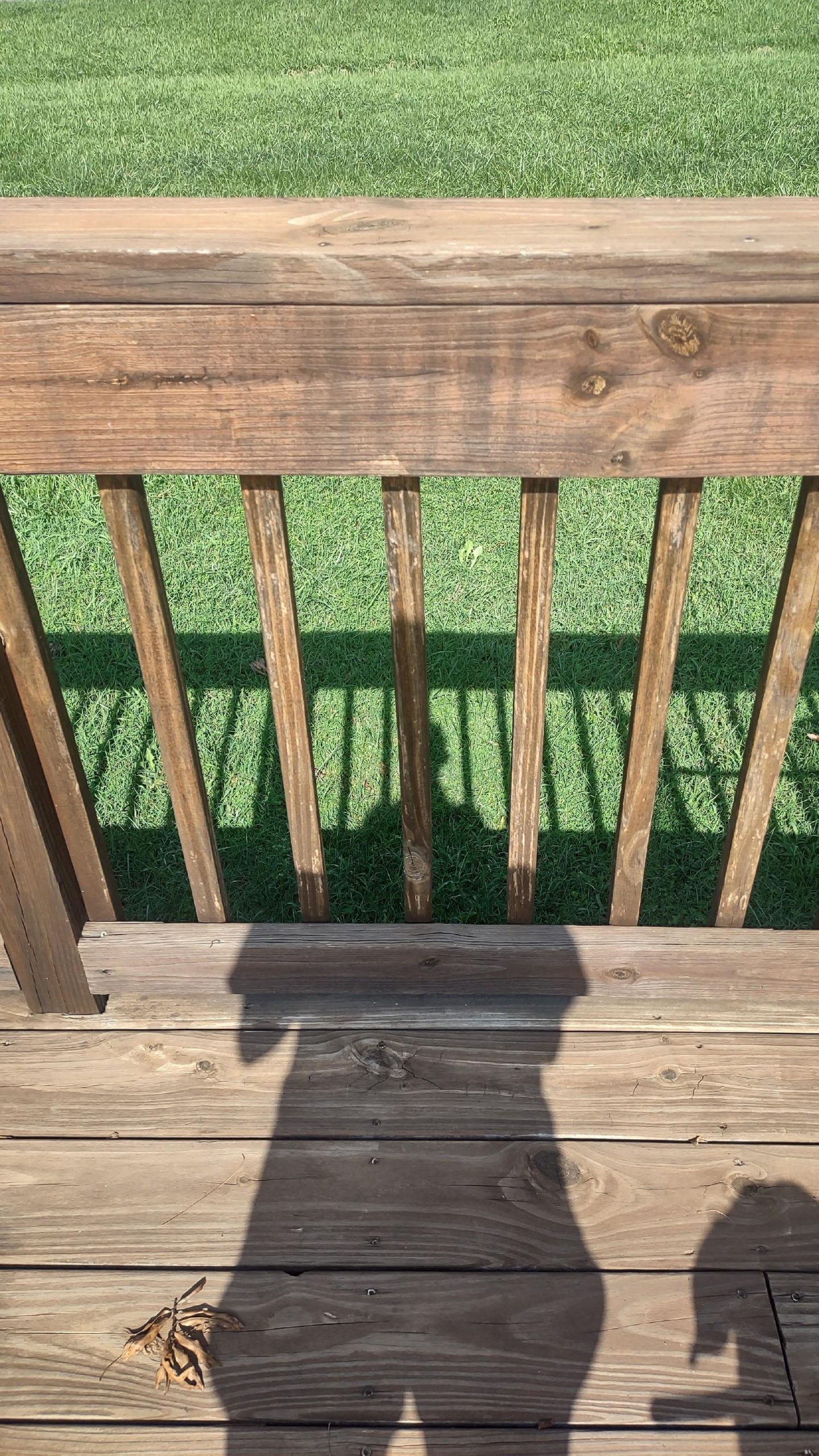

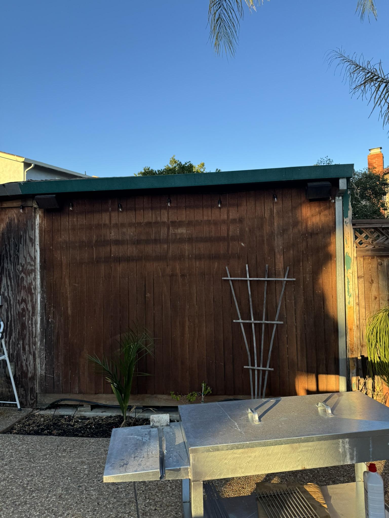

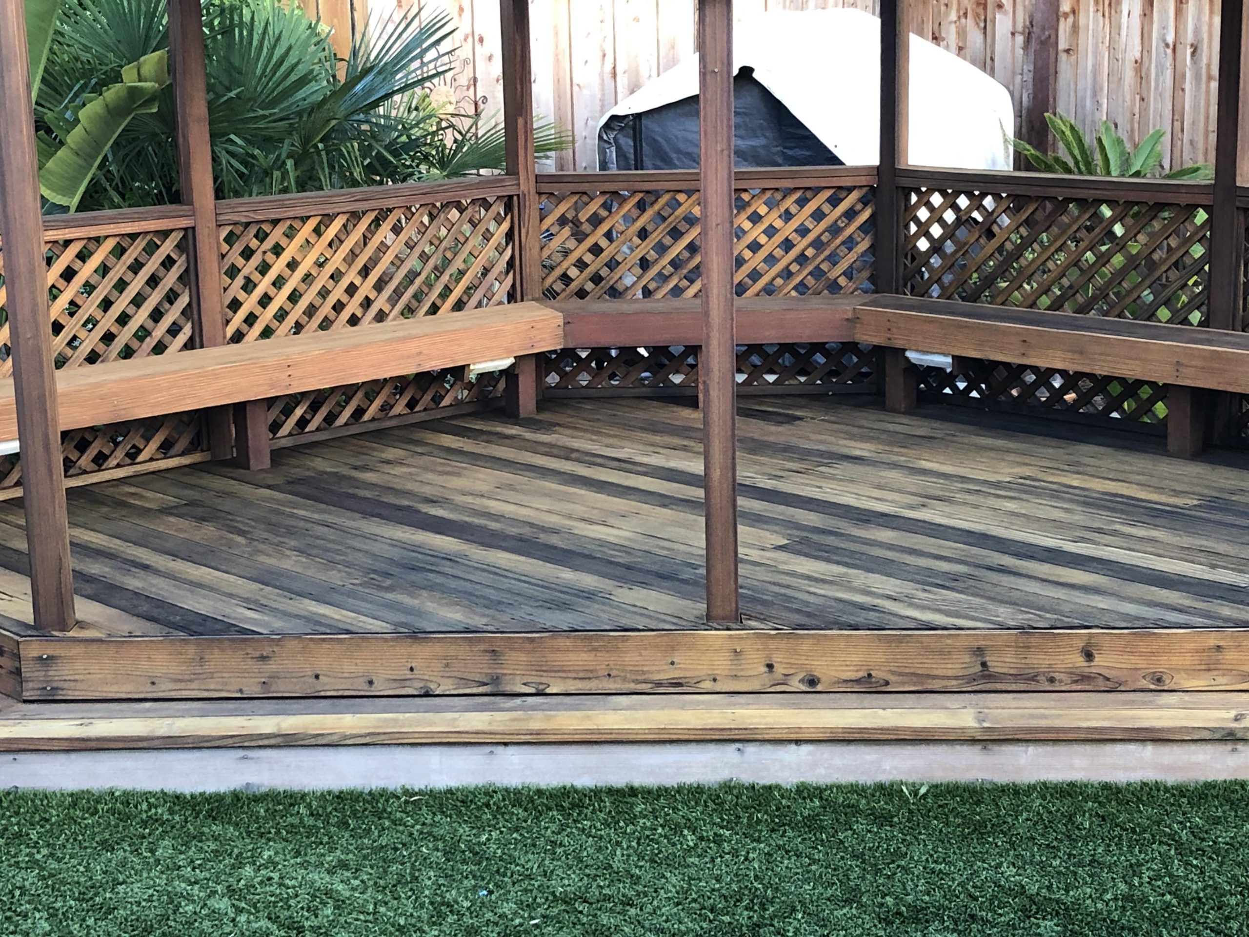

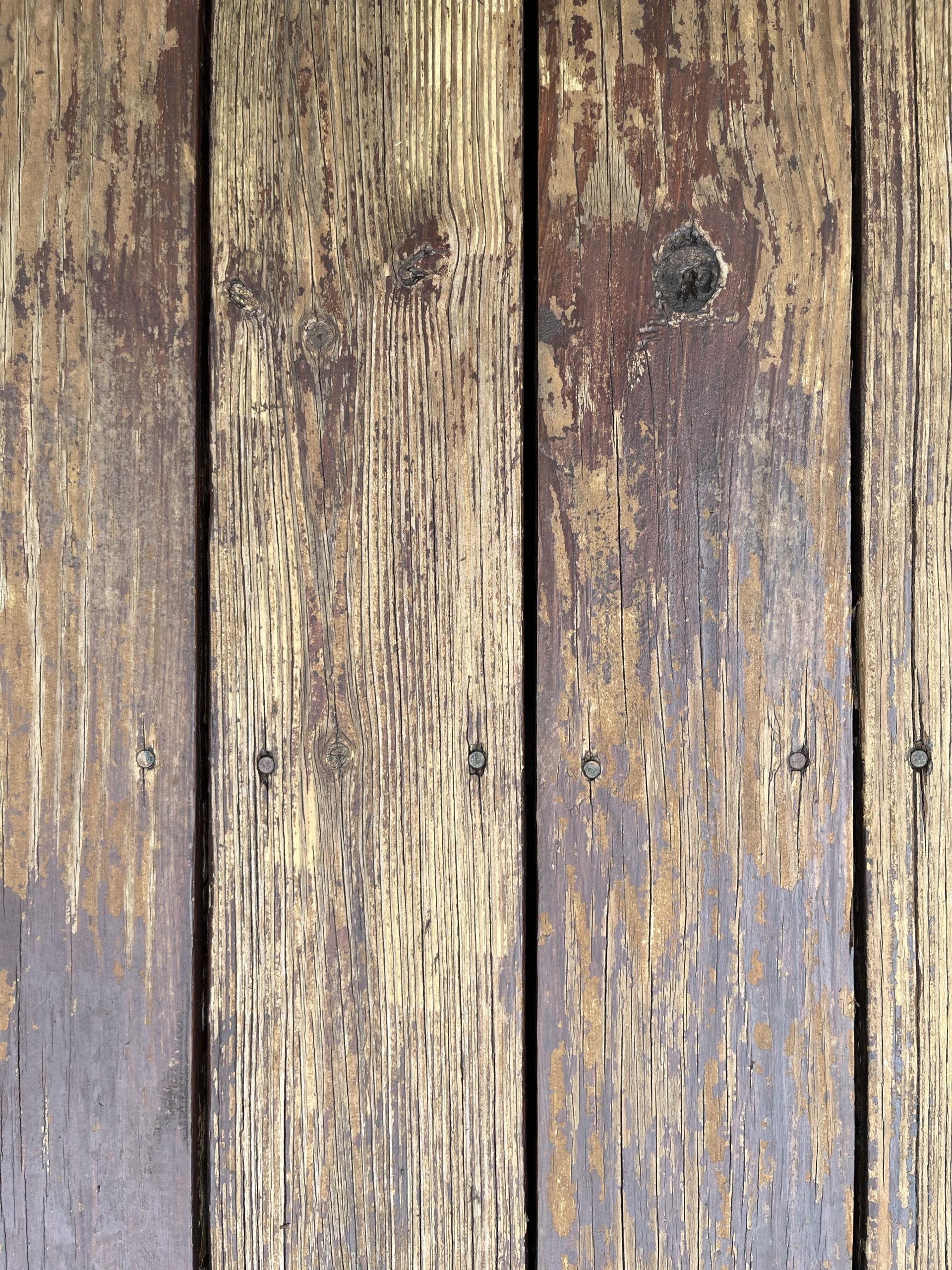

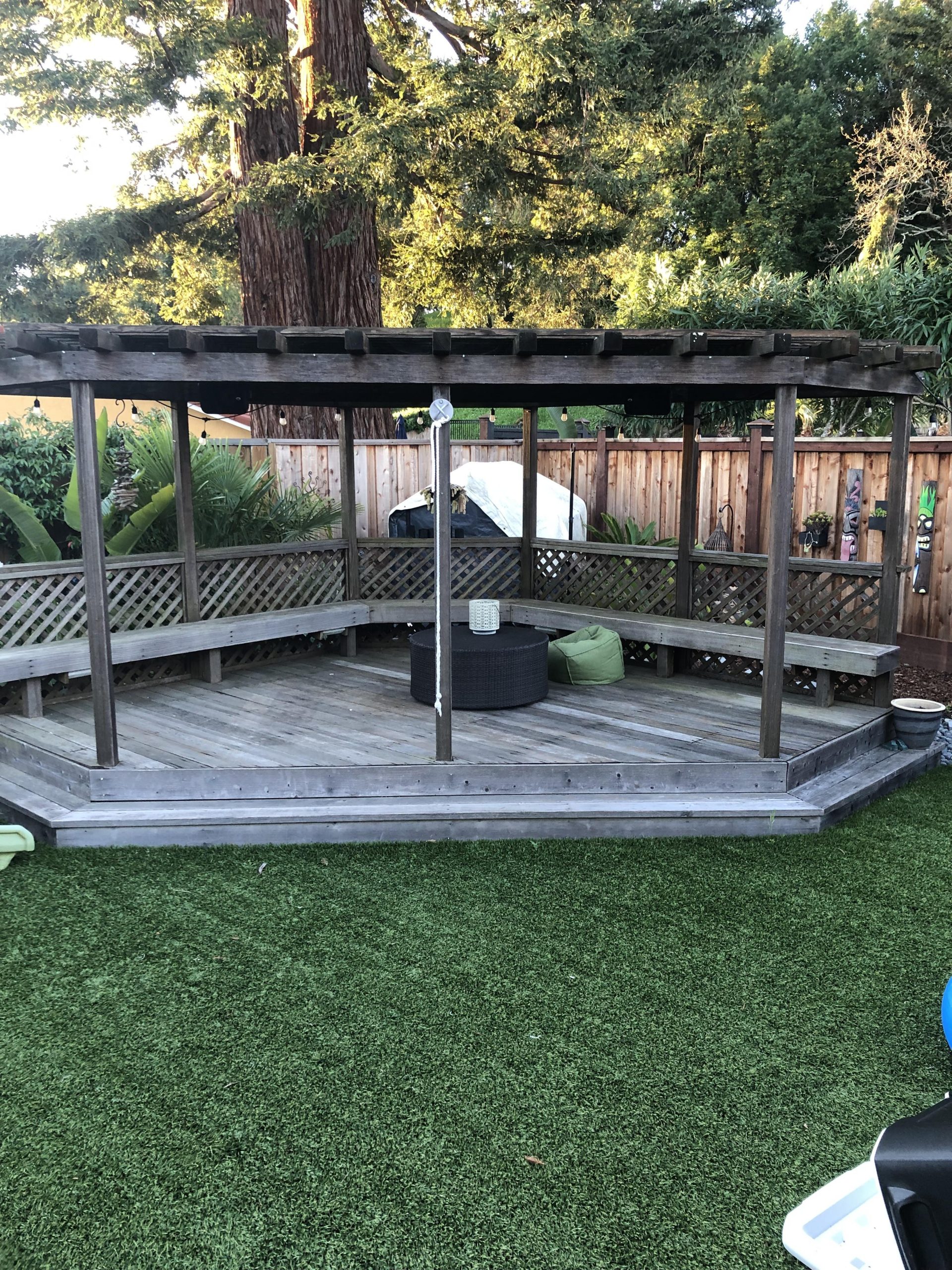

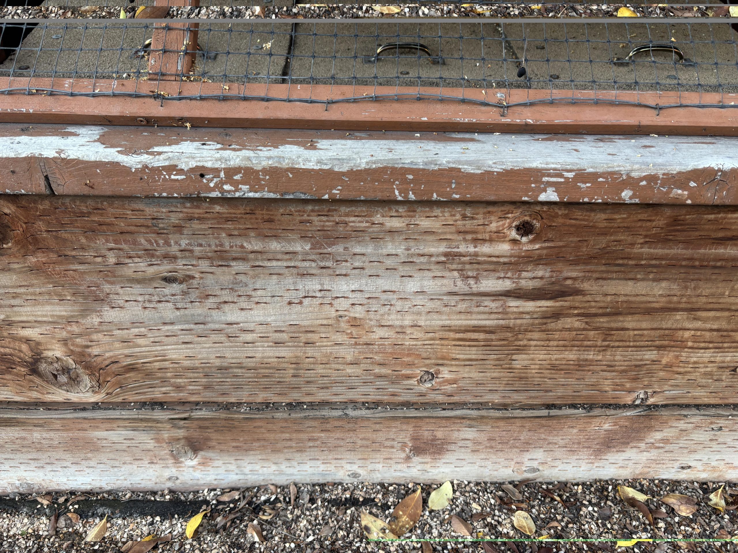

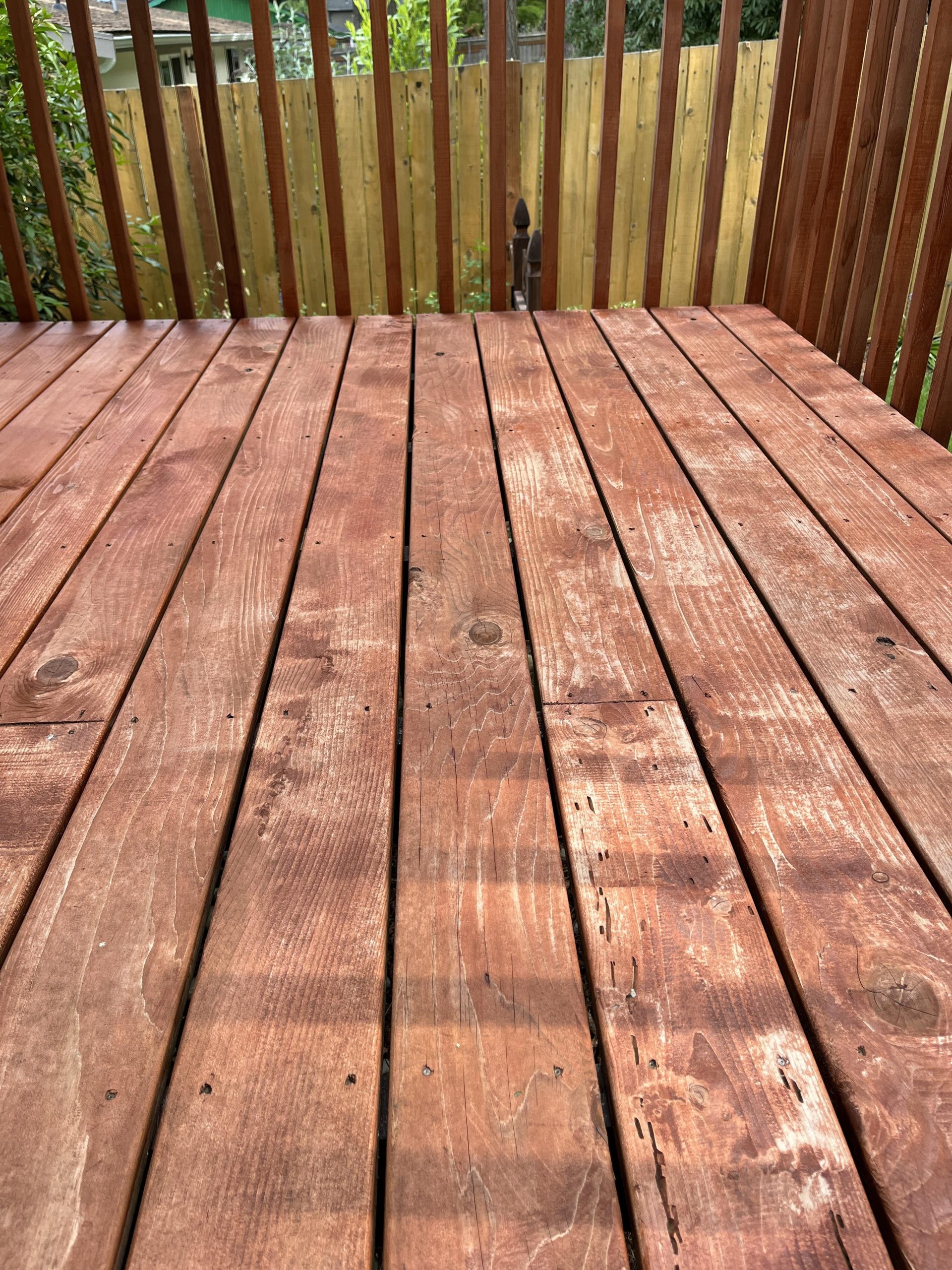

TWP – I hired a contractor to stain a gazebo and steps in my backyard. The gazebo has not been stained for at least 10 years. After the contractor stained the gazebo I noticed it looked very uneven. I pointed this out and they told me it was because some boards are more porous than others. I feel like they didn’t complete the correct prep. I’ve attached photos of before and after stain. The stain is TWP California Redwood. Any feedback you have would be great! I would like the gazebo stained correctly.
IMG_6819
IMG_7136
IMG_7133
Heather
Heather
6 months ago
Thank you. So even though I’ve read that if old boards are prepped properly they can stain, it’s not the case for all?
Heather
Heather
6 months ago
TWP Stain California Redwood

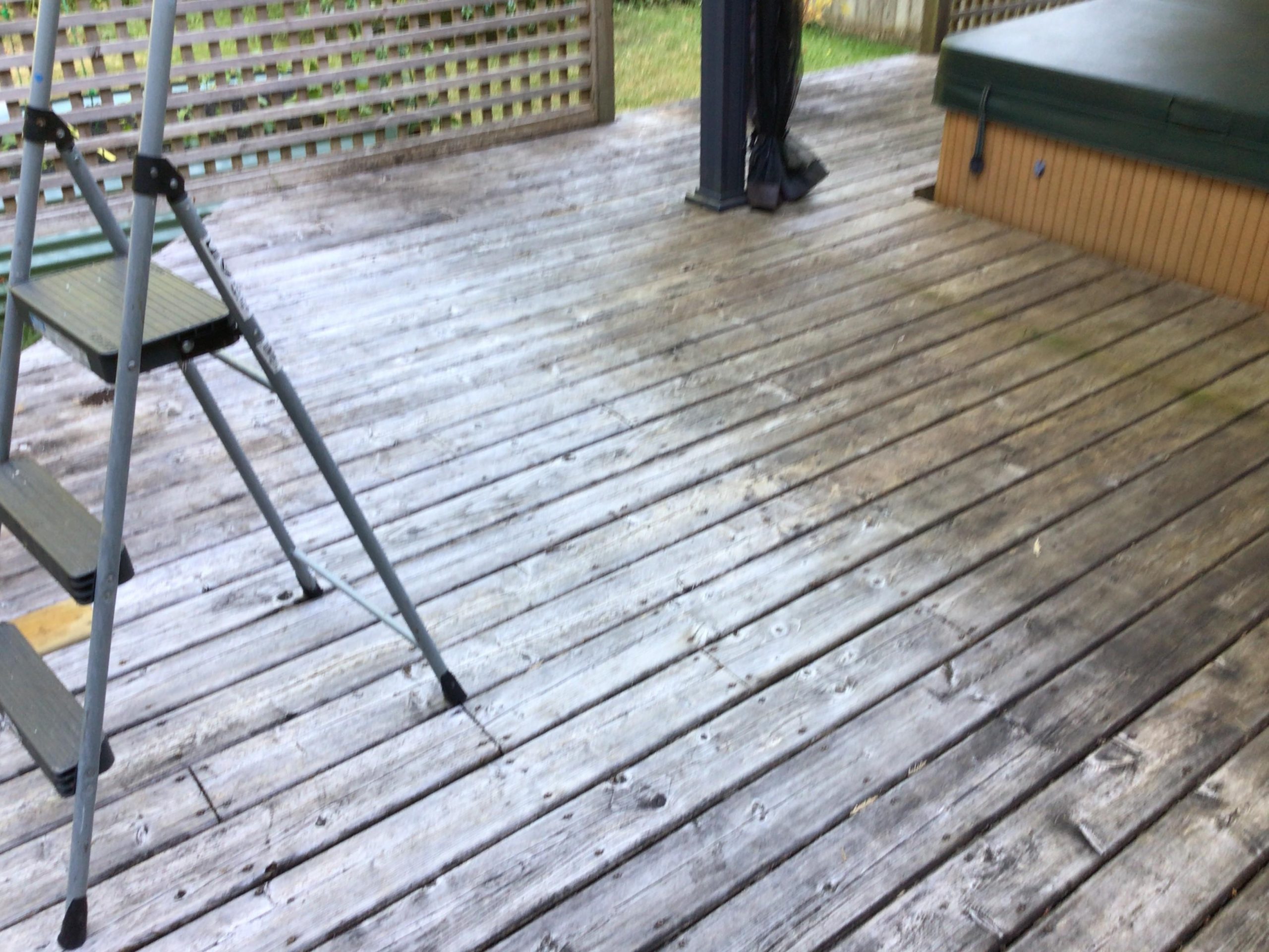

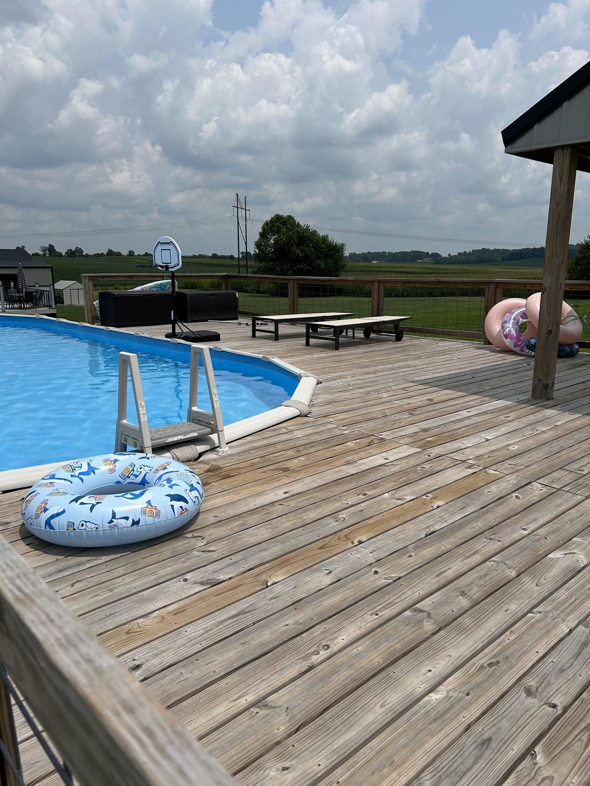

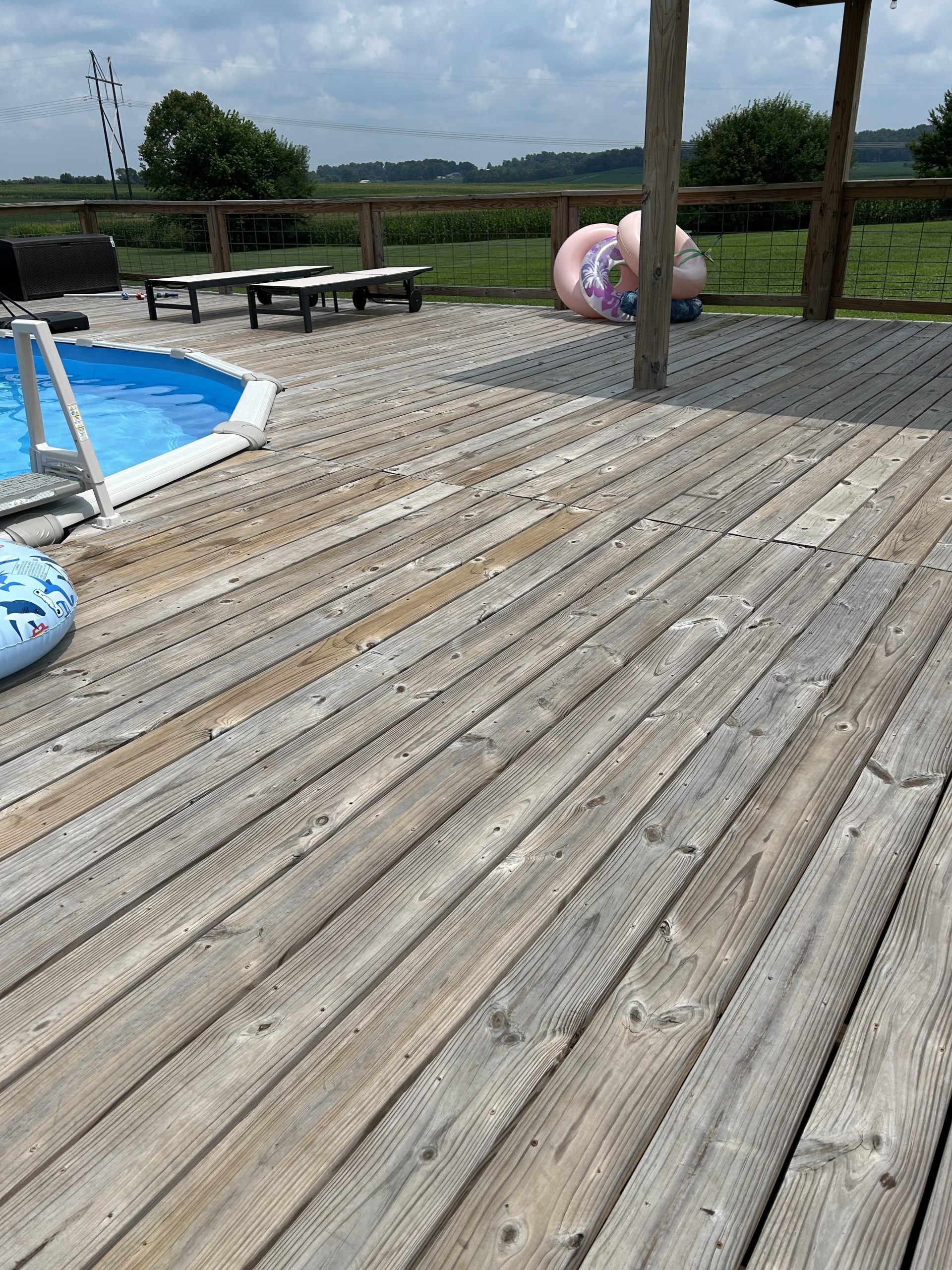

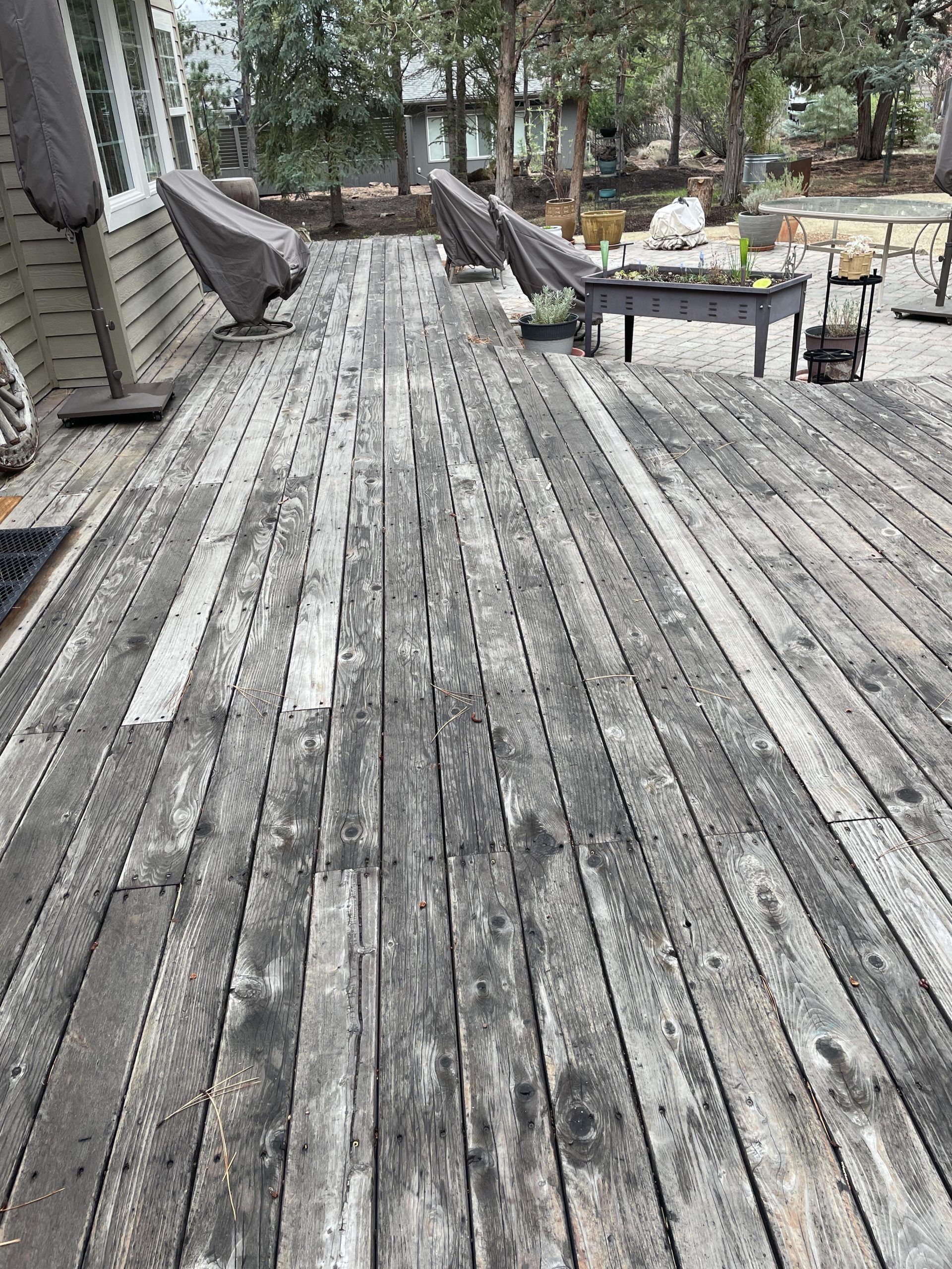

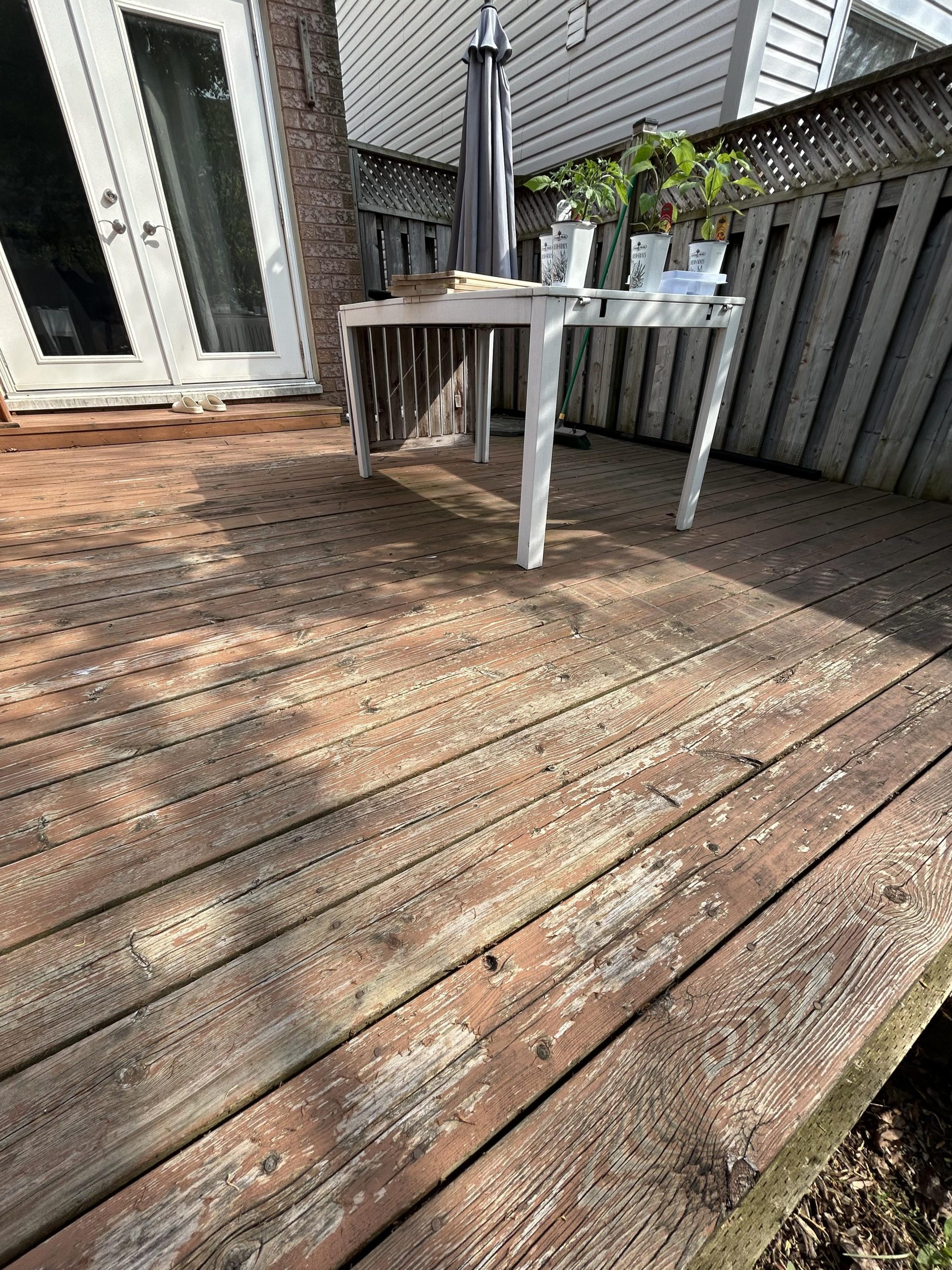

We have a 9+ year old 600 sq. ft. exposed cedar deck in Bend, Oregon that we treated 3 years ago with a mix of 50% Boiled Linseed oil and 50% Mineral spirits after sanding the deck. At that time we did not go back and dry mop so there were some spots that were tacky at the end of the process and stayed that way for that summer. This May we are going to re-stain the deck with TWP 100 stain series. The wood, 95 % weathered and gray, is in good condition with just a few boards needing replacement. The other 5% under the eaves still shows some of the look from the original linseed/mineral spirits treatment. We are planning to sand the deck (we sanded a small piece and it looks good). We would like your thoughts on the prep process considering the treatment 3 years ago and about the TWP 100 series product for our deck in general.
Leslie
Leslie
7 months ago
We just had a down pour last night so the deck is wet. Thanks

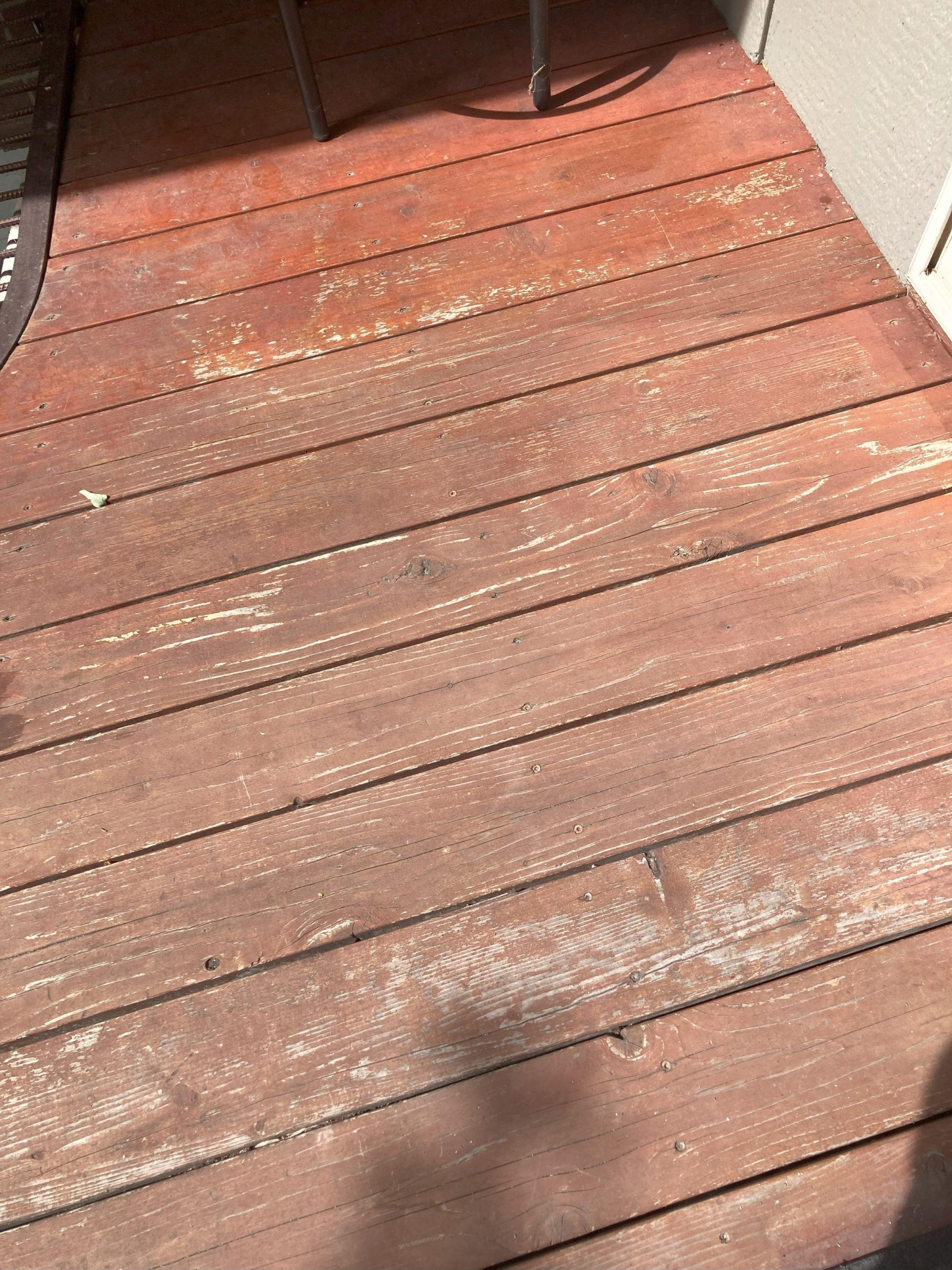

Richard Boyer
Richard Boyer
8 months ago

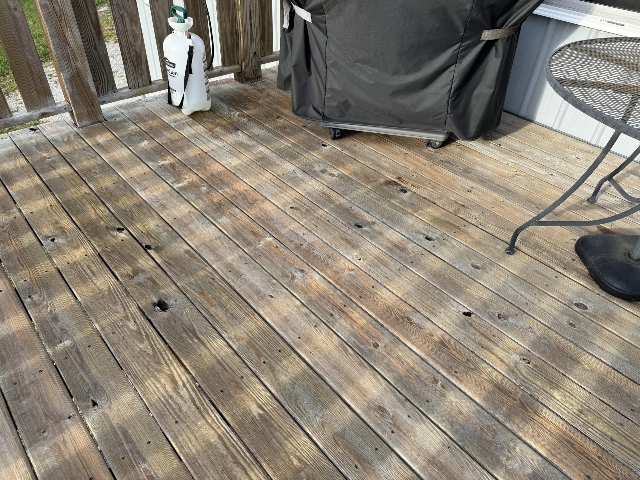

I need to know if I should clean or strip.
1. Cedar decking is 3-4 years old.
2. Stained with Cabot Australian Timber Oil – natural color
3. Applying a maintenance coat with same brand and color
4. Deck was stained about 2 years ago
5. About 60% of the original stain is still there. The other 40% is bare wood.
6. No mold or mildew issues.
7. Previous coat is simply wearing off in high traffic areas.

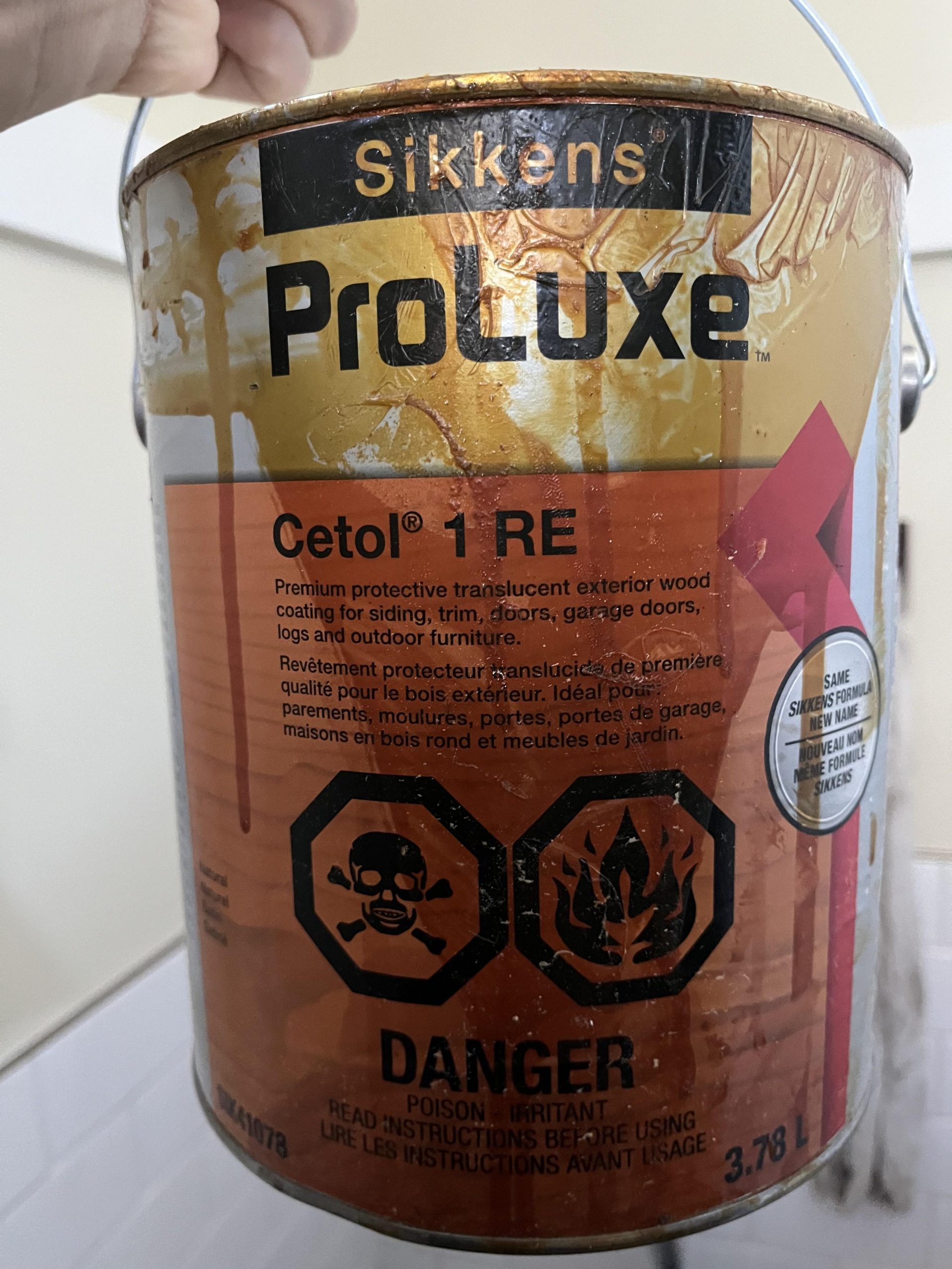

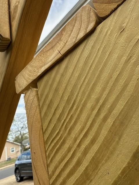

I have 8 year old cedar decks. 5 years ago, they were stained (poorly, not by me) with Sikkens. Looked terrible, I hate that stuff! We just finished sanding it all away—a big job, considering the main deck is covered. Unfortunately, it’s going to rain for the next 4 days. The forecast says we will get a week of dry weather after the rain.
We covered the railings with loose plastic. Will we need to re-sand everything? What will 4 days of rain do? Or can just move forward with allowing the deck to dry before we clean and brighten with RAD and then stain?
Additionally, I bought 2 stains just to make sure I had them—would you recommend RAD semi-transparent cedar or Armstrong-Clark semi-transparent cedar? I’m in the PNW.

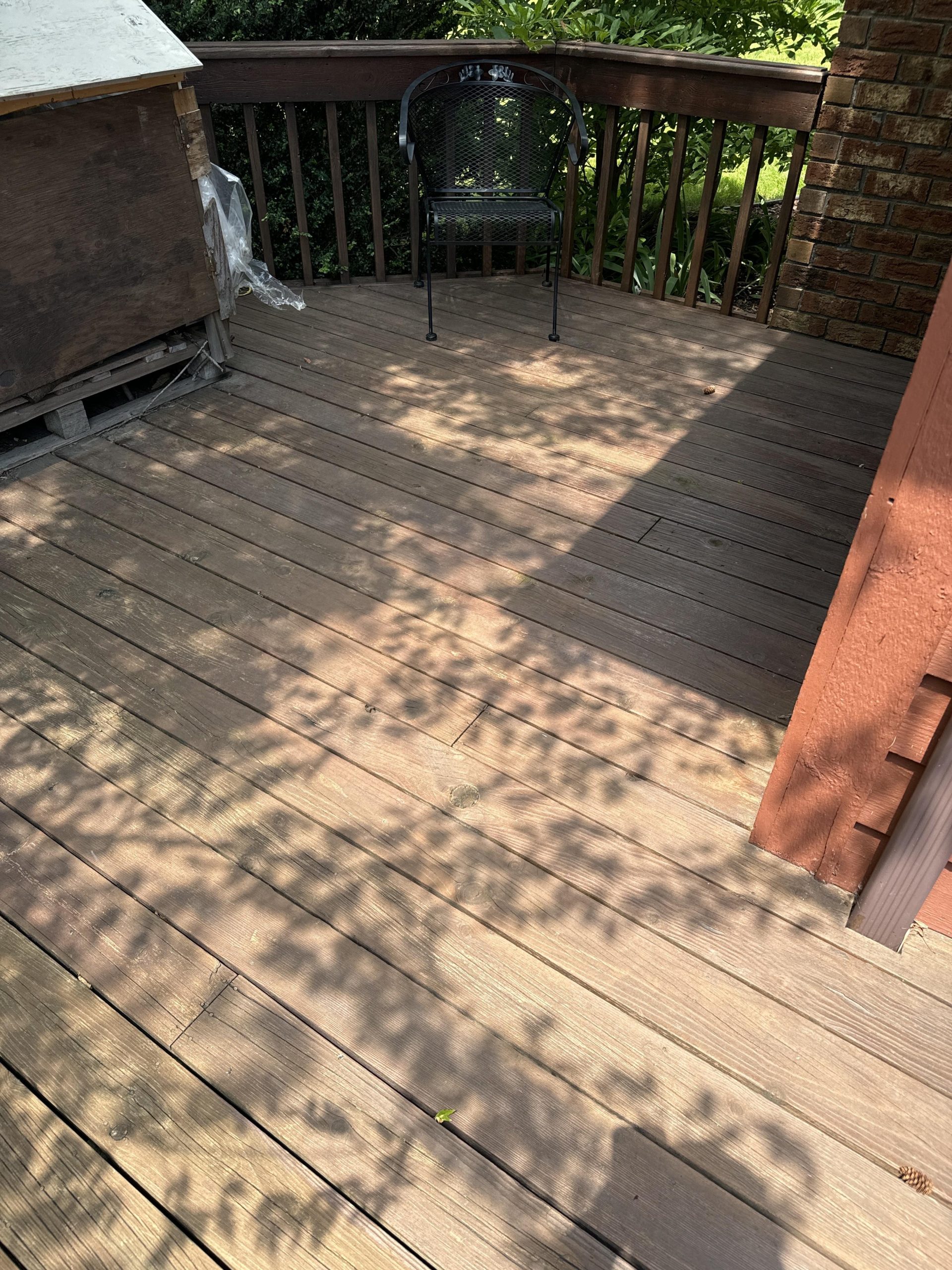

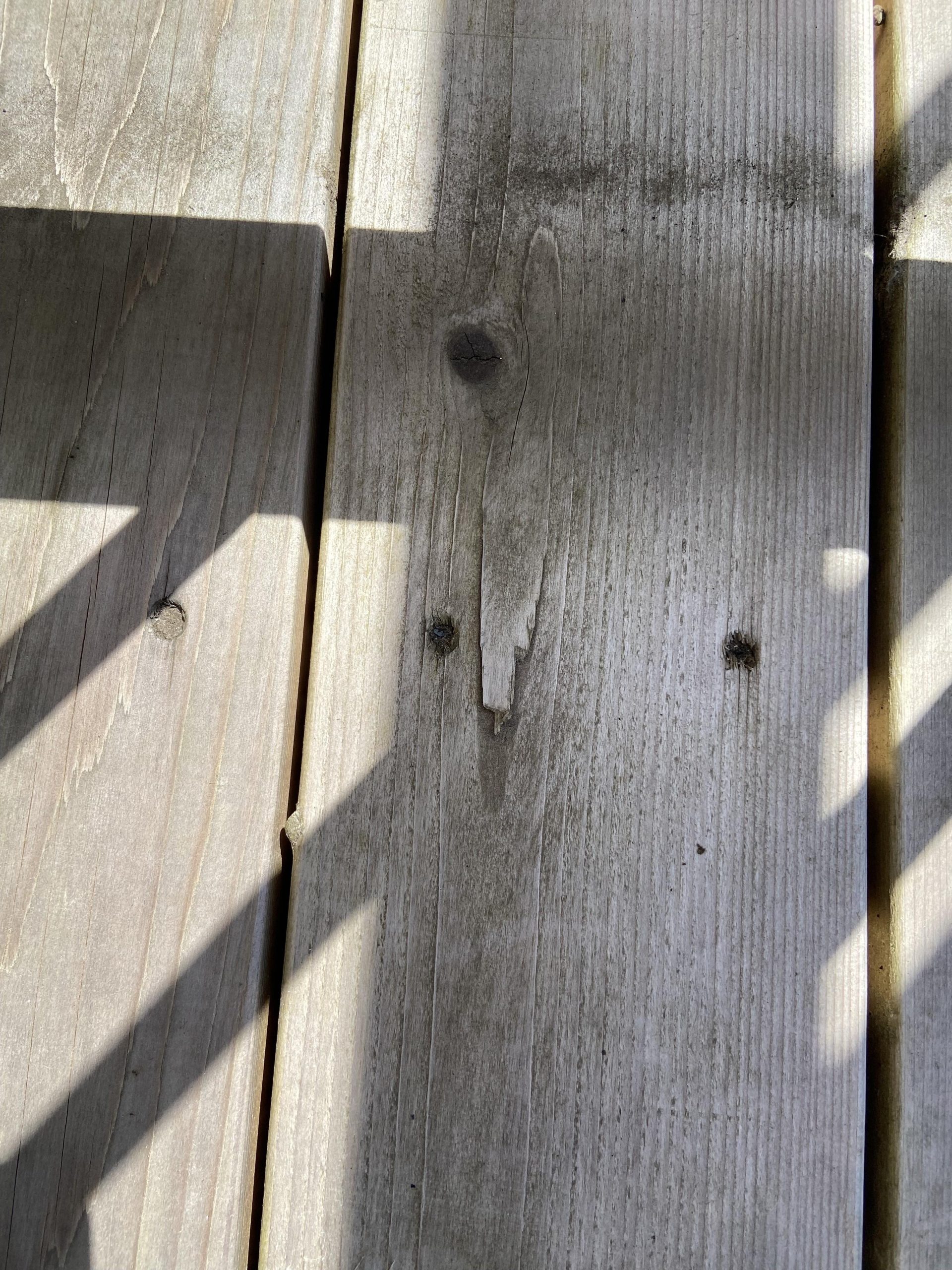

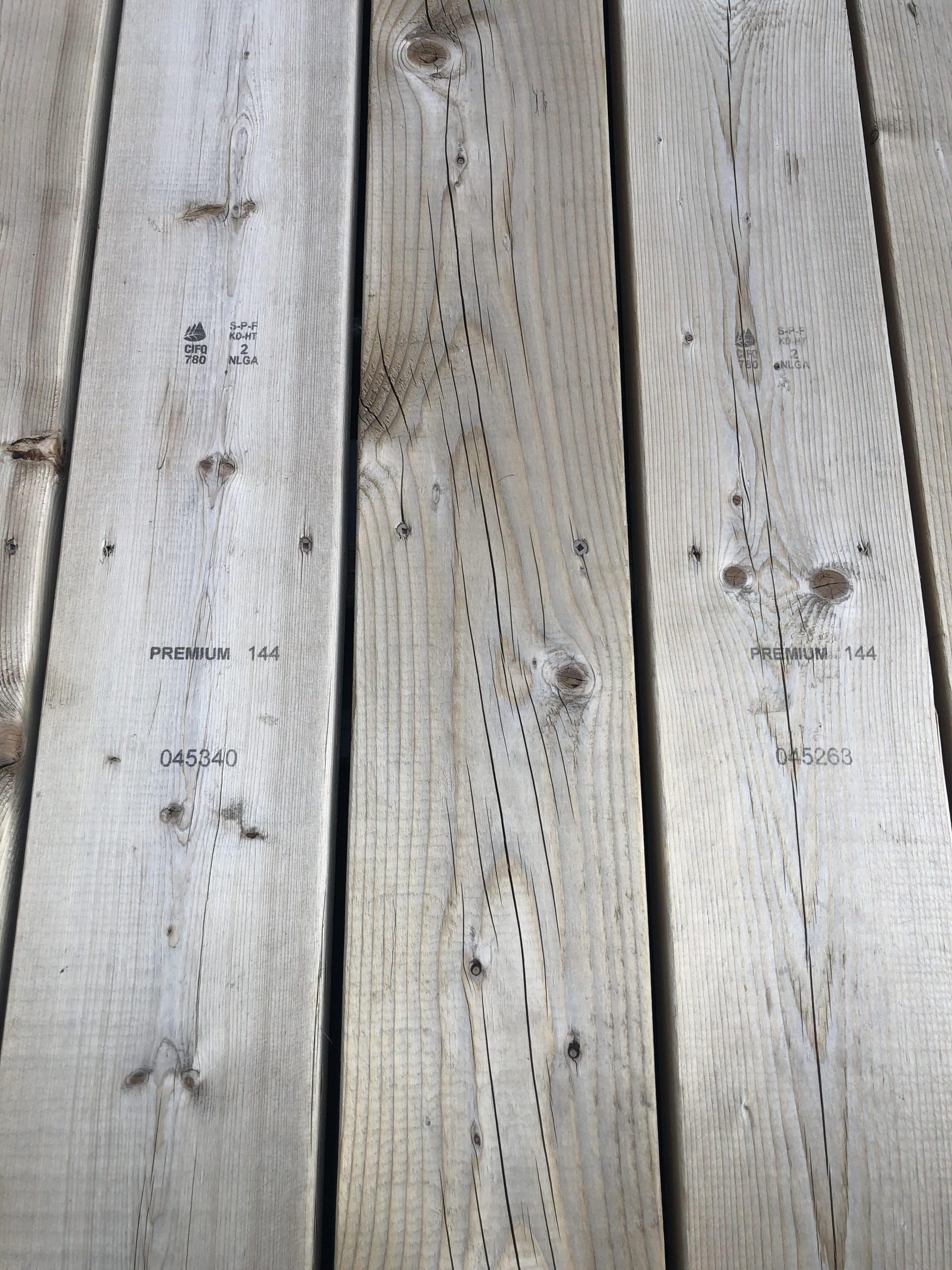

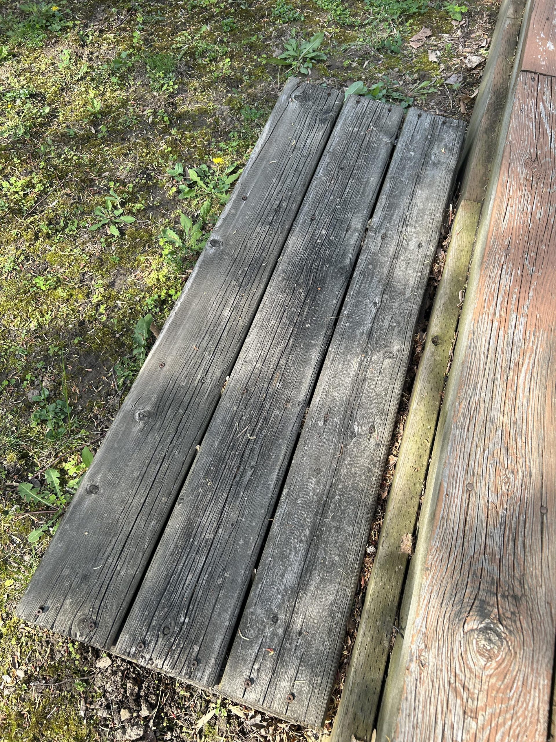

Should 10y/o PT decking (above ground rated) be cleaned + stripped + brightened or just cleaned + brightened? It was never stained or painted, it just has the original orange-colored ACQ PT coating that’s used in the West and PNW regions on it.
Craig
Craig
Hopefully these pics work. None of the boards have been stained, they’re all above ground rated PT lumber but clearly not all the same age. My goal here is to try and get a more uniform appearance from the deck down to the dock and I’m not quite sure how to tackle the orange pressure treated wood.

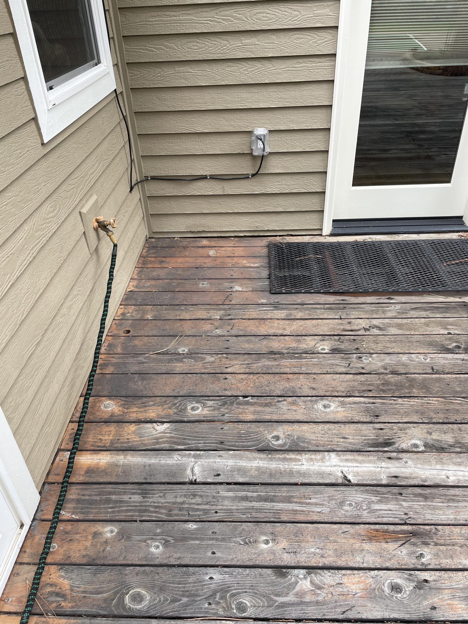

Will
Will

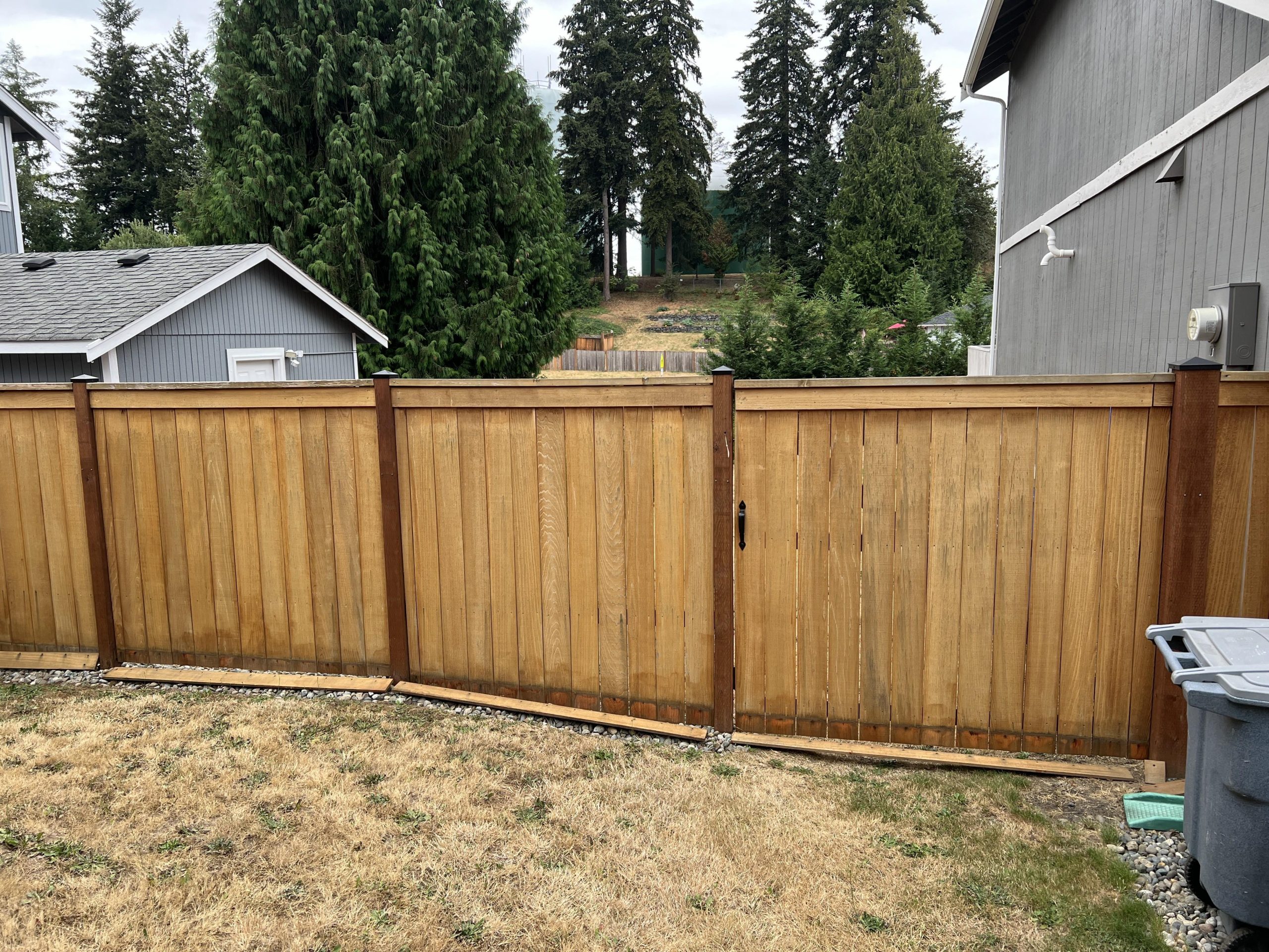

  1. New Wood or Older Wood? Nearly 5-year old deck and porch from a house built in 2020.
  2. Does the Deck have a Current Coating? Builder seemed to have applied a very light semi-transparent stain (possibly oil) that weathered very quickly (we should have taken care of this years ago).
  3. Are you Switching Brands of Deck Stain or Applying a Maintenance Coat of the same Brand and Color? Not sure what was previously used but intending to use Cabot Austrialian Timber Oil (honey teak) this time.
  4. Deck Stain Brand Previously Used? Enter “unknown” if you do not know. – unknown
  5. What is the Current Deck Stain Type? Oil-based or Water-Based? Clear, Transparent, Semi-Transparent, Semi-Solid, or Solid Stain? – not sure
  6. Mold or Mildew Issues? – probably, we’re in the PNW
  7. Reason for Previous Stain Failure? – not sure how to answer
  8. You Must Include Picture(s) of the Current Condition.

Hi from Alberta, Canada. I appreciate your helpful posts and would be grateful for advice on how to prep this arbour and small porch and what product you’d recommend for restaining. Thank you!
  1. New Wood or Older Wood? Older (15 years) — last stained 8 years ago
  2. Does the Deck have a Current Coating? Yes
  3. Are you Switching Brands of Deck Stain or Applying a Maintenance Coat of the same Brand and Color? Haven’t looked into products yet. Ideally same colour.
  4. Deck Stain Brand Previously Used? Sikkens ProLuxe Cetol 1 RE
  5. What is the Current Deck Stain Type? Oil-based or Water-Based? Clear, Transparent, Semi-Transparent, Semi-Solid, or Solid Stain? Semi-Transparent; unsure if oil-based.
  6. Mold or Mildew Issues? No
  7. Reason for Previous Stain Failure? The areas most exposed to sun have weathered.

* New Wood or Older Wood? Older wood
* Does the Deck have a Current Coating? Yes, but not properly applied over 3 years ago
* Are you Switching Brands of Deck Stain or Applying a Maintenance Coat of the same Brand and Color? switching brands from BEHR PREMIUM®SEMI-TRANSPARENT WATERPROOFING STAIN & SEALER redwood to TWP 1500 Series Pecan
* Deck Stain Brand Previously Used? Enter “unknown” if you do not know. – BEHR PREMIUM®SEMI-TRANSPARENT WATERPROOFING STAIN & SEALER redwood
* What is the Current Deck Stain Type? Oil-based or Water-Based? Clear, Transparent, Semi-Transparent, Semi-Solid, or Solid Stain? Oil based BEHR PREMIUM®SEMI-TRANSPARENT WATERPROOFING STAIN & SEALER
* Mold or Mildew Issues? – very little, mostly dirt
* Reason for Previous Stain Failure? Not applied correctly, only pressure washed – no cleaner or anything, and only one coat with not full coverage

  1. New or old Wood? 10 year old cedar deck.
  2. Does the Deck have a Current Coating? Last coating was SW Super Deck semi- transparent water borne applied 4 years ago; original finish was a clear wood preservative.
  3. Are you Switching Brands of Deck Stain or Applying a Maintenance Coat of the same Brand and Color? Would be more than willing to change and am seriously considering a solid stain.
  4. Deck Stain Brand Previously Used? Sherwin Williams waterborne semi-transparent; wood was sanded prior to application.
  5. What is the Current Deck Stain Type? Oil-based or Water-Based? Clear, Transparent, Semi-Transparent, Semi-Solid, or Solid Stain? Semi transparent applied 4 years ago.
  7. Reason for Previous Stain Failure? Not sure if I got good penetration with SW. it held up about a year. The covered porch floor looks fair, except for some sun damage. The ramp and landing get lots of hot Texas sun as well as traffic from dogs and people. There is significant peeling and some of the boards will need replacing

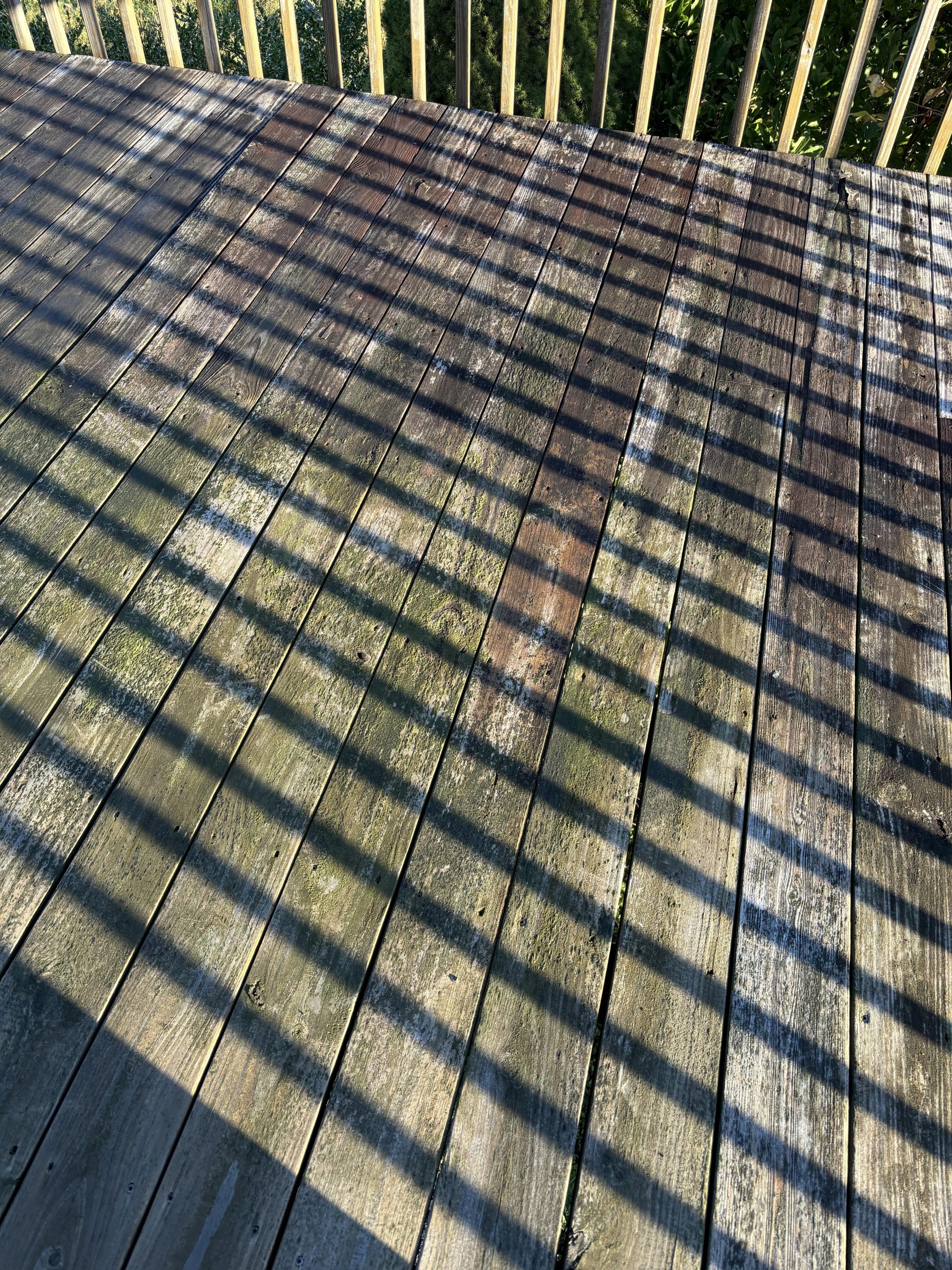

  1. New Wood or Older Wood? Old (> 15 years – but in good shape)
  3. Are you Switching Brands of Deck Stain or Applying a Maintenance Coat of the same Brand and Color? I might switch brands, but my plan is to use a same/similar color solid stain as I used last time
  4. Deck Stain Brand Previously Used? Valspar
  5. What is the Current Deck Stain Type? Oil-based or Water-Based? Water, solid stain
  7. Reason for Previous Stain Failure? This is unclear. I’ve restained the deck about every 2-3 years because bare wood starts to appear in spots. I suspect since I live in the NE US, the cycle of snow cover and cold in winter plus spring rain and hot, humid summer have a negative effect. Also, my prep each time has been to (a) power wash, then (b) use a deck cleaner. No sanding. Maybe my prep hasn’t been sufficient?
1
2
3

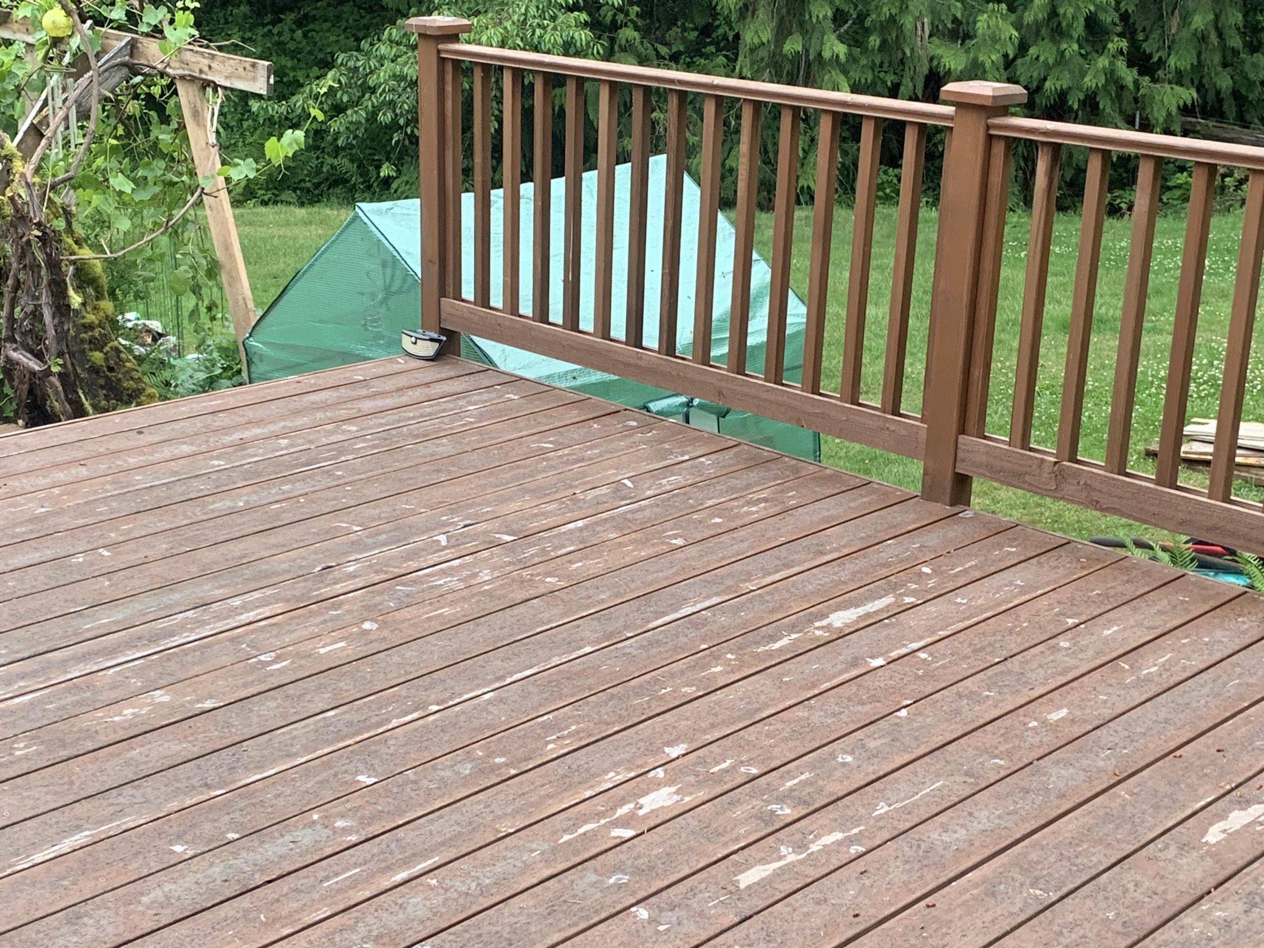

  1. New Wood or Older Wood? This deck is about 10 years old.
  2. Does the Deck have a Current Coating? Yes, I used TWP two years ago
  3. Are you Switching Brands of Deck Stain or Applying a Maintenance Coat of the same Brand and Color? I will switch color and use TWP again
  5. What is the Current Deck Stain Type? Oil-based or Water-Based? Clear, Transparent, Semi-Transparent, Semi-Solid, or Solid Stain? Not sure, I don’t have the can anymore
  7. Reason for Previous Stain Failure? Big dog stratches on the deck and Oregon weather
Thanks so much for your help! I have used your site for years.
I would also love to know what stripper/brightener I need to prep the deck for the new stain.

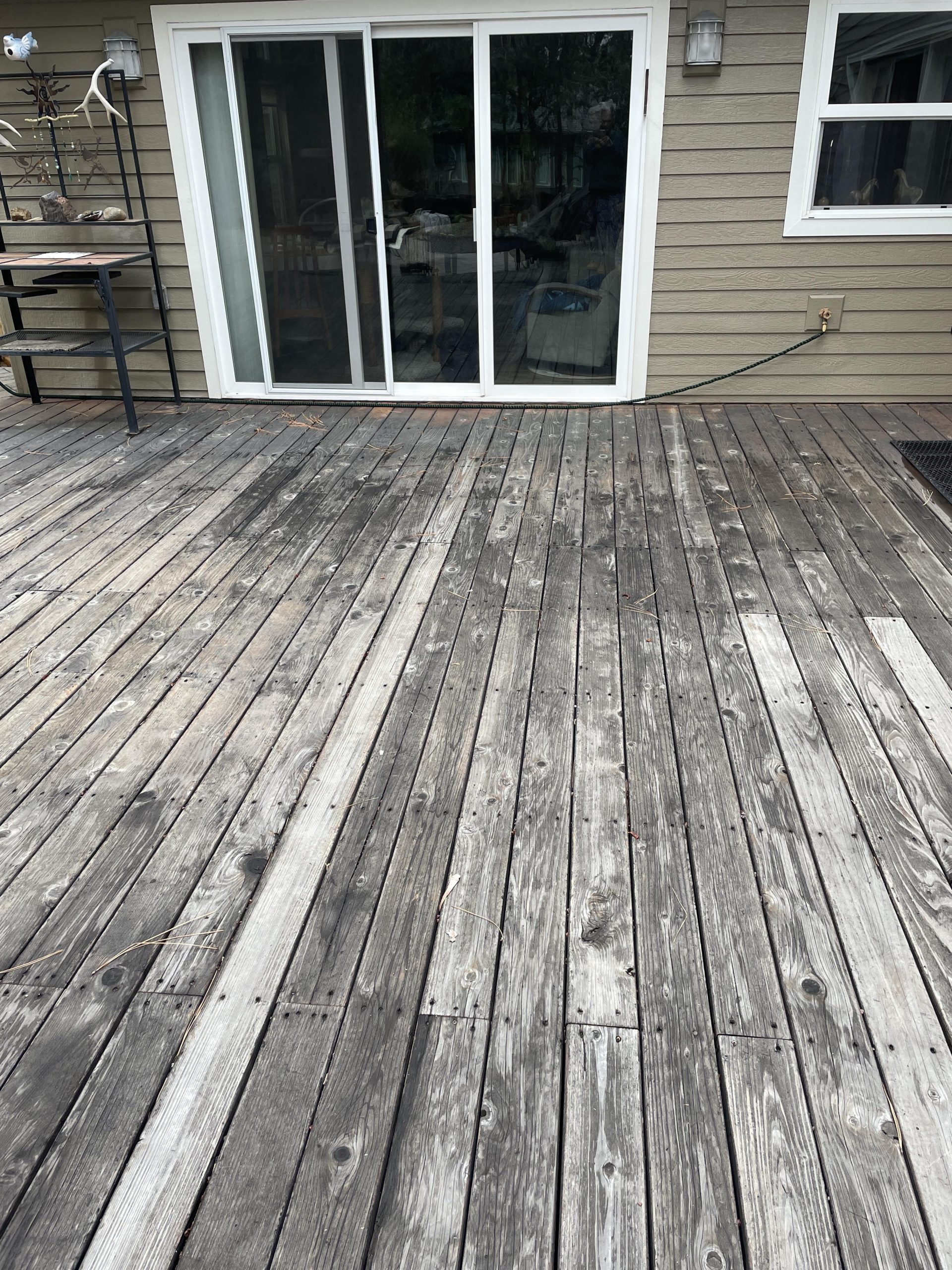

1. Old wood (~11 years), with exception of one railing 4×4 that had to be replaced.
2. No Current Coatings (waterproofing applied ~7-8 yrs ago)
3. N/A (no coatings)
4. No stains, unknown waterproofing brand.
5. No stains
6. Slight mold issues in nail holes/btwn planks, but mostly scrubbed off.
7. No stains used to date.
8. Pics, see attached (before/after scrubbing, mold).
Scott –
I’d love your advice, particularly after reading your deckover reviews (that’s out now!).
I’ve got a large pecan tree that looms over the deck, providing lots of shade, but also lots of dirt, leaves, pollen, and pecans that can stain. I’ve scrubbed the deck to get rid of the dirt, but haven’t used any cleaner or brightener yet. Goal is to coat (stain/paint) to blend/hide the stains, but also protect/extend the life of the deck.
Again, I’d love your input.

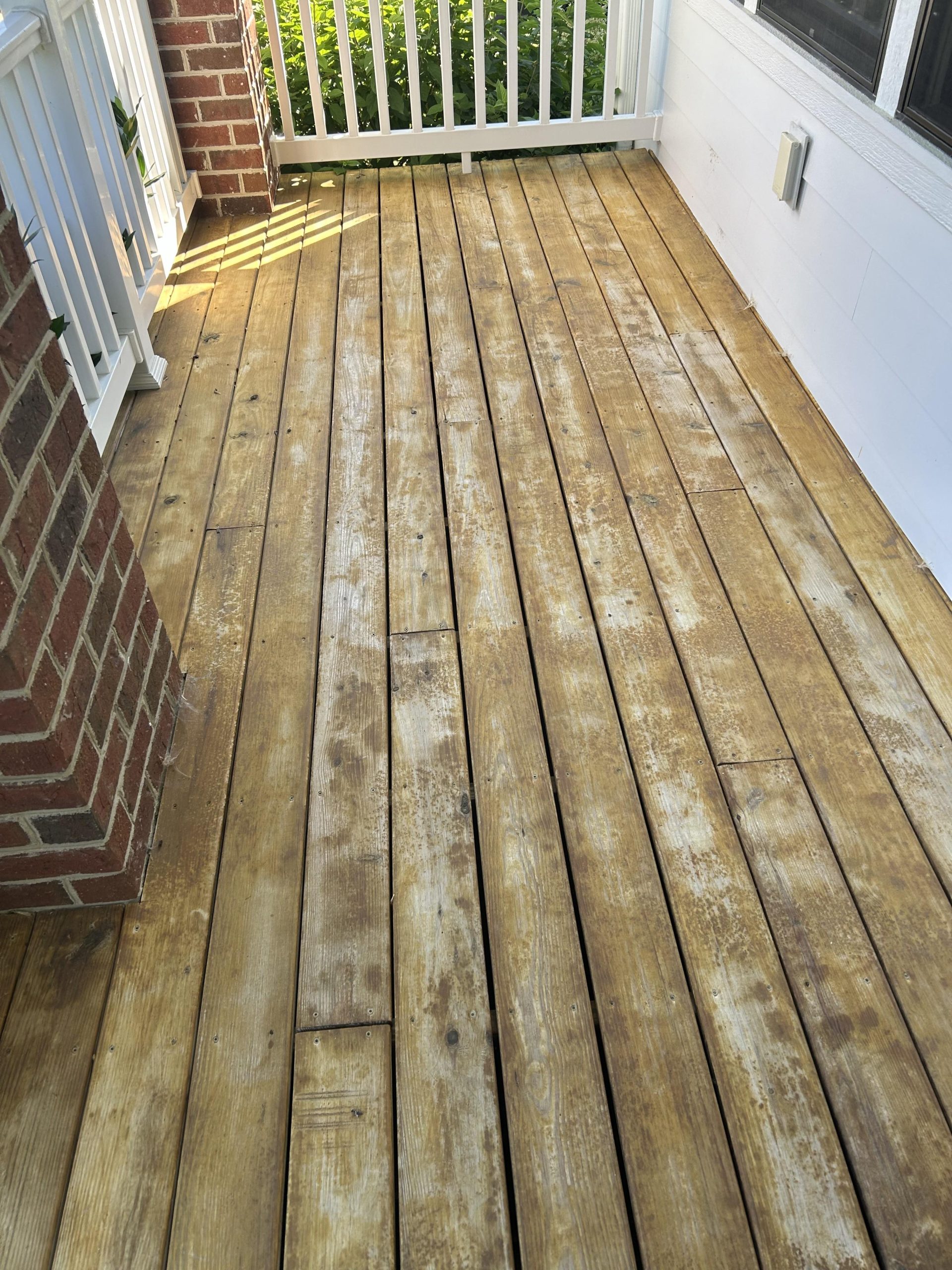

I have begun the process of refurbishing our front porch. It has been power washed and now I am confused, too much internet info, how to remove the old stain. I do not know what the previous homeowner used or how long ago. It has been over 7 years ago. I am going to re-stain using Cabot Gold moonlit mahogany. Any help would be greatly appreciated!
Kent
20250624_202458
20250624_202510
20250624_202556
Kent Horsman
Kent Horsman
Can you recommend a stain that will give the effect of an indoor wood floor? Oil or water based makes no difference to me. Looking for the best appearance and most durable finish. We are going with a dark mahogany type color as we are painting the rails, rail caps and posts white and staining the deck and balusters dark.
Thank you for your time and advice!!!

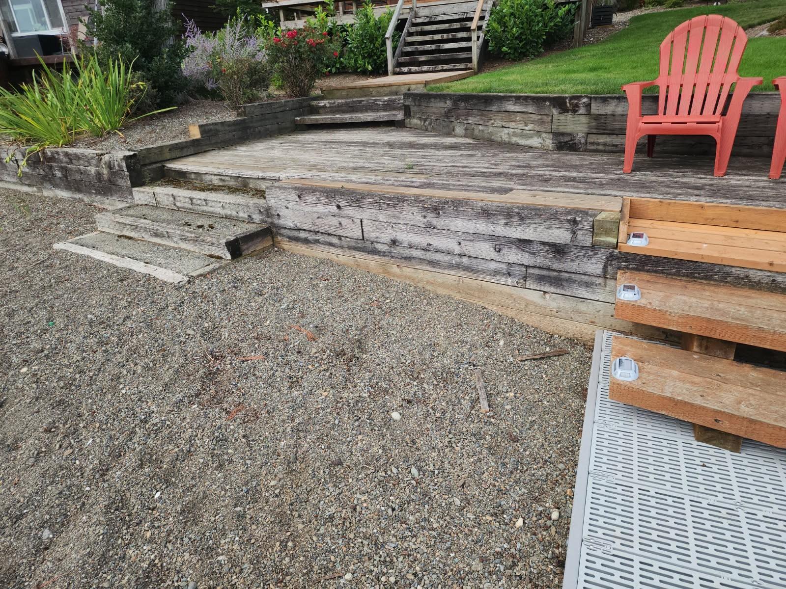

  1. New Wood or Older Wood? MIXTURE OF BOTH
  2. Does the Deck have a Current Coating? POOL HAS SEMI TRANS STAIN (DONE ABOUT 6 YRS AGO. UPPER DECK REPLACED MAJORITY OF OLD BOARDS- ONES REMAILING HAVE A THICK DECKOVER SOLID PAINT)
  3. Are you Switching Brands of Deck Stain or Applying a Maintenance Coat of the same Brand and Color? NOT SURE PREVIOUS BRANDS USED. PLAN ON USING BEHR DECKOVER SOLID ON ALL UPPER & POOL DECK
  4. Deck Stain Brand Previously Used? UNKNOWN
  5. What is the Current Deck Stain Type? BEHR TEXTURED ADVANCED DECKOVER
  6. Mold or Mildew Issues? NOT THAT I’M AWARE OF
  7. Reason for Previous Stain Failure? POOL DECK IS NEWER THAN UPPER DECK. TIME TO REFRESH & REINFORCE UPPER DECK & WANT TO REFRESH POOL DECK AND HAVE ALL THE SAME COLOR.
As you can see with the attached pictures, our deck is large & not all uniform – mixture of old(original) boards w/ heavy solid stain (peeling up and can remove in large strips) new replacement boards on upper deck. Lower deck (pool) boards are only about 5-6 years old & need stripped & re-stained (solid stain)
I am trying to complete the full deck at one time – the refresh & uniformity of the solid stain. I did purchase an airless sprayer to utilize on the vertical boards. During my research I have learned that I will need to dilute the solid stain to go in sprayer & for the first coat on the new deck boards. I have deck cleaner, pressure washer & 5 gallons of the solid stain already.
Any time line or order of operations you recommend to make this as least stressful, cost effective and streamlined as possible will be greatly appreciated.

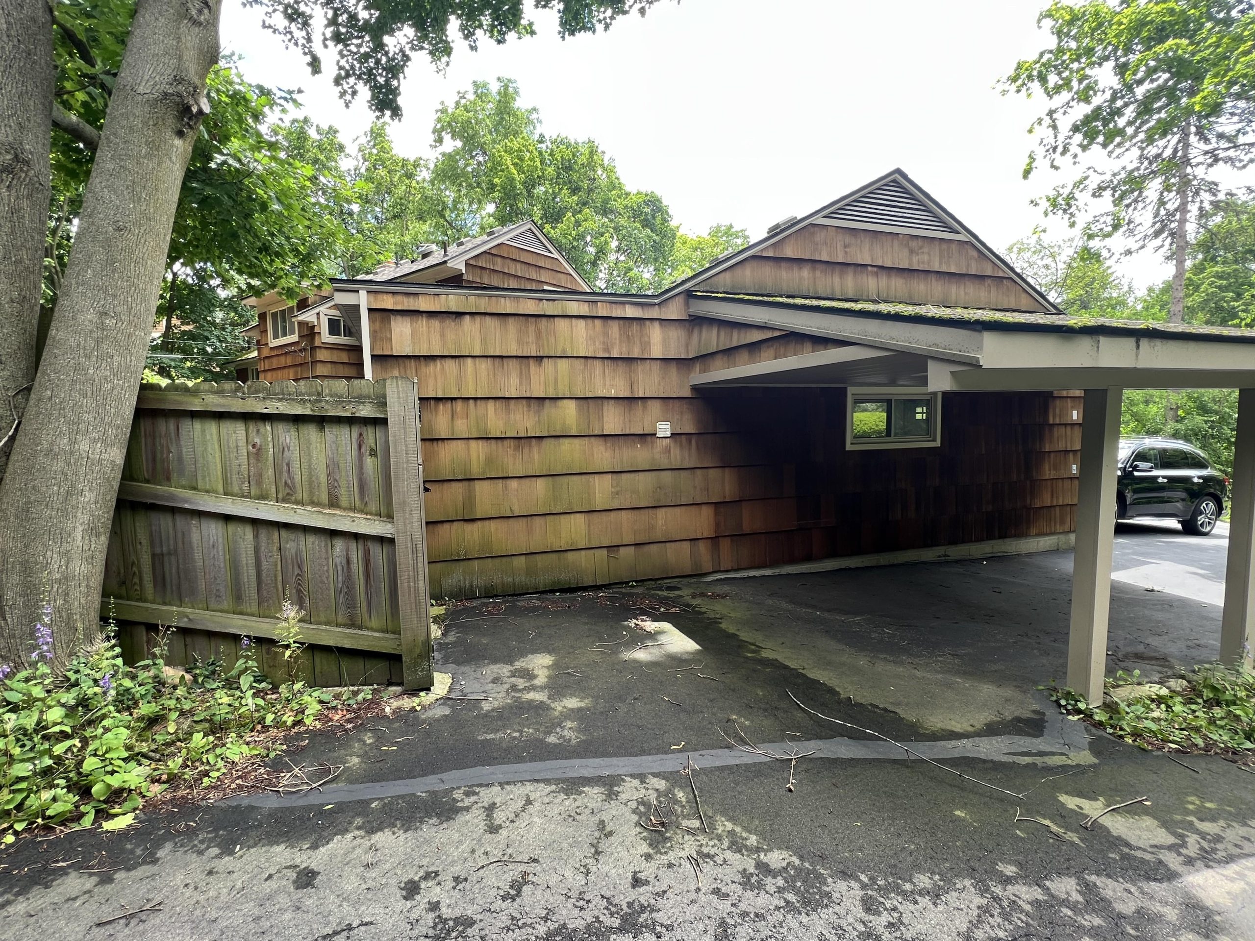

  1. 15-yr-old redwood fence and raised beds, the fence with intricate top panels (“keyboard”).
  2. Originally “stained” with (*sigh*) Behr Premium Semi-Transparent “Stain” in 2010, using a pressure sprayer and (following the instructions) 2 light coats.
  3. Looks like we’re stuck with “the one we brung”, since logistically it would be a nightmare to try to strip everything (see photo of fence). Note: We’re talking 136 linear feet of 18″ tall raised bed walls with a 6″ wide top board plus well over 200 feet of 7-ft-tall fence.
  4. Behr Premium Semi-Transparent “Stain” (from back before Consumer Reports dropped their rating)
  5. Acrylic based, Semi-Transparent
  6. No mold or mildew that I’m aware of. 3 months of intermittent rain followed by 9 months completely dry is a typical year.
  7. Reason for Previous Stain Failure? Having read your review of Behr Premium Semi-Transparent “Stain”, I suspect you’re in a better position to answer that than I am. I will say, though, that the vertical surfaces didn’t show visible wear until after several years (the stain was applied 15 years ago) and the horizontal surfaces didn’t start to peel for the first 3 years.
  8. You Must Include Picture(s) of the Current Condition. 1st picture is a front view of one of the raised beds. 2nd picture is of the gate, showing wear on vertical surfaces and active peeling on horizontals.
Since logistically (for reasons of physical intricacy of the structure, our age, $$ restrictions and most of a 5-gallon bucket leftover from a more recent purchase) I suspect we’re locked into re-applying the same Behr product, what is the best approach to trying to get the re-application to stick to the bared wood at least as well as it did the first time?

New pressure treated pine last year, cleaned/brightened with RAD, stained with AC semitransparent… beautiful! Cleaned/brightened with RAD today used fan tip contraption that attached to garden hose (less powerful than the pressure washer). Looks blotchy and seeing shoe prints after drying. What do I do now?!!! I’m afraid that staining as is will not turn out well.

William
William
Deck prep
Answers to the 8 questions
1-3yrs old
2-Yes
3-Maintenance coat same brand color
4-Super Deck
5-Solid
6-No issues
7-Before last stain cleaned w/dawn & oxi clean and used deck whitener
8- Pics attached first pic is the worst area

Built deck in 2020 with pressure treated spruce. Let it weather for 12 months and followed with a clean/brighten/spot sand the next season and application of Armstrong Clark Transparent deck stain (Natural tone). By fall the deck started turning black. Retailer suggested UV damage due to no pigment so the following season I cleaned/brightened and sanded the whole deck and applied Armstrong Clark in a cedar tone. Again the deck turned black so I attempted to clean it the following year with the retailers cleaner/brigtener and it would seemingly pull the stain out as well as if the stain was not penetrating the wood and was trapping mold. I tried some 30 Second mold cleaner and it immediately cleared up the mold but also pulled the stain and left some bleaching (did this before seeing you tip to avoid that product). I am looking to move to something water based and know have to again strip/sand/brighten but what do I need to do to ensure the new product penetrates (full mold treatment prior to staining???). The hours that this takes (500 sq feet plus stairs and skirting) makes this quite frustrating so I want to be sure I am prepping properly. My neighbour across street built deck and used same stain the same season and has had similar problems.
Evan
Evan
Thanks – any idea why the stain seemed to never penetrate the wood?

I have been using Flood CWF oil. It turns black like it’s collecting dirt. In 4 years on a new treated wood deck I’ve used deck cleaner and pressure washed it and reapplied the same product. It’s prepared again and I have 2 gallons of product but am looking for something that stays looking better. It’s hard to clean the cwf off? I thought the oil would be better than a water based product but am disappointed.
Jerry Rhodes
Jerry Rhodes
I plan to sand it to remove raised grain (fuzz) from heavy pressure washing. Pics won’t load.

Hi, I have a deck that was finished in early April 2024. I’d like to stain it in the next couple of weeks while the weather is around 60 degrees. Do you recommend I sand the deck prior to staining? Or should I skip the sanding because it’s so new and could potentially close up pores and prevent stain from sinking in. Also, what other steps should I take prior to staining? Should I clean the deck? Anything else I should do? Very new to this but don’t mind putting in the extra effort to get a great finish!
Hunter Aref
Hunter Aref
Thank you. I live in Charlotte, NC so it gets pretty hot/humid in the summer. I’d also like to clean, brighten and stain all in one weekend if possible. Do you recommend a specific type of stain for my region? Semi- transparent? How do I choose what VOC? Here’s a picture of my deck. I believe it’s pressure treated wood but not 100% what kind.

I live in northern CA and installed a three level redwood deck in full sun about 20 years ago. Prior to installation, I coated all surfaces with Superdeck oil based stain in redwood color. Two years ago, I decided to refinish the deck as the redwood had weathered considerably. I removed all the deck boards, flipped them over, and ran them through a planer to remove any old stain and expose a “fresh” surface. I then stained the “fresh” surface with TWP 1502 (redwood color). The results were very good even though the color was a bit on the orange side. The plan was to then restain one level each year to maintain the deck. This year I decided to restain one of the levels because the stain was beginning to wear off. I purchased some more TWP 1502 and tested the color by staining a few of the stair treads. I first cleaned the boards with a stiff bristle brush to remove any loose stain and dirt. The result was a very dark red color. I then sanded the boards to again expose a “fresh” surface. This time the color was lighter but still darker than the color from two years ago. Is there a way to lighten/brighten the stain so as to better match the color of the other
two levels?

We have a situation on our hands! We had a pressure-treated wood deck installed one year ago. We let it weather, cleaned it, and brightened it.
Before staining the deck, the contractor used Bondo to fill knots and any minor imperfection in the deck; more repair was done than necessary, in hindsight I would have done no repair.
He then tested the penetrating oil-based translucent stain (natural color) on a board and realized that the stain would not cover the grey Bondo… The stain only calls for one coat.
He then removed all the Bondo by hand (mostly scraping) and in the process used an orbital sander on the deck.
The next day (yesterday), he applied the stain. This led to multiple light spots all around most knots on the deck where the Bondo was removed and the deck was sanded.
I called the stain manufacturer, and they said it could be alright to try to add additional stain only to the lighter spots but to first test in a small area. I’d like the deck to look more uniform, and the staining was a big job that took two men a full day to brush on by hand.
Is this the best approach, or is there another path I should take?
Thanks for your help,
Liam

I have a 30 year old pressure treated deck. We recently bought the house and the previous owner only knows that they used a waterproofing stain. It is semi transparent, and wipes off with alcohol. It is a very large deck 12 feet off ground. We do not want to strip, we are in our 80s. I want to clean and brighten and use solid stain, but my husband is concerned it will peel. Half of the deck is covered by an awning and the rest exposed with a basic western exposure, so late beating sun.We live in south central Pa. All advice appreciated
Kay Comly
Kay Comly
Screenshot-2024-09-09-at-9.58.29-AM
Screenshot-2024-09-09-at-9.59.04-AM
Kay Comly
Kay Comly
I have read this, but it does not say how to prep over semi transparent stain. I want to avoid stripping but will clean thoroughly. My concern is can I do this and avoid a peeling situation. I would use Restore A deck solid

I have a decent amount of decking that was stained by a recommended contractor with Proluxe (PPG) transparent matte SRD RE. Didn’t last a year and they didn’t prep properly as I observed when they came back to “fix” it and then quit. They pressure washed and then ghosted me.
Can I strip and brighten and try a new stain or will I need to sand?
Deck is 7 years old.
Pressure treated yellow pine. Virginia so heat, sun and rain.

We’re wondering what we should do with this finish that is failing unevenly and boards are slightly gray. Our deets:
  1. Old wood (20+ yrs)
  2. There is an existing uneven coating
  3. We are switching brands
  4. At least two brands were previously used with minimal prep done between applications: most recent: Behr Premium. Earlier: Armstrong-Clark
  5. Current deck stain type: Behr Premium: Cedar Naturaltone semi-transparent waterproofing stain and sealer (penetrating oil), but there may be remnants of Armstrong-Clark: Cedar Semi Transparent
  6. Minor mold/mildew in shaded areas
  7. Reason for failure unknown, but maybe poor prep, UV from south-facing aspect, and/or foot traffic?

We are planning to re-stain our deck but unsure of preparation steps. Deck built new in 2021; stained same year with Cabot Semi-transparent Stain + Sealer. Will use the same shade to re-stain; focusing on the horizontal boards (deck, rail, steps). Deck is on east side of house; in metro Kansas City. And advice is appreciated. Thank you.
New Wood or Older Wood? 3 years old
Does the Deck have a Current Coating? Yes Cabot Semi-transparent Stain + Sealer (oil based).
Are you Switching Brands of Deck Stain or Applying a Maintenance Coat of the same Brand and Color? Will use the same brand and shade to re-stain
Mold or Mildew Issues? no
Reason for Previous Stain Failure? not sure

I will be staining my home in the upcoming weeks. House has an existing stain, but has not been coated in the past 5 years. I’d like to match the existing color, but do not know the brand that was previously used. There’s also significant mildew growth in some areas. The previous stain hasn’t failed any areas, but has began to dull in places. I am torn between using the stain remover and then the brightener, or just using a cleaner and then a brightener. Do you think the stain remover is necessary?

  1. New Wood or Older Wood? 4 years old
  2. Does the Deck have a Current Coating? SW SuperDeck Transparent Oil Based
  3. Are you Switching Brands of Deck Stain or Applying a Maintenance Coat of the same Brand and Color? Same brand maintenance coat but have questions
  4. Deck Stain Brand Previously Used? Enter “unknown” if you do not know. see above
  5. What is the Current Deck Stain Type? Oil-based or Water-Based? Clear, Transparent, Semi-Transparent, Semi-Solid, or Solid Stain? Oil based Transparent
  6. Mold or Mildew Issues? I think so, see photos
  7. Reason for Previous Stain Failure? not sure
I built a new fence in June 2020, followed up with a summer of drying then cleaned and stained it Sept 2020 with the above stain. I wanted to do a maintenance coat to keep it looking good for years to come but most info applying stain says to strip the stain, then brighten and stain. My fence is in good condition overall, looks good from the street still but does have some dirt or maybe mold issues, see photos. I assumed I could just give it a good clean (not necessarily strip the stain) then brighten and stain with the same stain to keep the color similar. Although I liked the super deck stain, I see here it’s not highly recommended (not sure if it matters for fence vs deck, i think it worked fine) If I hold off till next year, I would buy the recommend stains. Based off my photos, what’s best way to proceed? Being the middle of August and in WA state, we have only a handful of good weekends left. Quite frankly I’m a busy every weekend this month and most of Sep so I am debating just waiting till next June/July to do the entire process. That would allow me to get all the supplies ahead of time, and plenty of nice weekends to get it done. Any advice is helpful and thanks for the time

I had a new cedar deck built in fall 2022 during very warm conditions in Pacific NW) and used Behr Premium semi- transparent, waterproof stain and sealer. Shortly after the first year it began peeling along with formation of mildew spores which both conditions have become extensive on all new deck boards and railing (primary damage) with some mildew forming on columns and posts. I’m hesitant to use the same brand, but would prefer to do so. I’m not certain why this stain failure has occurred as this product appears to be highly rated so may be improper application (??)
– new deck photo & current condition are attached

chris
chris
Hello Scott.
We moved in here a year ago. This is an old treated wood deck that has always been left untouched. Could be 14 to 23 years old.
Most of the screws have come up a little so sanding is out of the question.
We would like to just have it last longer (grey is fine) while we save up to replace the boards which are still in not too bad condition.
The frame is in good shape. What might you recommend?

MAUREEN
MAUREEN
Moved into the house and have no idea how long since the deck was stained etc.
What should we use on this deck to make it look nice again

  1. New Wood or Older Wood? Old — but I’d guess >10 yrs since it was a rental during that period.
  2. Does the Deck have a Current Coating? Yes, peeling solid coating
  3. Are you Switching Brands of Deck Stain or Applying a Maintenance Coat of the same Brand and Color? New brand — since I don’t know what was put on before
  4. Deck Stain Brand Previously Used? Enter “unknown” if you do not know. Unknown
  5. What is the Current Deck Stain Type? Oil-based or Water-Based? Clear, Transparent, Semi-Transparent, Semi-Solid, or Solid Stain? Solid stain. Oil based?
  6. Mold or Mildew Issues? Yes, green mold, mostly on the vertical railing pieces
  7. Reason for Previous Stain Failure? Unknown and would love your guess. I assume it’s just age. Home was previously a rental so only got minimal maintenance.
  8. You Must Include Picture(s) of the Current Condition. See attached.

Appreciate all the info on the site and all your help with the comments here. Was thinking a wood cleaner. Then apply same stain. Is brightener recommended for this situation too after the cleaner and before staining?
3 years old. New deck in 2021
Yes. Cabot Australian Timber Oil Natural Transparent.
Need advice. Was planning on a using the same brand and product above.
Cabot Australian Timber Oil Natural Transparent. Applied May 2022
Oil. Transparent.
Had spots of green algae. Used Dawn and water. Didn’t work. Hit it with some pool cleaner.
Reason for Previous Stain Failure? Age? Applied in May 2022
Thanks in advance for any guidance you can offer with prep for this year. Happy holiday weekend!

We bought this house a year ago, and have been plugging away at all of the deferred maintenance. The deck is in need of attention. I recently power washed to remove loose pieces of the coating. It seems to also need a sanding (even more so after washing). Hoping it’s not too far gone that I’d have to use a resurfacer rather than stain, as I don’t want to be locked into the limited colors available. Could you please advise?
1.    Older wood.
2.    Solid stain? Probably 50% of it is worn off.
3.    I’d like to apply a solid stain in a different color.
4.    Unknown brand.
5.    Unknown current stain type.
6.    No mold or mildew.
7.    Deferred maintenance.
8.    Pics attached.
Any guidance you could offer would be appreciated. Thank you so much!
* Both. The new wood is the deck board. Everything else is older wood.
* Yes.
* Switching brands and color—switching to Armstrong Clark semi transparent cedar
* Behr waterproof
* Solid stain
* Maybe
* Chipping
70121879928__E756BF5B-4068-4BF8-AA99-5198D82433FD
IMG_2122
IMG_2191
Iris Martinez
Iris Martinez
Does the stain need to be completely sanded off? I put the gel and then sanded. Seems like there a lot more paint left.
I was planning to do semi transparent Armstrong cedar color on the verticals.
Older wood, approximately 12 years old. Not 100% sure if cedar?
Yes, not certain what it is.
No
Unknown
Unknown?
Not that I’m aware?
West facing deck with no trees, substantial sun contact.
20240306_081319
20240306_081324
20240308_101821

Hello! Thanks for being such a a helpful resource!

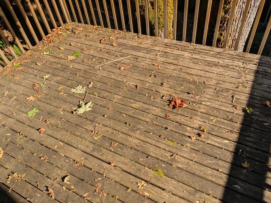

First time home owner dealing with 3 deck spaces… Back deck, front porch and side entrance. All of them are wood, built about 3-4 years ago, and to my understanding they’ve never been treated.
New Wood or Older Wood? Newish? 3-4 years
Does the Deck have a Current Coating? No current coating
Are you Switching Brands of Deck Stain or Applying a Maintenance Coat of the same Brand and Color? N/A
What is the Current Deck Stain Type? Oil-based or Water-Based? Clear, Transparent, Semi-Transparent, Semi-Solid, or Solid Stain? None yet
I’m unsure if I need to sand this all to get a nice surface, and how I should deal with staining. Do all of the surfaces need to be stained, including underneath?
George
George
Let me know if these work
May_12_2024_3_37_54_copy_482x640
May_12_2024_3_37_57_copy_482x640
May_12_2024_3_37_46_copy_640x482
May_12_2024_3_37_40_copy_640x482
George
George
You don’t think it needs to be sanded?
George
George
Thanks! Does the link you sent include Clean and Brighten products/methods? Apologies if my questions are basic

Can I stain a deck and fence that has been painted after stripping with a TW
P product? If so what process should I use. It is peeling badly but no mildew and we are in Wyoming so product needs to with stand very cold weather.

Hello- We purchased a house where the previous owner made some strange choices including covering a large portion of the deck with cement pavers. We did a quick (not very well done staining) of the portion not covered by pavers 2 years ago when we first bought the house and just recently discovered the section of the deck that has been covered with pavers. We are replacing some areas with new wood but for budget reasons most of it needs to stay the same wood for now.
  1. New Wood or Older Wood? Mostly old pressure treated wood, see above.
  2. Does the Deck have a Current Coating? Half of the deck yes, half no.
  3. Are you Switching Brands of Deck Stain or Applying a Maintenance Coat of the same Brand and Color? New stain Brand and color
  5. What is the Current Deck Stain Type? Oil-based or Water-Based? Clear, Transparent, Semi-Transparent, Semi-Solid, or Solid Stain? The partial stain is Solid, not sure if it is Water or Oil Based
  6. Mold or Mildew Issues? Not to the eye but I worry about what is underneath.
  7. Reason for Previous Stain Failure? It hasn’t failed necessarily but we want the deck to all match.
Thank you in advance for your advice.

Thomas
Thomas
Hi Scott, First of all, thank you for providing this excellent public service!
I last restored my deck in late 2021. As you will see in the photos, it needs some work.
My answers to your questions:
Old redwood
2. Current Coating?
Yes
3. Switching Brands of Deck Stain or Applying same Brand and Color?
Same brand and color: TWP “Driftwood”
TWP “Driftwood”
Don’t remember. I think Semi-Solid.
Not really.
Wear and tear in traffic areas. See photos.
Question: Is there a way I can restore the traffic areas only?
8. Picture(s) of the Current Condition.
See below.
IMG_8313
IMG_8310
IMG_8314
Thomas
Thomas
I’ll take this opportunity to ask about some benches next to the deck. (See photos.) They were built out of ipe (tropical hardwood) around 2008 and never coated, treated, or restored in any way. My feeling is that a good pressure wash will make them look great again. But then do I need to coat/treat in some way?
IMG_0106
IMG_0107
IMG_0108
Thomas
Thomas

I live in Southern California with a south west facing deck that gets a lot of full sun and coastal fog all year long. The deck is 18×26 ft redwood, built in 2021 and stained with semi transparent Cabot after it weathered for four months. It was properly prepped and sanded before using the semi transparent stain. This deck is attached to ADU rental making it difficult and expensive to do maintenance. Stain wore off in most high traffic areas after 18 mos. and photos show deck after recent power wash with no extra cleaning/brightening products.
My husband and I are having debate with my painter/contractor on whether to sand down to bare wood or no, and what to use to maintain UV protection that won’t need refinishing every 2-3 years. Hoping for something that lasts 5 years. Bids to redo our deck ranged from $4000-10,000! And wish we had used composite! Hubby wants to paint deck for lower maintenance but wondering if a semi solid or solid stain will be better than deck paint and last as long?
Pergola is already stained with Cabot semi-solid in Cordova Leather so looking for a lighter floor stain color that offers good long lasting coverage and UV protection. Also need to decide on whether another round with a cleaner/brightener is enough prep or if full sanding (painter recommended) is necessary. A few spots have stains from planters that may need a light sand, but no obvious mold or mildew.
Planter boxes were purchased online and appear to have solid stain on them. Ideally, would like to clean and prep these to better match deck.
Would appreciate advice on next steps and best products for longevity. Great site! Thank you.

Hi, I’ve been asked to redo a large fairly new deck in the beach area of SoCal. The deck was brand new about 2 years ago and the builder used Behr semi-transparent. It has failed significantly (badly peeling on most horizontal areas and mostly mildew on vertical). I’m planning to strip and neutralize but need your advice on what semi-transparent to use to hold up the best in our high UV but also high moisture/humidity environment.
Link to Google photos https://photos.app.goo.gl/KrdRh5gBQNEFrkpE8
