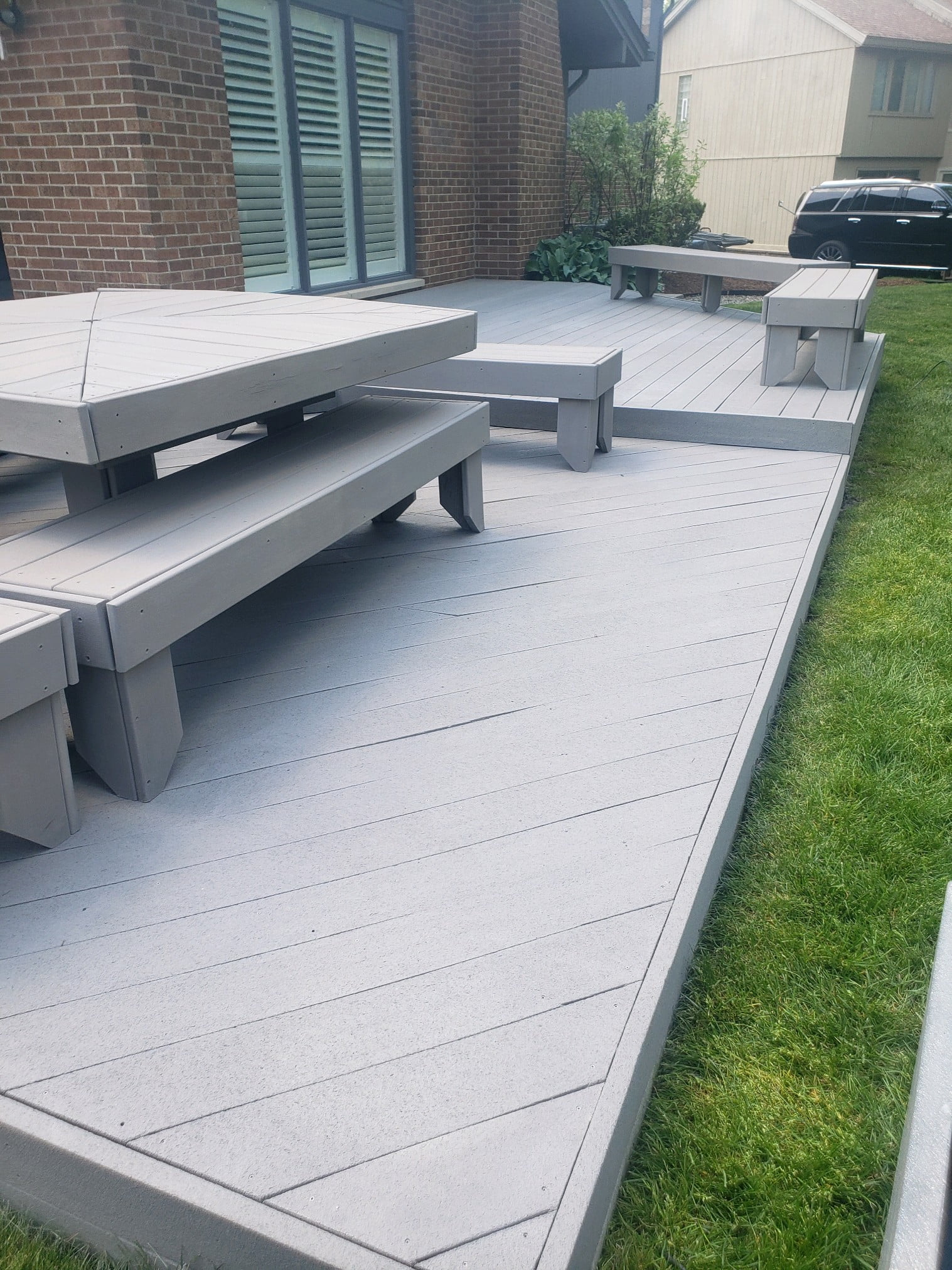

How to Stain a Composite Deck (Properly and Safely)
If your composite deck is starting to look faded, moldy, or worn, staining can revive its appearance and add much-needed protection. Older composite decks—especially those made from wood-plastic blends—can benefit from a good cleaning and the right type of penetrating stain. Follow these steps to get long-lasting results.
Step 1: Clean the Deck Thoroughly
Before applying any stain, you need a clean, dry surface to ensure proper penetration and adhesion.
✔ Use a composite deck cleaner to remove dirt, mildew, algae, and gray weathering.
✔ Scrub with a stiff-bristle brush or use a pressure washer on a low setting (under 1500 PSI).
✔ Focus on mildew removal, as older composite decks often harbor mold due to their wood fibers.
✔ Allow the deck to dry completely—this can take 24–48 hours depending on conditions.
Pro Tip: Never stain over damp composite decking—it will trap moisture and lead to early stain failure.
Step 2: Choose the Right Composite Deck Stain
Not all stains are suitable for composite materials. Select a high-quality, penetrating stain designed to work on wood-plastic composites.
✔ Choose a semi-transparent or semi-solid penetrating stain—avoid solid or film-forming products.
✔ Look for formulas that contain mildewcides or zinc-based additives to prevent mold and mildew regrowth.
✔ A good stain will resist UV fading, discoloration, and water absorption.
We recommend TWP Semi-Solid Pro-Series for composite decking due to its excellent penetration, color retention, and mildew resistance.
Step 3: Apply the Stain the Right Way
Proper application makes all the difference in durability and appearance.
✔ Use a stain pad, brush, or roller to apply evenly and push the stain into the surface.
✔ Work in small sections and follow the grain of the decking when possible.
✔ Avoid over-applying—too much stain can cause pooling, tacky spots, or uneven color.
✔ Allow the stain to penetrate for a few minutes, then wipe away any excess.
Avoid using film-forming stains—they don’t adhere well to composite and tend to peel, trap moisture, and encourage mildew.
