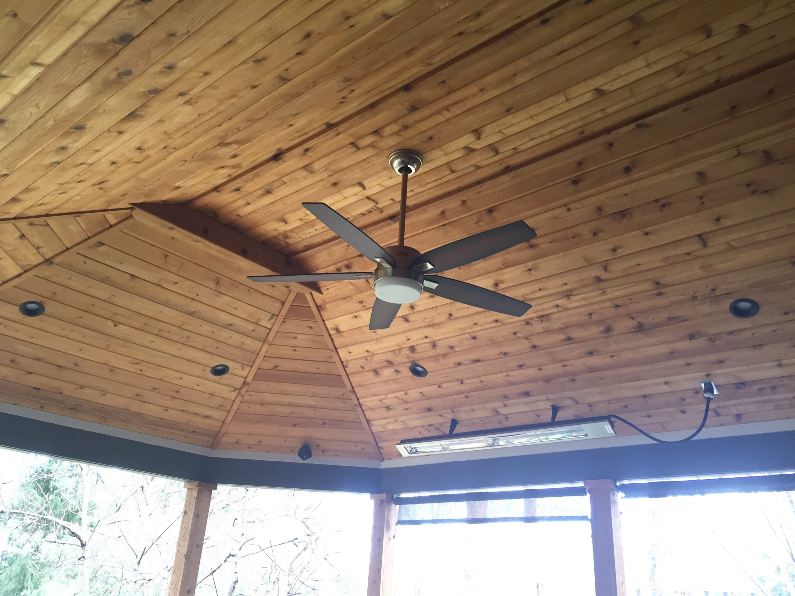

Porch ceiling stained with Armstrong Clark Natural Tone
My favorite stain for a porch ceiling is the same penetrating semi-transparent deck stain you use on the rest of the wood on your covered porch. Semi-transparent stains soak into the wood, protect it from moisture and mildew, and let the natural grain show through. Using the same product everywhere also makes it easy to match the color across the floor, posts, railings, and ceiling.

I am very confused after reading on so many different sites. My husband is installing spruce tongue and groove panels on our outdoor patio. New addition to the home. Not staining prior to installation. That would be quite a challenge for us space-wise. Your porch ceiling looks amazing. Reading your recommendations I first looked at the Restore-A-Deck, but wish they had more of a color selection. Then saw that you used the Armstrong Clark. We’ve stained before, but nothing of this magnitude. Not sure how the spruce is going to take the stain or what to use for pre-conditioning. Planning on applying the stain with a sprayer. Any advice or suggestions that you can give regarding products, procedure, and what to expect with the spruce?
What color stain was used on the ceiling in that picture?

What wood species? I have yellow pine t&g on my ceiling and I doubt it would look as nice as this!

Was this a transparent or semi transparent stain ?
