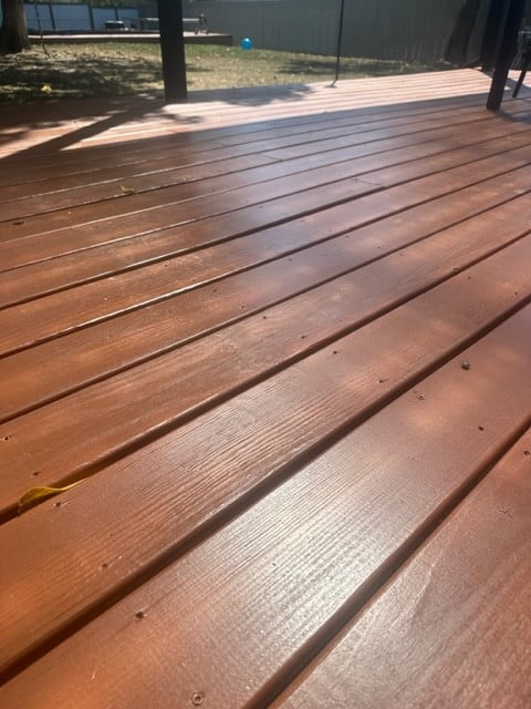

We’ve stripped at least twice, and in some areas three times, with the RAD stripper, and we just can’t get those two long boards to not be grey. Is this just the wood or do we need to keep going? I am afraid I’m getting too focused on getting it perfect. Is it ok to go ahead and stain? We also have the RAD cleaner that I bought accidentally but I’ve kept in case that’s what we needed to use to finish this up. What I don’t want is to stain it and mildew/mold keep growing under there.
Make sure to brighten the wood after stripping, and then you should be okay to stain.

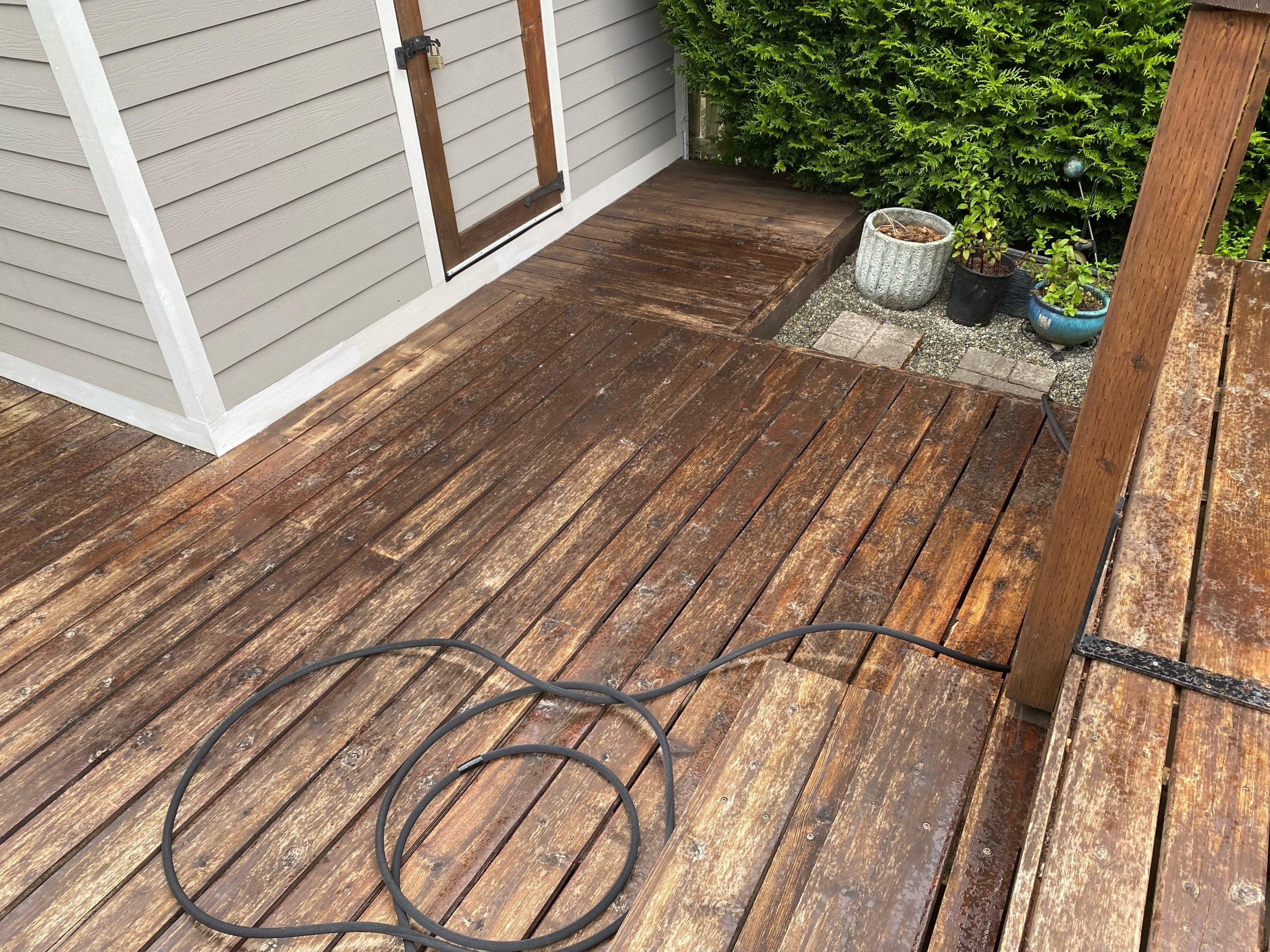

I’m going to try and remove some Transformations SemiTransparent stain that is about 8 years old on a log home. It’s about 500 square feet of space. I purchased the Wood and Deck stripper with the gel because it’s logs. If this has too much of a varnishy finish and it won’t remove the product what is my next option?
The RAD PaintStrip: https://www.deckstainhelp.com/product-category/rad-paintstrip-paint-solid-stain-stripping-gel/

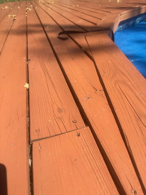

I am reworking my deck, that was “treated” with the Sherwin Williams Super Deck water based, semi transparent deck stain. If I am going to go with a TWP product, do I need to remove every bit of the stain on my deck, and the oether parts of my deck? If so, what deck stripper is recommended, in addition to sanding off the stain on the deck?
Yes, you have to remove the SW stain. Add some pics in the comments of the current condition.

I have a old deck which appears to have no treatment by past owner. Thinking of using the Retore-a-deck cleaner and then the Brightner before I put a stain on it. Looking for recommendation.See attached
No pics, but yes, that will prep the wood. For the stain, use a penetrating stain such as Armstrong Clark or Restore-A-Deck:
Do not know what stain is on railings but appear to have a sheen so I think perhaps a type of sealer was put on them. Wish to revert to a semi-transparent stain with no sheen so that maintenance will be simpler. Would the Stain stripper work on this so as to switch to semi-transparent stain be recommended in this case.
We would need pictures to see what would work best. You can add them in the comments.
here are the pictures, sent the earlier but there were 5 so I guess they did not go through.
Still no pictures. Most likley they are too large in size. They have to be below 2mb.
Will try one more time but pictures are 1.2mb and there were only two.
Try one at a time.
here is one
Here is the second one. they are jpeg format.

We just had two decks stained with Cabot Semi Transparent Redwood stain. It seems like the stain was applied very heavily as it is shiny and tacky. It almost looks like paint. It makes the wood very hot and slippery. What is the best solution at this point? One of the decks surrounds a pool.
To fix you would have to power sand this all off.
Oof. Ok, is that what you would recommend given the photos?
If the stickiness does not go away then yes.
And can you explain why sanding vs any kind of stripper or a combination of the two?
Strippers will not work very well with a newly and over-applied stain like this.

Please help! (in the last pic, we tried a stripper as a test. we also pressure washed) Thank you!
See this for tips: https://www.deckstainhelp.com/how-to-remove-a-solid-color-deck-stain-or-paint/
What stripper will remove behr deckover acrylic based
It is not possible to remove a deck resurface stain with a stripper: https://www.deckstainhelp.com/how-to-remove-rust-oleum-deck-restore/

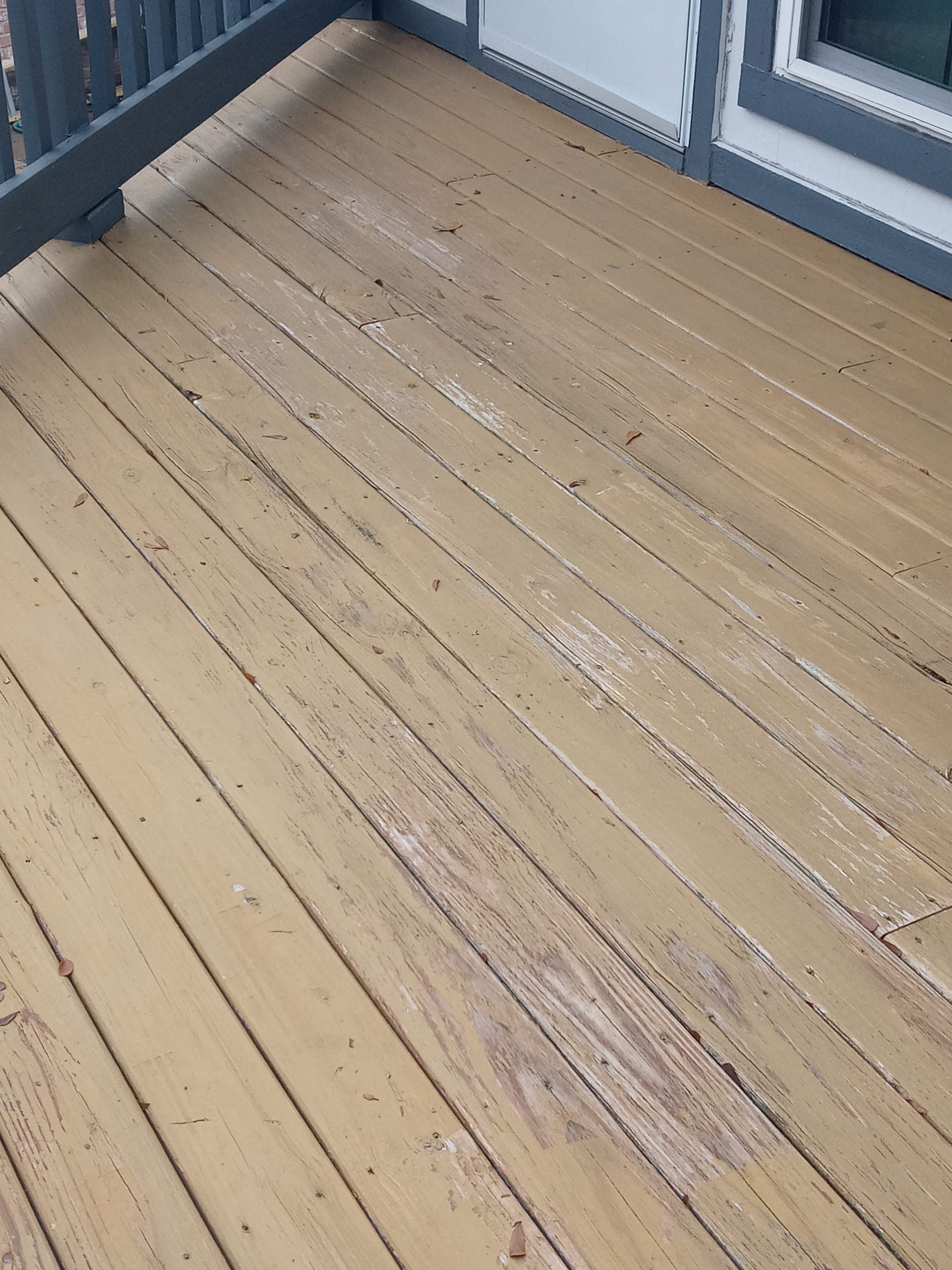

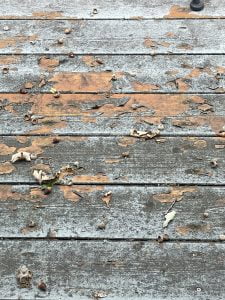

My deck is flaking bad and I need to remove what’s on there. Would a stripper work or do I need to sand? Let me know what approach is best! Thanks.
A stripper will not remove this fully. You can strip some off then it will make your sanding easier. Brighten the wood after.

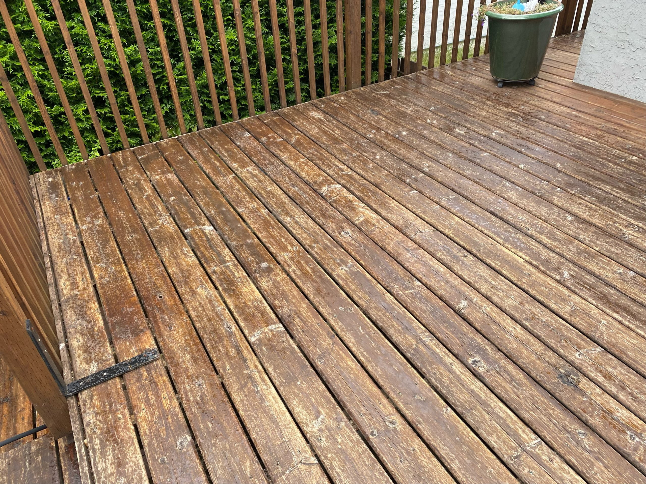

I have an older cedar deck. The pictures show it after pressure washing. The peeling boards are from replacement boards put on one year ago. The whole deck was then covered with Sikkins water based semi-solid stain. I want to remove the Sikkins and wondering if I can use a stripper first (will it damage the unfinished spots?) and then spot sand before using a brightener. Thanks
A stripper will not remove this. You will have to power sand to fix this. Sorry.

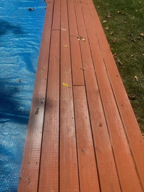

We put Behr Semi-Transparent waterproofing stain and sealer on our deck 2 years ago. It is peeling off all of the flat surfaces, but on the vertical posts etc…We would like to remove it all and start over with a new stain. Will a wood stripper work or will we need to sand the areas that are not peeling?
Post a picture of the deck in its current condition.
Here are a few photos
Use the Restore A Deck Stripper with these additives: https://www.deckstainhelp.com/restore-a-deck-stain-stripper-booster-thickening-gel-review/
Great, should that remove all of the stain?
90-100%

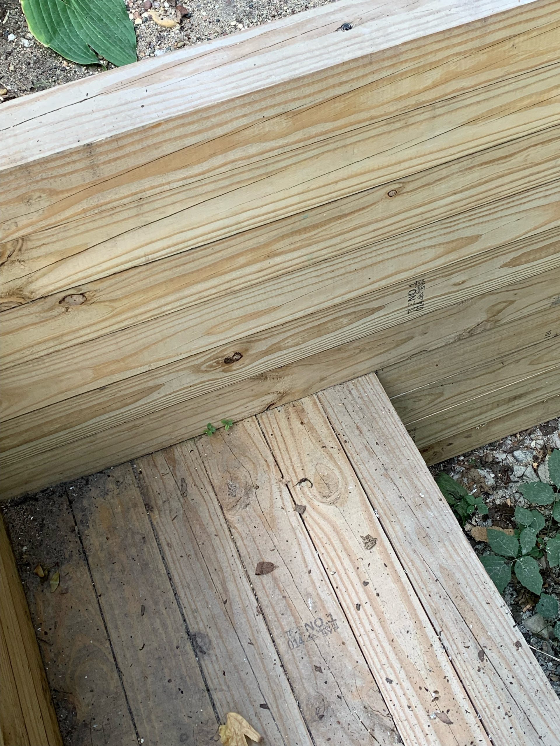

New deck using the usual 5/4×6 treated deck boards. Sanded using 220 grit paper. Rolled Superdeck semi-transparent oil. Many sticky patches weeks later. Any ideas how to fix this ?
You might need to strip it off and start over. You did a few things wrong. New wood needs to season and be prepped correctly to open the wood grain and remove the mill glaze: https://www.deckstainhelp.com/staining-a-new-deck/
Also sanding a deck is not a good idea, especially at 220 grit. This will reduce the stain’s ability to properly soak into the wood grain.
