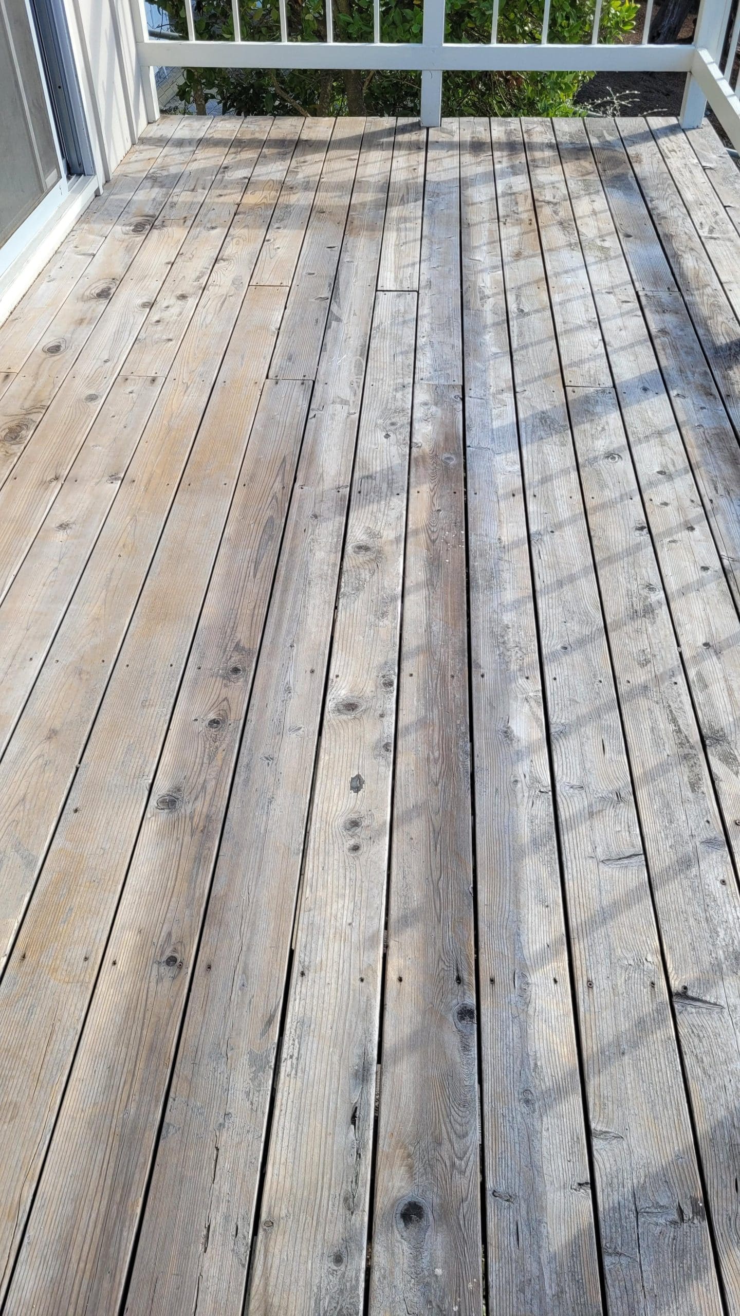

Hello Scott,
We have an old redwood deck built in late 70’s. It hasn’t been stained in years. I have attached a photo. My wife pressure washed it over the summer. Deck is pretty weathered, as you can see. Most likely no residual stain. Live near the ocean, so mold and mildew concerns.
I reviewed your article on semi-solid stains. I was previously considering a solid water- based, due to age of wood and wear. The Valspar an Behr and Cabot solids sedmed to test well in Consumer Reports as well as in Bob Vila’s reviews. I want to stay away from the semi-transarent and transparent, since their appearance degrades rapidly after yr. 1 per testing (per CR).
I am concerned about potential peeling with the water- based solids, so was possibly considering an oil- based semi -solid. I know that you recommended TWP (although it seems this brand is tied in with your e commerce site). I belive Bob Vila rec. Cabot as a semisolid. Would this be preferable since the oil based penetrates and since it is an old deck? Just a cleaning and brightening product, then sanding?
CR also mentioned if an older deck like this had pressure treated wood installed (unknown if it is), there may be arsenic deposits within the wood, and it is better for a pro to perform the work. What is you feeling also on this?
Thank you in advance for your advice.
Weathered wooden deck with visible wear and tear, showcasing potential for cleaning and treatment with semi-solid oil-based stain for improved UV protection.
Joe C.
10 months ago
Thank you. You had mentioned good prep. Would you also recommend using a cleaner and/or brightener, then sending prior to staining? The Gemini Restore-A-Deck kit?
Also, since the redwood decking is old with cracks/imperfections, I would assume the TWP semi-solid would be best. The solids on the market all seem water-based acrylic, so a semi-solid penetrating oil-based stain as you mentioned would seem to be best. Just wanted to make the right choice.
Thank you again.
Joe C.
8 months ago
Thank you. Since we’ve waited until late fall with a few rainstorms so far, and still want to stain, it appears we are limited to the Restore-a-deck and Olympic Maximum semi-transparent. Both seem to be among thew few that can be applied to damp wood. This Olympic product had a lower test score in CR. Also, with our weathered redwood deck, we thought that a solid would be best. So, the Restore-a-Deck solid would seem to be the choice at this point. Would you agree?
Also, we were curious about using a water-based since it would just be a film on top of the wood and would not penetrate. But from reading it seems that the RA Deck does penetrate the wood. If so, would this apply also to the solid colors version.
Thank you again for your help.

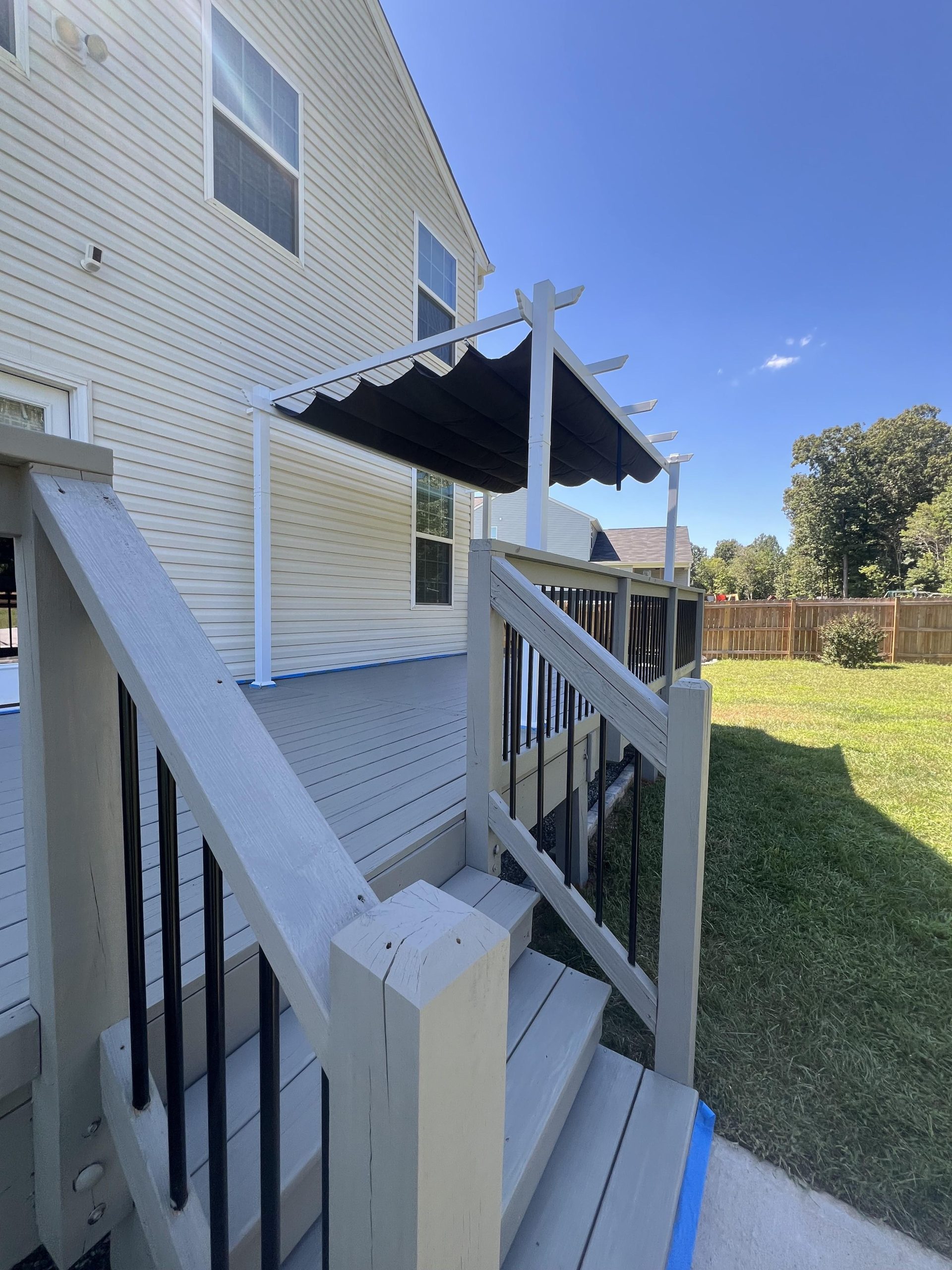

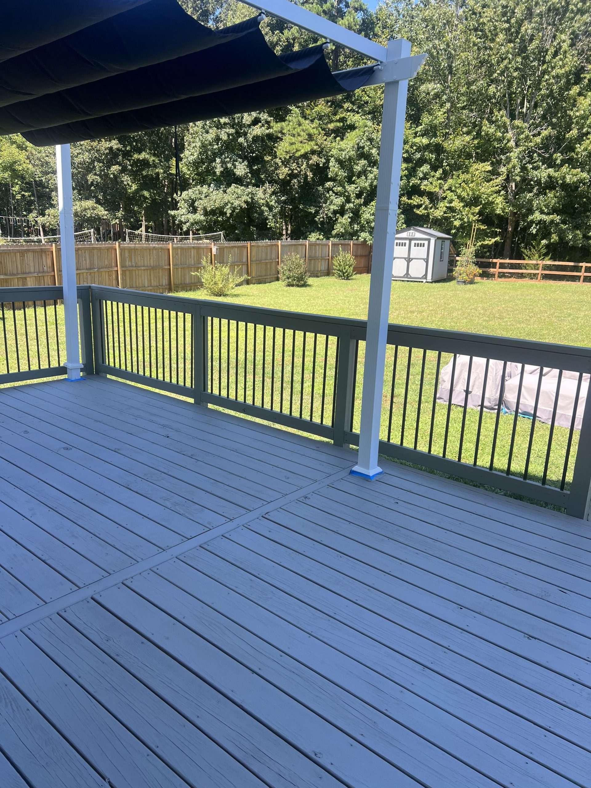

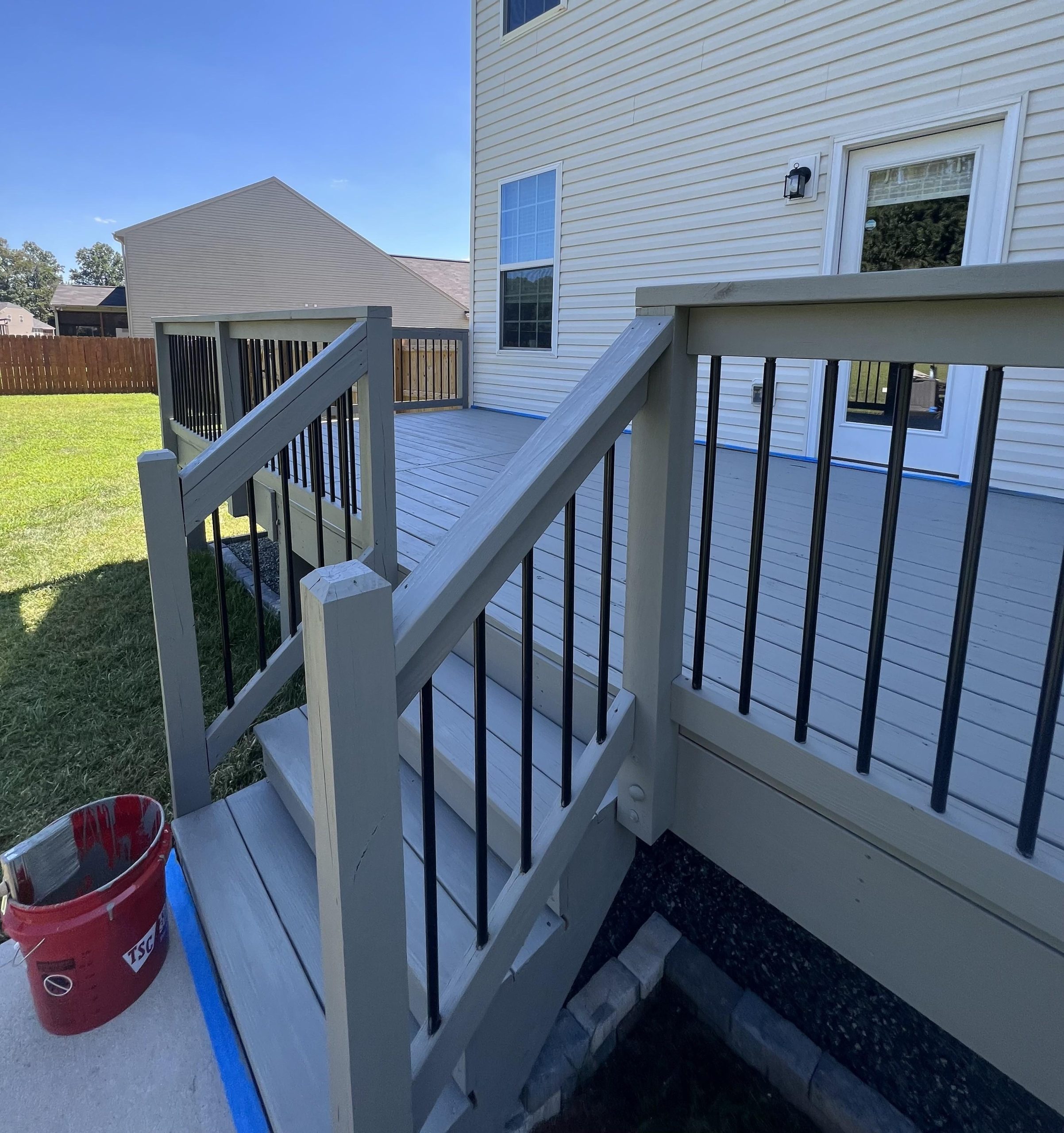

Jerry T
11 months ago
Finally was able to use the information you provided and it turned out fantastic!
Stripped the old deck and brightened and then brushed the solid stain (Coastal Gray)
Here are fished pics and thank you again for all your help!!
