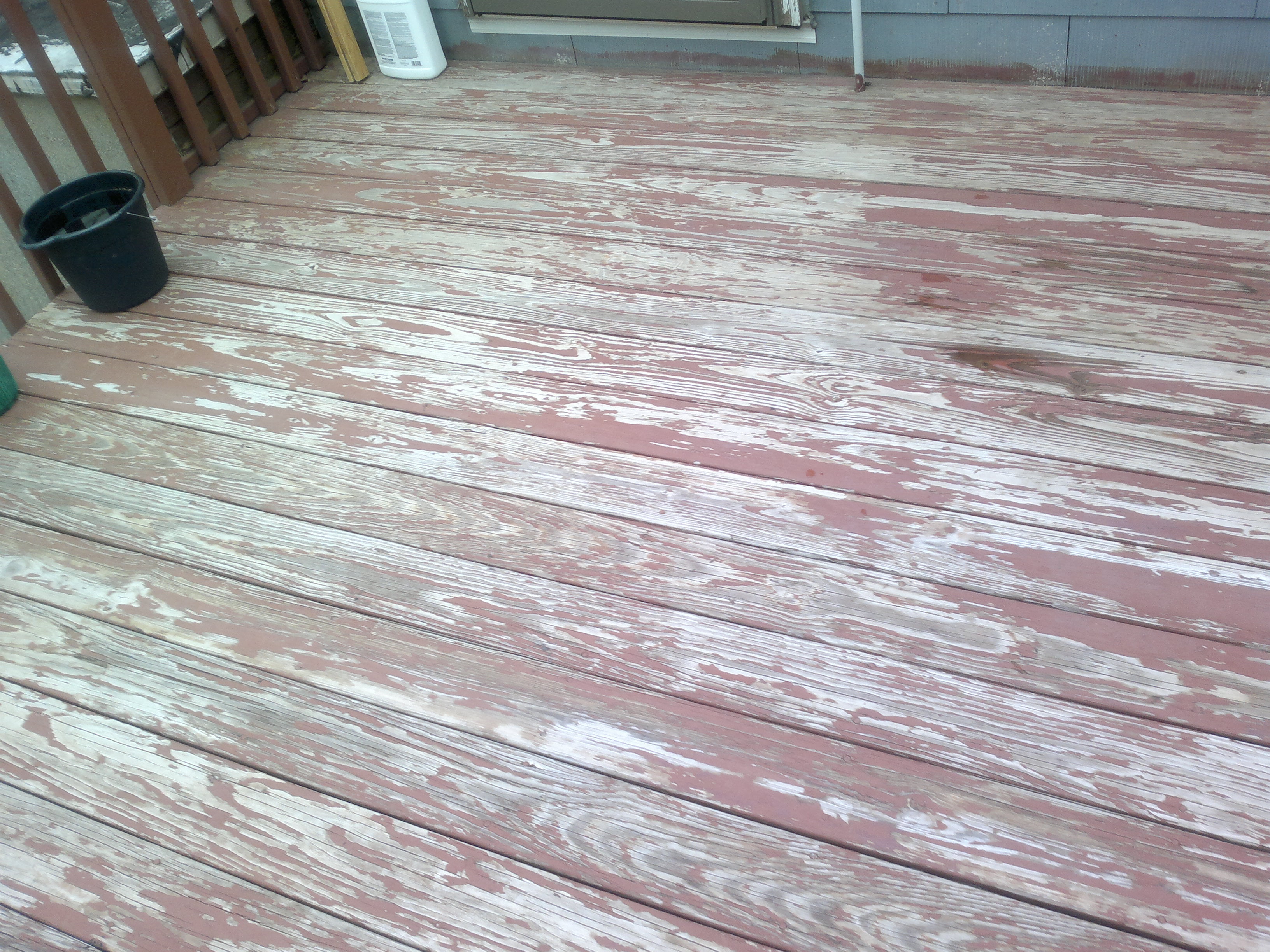

#1 Repair the Old Deck
Do a thorough look over for any rotten boards and replace them. Check for loose boards and railings and tighten these up as well with decking screws or galvanized nails. Check the foundation and decking supports for any structural damage.
My Pro Tip: Boards rot from the bottom up, so look under your deck for signs of wood rot.

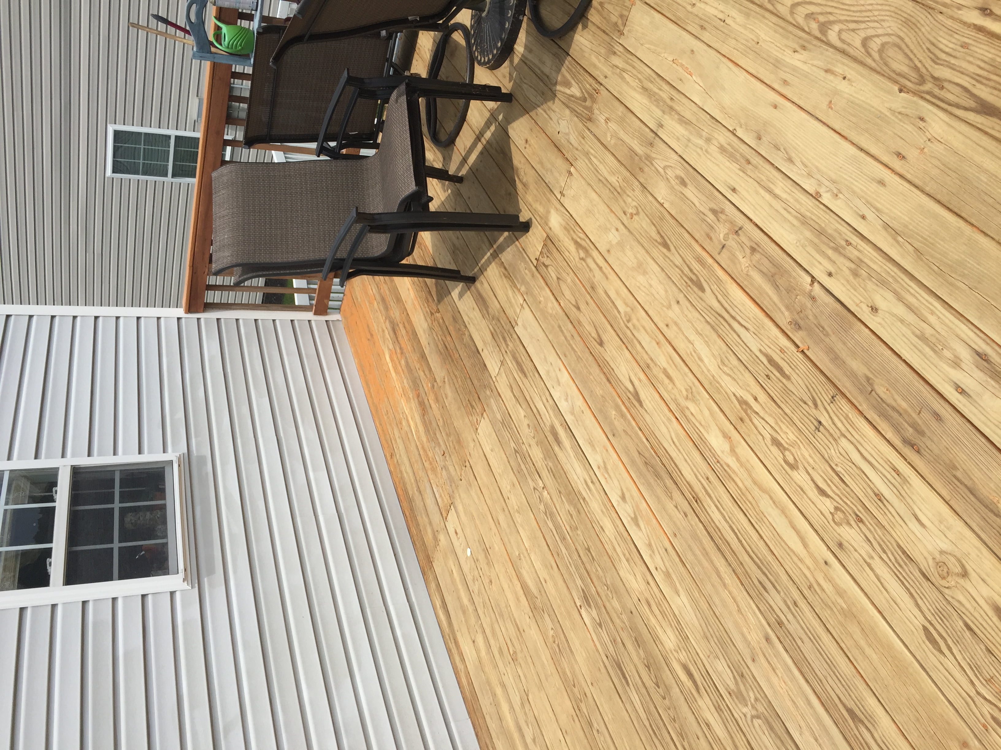

#2 Weather the New Deck Boards
If you replace any rotten deck boards with new smooth decking, they cannot be stained right after installation. The decking is not porous enough to accept the stain, which prevents the stain from properly penetrating the wood. Most stain manufacturers suggest waiting a few months for the new boards to season. See my new wood tips here: Staining a New Deck.
My Pro Tip: Ink stamps on new boards. Lightly hand sand those off before weathering the new wood.
#3 Prepping the Old Deck for Stain
There are 3 main options for prepping your old deck, and the current condition determines which direction to go in. If you are unsure, see this article for more info: Prepping a Wood Deck: Clean, Strip, or Sand.
✅ Prep Tips for Old Decks
  • Remove all failing coatings
  • Clean and brighten the wood
  • Replace severely damaged boards
  • Allow proper drying before staining
Clean and Brighten the Deck
My Pro Tip: Best When Removing Oxidation/Graying
It is not impossible to bring old gray wood back to life. A little care and maintenance can revive the most neglected decks. If the deck is still in good structural condition, the grayed wood can be cleaned using a wood deck cleaner.
Use a scrub brush or pressure washer with the deck cleaner to remove unwanted mold, mildew, dirt, and graying. The transformation of washing an old deck back to clean again can be amazing. After using a wood cleaner, it is important to use a wood brightener. While the wood is still wet, apply a wood brightener to the surface to enhance the wood’s beauty and open the wood pores for better stain penetration.
Strip and Brighten the Deck
My Pro Tip: Strip the deck if you have an old clear, transparent, or semi-transparent stain that has failed unevenly.
To remove old deck stains from the wood, you have to use a deck stripper. A quality deck stripper will break up and soften any old decking stain, allowing it to be washed away with a pressure washer. Once the deck has been prepped with a stripper and the old deck stain is gone, a wood brightener is necessary to brighten and neutrlaize the stripper, restoring the pH of the wood.

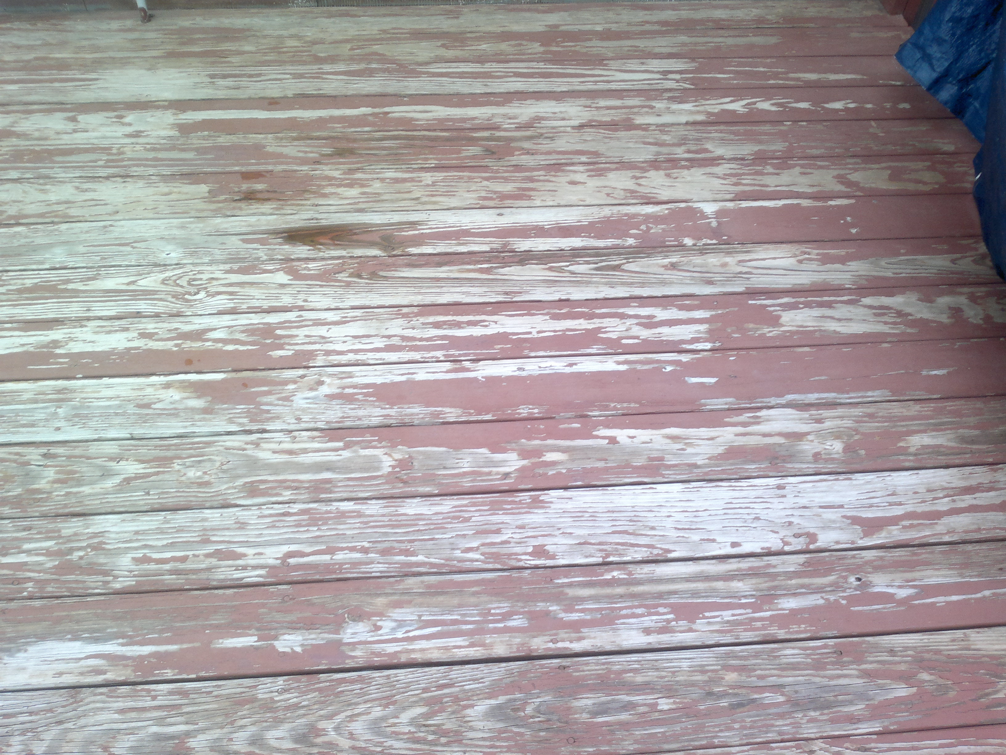

Sand The Deck
My Pro Tip: Sand the deck if trying to remove an old, peeling, solid color stain.
Most deck strippers will not remove solid stains or paints. If this is the case, you may have to sand the old stain to return to bare wood again. See these tips on deck sanding: How To Sand an Old Deck.
#4 Staining the Old Deck
Apply Penetrating Wood Stain
✅ Why Penetrating Stains Are Best for Old Decks
Penetrating stains absorb into the wood instead of sitting on the surface. This allows them to:
  • Avoid peeling and cracking
  • Wear naturally over time
  • Be easier to reapply
  • Handle older, more porous wood better
My Pro Tip: Choose a Semi-Solid Stain to hide imperfections in the old decking.
Once the deck dries, choose the best stain for an old deck. Because old wood decks are significantly dried out, a wood stain that conditions the wood is essential. We use stains like Armstrong Clark or TWP Wood Stains for an old deck. This type of wood stain contains non-drying penetrating oils that help rejuvenate the wood cells. These conditioning oils stay deep in the wood to replace the wood’s lost natural oils.
The stain also contains drying oils that separate from the conditioning oils. These drying oils remain on the exposed surface to cure locking in the conditioning oils and provide protection against weathering. This conditioning of the wood’s cellular structure and weather protection are the keys to reviving an older wood deck.

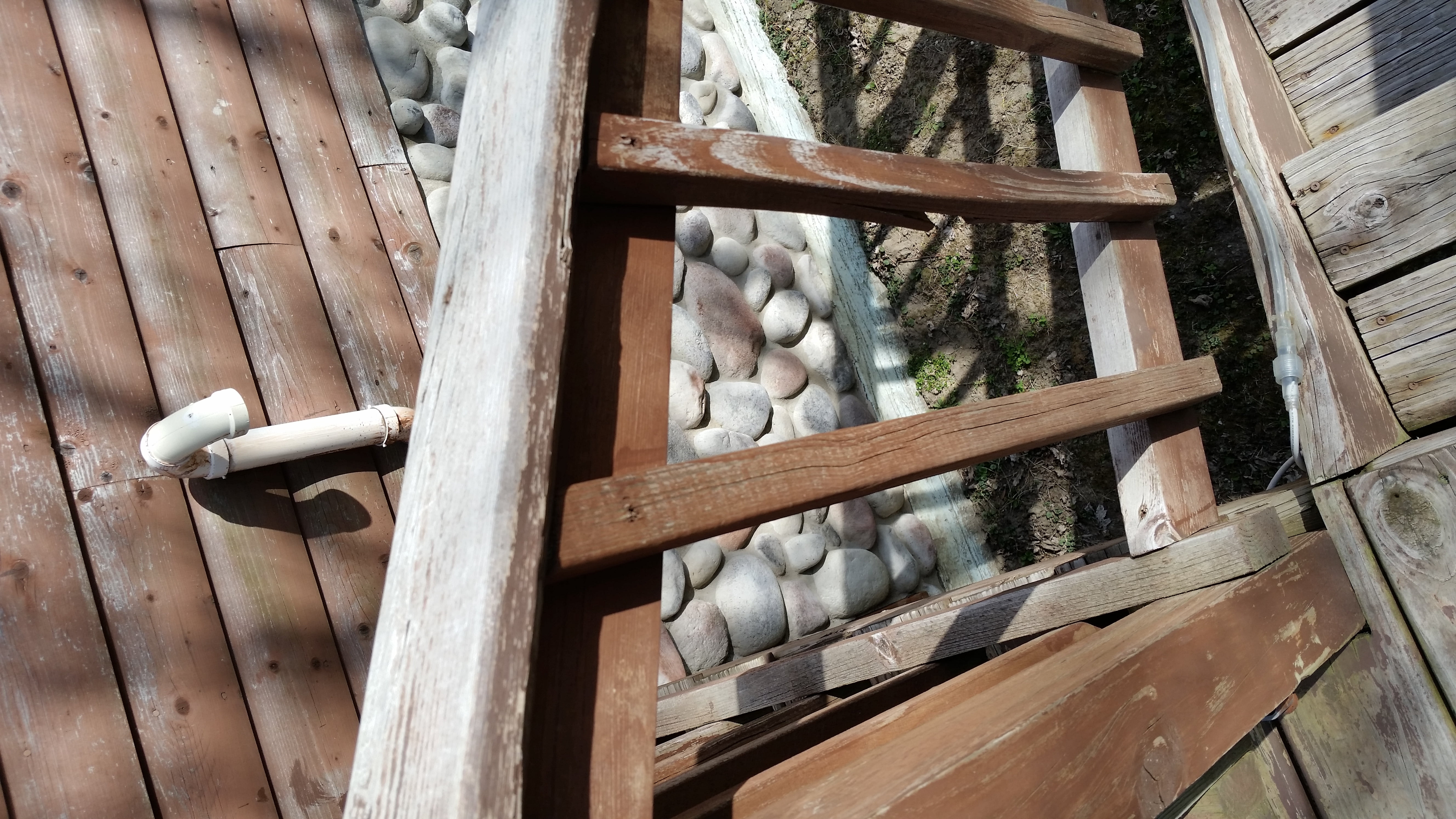

Restoring a 30+ yr old deck and 20 yr old railing/spindles, all redwood. In Colorado, part sun, part shade. So far just pressure washed – photos attached show before & after side by side, and railing + deck after. Deck still shows some wear, railing is better. What do you recommend for next steps and finishing coat(s)?

Hi Scott, I live on the west coast of Canada (lots of rain) and my vinyl-coated deck is 20 years old. My question has to do with under the deck. Although not directly exposed to rain, the dampness over the years has cause the wood to grey and become very weathered. What is the best stain to apply under the deck to extend its life. The joists are and plywood are still in decent shape.
Ian
Ian
We don’t have those brands in my Canadian city. We do have Minwax, Olympic, Behr, Varathane, Penofin and Watco. Any of these a good runner-up to your recommendation? {I prefer not to order online.} Thanks Scott.

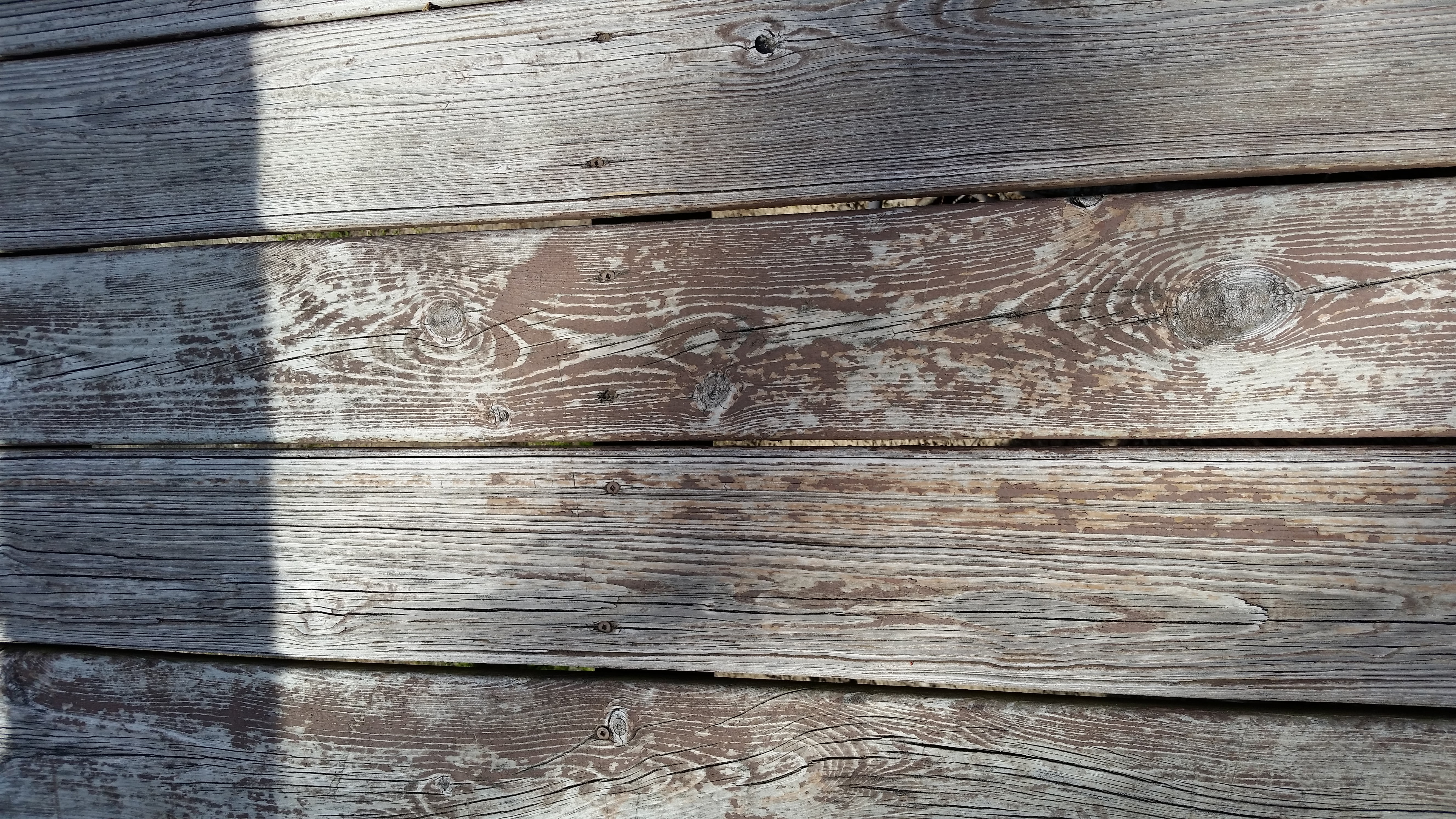

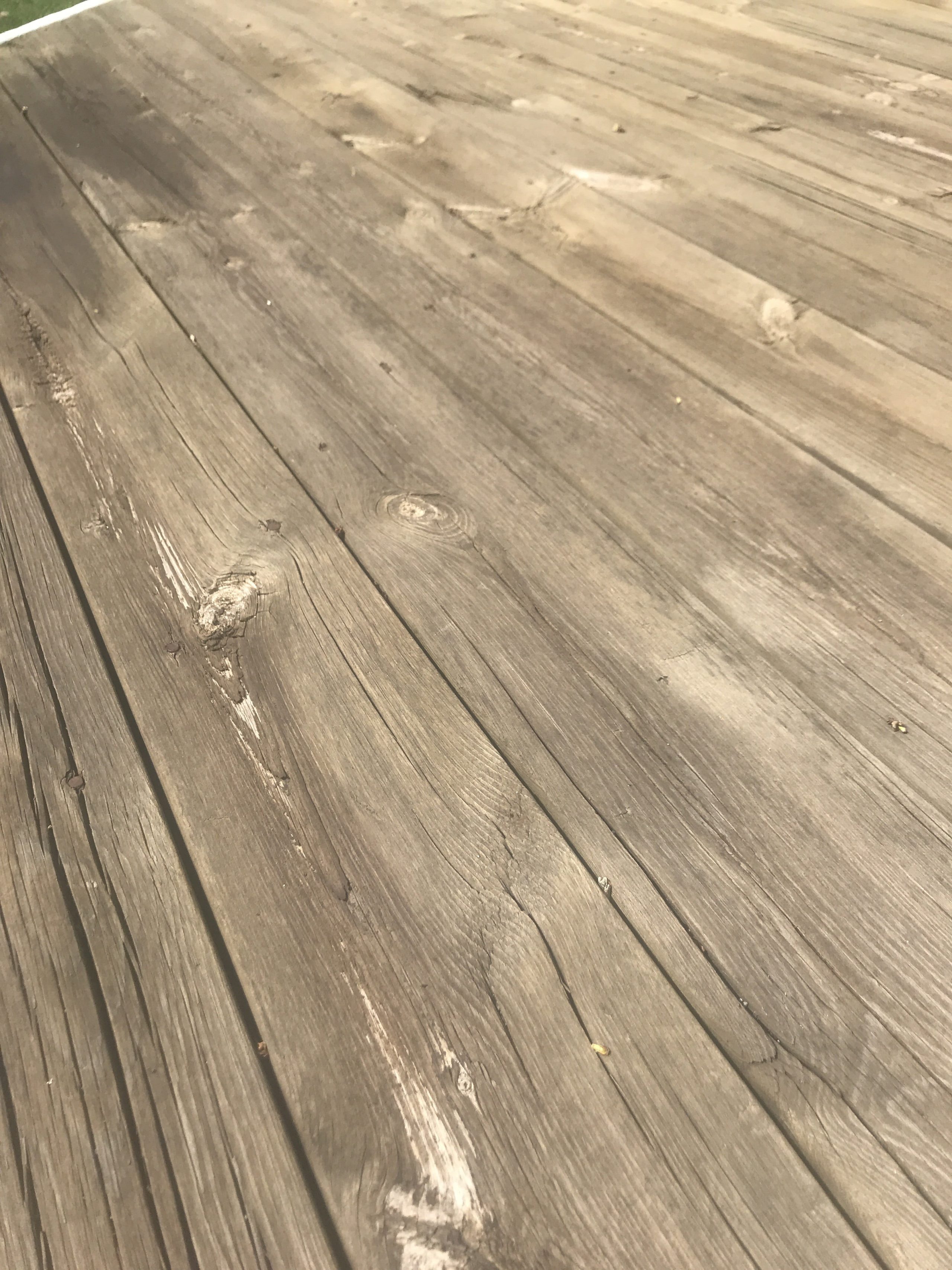

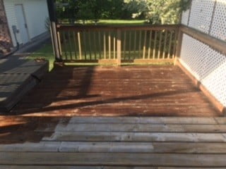

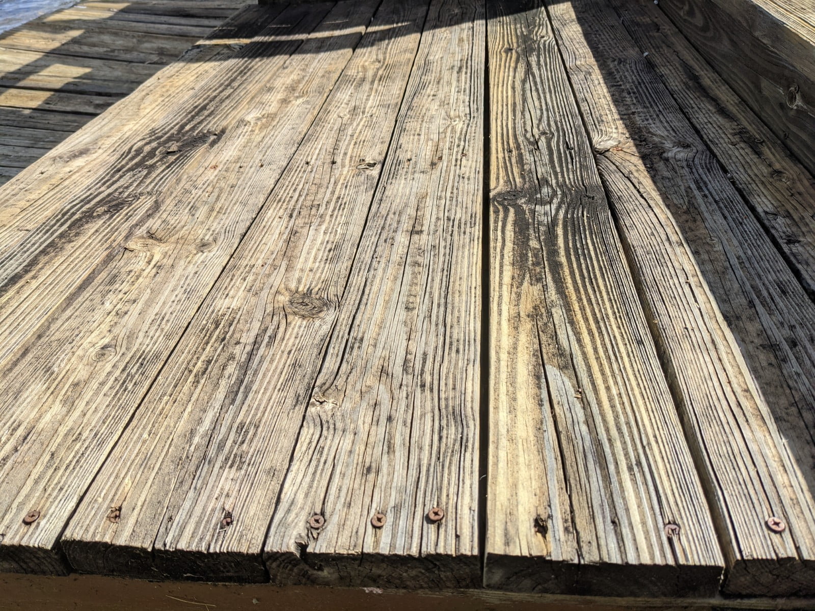

We have a 20-year old deck, half of which gets a lot of sun and half of which is mostly in the shade. The deck planks and handrails on the sunny side are showing some cracks, and the parts in the shade tend to get mildew. Deck was last stained in 2020 using Behr semi-transpartent stain and sealant penetrating oil (color 4629, chocolate). Am looking to re-stain this summer. Would like to use a stain that will protect the wood better than the Behr (in terms of water repelling and retaining color) and ideally not require the use of a stripper when reapplying moving forward. Am considering using Restore-A-Deck cleaner and brightener, followed by an Armstrong-Clark semi-transparent stain. Would I also need to use a stripper to remove the existing Behr penetrating oil stain? And do you think we’d be better off going with a semi-solid or even a solid stain, given the cracks? (If we use a solid stain, we’ll probably go with Restore-A-Deck solid in brown oak.) Thanks in advance for your advice and thanks for this forum. This information enables much more informed decision-making and subsequent headache avoidance.
Stuck in NE Ohio
Stuck in NE Ohio
Weird. I went through the motions of attaching a picture to my post. Let’s try again…
Stuck in NE Ohio
Stuck in NE Ohio
I reduced the resolution by 50%; I see it below the text field so presumably this resized picture will come through. Fingers crossed…
Stuck in NE Ohio
Stuck in NE Ohio
Got it – thanks! We’re considering a semi-transparent Armstrong-Clark or TWP 1500 stain. Do you think we’d be better off using a semi-solid or even a solid stain, given the cracks?
Stuck in NE Ohio
Stuck in NE Ohio
Thanks again. Much appreciated!

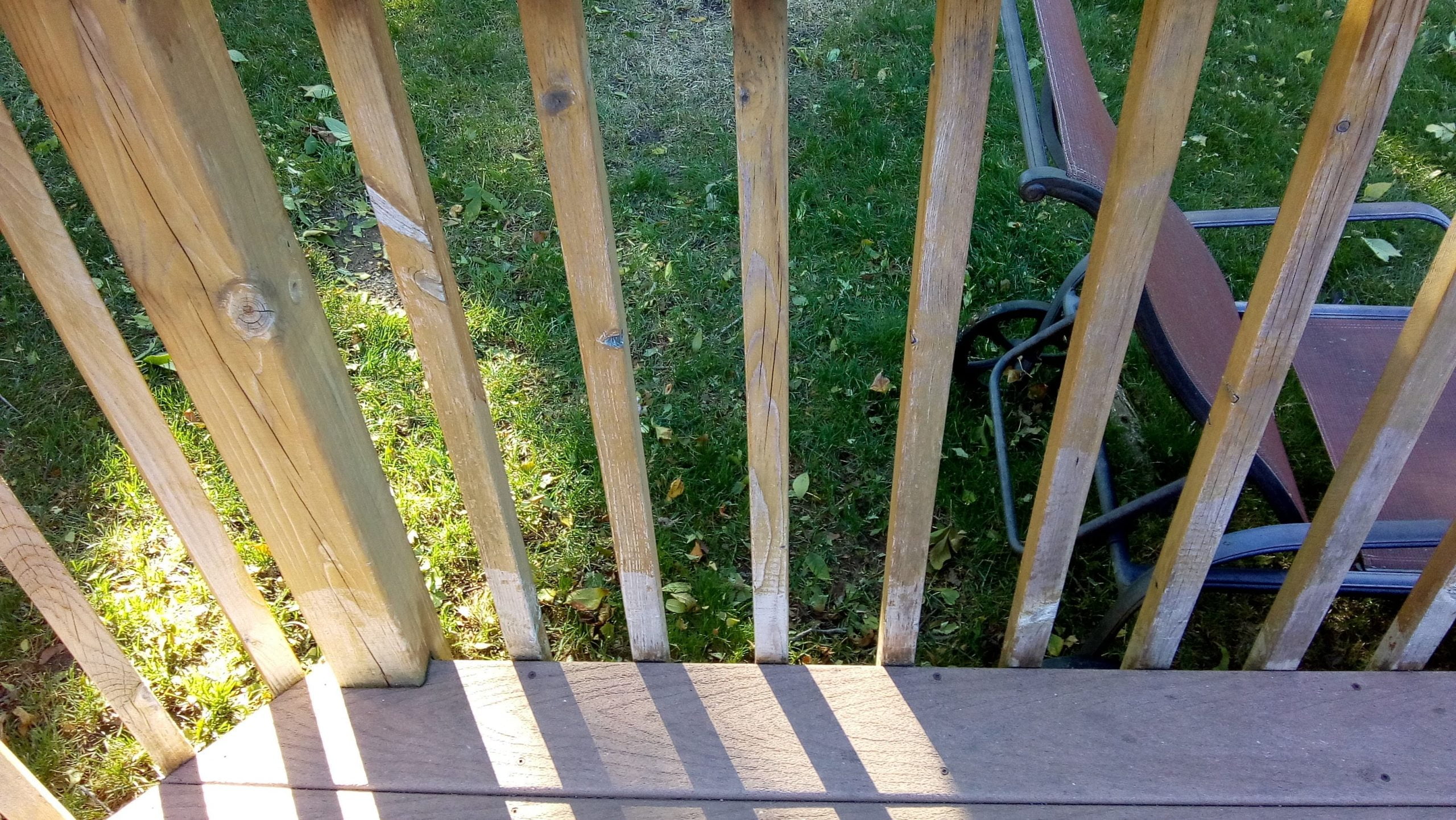

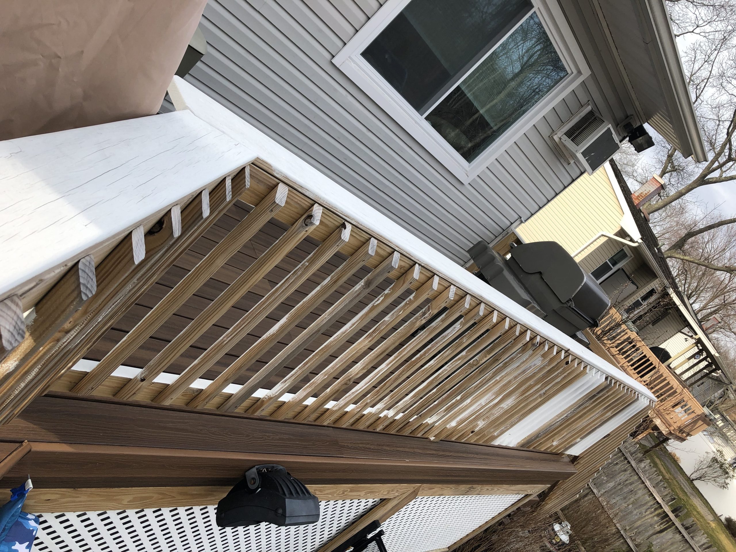

Photo for review.
Helen Margaret Jack
Helen Margaret Jack
I have a 15 year old trex deck with wooden spindles. Spindles stained once about 13 years ago. Now some peeling and cracking in the larger pieces. What should I do?

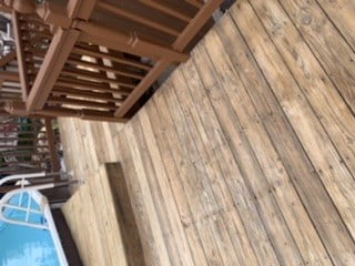

Photos
Fares

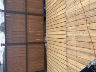

Fares
Hi our deck is around 15 years old however we added an extension 3 years ago and the deck was painted. This year we decided to sand it down and instead stain the deck, however we found some rotten planks which we replaced. We stained the rails semi solid chestnut color, originally wanting to have the floor lighter but we can’t decide on a color because my house siding is white. Could u recommend a good stain color type and brand. I appreciate the help thank you very much for your time.

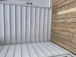

Jacqui
Jacqui
Reply to  Jacqui
Photos as requested

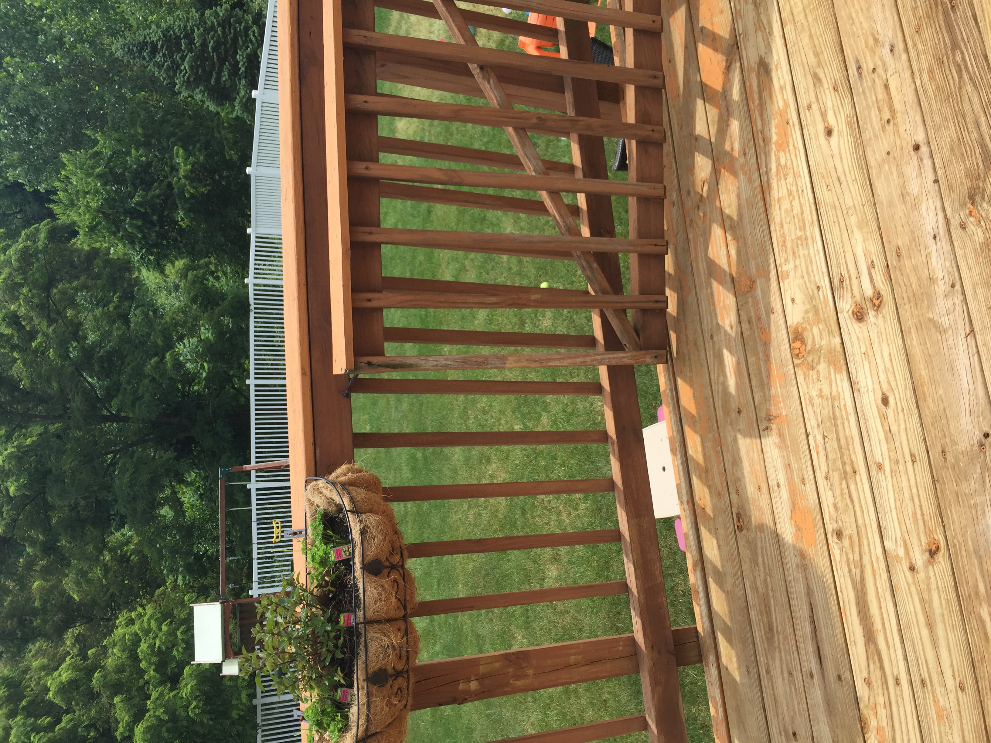

Ann

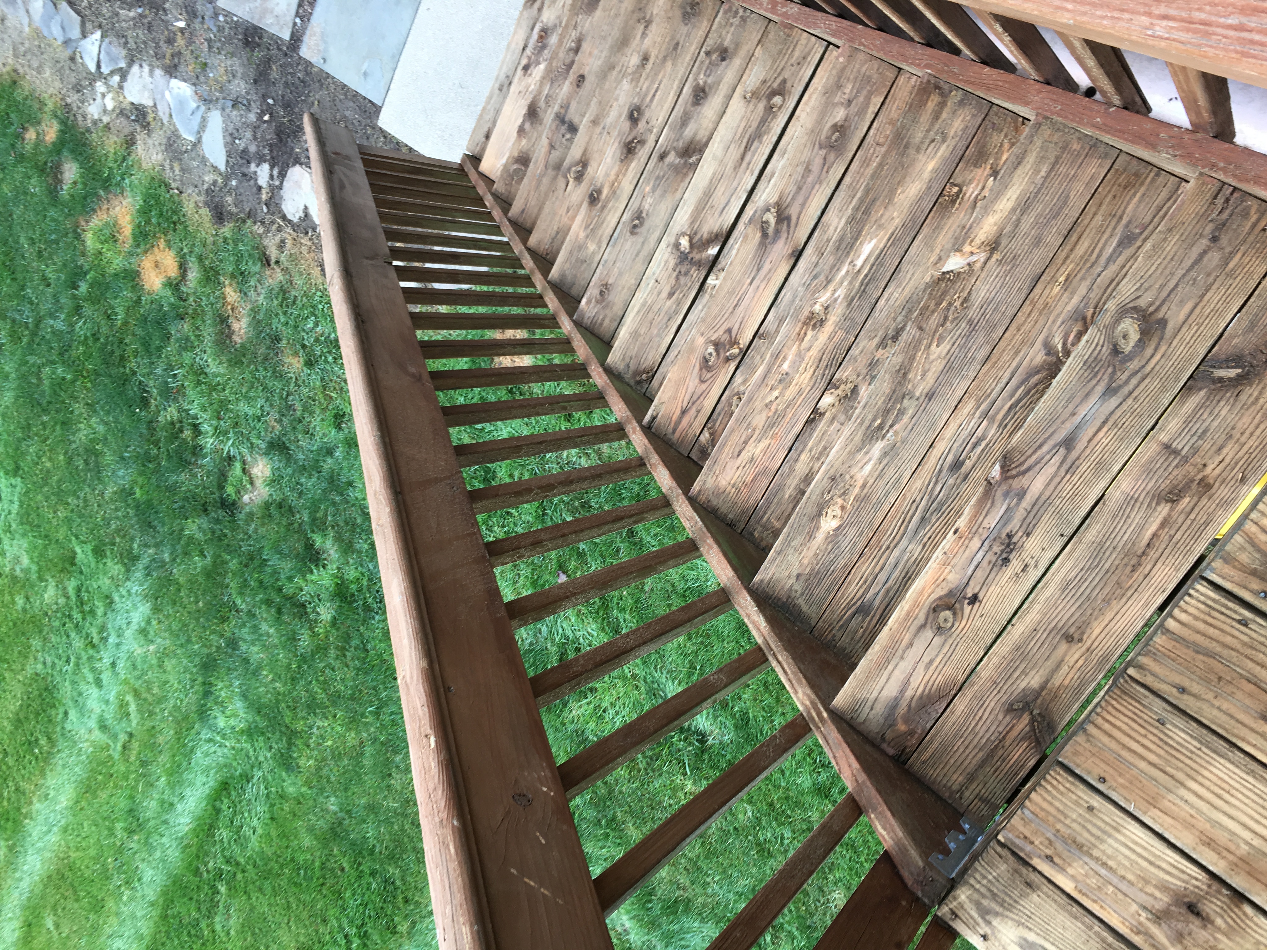

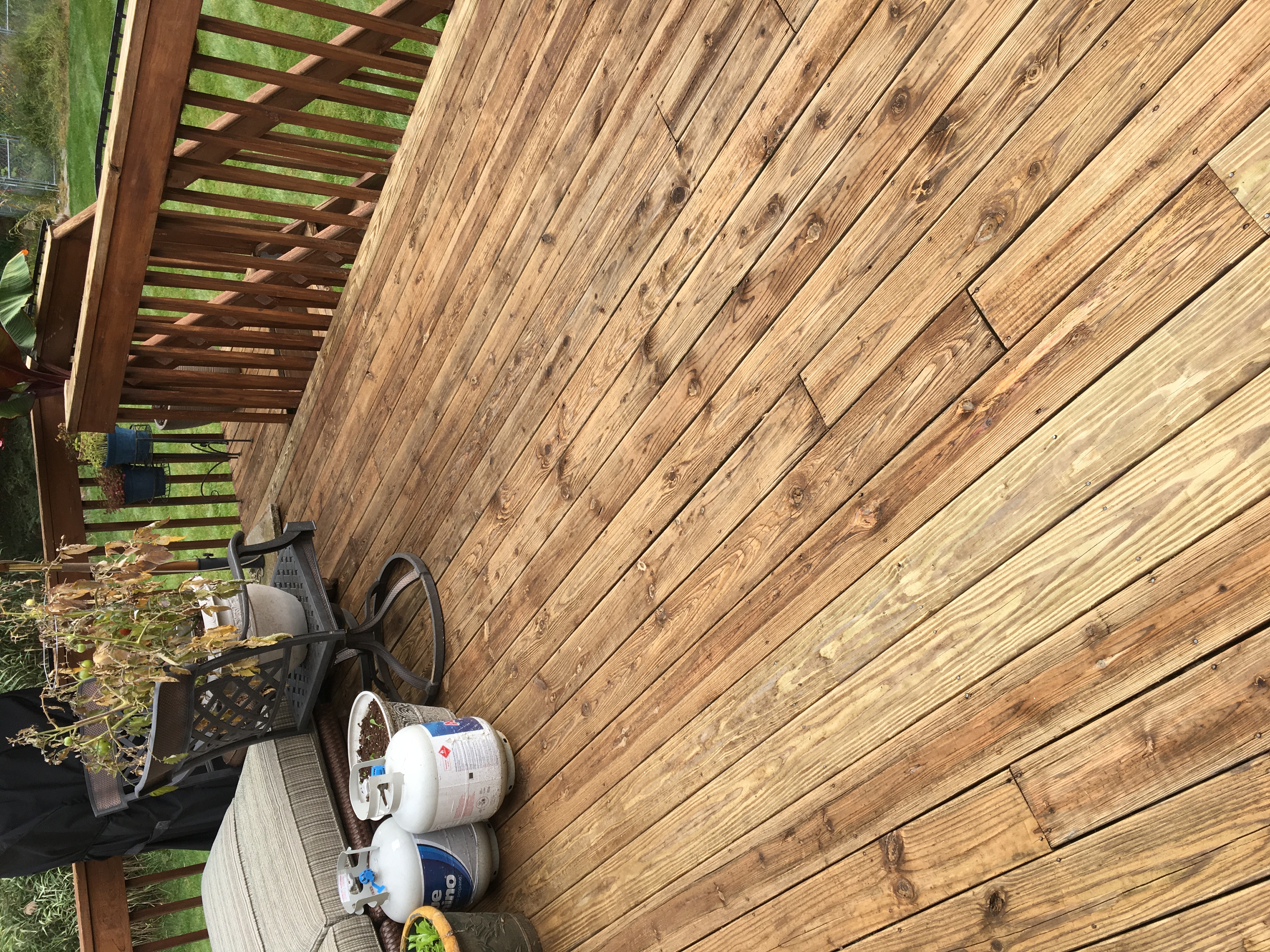

Our deck is about 24 years old. We refinished it in 2012 but can’t remember (and kept no record!) of the product used. Based on pics taken during that application I’d guess it was a semi-solid, and the color is fairly dark.
My husband just power washed the entire deck and railings, with better success on the deck floor than the verticals in removing the previous finish. I’d prefer to go with a lighter / medium color this time, and am ok with some of the darker previous stain showing thru.
I rather impulsively bought TWP 100 Cedartone after reading lots of great reviews and comments here. Was that a mistake?
The power wash, done with water only, also raised the grain a fair amount.
How would you suggest we proceed: 1) since we don’t know what the previous product was; 2) in terms of the color change; and 3) given the roughed up grain?
After pressure washing, there is still a lot of old stain left on railings. Does this need to be stripped off before using your products? Do I have to mask around deck to protect siding, doors, etc. or is it washable?

We recently moved in to a house with an old deck (assume 20+ years?). The deck looked unfinished and had many splits and a few damaged planks. I sealed the larger splits with polyurethane and replaced the damaged planks. A year later, I stained it with a solid-color stain using a sprayer. Looked great. A year after that, most of the stain starting flaking off. I wanted to start over so I quickly (one-pass) power washed off the remaining stain, though some bits did not easily come off. (Please see attached pictures, to see the deck in this current state).
My question now is: can I re-apply solid-stain without removing the little bits currently on the wood? Also, I have not cleaned the deck with any chemicals (I imagine I’ll have to fully remove all stain before I attempt to clean?) I plan on applying the stain with a brush/roller instead of a sprayer this year- hopefully that will achieve better results?

After wood cleaner & brightener, is there a good CLEAR stain I can use? This is for exterior redwood shelf that I have sanded…but it still shows gray lines in it. Thanks!
Gayle Whitehead
Gayle Whitehead
OK…pics below of how redwood counter looked after built & sealed May 2018, last week looked gray, then I sanded, but still have light gray stripes. Good and smooth…do I have to use BOTH the Defy Wood Cleaner and Brightener..or, can I just use the Cleaner? Then which brand of sealer or stain should I use?
Thanks sooo much!

James S
Sorry about posting incorrectly below.
This is where I need help. I have an old weathered deck in good condition. I have power washed it. It appears it has not been stained previously. It is treated wood about 12 yers old. I want to apply a solid stain. The paints store has recommended I apply Fresh Start, a sealer prior to applying the stain.
Anybody have an opinion on this approach? What about using a brightener too?
Thanks for any thoughts on this project.

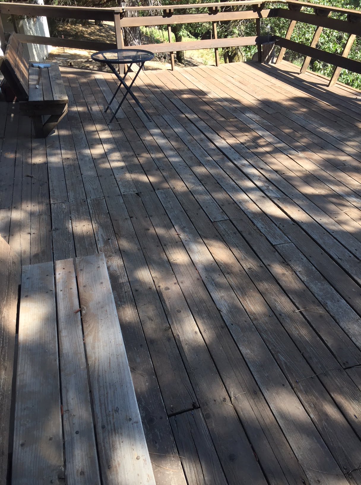

I just bought a cabin in Crestline, CA with an apparently 30 year old deck. The owner who owned it 5 years ago (he lives down the street) said he used to use Superdeck 1906 oil based stain, but after reading the reviews I’m going to go with something else. There’s extreme weather as it’s on a really windy ridge that gets snow, rain, and sun. Any recommendations? It’s redwood and brown in color but pretty faded. It seems the owner of the last 4 years didn’t do anything with it. I’m leaning towards the TWP 500 or 1500, but I’m wondering if a semi-solid Armstrong clark would be better to cover up the battered quality of the wood. Any input appreciated!

Also why is the treated decking rotting? Is it the chlorine? We have tried a couple different stains and they just peel off. We have replaced 3 boards and think we should sand it all and then restain but don’t know what is the best thing to use.
Amy
Amy
Our old deck is our pool deck so it gets wet a lot and with chlorine. What is the best kind of stain or pain to use?
