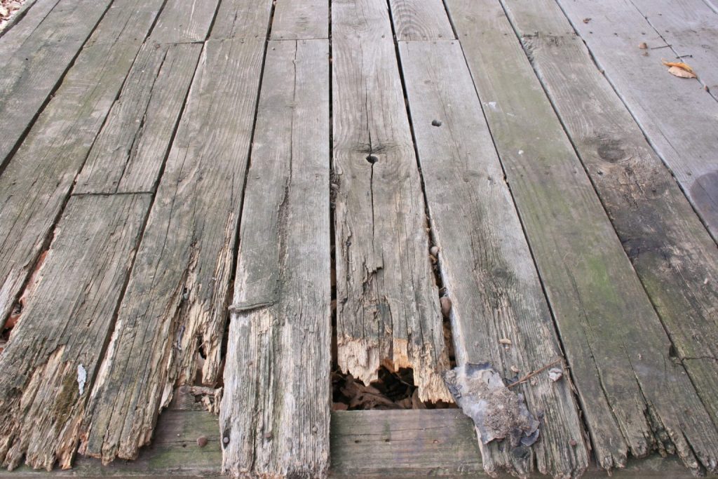

Sun Damaged Decking
Sun Damaged Decking

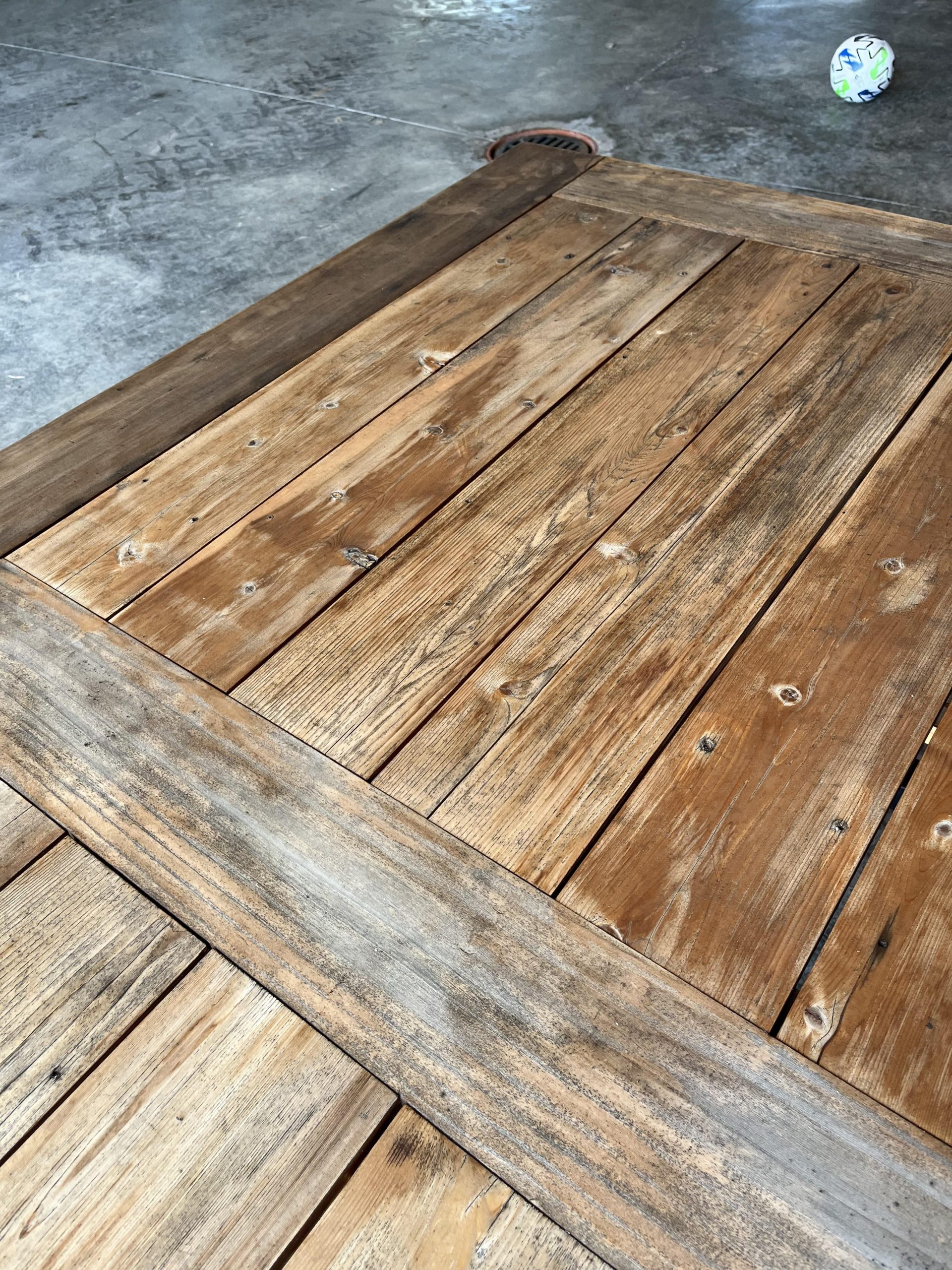

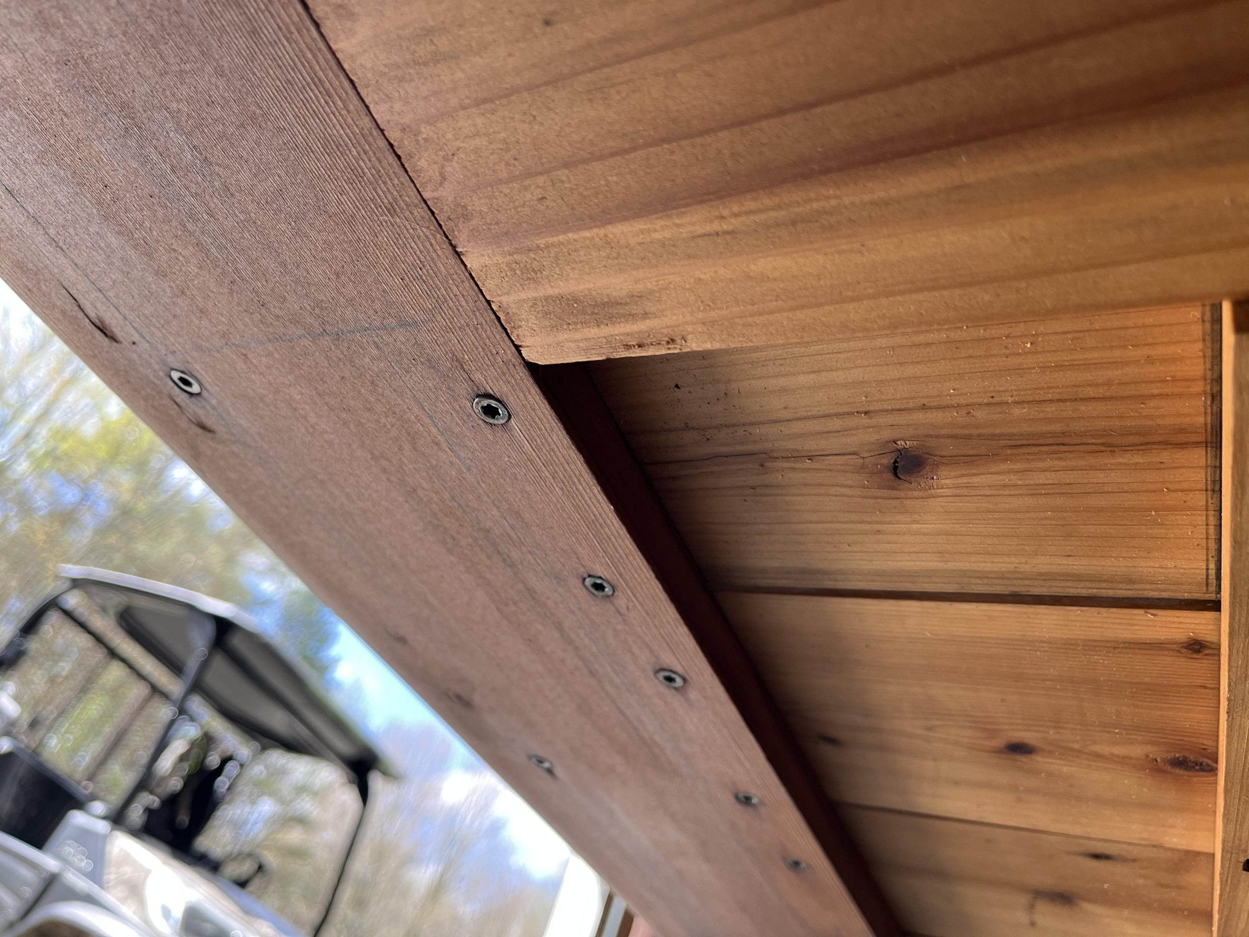

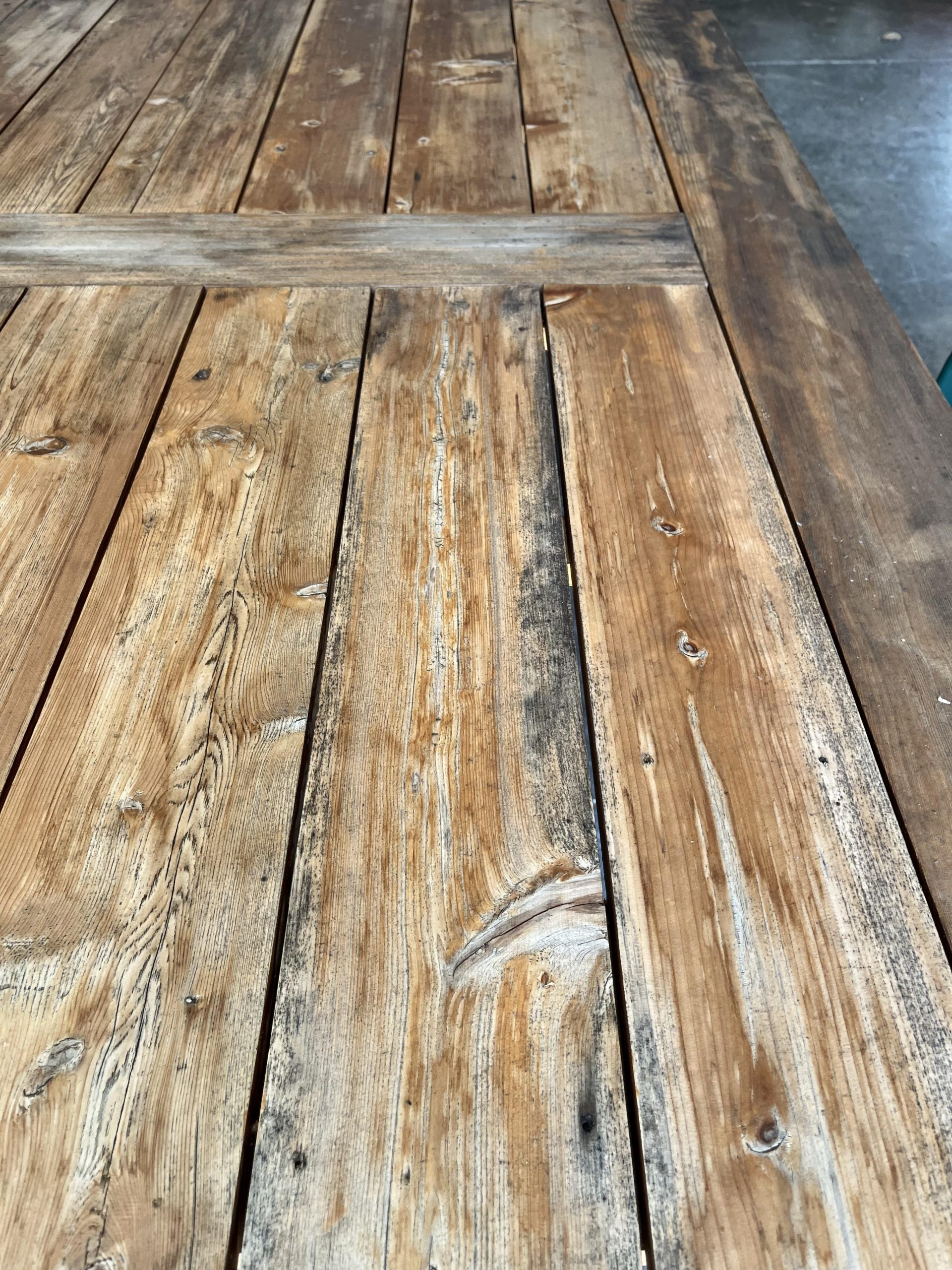

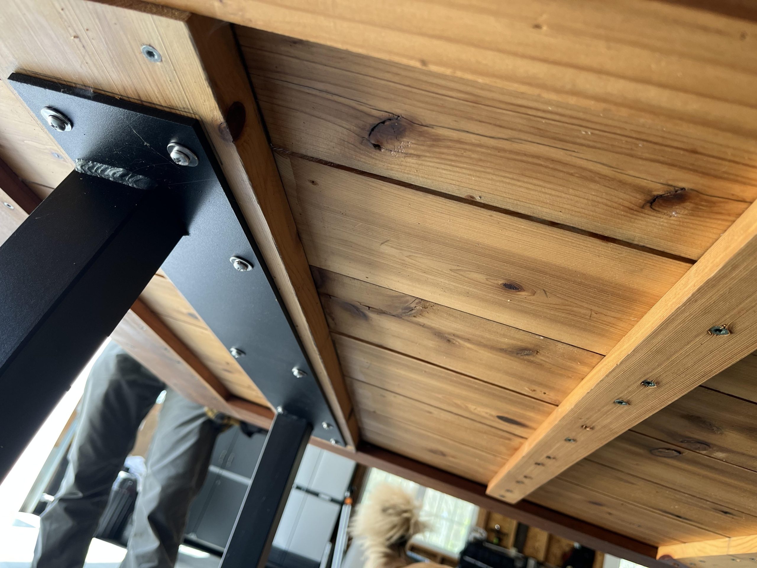

Question, We repurposed an old cedar fence into a outdoor table top. It was plained down and sanded to fresh wood. sat in our covered barn for a yr. I used Flood UV clear on all sides, table sits in a lot of sun and did not make it for a season. Bottom looks perfect. Top is weathered, gray and looks spotty. What should I do? I have heard to use a darker color and that would cover the ugly –
Megan
Megan
6 months ago
the first two are the bottom of the table with Flood UV clear and the last two are what the top of the table looks like. Flood told me to due a water test and if it is still water proof then pick a darker color apply another coat. I just don’t want this to keep happening. Maybe we just make a new table top with different wood.

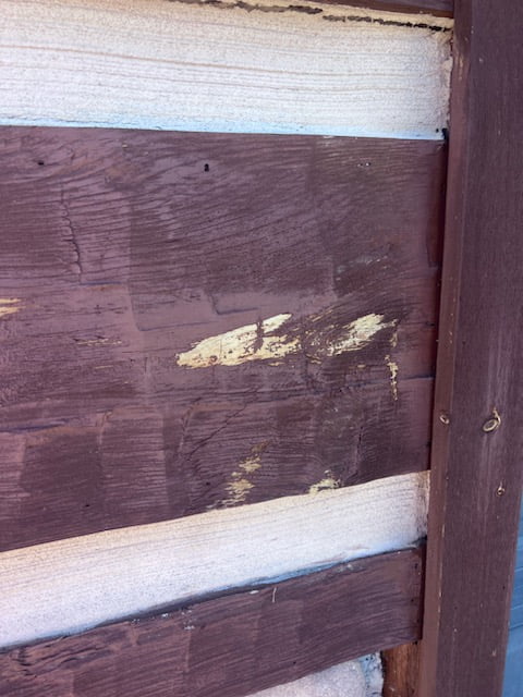

What product should I use to re-cover wooden railings in direct sun year round that are badly peeled after first transparent stain and then solid stain? The vertical posts are holding the solid stain fine, but the horizontal surfaces peel badly.
Sandra Wood Forand
Sandra Wood Forand
Here’s the peeling solid stain on drying wood two years after application.
