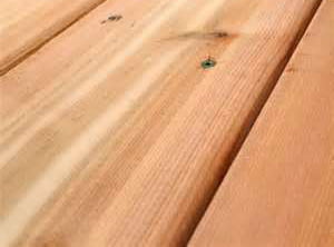

Are you trying to find the best cedar wood and decking stain? Here are a few things to consider when comparing options and how to stain your brand-new cedar.
  1. Weather the Cedar Wood
  2. Prepping New Cedar Wood
  3. Is your Cedar Rough-Sawn
  4. Choose a Penetrating Wood Stain
  5. Compare Best Cedar Stain

1. Weather the New Cedar Deck
Many types of cedar are used for exterior surfaces, with Red Cedar being the most common. We recommend waiting 3+ months to stain new smooth cedar wood surfaces to allow the wood to weather, creating an ideal porous surface that will hold the stain better. (Always follow the stain brand’s directions, though.) After the weathering, all new cedar wood should be cleaned and brightened for the prep. This will remove any oxidation and mill glaze.

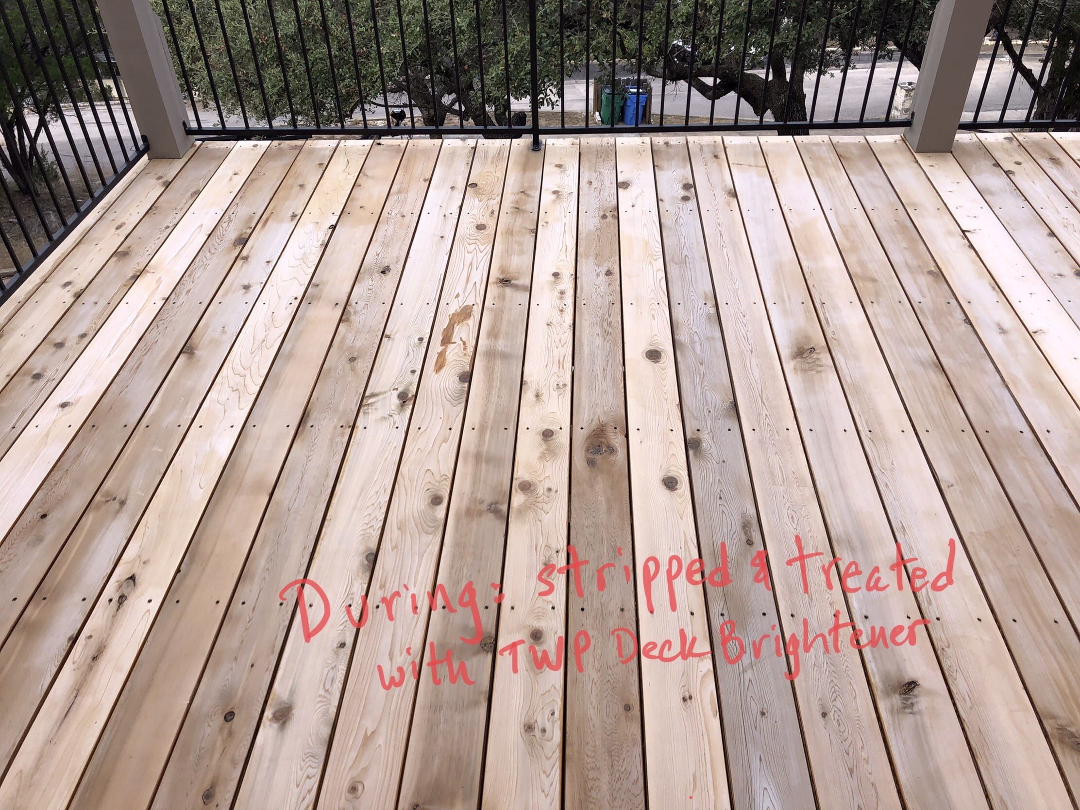

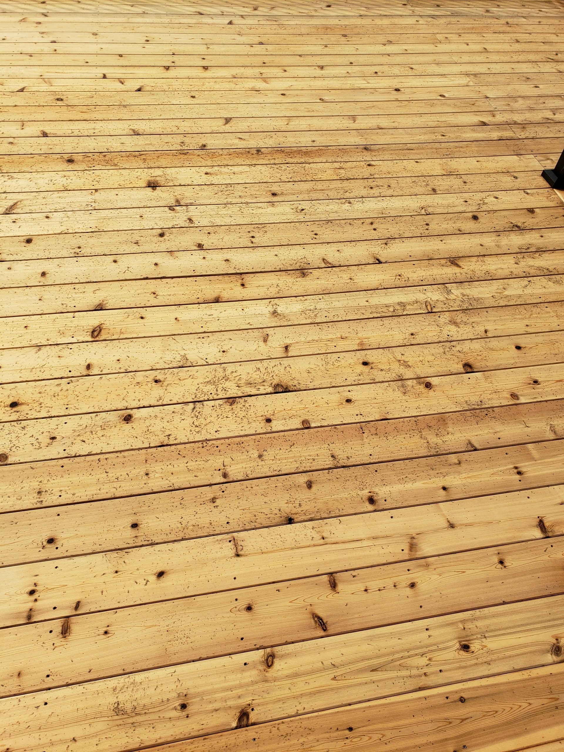

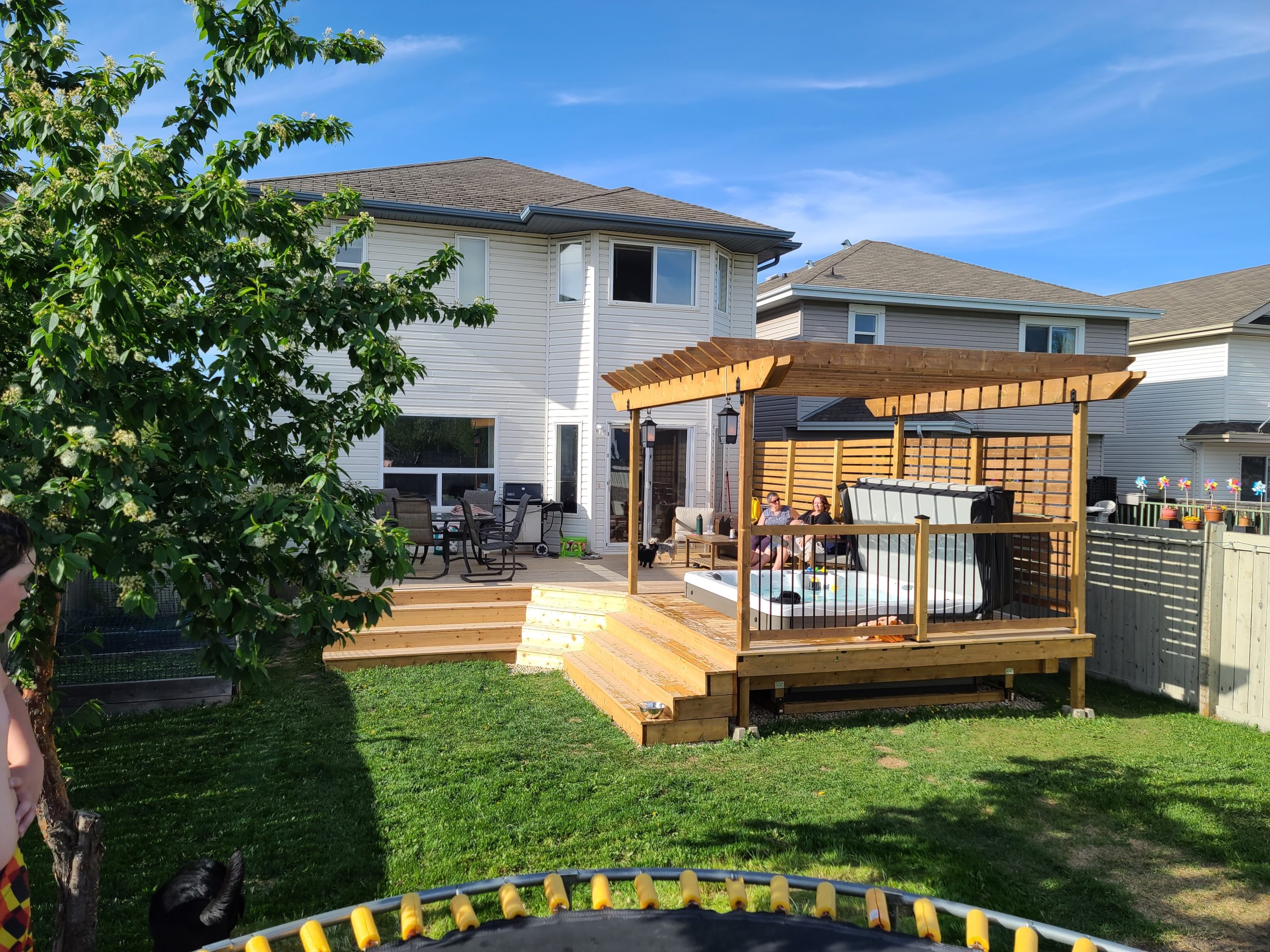

I finished my project a few weeks ago and am very happy with the results. Here are several pictures, some before, during and post project. The deck was originally completed with Sherwin Williams Super Deck oil based transparent (Natural). The contractor sanded too fine, likely resulting in the poor adhesion. To fix this I sanded back to bare wood, allowed to weather for 60 days, pressure washed, then conditioned with TWP 2 step deck brightener. Then stained with TWP 1101 oil based cedar tone, spraying on first coat, then used pad applicator to place second coat before first coat dried. The deck was allowed to dry for 8 days before stepping on it (not intentional, just happened to be away).
Chuck
Chuck
I thought I had with the comment but appears they were not accepted. Any limit on size or number of pictures?
DSH
DSH
Testing pic
Chuck
Chuck
Reply to  Chuck
Here are some pictures, before, during, and after
