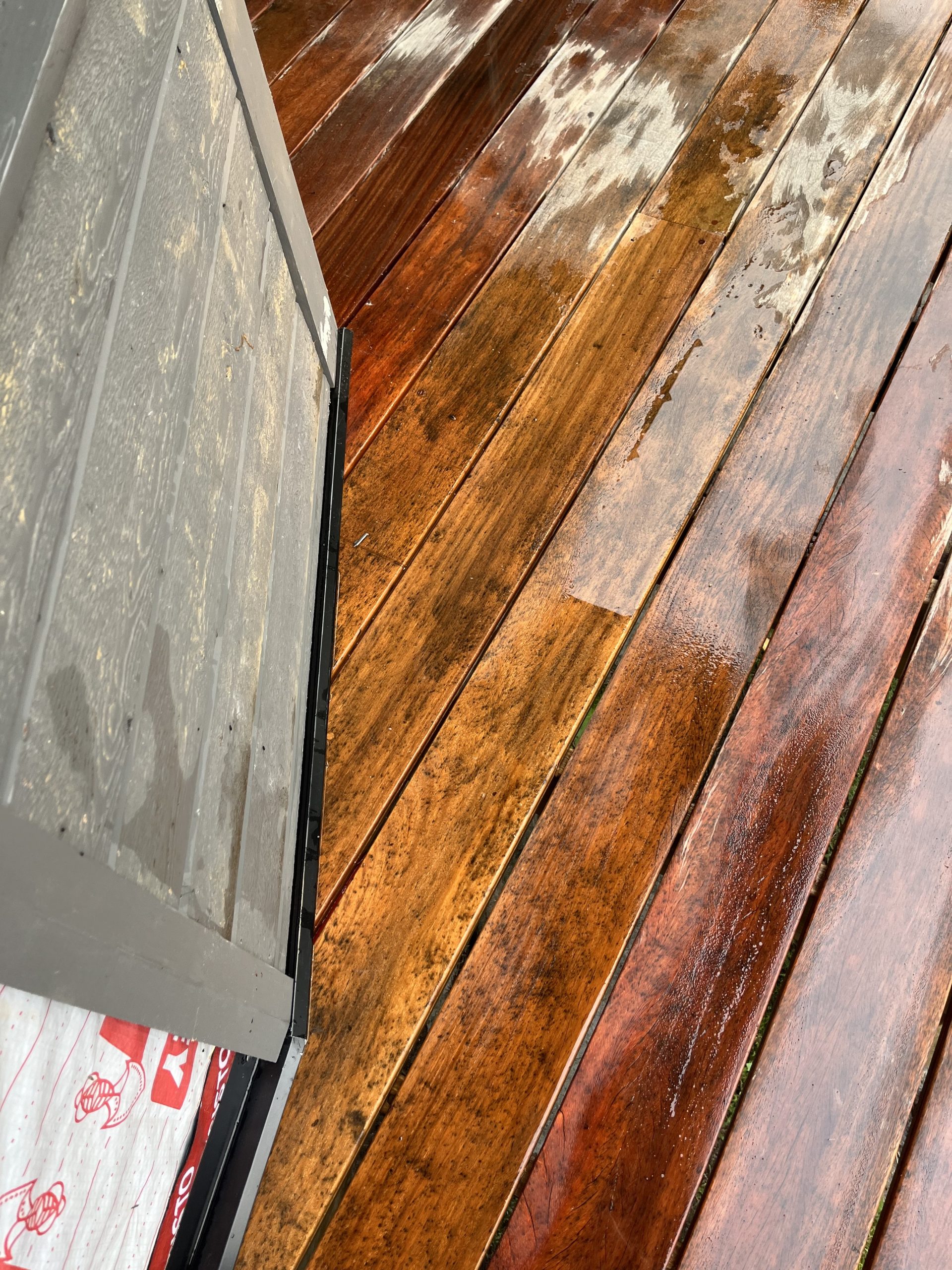

Geordon
Geordon
Scott,

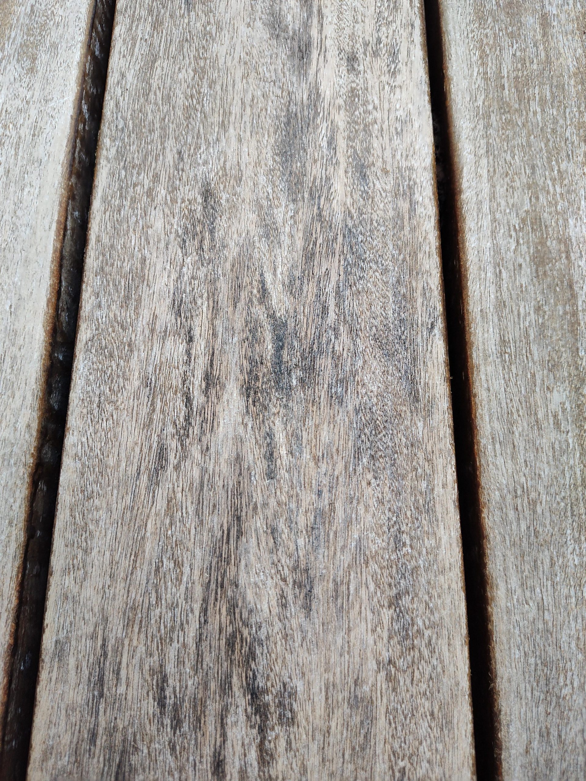

I have an older Garapa deck (Brazilian hardwood like IPE), which has been stained every few years with TWP 100. Yesterday, I lightly wet the deck and performed Step-1 Strip then followed with a Brightener. After each spray application, I agitated the solution with a deck brush, let dwell, then pressure washed to rinse off. The attached pictures were taken the following morning. I still have large areas of black mold present where rain water tends to dwell over the years. When wet, they become very unsightly.
What do you recommend for a deeper root mold kill before applying a new coat of TWP? Should I be using different products?
IMG_20241021_091105574
IMG_20241021_091122069
IMG_20241021_091135601
Geordon
Geordon
I apply 50/50 TWP 110 and 115 (Honey and Pecan). Never had a dark stain on the wood. I will try the bleach. Thanks.
Geordon
Geordon
Scott,
The darker spots are definitely not old stain and the bleach treatment helped. When the boards are wet, I do see old stain which did not get stripped off. I should have provided wet images, as well. Looks like I will need a second application of #1 RAD stripper. I probably didn’t get good enough coverage the first time or I had heavier build ups in spots.
I guess deck staining is like painting — a successful finish depends mostly on good prep work. Thanks, again for your review.

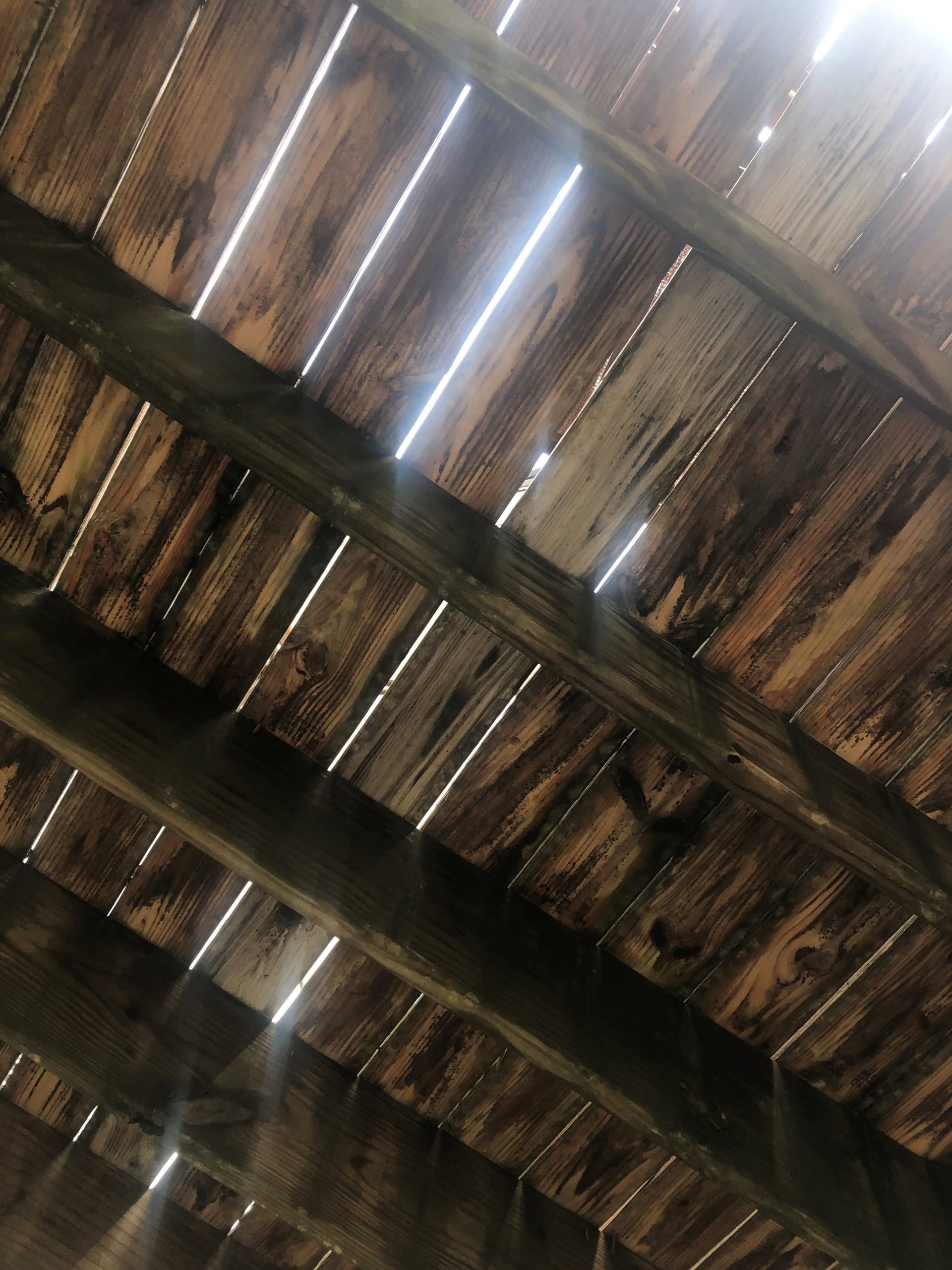

andre kempe
andre kempe

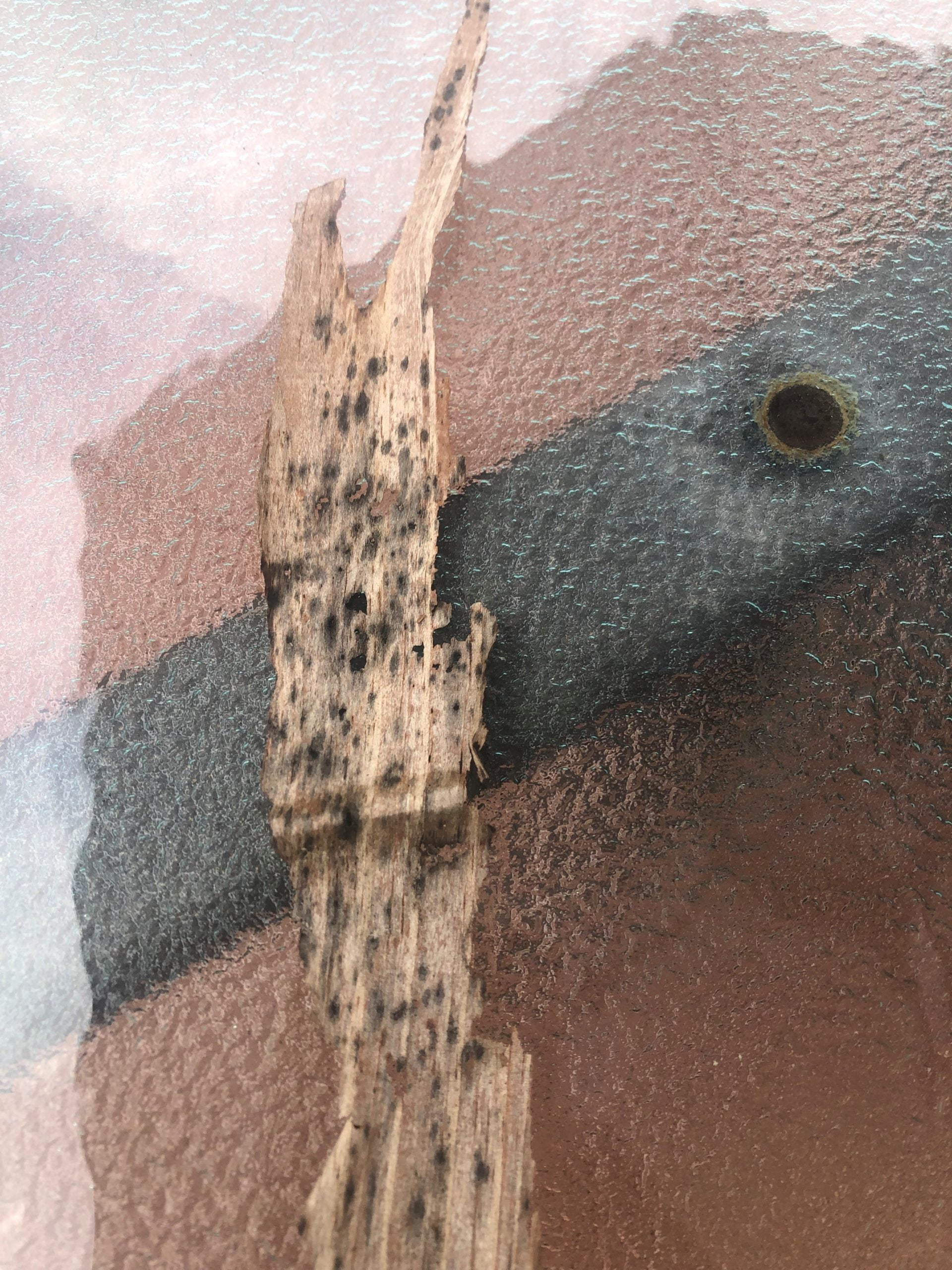

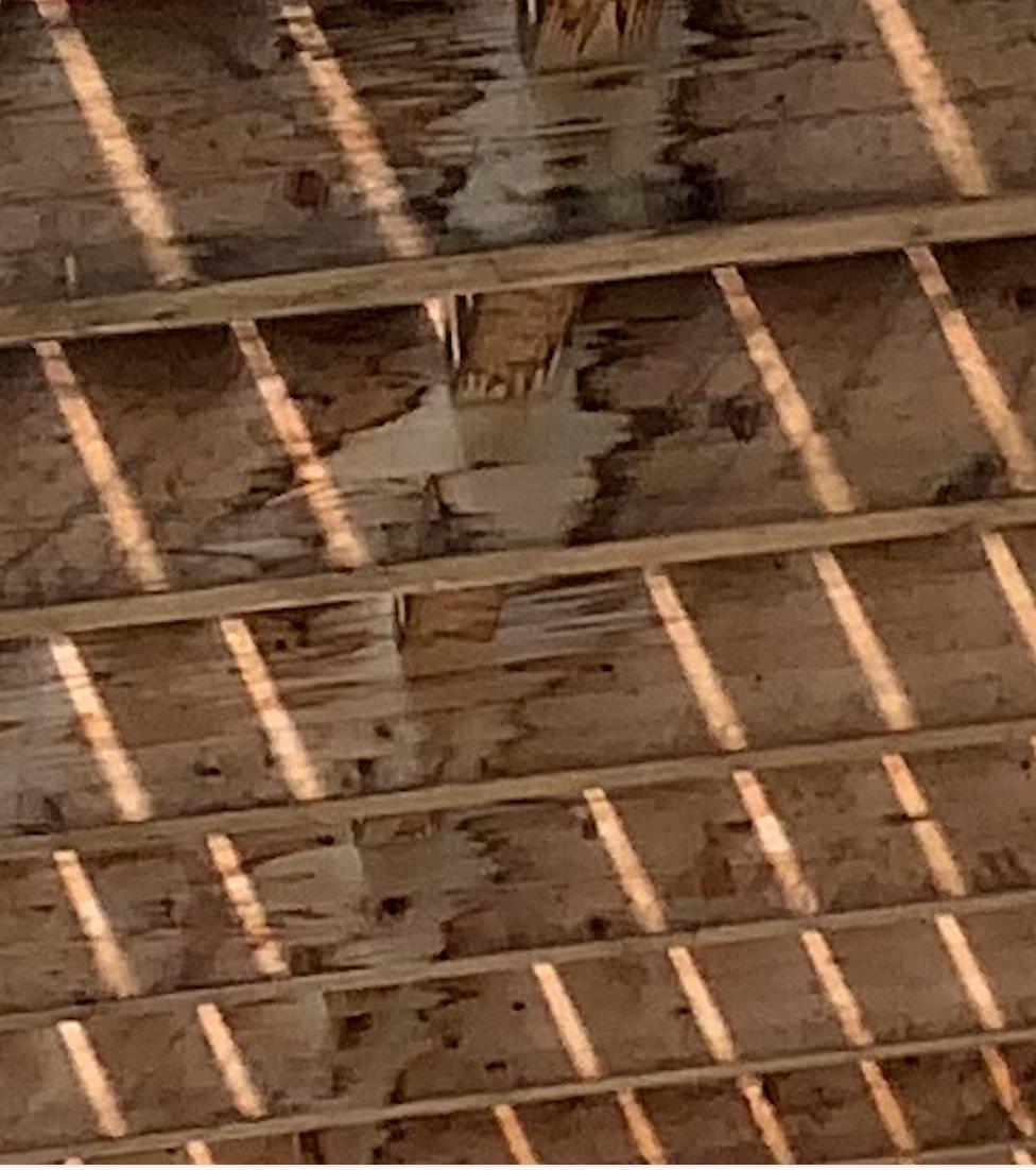

Hi Scott, thank you in advance for your kind help..
We have a large roof with a spruce or jaw wood construction not impregnated in any way. There are glass panels covering the wood blocking evaporation. The condense water creates wash out and dark brown streaks where it floats off.
I am seeking a method to clean the steaks and protect the wood afterwards.
andre
Xnip2024-08-11_18-38-42
IMG_0575
andre kempe
andre kempe
Hello Scott, thanks a lot for your professional view on this. If i cannot prevent the wash out process in the wood – should the beams be coated at all? I want to prevent structural damage. But since we have to accept the patina – would it be better to leave the beams untreated?

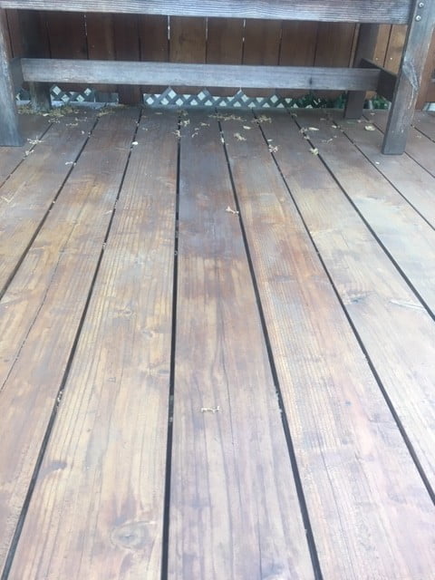

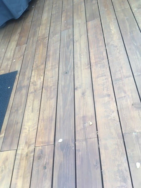

Getting ready to stain a patio deck for the first time in way too many years (we just moved into the house in Colorado). Part of the deck is open to the elements and part is under a balcony. We pressure washed it all and the open area did fine. The area under the balcony however has water stains from the pressure washing (less than 24 hours old). This part of the deck always “stains” when it gets water on it. How do you recommend we clear them up before we stain the deck? Thanks.

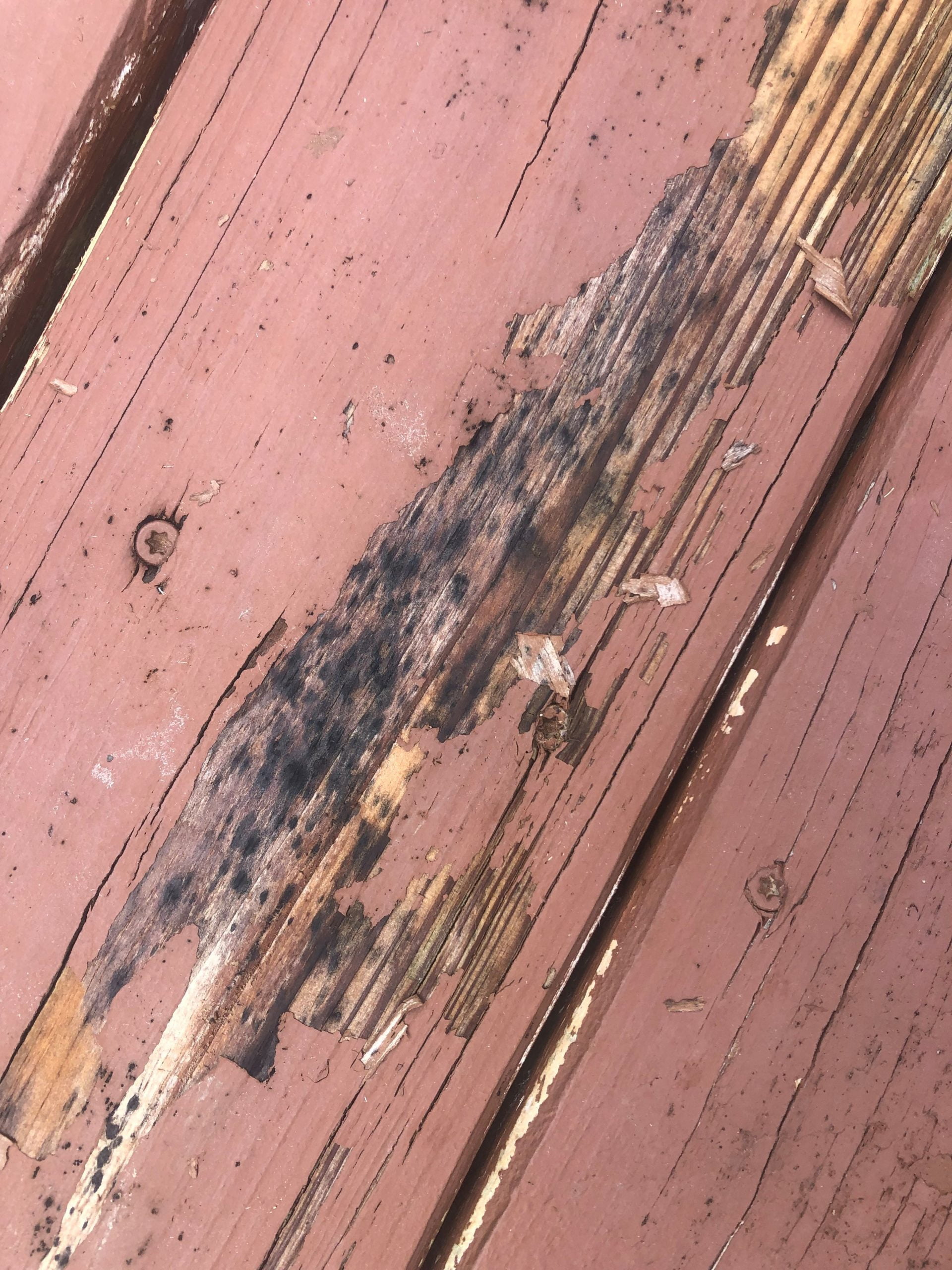

Travis Williams
Travis Williams

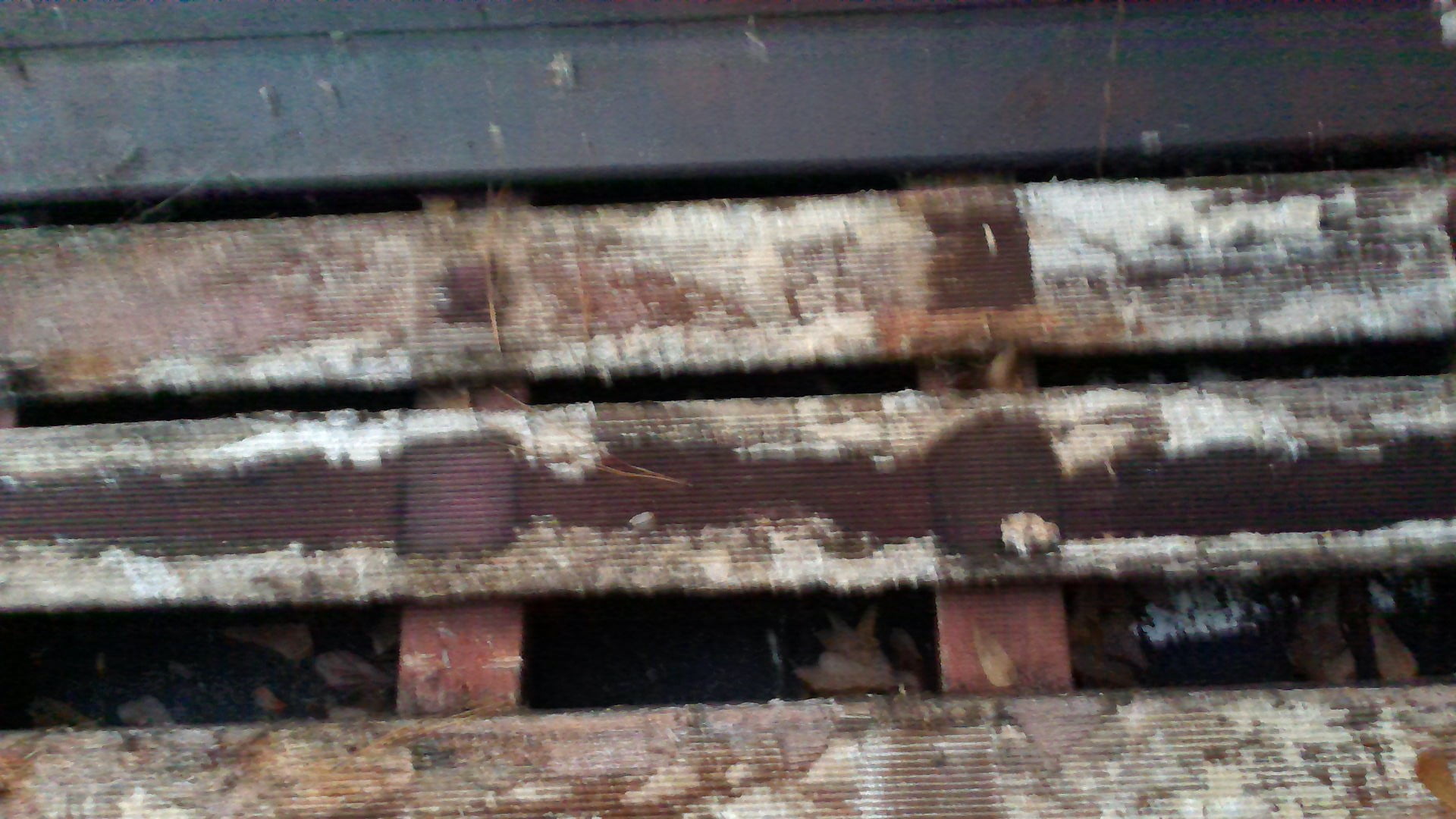

I have a 5 year old deck that looks to have black mold spots on top and bottom of the deck boards. Deck was sealed with a Behr product and is peeling off. The deck also gets plenty of afternoon sunlight. Can this mold be cleaned? Do have to replace the boards? The boards themselves are strong. The pictures attached are the top of the deck where it is peeling, a piece of the Behr stain that peeled off and the bottom of my deck.
Travis Williams
Travis Williams
For the Deck Cleaner which brand do you recommended and for the wood brightener which brand do you recommend? The ones you recommend, Can these be purchased at the local hardware store like Home Depot and Lowes? Also looks like the mold is growing under the stain. Any ideas for this?

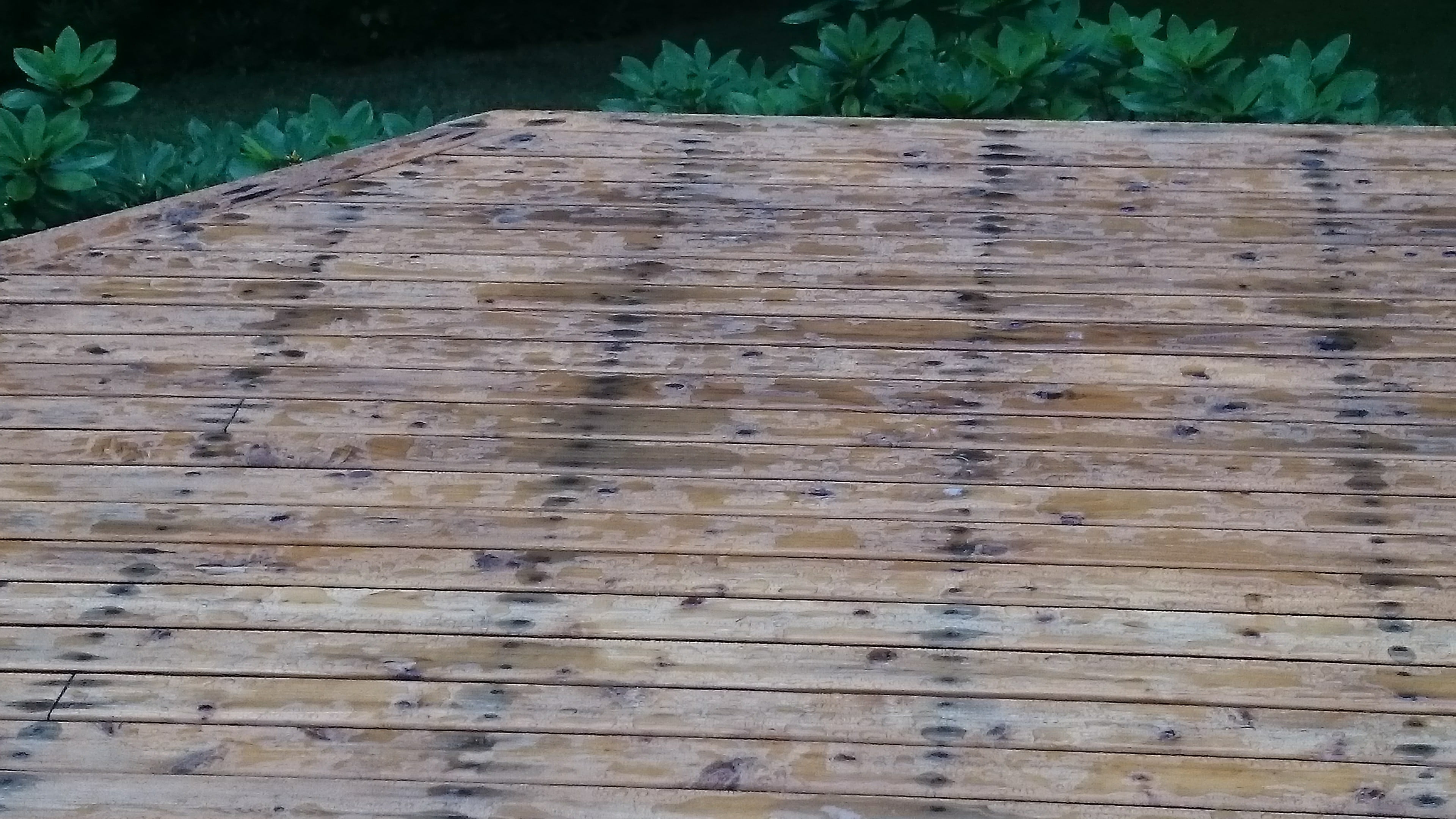

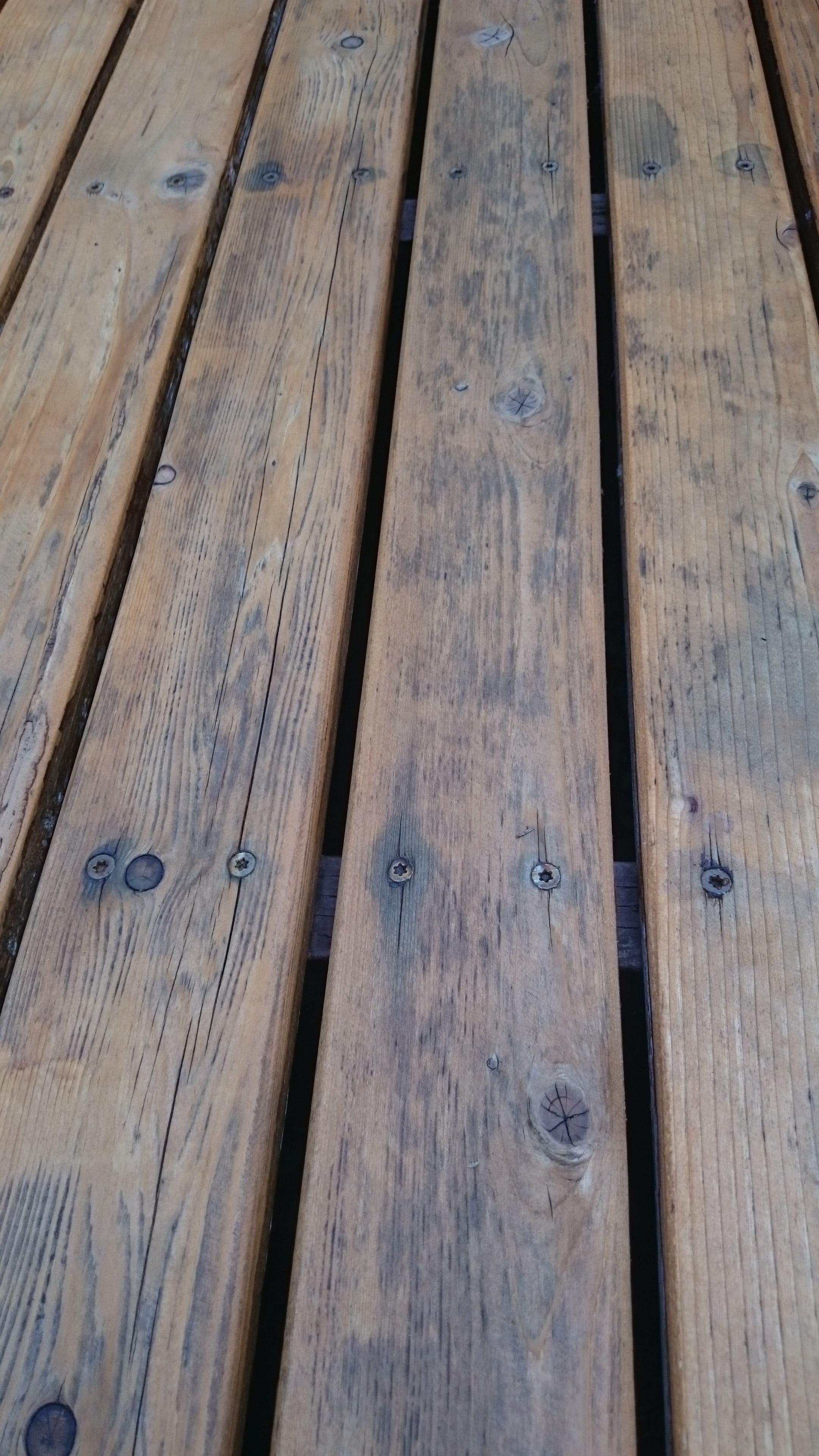

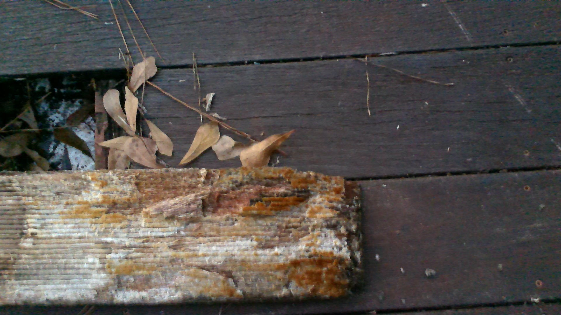

Mick
Mick

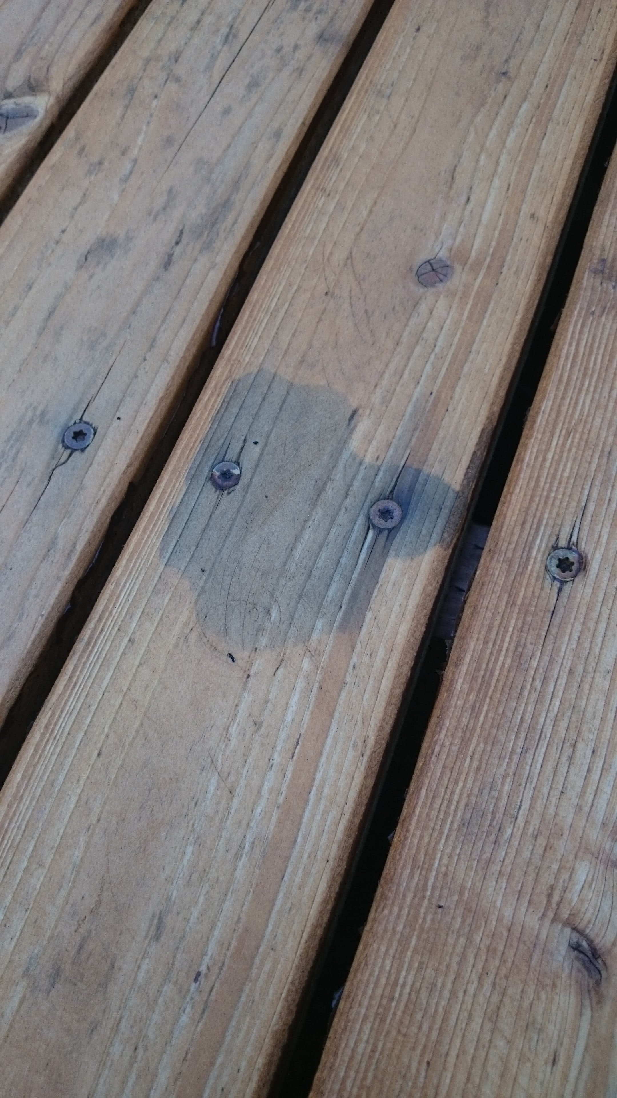

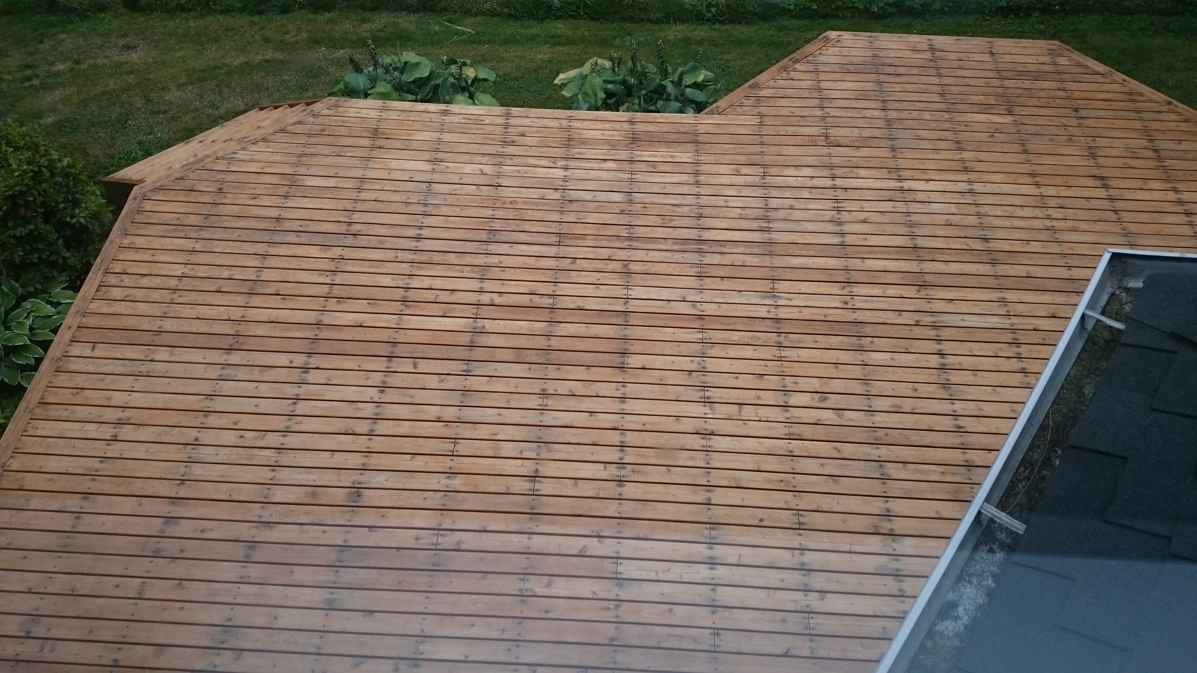

I have over a thousand ceramic coated deck screws (not stainless) with scratched heads down to metal and now black spots are forming around them after staining with TWP 100 and then rain four days later. As the oil based stain doesn’t put a protective coating over the screws (thought there would of been a strong enough film that cured over them) is there another way to seal the screw heads so we can clean and brighten and not have the black spots return?
Mick
Mick
That was the answer I dreaded, but somewhat expected. Replace with stainless steel screws in case we need to sand again? Also, since we just put down the TWP, should we wait until spring to do the clean brighten and reapply post screw replacement?
Mick
Mick
Thanks. Iron stain is a fresh new topic for me. We cleaned and brightened the deck, then it rained within 2 days. So we waited 3 days for it to dry before staining with TWP 101. Three days later it rained. That’s when we noticed the iron stains. Do you think it stained pre-TWP and we just didn’t notice or are the stains above the TWP? Basically, does oil base staining enhance the iron stains?
Mick
Mick
I posted three above. Here’s another. Seems to mellow a bit after drying, but not much
Mick
Mick
Reply to  Mick
Here are some pics right after a rain. TWP puddles/ blocks the water, but allows the iron, water and tannins to mix and make ink? Boy, if there’s ever a recommendation to sand a cedar deck without stainless screws better have a warning every time about this pitfall. I never saw it mentioned and I researched alot before going with TWP and proceeding with clean and brighten.
Nails Rusting On Deck
Mick
Mick
Exactly. So please do a service and mention that, if you sand a deck (especially cedar) and you don’t have stainless steel screws or nails, there is a great risk that you’ll end up with unsightly stains after all your hard work AND additional work will need to be done replacing all of the screws or nails as well as cleaning and brightening rework. My point is, there seems to be little or casual mention of the iron stain issue. I know deck experts probably aren’t chemists, I sure am not, but if it’s a known issue, spread the word. I want other folks who research before taking on a big project not to be disappointed. Thanks.

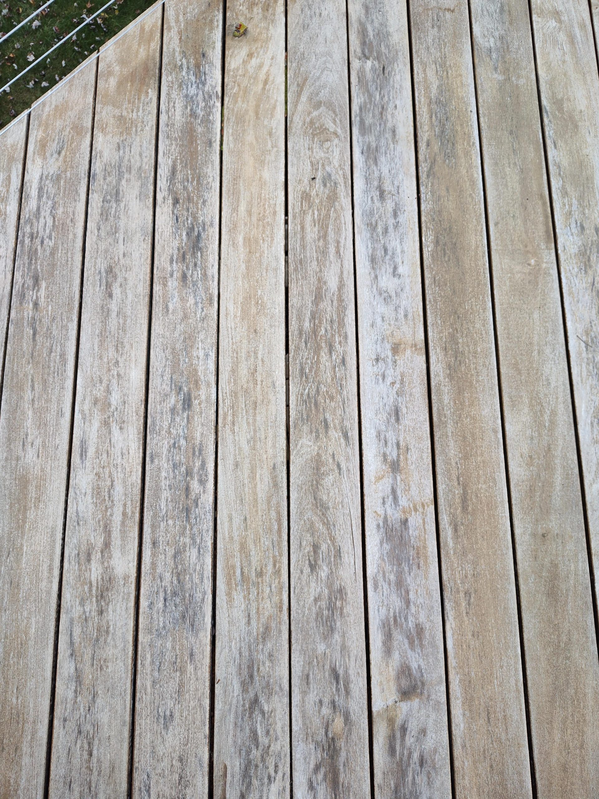

Hi from Spain, I have recently laid my IPE deck, I then stained with Cedria Teka oil( Good Spanish brand) as they told me it gave really good results.
After 2 months black mold spots have turned up. I have read your posts and even the bench I did 3 weeks ago and I haven’t stained yet got the spots.
I have tried the bleach method at 50/50 dilution and rinsed off but the black spots remain.
Any advice on how to get rid of the spots?
Once the spots are gone is it reccomendable to apply a fungicide before oiling?
There seem to be no posts here in Spain with such support as you guys.
First and second picture stained deck
Third and fourth unstained bench

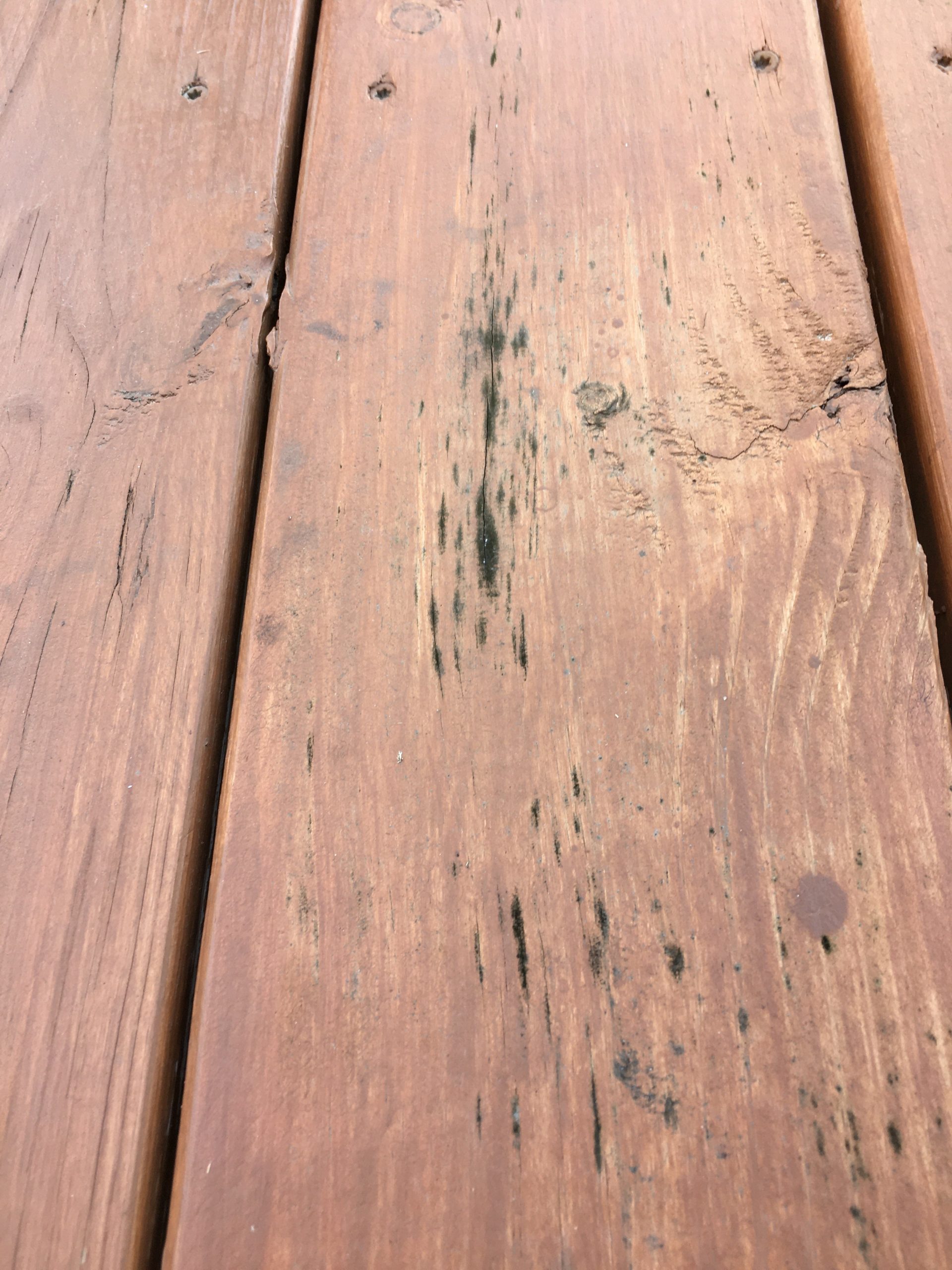

We apparently live in a swamp. After prep with R-A-D products and applying TWP 100 stain our PT pine deck is always covered in mold within 6 months. (We did $20K of drainage improvements around the house. The deck is 2-4 feet above grade.) Is there a more mildew-resistant product than TWP 100 and/or a mildewcide that could be added to the (TWP?) stain to increase the resistance?

Thanks. Is there a surface spray mildewcide you recommend that could be applied periodically without degrading the TWP 100?

I just finished building a western red cedar deck and, not surprisingly, as I now learn, it has started to get grey/black stains which arrived after the first rain for several weeks. After a chat with Armstrong Clark I had planned to wait until spring then brighten the wood with oxalic acid solution and then put on a Armstrong Clark semi-transparent stain. Now that the black marks have begun to show up, should I change this plan. Presumably by April/May (in BC) the marks will be much more widespread and i am concerned that they may not be removable by then. Any suggestions would be most welcome.
Tim
Tim
12 years ago
Reply to  Mick
Western Red Cedar reacts with iron and steel when water is added to make black/grey stains. Did you use zinc screws and galvi. nails? Did you cut any steel or do any grinding where the black parts are? A new cedar deck should start to mold for a year at least. ( I live in BC)

II do now?
Courtney
Courtney
13 years ago
We built our house one year ago. We had our second-story deck pressure washed and stained with Deckscapes at the end of May. The weather here has been unusually rainy for the past four months. The underside of the deck was not stained (we were told it was not recommended).
The top looks fine. However, the underside now looks terrible (there are large black spots and streaks (where the rain runs between boards) and smaller yellow spots, which I assume is mold and mildew. The person who stained it said he didn't know what to say except that it's been unusually rainy and that it would not hurt anything. However, it does not seem like it should look that bad, and the edges of some of the boards even look "jagged", I'm concerned they will rot.
We would like to know what we should do next. We are considering having the underside stained, but is there something specific we should use? Do we need to treat the bottom with something first?
