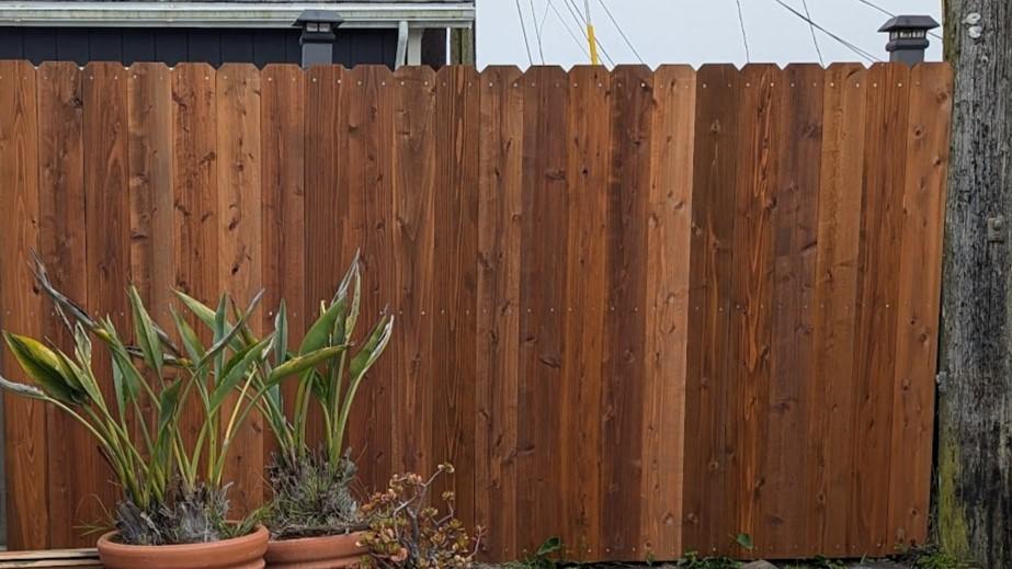

I used restore-a-deck semitransparent in dark walnut on my cedar fence and unfortunately don’t love the results. Other than being a little more red than I expected, I don’t think it’s the fault of the product; the wood was quite variegated, so the stain came out in a lot of different shades. (Also possible I applied it wrong, though I did follow the instructions). In any case, I’m thinking I might want to try another color over it. Possibly even a solid to get it more uniform.
Based on how I understand the product works, I assume I can’t use any other penetrating stain (including the restore-a-deck itself) for some time. Is that right? Could I use a solid stain or a paint over the semitransparent, though? It’s not a deck so I assume some of the concerns about paint may not apply.
Cedar fence stained with restore-a-deck semitransparent dark walnut, displaying varied shades and tones, with potted plants in the foreground.
