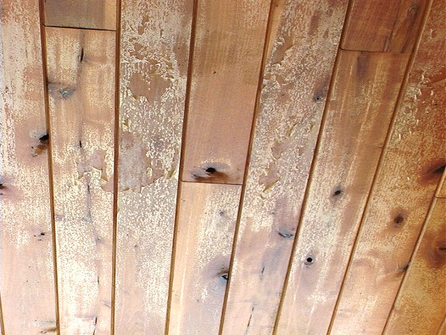

Why You Should Avoid Clear Sealers or Polyurethane Over a Deck Stain

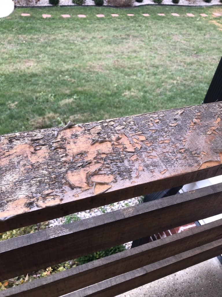

Peeling Deck Varnish
Deck stains are specially formulated to protect exterior wood by penetrating the surface and providing defense against the elements. Quality deck stains contain UV-blocking pigments and mildewcides to prevent fading, mold growth, and moisture damage.
Applying a clear sealer or polyurethane over a deck stain is not recommended because:
  • Adhesion Issues – Clear coatings don’t bond well to most deck stains, leading to premature peeling and flaking.
  • Lack of UV Protection – Clear sealers contain no pigments, meaning they offer no protection from the sun’s damaging UV rays. This will cause the deck stain underneath to fade and break down faster.
  • Difficult Maintenance – Once polyurethane starts peeling over a deck stain, you’ll need to strip or sand the entire surface before re-staining.

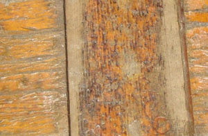

The Consequences of Using Polyurethane on Exterior Wood
Polyurethane is not designed for outdoor decks. While it works well for interior wood projects, it does not flex with outdoor temperature changes and will eventually crack, peel, and trap moisture underneath. Once this happens, maintaining your deck becomes a nightmare—you’ll need to remove all traces of the polyurethane before you can re-stain.

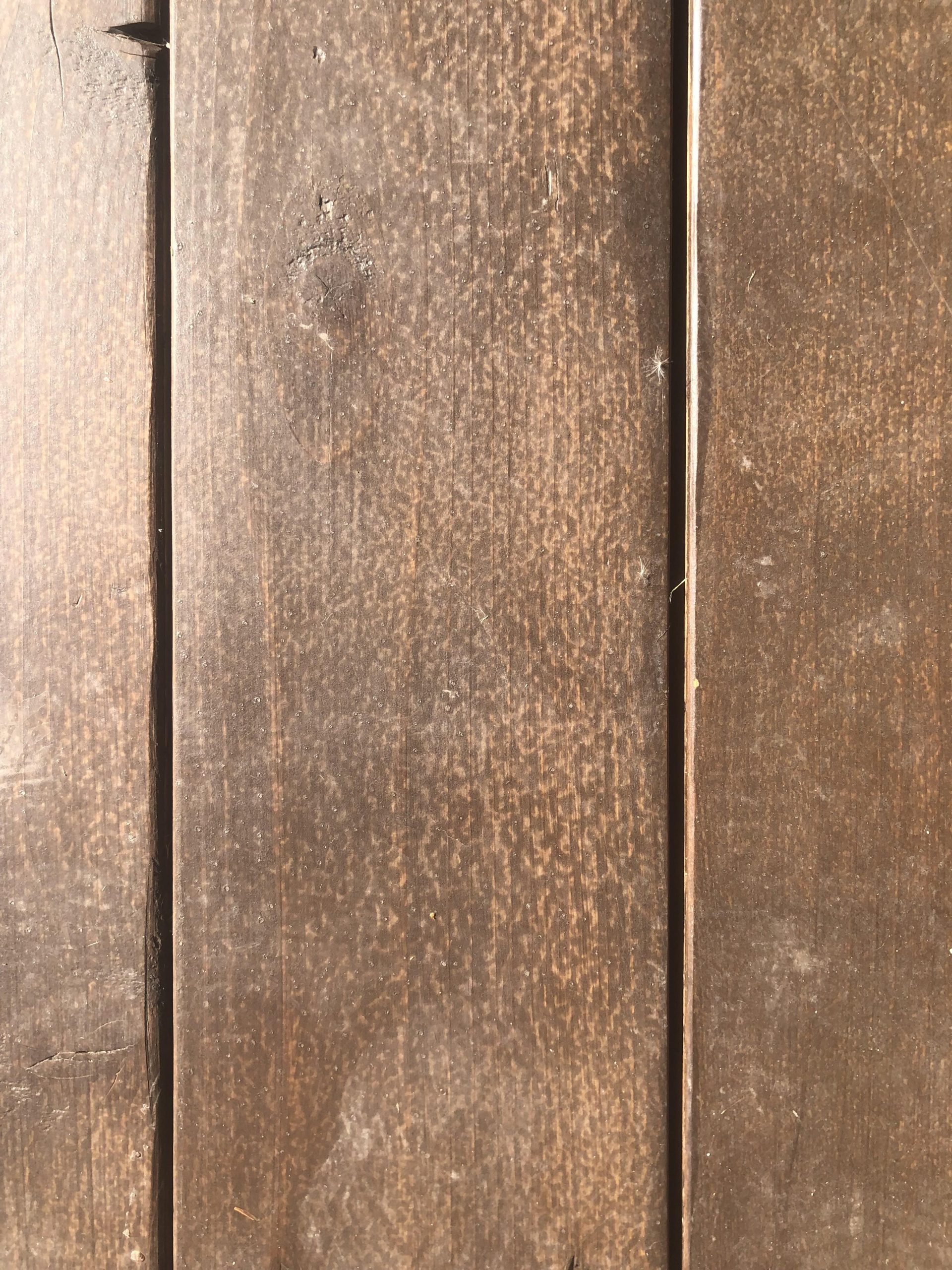

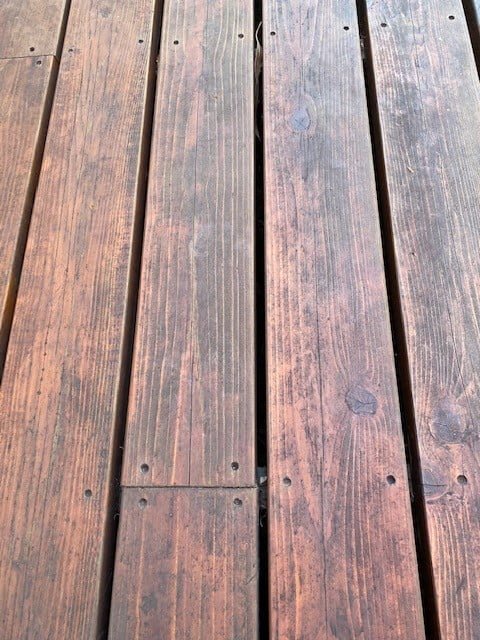

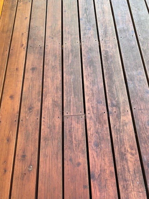

We had a new redwood deck installed 4 years ago and stained it with PPG ProLuxe SRD RE wood finish. The stain has held up well, but dirt and grime has built up on the surface. I intend to reapply the same stain this year. My question is should I strip the old stain and brighten the wood before re-staining, or can I simply clean and then reapply the stain?
Dan
Dan
The photos are typical of the condition of the deck. Thanks for taking a look.
Dan
Dan
Thanks Scott. I recently discovered your website and have marked it as my go to for information on deck/siding maintenance.
