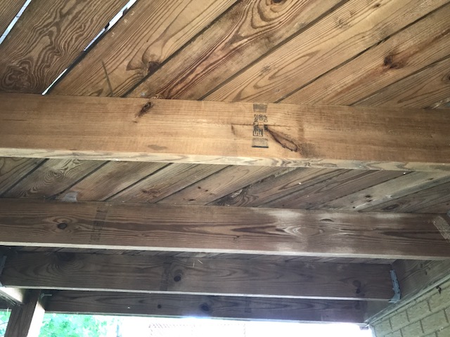

Hi Scott, thank you for this fantastic website. After cleaning/brightening — during the 24/48-hr drying period before staining — how important is it to stay off the deck? Should there be no foot traffic at all? Or is light foot traffic okay? Shoes on/off? Thank you!
Emelio
Emelio
3 months ago
Thanks for the quick reply 🙂
Next question: do I need to clean the cedar pickets or the cedar handrail on the railing before staining?
Emelio
Emelio
3 months ago
Reply to  Emelio
Dang. I was hoping you’d say pickets weren’t necessary 🤣
Emelio
Emelio
3 months ago
Reply to  Emelio

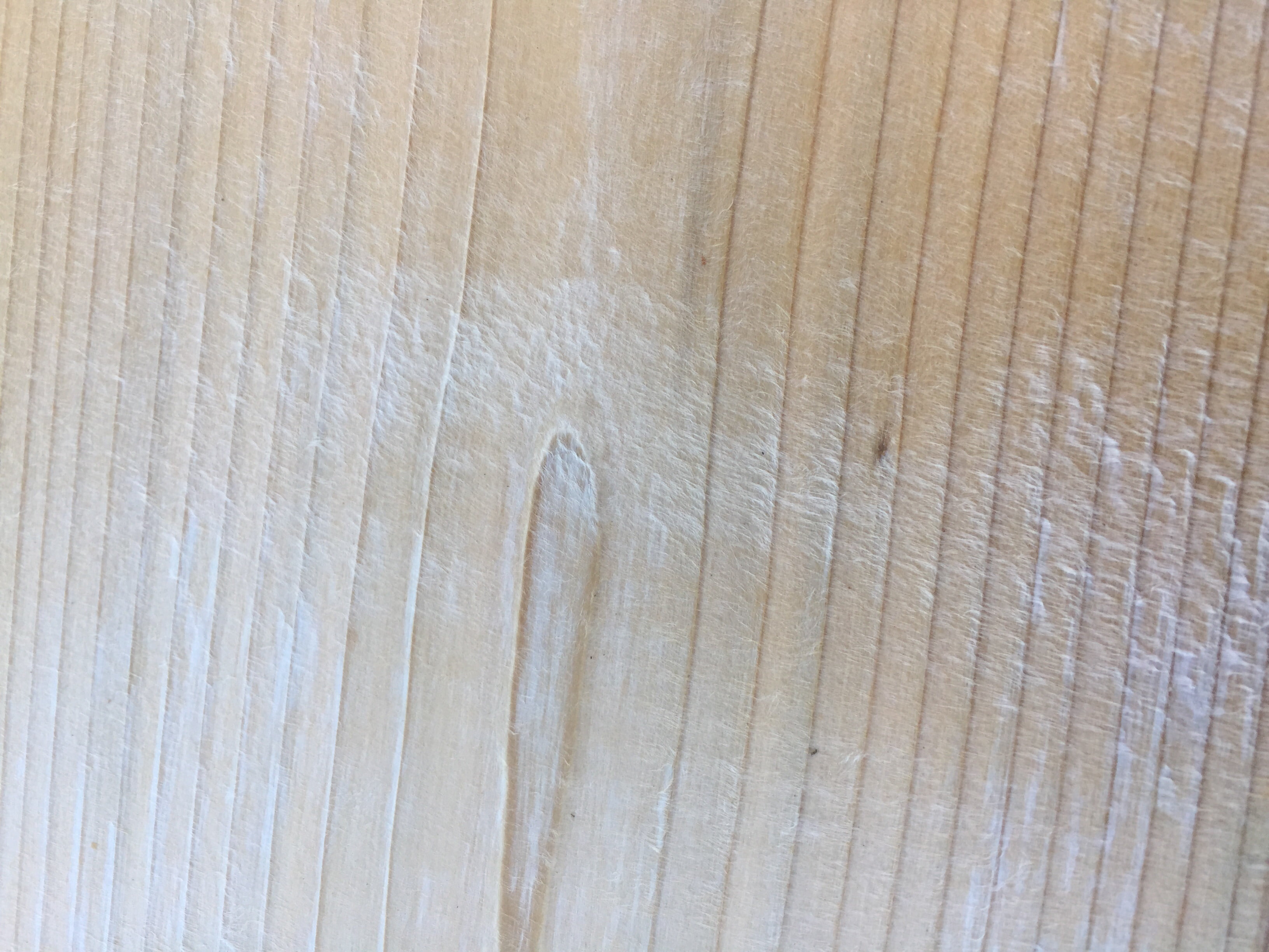

Ok I’m going for the pickets today! Clarifying question about wood fuzzies, after looking at your article on the subject: does a buffer pad work fine on fuzzies, or do I need to attach a sanding-specific buffer pad? Looking at these two buffers to rent in my area but not sure if they’re right for the job.
Emelio
Emelio
3 months ago
And would an orbital sander not be a good idea? Or can I use an orbital with the right grit level? 60-80?

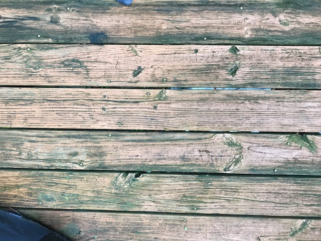

Deborah
Deborah
Hello Scott:
I forgot the picture.

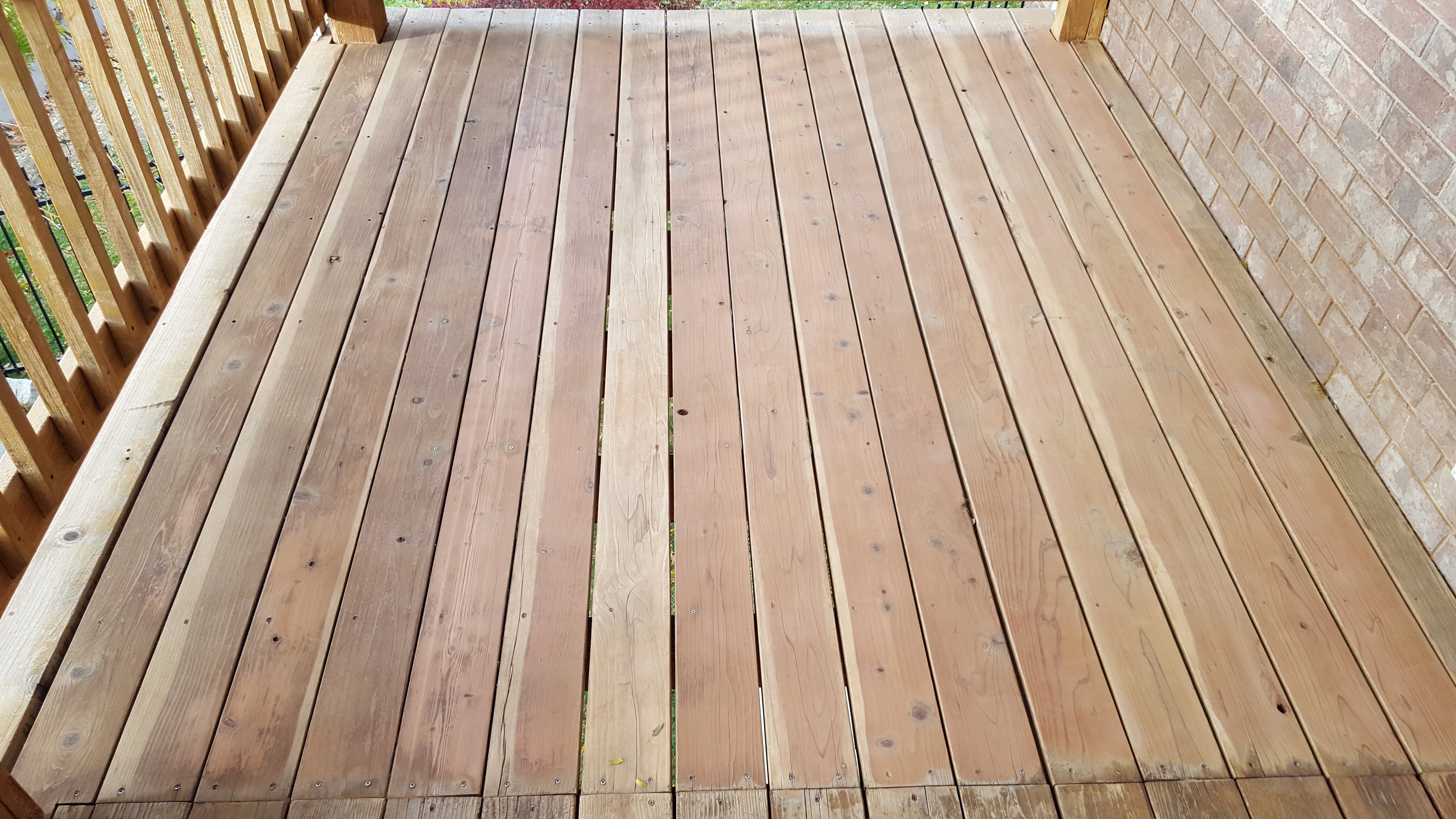

Best way to prep IPE that is in very good shape? (just graying).
Thanks, Scott! Next weekend project!

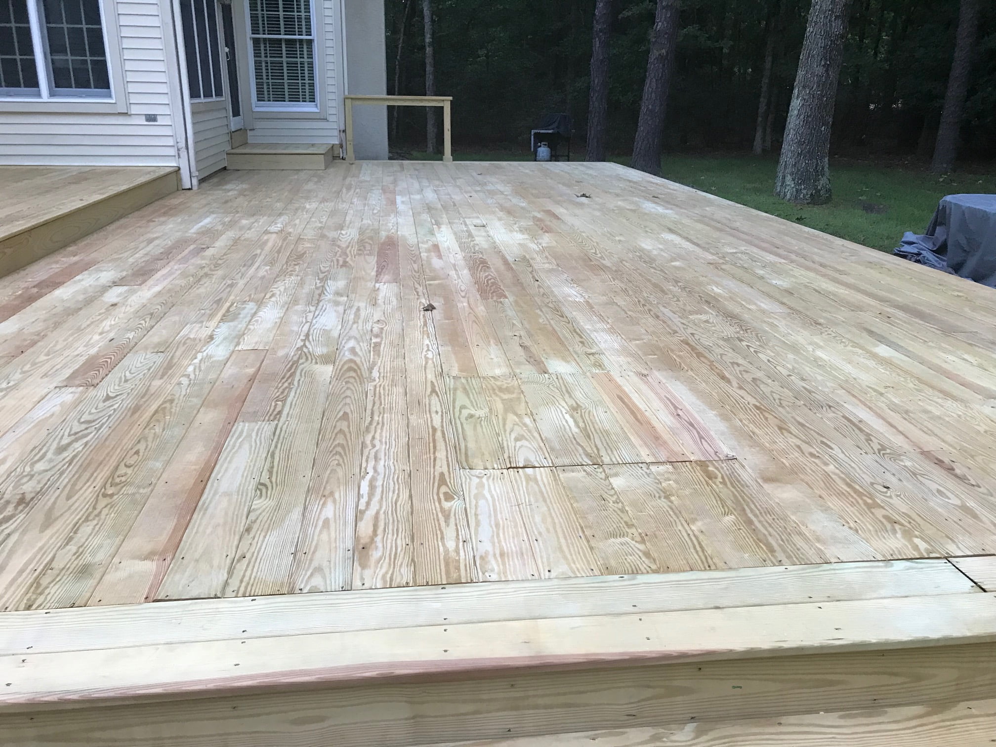

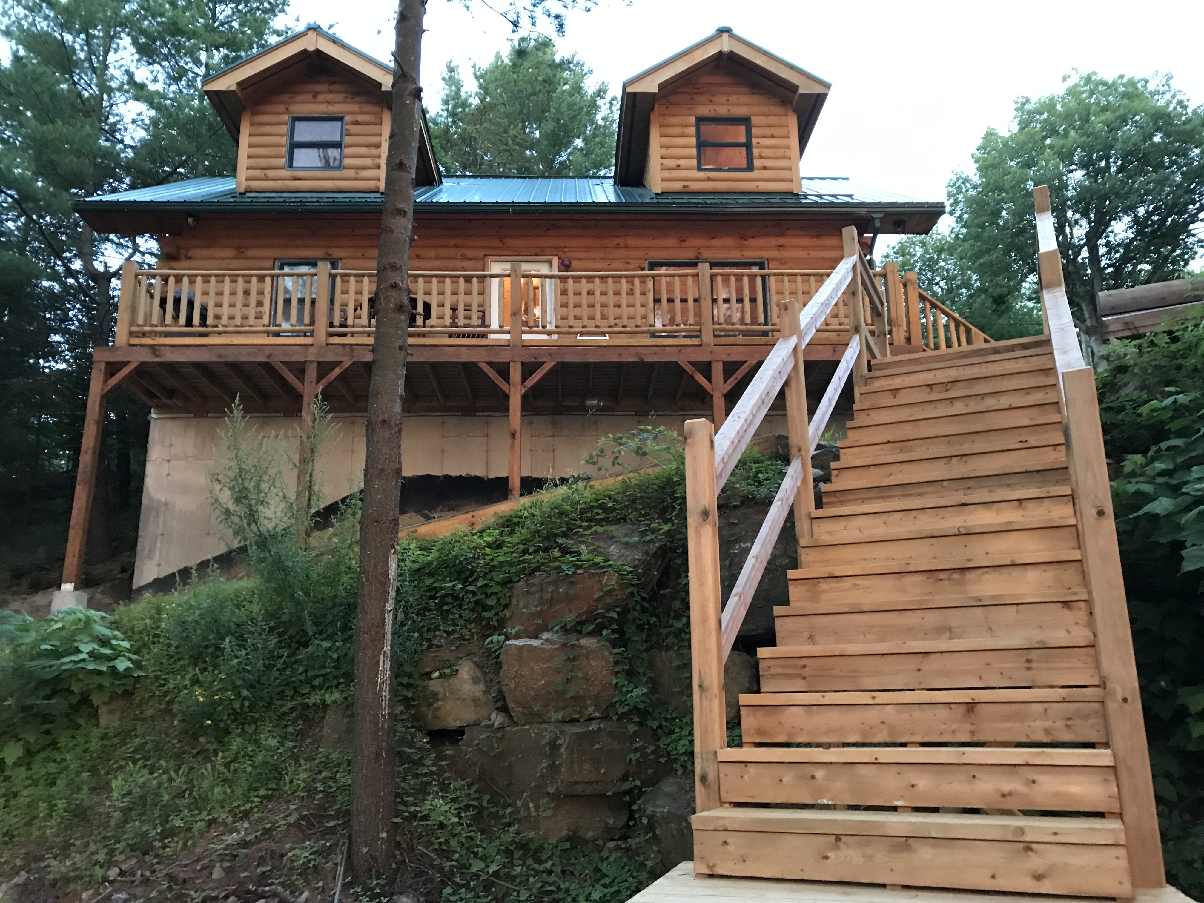

Before, during, and after.
6308586B-3864-4E88-BF16-3C3D5320085B
F53609AA-CBD5-4683-8EC9-7ACB1EE63E39
D7D35ABF-172C-462A-9E8B-603DADEF74DC
I used Defy products for both cleaning and staining.

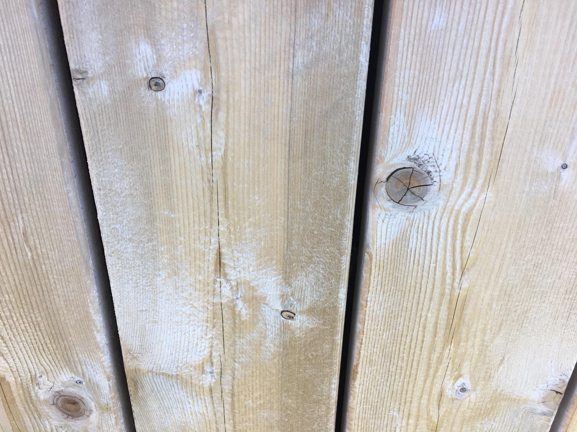

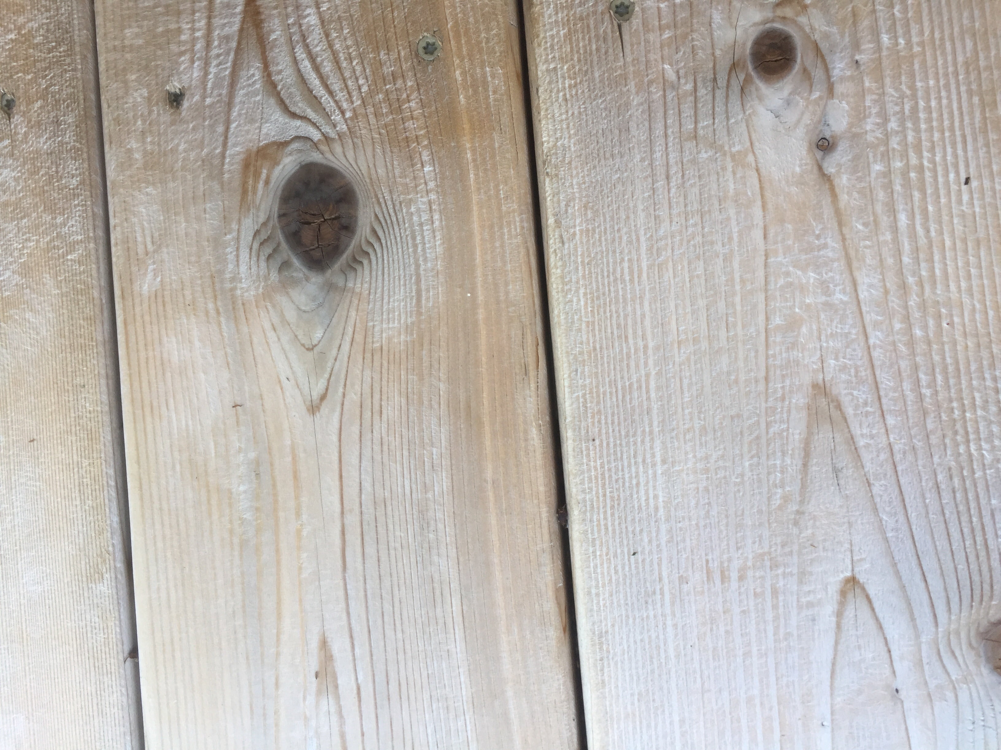

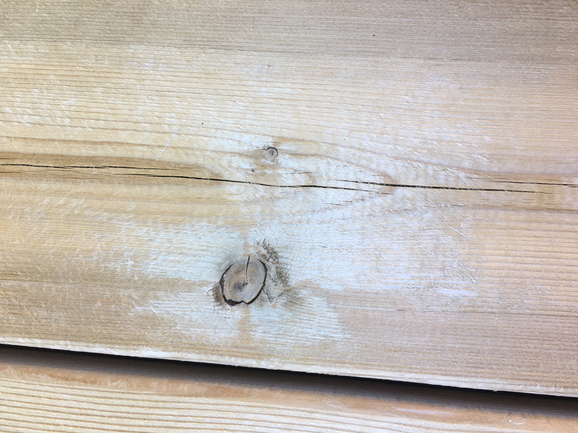

thanks.Is a deck cleaner the same as a “Restore” or “Remove” deck product?

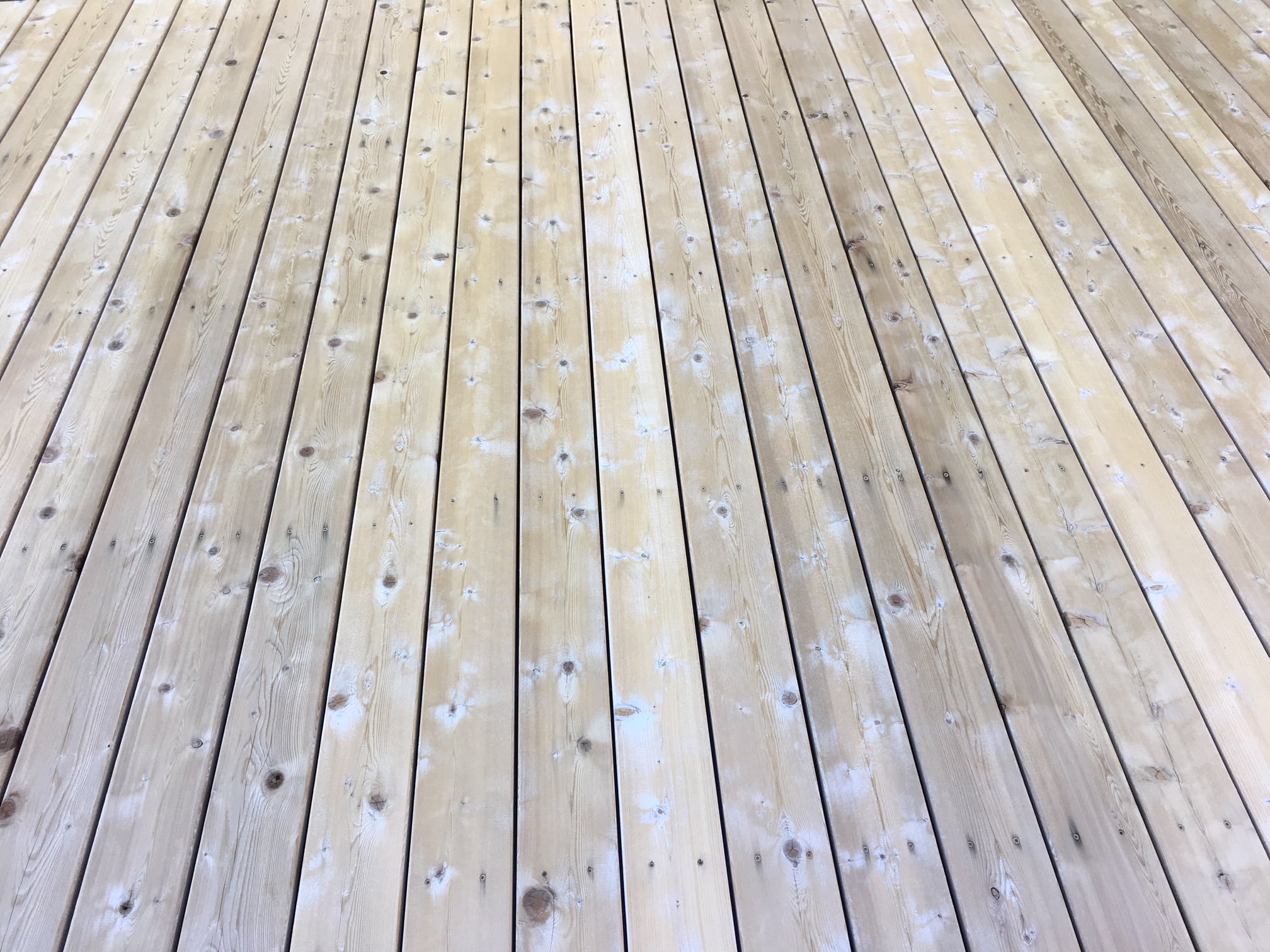

It’s strange, because the brighter I used even left white film on a new unweathered board. It did not revive it.
George Martins
George Martins

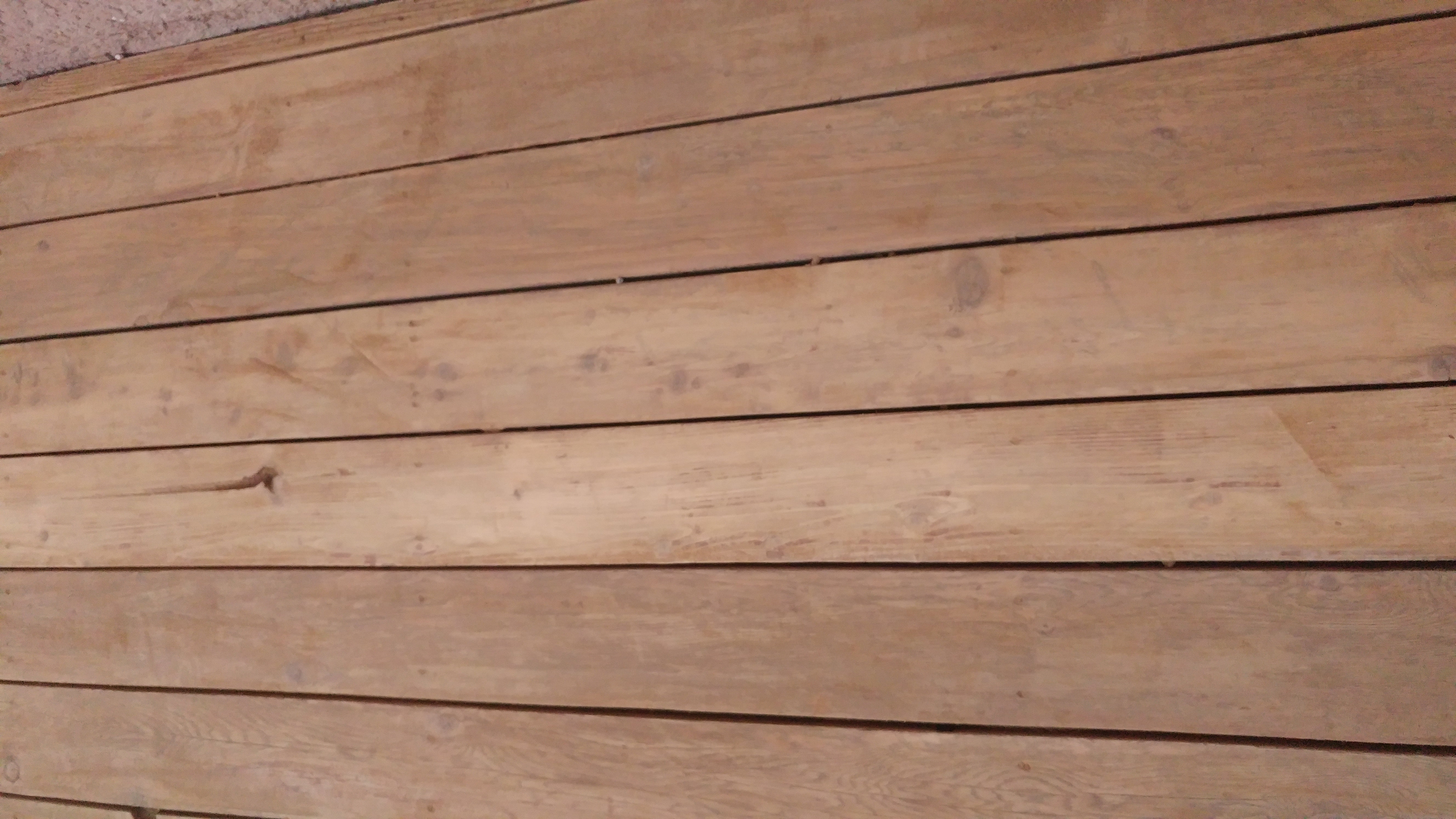

I used a brighter on my thermal wood deck and now it’s turned whitish, rough and did not remove all the algae. What do you recommend to bring it back to natural tone and do you seal it with oil?

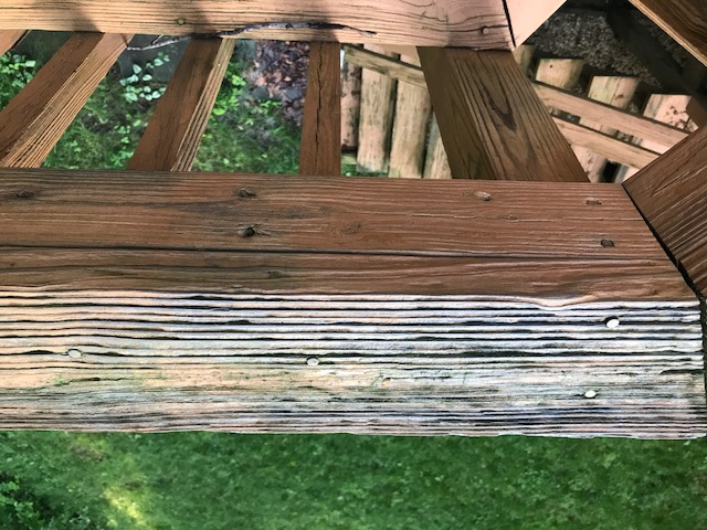

MzLiz
MzLiz
I’ve got a 20 year old, glulam beam that will sanded down to bare wood, (I plan to stain with TWP 100 – Rustic). Do I need to apply a brightener prior to staining? Or can I stain the beam as-is?
MzLiz
MzLiz
80 grit to remove the old stain (unfortunately Behr), then I lightly smoothed it out with 150 grit.

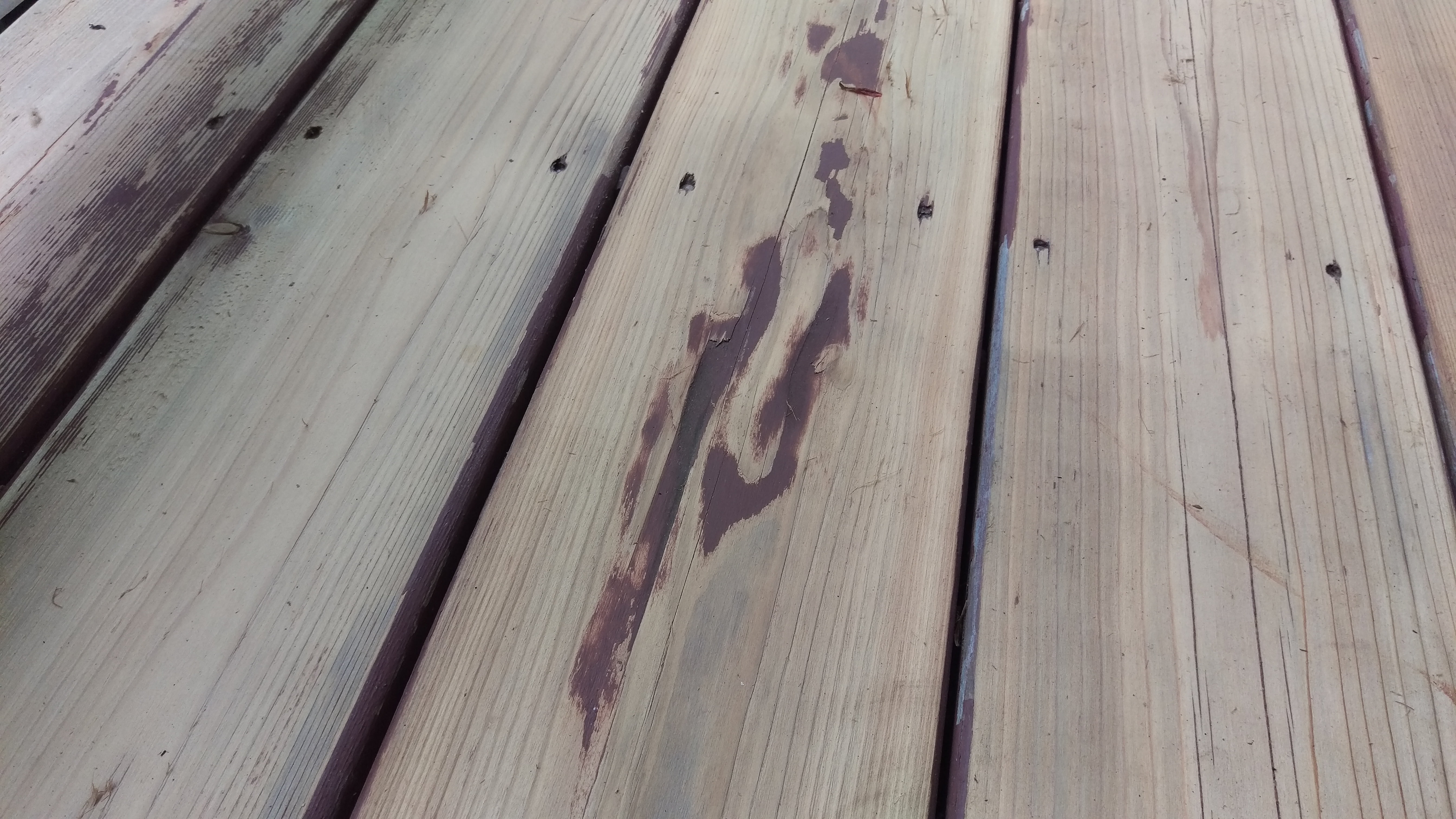

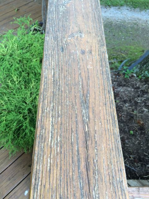

Advanced Deck over with texture redwood color…… seams to peal in large sections after a few years. Is it common that it wrinkles and peals like this?

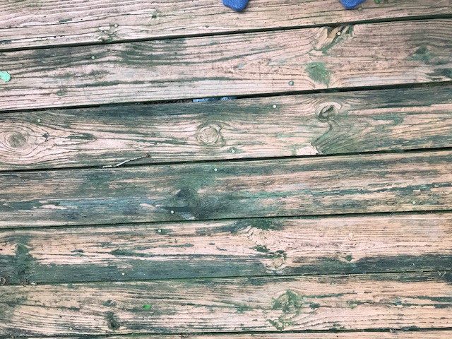

I have a old deck that has been stained with a Floods solid stain for the second time probably 9 years ago and looks good other than a couple small spots that are peeling on the railing. Should I just use Restore a Deck cleaner and power wash?
I wanted to refresh the whole deck as I added a new pressure treated wood cap on the railing and wanted to know which product would be best to use TWP 100 or TWP 1500 for this application?
If neither product is a good choice want would you recommend?

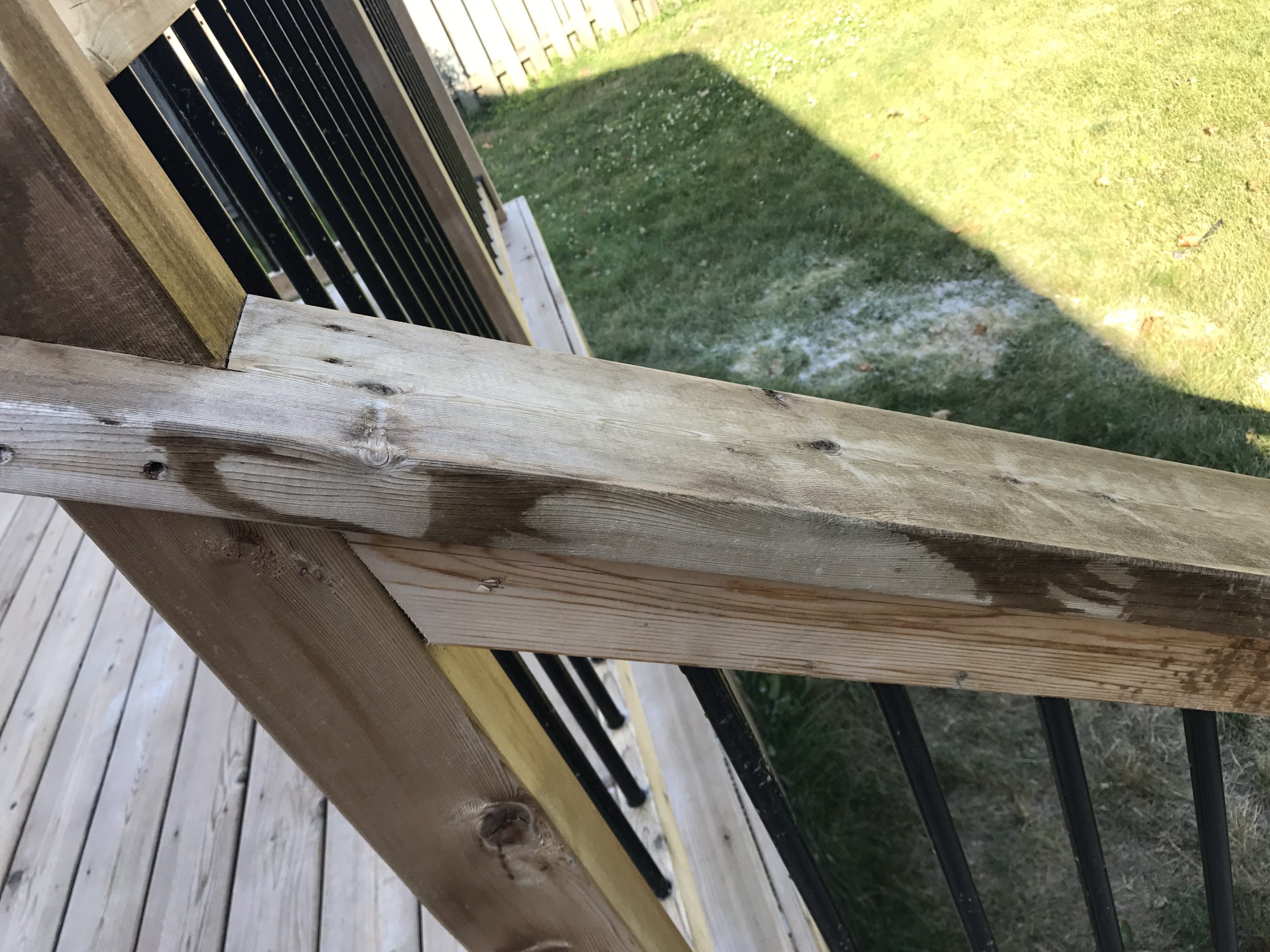

I used the cleaner and brightener on 3year old deck then stained railing and half the large deck with twp. I was unable to finish due to rain on the weekends for the last month. I believe I need to reapply cleaner and brightener before I finish staining unstained sections. My question is if it is okay if the cleaner and brightener get over sprayed onto the new stained sections or do I need to make sure the cleaner brightener only get applied on the old deck. I don’t want the cleaner/brightener to affect/discolor the new stained sections.

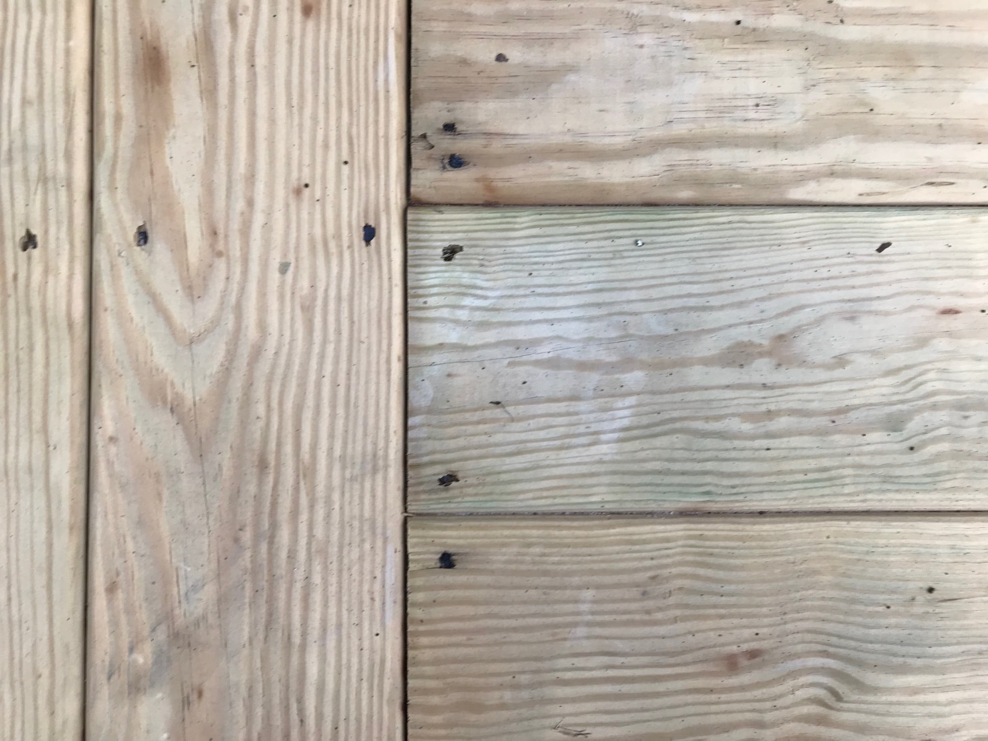

I pressure washed the new wood on our deck, but the soap dried on it before I could remove it. When it rains you can see small bubbles. How can I remove the dried on soap.

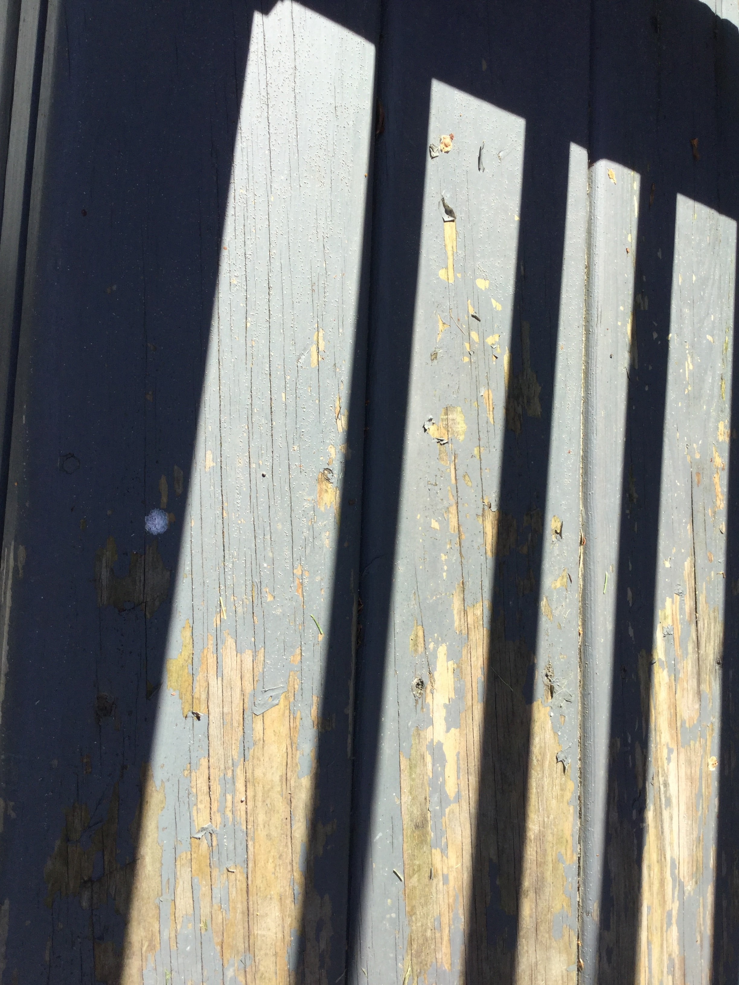

We have a covered porch with entrance stairs. When we bought this house 3 years ago, it was all untreated and grey. Using the great information on this site, I prepped and cleaned the entire surface, and used the Sherwin Williams Deckscapes semi-transparent latex stain on all the horizontal surfaces. Last year (year 2), I again cleaned the surfaces and did another coat to darken it a bit. The covered portion of the porch still looks great, no cracking or peeling.
But in my quest for The better idea, I used the crushed nuts mixed in for the stairs last year. As the picture shows, that process apparently made for sandpaper in the walking areas. Peeling down to the bare wood. No more traction attempts this year!
My question is this. I’m ready to redo the stairs. Do I clean/powerwash/sand to remove all prior stain?

I cleaned an unfinished cedar deck with wood wash (Biotestore) and it discoloured some of the wood in spots. Is there a way to correct this before I stain?
KEvin Baker
KEvin Baker
Here are a few that show the stains and colour changes. I followed the directions of the deck cleaner, used a plastic brush and power washed. Thoughts?

I sanded my cedar deck. Cleaned it today and it left dot like spots in places. I’m scrubbed with a nylon brush and old stain came up. Is this normal. Should I clean again. Stripper not an option. Too much vegetation. Previous stain was ready seal. Two years of o.it wiothoit more than cleaning. Ordered TWP. Any thoight

Hi! I cleaned my deck with cleaner and followed it up with brightener. Unfortunately it did nothing for the algae. I used vinegar and baking soda and a scrub brush to get the algae off and now I’m wondering if I need to use the brightener again. Thanks!

I had a new set of stairs built last year and let them age for a year, untreated. They are under several pine trees which drip sap. What is the best process to address this before staining and sealing? Also do you have any recommendations for a good type of stain to use that will ease pitch remove next year?
