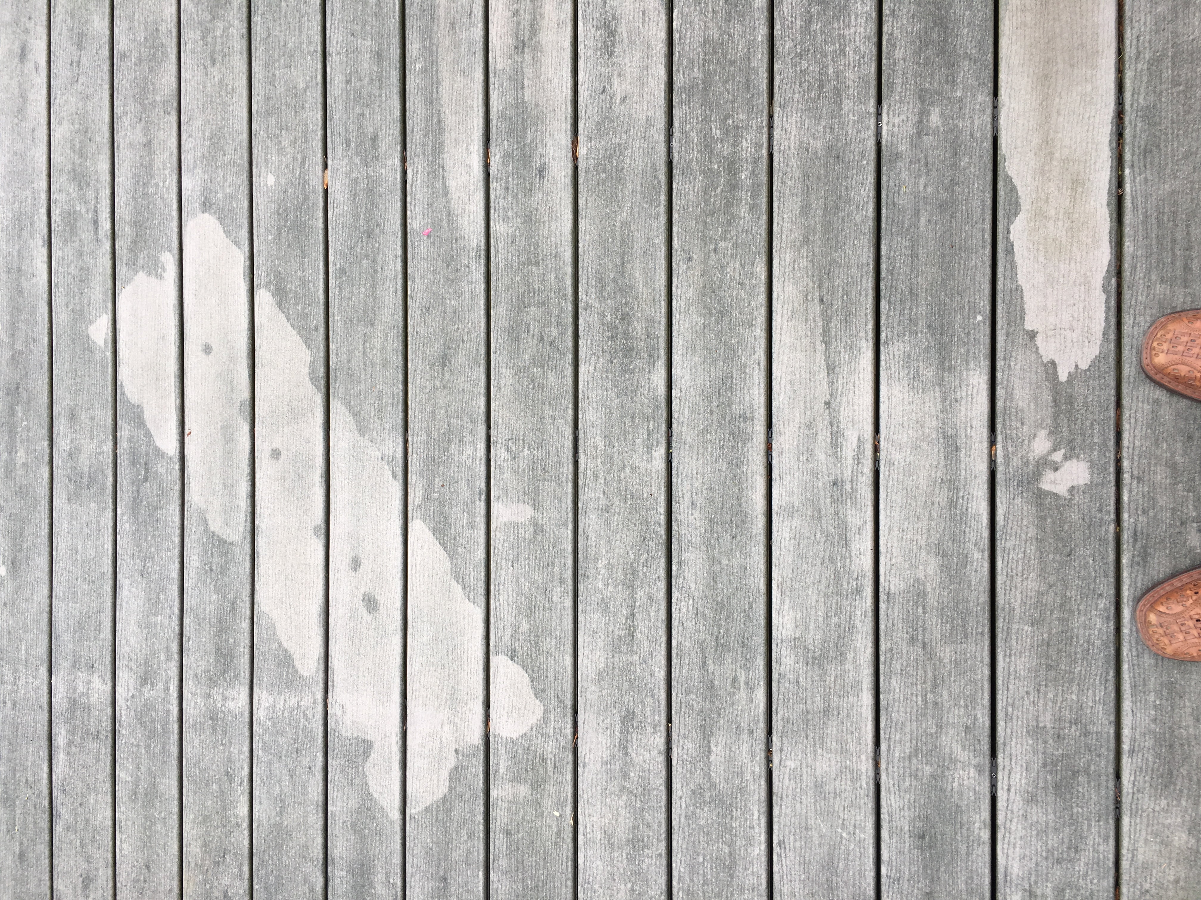

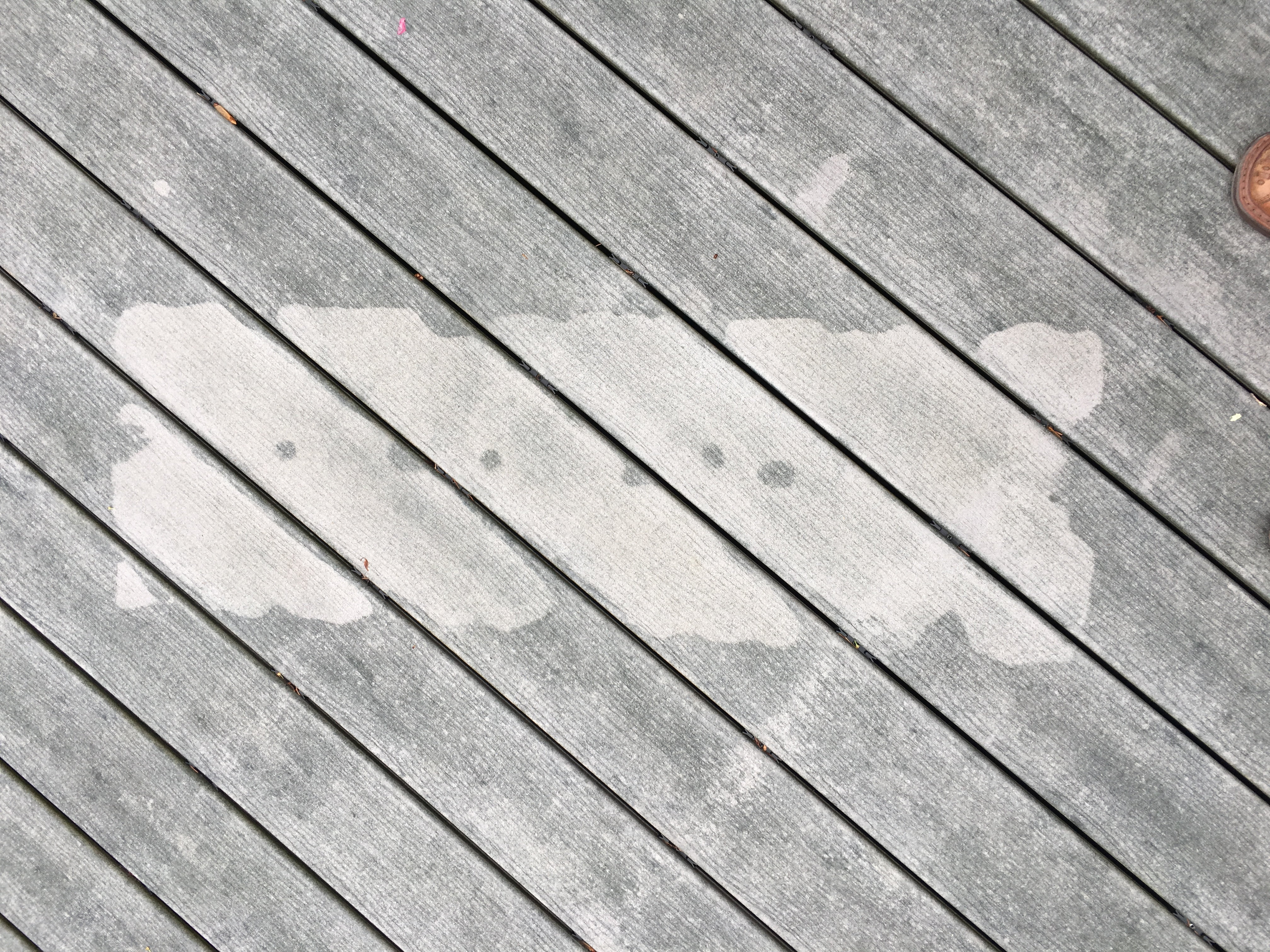

I spent alot of money installing a trex deck and three years later I am getting white spots and what looks like a white film. What can I do about it? Can I stain it? And How can I prevent it from continuing where it has started. How can I prevent this from starting on boards that are still in good condition?
Without knowing what it is and what is causing the white spots, there is no way to answer how to remove it or prevent it. Have you contacted Trex support for assistance? Pictures would help as well.

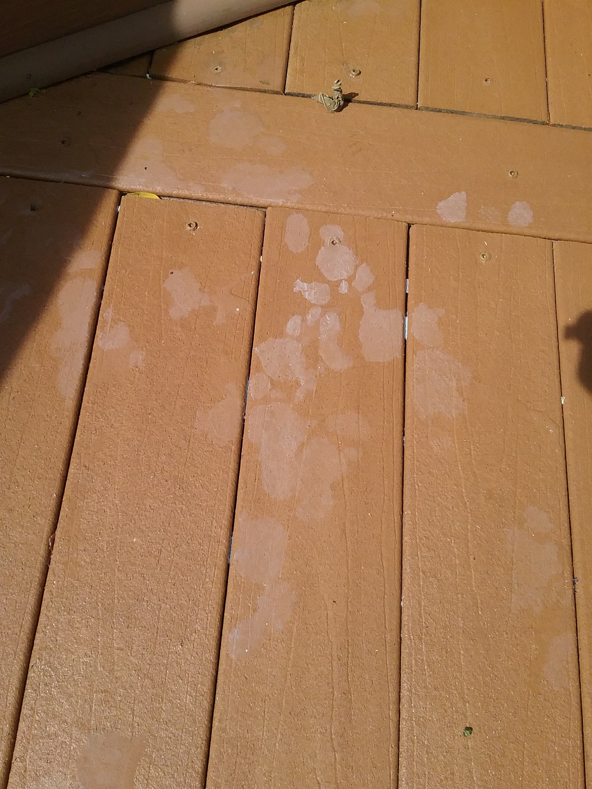

Hello. I applied extreme composit sealer on my deck after I power washer it. Now I have white spots everywhere the water beaded up on the composit decking.
Post a picture.
Photo of white spots where the water beaded up. I applied defy extreme composit sealer yesterday. It rained this morning
That looks like mineral deposits from the rainwater. Try wiping it off with a wet rag.
