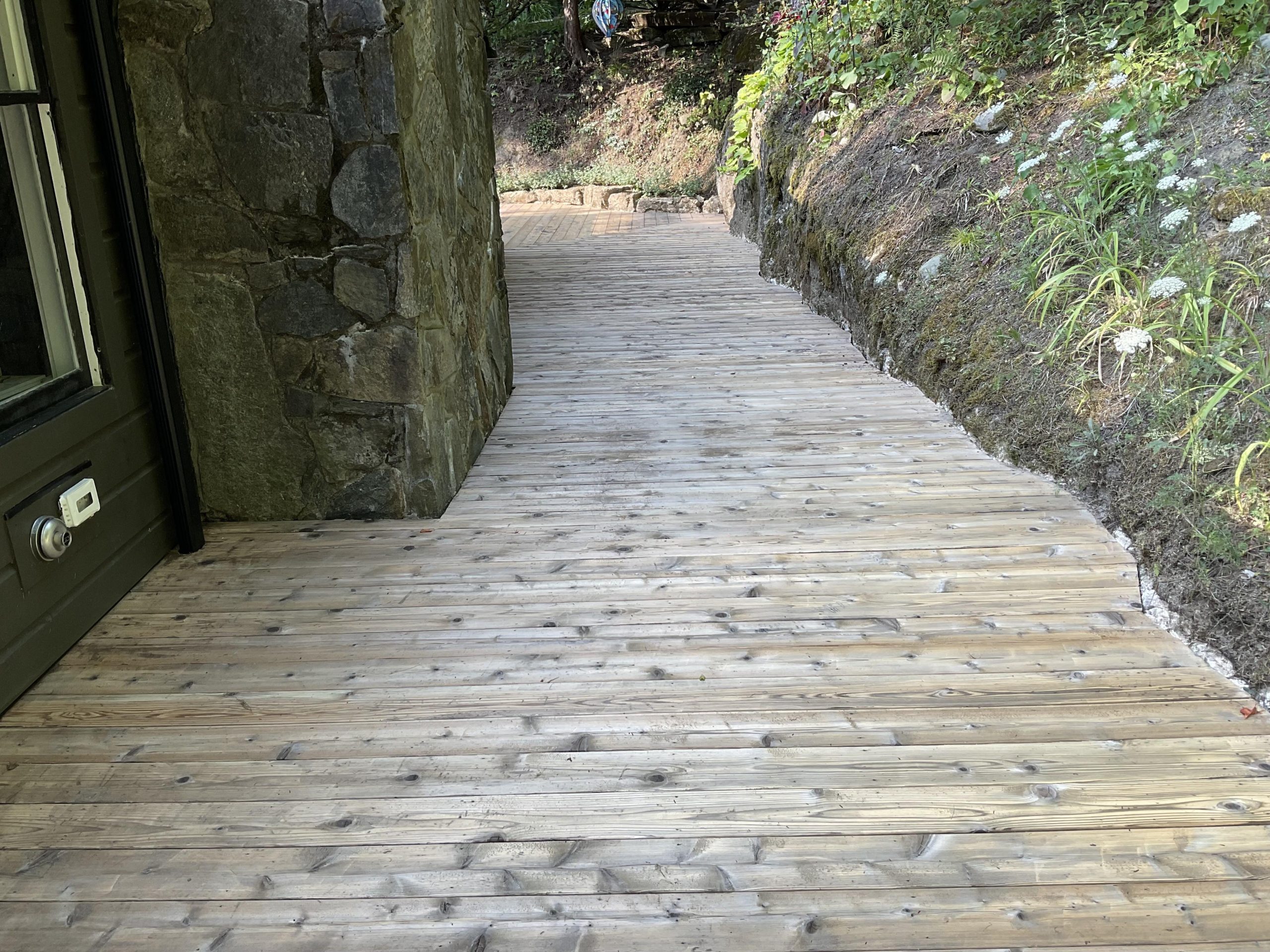

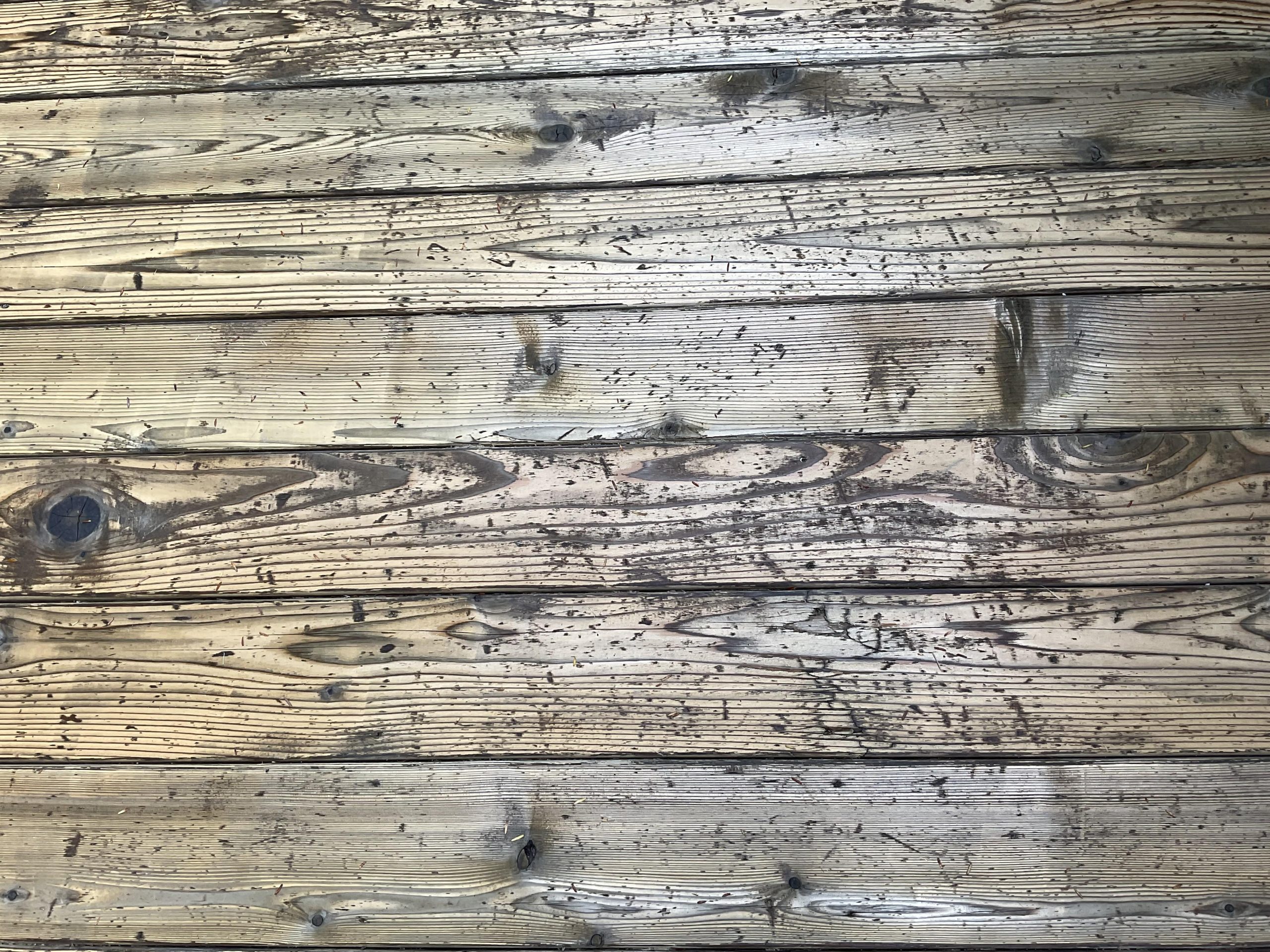

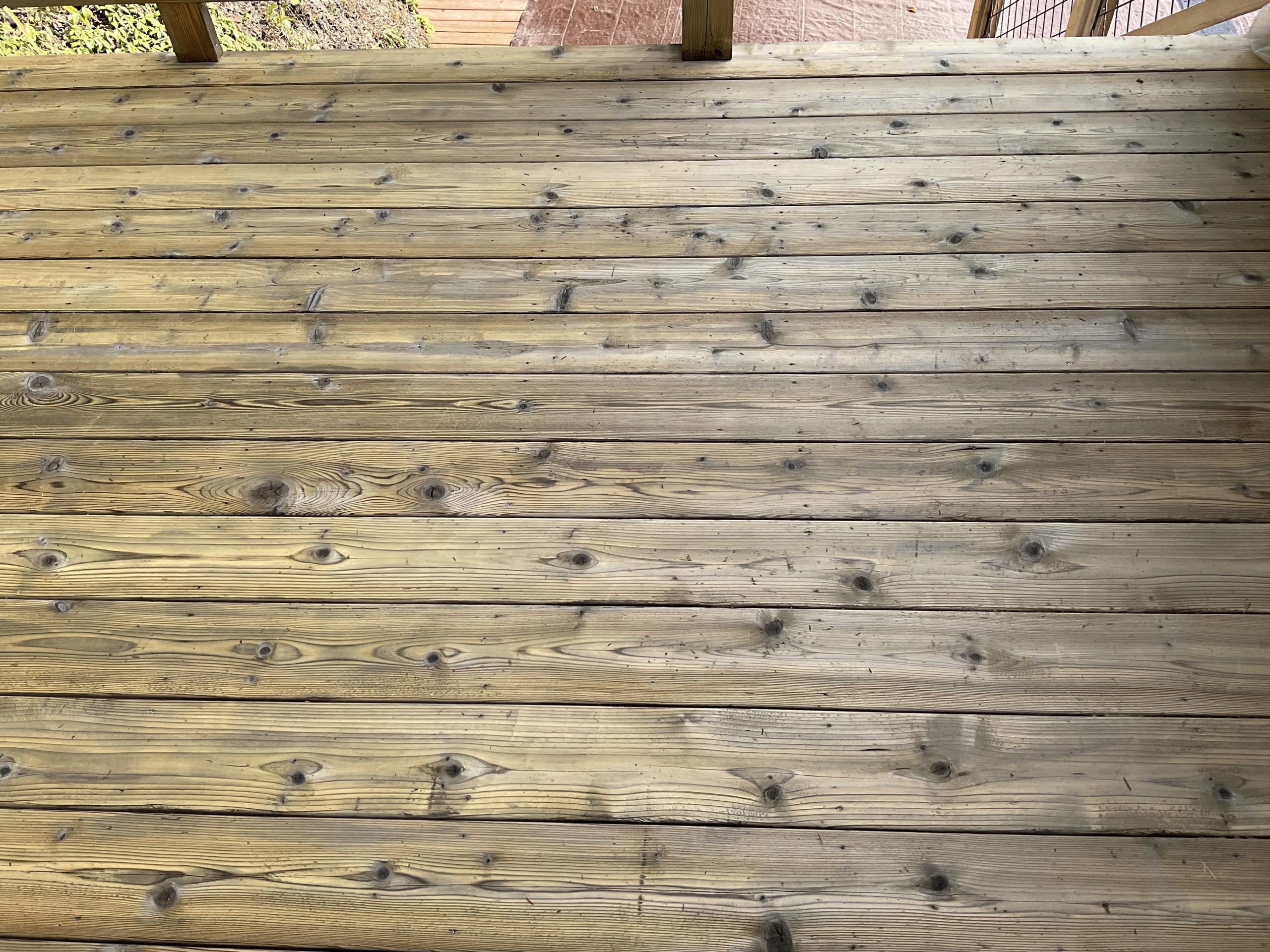

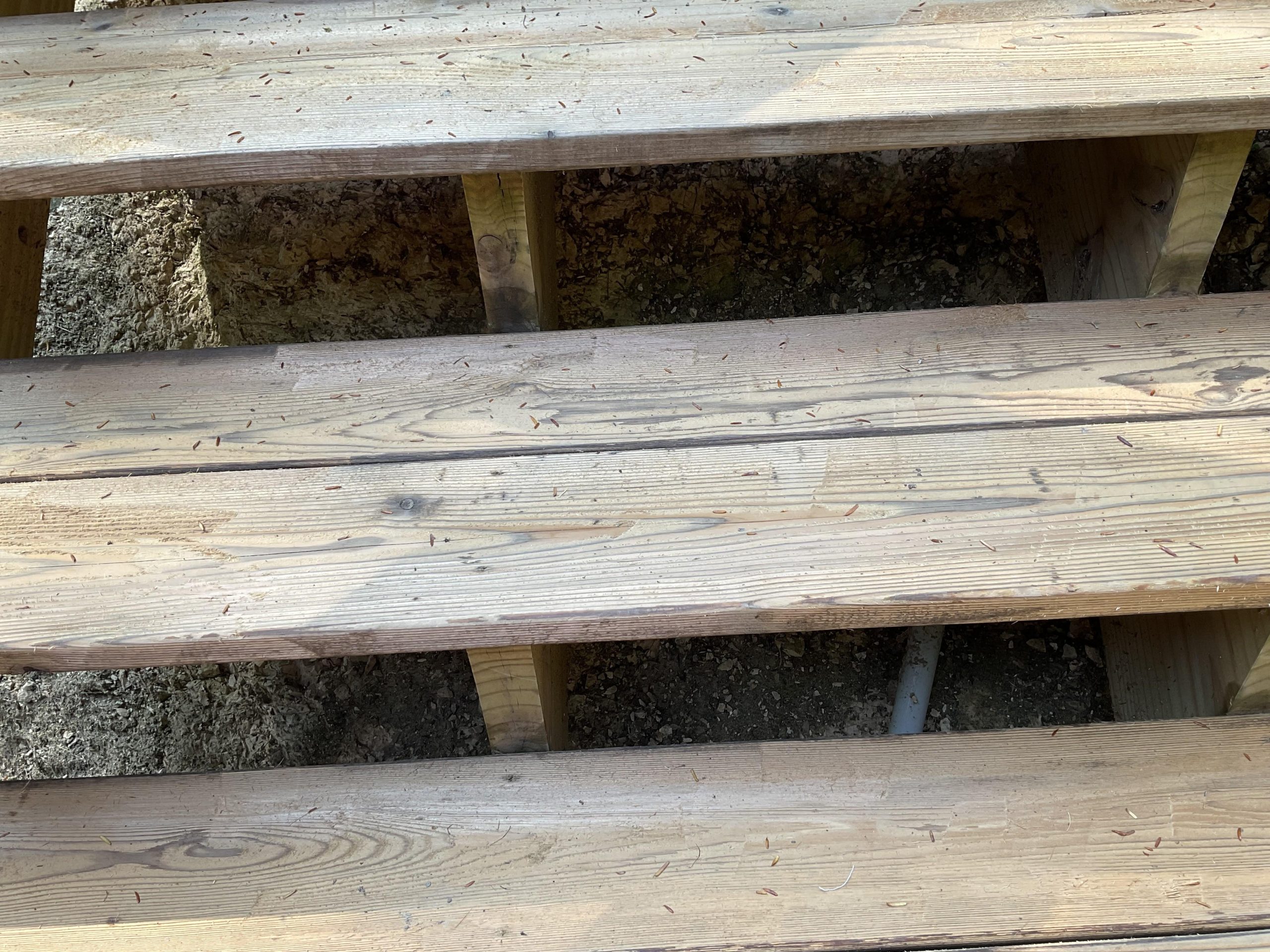

3 years ago we put Penofin Penetrating Oil on our cedar deck. We do not like how it looks and want to stain the deck. I assumed we would need to strip, because we are changing products, even after power washing. However, after reading various questions and answers, I am not sure if we need to strip or just clean. Please see attached pictures.
