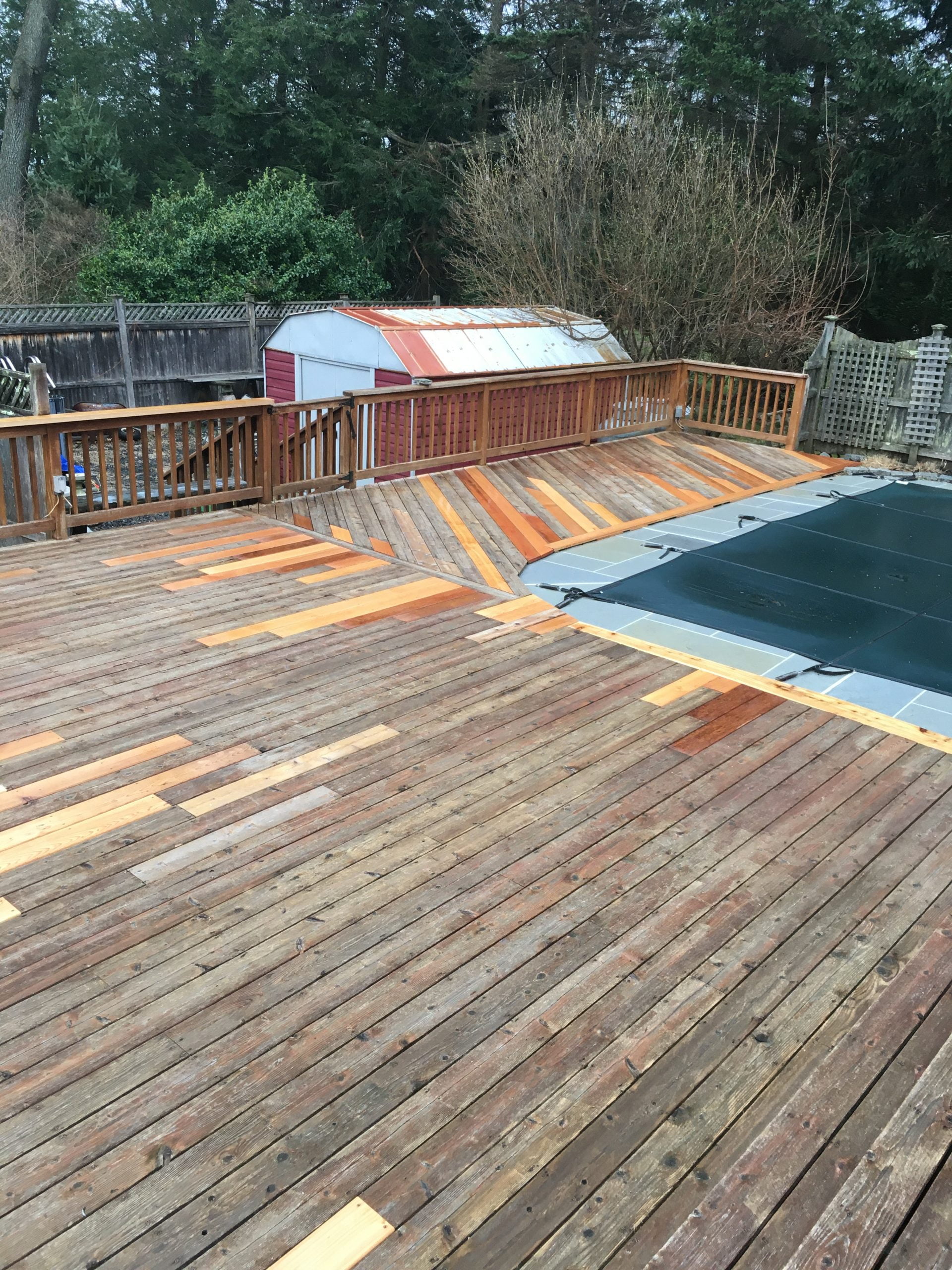

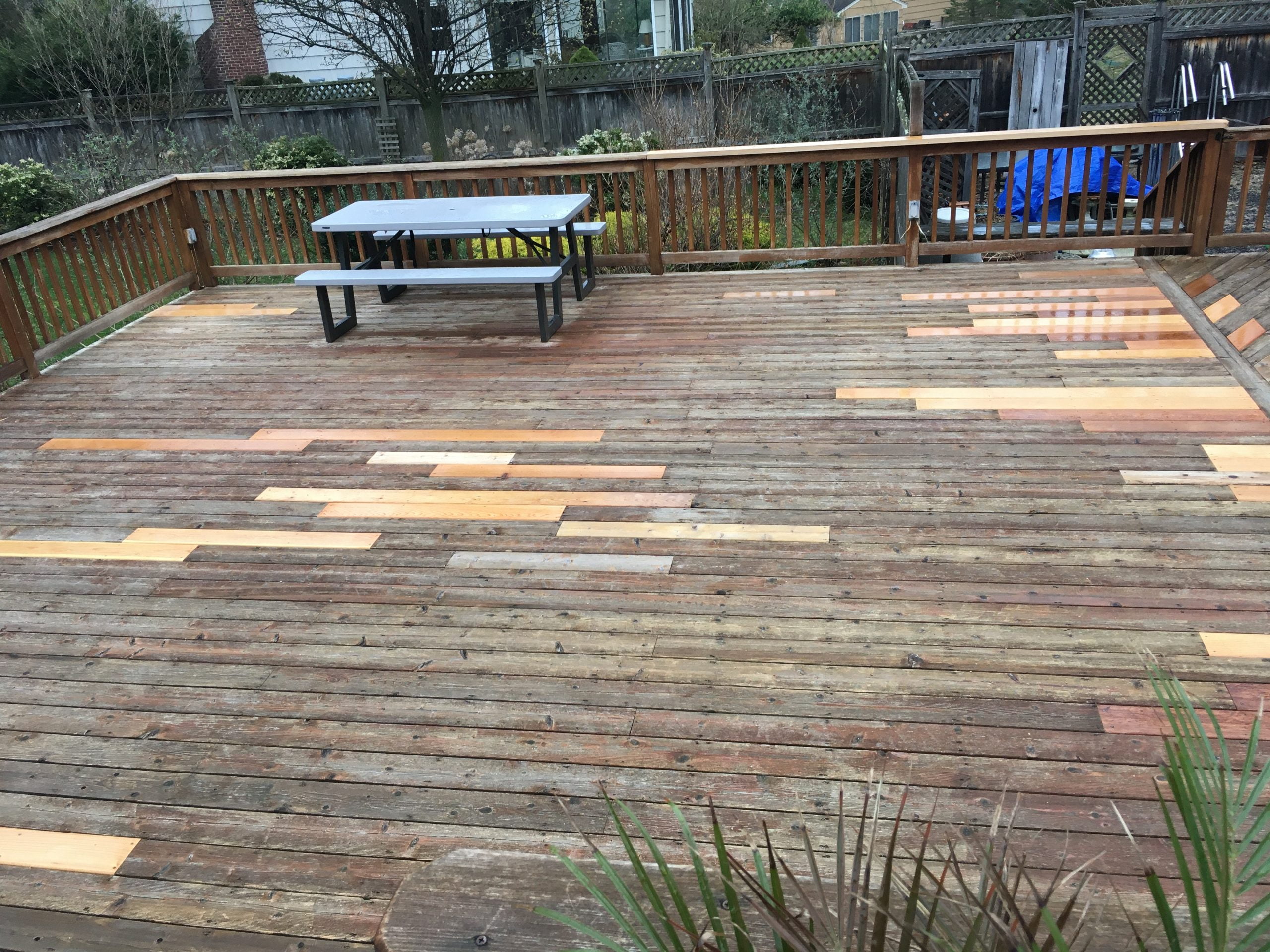

I am power washing, sanding and staining my deck (unsure of age, guessing 10 yrs+), which appears to be pine. Many of the boards need to be replaced, so how should I go about stain application? One coat on new, two on existing boards? Or do I replace them, wait three months, and then do the entire thing wet on wet? We are in New England, so that would put staining at the end of October, which seems dicey. I wanted to use the Defy semi-transparent based on the reviews and mold resistance.
Wait 3 months, prep, apply one coat to all wood. Next year, lightly wash and apply another coat. https://www.deckstainhelp.com/staining-a-new-deck/
