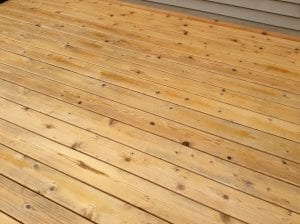

The best deck stain to use for a non slip surface is a semi-transparent penetrating deck stain. This type of deck stain protects the deck just like a solid stain but leaves the wood grain bare. This means that the surface is a bit rough like lumber even though it is protected. A solid deck stain forms a film over the surface of the deck that can be slippery when wet. DeckStainHelp.com experts do not recommend making solid deck stains non slip with sand or other grit.
- Semi-transparent penetrating deck stains are the best choice for a non slip surface on your deck.
- Penetrating stains protect the wood while leaving the wood grain exposed, creating a naturally rough, grippy surface texture.
- Solid deck stains form a film over the surface that becomes slippery when wet, making them a poor non slip choice.
- DeckStainHelp.com experts advise against adding sand or grit to solid deck stains to improve traction.
- Penetrating stains offer the same protection as solid stains while maintaining safer, more slip-resistant surface conditions.
