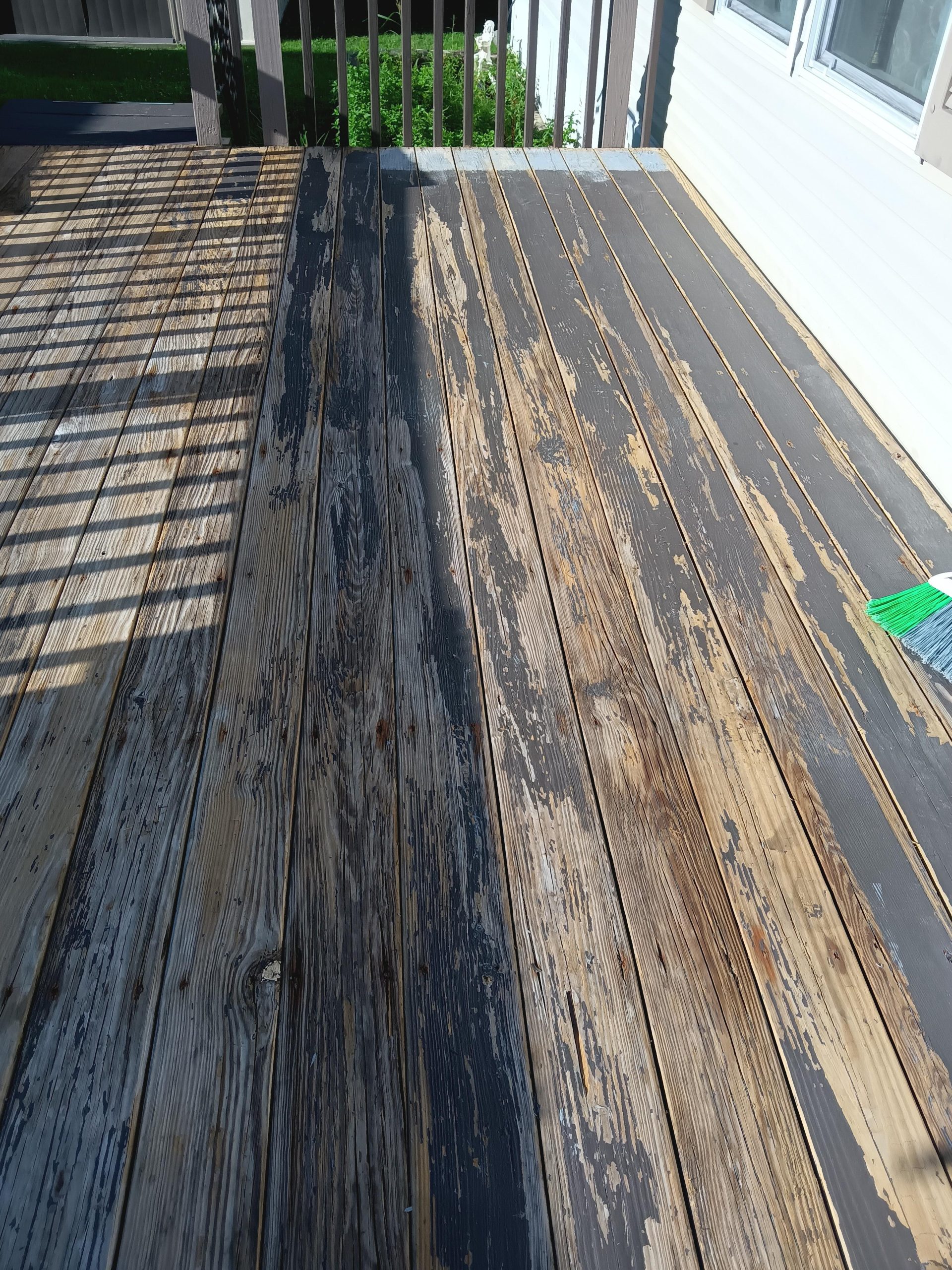

My 16 x 12 pressure treated deck is over 20yrs old – (purchased home in 2020) my neighbor informed me it had “never” been taken care of. I had to paint/stain it – HOA insistence.. I used slip proof deck paint for safety reasons. 2025- I have scraped lots of paint off after reading don’t sand pressure treated wood?? I now must sand the remaining that wont come off ( about 8% of the entire deck) paint stripper was of no good use! Luckily the boards are in quite decent shape otherwise. So after all that hard work, I need good advise, What stain should I use? semi transparent or solid ? oil or water based? , I don’t really care if I see wood grain or not preservation and longevity of the stain is much more important. I live in the NE so snow is an issue, I have to use snow removal pellets “Salt” in the winter time. -suggestion on what kind would be very appreciated. PS note to any readers, slip proof paint is not all that is cracked up to be.
Kathy
Kathy
I hope my pics came through
