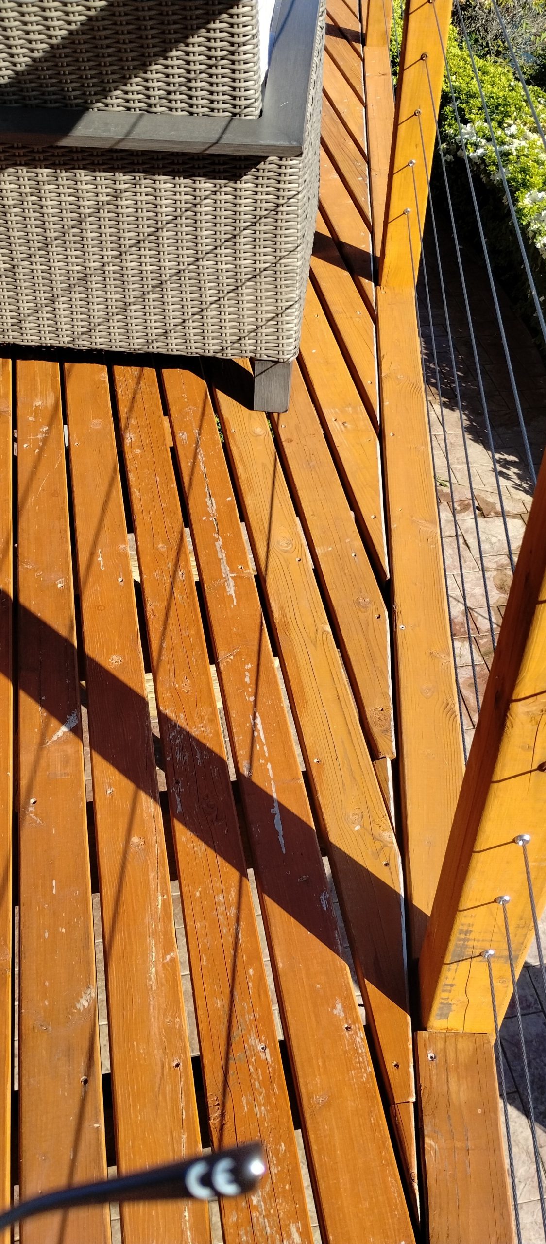

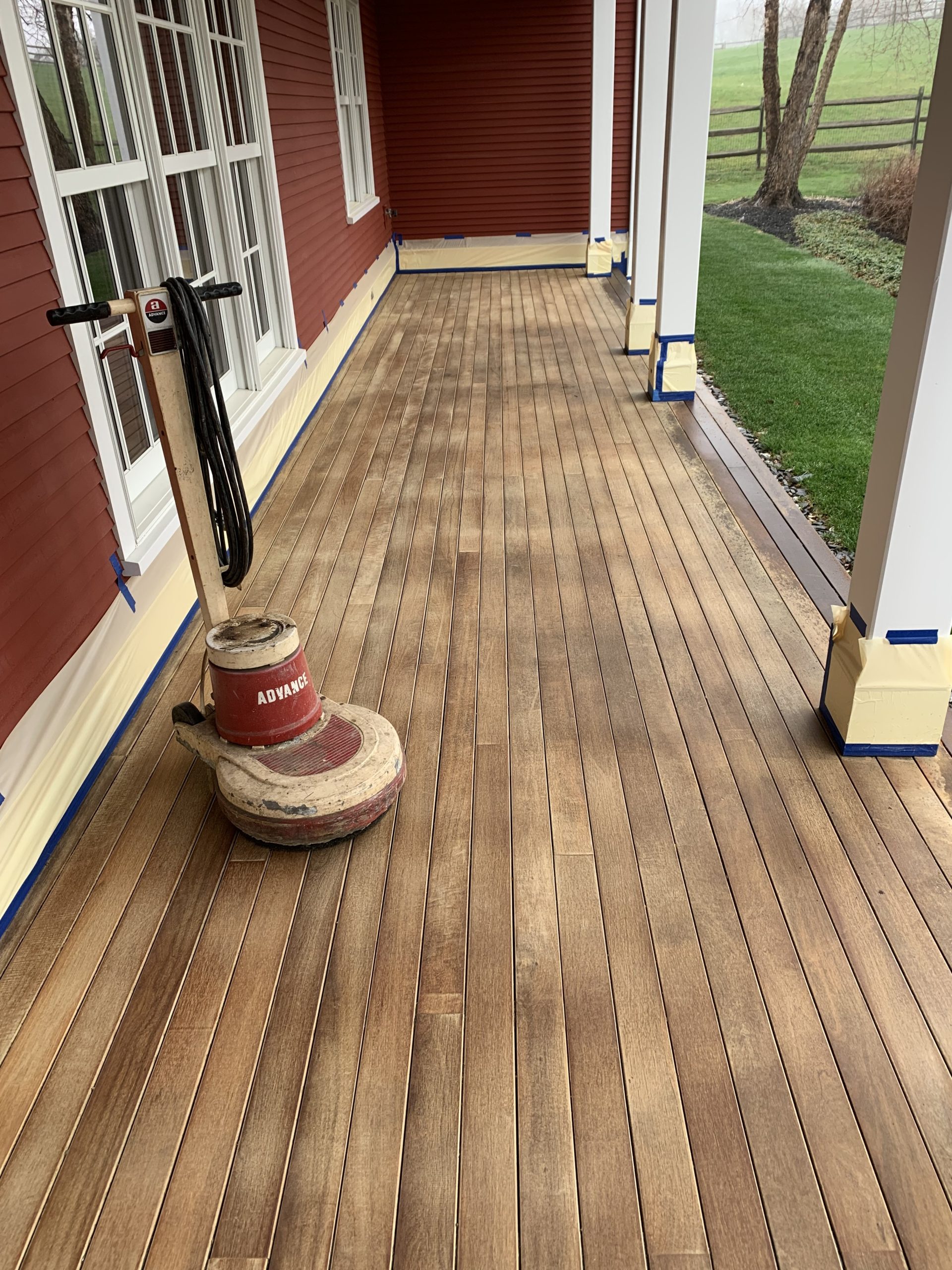

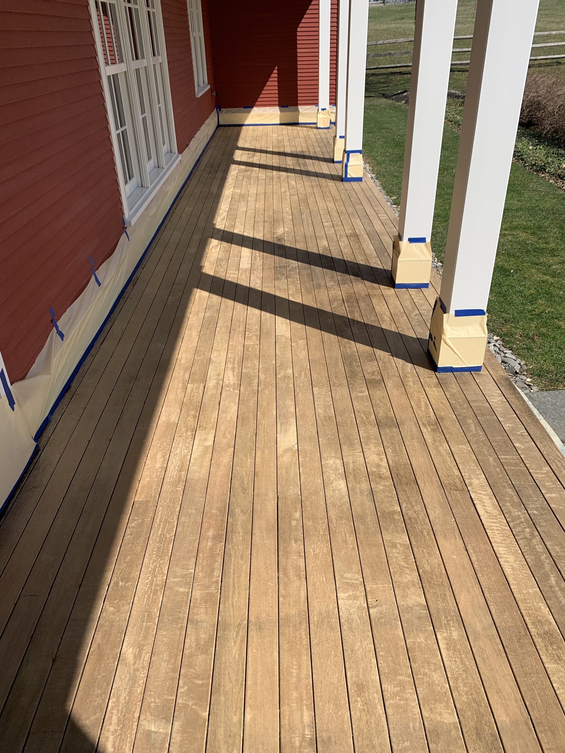

Hi Scott, I forgot a couple questions from an earlier post.
My porch looks almost exactly like the attached image from one of your articles.
If I use the RAD Brightener and Semi-Transparent stain, they both say
it is OK to stain on a wet (damp) deck.
Do you agree with that procedure or is waiting a couple days for deck to totally
dry after brightening a better approach for the RAD Semi-Trans stain?
Thanks again!!
That is a solid stain. You can apply it to damp wood or dry wood. Either works.

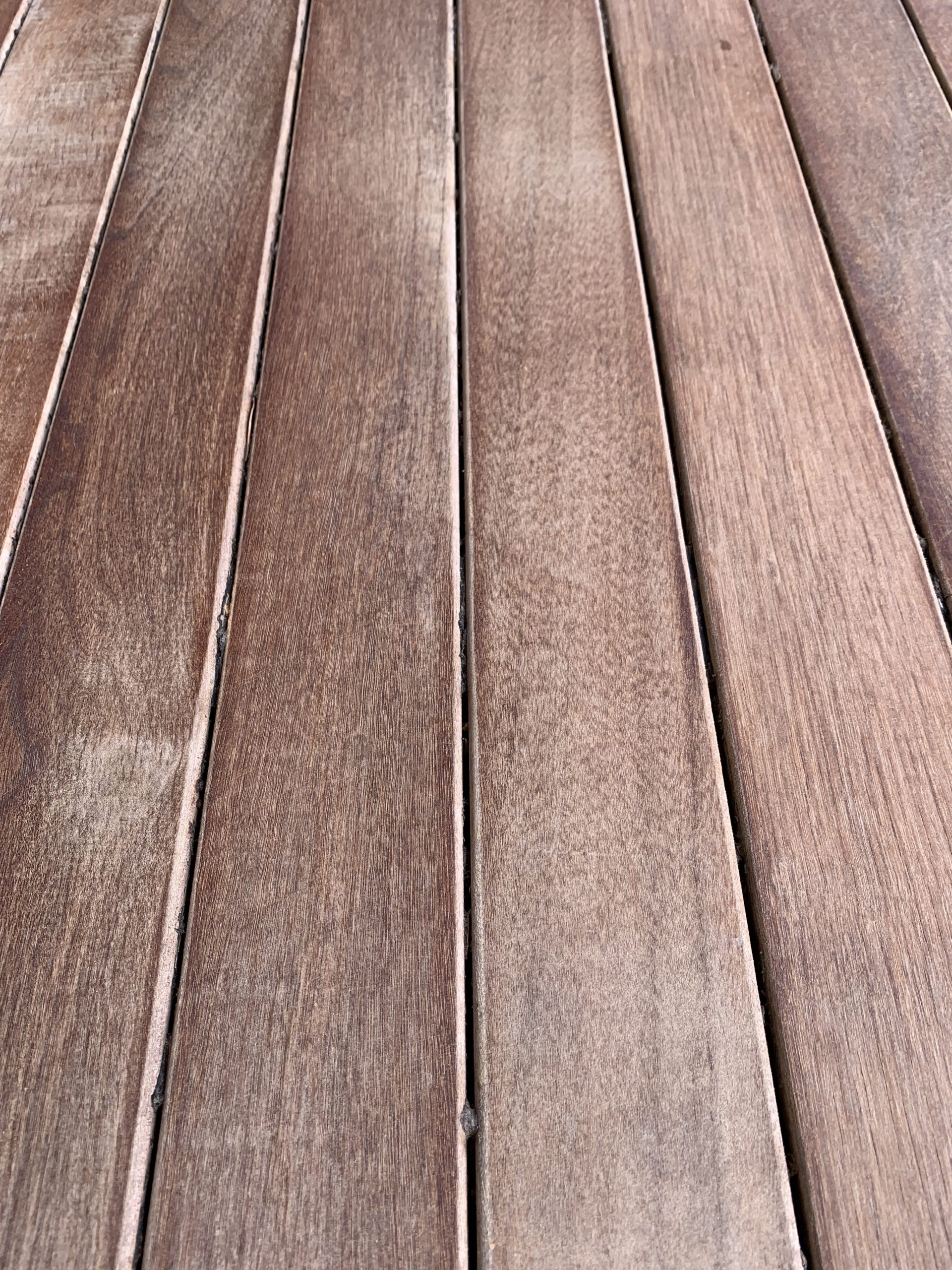

Hello Scott and thank you for sharing your knowledge, it is a BIG help having this guidance.
I am working on a very small front porch…9′ x 5′.
I have removed and orbital sanded every one of the 26 balusters using 60-grit discs.
I also used the orbital to sand the railing area, then found all your info!!.
There is some remaining solid stain on the railings which, from what I have read, does not need to be sanded off. Is that correct?
I am buying the RAD Paint and Solid Stain Remover to use on the deck boards which currently has a reddish semi-transparent stain on it.
We will be using RAD Semi-Transparent stain.
Questions:
I appreciate your time and expertise with this!
Trying to wrap this up prior to temps too low here in Rochester NY.😃
Correct — you do not have to remove sound solid stain from the railings if you are going back over it with a solid stain. Scrape or sand off anything loose or peeling, then clean and brighten. The RAD Solid will cover the remaining solid stain as long as what is left is tight and not flaking; any peeling left behind will telegraph through.

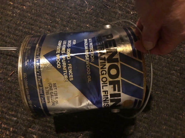

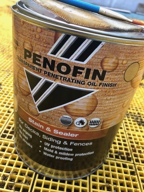

I am going to strip my old stain off using a Cabot wood stripper then pressure wash it and then use diluted oxolic acid as the brighter to neutralize the stripper. I have read if you use OA you then have to use baking soda to neutralize it so the new oil based (Penofin) stain will penetrate the wood is this true? I’m applying the Penofin with a Cabot stain pad. Or is there a better product to use besides OA?
No, you do not need baking soda. The oxalic acid brightener is the neutralizer — that is its job. It cancels out the caustic residue left by the stripper and reopens the wood pores so the stain can penetrate. Adding baking soda after it would only work against that.
Sequence is: strip, rinse thoroughly, apply the brightener while the wood is still wet, let it dwell, then rinse well and let the wood dry before staining.
Would you like a recommendation for a better stain for your situation? Penoign has known issues of darkening or even turning black over time.
Thanks you. This is so frustrating all over the internet it said to use baking soda after brightener. I even spoke with my local paint store they also recommended it. I had already purchased Penofin so I have to use it as the return date had passed. If you know of a better stain that I can use over Penofin next time great. I live in CA not sure if that makes a difference.
Skip the baking soda. The brightener is the neutralizer — that is exactly what it does after the cleaner or stripper. Adding baking soda on top of it just works against the acidic brightener and leaves residue on the wood.
As for next time: you cannot stain over Penofin. It has ongoing issues with darkening and turning black, and it will have to be stripped and brightened back to bare wood before any new stain goes on. Once it is off, TWP 1500 Series and Armstrong Clark are both compliant in all 50 states including California. Restore-A-Deck is another option — it is water-based and has no VOC restrictions anywhere.

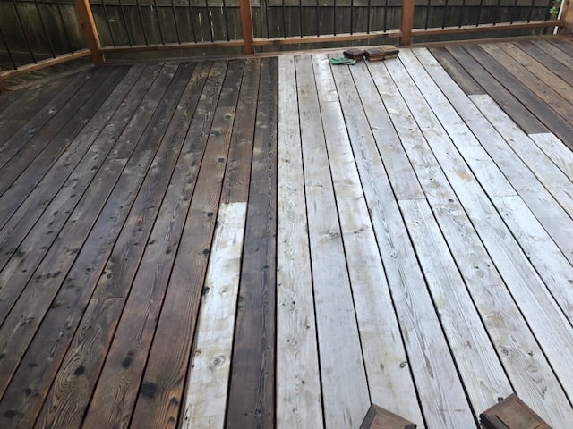

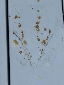

Used rad stripper like you suggested, applied with brush and started scrubbing once I’d finished a section so maybe 30 mins and the deck is all patchy with dark areas from the stripper. This is old redwood that I freshly sanded last year and put two coats of ready seal down which was wearing. I wouldn’t mind if it all turned dark but it’s really patchy and you can see where I occasional splashed the stripper from the bucket- not happy Anna very worried I’ll have to let it dry and sand AGAIN! I daren’t try the brightener in case it just brightens but leaves it as patchy as it is now as ship water in so don’t want to waste time if I’ll have to sand it anyway!
Do you have pictures (you can add them in the comments) of what is done so far? Did you pressure wash after applying the stripper? Scrubbing is not as effective as pressure washing, and the outcome can vary depending on the stain brand and type being removed.
FYI, it is normal for the stripper to darken the wood as it raises the pH balance. The brightener neutralizes it and lowers the pH balance.
So I just scrubbed it as sanded last year and hosed it with the hose on jet but you are right the brightener helped immensely. Phew was scary for a while as looked almost burnt black where the bucket had sat or where is splashed it.

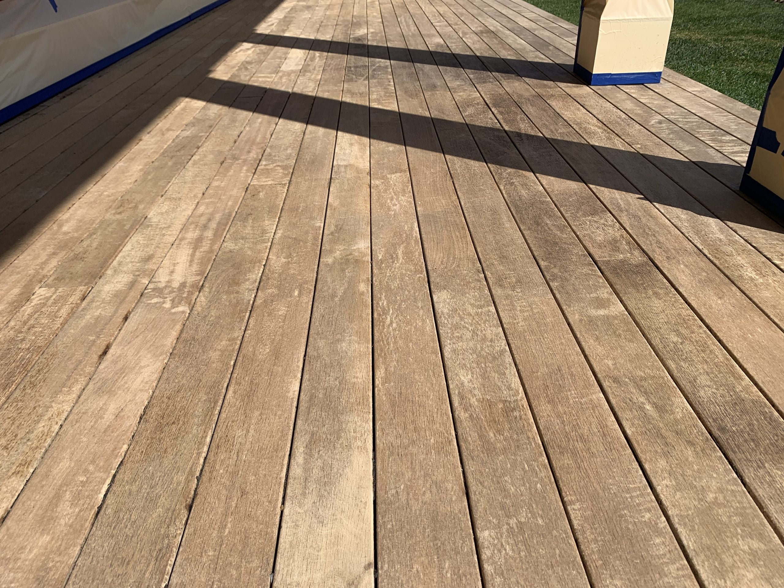

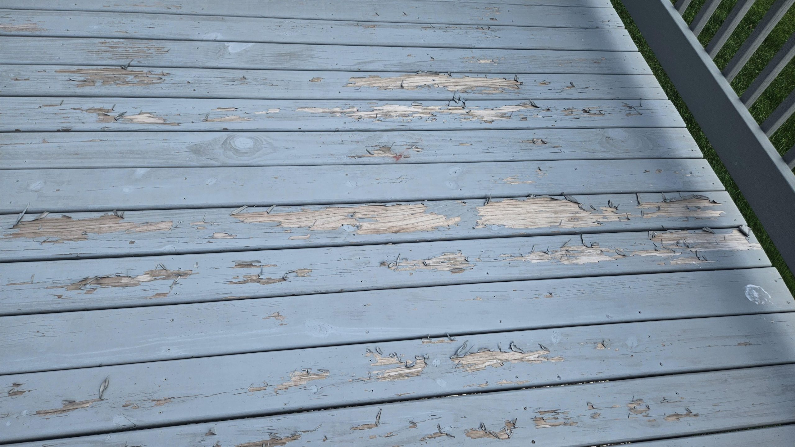

We rebuilt our pool deck in the summer of 2023, with new treated lumber decking, posts, spindles. The deck boards were installed in June 2023 and were left until fall of 2024 to stain using Cabot Solid Color Acrylic Deck Stain. We noticed a little bit of cracking/flaking on the deck boards in 2025 but now the deck boards are in bad shape with peeling and flaking of the stain. The railing and spindles are fine as we did stain them indoors before installing them. We have to do something and don’t know where to start. Very disappointed in that we thought we had used a quality stain and waited enough time for lumber to weather.
Not sure if we want to tackle it ourselves or hire it out. Your suggestions would be much appreciated.
Apologies for piece-meal query. Here are a few pictures of the remnants of stain. I’m betting, though, that the whole thing should be stripped? Also, when I had the old stain pressure washed off, it was then treated by a company called ‘Elite Seal’ with a silicate based concrete and wood sealer he marketed as creating a ‘liquid glass’ barrier to moisture about 1/8″ below surface of wood that would prevent deterioration. I can find nothing on the company now, and what I can find about using concrete sealers on wood is not advisable, so I’m not happy. It was great at first but then the wood began to mildew and I’ve been washing it since.
Use this kit while pressure washing:
With both additives for the stripper:
https://www.deckstainhelp.com/product-category/restore-a-deck-stain-stripper-additives

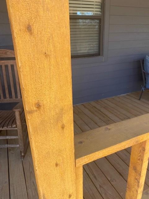

We have raw cedar beams and railings that we stained with Behr last year that seem to be turning yellow/orange to me. I would like to start over and use a high quality stain. Is this possible without ruining my raw cedar beams and railing?
Yes, just strip and brighten with the Restore A Deck Stripping Kits while lightly pressure washing.

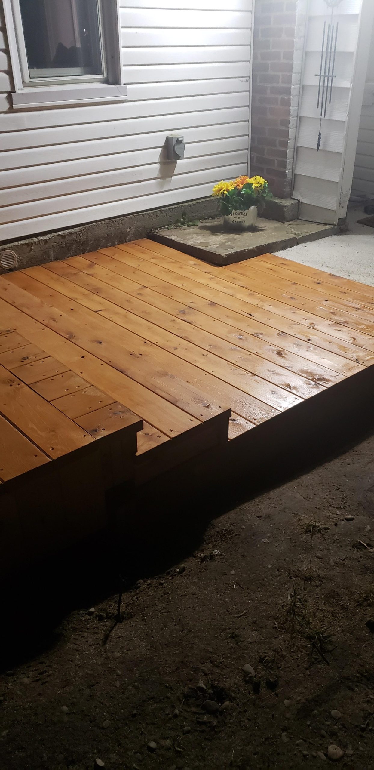

We have a brand new cedar deck. We put Behr Waterproof cedar naturaltone on it and it turned orange. Need to get it off but dont want to damage new wood. Stripper or industrial sander?
Advise please
You cannot stain brand new wood: https://www.deckstainhelp.com/how-long-should-you-wait-to-stain-a-new-deck/
As for removal help, please post some pics.
Pics attached
Newly applied stain is very hard to strip and even harder when it is Behr is it is a film forming acyrlic stain. You could attempt to strip it but you may end of sanding as well to get it all off.

I have a 19 y.o tigerwood deck. In the early years I cleaned and stained yearly. Life got busy and now it has been at least 5 years since last treatment. My questions for you are
1. I am planning on sanding rather than chemical stripping. What order of activity do you recommend. Sand/clean/brighten/ rinse/ dry/ stain or clean/ brighten/ sand/stain?
2. Grit recommendation and sander type for tigerwood
3. What is the best stain product and color to return the wood back to its original beautiful state. Thank you!
1. Clean, let dry, sand, brighten, then stain.
2. 60-80 tops.

I had my entire deck replaced in Aug. 2023, used yella wood. It was stained with gray color stain in April 2024. I live in NW Florida where it gets very hot in the summer. Pitch began showing up as soon as summer hit. In all the years I’ve had a deck and have had boards replaced, etc., I have never had this happen. What is the best way to remove the pitch and is there any way to do it without harming the stain. Also, should I wait until cooler weather. Thanks!
Sap leaching out. It cannot be prevented and you cannot remove without without having to recoat. Sand and scrap it off and then recoat the affected boards.

I have a large deck that is painted with a solid color stain (previous owners didn’t take care of this house). You can see there are two colors going on here. What do you recommend for removing absolutely all color? There are also a lot of areas with wood rot that need to be replaced. I want to get our deck back to a beautiful brown wood stained color.
Strip off as much as possible and then sand the rest as needed.

it’s great you’re providing this resource! The deck I am working on is a hardwood deck that has been stained with an oil semi transparent stain every year for the last 15 years. Some of the decking was black before I started this project. So far, I have used a stain remover, followed by a wood brightener. I have not achieved my desired appearance yet. Can you please provide advice on how to proceed? I have attached photos.
It looks like you “furred” up the deck from stripping. See this for tips: https://www.deckstainhelp.com/wood-fuzzies-furring-on-deck/
Just following up to say that it’s looking much better. I used the floor buffer with 60-grit mesh sandpaper and a scrubbing pad as backer on the entire deck which really helped to bring back the wood grain appearance I’m looking for. Is it ready for stain, or should I do something else before that? The look is a little inconsistent, but the stain will probably blend everything and make the inconsistency disappear.
Brighten all wood for final prep.
I had a new deck installed 3 years ago. I treated all the wood with Penofin (clear) blue label at that time. It, of course (now reading your reviews), turned to a dark gray. I used a product called Sun Frog Deck Cleaner to prep the deck for re-treatment. I was unhappy with the Penofin because water seemed to just soak into my deck and I live in Oregon and we have a lot of rain. I then saw that Penofin made a product that was a Stain and Sealer so decided I would try that. They didn’t make it in clear, so I chose the Cedar finish (it is a cedar deck). I should have stopped immediately, but with the rainy season fast approaching, I figured I just needed to get something on the wood. Now, however, I just can’t stand how dark it has made my deck. I need your advice – I have thought about just completing the deck in this Penofin so that when I attempt to strip it next year at least it will have a similar look everywhere. That is, unless there is a product that can completely remove all this freshly applied Penofin. The staining is about 1/3 completed. So, is there a product that will completely remove this fresh stain? Please tell me all the products I should use (it sounds like a brightener is another important step, that I have never used). The TWP 100 series is rated the best on your site so I will use that next time (should I get clear or cedar to get the look that you have on your banner above?). Thank you so much for your help!!
Leave as is and strip and brighen in the Spring. Use the Restore A Deck Stripper and Brightener kits.

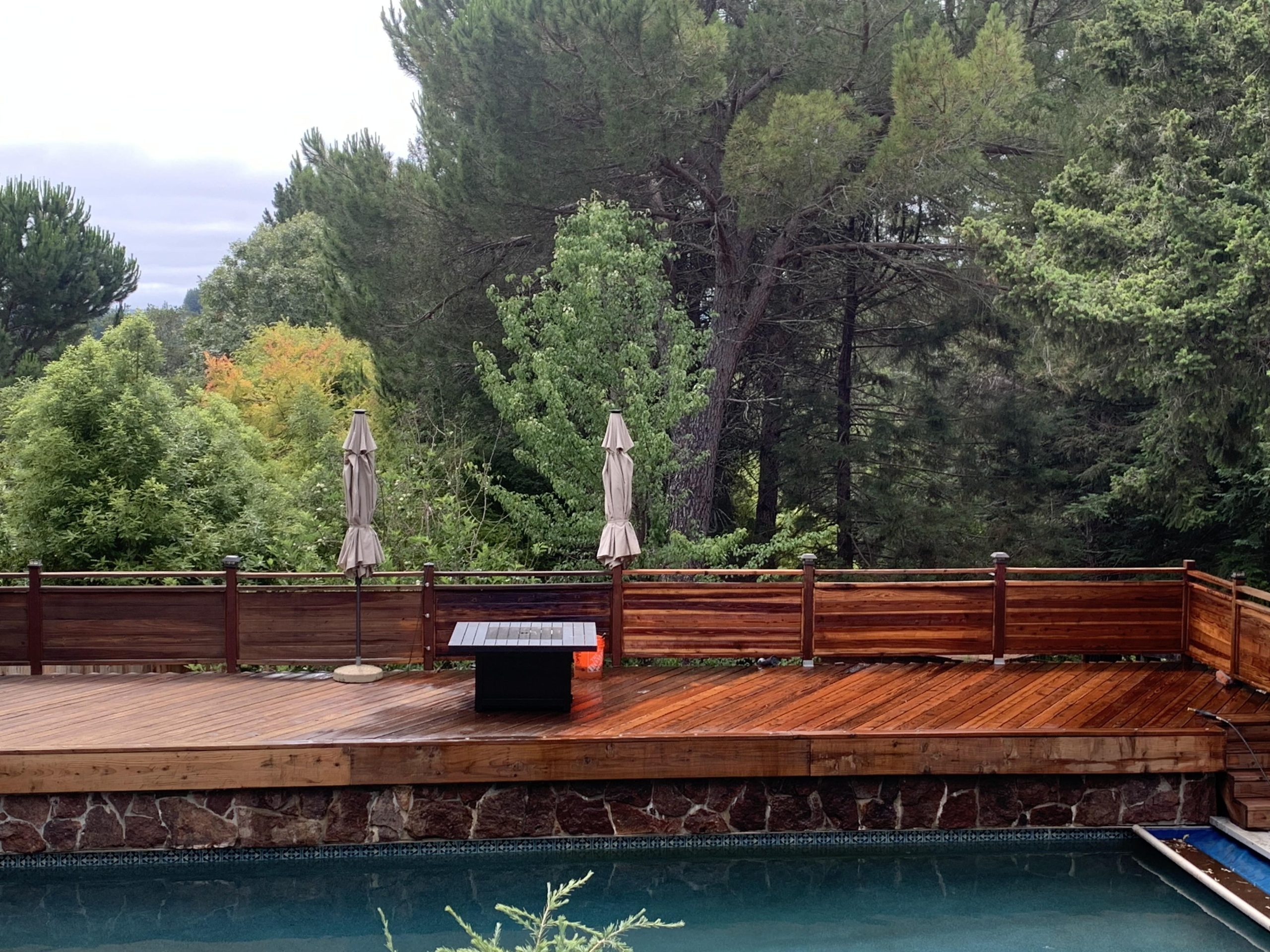

Stripped stain off IPE deck. Decking to the right was done 2 weeks before the decking to the left. Used the same, albeit poor, stain – Valspar. Do I need to sand the decking on the left? Will exposure allow it to eventually blend?
You will need to sand off the Valspar and then clean and brighten all so it is even before restaining.

Here’s my porch with the Olympic Max Honey Gold exterior stain and sealant.
Stripper and then brightener should work.

I prepared my deck and decided on a light red clear stain.My deck has a step down and buts up to my pool deck. I used a brush to trim out by the pool edge and step up. When I used a roller on the deck itself, I got the color I wanted, but the trim area is much darker. What can I use on the trim area to achieve the lighter shade on the deck?
You cannot lighten up the color without stripping and starting over for all.

Just had my deck stained on Monday. The guy had taped something to a post and when he pulled it off, yes, it peeled. I can see the post underneath still has the previous stain…actually a little shiny. He was supposed to prep and stain. I could literally peel the whole post. He used Sherwin Williams superdeck. semi solid. What should I do?
Not much you can do besides sanding everything down to the bare wood and starting over.

My deck is about 8 years old pressure treated wood quite large last summer, my contractor cleaned it with Pittsburgh ultra deck cleaner and restained it with Cabot semi-solid redwood stain. now everything is peeling what do we have to do to fix this? I live in Central ohio.Thanks so much for advice.
Most likely have to power sand this to fix. Feel free to post a picture.
Following up had to wait for rain to stop. Two photos today.
Yes, you will need to power sand this all off to fix.
Ok do after power sanding do we have to do anything else to prep?
Clean and brighten for the final prep.
I have just stained my deck with decking oil, and I hate the colour!! Can I remove it
It was thompson timber oil
We would need more info. Exact brand name and type of stain that was applied. Pictures of deck and product would help as well.
Thompson timber oil
Use the Restore A Deck Stripper and Brightener:
See pic

We purchased our home a year ago. It has a 25 year old deck that had a solid stain on it. We replaced several old boards. We sanded it all which took days and then used a deck cleaner. When we were washing off the deck cleaner we noticed the old stain was still peeling in some areas. Do we need to strip it as well or can we just use a brightener and then apply a solid stain? It was a reddish/brown and we are hoping to make it grey. We have invested 40+ hours (1,000 sq. ft. deck) so want to do it right the first time. Thanks for any advice!
You cannot stain over peeling stain so you will need to continue to prep until nothing is peeling. Strip and or sand. No need to use a brightener.
what do you think is easier, sand or strip? If I strip do I need to sand again? I used a large floor sander on the floor and hand held sander on the rails. Most of it is down to the bare wood but some areas still have small streaks of stain on the floor.
Strip what you can and then sand if needed.
I have had an accident with this product and want to remove it. Any advice on a stripping product please?
Any stripper should work.

Hello, I have a deck with an unknown prior coating. Not sure when prior homeowner last stained.
My plan is too strip, brighten and stain with Flood Pro Series Solid Cedar.
Do you think it will require sanding as well?
Here are some photos that may help.
Dan
No need to sand. Strip off what you can leaving any intact stain. The Flood solid stain will cover it.
Two years ago I put “Behr Premium semi transparent weatherproofing” on my deck. It looked terribly right from the beginning. Two years later it looks really bad. This is an acrylic stain. What can I use to strip my deck? I would prefer to use a product that can be put on, then hosed off with a pressure washer. Is there such a product? Thanks.
No and the Behr stain is not an easy strip. You will need a stripper like the Restore A Deck Stain Stripper and pressure washing to remove. You may need to strip a few times to remove the Behr fully. Brighten the wood after.
Thanks for your help. I accept that it will have to be hand sanded. What can I put on it afterwards so that I never have to deal with this again? I want to protect the deck, but I don’t need any additional color (ie stain) or anything – just protection from sun and rain. What would you recommend? Is Thompson’s water seal a good choice?
You must have color if you want UV protection from the sun. Use one of these: https://www.deckstainhelp.com/the-5-best-deck-stain-reviews-and-ratings/
