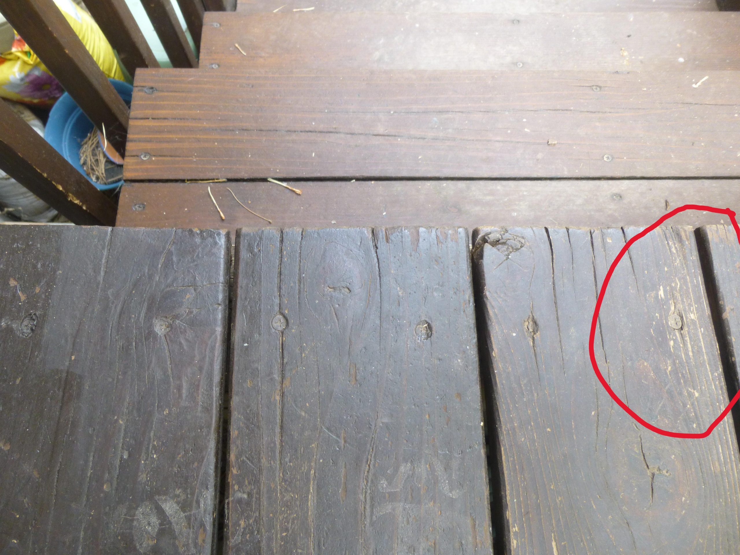

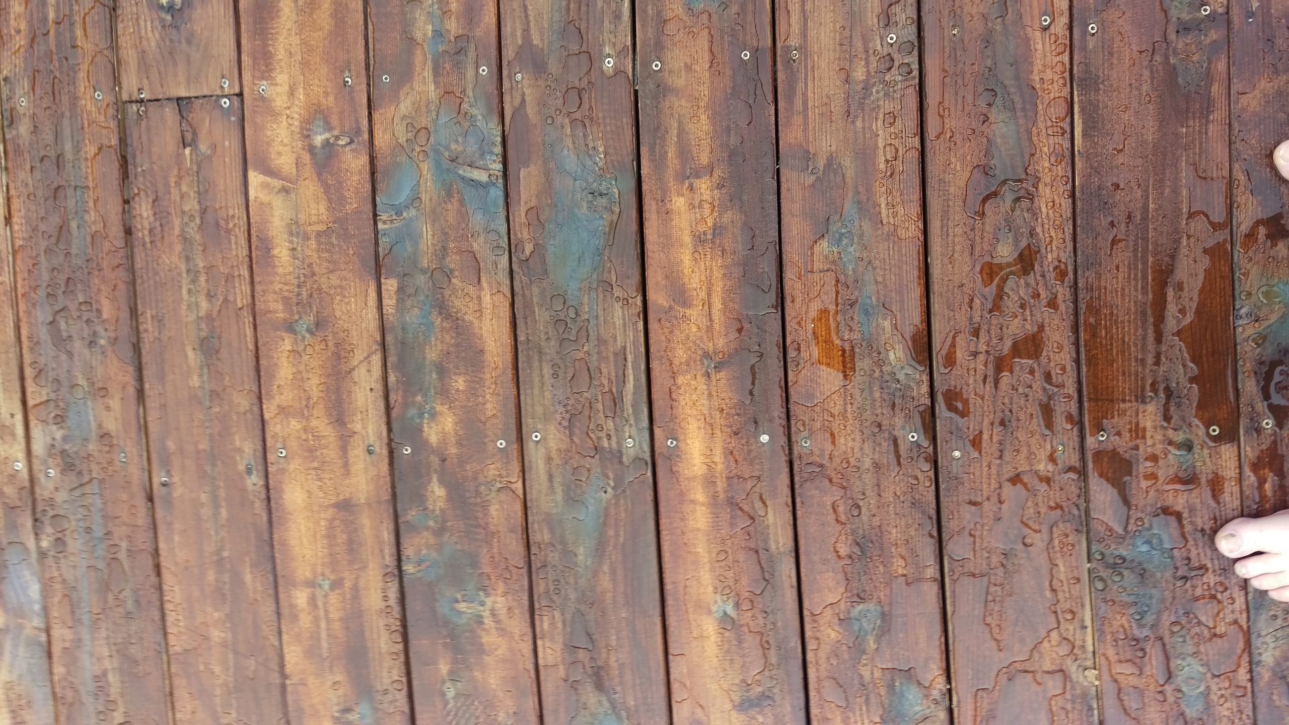

Hi, we plan to stain a 15 year old pressure-treated wood deck. We used Ben Moore Arborcoat semi-transparent oil stain in Platinum color 13 years ago and nothing since (I know, bad). It was high VOC then and worked beautifully. We have just pressure washed and it doesn’t look too mottled…with a few areas still holding on to gray stronger than others. I would appreciate your recommendation on how to proceed and whether BM’s replacement semi-transparent oil product, WoodLuxe, should be a contender.
Thanks for running a really helpful website. I live in the mountains of AZ at 7000ft and get lots of sun, snow, dry, etc so it’s challenging. 20 years ago, I started with Duckback (now Superdeck) semi-trans and it blackened and didn’t last long. Tried Ready Seal semi-trans and it did not last more than a year or so but was easy to recoat. Unfortunately, the colorant in repeated coats added up and I lost the grain. Based on your info, I chose Defy Extreme Butternut 5 or 6 years ago. It has lasted the longest by far (2-3 years on horizontals, longer on railing) but upon recoat I am finding that I am again losing the transparency to the grain, in spite of following instructions to use cleaner and then brightener before recoating. This leads me to two questions:
1) Is there any way to deal with wear in the traffic areas with Defy (i.e. a re-coating strategy)? 95% of the deck often still looks decent and might not re-coating but I’m getting wear in traffic areas down to bare wood. See pic of a darkening re-coated area with some wear spots (not the worst, but it was closest to the recoated stairs) shown next to an area that I just sanded and recoated.
2) Looking again at the pic, is there ANY semi-transparent stain product that is easy to re-coat but DOESN’T accumulate pigment with every re-coat such that the grain gets lost? Maybe this is an inherent function of semi-transparent stain and thus hopeless, but it made me wonder if it’s possible to do a Defy semi-trans initial coat and then re-coat every year with Defy clear – would this work?
P1020617
Thanks very much for the speedy reply. I used DeckWise cleaner and then brightener prior to recoating. I had traffic areas that made me want to recoat, but yes it seemed like the wood did not really absorb the recoat with Defy and instead it kind of sat on the surface.
Is it possible that most of the deck was not “ready” for recoating and is there a solution for this when wanting to recoat?
I am planning to sand and recoat. Stick with Defy or try something else like RAD or TWP?

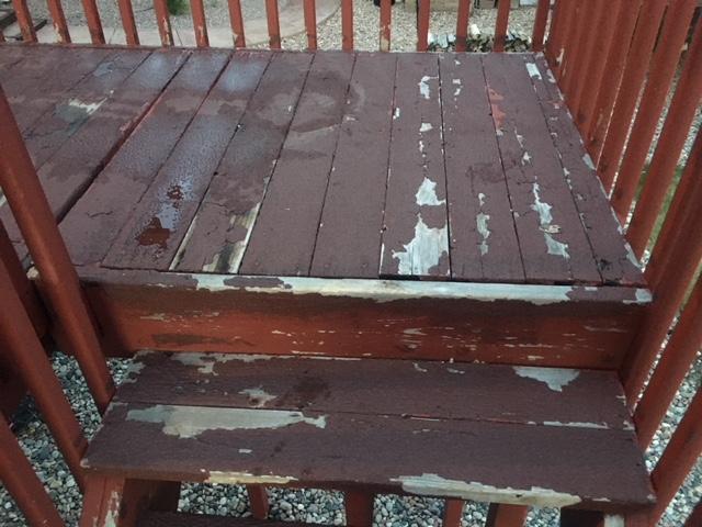

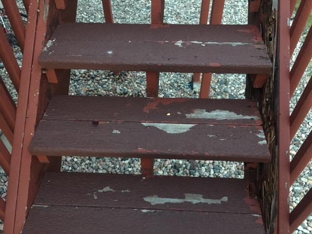

Have a 3 year old cedar deck(2×4) that was originally painted. Would like to stain it. Is it ok to sand it with a belt sander prior to staining? I there something else I should be doing as well? Please advise. Thanks.

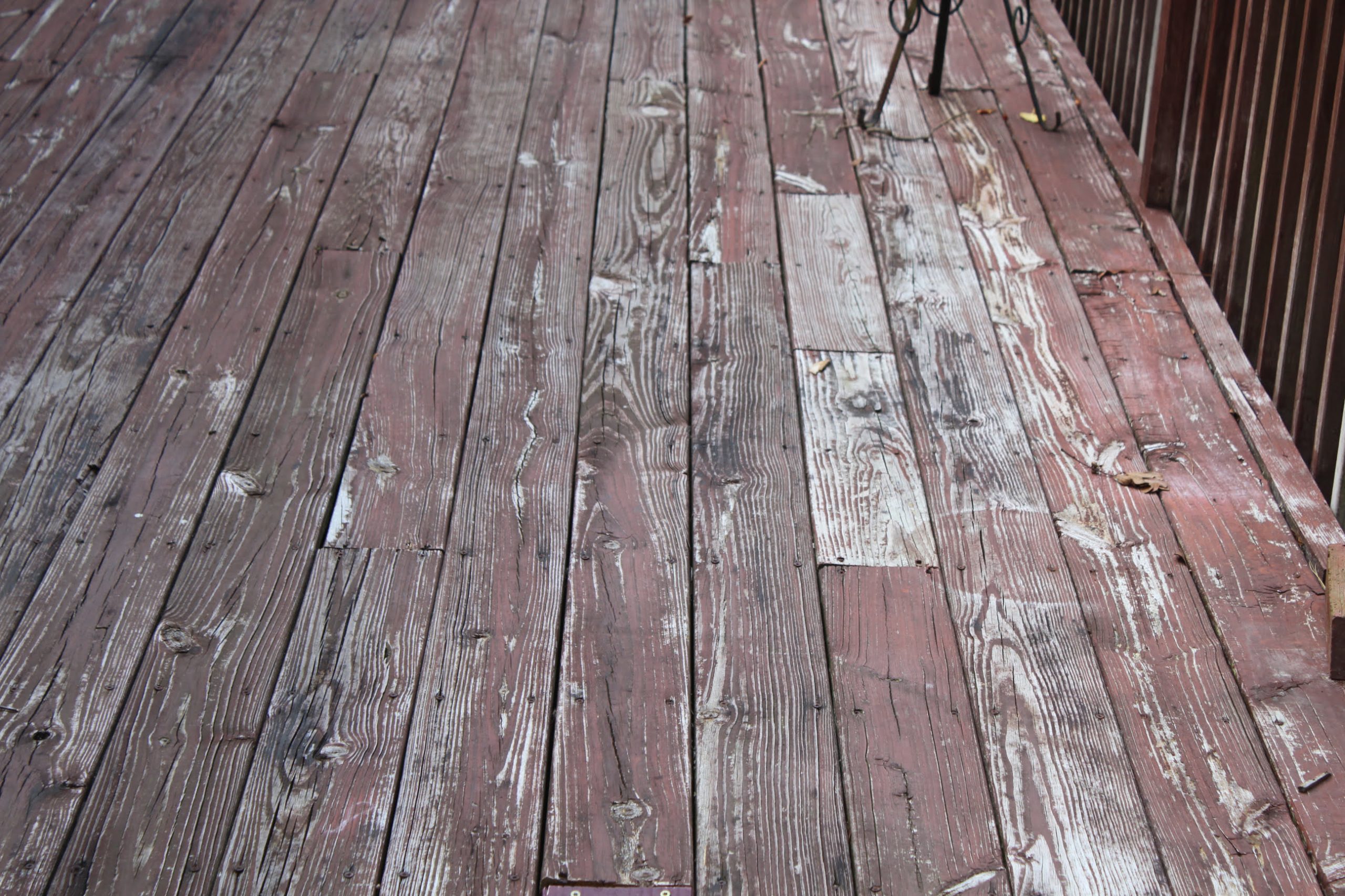

Any issues using Defy: cleaner/brightener/butternut stain on an old deck which was last stained with RAD light walnut @5 yrs ago and is now worn out and in need?
It’s either Defy Butternut or RAD Dark Walnut.
But the nano particles I need!!
I’m not stripping it….

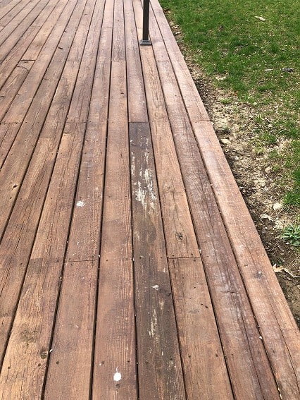

Hi, I’m a new homeowner looking to restore my deck before it gets colder here in CT. Problem is I have no info about the decks treatment until we moved in so I cant tell if it was ever sealed/ stained. I tested with the water pouring test and it seems to absorb it pretty quickly.
  1. Could you tell me if the wood looks untreated and if I’m good to go with my cleaning step?
  2. If i use the Defy extreme wood stain in Cedar tone or Light walnut, will that be okay?
  3. I also have no idea if the wood is pressure treated or the kind of wood used. Is that okay or should i get someone to get these answers?

Phil
Phil
Five year old pressure treated pine deck, mostly shade, very little traffic, one to six feet off the ground with a moisture barrier……..original, first stain Cabot; it peeled. RAD’d with both stripper and lightener and stained with TWP one coat…….it blotched, streaked black, and just generally didn’t look good. RAD’d with cleaner and brightener and re-stained with TWP two coats, wet-on-wet. Got same results as the first time. I again cleaned/brightened and applied wet-on-wet. Same results with some mildew build up [we’ve had a terribly humid, wet summer]. Applied wet & forget after checking with TWPstain who advised it would not hurt surface. Mildew returned immediately.
I just completed a RAD stripper application this week. It stripped maybe 85% but there is no 100% strip anywhere but on the rails.
Is a second stripper application recommended before brightening? Should it strip the remainder? Must it be stripped 100% if I choose to use a darker color?
Does it make sense to try another stain like Defy which is water based rather than oil based and has a mildew resistance and is tolerant of moist conditions?
Picture prior to my last strip job.
Thanks for your advice……this deck is large 44 X 12 and it’s proving to be a real monster.

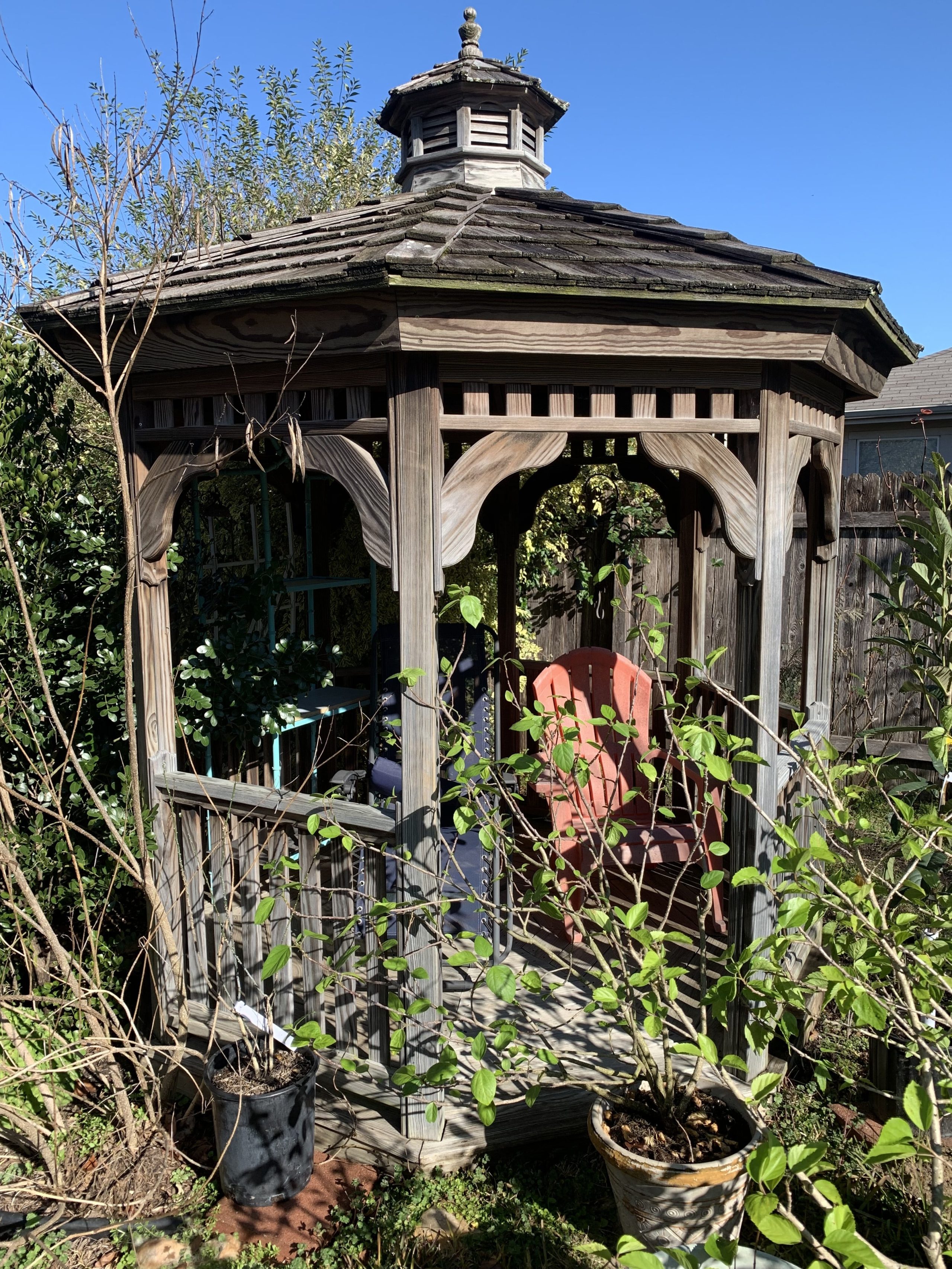

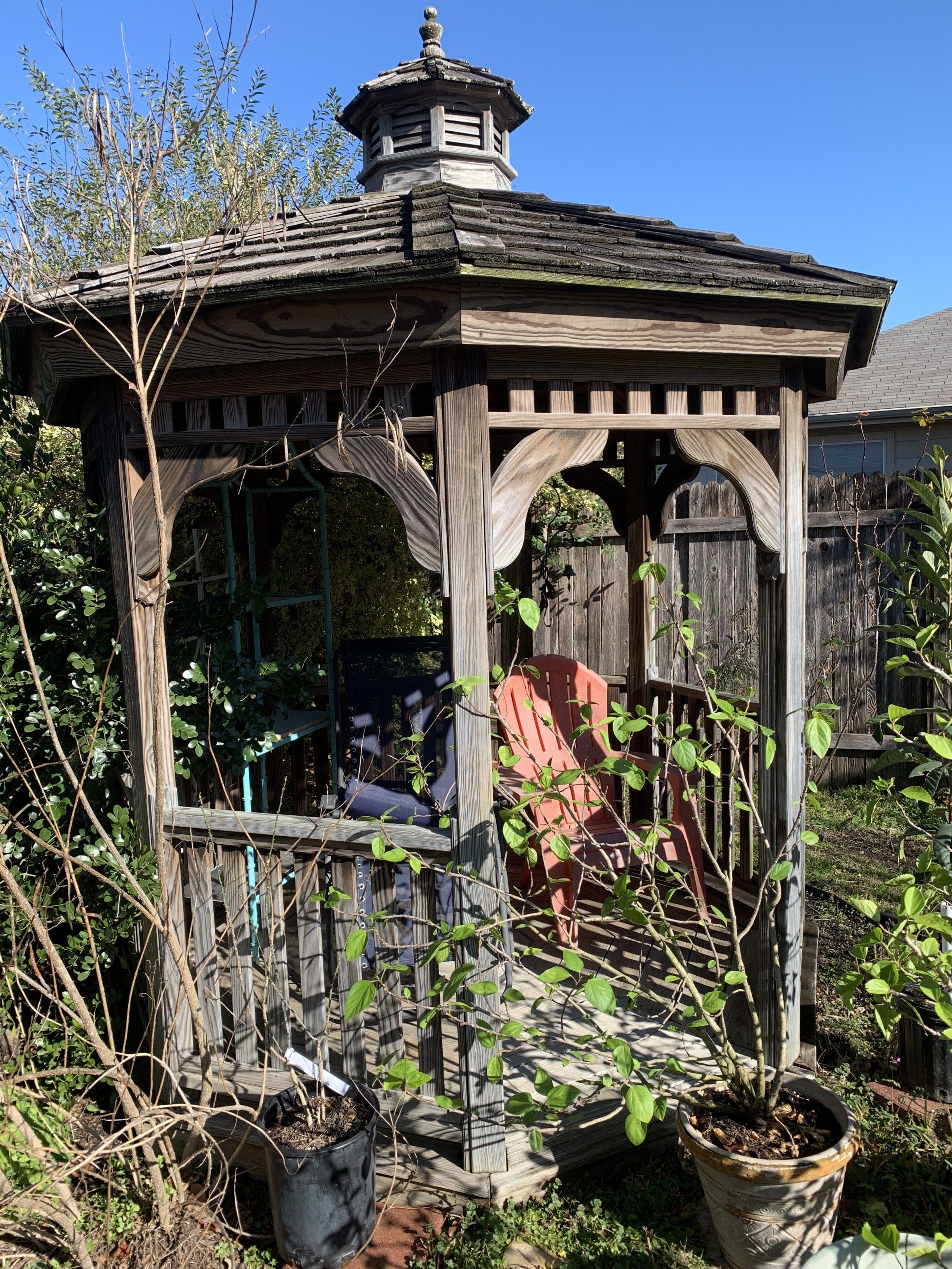

Denise
Denise
We have a 45 year old cypress deck that’s still in pretty good shape. We’ve replace a few boards, also with cypress. It was treated yearly with Cuprinol for about 25 years so it was a pretty weathered gray. It was neglected for about 5 years, then it was stained brown. That has finally faded and we’ve begun to clean and brighten it. Some boards have been replaced. My hope would be to get it back to a natural weathered gray appearance, but I realize that a lot of time has passed and the wood has been neglected. Would Defy clear or driftwood gray be a good choice? Another option would be to match the deck to the house (which is cedar siding with Cabot Seacoast Gray solid stain), but that would obscure the wood grain and be too matchy-matchy. I don’t want to go brown again. The wood doesn’t have to look perfect. I’m really stumped. The photo shows old boards next to a couple of the new ones. Thanks for any advice!

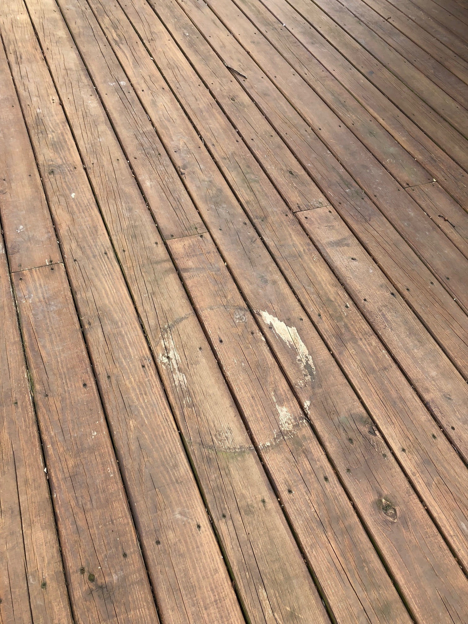

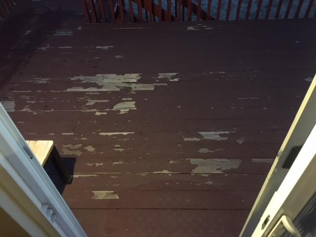

Beth Britton
Beth Britton
Location: Central NY, lake effect snow area
Partial sun AM, Full sun afternoon
Pressure treated wood
No mold or mildew issues
Deck is 4 years old-used Thompson’s water sealer stain year 2-didn’t take, peeled, wore away in high traffic areas. Year 3-current stain is Cabot Gold stain. Same issues-wore away, peeling.
The pictures are after power washing it. We would prefer not to sand it. I’ve read your best of 2020 article and am leaning towards the Defy or restore a deck product lines. If we use the stripper product do we have to use their cleaning product first? The power washer didn’t work to get the stain off of the spindles, what would you recommend? Lastly, what’s the best way to apply? I used a power sprayer and brush last time.
Beth Britton
Beth Britton
I’m having trouble adding pictures, it’s says maximum file size is 4MB
Beth Britton
Beth Britton
Here they are…
Beth Britton
Beth Britton
Thank you. Which product would you recommend for the stain?
Beth Britton
Beth Britton
When you said it’s excessively thick, did you mean on the spindles or the floor boards?

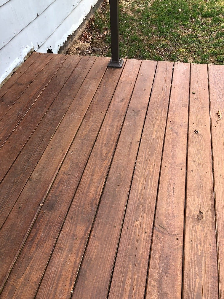

Indiana, Fort Wayne – Deck gets 80% full sun, 5yrs old pressure treated pine. I pressure washed the deck and removed current stain. Then applied one coat of the semi transparent light chestnut stain with a brush / roller method. The stain dries up quickly when applying it in full sun conditions. However, the results turned out good. I wanted a stain that was human/pet friendly to use since we have a couple of dogs. This did the trick! I hope it will last us two years before needing to apply the next coat. – Mike

Is this the “light walnut” color?

Yes, this is light walnut. It lasted two years. I recently applied the stain this year. However, instead of using a roller, I used a Woodmates Stain Applicator. Much easier applying the stain and took me about 3 hours to do our 20×20 size deck.

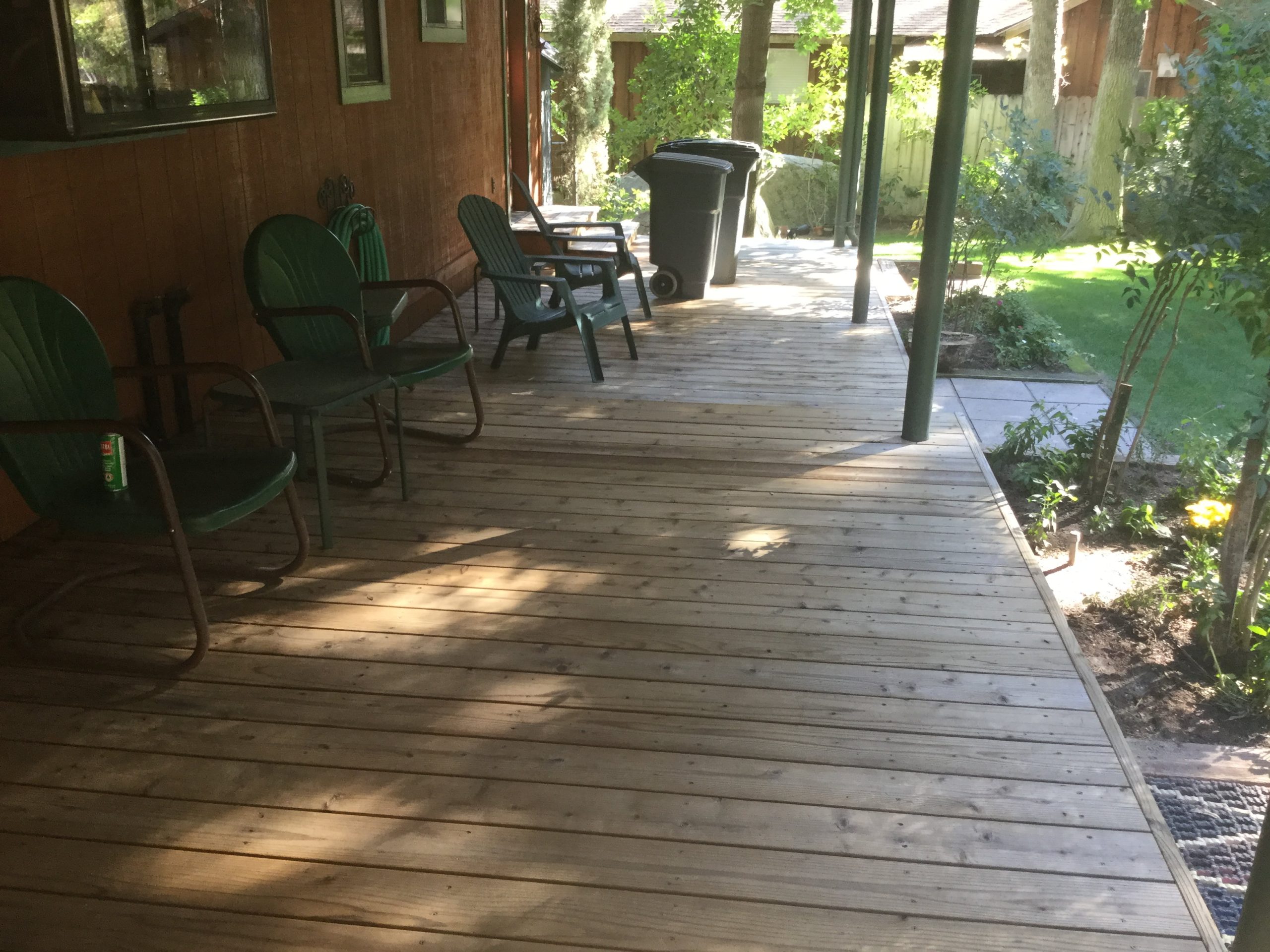

Tina Liehmann
Tina Liehmann
I have a year old Eastern cedar deck that I stained with Benjamin Moore Arbourcoat Translucent natural after it had weathered 6 months (the second deck for 1 month only). I realize from my research now that I should not have relied on the advice of the paint store personnel with respect to deck prep (none) and product. Much of the stain has worn off the horizontal surfaces and is peeling in a major way. There are also a lot of greying and black mold spots.
I will be stripping the deck and then cleaning and brightening it before applying any stain.
I live in Northern Ontario on waterfront property so the conditions include high humidity in the summers and a lot of freezing and thawing in the winter months. Most of the deck is in full sun with no shade. I prefer the look of translucent stain or clear stain but realize from reading up on it now that this will wear too quickly, so I am prepared to use a semi-translucent stain.
I am thinking about Restore A Deck, Defy, TWP 200, Armstrong (staining in the sun). I had planned to use an oil based product because I thought it was better, Am I correct in thinking the water based stains are newer formulations – which makes me wonder if there is enough info yet on how they stand up over time?
What would you recommend for this deck and can you please indicate under which conditions to apply (wet, dry etc.)
Thank you for your help.

Clueless in PA
Clueless in PA
Question/Review: What should I do now?
Almost two years ago we moved into a house with a deck needing some TLC.
What we did: Scrubbed off lots of mold/mildew/algae, sanded off old stain etc, applied Defy Extreme Semi-Transparent. We were pretty happy with how it turned out.
Now: It’s been a year and a half. Obviously there’s been some wear. There is also some significant mold/mildew/algae growth, but, much less than when we moved in. It is on the shaded parts and we do get a lot of moisture, so anything less than a bleach forcefield wouldn’t keep that green sheen at bay forever.
Also, rain doesn’t bead up anymore. not on any part of the deck any more. So, this means it’s ready to recoat right?
What do I do?
Defy Safe Oxygenated Bleach Wood Cleaner, then rinse, then Defy Wood Brightener (same day), then rinse, then let dry for (some days)? Then apply Defy stain (same stain as before)? Is that right?
How long should the deck dry (after brightening) before applying stain?
If rain happens between brightening and staining, do I have to start over with cleaning/brightening, or can I still just wait and stain when it finally dries out? The pH talk kind of confused me, and my current forecast includes rain for 10 of the next 10 days, so, I’m gonna need to know what to do if it rains. (Yes I am waiting for a better stretch of weather than 10 days of rain before I start this project. But still want to know, because rain happens here).
How long does the stain need to dry after applying, in terms of weather– how soon can it safely rain after applying the stain without it affecting the job?

Nita
Nita
I had a brand new deck installed with pre-treated lumber 2 years ago. Last summer I cleaned, brightened and stained with Defy extreme stain and products. This summer I need to do some work on my deck. Can you tell me if I need to strip my deck or just clean it before I brighten and stain? Here on some pics of what is going on with it.
Some places look great, and other places peeled.

My wife and I worked very hard last July and August (2018) stripping, cleaning/brightening our 12 year old cedar deck. Finally, in September 2018, we applied the Defy Extreme Semi Transparent stain. Everything looked great initially. Then 3 months later, we started to notice lots of flaking. All the vertical parts of the deck look fine. But the horizontal parts (floor boards and top railing) have lost a significant amount of stain due to flaking.
I am not sure which brand of semi-transparent stain was on the deck previously. We did remove all the old stain and the deck looked almost as good as when first installed. Needless to say, we are very upset and frustrated. I do have before, during and after pictures but not sure how to include them with this post.
Will someone please help?
Anthony
Anthony
Any suggestions as to how to prevent stripper from affecting areas that are not in need of stripping. (That is, all 200+ spindles, posts and skirting). Sounds like a major project……again! When I rinse off the stripper, it will be everywhere.
Also, When I applied the stain to the horizontal pieces, my application technique was no different than the vertical pieces. All spindles and skirting were removed before stripping, brightening and staining. All this was done horizontally on saw horses and planks.
Thoughts???

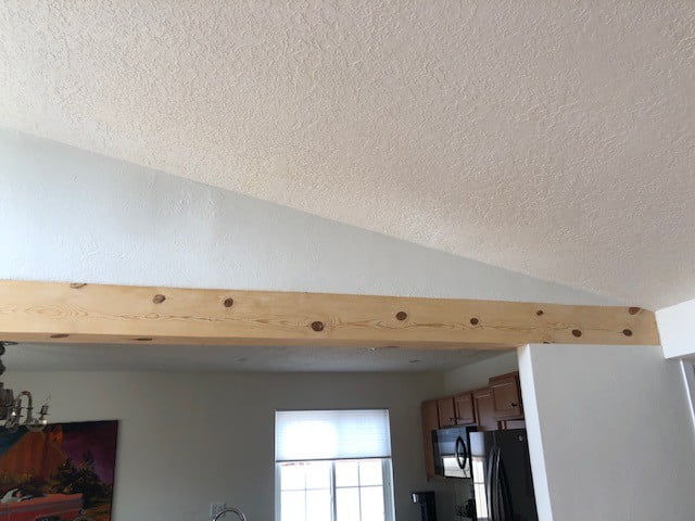

Hello, I have an 18 foot 10″x8″ wood beam installed in my home (Pine I think) and I want to make it a little darker to match the Saltillo floors; which product do you recommend I use to stain it and is pre-treating necessary? Thank You!

I have a gazebo that has never been treated. I am going to hire someone to pressure wash & stain it. Hoping for something to protect it from the hot Central Texas sun, & from mildew from the rain and clay soil here. What do you recommend?
Sheila
Sheila
Thank you for your quick response. I’m so grateful to have found your website. I find your information to be so much more thorough & helpful than the others I searched. Thanks so much!

I have a 20 year old redwood deck under covered porch with some afternoon sun on parts of it (central CA mountains).Deck has never been sealed or stained, I have cleaned and brightened how many coats of Defy Extreme semi should I apply.

We have a pine pressure treated deck. Over the years we have replaced rotted/warped boards. How would you suggest preparing and re staining the deck? The deck is about 12 years old, and about 600 sq ft. Thank you
Paul R Gesche
Paul R Gesche
Yes. Olympic Semi Transparent
Paul R Gesche
Paul R Gesche
What grit sandpaper should be used?
Paul R Gesche
Paul R Gesche
Not sure if my response went through. Just in case, will do it again. Yes it was stained about three years ago with Olympic Semi Transparent Stain. Picture enclosed

I have a 17-year old pressure treated wood deck in CO that has been stained multiple times throughout the years, the most recent being in 2013. Here are pictures of how it currently looks. It clearly needs to be re-stained. Which of the following should I do before staining – pressure wash, sand, strip, brighten?
James
James
Thank you. What prep work should I do before re-staining?
