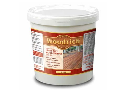

- HD80 earns an overall score of 7.75 out of 10, making it a better-than-average deck stain stripper.
- At $39.99 per container, HD80 makes 5 liquid gallons, costing roughly $7 per gallon covering 150 square feet.
- HD80 contains sodium hydroxide and surfactants, effectively softening stains like Olympic with only light scrubbing agitation needed.
- The formula darkens wood significantly, but pairing it with Citralic Wood Brightener reverses the darkening and restores wood color.
- HD80 is a strong concentrate requiring protective gloves and eyewear during mixing; rinse skin immediately upon contact.
- Testing on a 400 square foot pressure treated pine deck showed 70 to 80% removal of heavily worn Olympic semi-transparent stain.
