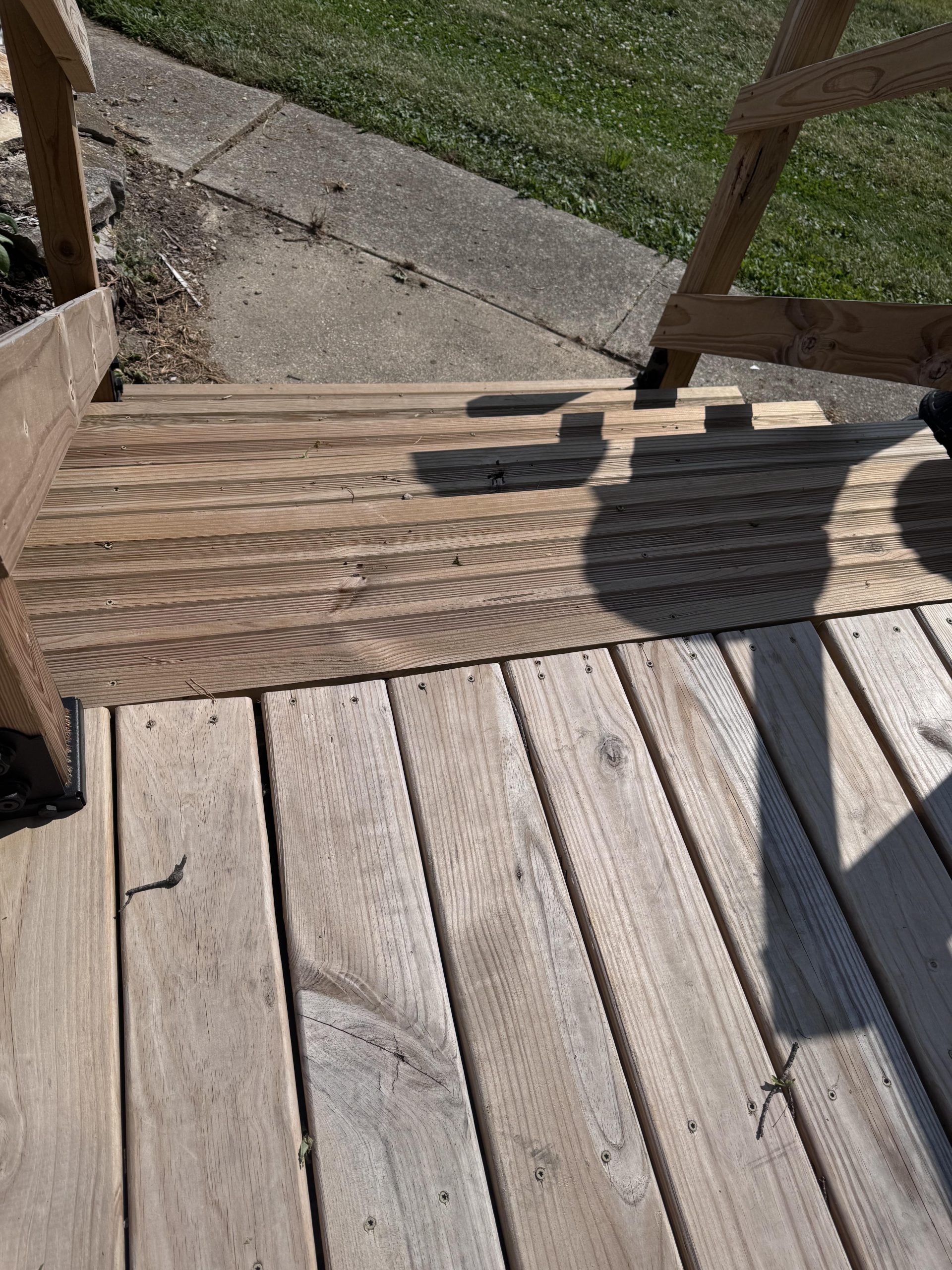

Tami
Tami
3 months ago
Thanks! Also, the boards for the steps right now are a different shade than the deck boards. Will that make a difference overall after staining? Suggestions?

Hi Scott
I had a new 16×20 pressure treated deck installed Oct of 2024. It is now entering Sept of 2025. I’ve been reading many different opinions on staining and came across info that suggested cleaning for mill glaze and sanding to smooth things out. All of the screw holes were splintered as well as many rough knot holes. Made sense to me and I did sand with 80 grit. I came across your site and you indicate to NOT sand. I now have beading water on the boards. Any help on how to proceed would be appreciated. I’m looking to eventually stain with an oil based semi transparent. Should I continue to wait untill next spring and then what?
Mike in South Ohio

Gaurav
Gaurav
This is my new deck and fence both are new installed just 1 week gap week .
What should I stain and what color to use so they match. They installed in August 2024
Screenshot_20240815_234833_Gallery
Screenshot_20240815_234830_Gallery
Screenshot_20240815_234831_Gallery
Gaurav
Gaurav
I read it. For this type of wood should I wait for three months. It will be winters in toronto by then.
And I have to wait for spring for do it . Someone advised me we can do it after 3 weeks. What is ur take on this
