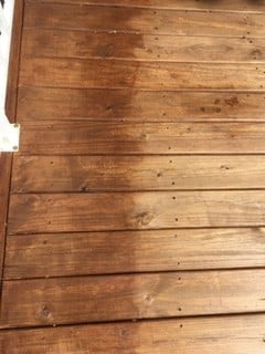

I built and stained my girlfriend’s deck (thin coat) using Ready Seal Natural Cedar Oil Stain on the wood before constructing deck. The deck is made of redwood I purchased the wood from Home Depot. After building, the stained deck looked immaculate. But I can understand how each year it will lose its beauty and start to wear and darken. The deck was built and stained during summer of 2024 (last year).
Please explain to me when I should next stain this deck, I have been told many times after 2 – 3 years. But the manufacturer rep at Ready Seal said 6 – 8 years because redwood is very dense and the stain would not penetrate until after that time due to tannins in the wood that block the wood pores. He told me I can use a powdered oxalic acid to clean and neutralize tannins (after the min 6 years, clean and then stain. He also told me as an alternative, I could stain it now with a darker Redwood Oil Stain because that would hide any discoloring from the more lighter Cedar Stain. (That made no sense to me – why would I stain it this year when he just told me that the redwood material wouldn’t take a stain because the tannins have the wood pores all clogged up).
Yet another rep at Ready Seal told me to stain after 2 – 3 years, use a bleach/water spray, let sit for 15 minutes and then hose wash. Let dry for four days. Then seal with one thin coat.
PLEASE TELL ME WHAT TO DO. I am very confused and do not wish to ruin this deck.
Please tell me what I can stain the deck again using the same original stain. What materials do I use to stain with.
Please tell me when I can do this and how to do this.
Please tell me if I need to clean deck first, what to use and how to do this.

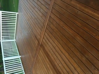

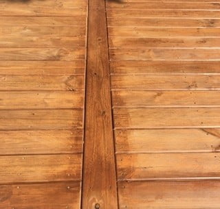

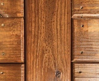

Here is a photo of the deck taken a week ago.
And a photo of the stain I used last year on the redwood.
Thx for any advice u can provide for me. I just want to optimize cleaning and staining to provide the best looking deck saving it from wearing and looking like its has been neglected.

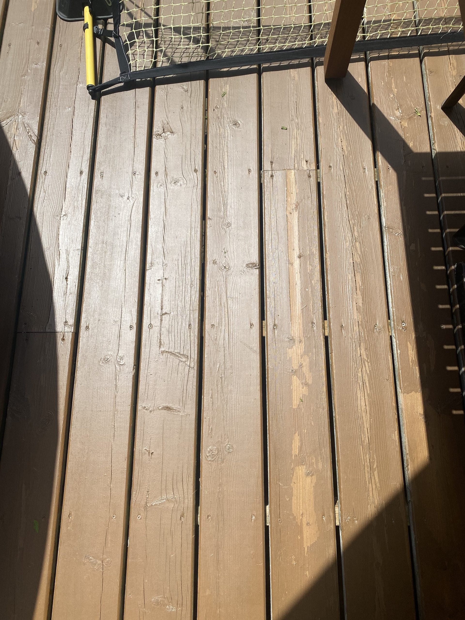

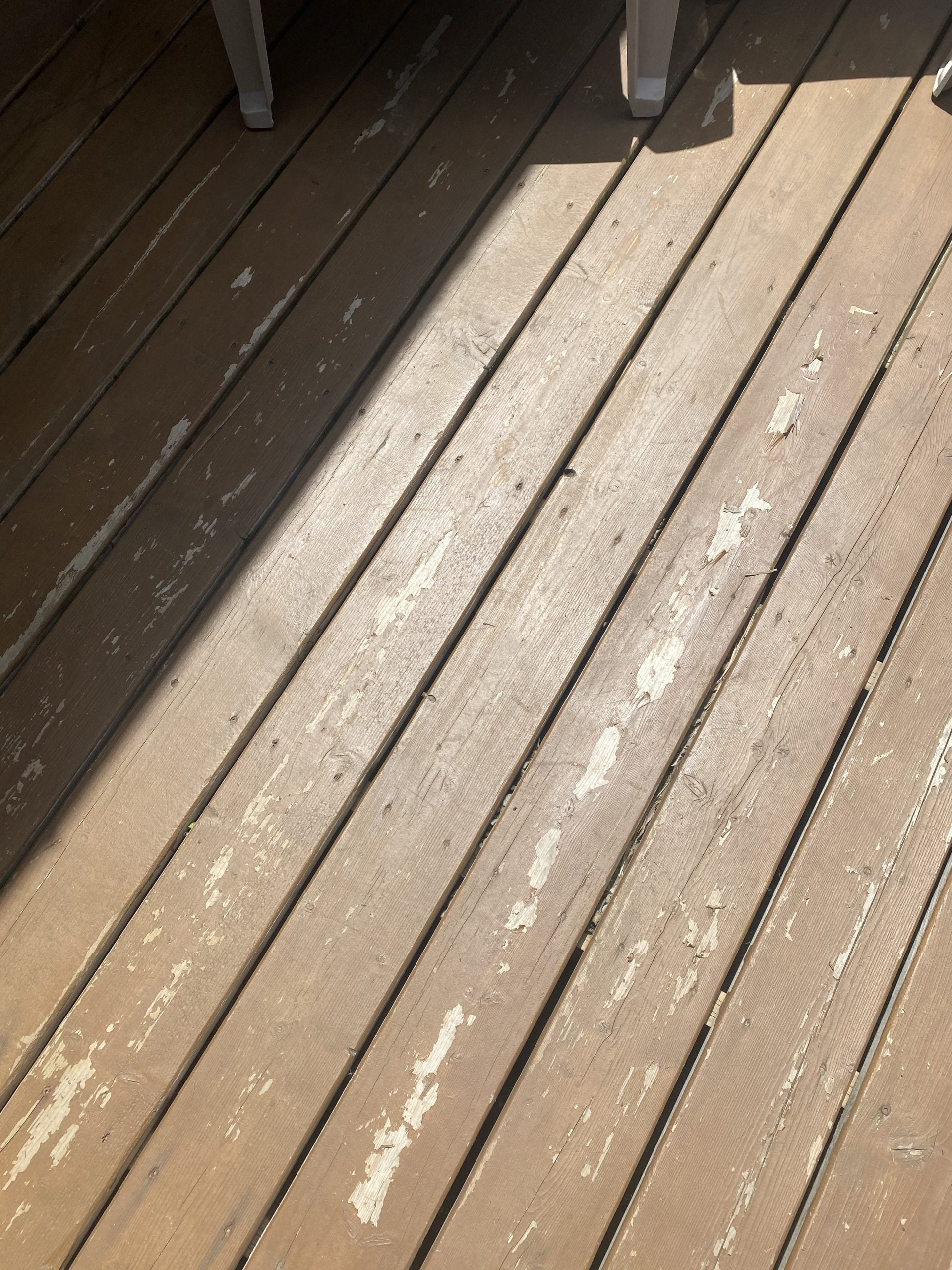

Hi there I have attached a photo of our decks. We use semi transparent stain (cloverdale paint, weather one) Every year, there is peeling of stain in high traffic areas. My husband cleans decks and reapplies the stain every year. I don’t feel it looks as good as it did the first year it was done, the areas of peeling that are restained ate noticeable. Should we be doing something differently? First picture is the peeling deck, second picture is the restained peeling deck (not the same area). Thanks!
