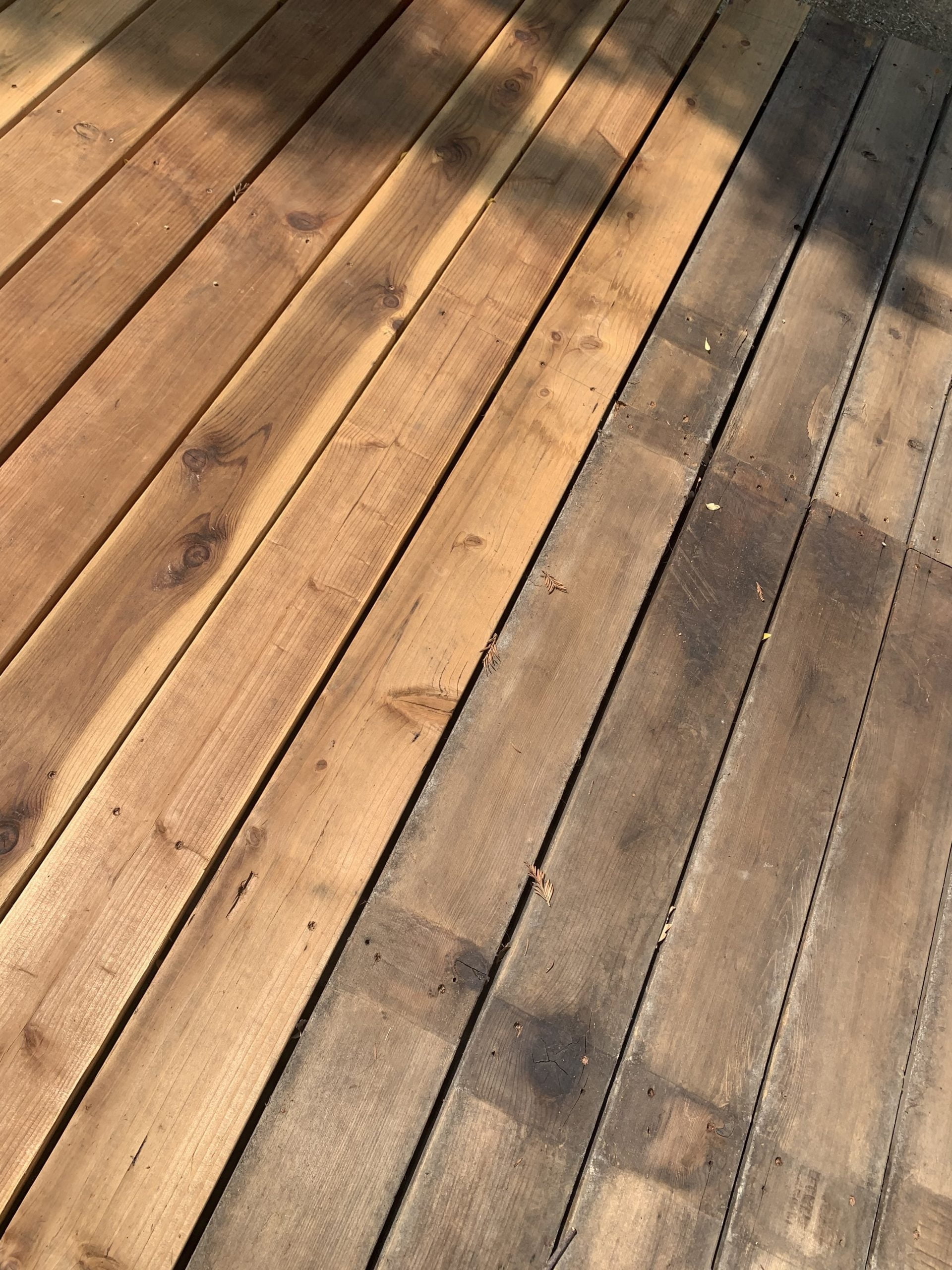

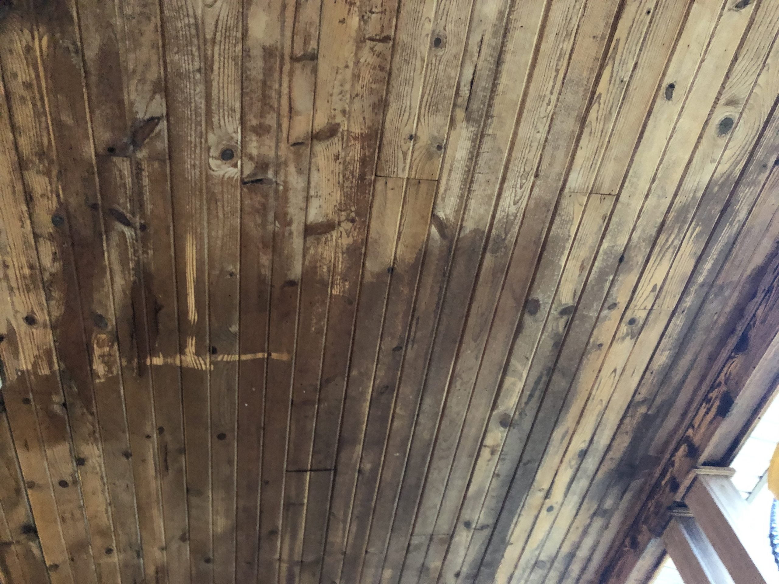

Love the website…I’m learning a lot! Nine months ago we replaced several rotten boards on our 20+ year old deck. The remaining boards were also sanded, but many of them are still in “rough” shape (cost considerations prevented us from replacing the entire deck). It’s now time to stain the deck, but I have a few questions that I’m hoping you can answer or provide some advice for:
(1) The old boards are grey when dry, but dark brown when wet (see pics). Of course, I’ll work on them when they’re dry…but will the stain change color (darker) when applied on the old boards? I’m trying to decide on a color, and this could impact that decision.
(2) Your “Pro Tip” says to use a semi-solid stain for better blending. How much difference is there between a semi-solid and solid stain when it comes to blending? Seems like there are disadvantages for solid stains (e.g., peeling), so I might want to go with a semi-solid…but I do want the old and new boards to blend well.
(3) I saw your other article where you advise against using an epoxy filler because it won’t look good (at least with transparent or semi-transparent stain). However, the old boards on my deck still have a lot of imperfections that I’d like to smooth out/get rid of if possible. You seem to say (in the other article) that using filler is OK if you use a solid stain, since that will cover everything. Would a semi-solid stain also cover-up filler?
(4) If I do use an epoxy filler and follow your prep steps above for best blending (wash, brighten, sand), when would I apply the filler? Between the brightener and sanding?

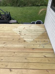

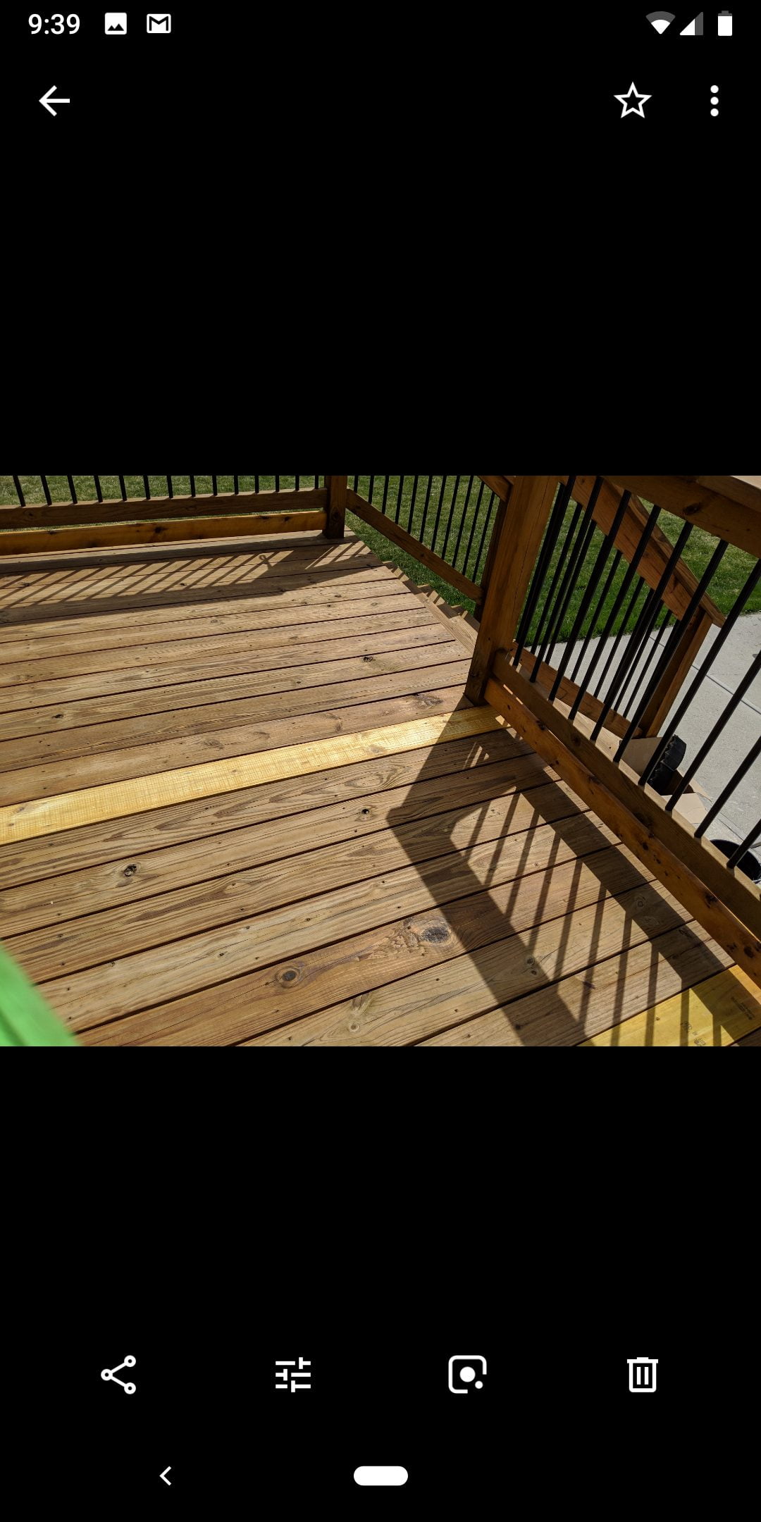

have new extension to the old deck. want to stain the whole deck. i’ve power washed. was going to sand but weather not cooperating. did some research and saw a bunch of articles that sanding isn’t always necessary. I used an orbital hand sander 60 grit on the stairs and not much changed color wise. the new stain i’m using is darker than the original. what do you recommend? thanks in advance.
First of all, you cannot stain this new wood yet. See this for tips:
The only way you will get this to blend is to use a solid stain on all wood.

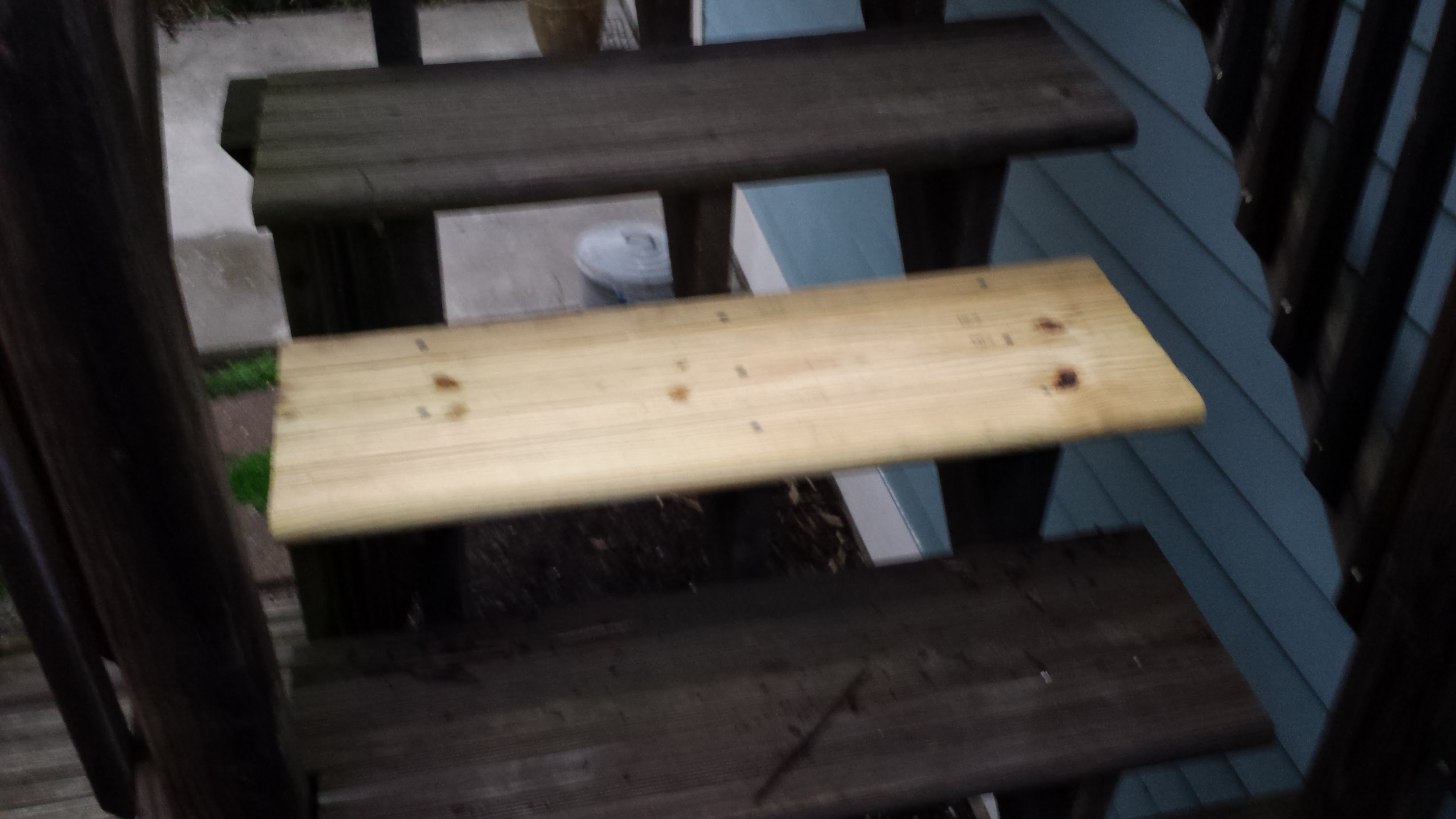

Thanks for being available. I have pressure-treated 1 1/4 deck surface boards that were installed a year ago and weathered without staining.
I just replaced the steps this summer with different pressure-treated 2×8 pine, so it is lighter color.
If I put Thompson’s Water Sealer on the deck boards now and wait a year to do the steps, will they likely come closer to the deck floor color before I seal them, please?
Also, does water sealer application require all the preparation steps you described above for applying stain?
Thanks for your help!
Thompson’s is useless and can cause harm so do not use it. https://www.deckstainhelp.com/thompsons-waterseal-finish-review/
You will also have to strip it off before staining. Best to just leave as is and clear and brighen all in the Spring to stain.

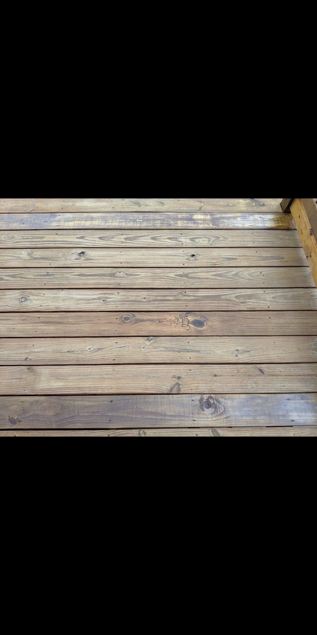

Here’s a pic
You will not be able to get that to match but you could do the contrasting color if you want.

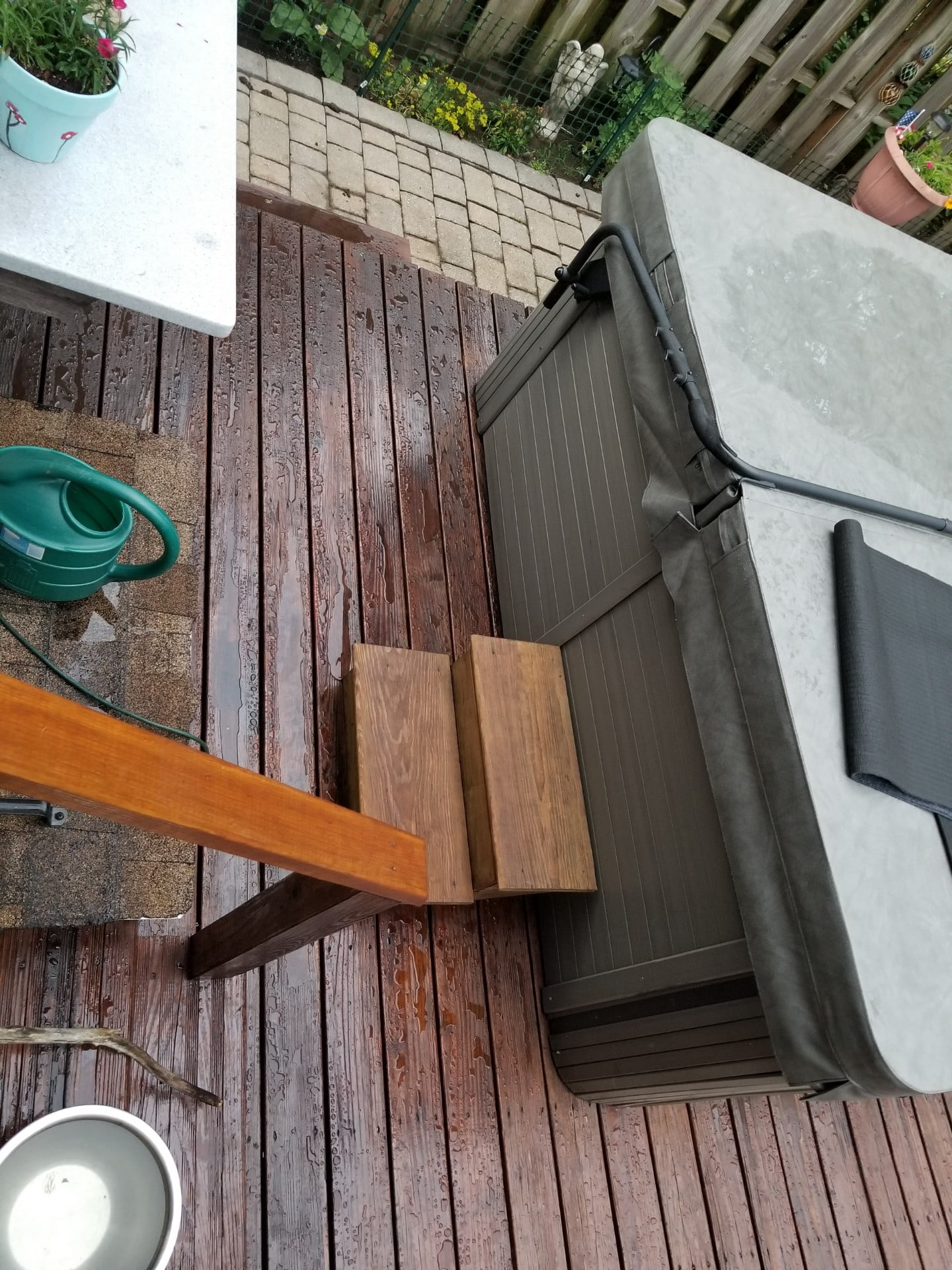

Hello, ten year old deck was newly stained. Stairs to hot tub and railing being newer wood do not match. What’s the easiest way to fix This? Can I sand or apply kilz and paint over in a contrasting color? Thank you

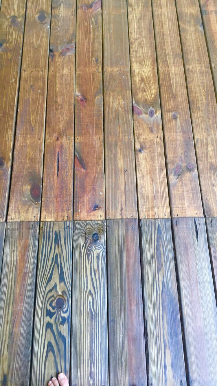

1. I power washed part of my deck to prep for first time staining and I husband did the other half. They are now two different colors of clean. Do they have to match before putting a semi transparent (dark walnut) stain on them if we want consistant color? I am hoping the come out looking the same.
2. Also, I left track markings in the half I power washed. Can I get rid of those?
1. If even in color when wet then it should be even in color when stained.
2. No, that is deep in the grain. You would have to power sand the entire deck to remove those lines.

We had to replace a few rotting boards and of course they are not blending well with the old boards.can I stain the new boards right away or must I age them for awhile. We also added a new railing
You should wait: https://www.deckstainhelp.com/staining-a-new-deck/
How long should I wait?
Depending on the stain brand but 3 months is normal. It is in the article we sent.

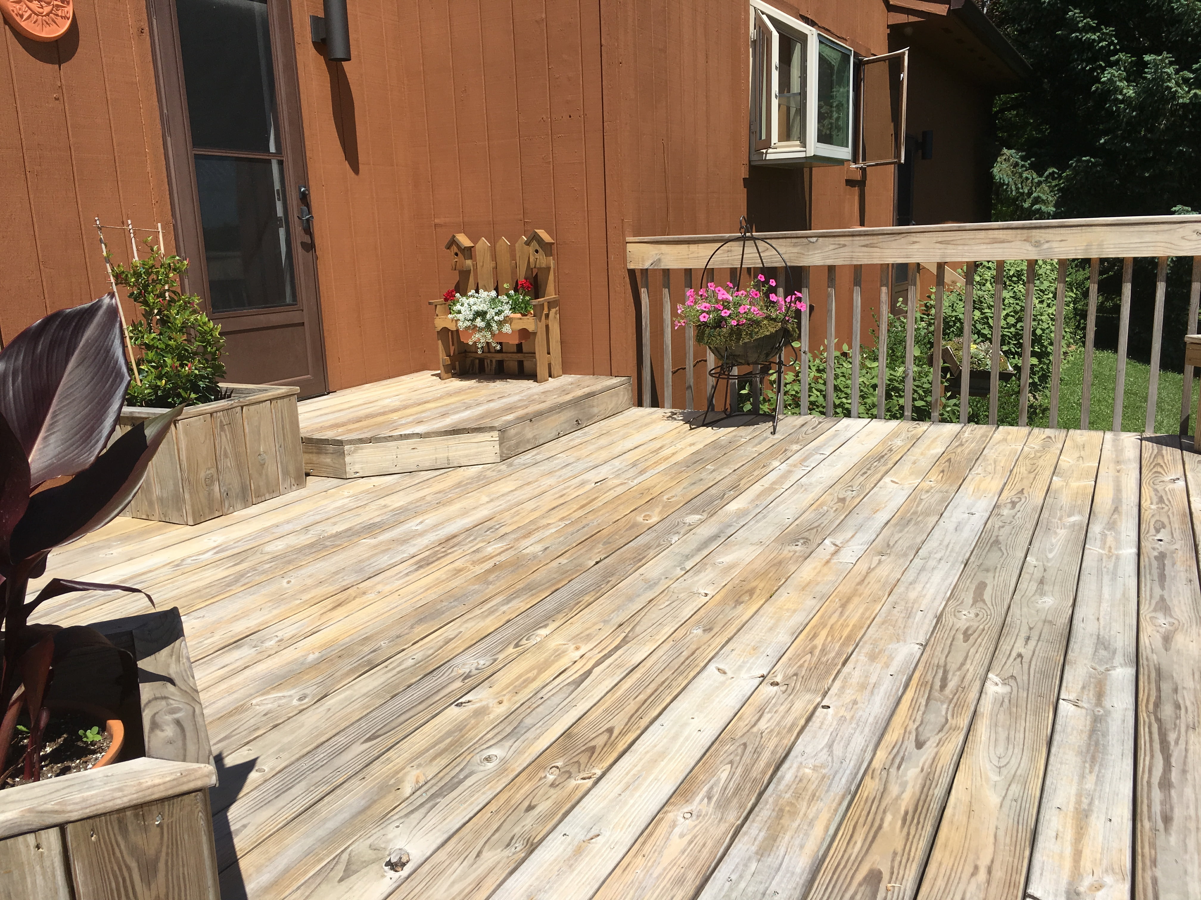

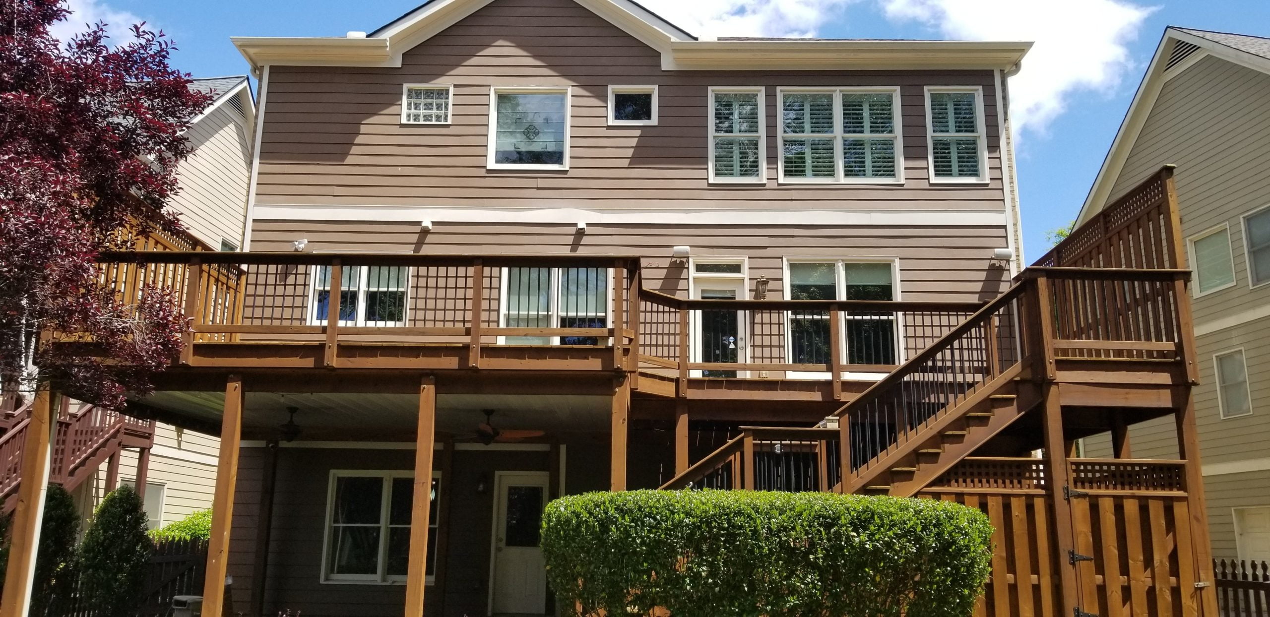

I just stained my deck which is a combination of new and old wood. The old wood is Cedar, and the new Pine deck board I believe. How can I get the Pine as dark as Cedar to match? I used Ready Seal Dark Walnut. I will attach pic in another post above.
We have a large deck, built by previous owners, so we do not have information about the product used. It needs to be maintained and restained. It has privacy panels that I believe are cedar. It appears that the product used on it originally is a semi-transparent stain. We’re considering a semi-solid stain in a different color. Wondering how far can we stray on the color, (i.e. should we try to stay in the same color family), especially since the privacy panels are cedar. Could we stain the whole thing the same new color, including the cedar panels, or will it take the stain very differently?
You will have to strip and brighten this for prep when switching brands and types of stain. Once removed, you can use any color you like. Try the Armstrong Clark in a semi-solid color.
Thank you. Just to be clear, you are referring to the privacy panels?
All wood that has a stain needs to be stripped.

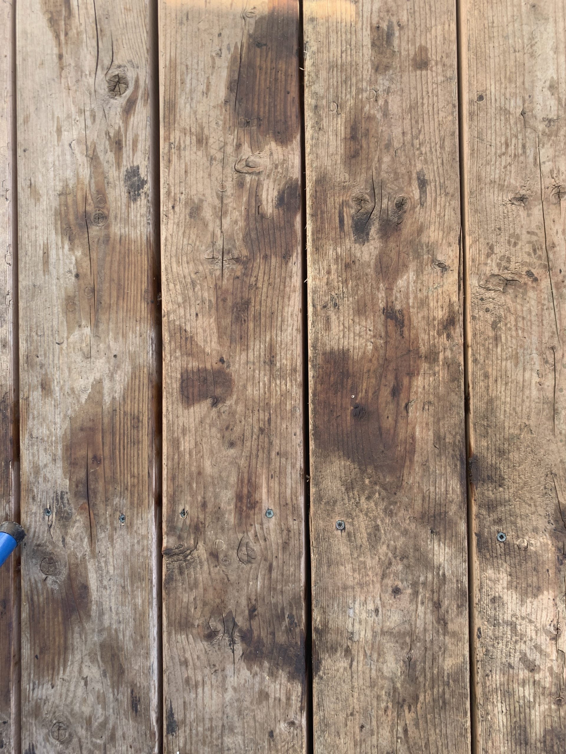

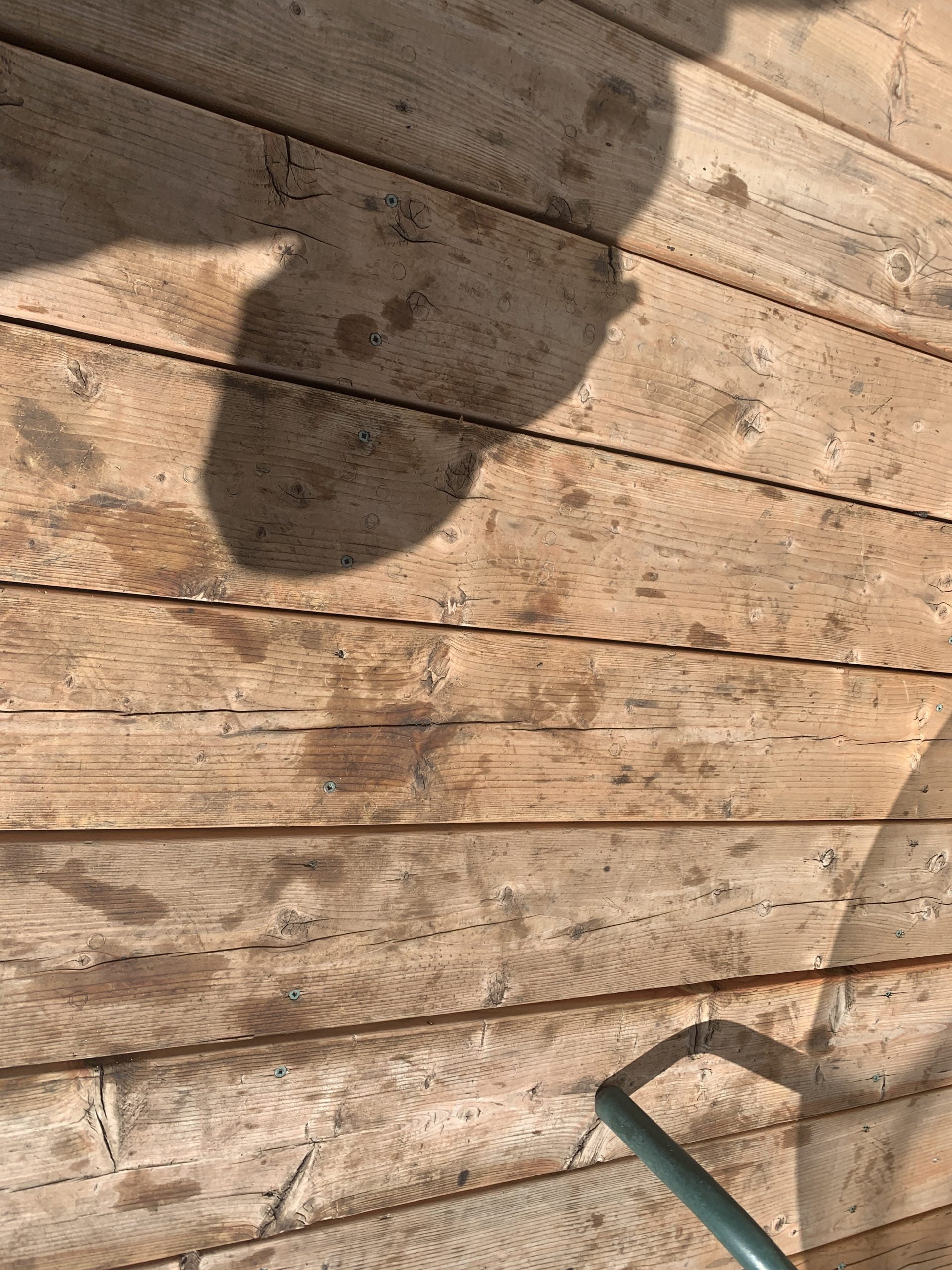

Hi, I will use a stain remover for oil spots on the deck. What’s your suggestion on how to paint or stain afterwards so that the colour is even?
Send some pictures of the wood after the prep.
Hi, let me know and thank you for your help
You probably will not get out all those grease or oil spots. If you cannot, you will need a solid stain to cover it: https://www.deckstainhelp.com/what-are-the-best-solid-color-deck-stains/
So should I sand as best as I can, and apply the solid stain? Or will the solid stain hold on top of grease spots?
Just pressure wash and then cover with the solid stain.

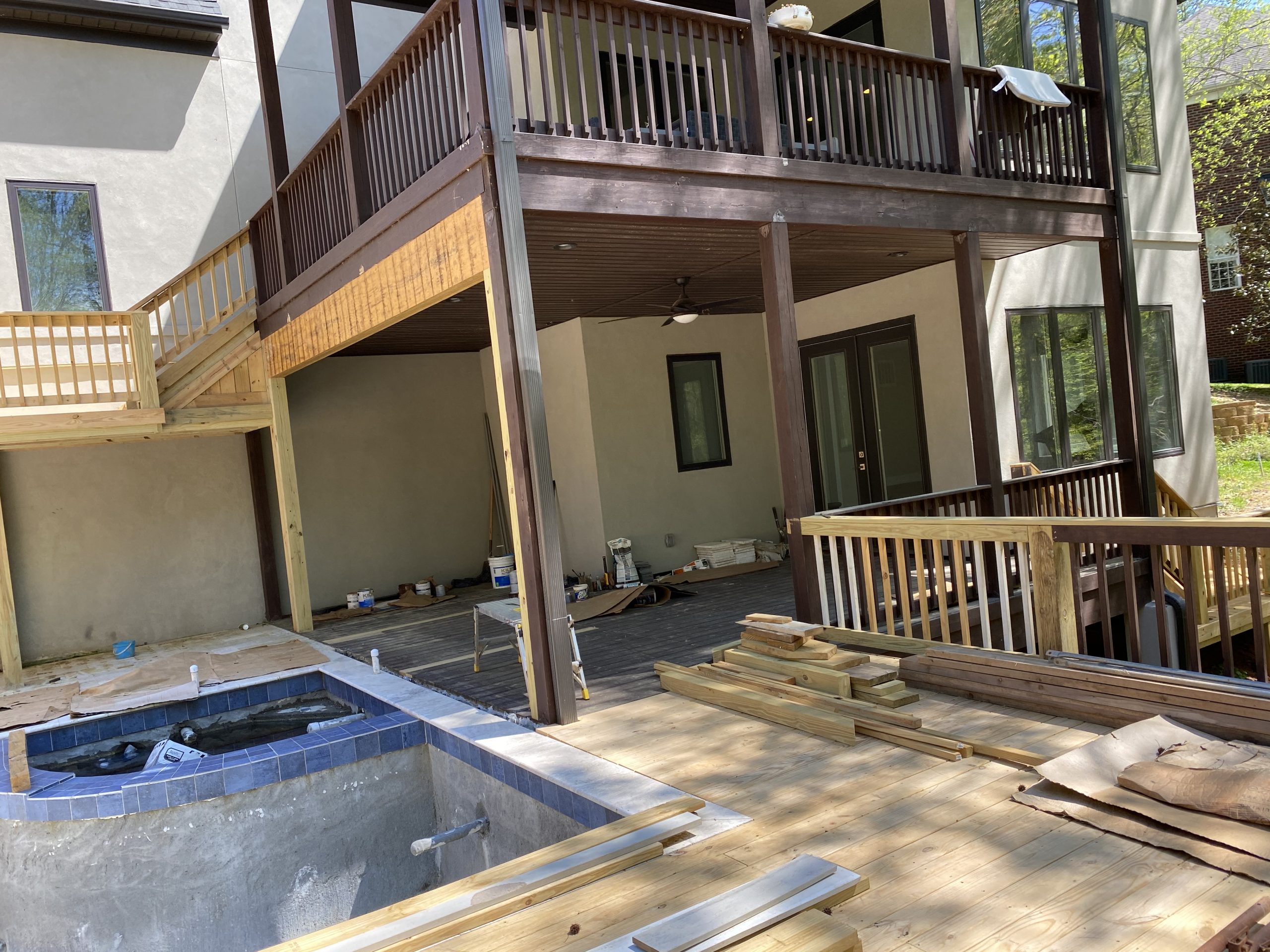

Working on this deck had to replace some of the rotten wood with new wood. Plan on staining the deck next. What is the best and cheapest way to get the wood to blend together. Already been power washed.
You cannot get it to blend perfectly if you do it now. The only way is time or going with an opaque stain.

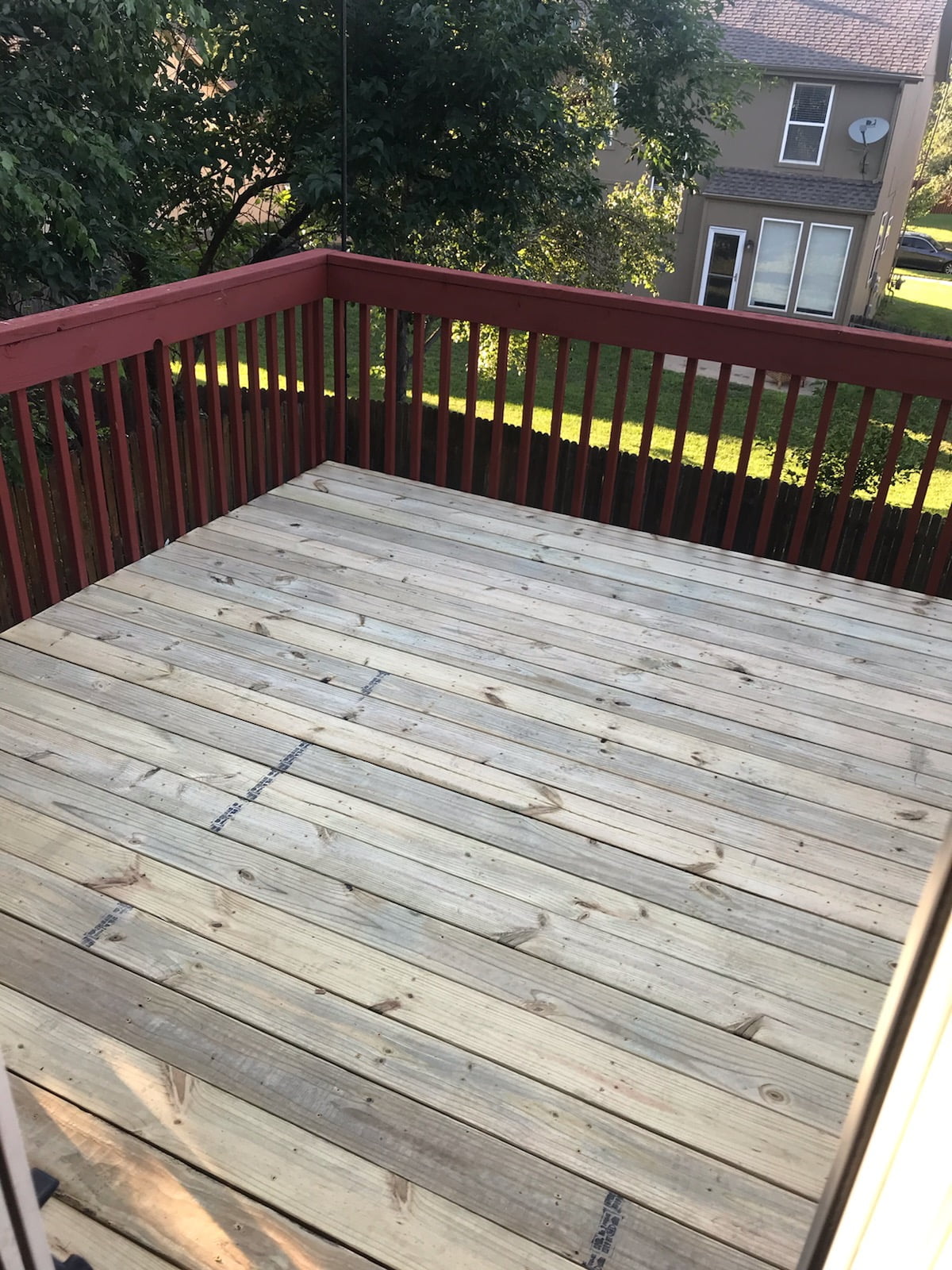

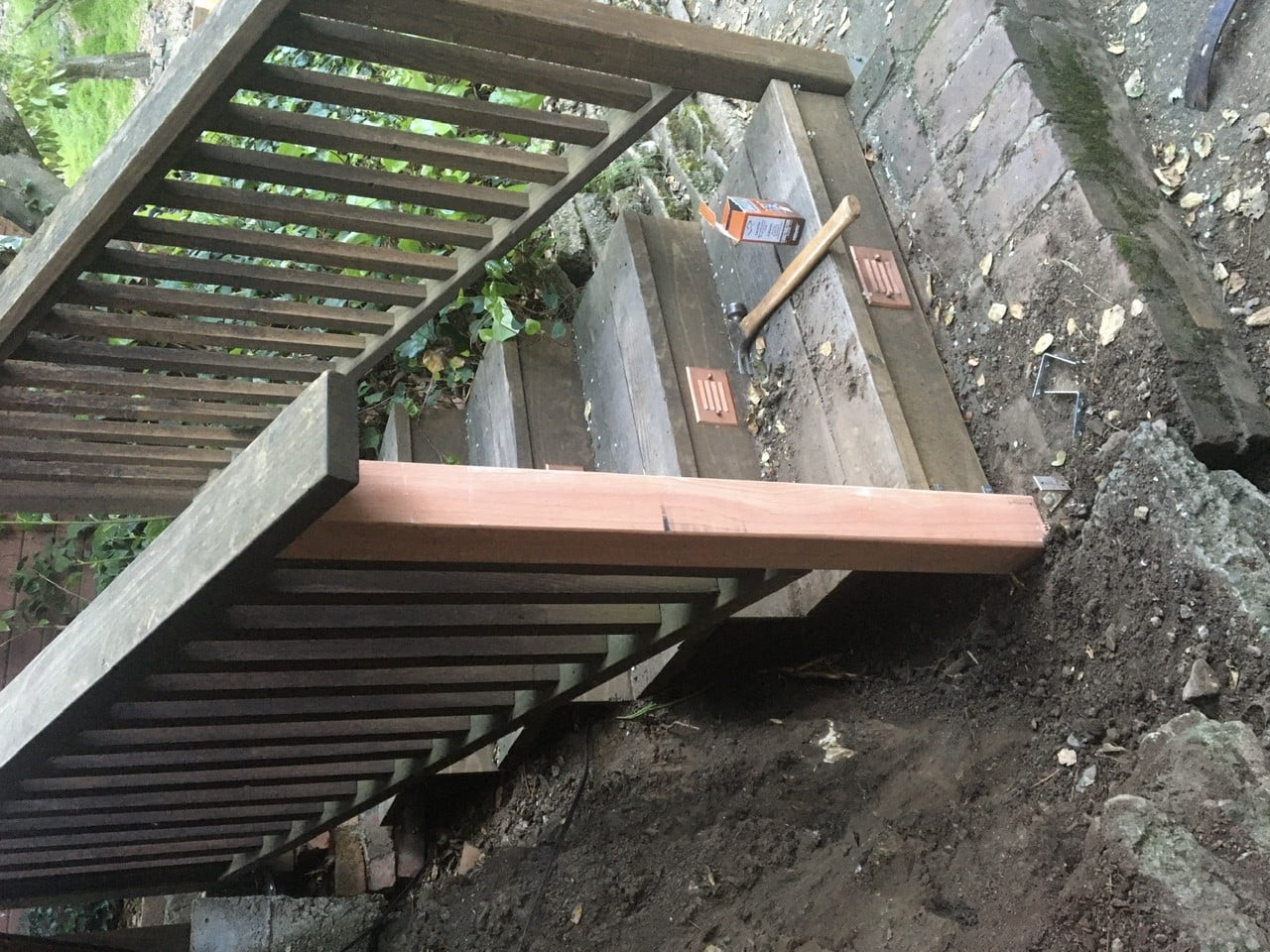

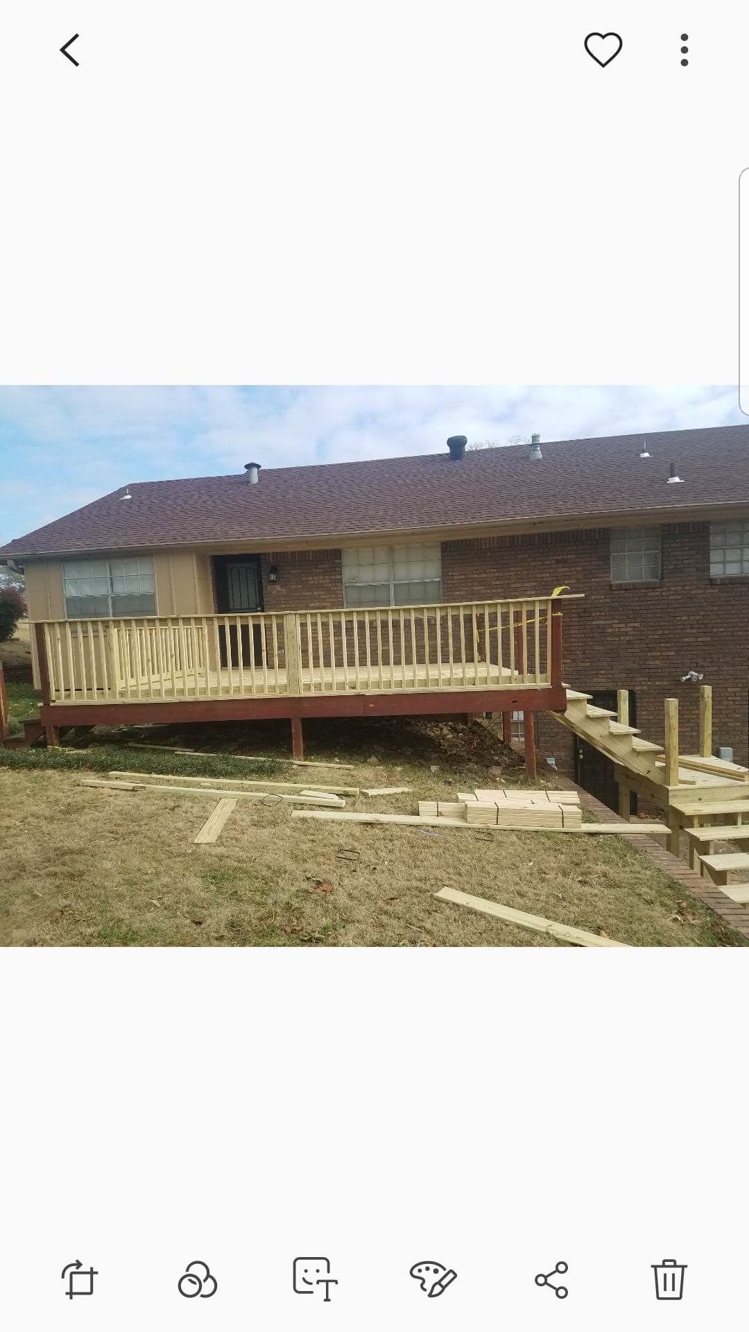

Here is a picture of a repaired deck. Red part is painted but the owner wants it all stained to match. How can I achieve this?
How can I match this in a stain…red part painted.
FYI, you cannot stain new wood right away: https://www.deckstainhelp.com/staining-a-new-deck/
Do you want a solid stain or semi-transparent stain?
Is it best to paint the old and new deck boards

I am in much need of advice. We purchased a house with a 2nd story deck that seems to be pretty old and has a solid red paint. Last October I added a set up stairs with pretreated wood but was waiting to seal it, then this summer I replaced all of the boards with pretreated wood on the deck because of splintering and rot but I kept the support structure and railings because all of that was in good shape but it is still all red. I know I need to wait a couple of months to stain or paint the new boards. What is my best course of actions for the next steps to get everything to match(ish)? My plan was to try and power wash the existing red off but from there I am lost as to what to do because of the big difference in the age of wood between the boards/stairs and the structure. I am assuming the older wood is too old to stain but is it wrong to paint the new wood?
This is a picture
The only way to the red paint is to sand. Pressure washing will not remove it. The best course of actions is to go with a two-toned deck: https://www.deckstainhelp.com/why-have-a-two-toned-deck/

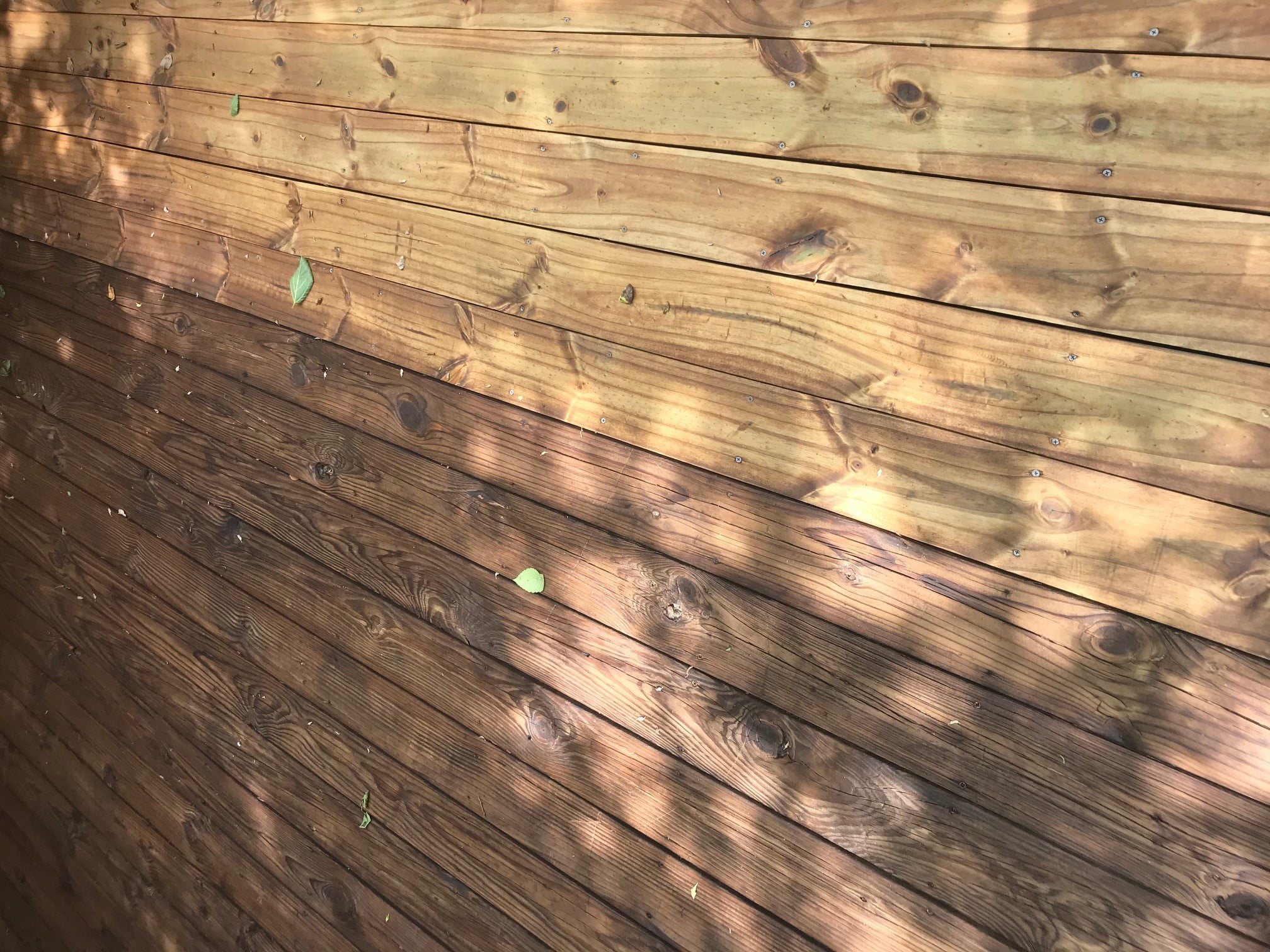

I have a deck that I built and stained 3 years ago with a (supposedly) 6 year semi-transparent stain. Since then I’ve had a deckboard or two split and crack so I replaced those boards today with new wood. I stained a sample piece of the new wood (see the orange-ish 2 ft. section lying in the one picture) with the same stain that I used 3 years ago but it doesn’t match my existing deck boards closely at all. The current deck boards aren’t in terrible shape so I’m thinking that stripping them probably isn’t necessary, but what steps would you recommend I do to get these new boards matching the old as best as possible? Thanks in advance.
Here are the pictures.
If switching brands of stain you will have to strip. New wood needs to season as well: https://www.deckstainhelp.com/staining-a-new-deck/
It will be virtually impossible to blend these new and old boards when using a semi-transparent stain.

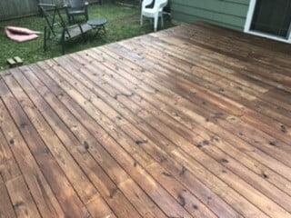

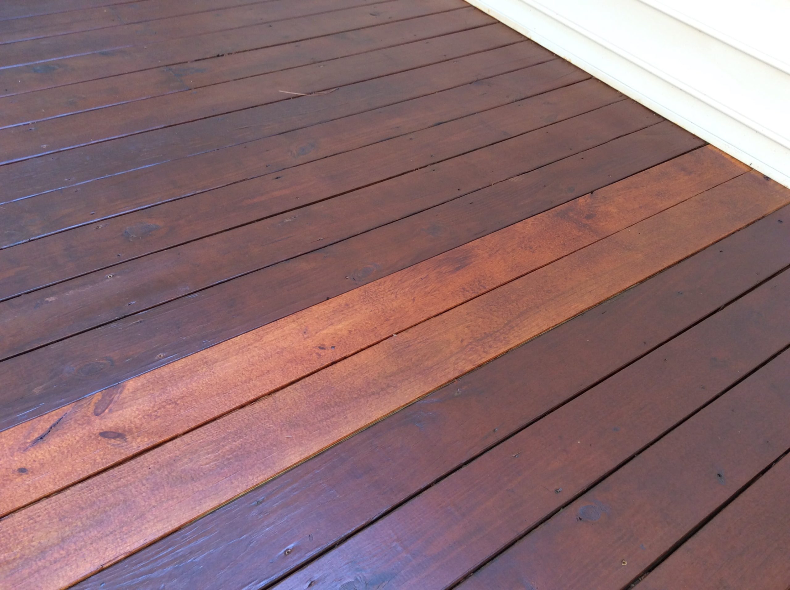

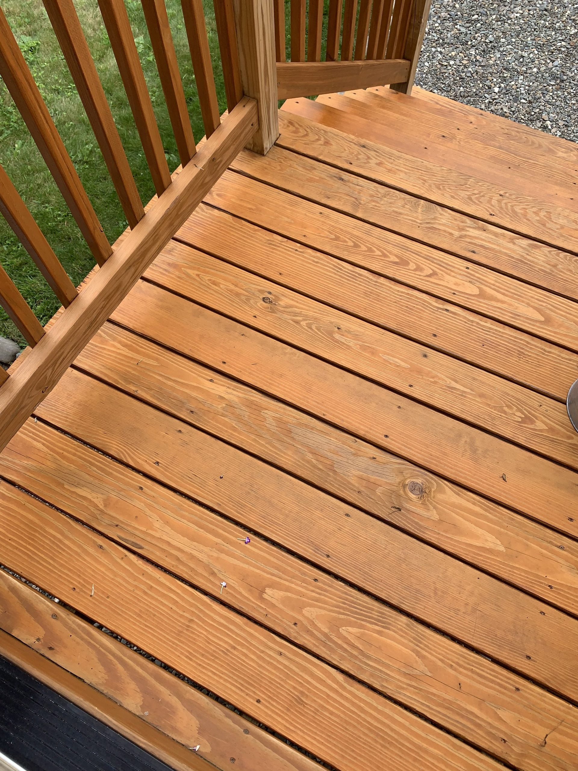

Pictures for my comment below. The boards at the top and bottom of the picture are the new boards that I stained, the board at top of pic I sanded with 150 grit to see if that would help…it didn’t. The other picture is the “before.” Thanks!
You will not be able to get the new wood to match the older wood in this scenario. Nothing you do will make it blend when using a transparent stain. The brand new wood is just not absorbent enough to accept the stain the same way as the older wood.
Thank you so sand off or leave it alone?
Hi, novice here. I have a pressure treated deck and hired someone to stain. They replaced 2 boards and I am trying to get a stain that somewhat matches because the mismatch is driving me crazy. I have a semi transparent cedar stain down, they also put on new boards which turned yellow. I tried different stains to get to match, and it seemed I needed to go really dark, so I applied Moorish teak opaque oil based. Looked okay until it dried. I sanded one of the boards with 150 grit, only made it worse. Some dried a bit shiny which makes me think it didn’t absorb. Glad I found your site!
Questions:
1) should I try to brush paint thinner on these boards to decrease the darkness?
2) should I try to sand off with belt sander and apply another stain?
3) Should I sand some off and put another stain down?
Thanks in advance for your help. I will post pictures in another post because I don’t think my previous post worked with pictures. Thanks!!
When blending new and old deck boards together do you still have to wait months to stain the new boards? It seems kind of crazy to stain all the older boards and railings and not the new boards? Please help! Our handyman who is going to be doing the job is not quite sure himself which way to proceed?
If you stain the new boards without weathering, you will most likely have to apply another coat to those boards on 6-12 months.
Thank You

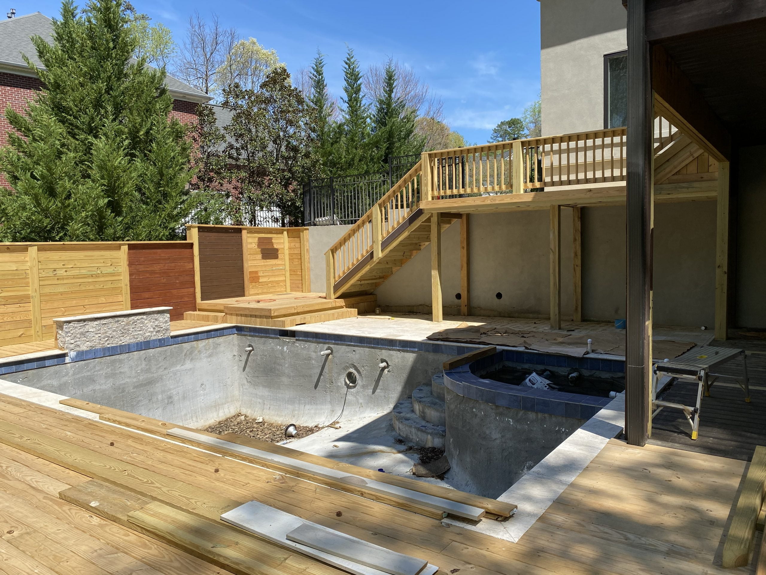

We removed outdoor carpet from a pool deck that is 17 years old…Replaced a few boards and put up new railing.. Was surprised how good the deck looked under the carpet…it has always been carpeted. Now we are contemplating a sealer such as Rust-Oleum Restore. I’ve read nothing but bad reviews on this product. Suggestions for a good sealer? Any suggestion would be appreciated…My son is determined to use Restore…

We have spent weeks and lots of money getting solid stain off the deck. Finally done. We added an addition 5 years ago to a 10 year old deck after solid stain removed the newer side is still very much lighter. We have stained it thinking we could just add mote stain to newer side to make it darker. This has only made it redder than the other side we used dark walnut transparent stain. I don’t want to go through the stripping process again! Are there anyway to blend this with out solid stain or redoing?
Post a picture please.
Are you seeing this pic
No way to blend this with a semi-transparent stain at this point. Natural weathering and a recoat in a year or so and should blend then.

Just installed this new step and it’s raining for about a week before I installed. Should I wait until everything dries up to try to match the older boards or does it not matter? Also should I pressure wash everything then try to stain the older boards too? Thanks!
When to stain the new wood really depends on the stain brand you are using for the rest of the deck. I would suggest reading their directions. New wood, in general, should season and be prepped:

Three new boards added to replace rotten ones. Deck has already had every thing done to it before new boards were added. Now a problem. What to do to the three boards to blend them in to old deck that will be acceptable. No thought was put into this issue when the decision to replace the boards due to safety issues.
Try to blend with a semi-solid color. Use Armstrong Clark stains. Prep well first.

I have a cypress ceiing in my den that we put up 31 years ago. The ceiling also had box built cypress beams, which we recently removed. We whitewashed the ceiling and it is beautiful except for where the beams were. That area won't blend with the rest of the ceiling no matter what we do. Also, there is a dark line that seems to outline where the beams were. It is a slight line but we can't get rid of it. We have tried sanding, that made the differences show up more. We tried stripper, denatured alcohol, etc and nothing we do blends the two. Any help would be greatly appreciated. We are trying to find a solution other than having to spend a fortune to put new beams back up to cover the discolored wood.
You will not be able to remove this discoloration or get it all to blend.
I am staining my deck with 1501 cedartone. Some boards are a nice golden color and some are dull greyish after the application. The deck was powerwashed three weeks ago. Why do you think there is such a noticeable difference.
The wood itself is the issue, not the stain.

i have an old redwood fence that I'm attaching a new redwood trellis/posts. I was advised to use a semi transparent stain and I am planning on using the Arborwood brand but don't know what stain is going to match them both. I want something along the cedar or natural color. Do I need to buy two different colors of stain or will one work? I am getting it pressure washed and could put a brightener to it if necessary. any suggestions?
FYI. you might want to read our reviews and consumer comments on the Arborcoat: https://www.deckstainhelp.com/benjamin-moore-arbor…
Clean and or strip to make sure all wood is clean and free of any old coatings. Brighten the wood when done. It will not be exactly the same but hopefully close.
