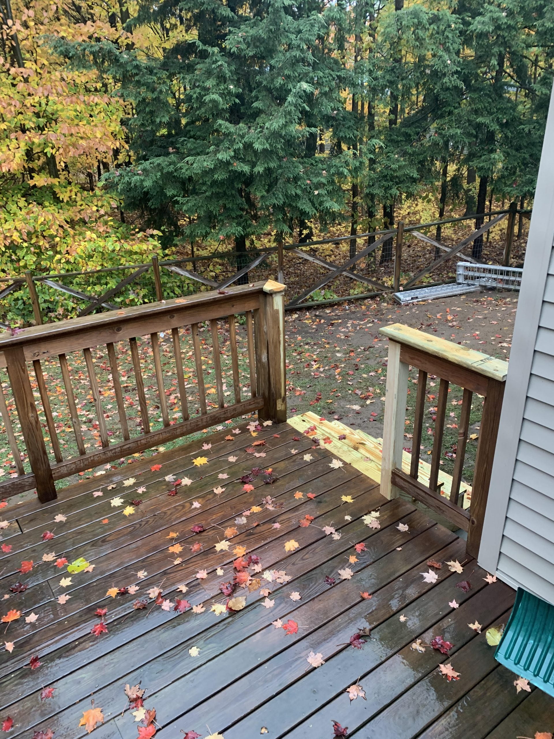

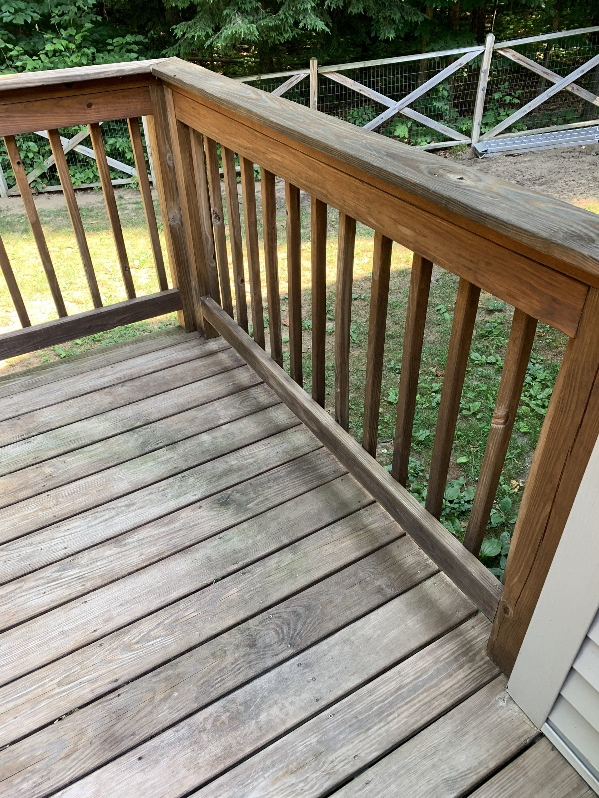

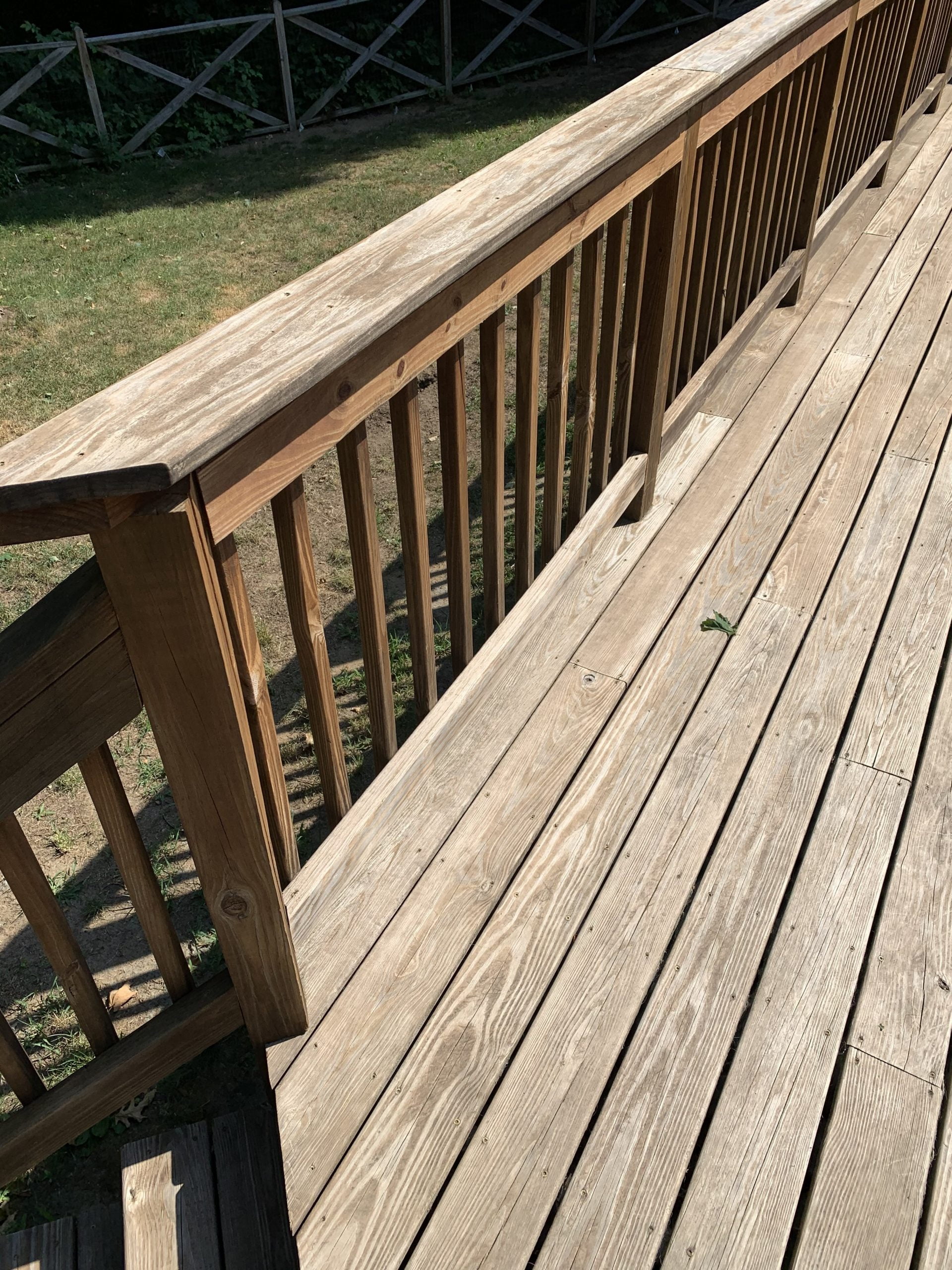

I have a 12ftx35ft all-wooden deck with approximately 55 feet of wooden railing. The deck is approximately 4-6 years old. I was fairly certain it had never been stained and the deck was definitely at least 1 year old when I stained it last, approximately 2-3 years ago. I read review after review from other websites and it seems there was always conflicting advice (oil vs water based, order of prep, brightener, etc), but no one has as comprehensive of a website and ACTIVE advice as you guys, so thanks for what you do! This is what I tried: Did a deck cleaner, then power washer, then had a ton of fuzzies that looked terrible, so I tried using a combination of a belt sander (roughly 3 inches by 14inch wide belt) and a 6 inch orbital sander to get rid of the fuzzies. It. Was. A nightmare. I used a deck pad applicator and paint brush on each spindle/post/railing. Total time was probably about 30 hours over a few weekends, of course having to redo a step or two because rain forced me to wait (and I have dogs that transit the deck from dog door to back yard while I’m at work). I used Thompsons WaterSeal Timber Oil (Teak). While I loved the color, it did not last long and I did not maintain it the way I should have. There is zero water beading on any horizontal surfaces with 5 second water test. Can’t tell on vertical surfaces but they seem more resistant (and darker). The dogs are very hard on this deck, as you’ll see from pictures. We average about 40 inches of rain a year and about 102 inches of snow. My dogs sometimes pee or poop on the deck. I’ve tried to stop it, but not a lot of luck. My top problems with the deck are: a) It gets INCREDIBLY slippery in wet/snowy weather. So much so that it makes it hard to even snow-blow the deck in winter because tires don’t want to grip. This is worsened by my laziness at promptly cleaning deck of leaves and performing annual cleaning/brightening and annual/semi-annual re-staining. I plan on fixing this in the future. b) Thompson stain seemed to last about a year or less. c) Mold/mildew/Algae grow incredibly fast on the deck even though I try to clear of snow often. I’m looking to do either TWP 1500 (live in NY) Semi Transparent (Rustic) or RAD Water Based Semi-Transparent (Cedar) and definitely leaning more towards the RAD option because trying to line up 2-4 days of no rain, warmer than 50, cooler than 80 or 90 with lower humidity is incredibly hard, especially when it means I have to keep my dogs inside during the process and come back from work to let them out. After reading other reviews and answers, my plan is to strip the deck with RAD, use pressure washer (2800 PSI, 2.3 GPM), apply the brightener from RAD, check for… Read more »
Todd
Todd
Reply to  Todd
More Pictures…
Todd Hunsicker
Todd Hunsicker
Awesome, thank you. Should I get the stripper booster gel stuff or not necessary?

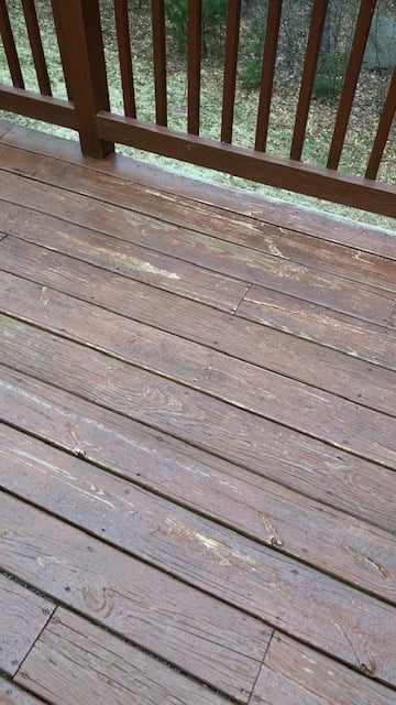

Here is a picture of what it looks like now. I haven’t done any prep or cleaning yet.

I have used Olympic Maximum redwood naturaltone semi transparent water based stain on my deck for years. I haven’t had great luck with it lasting over 2 years. Can I switch to a different brand and also switch to a semi-solid redwood water based stain to cover the semi-transparent stain ? And what would the prep be before applying the new stain ?
Thanks for any help
If I stay with semi-transparent just use a different brand water based stain can I just get away with pressure washing the deck and railings? Thanks for the help
Do you have a suggestion for the best stripper to remove a water based stain ?
Really appreciate your help
Reply to  Steve
Sorry for the double pictures. Had a hard time posting them
Thanks again I will order the restore a deck products. Couple quick questions, have you did any tests with Sikkens deck stain ? And what’s your thoughts on products like Behr Deck Over, Cabot Deck Correct or other resurfacers ? Can they be applied without a lot of sanding ? I ask because our deck is 16’ off the ground to the top of the railing and 32’x12’ and I just cringe thinking of how long it will take to sand lol
