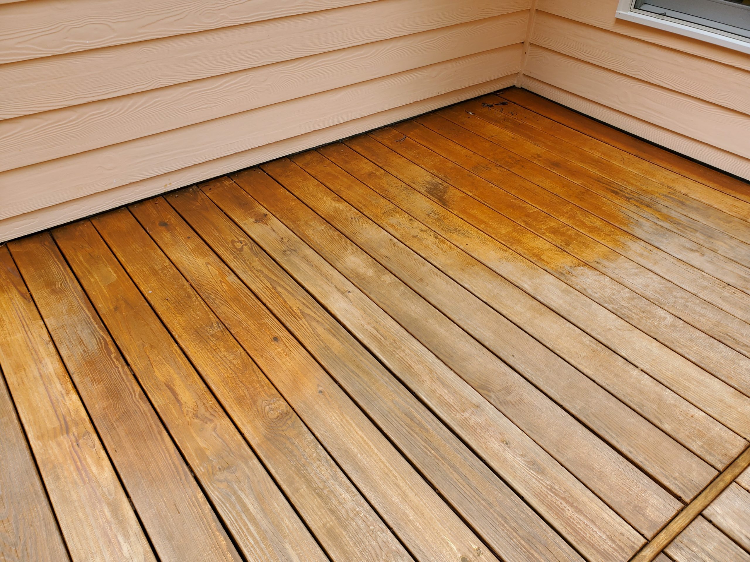

  • Mold and mildew thrive in shaded, moisture-rich areas of a deck, making those spots the first to show damage.
  • Left untreated, mold gets under deck stains and sealers, causing premature failure and accelerating wood rot and decay.
  • Clean mold using a deck cleaner with sodium percarbonate or a 1-to-5 bleach-to-water ratio with a stiff brush or pressure washer.
  • After cleaning, always recoat wood decks with a protective deck stain; composite decks benefit from a proper sealer.
  • RAD Guard Mildew and Algae Cleaner and Preventer removes and prevents mold, mildew, lichen, and algae with no scrubbing or rinsing required.
  • Apply RAD Guard every 12 to 24 months on top of most stains and sealers to keep exterior wood surfaces mold-free long-term.

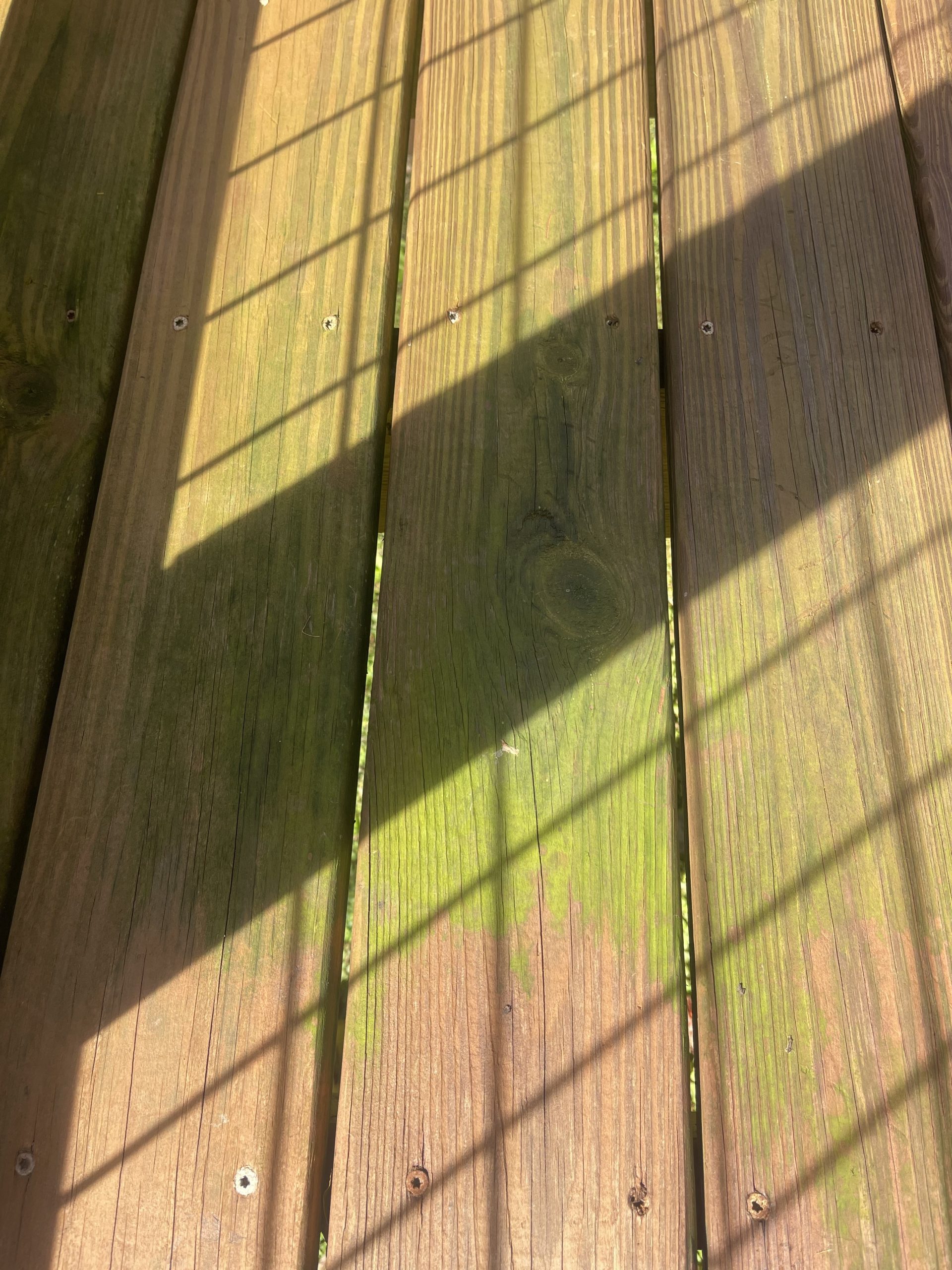

My mold is a rounded ball of green stuff mostly walnut size but round with a flat bottom on the deck. Last one was a big one bigger than a lemon on glass table.

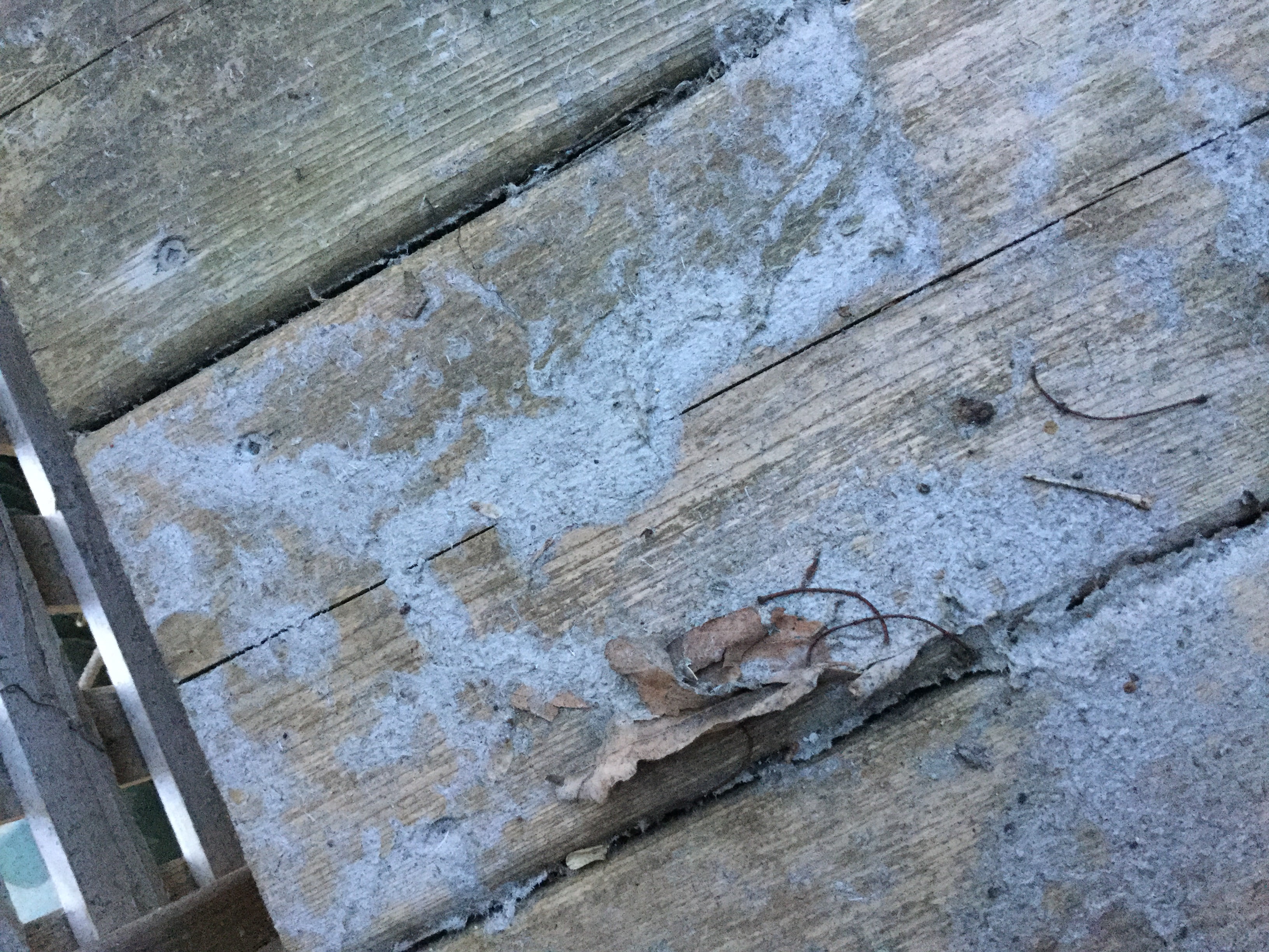

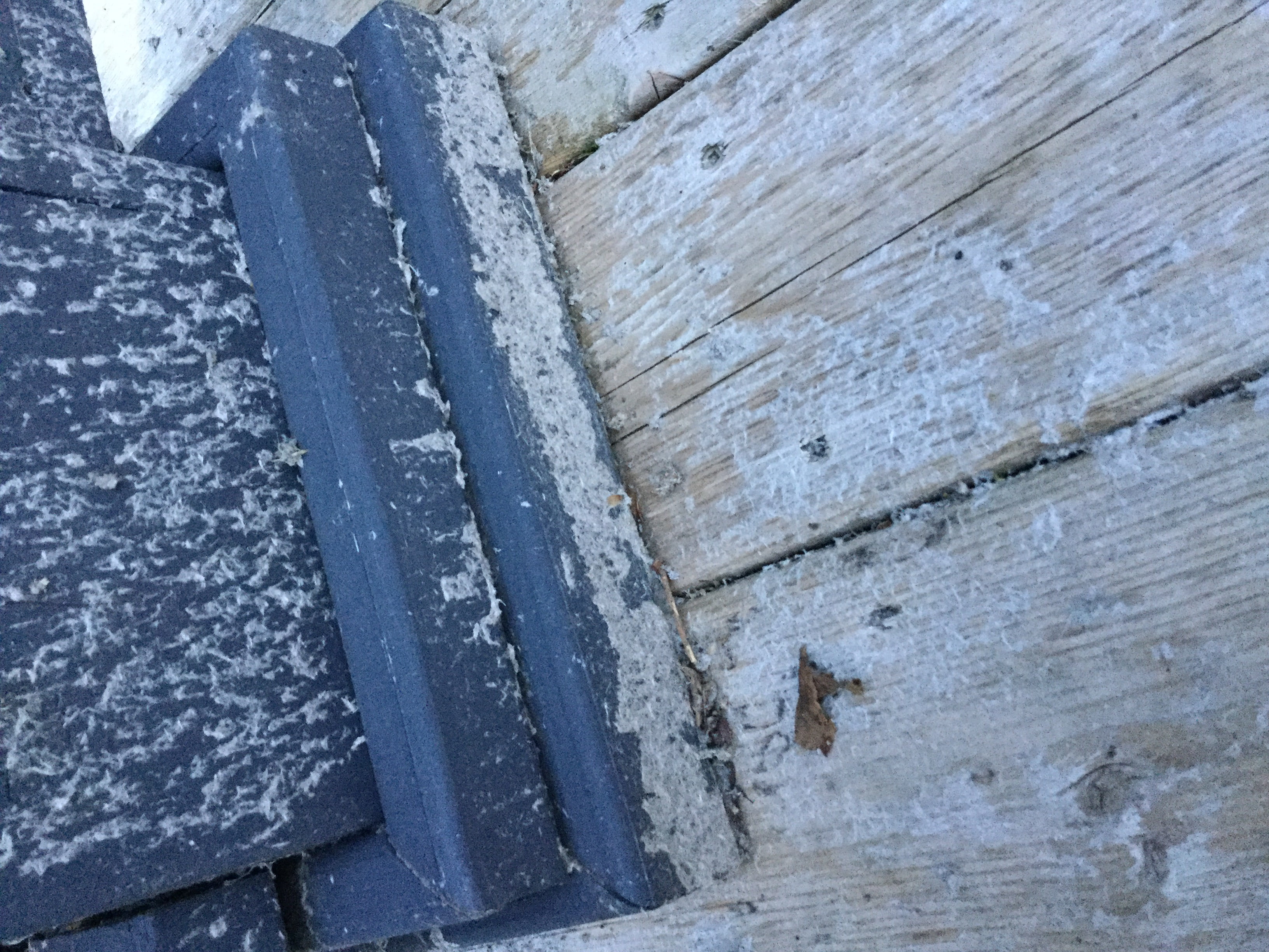

After the winter snow disappeared our cedar deck which we have left natural has a greyish film on it. It reminds me of a wet tissue that has dried in the sun. Is this Mold or mildew? We have wet it and swept it but it remains in difficult areas. Can you explain what happened and is there something we need to do in the future?

Here are a couple of photos.
Sheila
Sheila davidson
Sheila davidson
Thanks for the reply. It turns black when wet and can then be brushed off. But it is hard work. We live in Ontario. Could it have something to do with all the snow we get. We don’t shovel it in the winter. Also we were told pressure washing harms the cedar. There is no other finish on it.

Reply to  Sheila
Pressure wash it with a bleach free deck leaner then use a clear wood sealer on it. Ask at a ‘good’ diy store that knows about it.

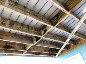

Our deck is 1 foot above a carport with a metal roof. What do you recommend I use without damaging metal roof?
