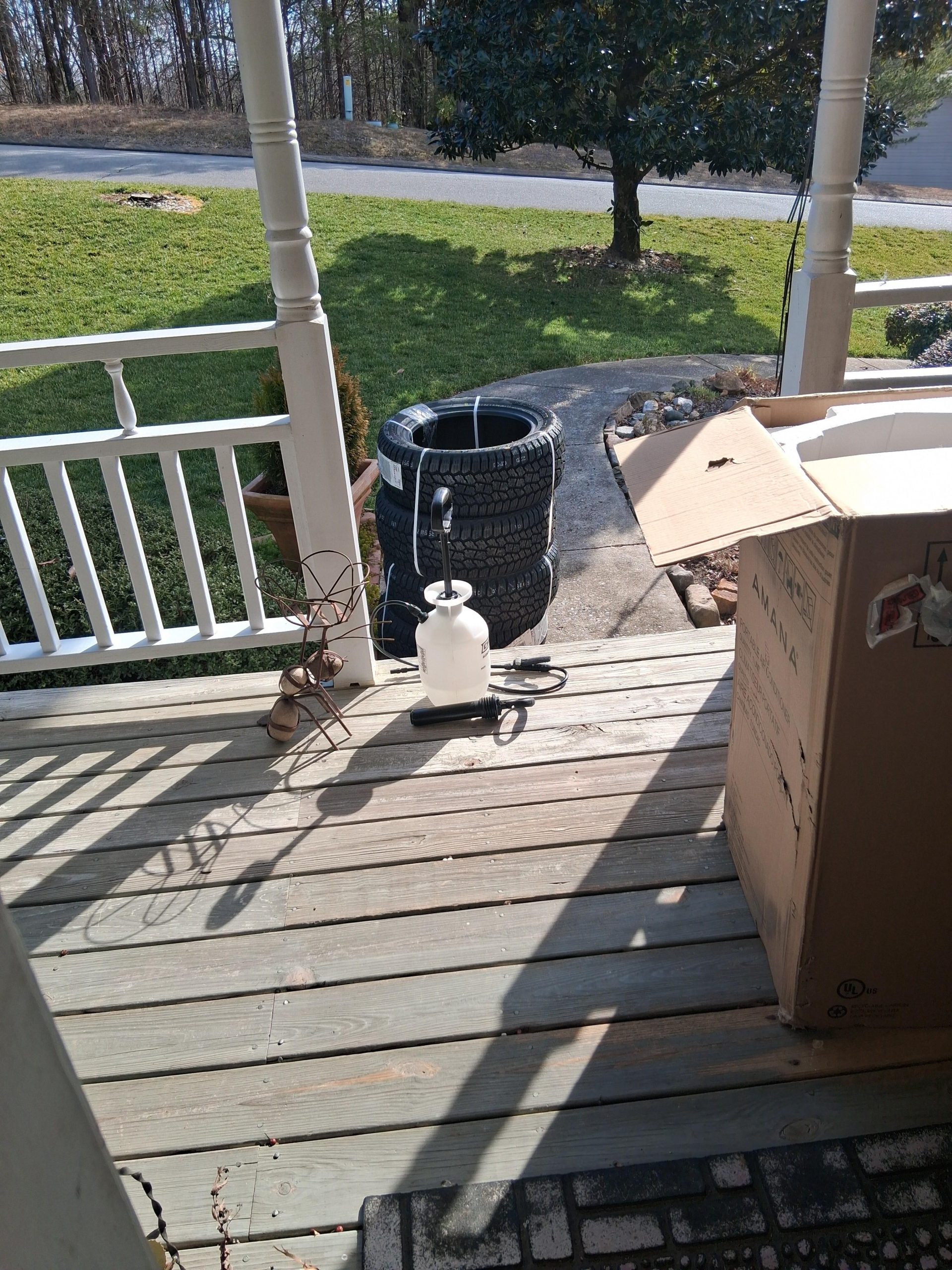

15 year old solid color stain want to put a semi solid or solid back on what is the stripping method you prefer? A squirrel ate that top coat off wish he would have kept going!

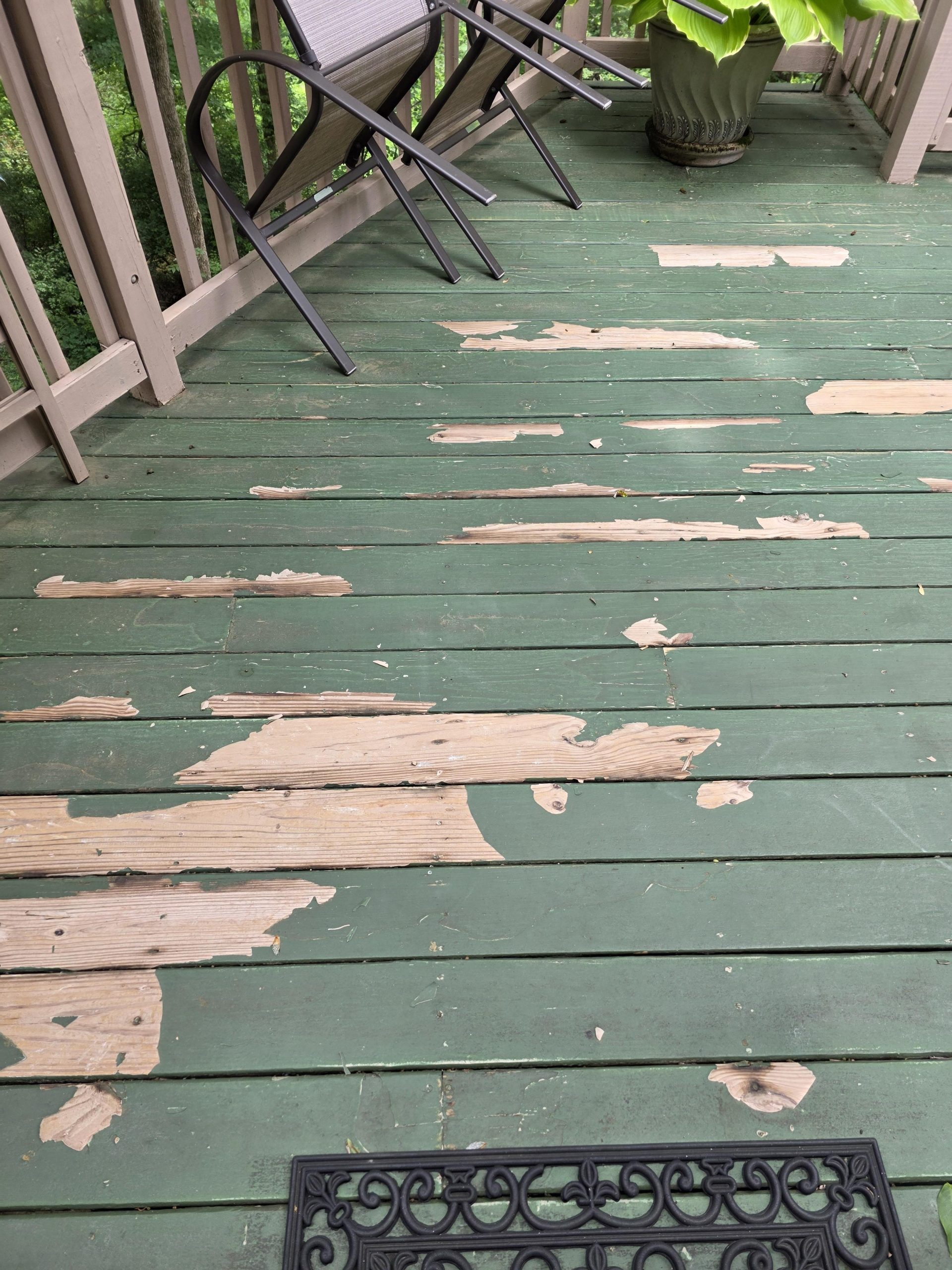

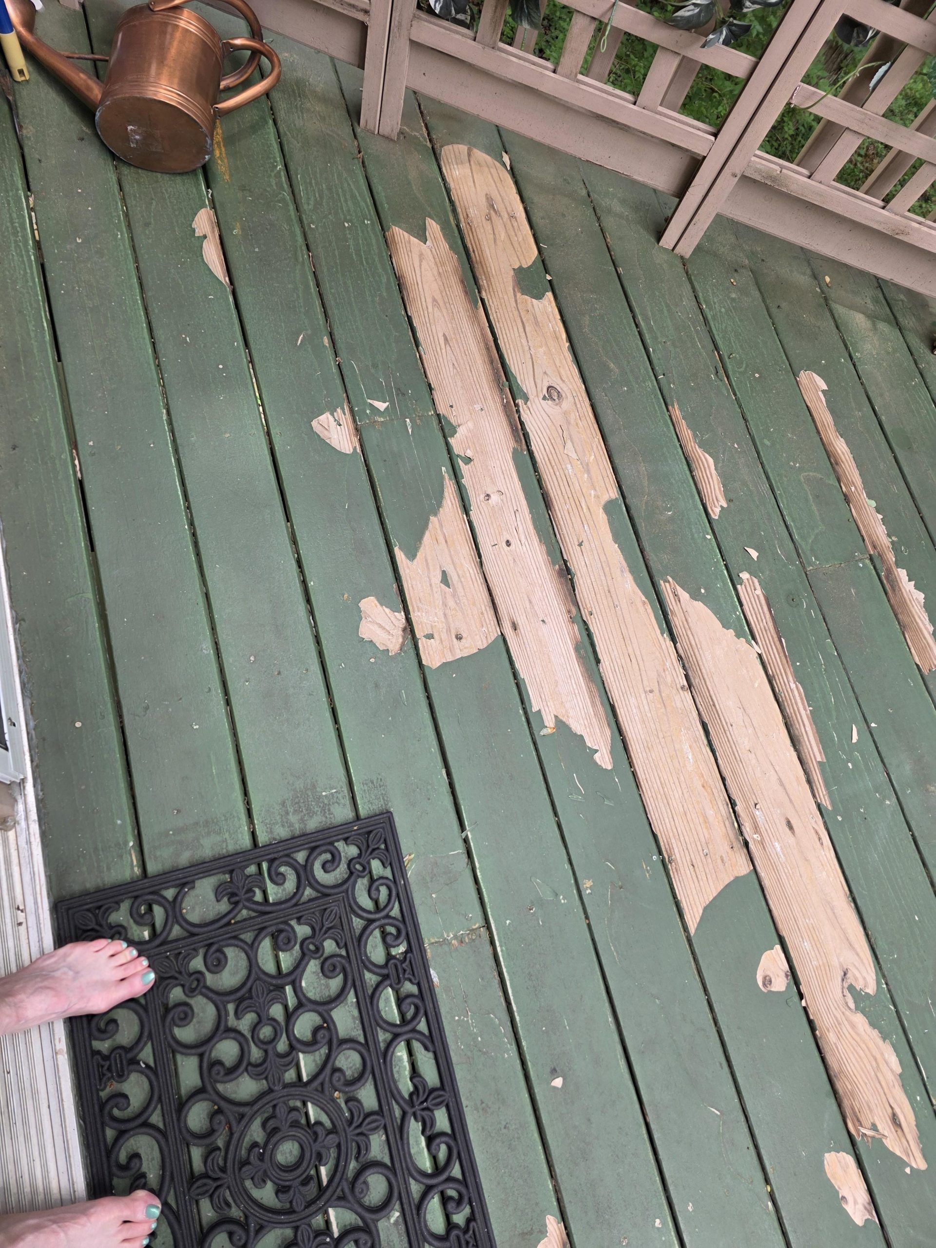

Debra
Debra
Do you recommend RAD for thus deck

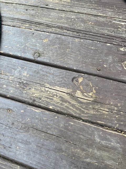

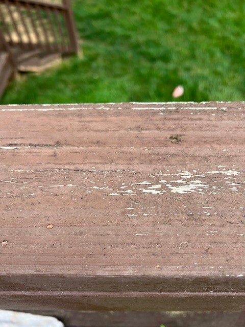

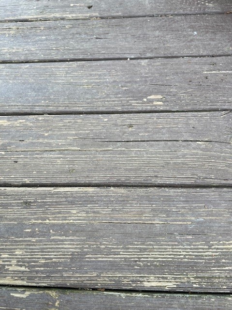

Hi Scott! This deck was neglected by the previous owner and It will be my big spring project. There are no clues as to the brand of stain used previously. I’m trying to figure out if I will need to use RAD PaintStrip or if another paint stripper will work. I plan to clean and brighten after stripping. I would also love to hear suggestions on specific stains to use. I included a picture of the railing that better represents the color of the previous stain.

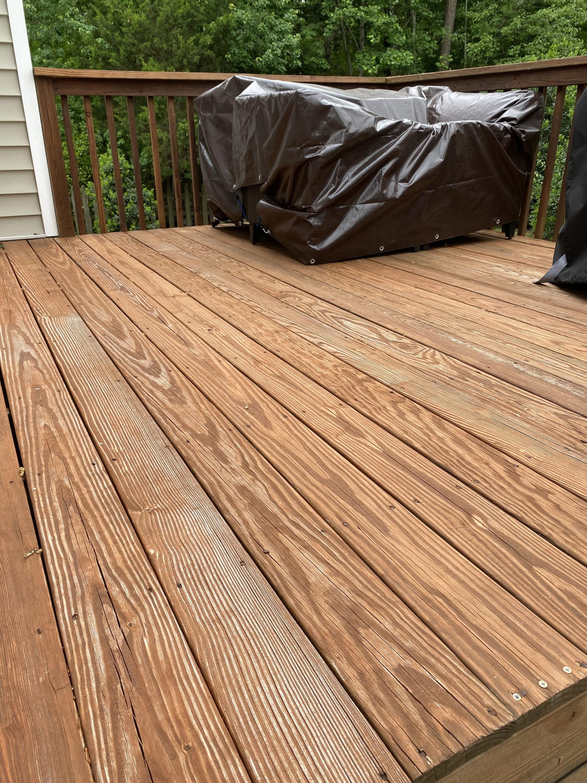

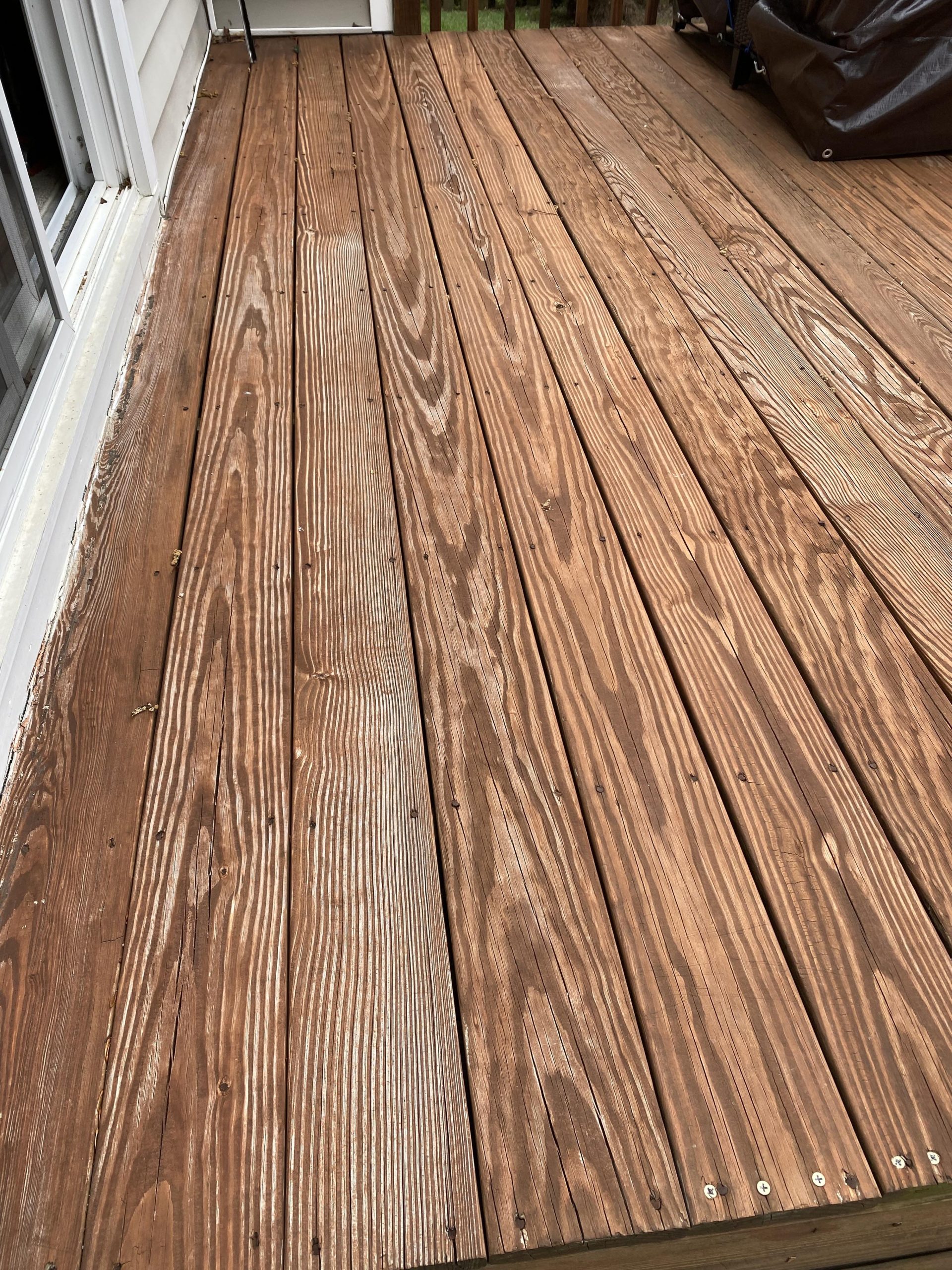

I have a 600 sqft deck that’s greater than 35 years old, built before I bought the house. No rot. We hired someone to stain it a few years back and they used a solid stain. The solid did ok, but it’s fading and starting to peel. I like the look of the wood, so want to go to a semi-transparent.
I sanded with a drum sander, started with 20, then 40, then 60, then 80 grit. Most looks great, but there’s some cupping and some parts where there’s valleys in the grain and the stain remains.
I ordered Defy deck cleaner, and Defy brightener, along with TWP 102. I suspect I need to now use a stripper to get the last bits of solid stain up before I clean/brighten/stain? Do you think a citristrip (sold at Ace) will work ok for the relatively small areas? I ask because the RAD takes a week to ship and I’m running out of time before I travel and then the weather turns bad. Then again, I’m assuming after all of the sanding I can stain right away. Not sure if I need to let the deck season through the winter then clean/brighten/stain in the spring?
Unfortunately I don’t know the type of wood I have. It’s in 16 foot lengths, 3 5/8 inches wide which doesn’t seem like a common size.
Attached are some pictures of the deck and how much I’ve sanded, with a bit of the old stain at the edges so you can opine if it’s solid stain or not. I’m going to do the railings in solid stain for contrast, so I’m not concerned with getting the old finish totally off of them.
Appreciate the help.
