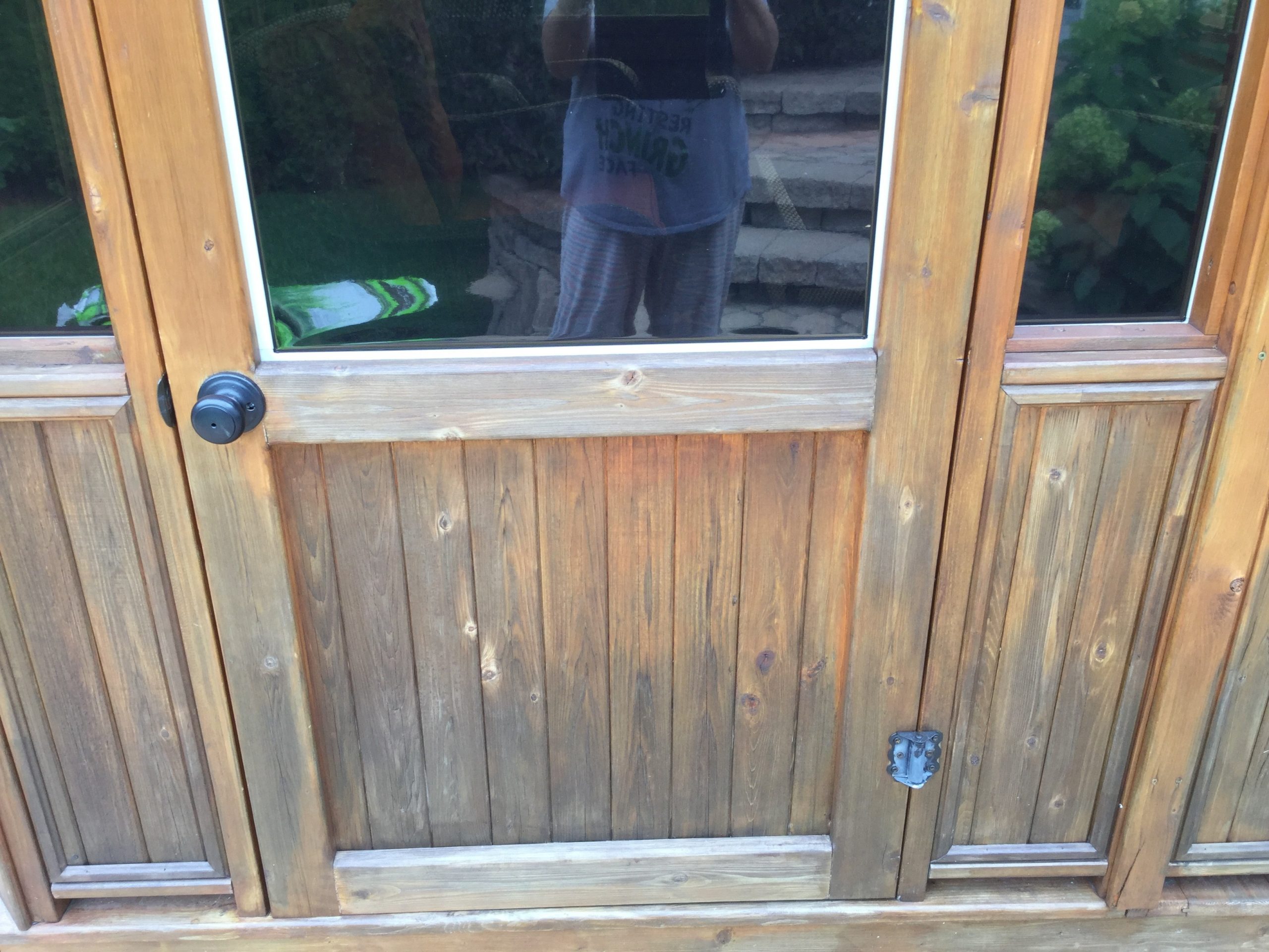

Hi, we need to clean and stain our cedar gazebo, the wood is very dark, we attempted to do it last year without success as you can see. There is mildew on our gazebo. We live in Canada where winters can be harsh, what is the best way in doing this? Is a pressure washer good or too harsh for the wood? Here are some pics
