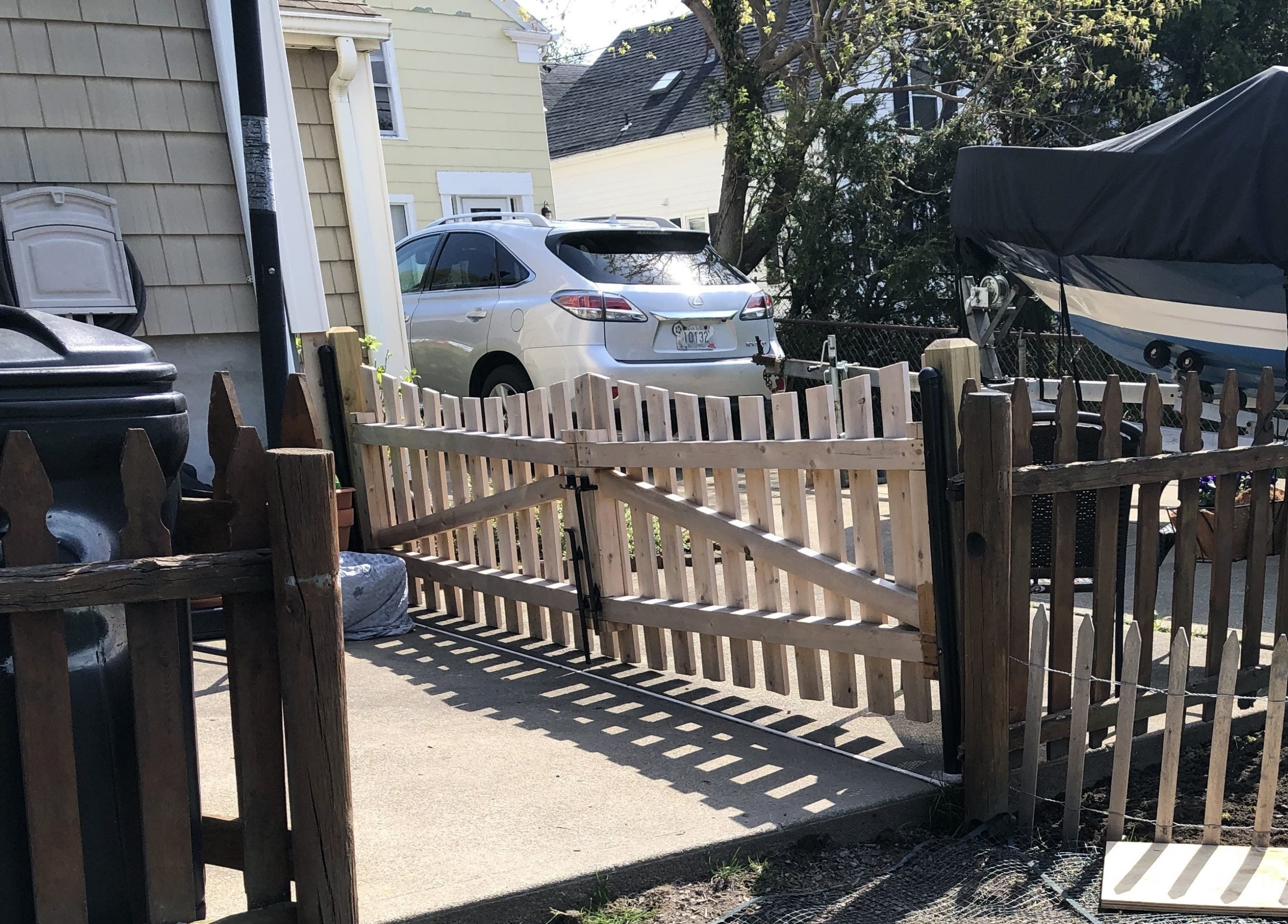

We installed this cedar gate/fence (see attached) last September and would now like to stain with your oil based wood stain. We waited so the wood could be exposed before staining. Do you feel it necessary to do any prep before we stain, i.e sanding etc?
No picture.
Picture of fence gate attached.
Yes, you will have to prep this.
What type of prep do you recommend?
Deck cleaner and then a wood brightener.
