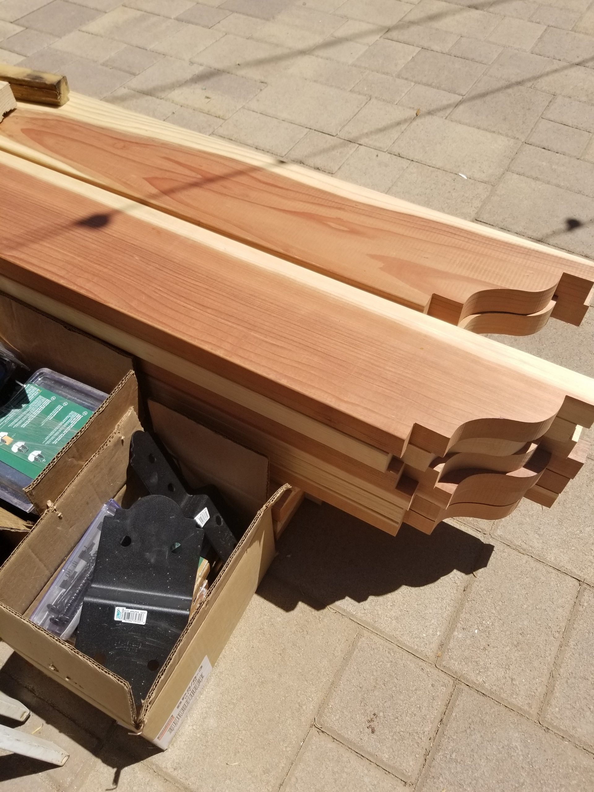

I purchased dried Redwood for a pergola project. Does it need to weather before sealing? I’m in Los Angeles.

I'm planning to build an open patio( attached pergola), I got the redwood from home depot which it was not cheap ($6000),
And I want to make the wood look good and last as long as possible, I was thinking of staining and sealing it before building it, but I'm not sure if that is a good idea or not, how can I know if the wood is dry enough to be stained and sealed? And does it need to be cleaned with any kind of cleaner before staining or not? And also I'm having hard time choosing the brand to use, I'm in Las Vegas and uv protection is very needed here, please advise,
