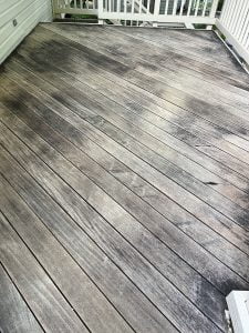

I just purchased a home with an IPE deck and the previous homeowner used BEHR deck over product three years ago and it’s peeling badly already. What product or method would you recommend for stripping than staining the deck the right way?
IPE deck surface showing weathered wood with visible stains and discoloration, relevant to discussions on deck maintenance and staining products.
Peeling Ipe deck stairs showing damage from inadequate stain protection, relevant to wood stain reviews and maintenance tips.
