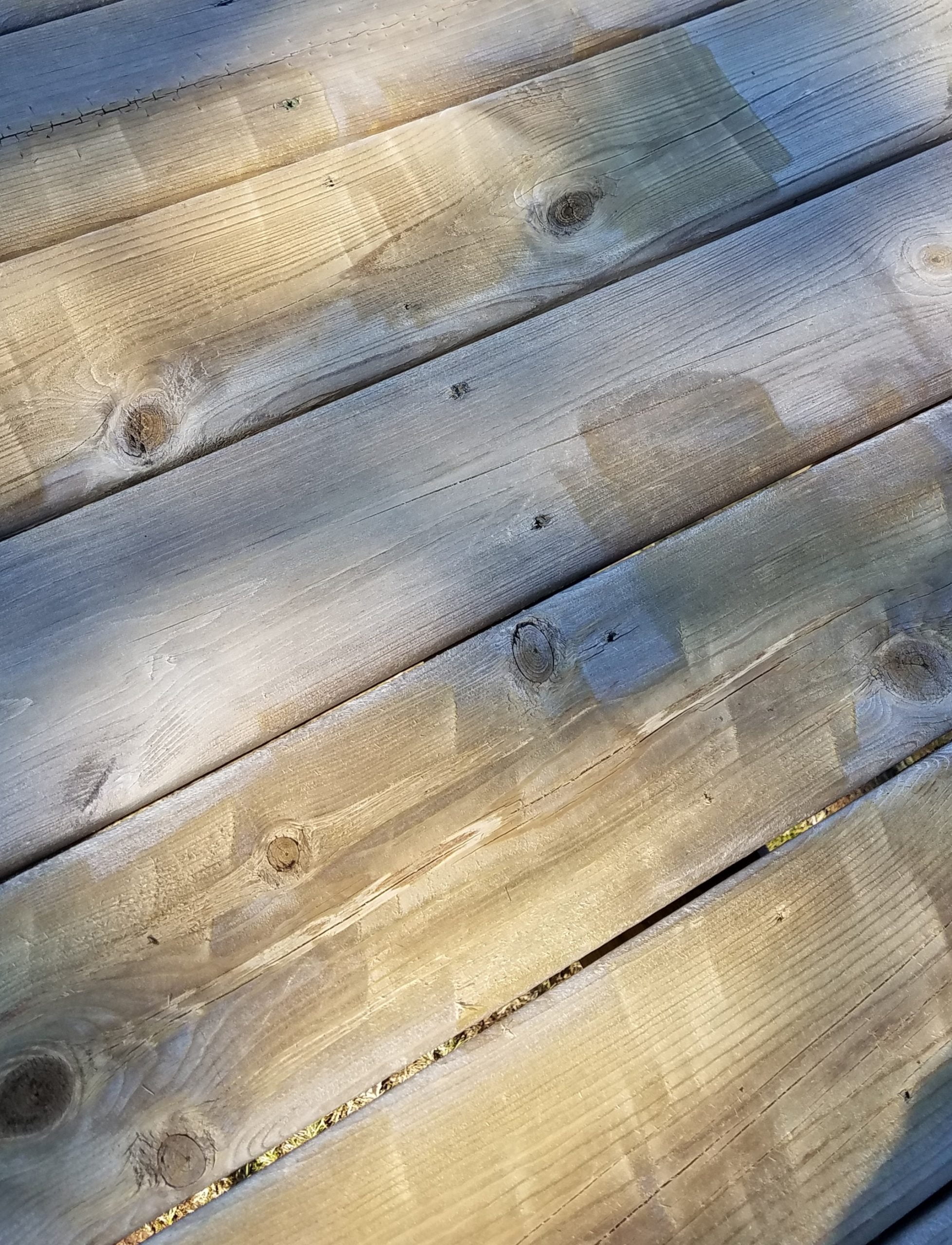

What if I cant get rid of all the grey on the wood? Tried a cleaner with a scrub brush. Tried a pressure washer. Going to sand away the wood fuzzies and then use a brightner andrl then stain it with a semi transparent stain. Will it work properly?

Should I try spraying the deck again with deck cleaner. Let it sit 10 minutes and use the pressure washer?

This is after power washing and then two times cleaner with bleach sprayed on and scrubbed and then one more spray of cleaner and usedthe pressure washer again.

I know but I’m literally holding the nozzle right to the wood. Moving it very slow and going over each board 5 times to even get it like this andworried I’m going to ruin the wood as I’ve made two deep tears with the pressure washer.
