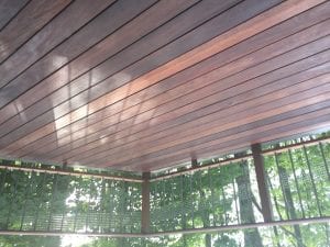

DeAnn Dunlavy
DeAnn Dunlavy
Here are the photos to go with my cabin stain questions
DeAnn Dunlavy
DeAnn Dunlavy
I have learned so much in the last two weeks reading on this website, and now need input about the best course of action on my widowed mom’s 50+ year old pine TG cabin (south facing, at 8300 ft elev)in Utah that has been treated for the last 20 years with Messmers UV Plus ( it was originally finished and maintained with Marine varnish, but that was messy to reapply . (see attached pics)
We used Natural a couple of times, which started going dark, and then switched to Pine color , hoping to “brighten” the color the last time, but it only became darker. It was not cleaned and brightened any of the times before staining (which after reading here is probably part of the darkening problem). We stain only when the old stain has degraded, so it has always absorbed well (maybe pulling in surface dirt?)
It also seems to have a thin “crystallized” stain film all over it. (maybe from over-applying?)
Three courses of action I can see listed below, based on info from this site:
1. which of those listed below is better given these circumstances, and is there a better fourth option?,
2. do I have the steps correct in each?
3. is there anything else I need to know?
UV protection seems to be the biggest criteria.
The water-based stains have a higher UV rating for preventing graying…
Does that also mean that they resist degradation longer, i.e., would need to be re-stained less often?
What are the relative re-application periods for each of these 5 products?
A. Continue using Messmers, and probably remaining as dark as it currently is
1. Clean and brighten- is there a reason to use Messmers AB vs Restore-A-Deck, which has better reviews?
2. Wait 3 days to dry, then roll on ONE coat of Messmers UVPlus.
B. Strip and use another oil-based stain -OR- water-based stain
1. Strip with Restore-a-deck plus both additives , then brighten.
2. Do I need to sand either before or after stripping – what are the benefits (its a huge, hard to reach area, so the benefits need to outweigh the difficulty)?
3. Wait 3 days to dry if using oil-based
4. Stain with one coat of rolled-on Oil-based
4a. AC (preferred, except all their UV protection colors are Cedar or darker
4b. TWP1500 in Honeytone
-OR-
5. Stain with one coat of rolled-on water-based stain
5a. Restore-A-Deck Stain
5b. Defy Extreme Stain
Thanks so much for taking the time to answer

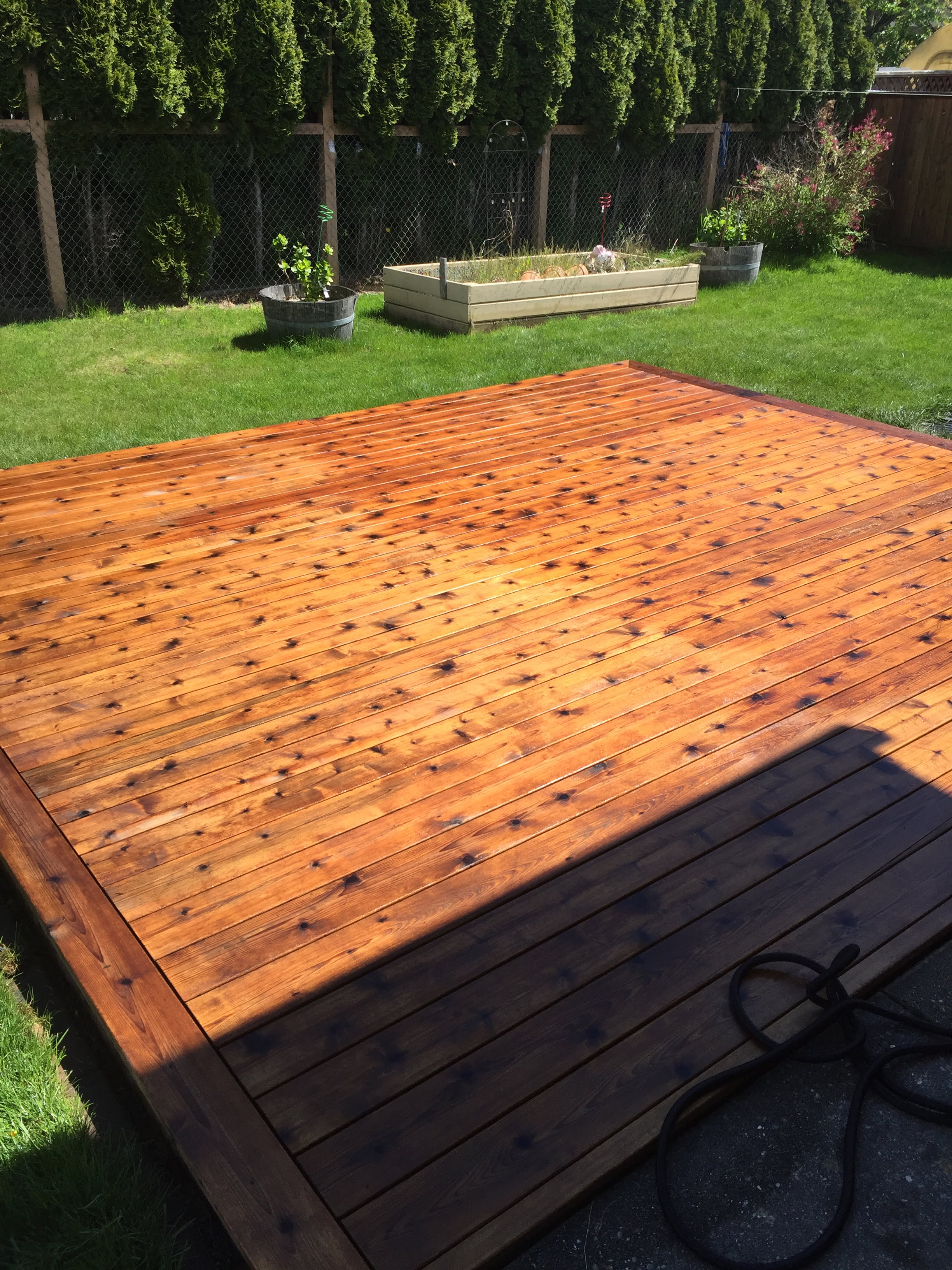

Torry
Torry
Just applied messmer’s a second time after 2 years on a cedar deck. Fraser Valley, BC, Canada so we get a lot of rain and where we are it is very windy in an agri area. I washed gently and used brightener after one season but was dissapointed with the results. We get a lot of dust. I left as it was for season 2 but could really notice the dulling due to the rain and dust. This season I used A/B with a good stiff bristle brush and I must say I was shocked at how much dirt came off. I was actually muddy in most areas. After a good rinse and then the brightener I brushed UV Plus again (natural) then wiped excess off each 20 minutes as I went. The results were as good as I had hoped. Deck looks wonderful. So for the $120 CDN every two seasons I consider that I decent investment. Yes it was a bit of work and prob spent about 6 hrs all together. I am very pleased. Avoid applying in the sun as it will get tacky quickly. First two photos were cleaning and deck wet, last was finished and excess wiped off
