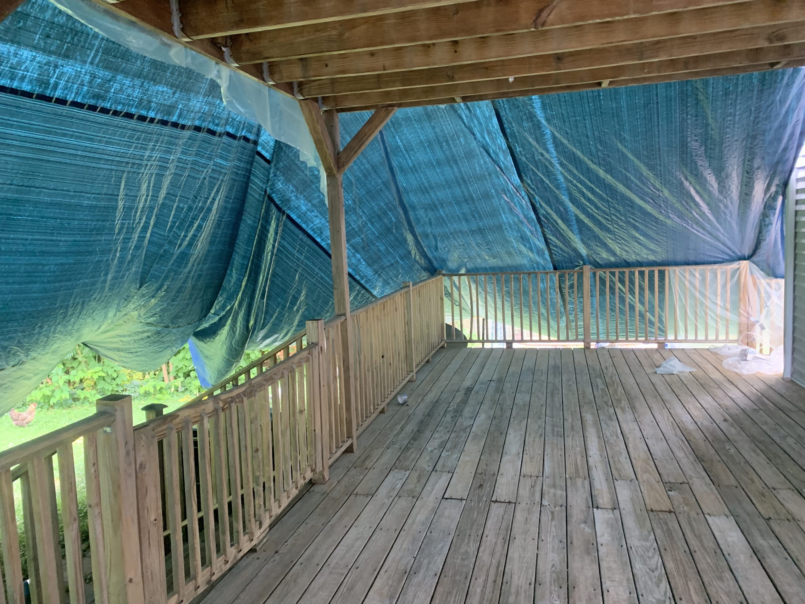

I have a weird scenario and I was hoping for some advice.
Quick question: Will tenting the entire deck after cleaning ever allow for the water moisture to reach the manuf recommended moisture level? Outside moisture is ~80-90% due to rain and general humidity. No real sun due to rain, rain rain. Will a dehumidifier help even with 4-6′ openings or if I choose to close it down completely.
Will the stain dry properly under the tent or does it require sun?
Longer version:
I have a 15 year old deck (mix of pressure treated decking and pine railings) that was only ever thompson sealed and cleaned every 1-2 years. This year, I want to apply TWP 1500 and I used the RAD cleaner to clean and brighten.
Unfortunately, it is summer and I clearly did not do enough research after hiring the contractor from a mix of 8 that came to the house. He is pressuring me to apply the stain and throwing out that he is the professional and everything will be fine, but we have had rain, rain, rain and the humidity is extremely high – 87% or so. The deck is raised and I drainage is not great, so there is likely a lot of moist soil under the deck.
I have a moisture meter and the pressure decking has never reached under 87% (most 100%) and the railings/spindles are between 37-60%. This reading was taken after 48 hours in an area that did not get hit by the light rain.
Last night, I gave up and tented the entire deck with a 30×50′ tarp as the forecast is rain/thunderstorms for the next two weeks off/on. There I have a 12×12′ upper deck with a 25×12′ (roughly) bottom, so that made this possible, but it did rain lightly before I tented the deck.
Tomorrow and after should be mid 80’s with ~42% humidity, but generally speaking storms pretty much for the next 10 days.
Thank you kindly!
Ben
Ben
Thank you for your guidance! From my perspective, I really have no choice but to keep the tent up or tear it down and wait until fall and start over with cleaning/brightening. Rain is forecast ed for at least every other day for the next 10 days and my understanding is that I really need to wait 12-48 hours after applying or the water can/will displace the TWP? Also, since the wood is already damp it might make things worse given the oil would not soak in.
The deck moisture (rails) was already 32%+ before the cleaning / without rain. That said, the moisture levels are coming down a bit with the main decking at 77% in may areas. I do have a pretty fair natural breeze with 3-10 mph winds all day and as mentioned the tent is between 2.5-5′ off the ground depending on what I attached it to, so it feels like it should have air to dry.
If you were curious I posted a single picture from within the deck tent and the deck is 3.5′ off the ground.
Thank you again!
