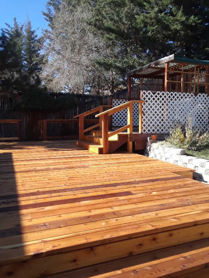

Hi couldn’t rate in regards to uv graying, color darkening or mold mildew as just applied. It was a pleasure to apply and very easy to use. Ours after testing 13 small samples we opted for the clear. The deck turned out exactly as desired. Looking forward to fall application as it is easy to work with.
Orland Park Il May 10 2017
Conditions partly cloudy, low humidity, temps 60’s, slight breeze. deck previously stripped and brightened. Two full days of dry time. Application via 3 and 4 inch brush. wiped with lint free cloth.
