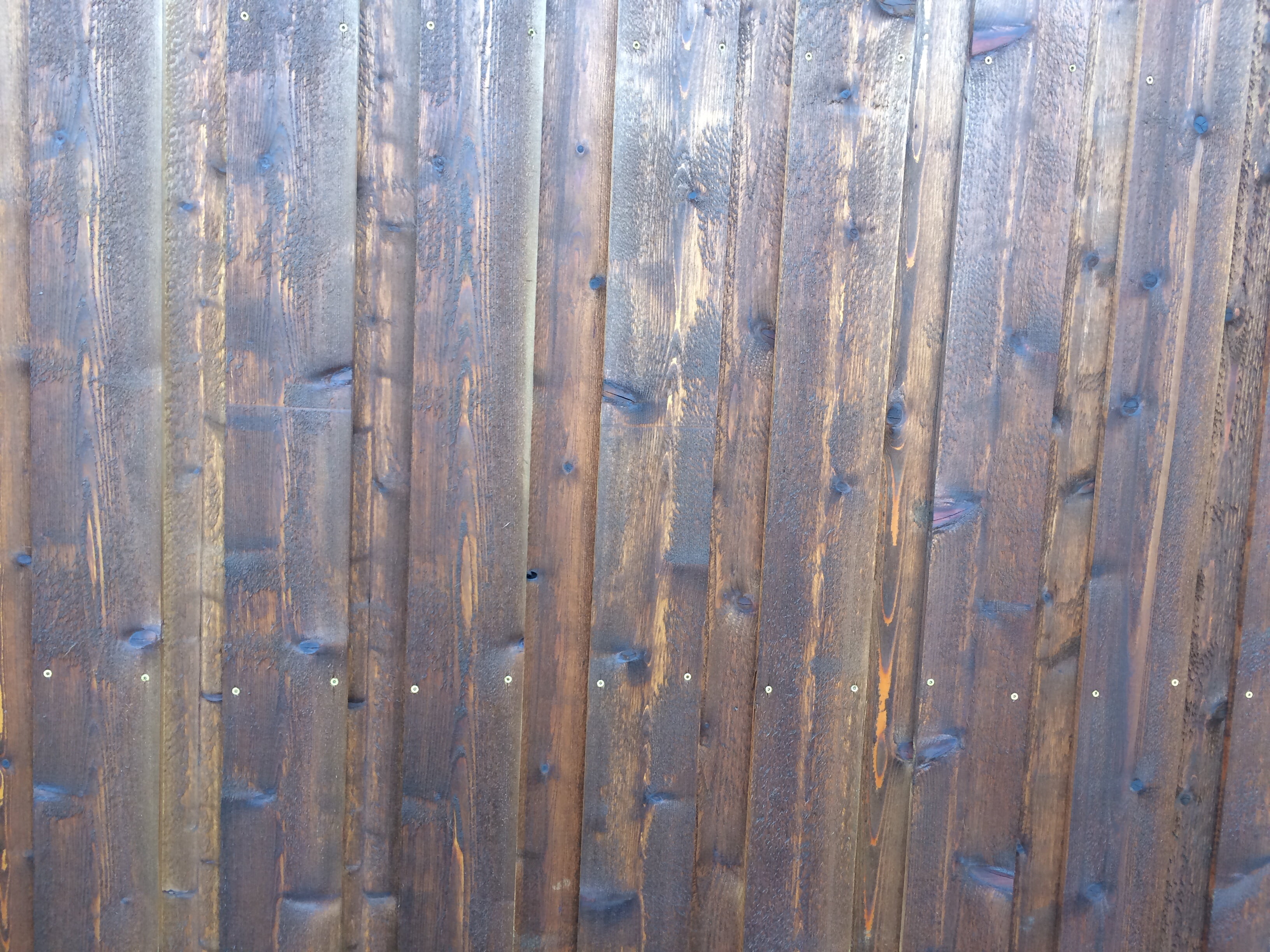

Our builder delivered new green (wet) cedar to our home, but it also rained on the wood for two hours that day, and then he built our fence with the very wet pickets. He returned just 36 hours later and stained with Ready Seal dark walnut. Of course the stain job is completely uneven and four different colors, but the worst part is that all of the defects in the wood turned very dark brown – black and the fence looks horrible; I suspect this is because the tannins never had a chance to dry and cure before being soaked with oil stain, but do you have a reference that I can read to understand this better, and at this point what can / should we do?
James
James
I will post three images. One of the new “wet” stained fence, one of a 17 year old gate that was power-washed and stained, and one of a two month old fence that was never stained until now; all three were stained the same day with Ready Seal.
Russ Newberry
Russ Newberry
Reply to  James
It looks, to me, like the left side of your fence (in the picture on the left) was sprayed with dark walnut and the lower right portion was sprayed with the pecan stain. The door and the non rail side of the fence both look like walnut. I’ve used Ready seal for years and have never seen that kind of color difference. This is purely speculation, on my part, but it sure looks like two different colors of stain were used…
tim
tim
Reply to  James
it appears as if the product wasnt mixed well the lower was the mostly solvent “top of the pail” and the upper was the “bottom of the pail” where all the colorant settled. as for the photo on the right soft woods need conditioner directly before staining to take stain evenly
James
James
Reply to  tim
Thanks for your insight Sherlock. The fence builder stirred the stain, he’s not very bright but he’s not that stupid!
Ready Seal is just a really crappy product designed for ease of use by DIY’ers and fence builders with little professional continuing education; read the reviews by the professionals here at Deck Stain Help.
I had the crappy Ready Seal chemically stripped off and then restrained with Bakkers, no more black knots and defects, just an even single tone and single color of high quality stain that will last for 5 years.
Do your research, Ready Seal fades 50% within 18 months and has no UV protection, just garbage.
