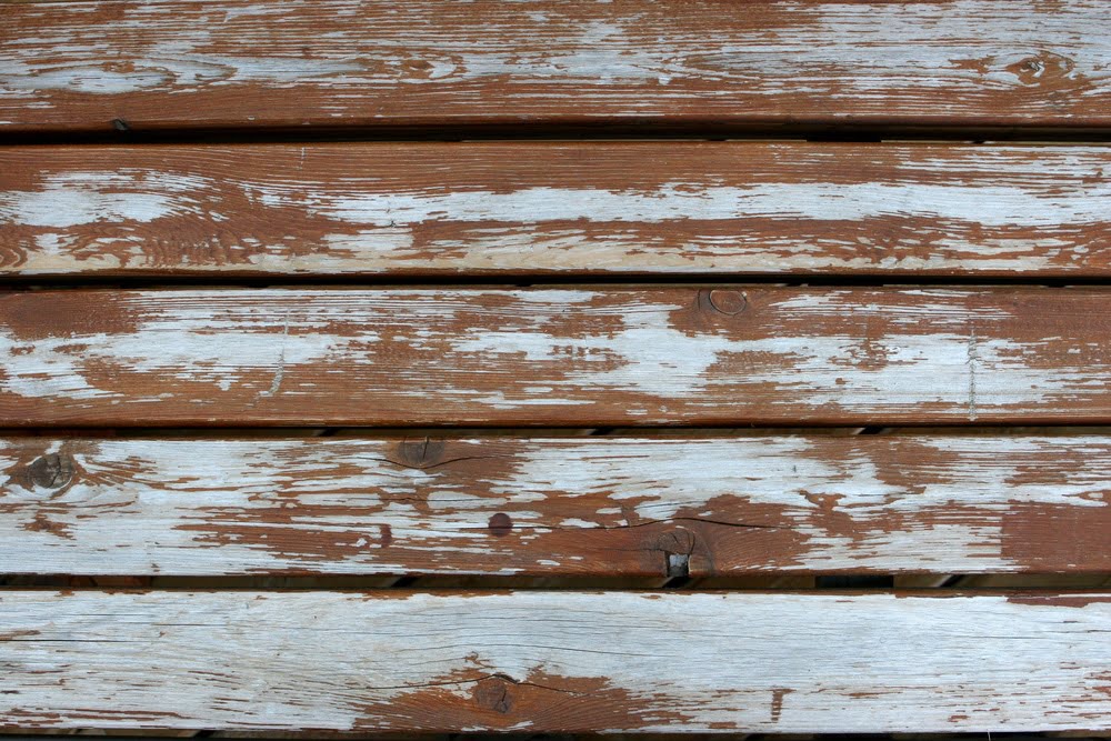

There is no need to remove the old transparent, semi-transparent, or semi-solid deck stain coating for reapplying unless the old stain has failed by wearing and peeling unevenly. Uneven wear may lead to uneven application. When reapplying the same deck stain and color brand, use a wood deck cleaner and a wood brightener for prep.

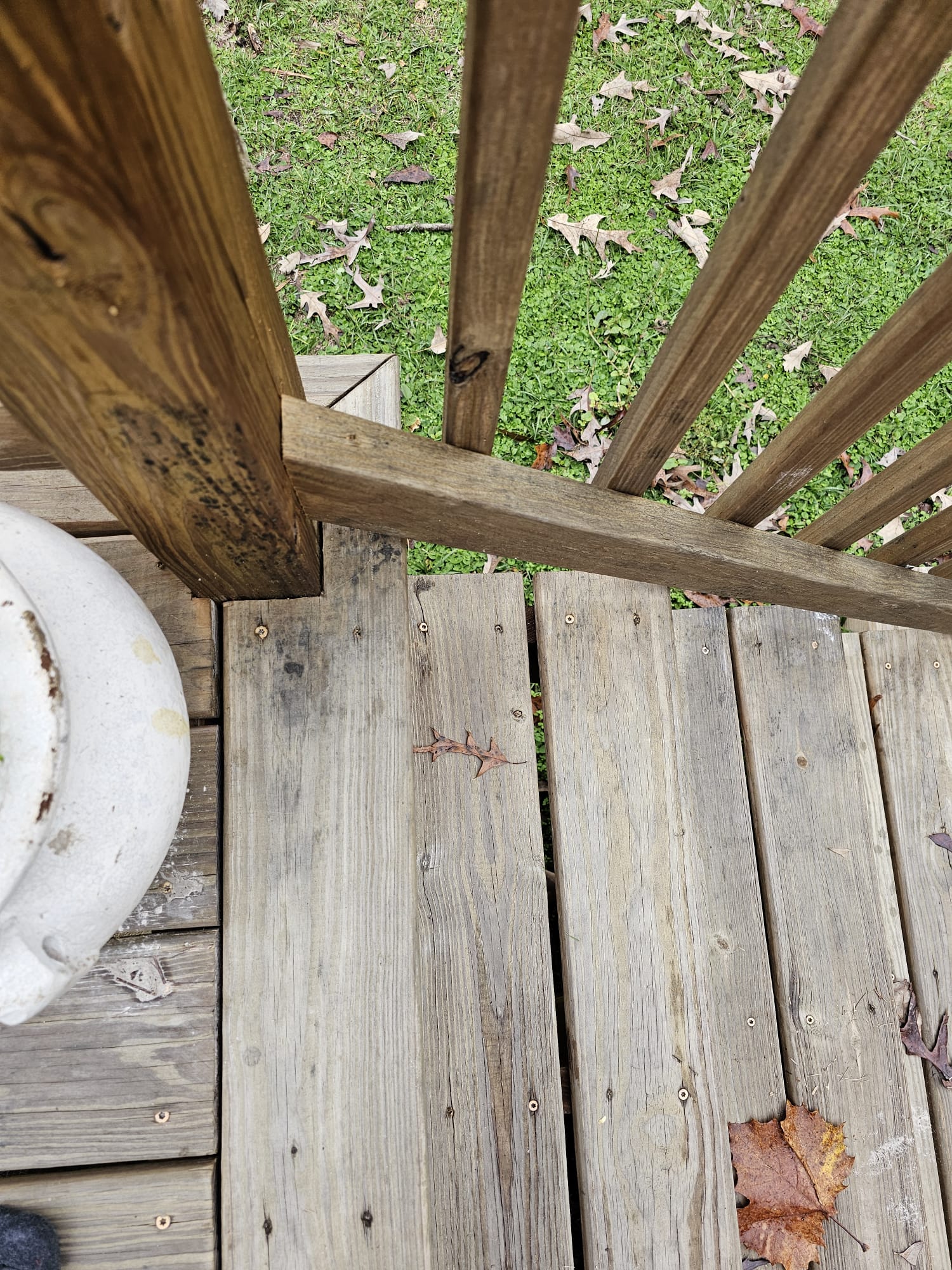

Hello. I am in north/central Florida, I had an 180 sqft deck built about a year and a half ago. I sealed it with oil based Olympic Maximum clear sealer about 6 months ago, never used any kind of stain, just clear sealer. Now it’s looking gray and dull, theres is also some mold/mildew on some spots. How should I prep it for staining?
I’m not sure what product I’m going to apply once its prepped yet, i have to decide wether i want to use solid stain or semi transparent. What will require less prep work? And maintenance in the future. Thanks so much.
