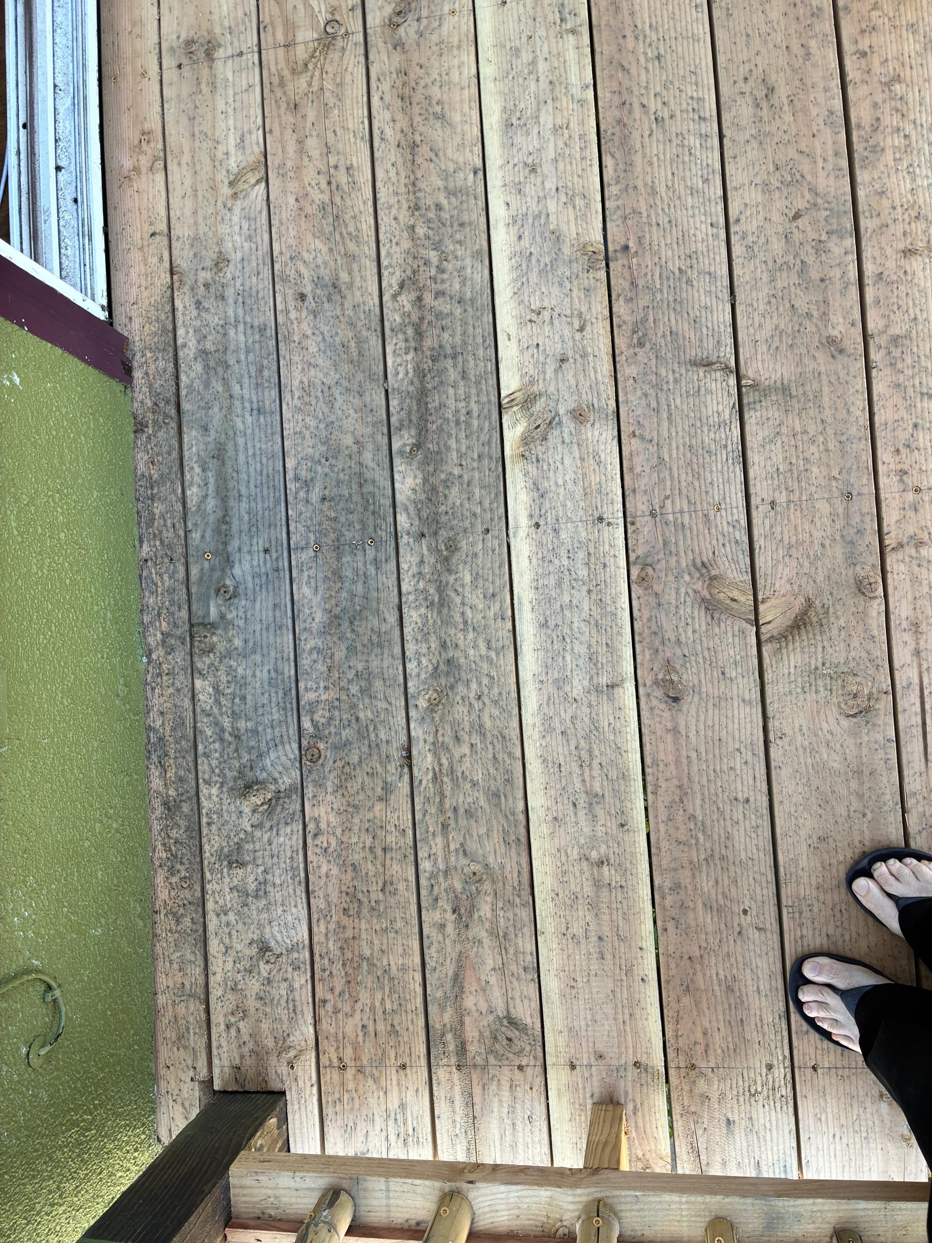

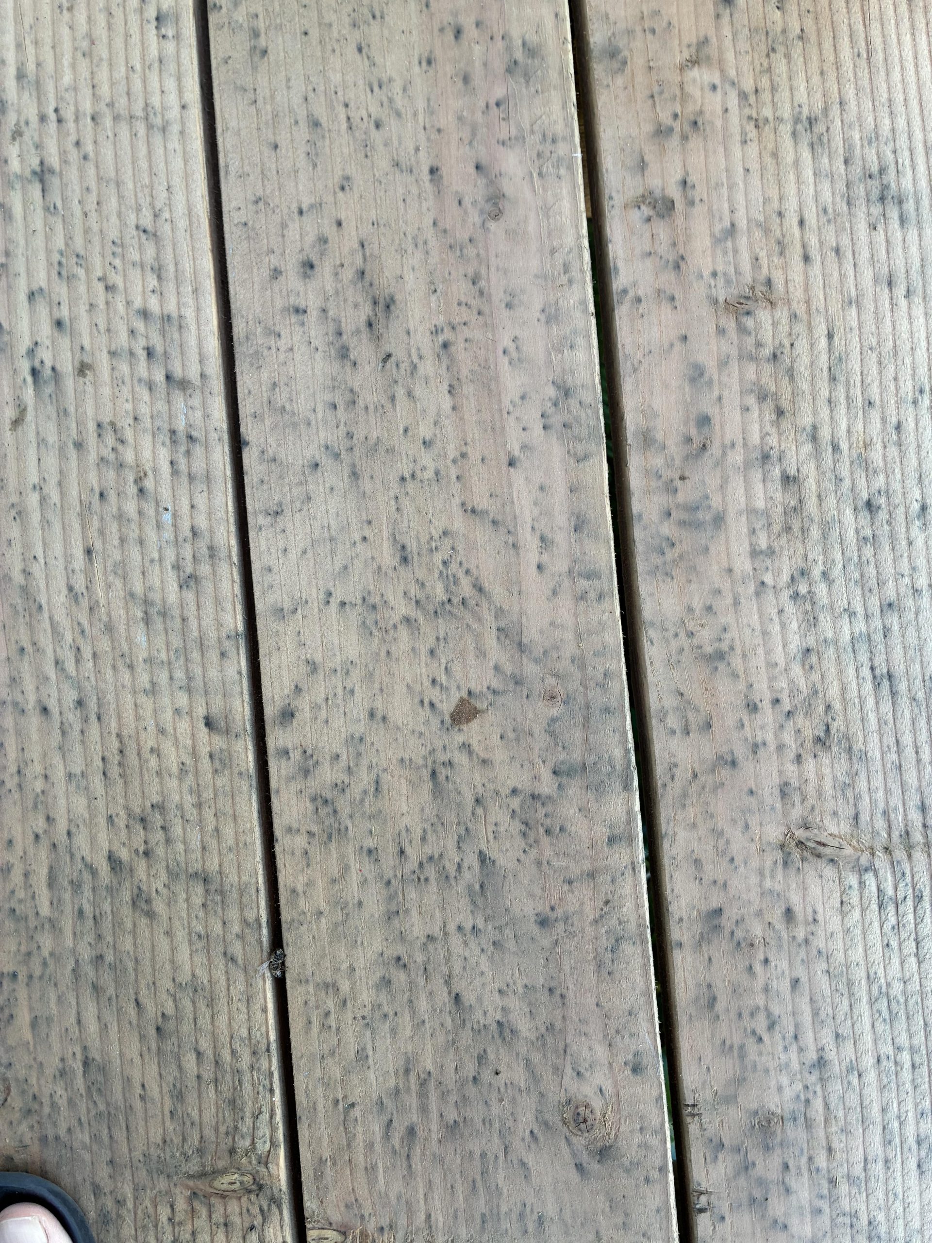

Just installed Doug fir planks to replace deck and it rained before staining. Looks like black mold. Any help appreciated north facing deck in Northern California.

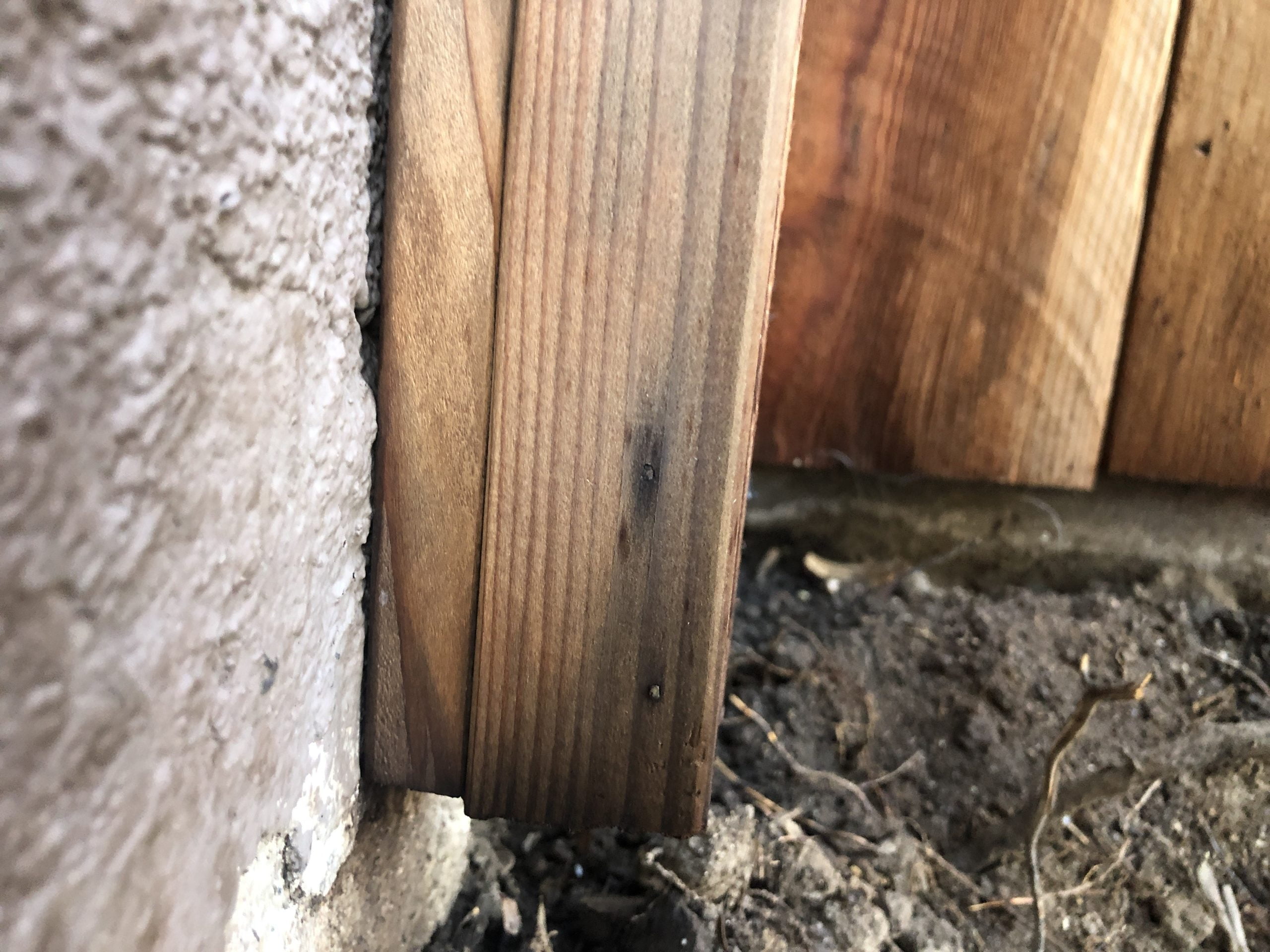

I have black rust spot from nails on my redwood fence- the redwood is untreated (we live in So Cal and have very good weather). The fence is beautiful other than the eye sores: black streaks around all the nails (just like your pictures show). Is there a way I can spot treat to remove the stains, without having to then stain the entire fence?
I have tries TSP (made the TSP, bleach and water mix, as well as the TSP water mix) , hydrogen peroxide solution, dawn soap (that cleaned the fence but did nothing to the black marks), oxalic acid. But all those change the color of the wood, significantly.
I’d love some feedback, guidance and help.
We love the color of the fence and do not want to change it at all by staining it.
Thanks in advance

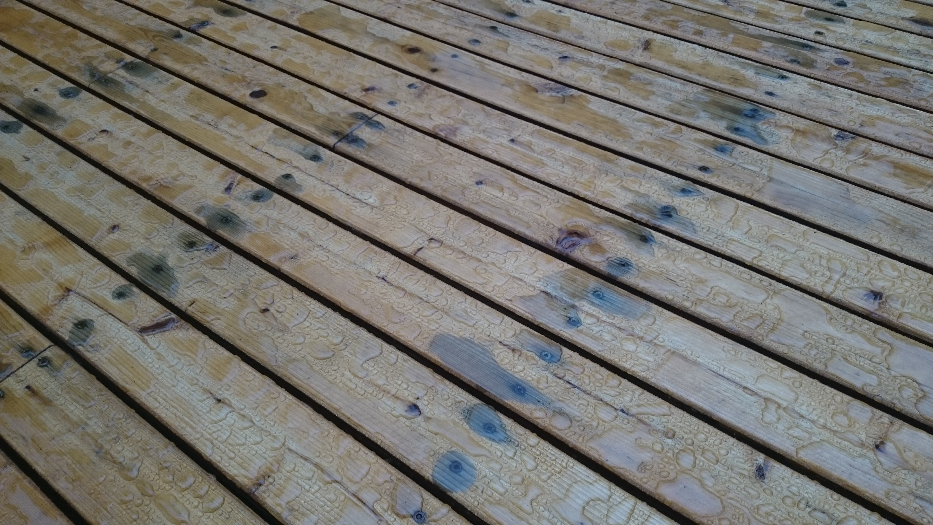

Hello, first I’d like to thank you for this site. The best collection of information I’ve found. So I used pressure treated pine with bronze coated screws for a deck I built last summer. Most of the boards have cupped, so my plan was to flip them over, clean with oxiclean, brighten with oxalic acid and seal with Seal-Once clear. I tried this on a couple of boards, and it worked well, except after using oxalic acid to brighten the test boards, I got these black spots around the screw holes (screws had been removed). Any ideas of what caused them and how to get rid of them? Thanks again.
