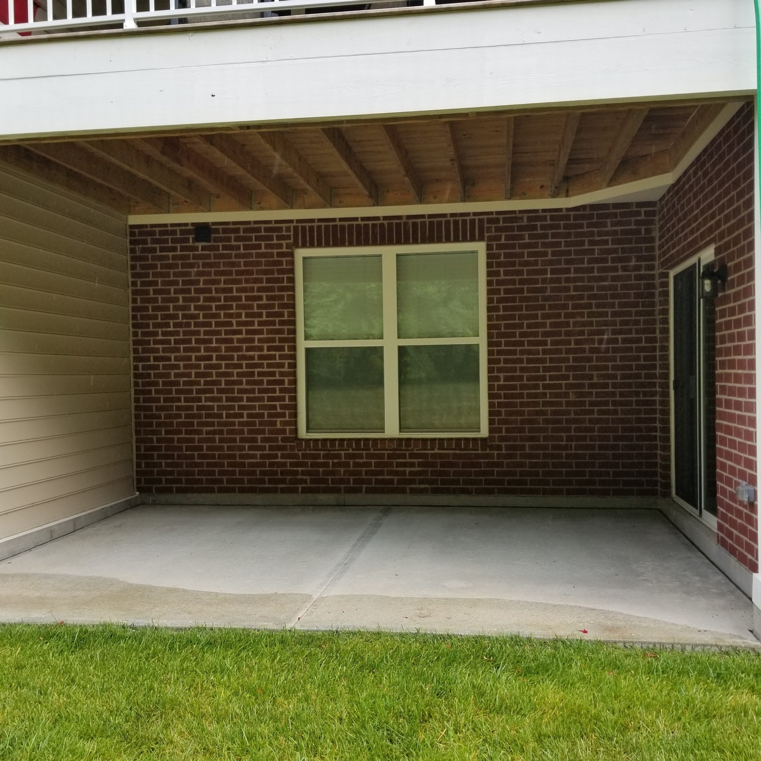

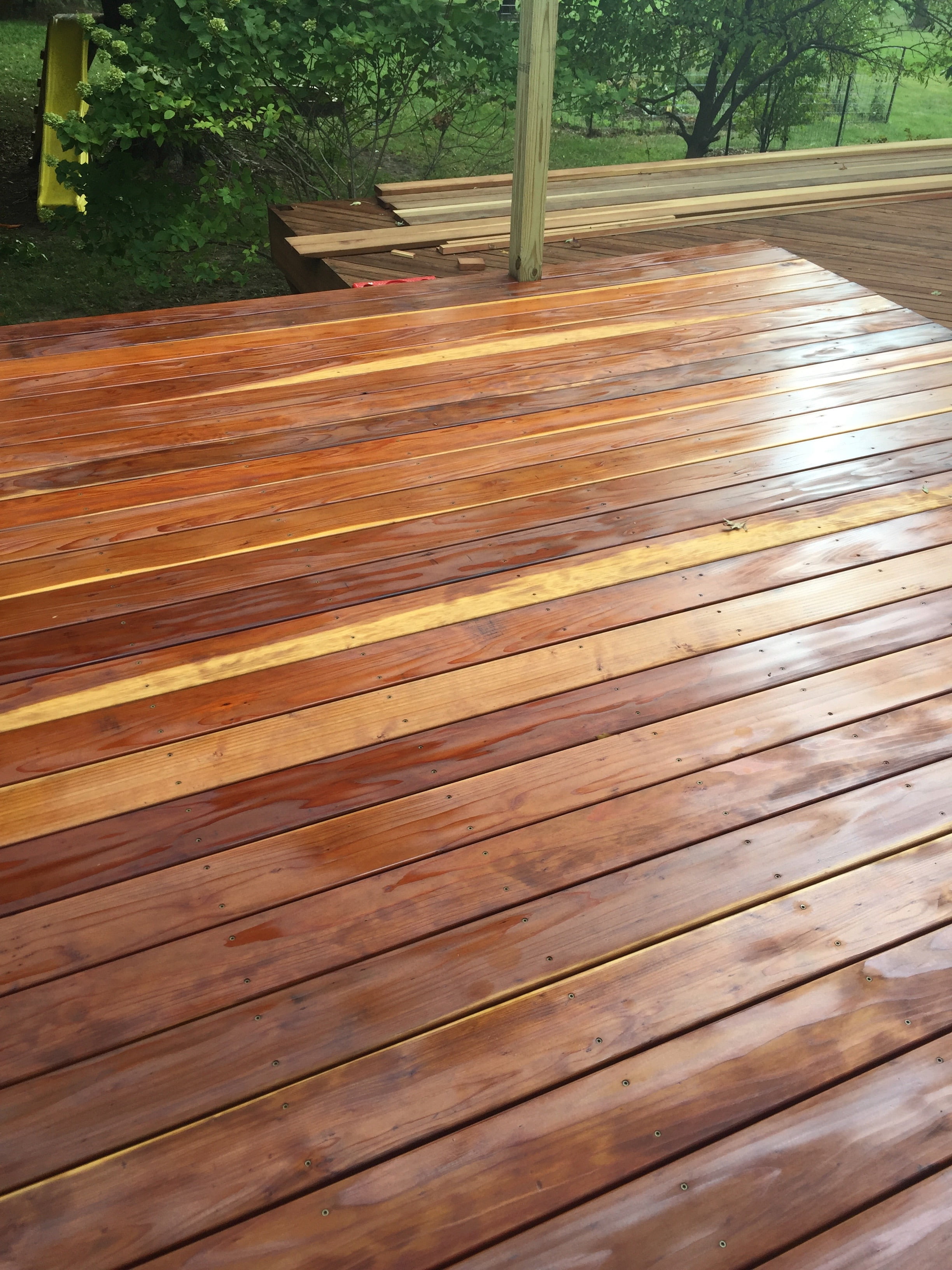

Now that I finished my deck project I thought I’d submit a review of the RAD products. My 500 sqft deck was stained with Pennofin back in 2010 then completely neglected since then. And I mean “completely” neglected. I didn’t have very high expectations coming into the project.
I couldn’t be happier with the results. I used RAD stripper and brightener kit for the project. This is industrial strength stuff so I took all the safety warnings seriously. I wore long sleeves, rubber gloves, painters mask and eye protection. I applied the stripper to 3/4 of the deck via sprayer before it clogged, then applied it via brush the last 1/4. After 30 minutes I rinsed it off with a 1600 PSI pressure washer using the green nozzel. It ended up removing 95+ % of the old stain.
After applying brightener to the whole deck I wasn’t completely satisfied how the brush application section turned out so I took another pass at it with the stripper. Then via a suggestion to a question I submitted earlier in this thread I applied another application of brightener to the whole deck and let it dry into the wood. Fantastic results. I ended up staining it with TWP Honeytone.
Before, stripping/brightening, and after photos tell the story.

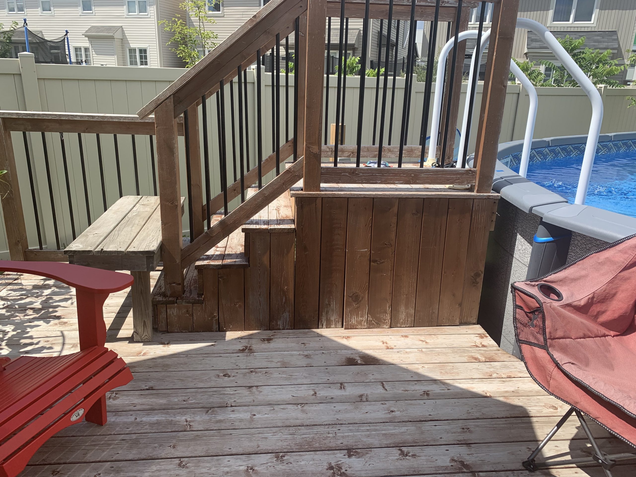

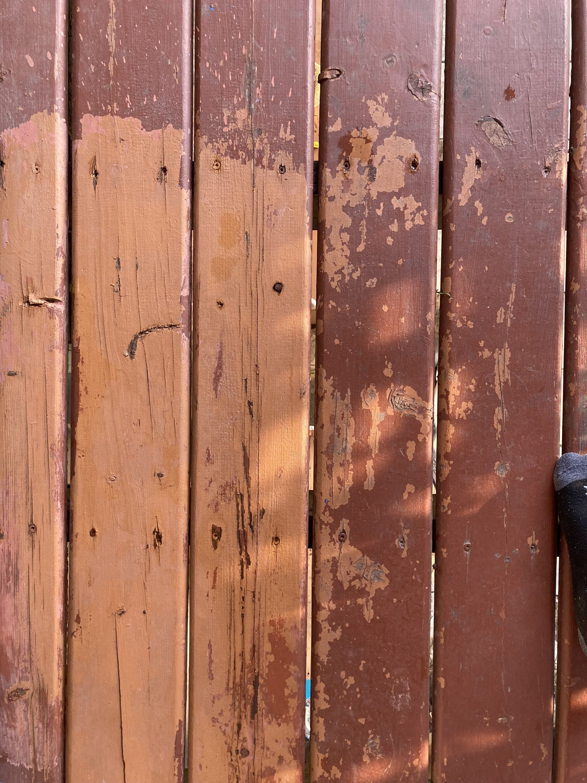

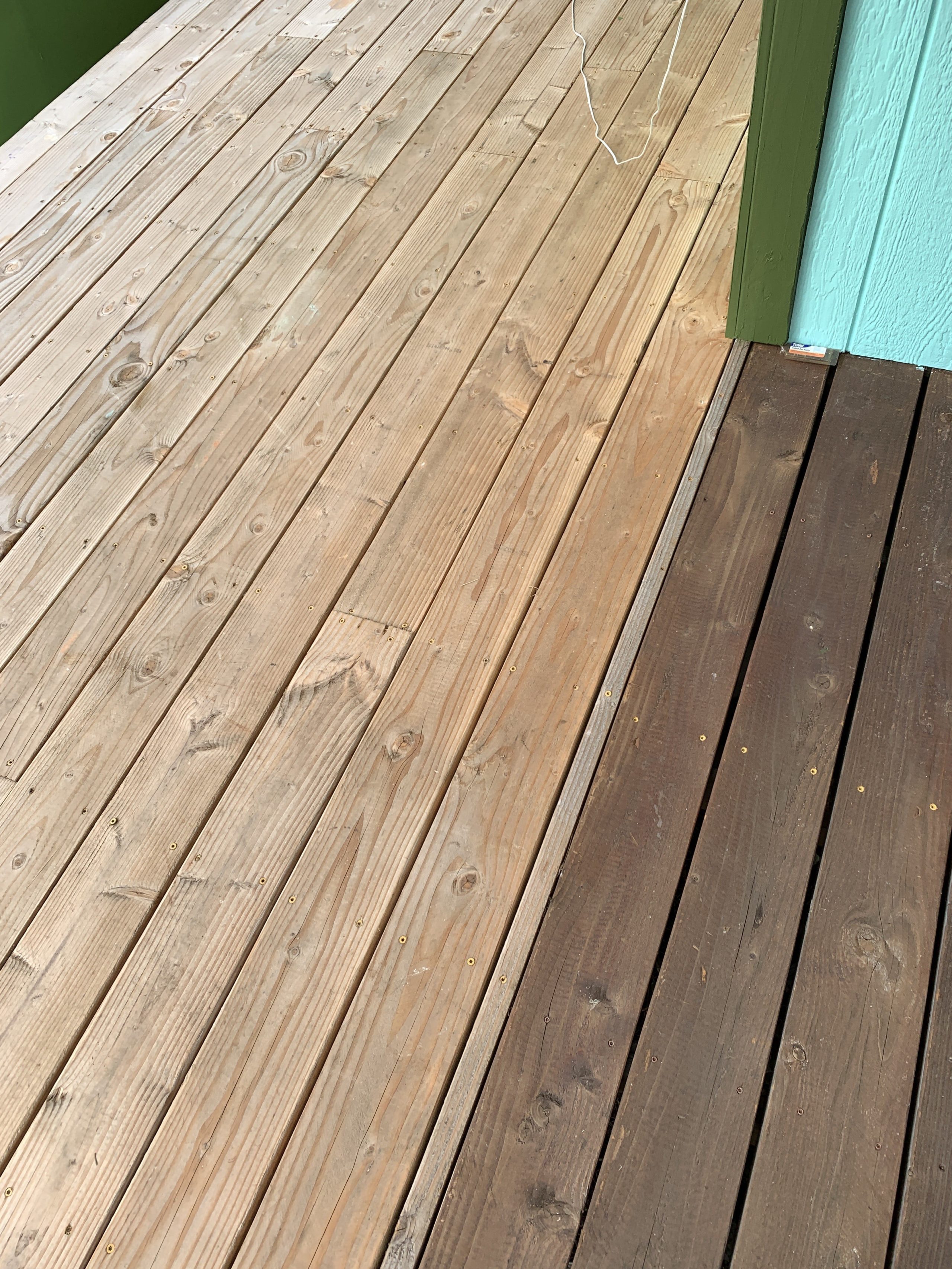

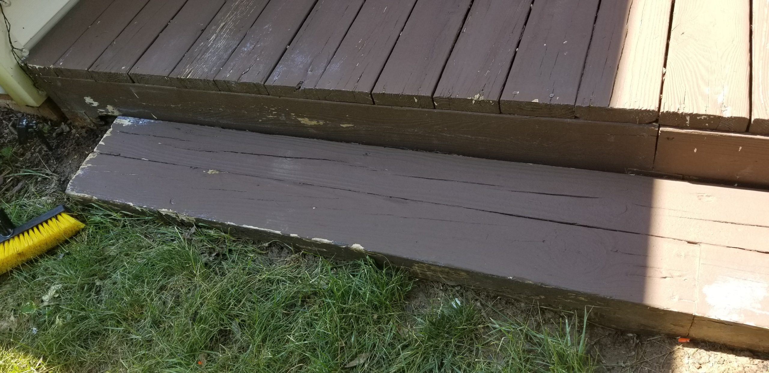

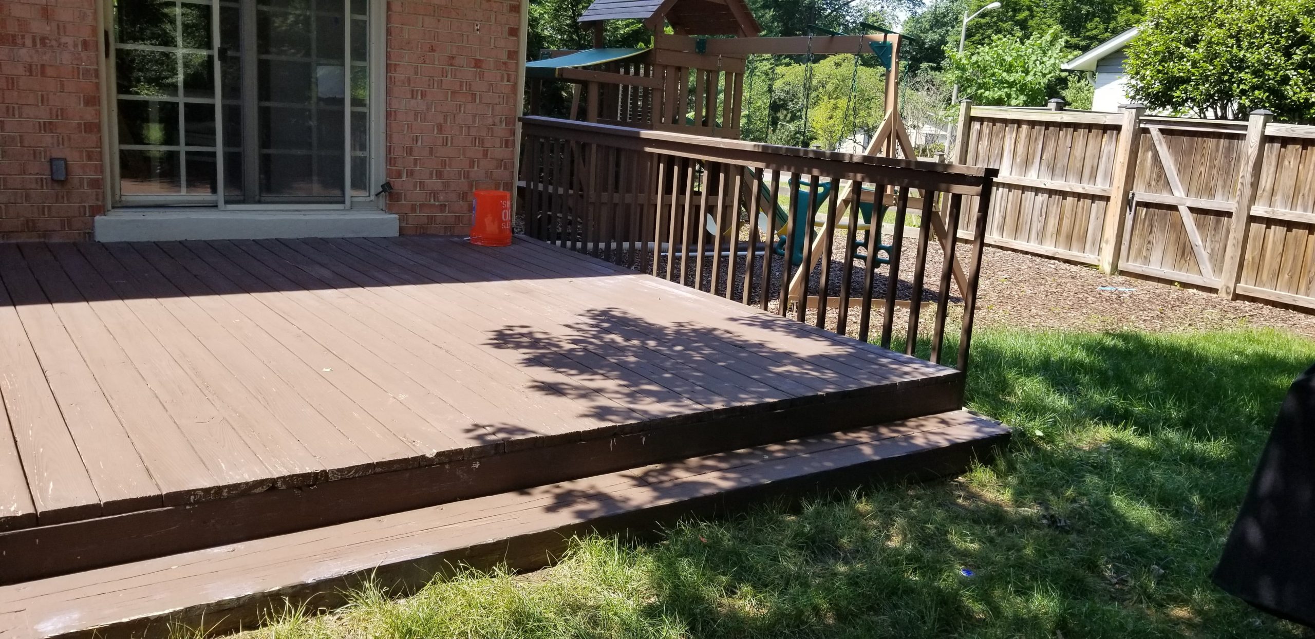

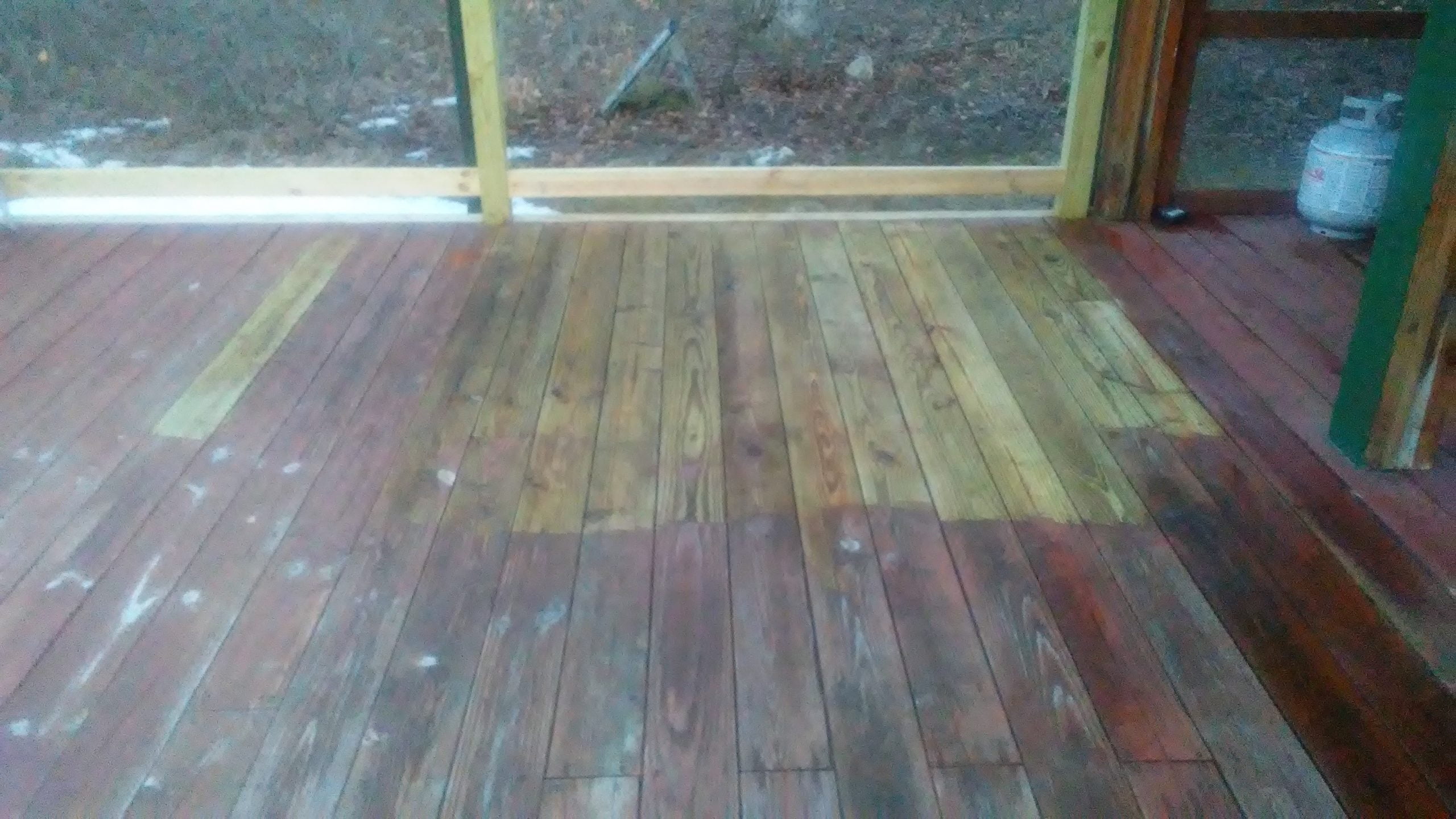

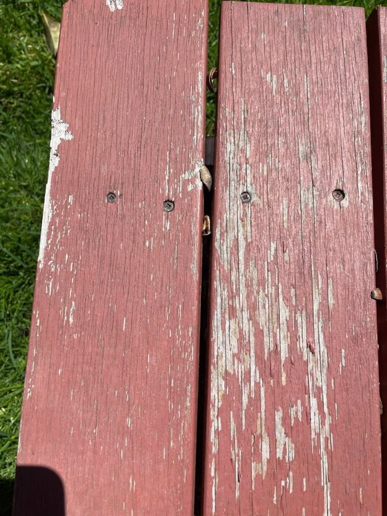

I have a deck by the driveway that has had the wood replaced on the flooring and railings in October 2025. It is past time to get the bare wood (pressure treated) covered. As you can see from the pictures, the base and uprights still have old Behr Premium semi-transparent, water-base stain on them. I would like to strip the Behr stain and have the whole deck coated with an Armstrong-Clark stain. I am not sure of all the prep products that I will need to complete this. I have read your columns about RAD stripper, booster, gel, brightener, and cleaner products. Do I need all of these products to prep my deck properly and, estimating from the pictures, do I need only one bag of each?
If I don’t use the stripper, I know I will have a two-tone deck, which I do not want. Also, will the stripper do damage to the black wire mesh paint? If I get this done by a professional, what equipment will they need, like pressure washer @ 1,500 PSI, etc.? Please give advice on the prep products that I will need, and the sequence for application and any timeline you would follow. I realize there are a lot of questions here. Sorry! Thanks.

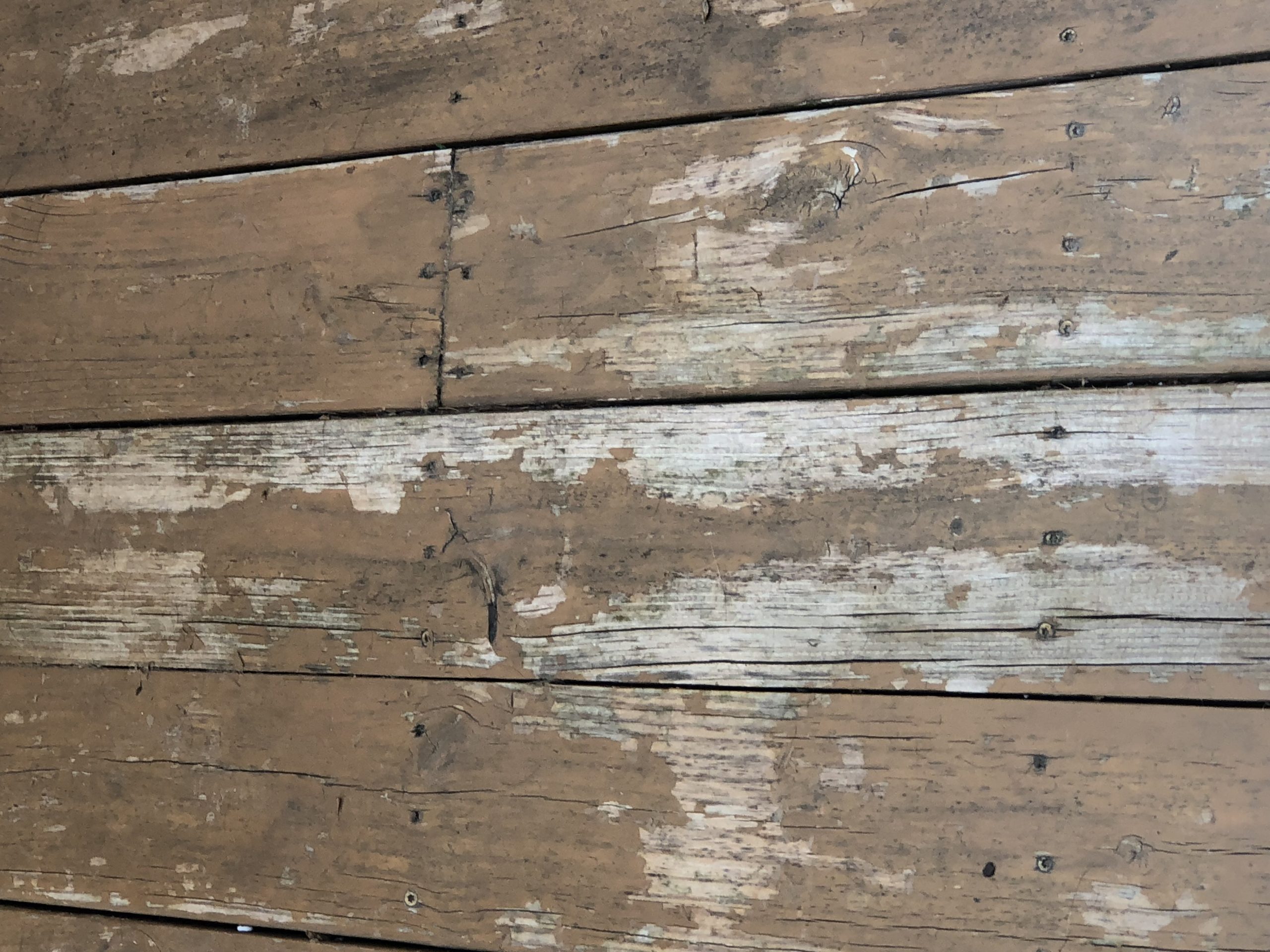

Best method to remove several layers of latex stain from my pressure treated deck

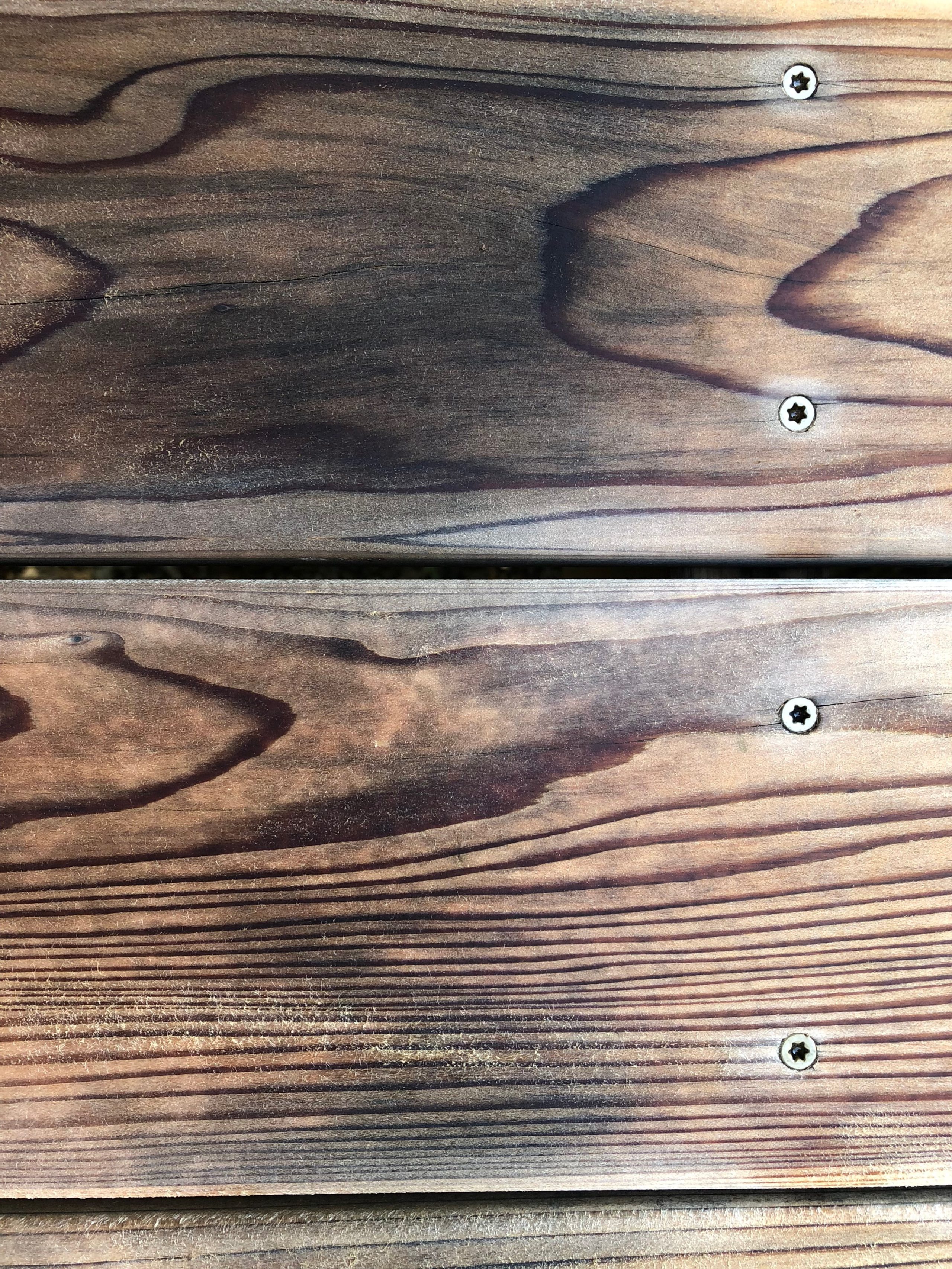

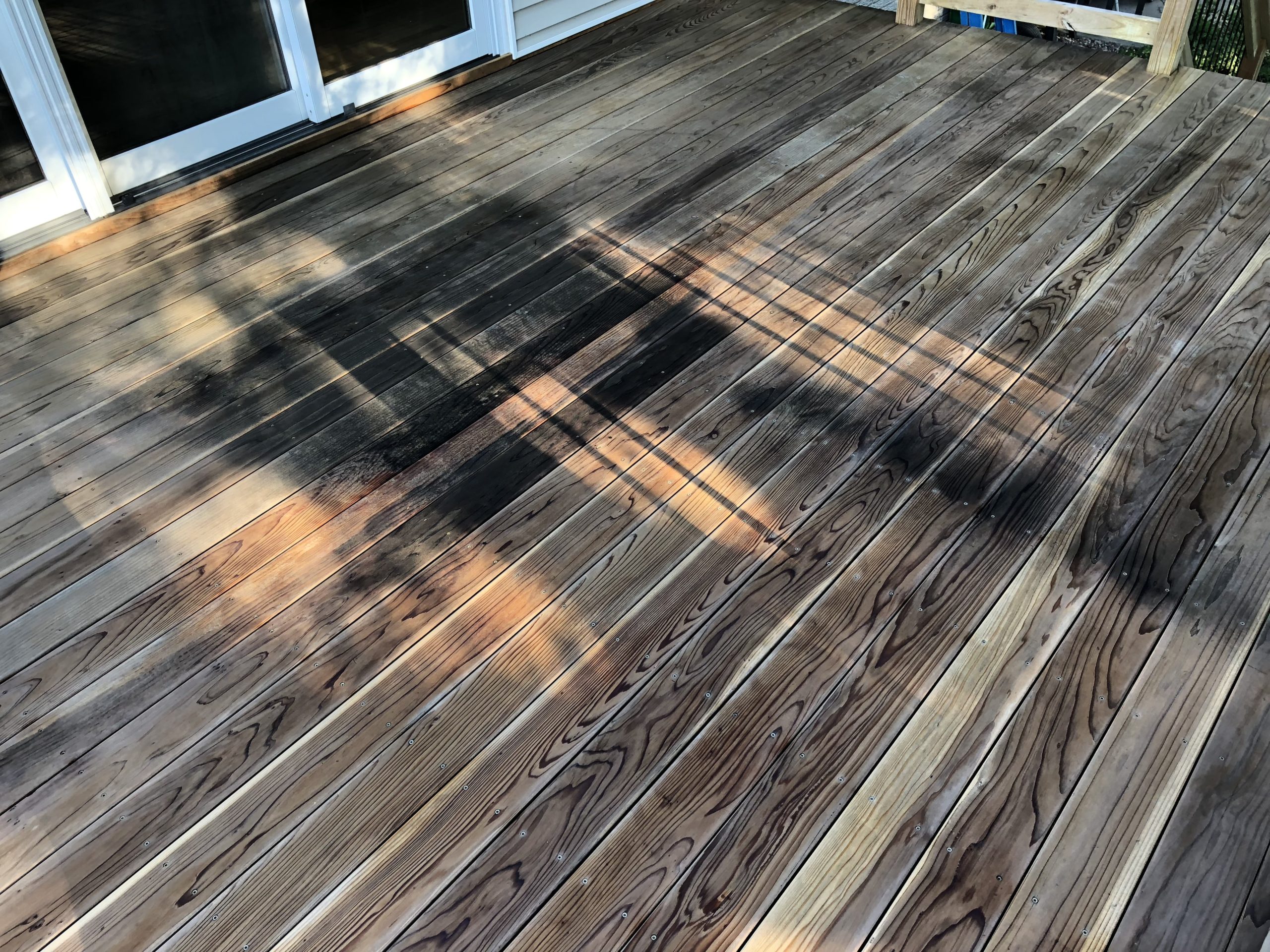

A year ago in September, we had our deck rebuilt by a local firm with cedar, it came out Amazing. It had a great smell and looked good unstained, however I was on a mission to protect it. What I chose post a recommendation to coat it was *****sons. It looked good at first, but after one winter it pealed in chunks and after a pressure wash that removed most but not all, the deck now looks like a “Rat Rod”. Rat Rod’s might be cool, but that look is not for my deck.
After looking at your product lines, I have an understanding and a guess as to what your recommendations might be. I look forward to seeing your response as to how to move forward and protect our deck in the most transparent/natural color, so the cedar shines through.
Thanks in advance!
Deck_Sept_2025
Anthony J
Anthony J
Thanks Scott!

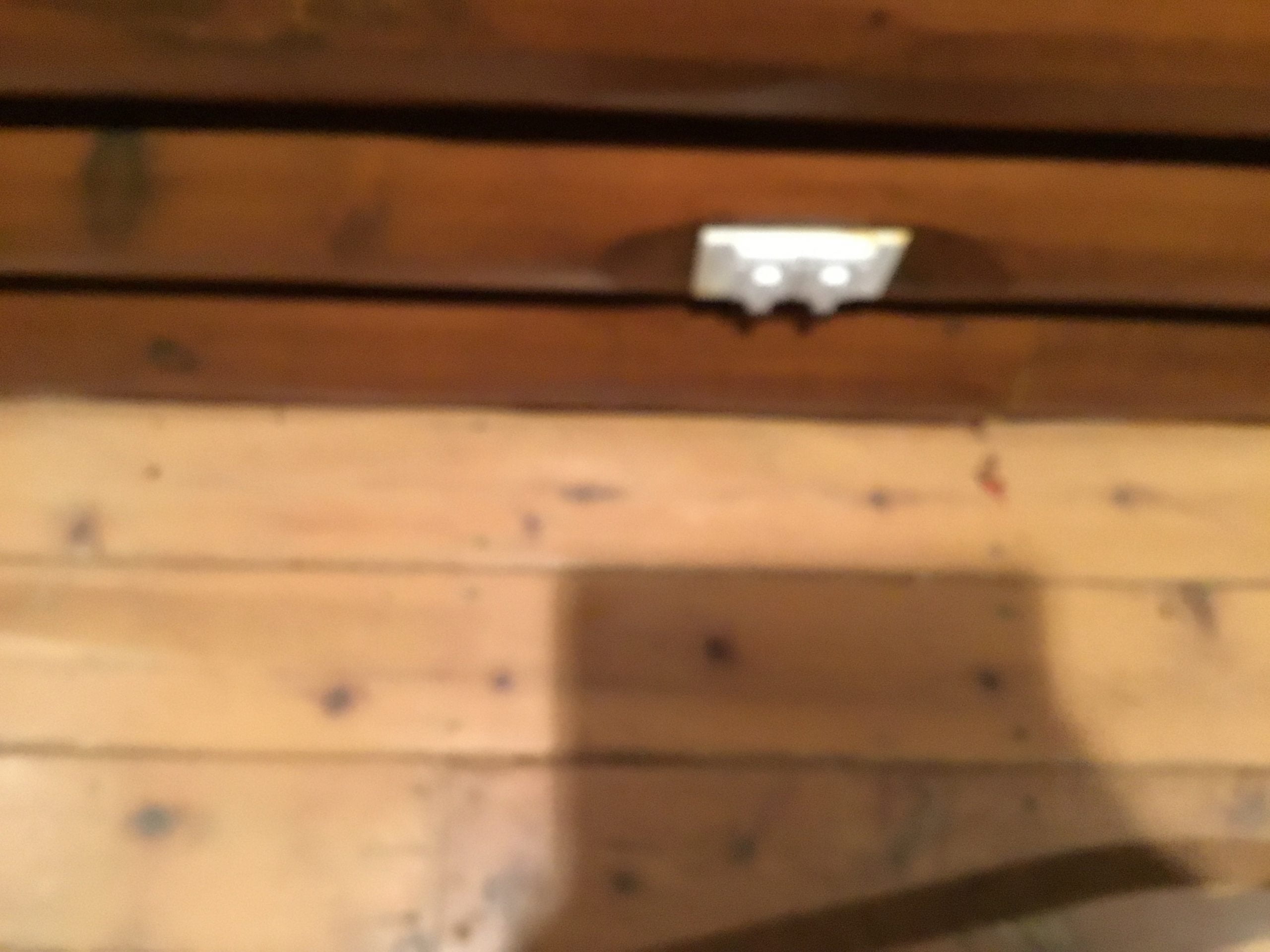

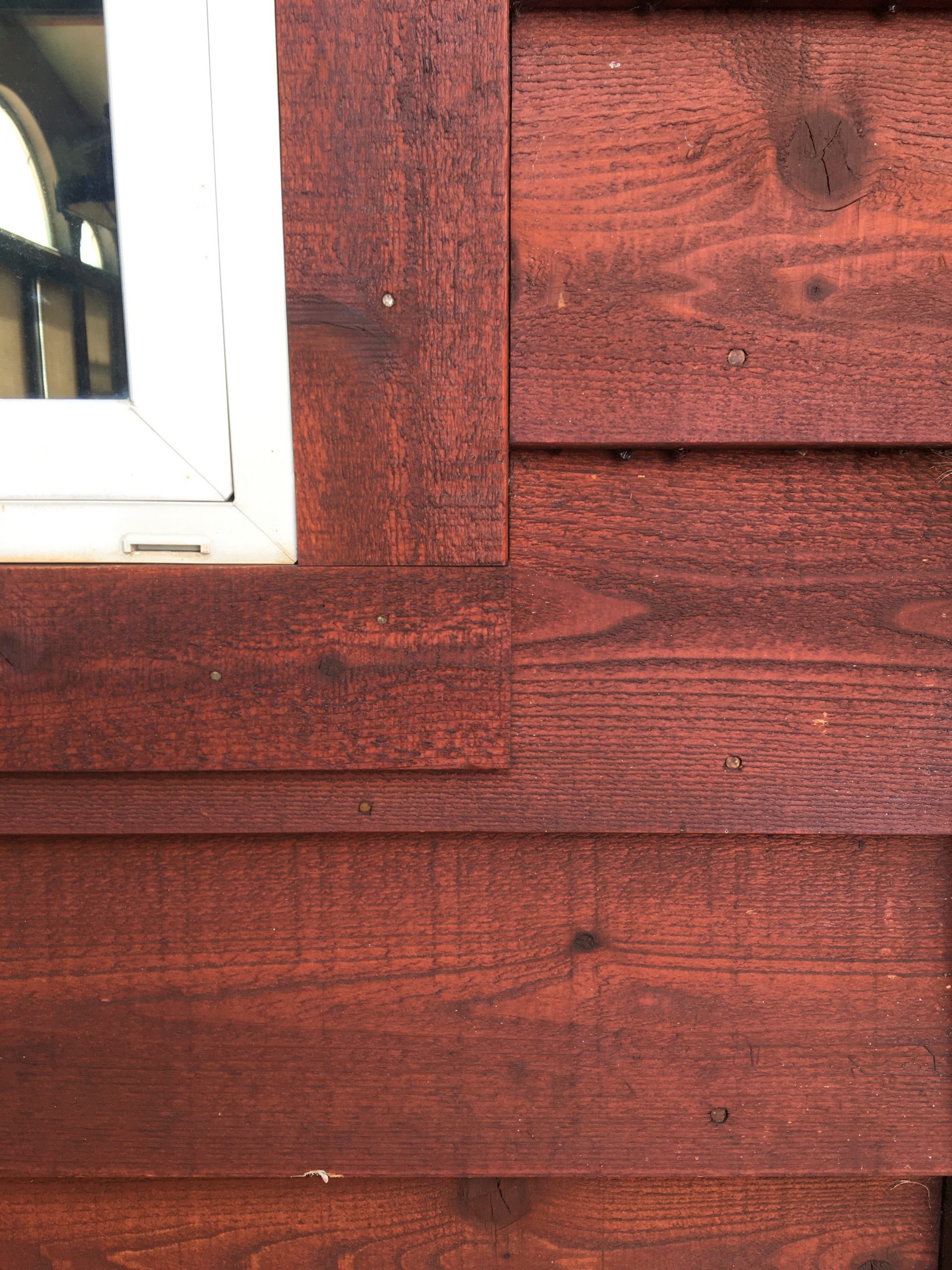

Contrator mistakenly USED 2 coats of ARMSTRONG OIL bast semi-transparant deck stain on 2 week old, new redwood deck & Immediately got foot prints & sap seepage.
It’s now about 1 month old & looks HORRIBLE.
Contractor now wants to scrub it with soapy water, weather the wood for 2 months & then re-stain with WATER base semi-trans stain. Will that work please?

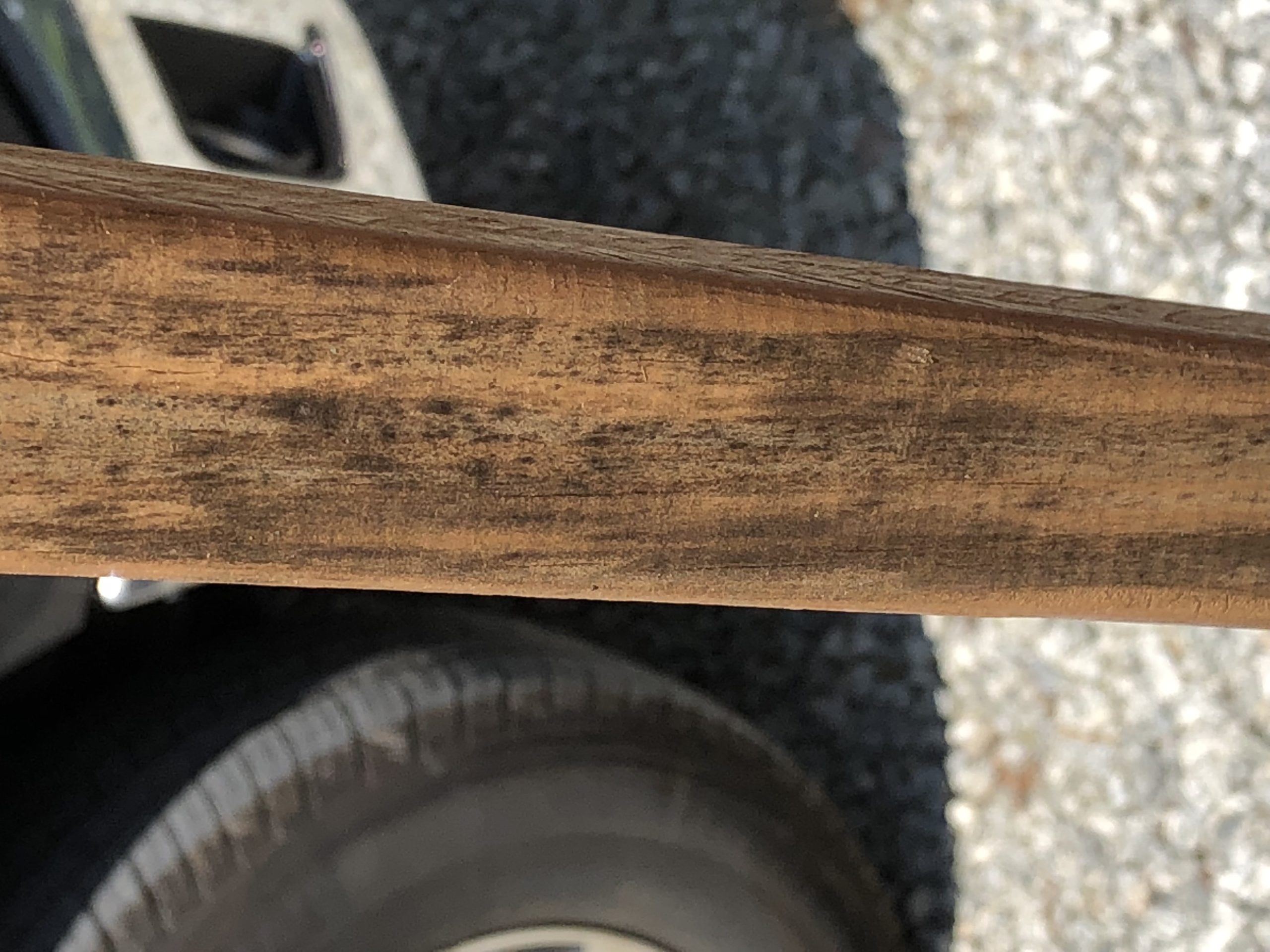

I used this product before stain/seal with Armstrong Clark (natural) last year. Worked great & really like AC! In prep for adding railings this year I reapplied AC to the ends most exposed to sun. All well. However, I made huge mistake in building the railings. I used galvanized goat panels & had to do final metal trimming to fit up on the deck surface. Well…long story short…that area is black (fortunately did all cutting in this end). Tons of rain since then so all those virtually invisible pieces of metal that I didn’t get swept away when dry have produced dark staining. I’ve been trying to sand & then use a product that some said would get stain out but it doesn’t, it did make a very minimal change tho. Will Restore a Deck get that stain out? Seems fighting uphill battle as anything that uses water just causes it to come back. Maybe its heavy sanding & using compressor to blow dust off cause that dust contains the particles & just seems to be spreading the problem. Maybe I will have to resort to replacing boards. Can’t turn them over, Any suggestions appreciated as need to remedy boards on that end before can put up final railing. I really don’t want a colored stain to try covering it up. Too much other wood invested in the natural & no time for re-doing all of it. Thanks!
glen
glen
Sounds like brightener will do it. Yes, its the metal flakes that have rusted. Screws are fine. Rest of deck is fine. Because wood has the armstrong clark on it assume I need to use the stripper first then the brightener? Or cleaner then brightener?. Brightener only? Thinking I need to get down to bare wood to get rid of all that metal dust. Doesn’t help that it kept getting walked on & then thoroughly soaked into the wood. Just wanting to confirm what combo I need to order. Thanks so much. I hadn’t been able to find the rust document.

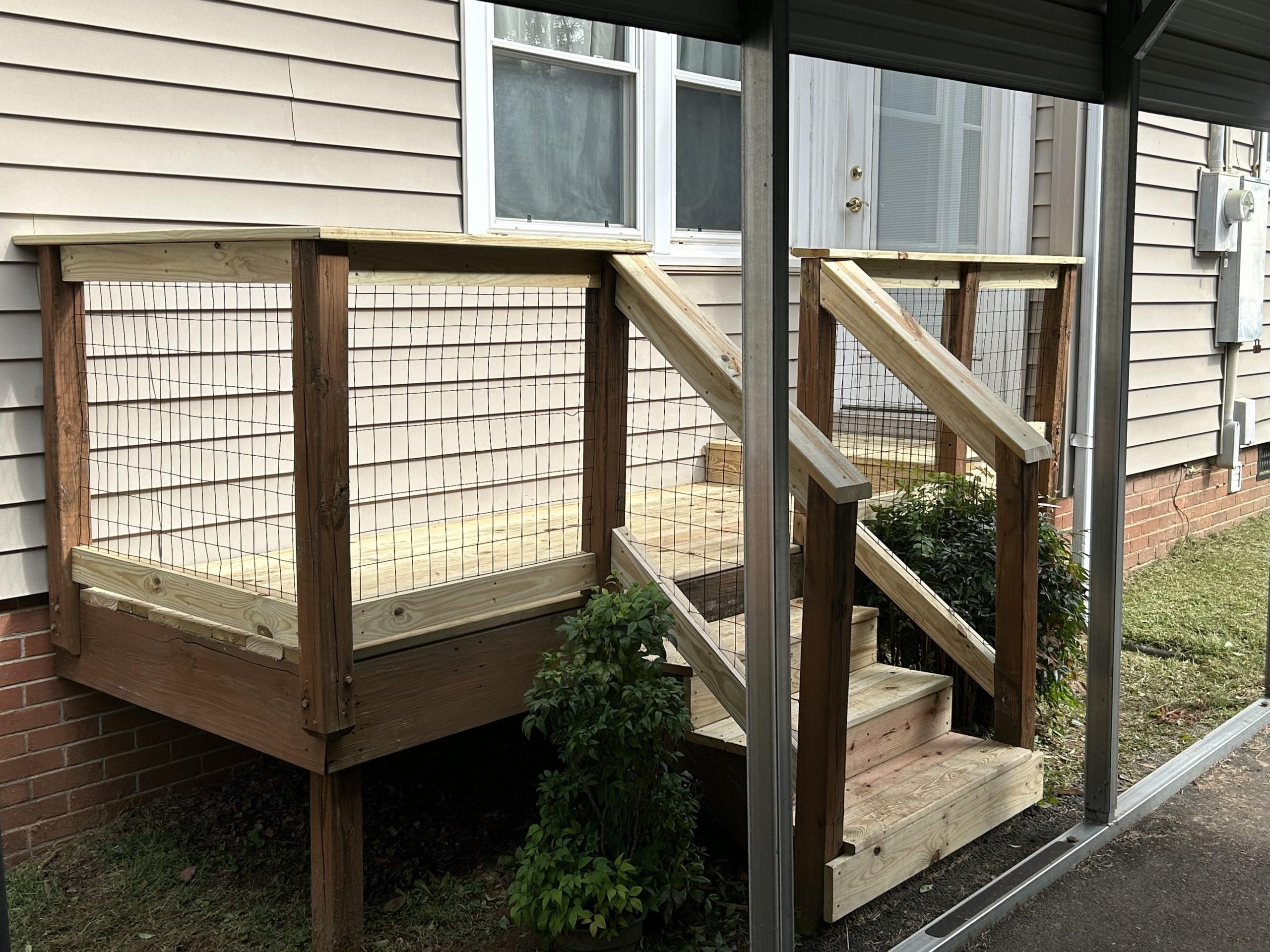

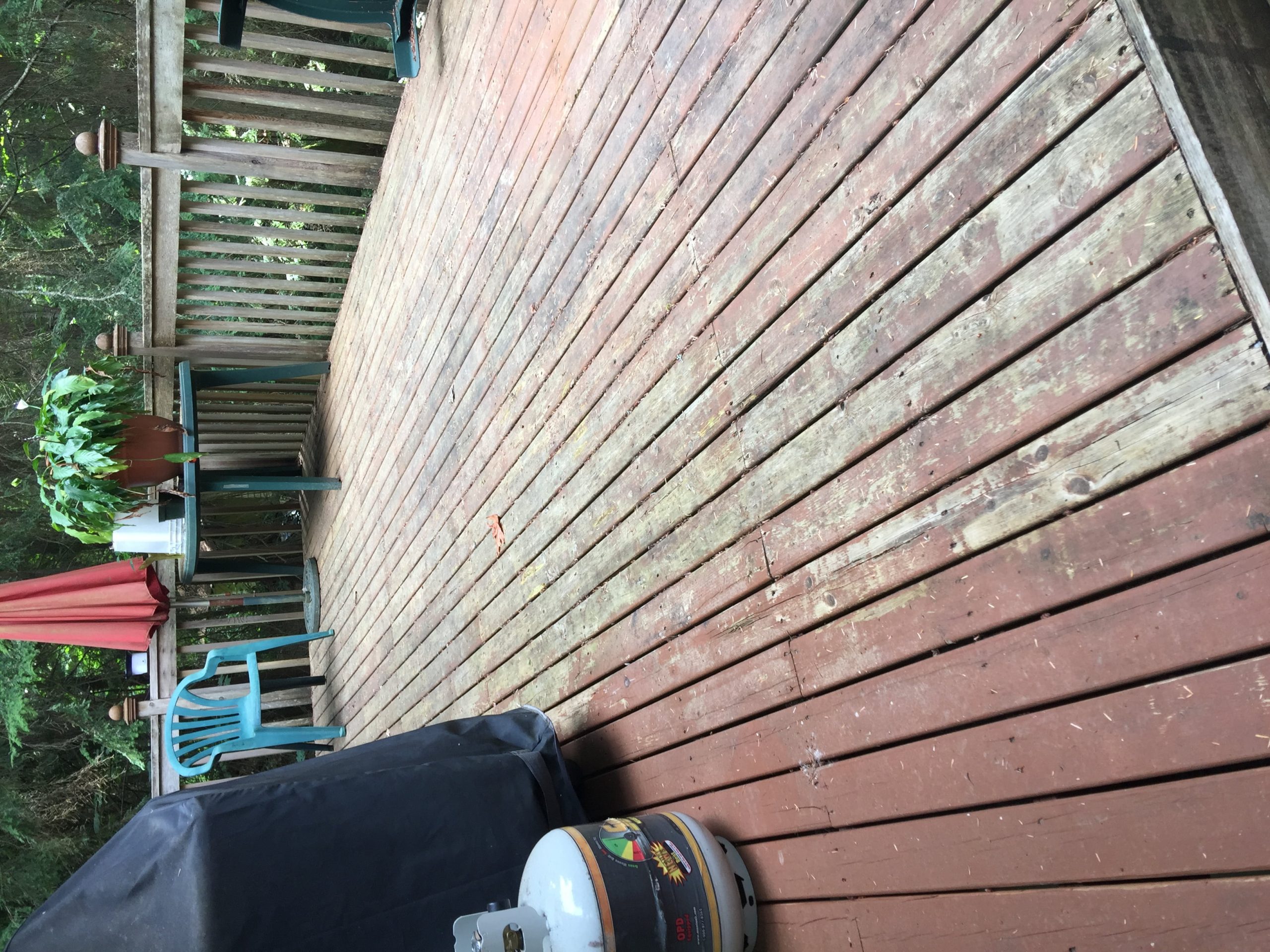

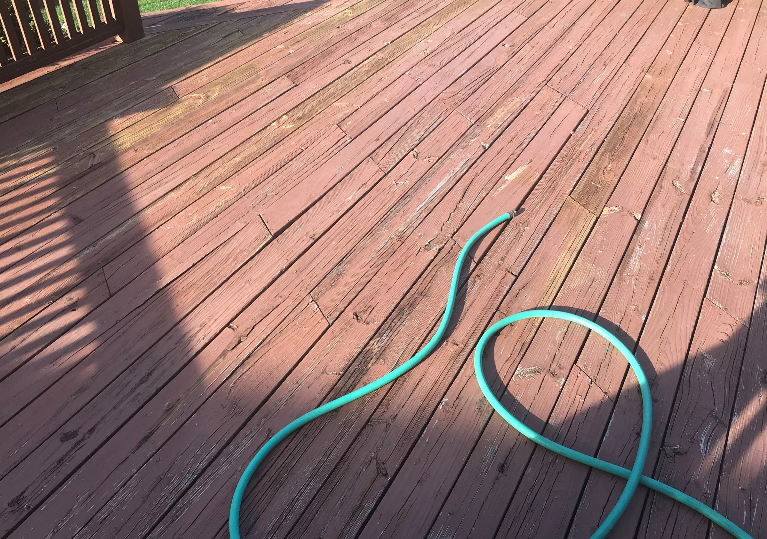

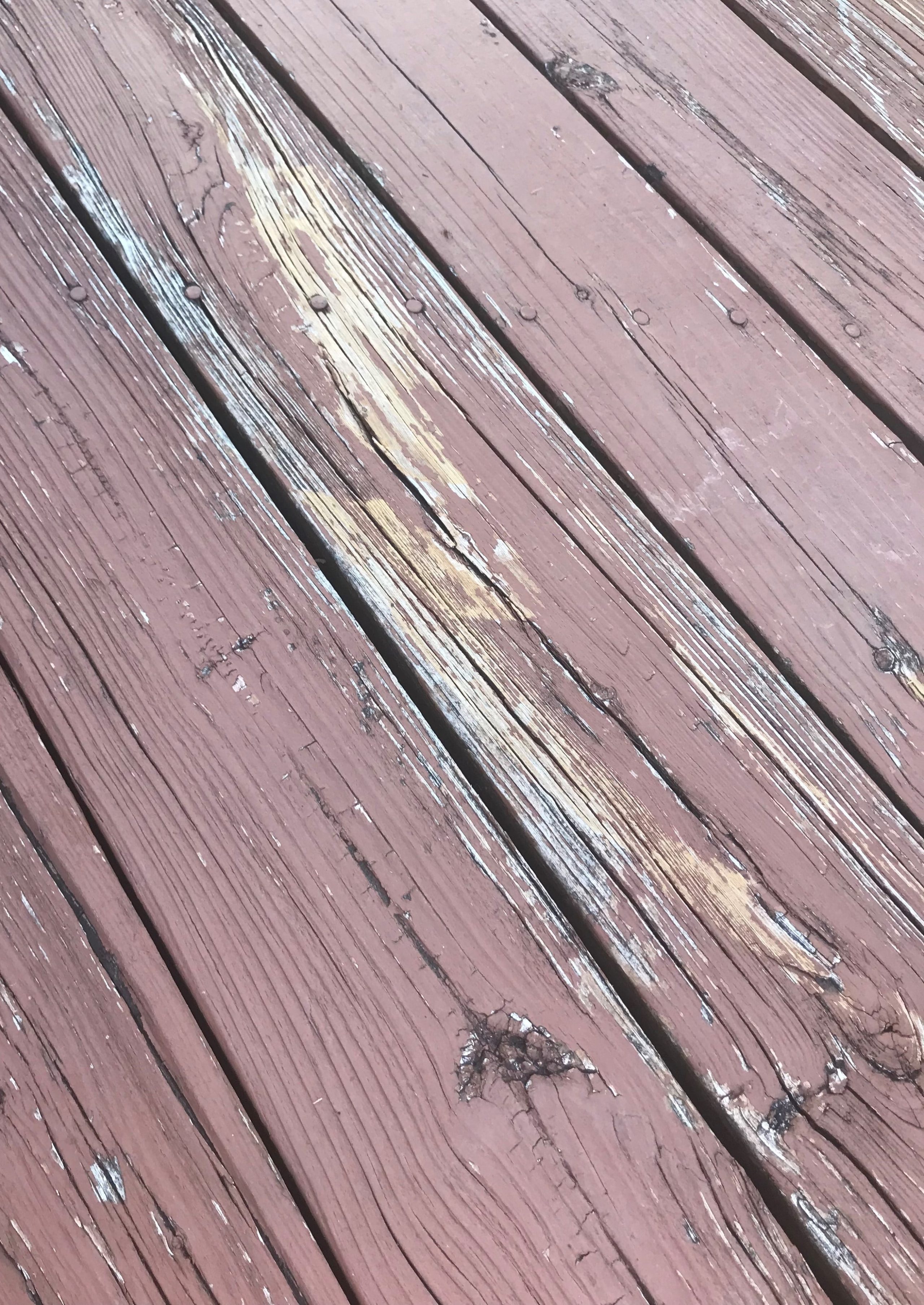

I have a rental cabin that was purchased 1 yr ago. At time of purchase, prior owners had deck restained. I am not sure of the product probably sikkens. seems like just within 1 yr, the deck showing a lot of wear and I want to restore. If I just use the RAD stripper, booster and thickening gel.
  1. Do you think it will work well to strip the floors?
  2. It seems like when you mist it, it goes everywhere and can get on cabin body and posts. So will I need to also restain the body and posts where it gets on?
  3. Should I be trying to protect the posts/body if I don’t want to restain those?
  4. Perhaps it should be hand applied and not misted? I have a wrap around porch so lots of floor to cover.
Angela Hsu
Angela Hsu
Is it possible not to strip it but just add a solid or semisolid stain directly on top after power washing? What product would you recommend?
Angela Hsu
Angela Hsu
Looking at my pictures, would there be a stain you recommend to hide the footprints that get on deck? I think they footprints from the gravel road are light in color. I was thinking perhaps using a lighter colored stain might be better. This would then probably require the full stripping using the RAD paint strip you mentioned.(thanks again for all your help!)
Angela
Angela
I messaged RAD compnay and they were of the opinion that it would be difficult to protect verticals from the gel/powerwash off even with tape/tarping. What is your opinion?

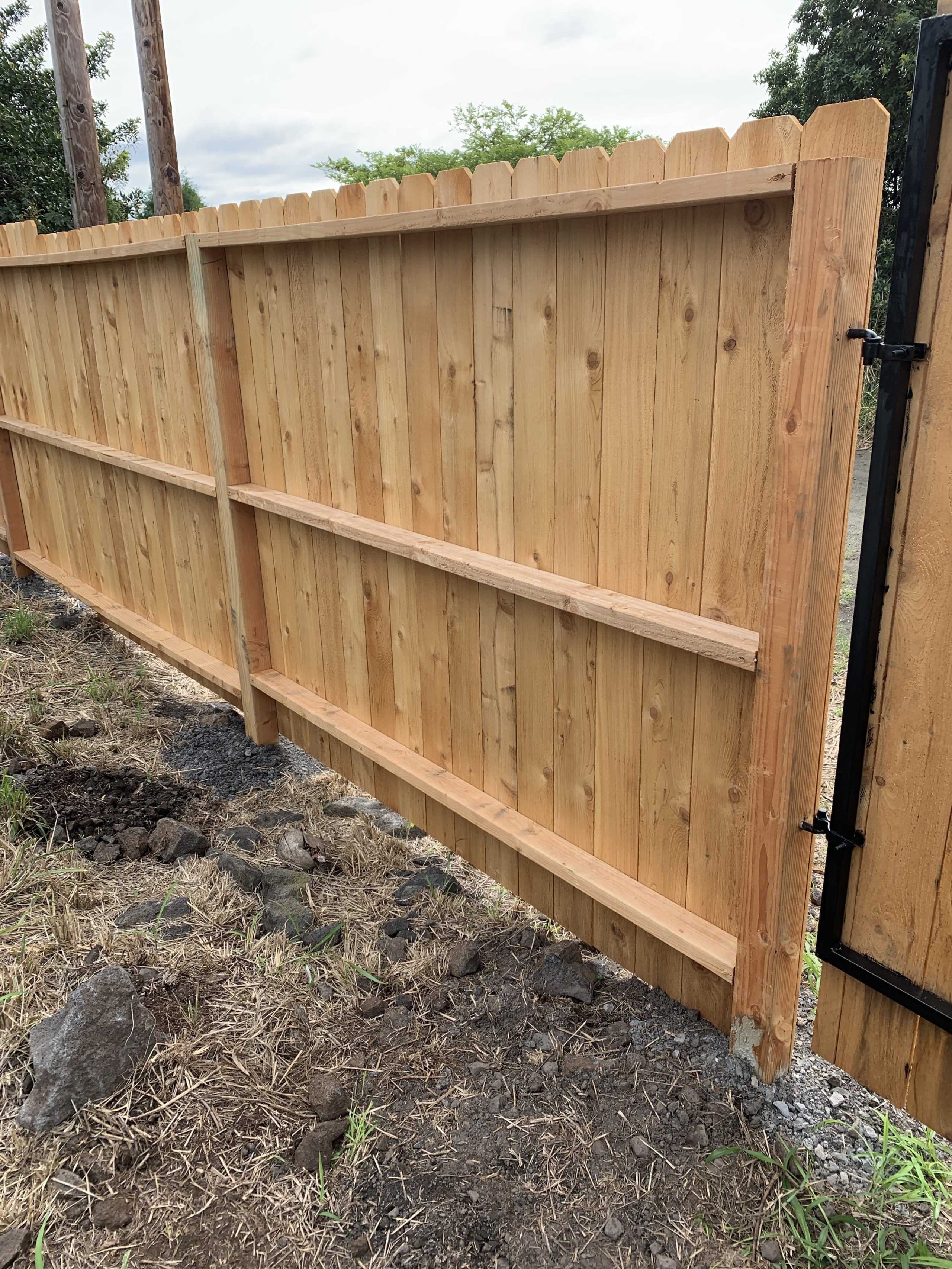

We just applied Ready Seal natural semi-transparent to our 9 month old redwood fence in California. It looks horrible (turned orange). Can we strip it and start over?

Hello, I am looking for some advice. This is a 30 year old deck. Last stained 2 or 3 years ago with what is pictured below. The top rail has had many different things on it over the years. Please advise, thanks!

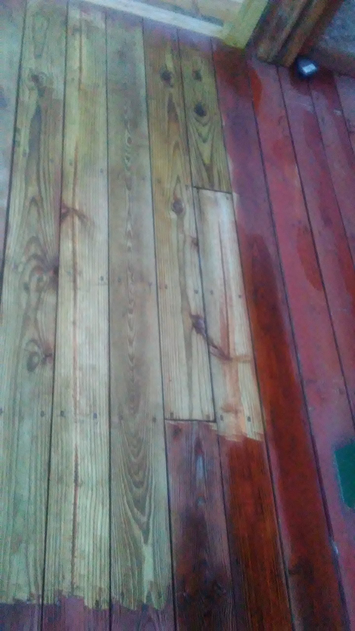

We have been trying to strip what it seems to be solid stain from our deck. First (left) picture shows the results after using a floor sander 36 grit. Didn’t make much progress. Then we tried the Beth stripper followed by the cleaner, which started to help very little (right, still wet), but we still have a long way to go to get rid of it. Would you recommend the RAD + booster on this situation or should we just move to another type of sander?

I will be stripping my deck rails using restore-a-deck with the two additives and brightening using the restore-a-deck brightener. The decking itself is Timbertech composite decking. Are there any concerns with the stripper or brightener falling on the composite decking? Will it discolor it? The decking does have some dark spots in it Do I need to cover it in plastic or something? Or would the stripper and/or brightener help clean the composite decking and it’s OK or even preferred to spray it along with the railings? Thanks!

Hello. I am going to re-stain a house that previously had ATO red grandis and the owner wants to go water based semi- transparent over it. Can I apply the water based over the timber oil?
Lauren
Lauren
Can I apply stripper with sprayer, let sit/ untouched, power wash off and then …?

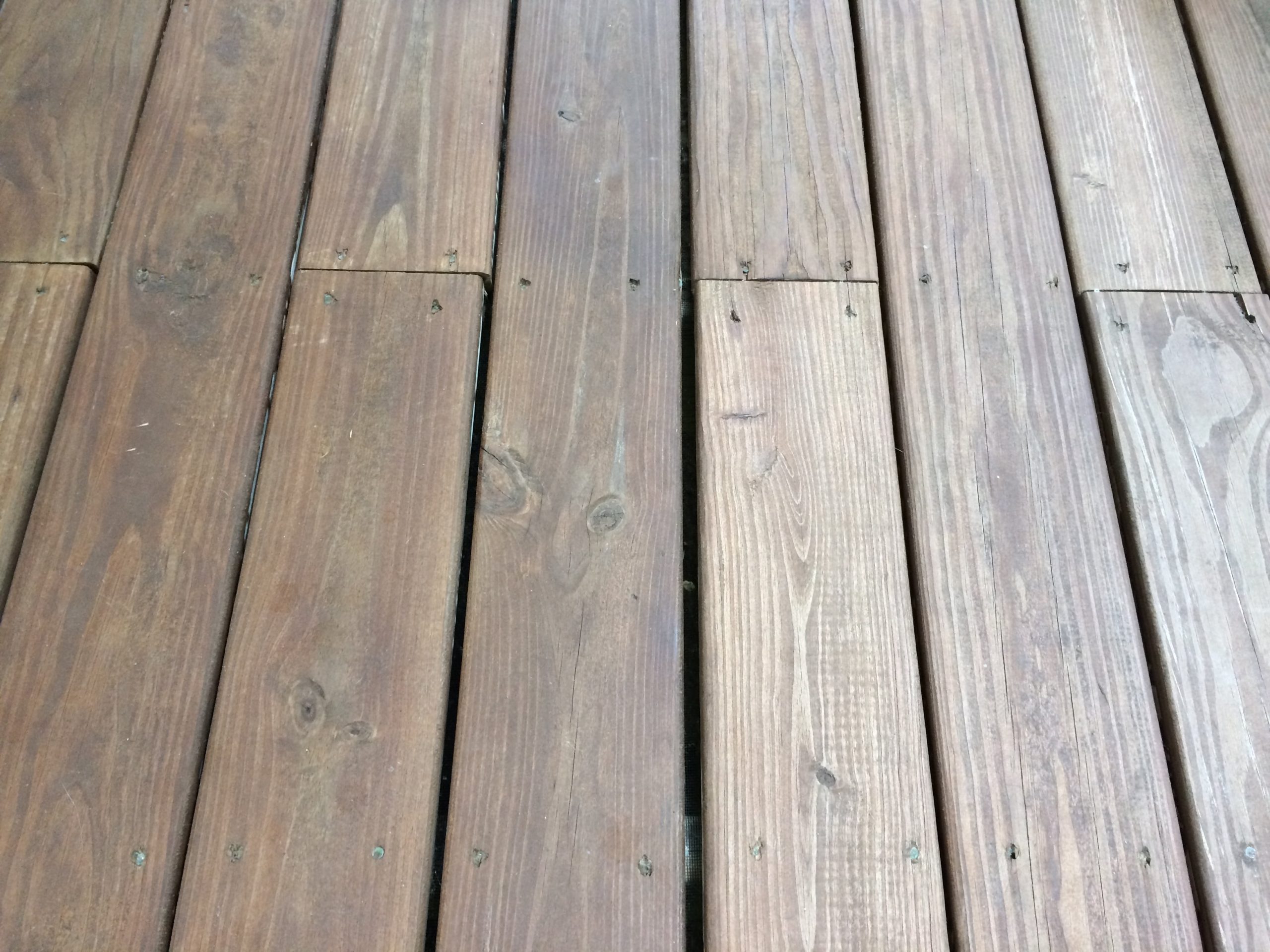

Deck Location State: West Virginia
Sun: Full sun
Wood: Pressure treated pine
Mold/mildew: no
Reason for stain failure: winter freeze/thaw, water dripping from eaves. : Most of the deck is still covered, but there are several places where stain worn off and wood exposed. Several spots get dripping water from eve overhang that goes down to the decking.
Previous stain: 3 yrs ago, new deck, no stain the first season.
2yrs ago, Flood CWF Cedar, 2 coats after deck wash.
Last year, Flood CWF Ultra UV5, 2 coats after deck wash.
Preparing for this year, 2020. Can I stain over last year’s coat with the same product to keep from removing the otherwise thick coat on 90% of the deck? If not, what product do you suggest I use to remove current stain, and what to re-stain with?

HELP! I used Restore-A-Decks 2-step Stripper & Brighter system to remove the old water-based Benjamin-Moore Arborcoat semi-transparent stain from my hardwood mahogany deck. After applying, power-washing off the old stain, brightening then thorough rinsing & drying, I applied 1 thin coat of Armstrong-Clark’s OIL-based Hardwood Amber semi-transparent stain, as recommended. It looked nice going on, but after drying looked horrible! Very mottled looking with extremely flat finish—no sheen whatsoever. I was careful to apply the stain evenly, full-length of deck 2 boards at a time. But, it looks like staggered marks from the pressure washer used to rinse-off the stripper now managed to show through the semi-transparent stain on the boards..
Can I save the looks of the deck by now applying a different SEMI-SOLID oil-based stain over the SEMI-TRANSPARENT one that’s now on it? If so, do I have to do any re-prep, or can I just apply the new coat of semi-solid stain to cover-up the current uneven appearance? I’m not that interested in showing the grain of the mahogany in it’s current condition. What can I do at this point? Thanks,

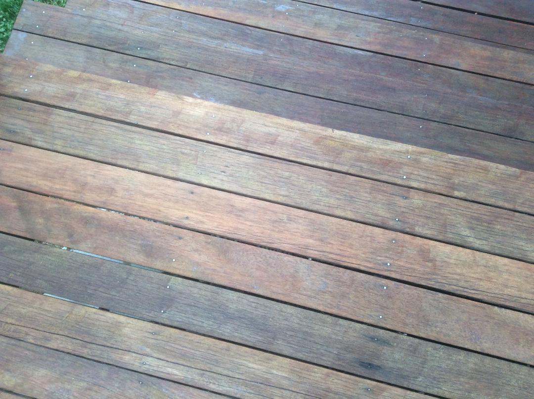

G. Anderson
G. Anderson

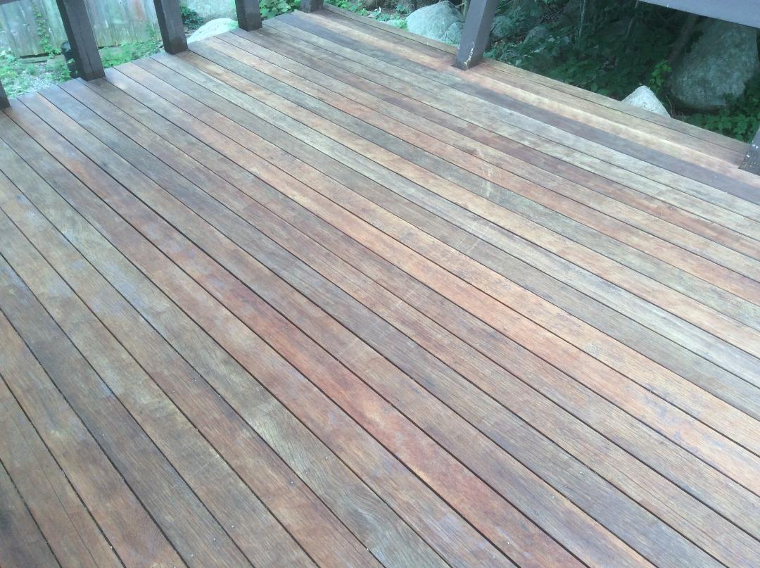

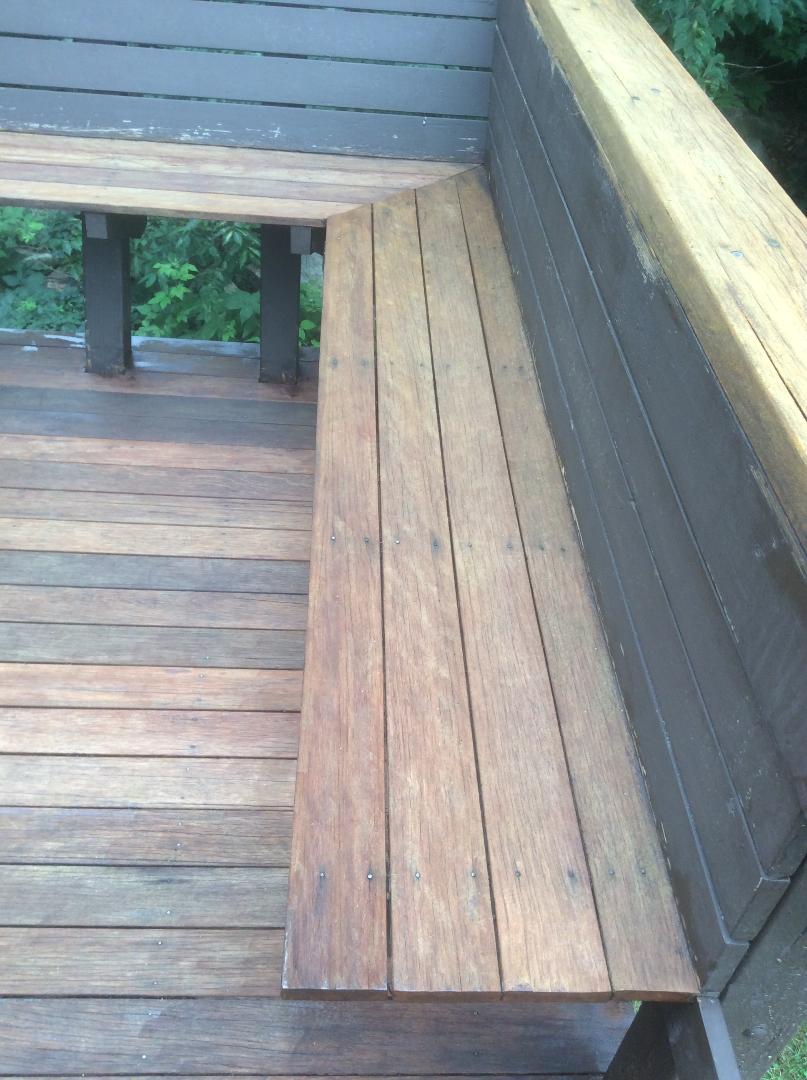

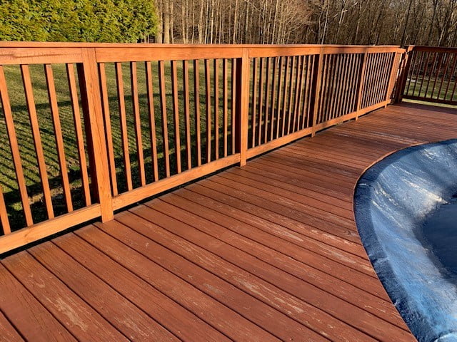

Here are a few shots of my mahogany deck with AC amber semi-transparent stain
G. Anderson
G. Anderson
Appreciate the info. I’m leaving as it is for this season. Next spring, I wish to ad another coat of the AC semi-transparent amber stain. Do I just use your cleaner, rinse and then stain? Or, will I need to re-brighten as well before stain application? Thanks.

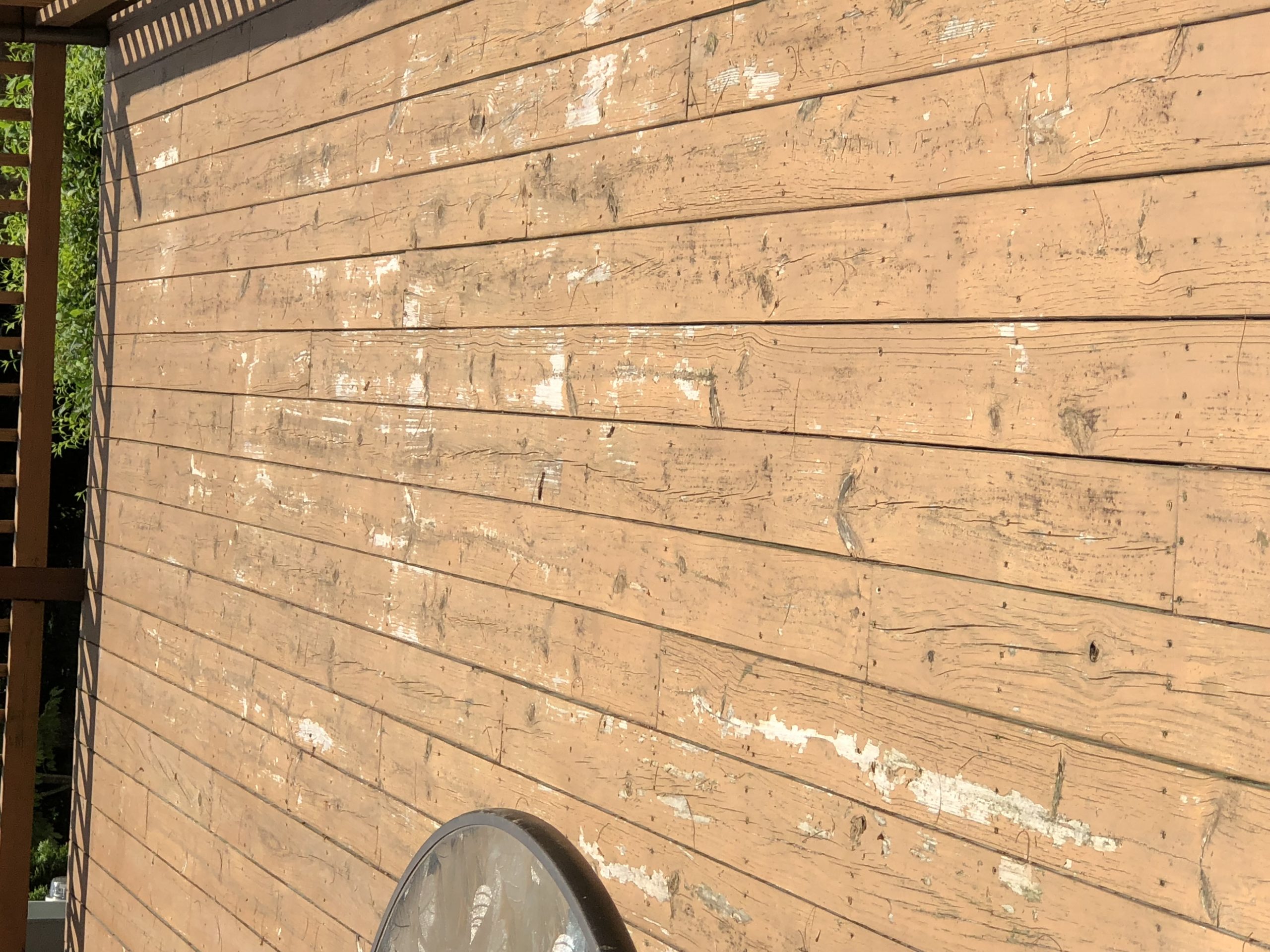

I have Behr super Rawhide (clear) on my cedar siding and it’s cracking and peeling. Will restore-a-deck stripper remove this stuff? I’ve read that only media blasting will take it off.

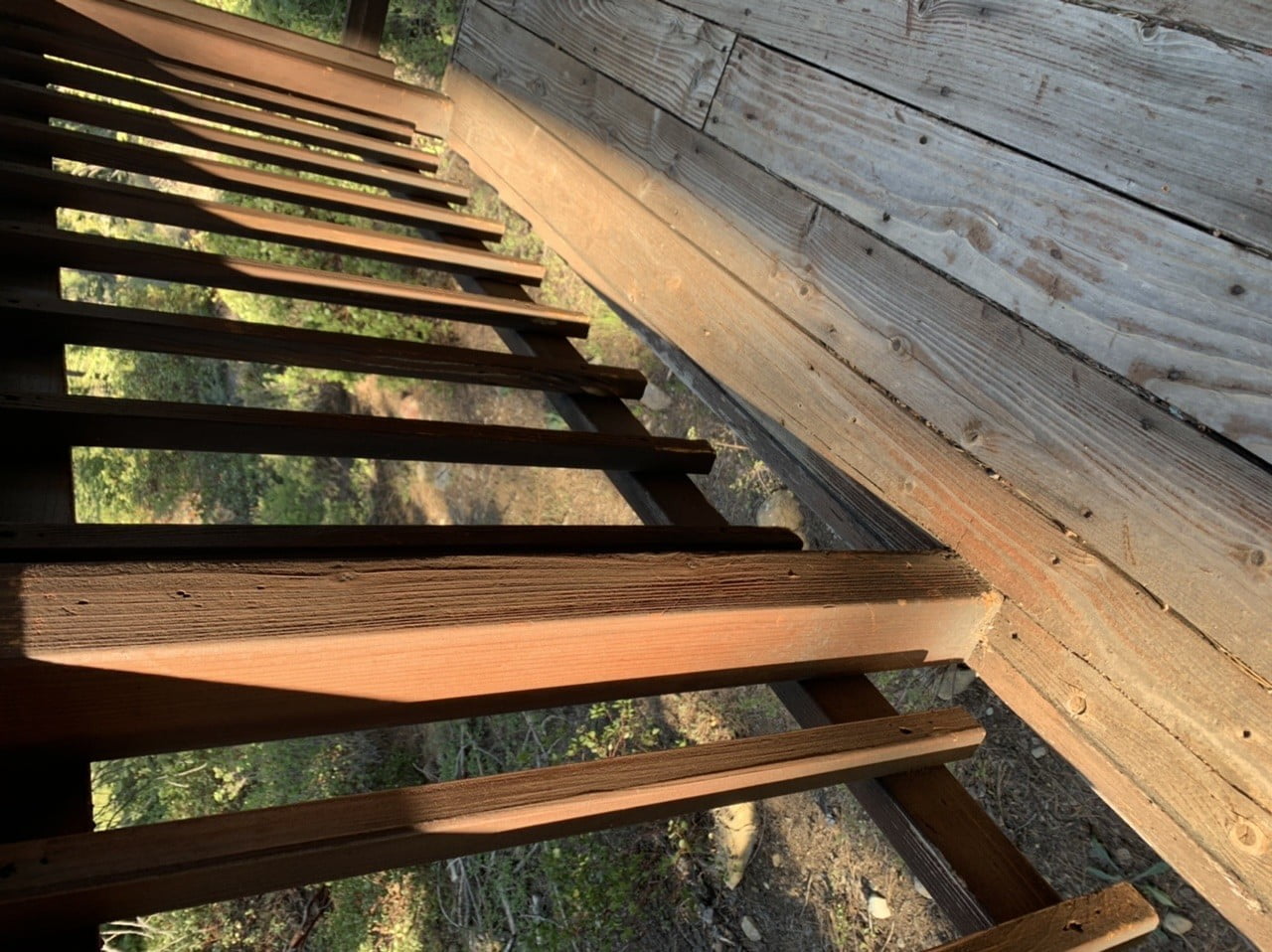

David in Tahoe
David in Tahoe
Thanks for this site. Best source of info on deck restoration I can find anywhere. I’m getting educated!
I think previous owner applied Sherwin DeckScapes solid (found a can under the house), although the can is brown and the deck stain has red tints, what’s left of the stain! Reading here I think I’m doing RAD 3-part prep, but I’m confused on two things:
1) I see you mention Stripper won’t remove a solid stain like DeckScapes. Should I just skip stripping then? This is related to my second question…
2) IF there is/was solid stain on my deck, my only option is another solid then correct? I can’t put a semi stain on, correct?
David in Tahoe
David in Tahoe
ok thank you! I’ll come back with photos once I have it stripped and cleaned.

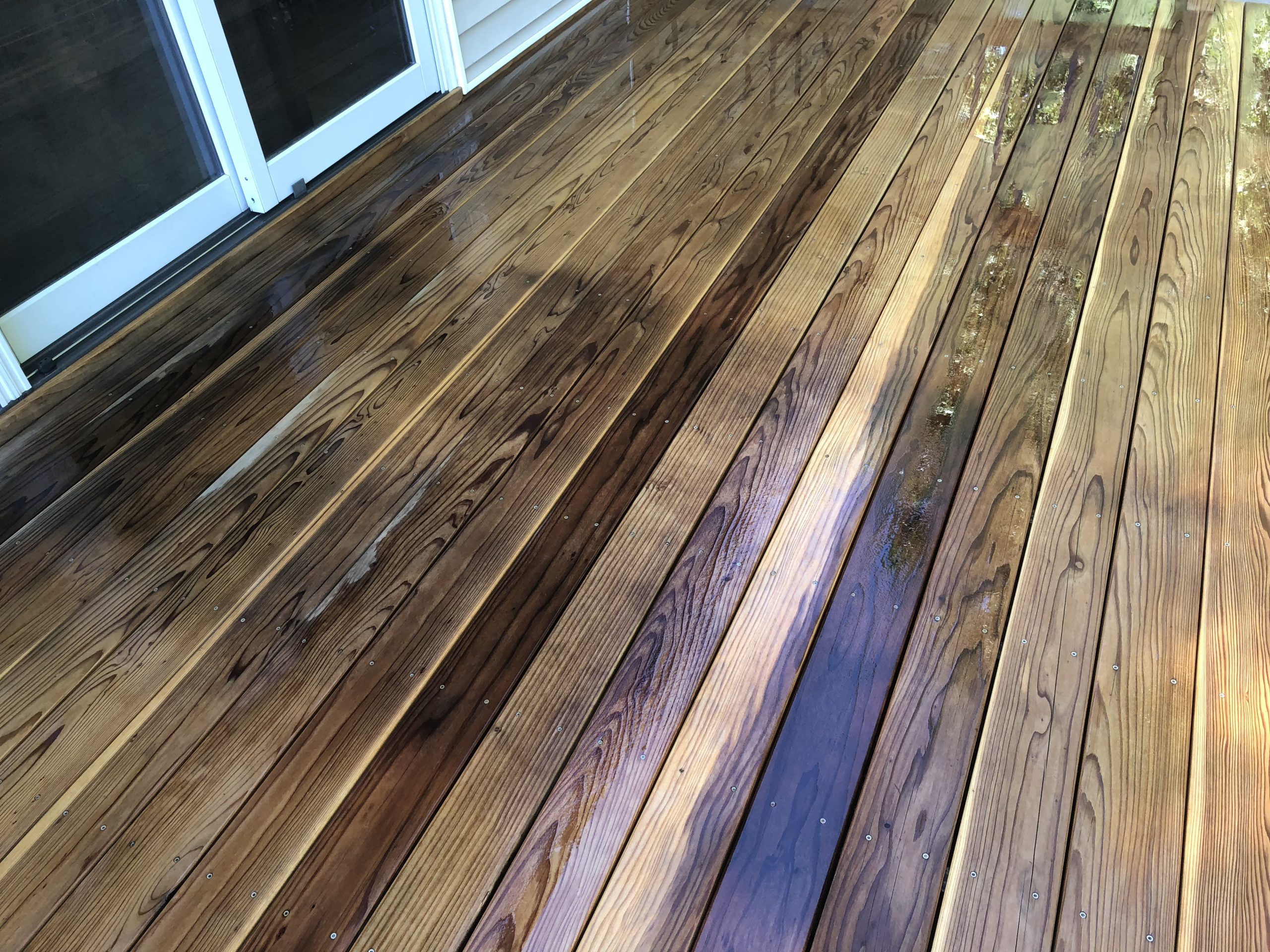

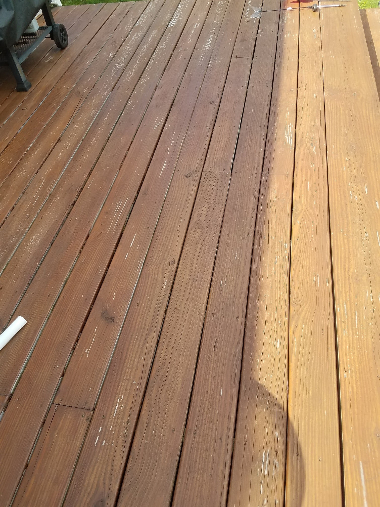

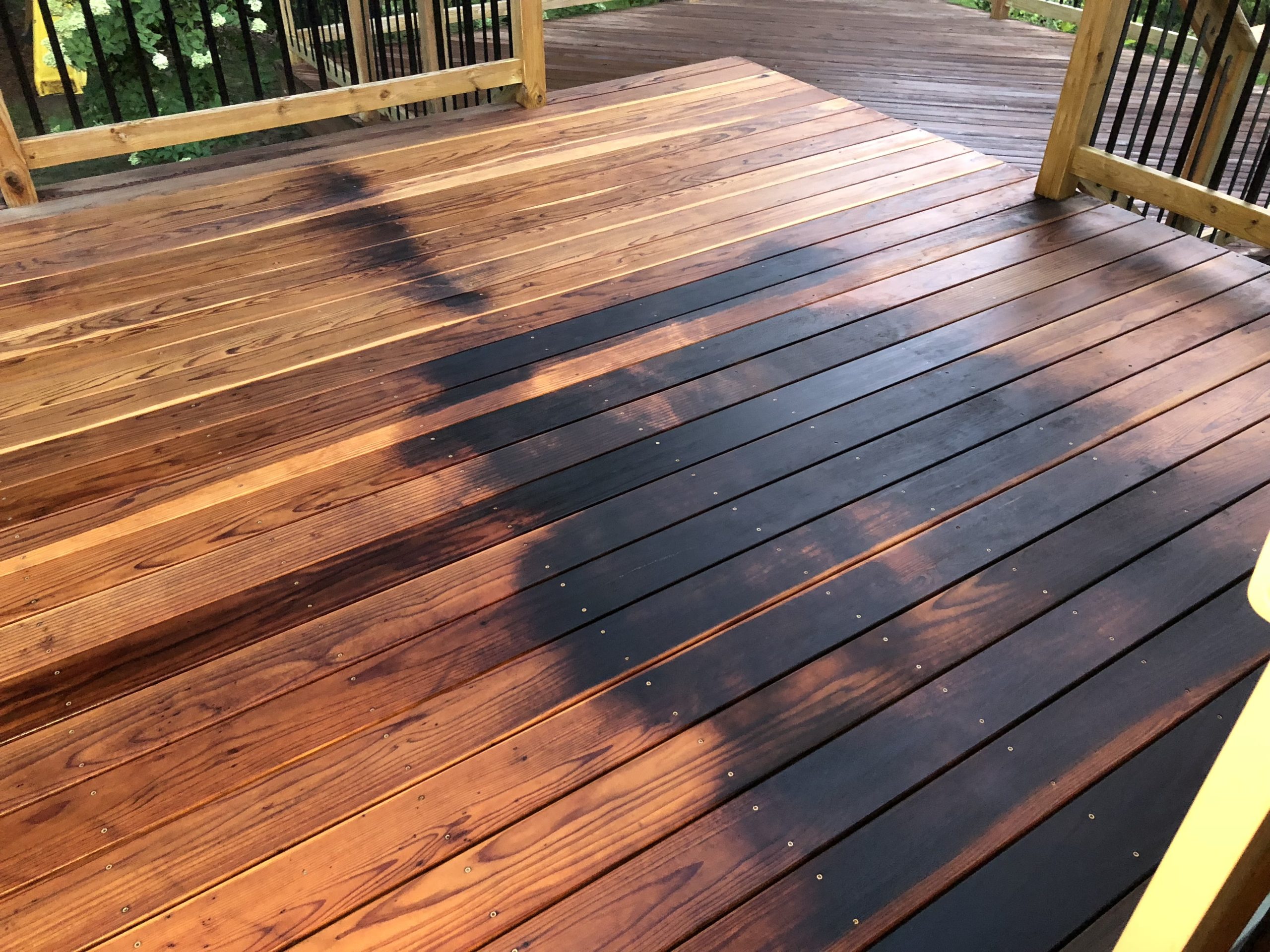

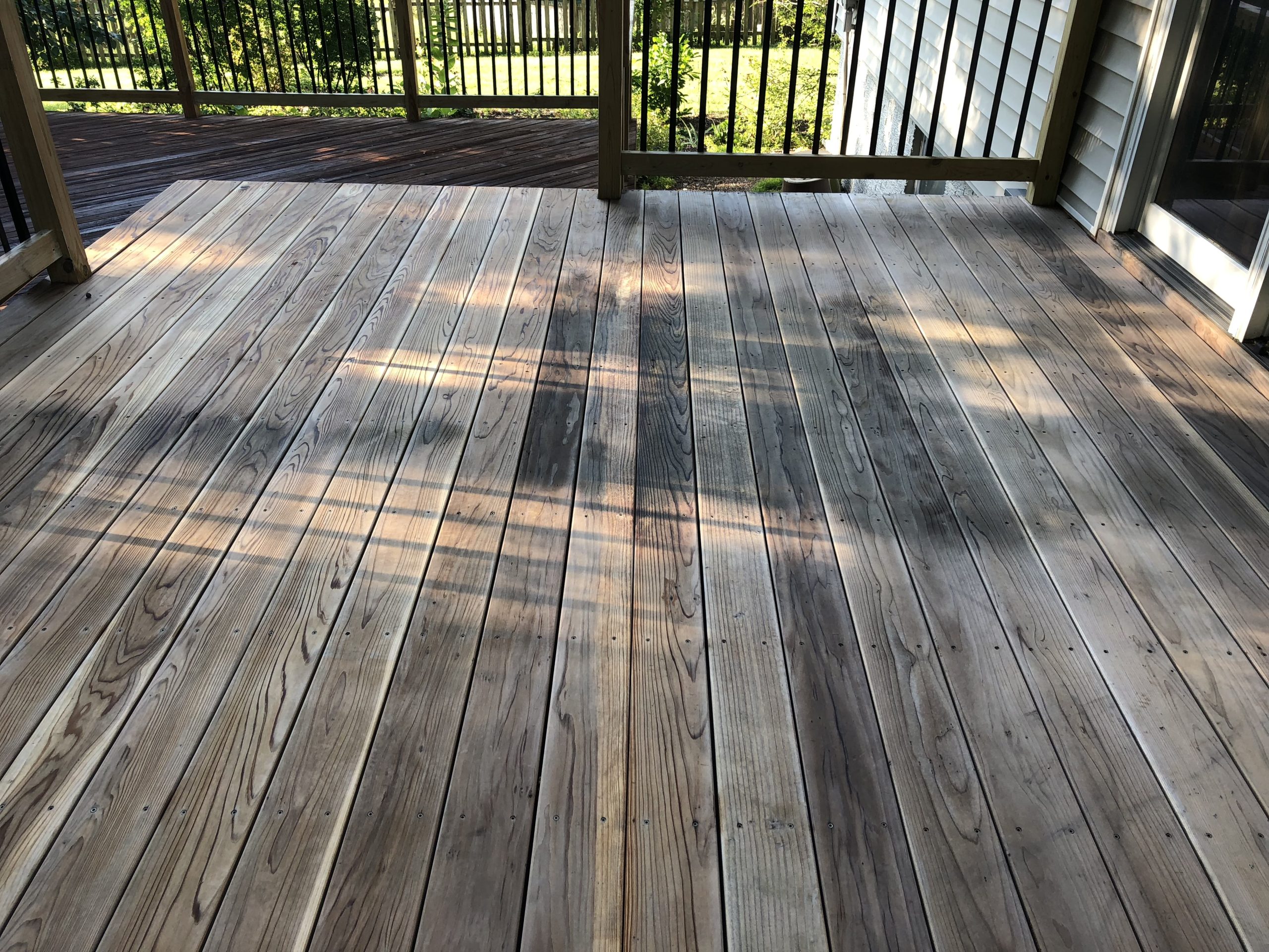

I am using the RAD (without booster or gel) on my pine deck floor that was media blasted and stained with Permachink Ultra 7 about six years ago. It’s a semi-trans water based stain and it is coming up, but I think the pressure washer may be doing the bulk of the work. I’m just wondering as I have more to do, if I should add the “booster” to the RAD to kick it up in strength. As it is, I mixed it double strength according to the directions. I don’t have the booster (also don’t need the gel as surface is not vertical), but could order it, but should I consider something stronger like Woodrich HD80? I will be light power sanding afterwards to get rid of fuzzies and imperfections.
So the question is, how does the booster (minus the gel) added to RAD stack up against straight HD80?
Thanks for any input.

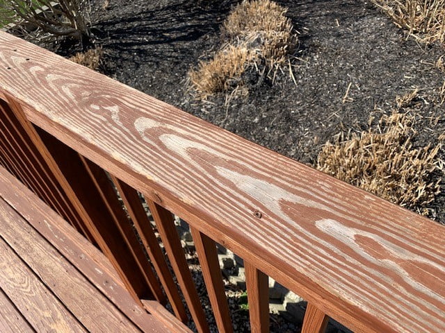

A Bennett
A Bennett
I am hoping that you can advise me how you would tackle this deck railing project. One of your replies states, “…no deck stain stripper will remove a solid stain effectively.”I don’t know enough to be able to know what is on the railing right now. Are you able to tell by the pictures, by chance?
If appropriate, I planned to use Restore-A-Deck Deck Stain Stripper with Booster and Gel Additives followed by the Brightener. We haven’t chosen the coating yet, and would appreciate suggestions for the most durable available for the conditions. The deck is in the Pacific Northwest with a west view and the house is very near the Puget Sound coastline. Also, is there a coating that would make all the wood consistent in color, or are we doomed to have a mismatch on the few treated posts and rim joist that were recently replaced? Do you have any thought about how long this project might take per 6 LF of railing? I appreciate any guidance you can provide! Thank you so much!
A Bennett
A Bennett
Thank you for your insight! I should clarify that we’re not doing anything to the deck right now. We’re just doing the railing.

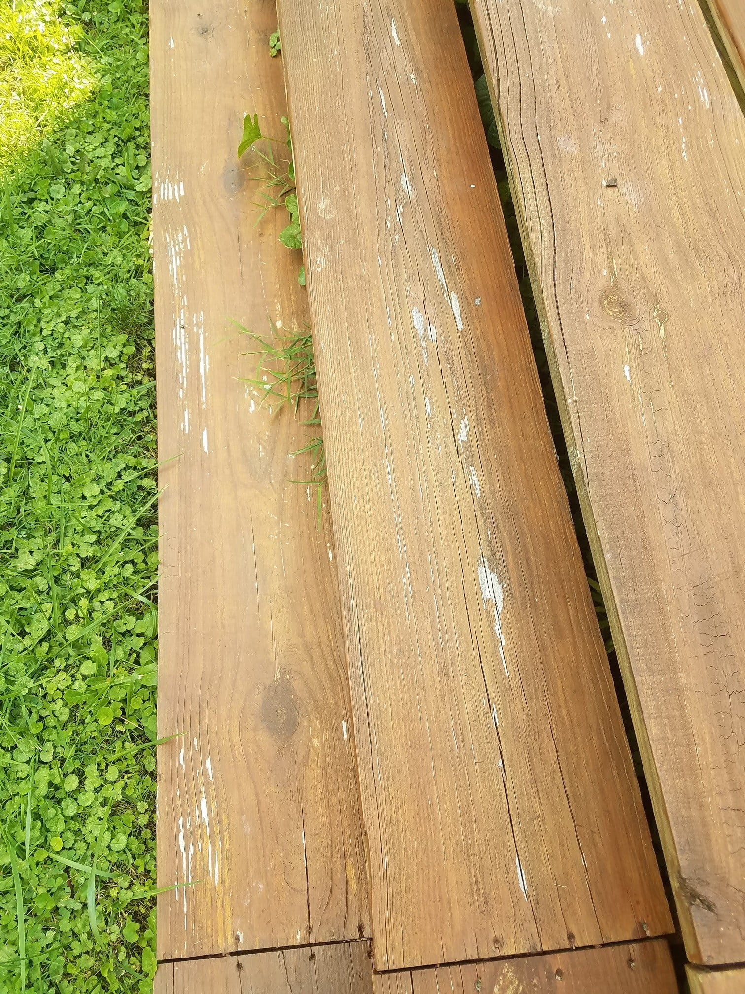

Jordan
Jordan

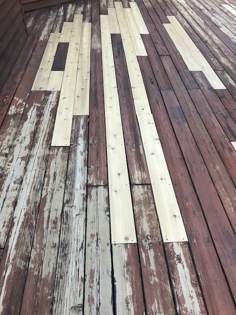

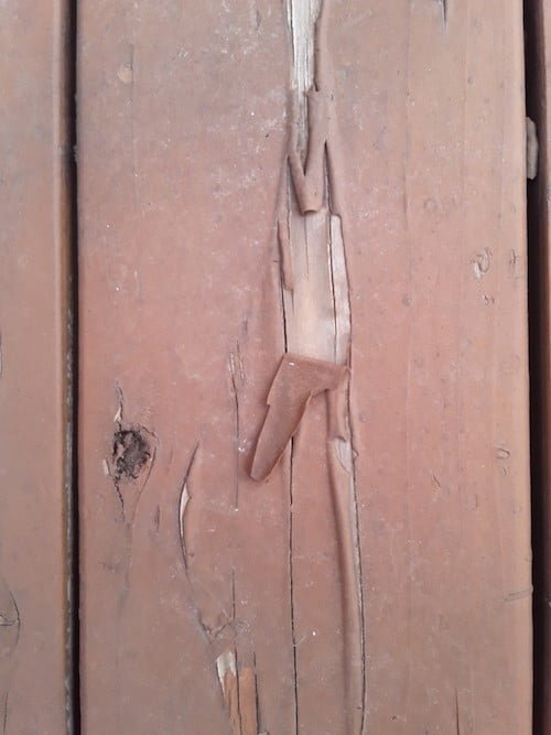

Hello!
My deck looks very similar to the above. Previous owner must’ve used some kind of solid opaque stain (paint?) which won’t come off using just a power washer. I plan to use Gulf Synthentic products to do a full restore but need to get this stuff off first.
Should I start with a product like the above to clean as much as I can? What about Wolman Deckstrip ASR?
I will likely need to sand, then use Perma Fill to level, then Perma Bond, then revive.
This is massive 22×26 deck, with many board likely needing replaced.
Jordan
Jordan
Thanks for the reply!
This stuff MIGHT be the Behr DeckOver so it is VERY thick.
Still think we don’t need to remove it?
Jordan
Jordan
Thanks again for the help. Here are some more details:
22×26 ft deck
Need to replace 8-10 boards
Planning to use Gulf Synthentics (about $1000 for this size)
Can’t get this stuff off (tried Wolman ASR and 2100 PSI power washer).
I am considering using a 3200 PSI washer to rip through this stuff and get down to the wood. It may chewed up a bit, but will this hurt the application of Gulf Deck Revive?
My thought process is that this still will cover it up, so it shouldn’t matter.

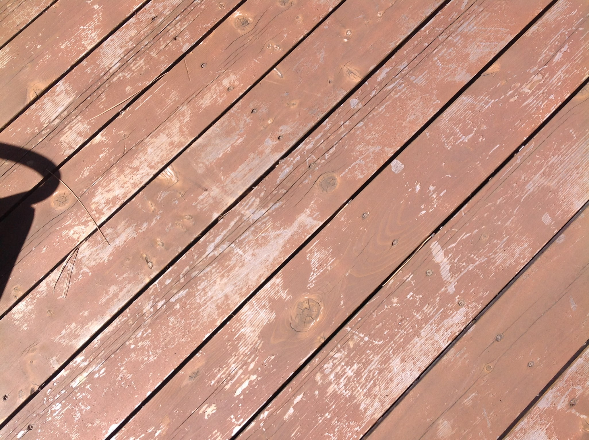

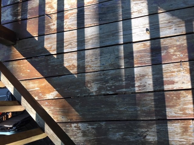

Harvey Knuth
Harvey Knuth

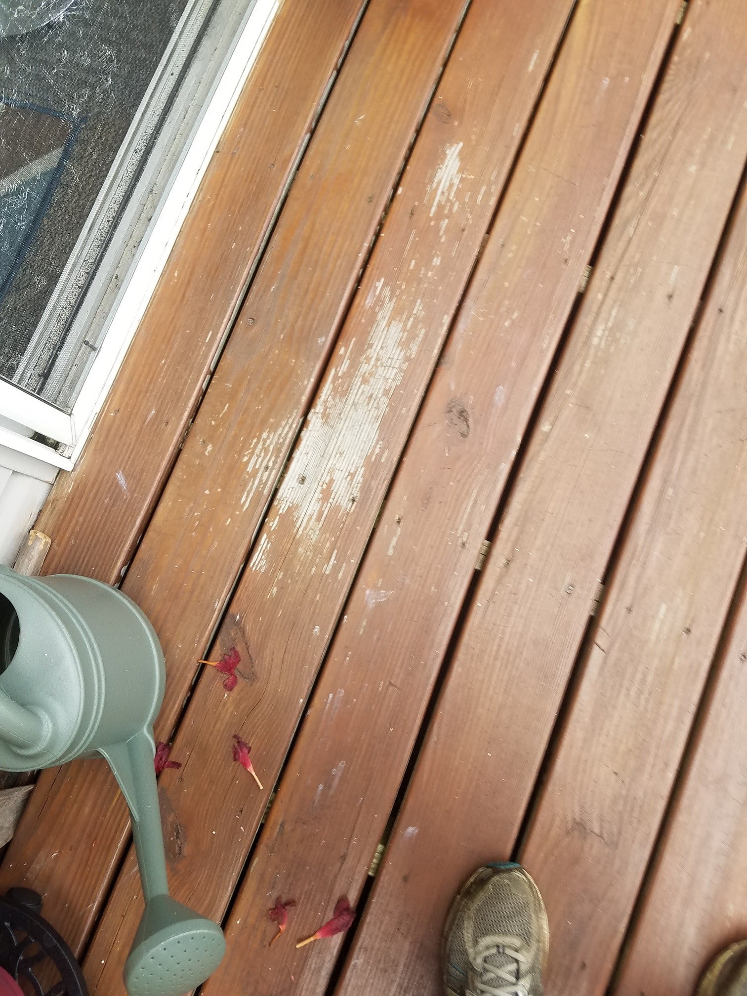

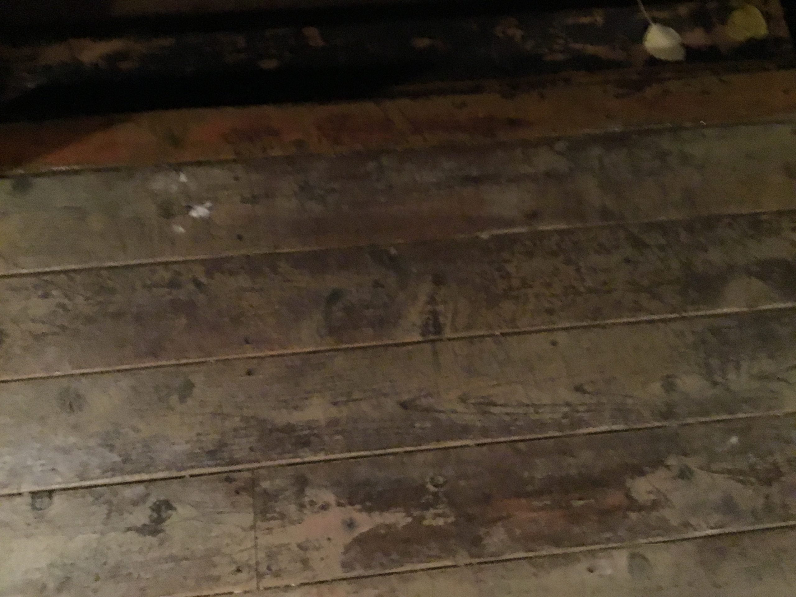

Looking for advise on choosing a deck stripper:
Need to remove stain applied 2 years ago: Olympic Maximum, semi-transparent, stain and sealant in one. It was advertised to prevent water damage and graying for 6 years…ha!
As you can see from the attached picture, it is pealing and wearing off, and the deck is weathered gray.
Will RAD stain stripper remove the rest of this stain?
Harvey

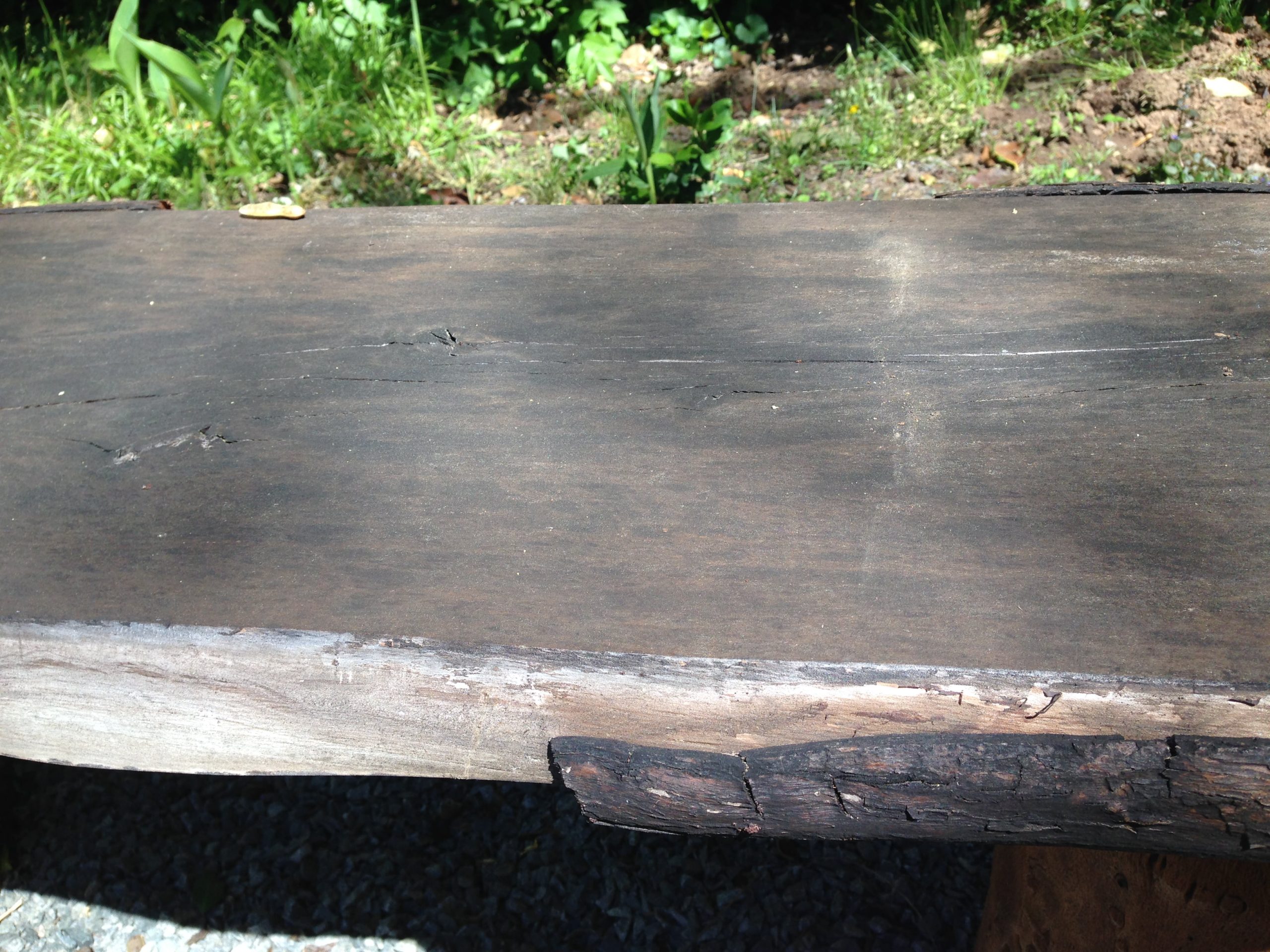

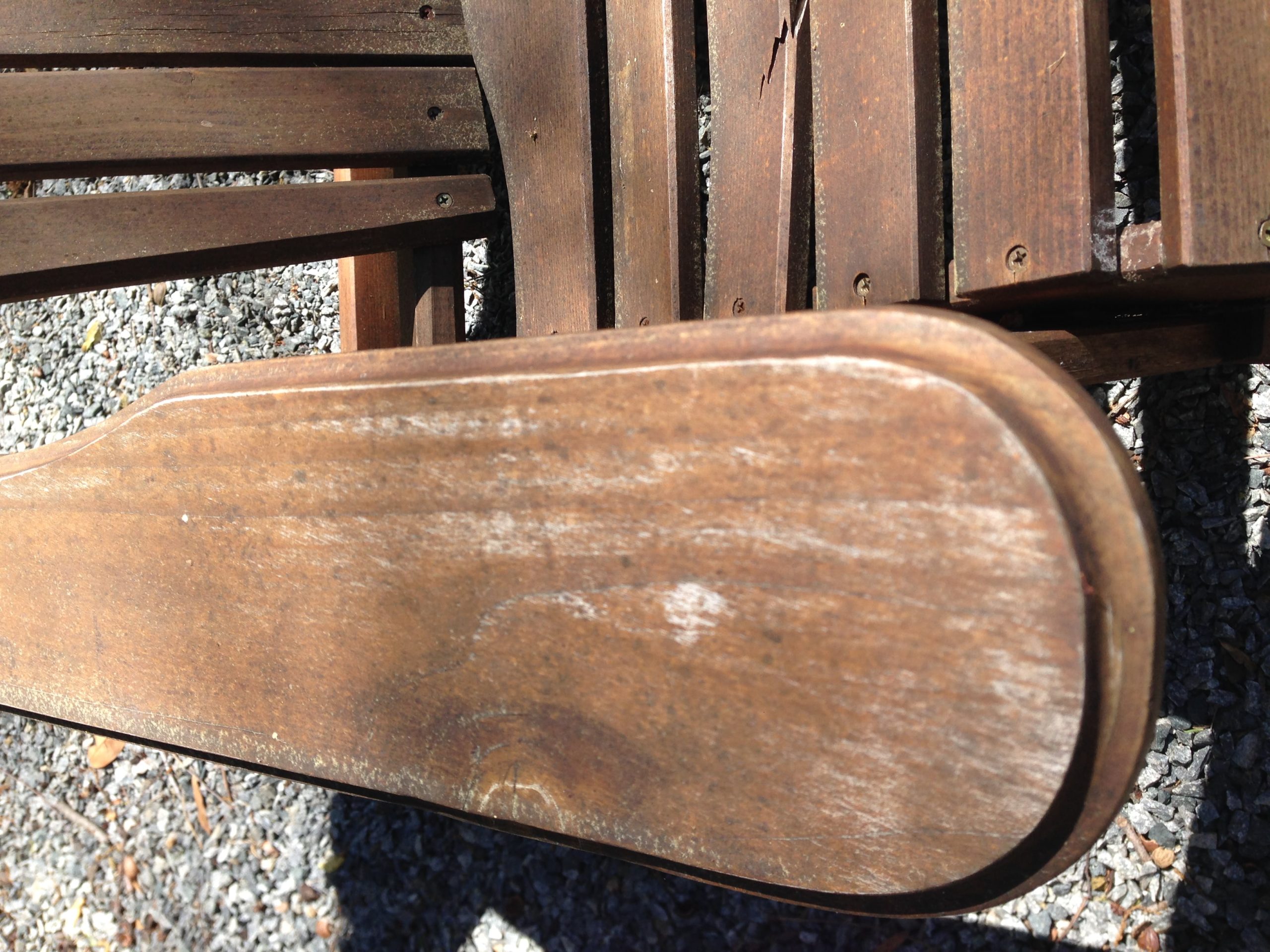

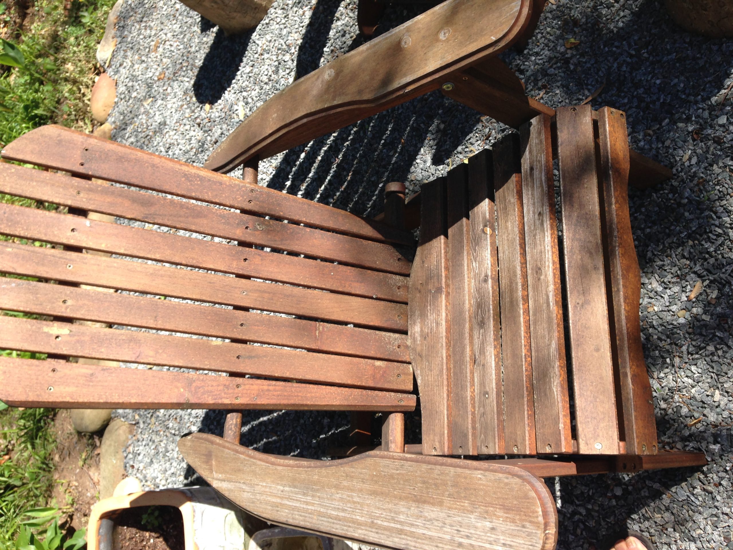

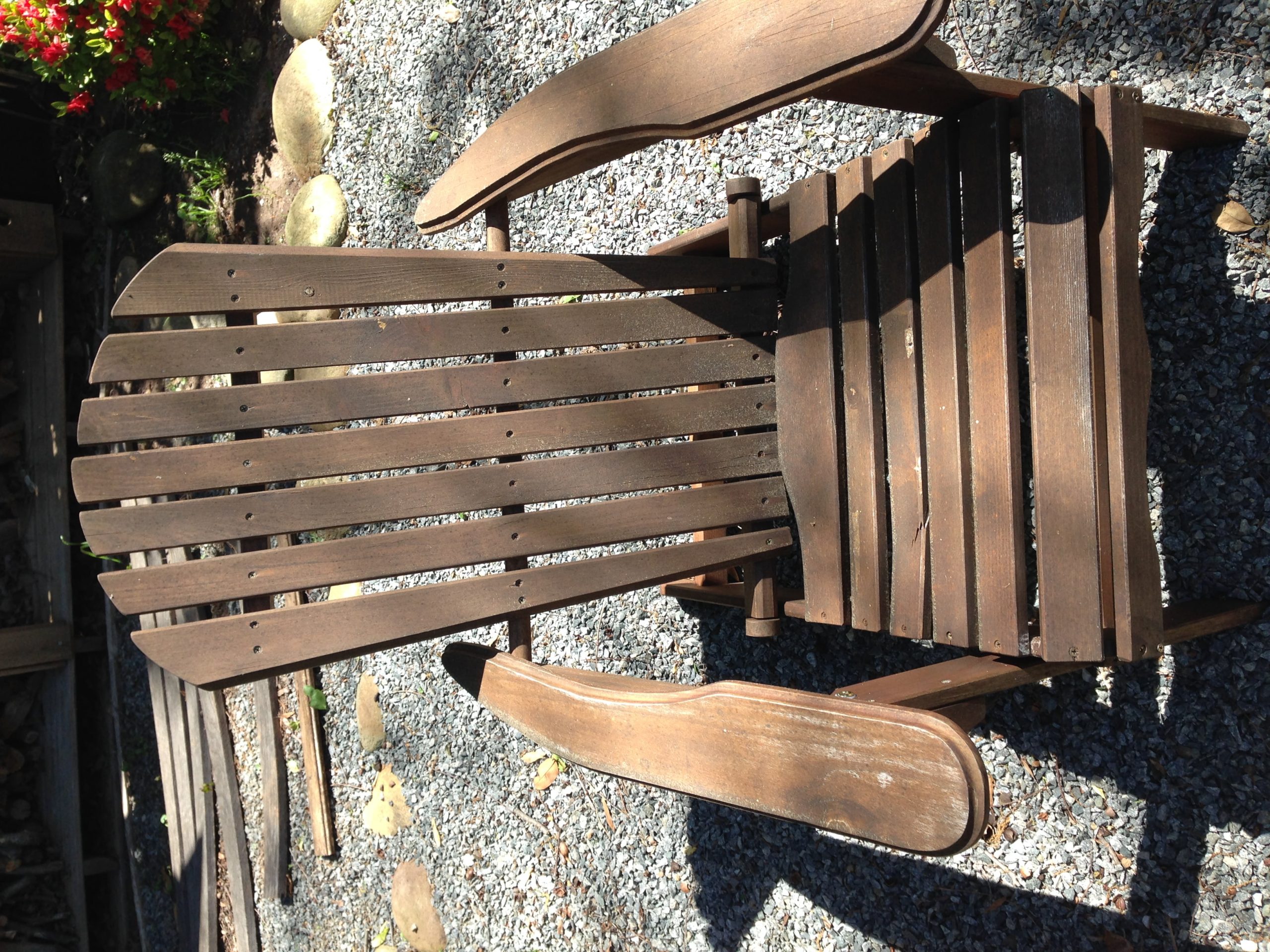

Billy
Billy

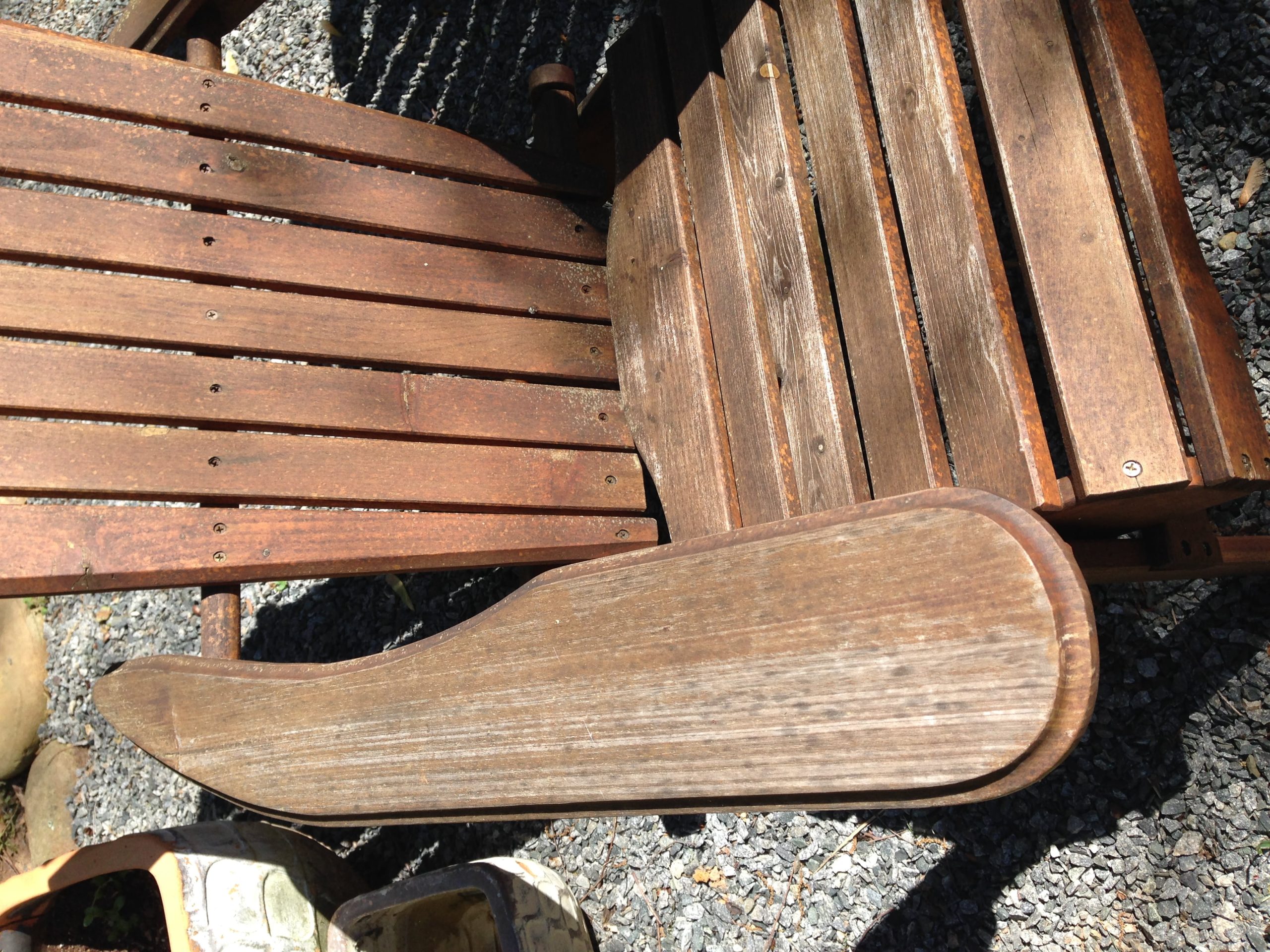

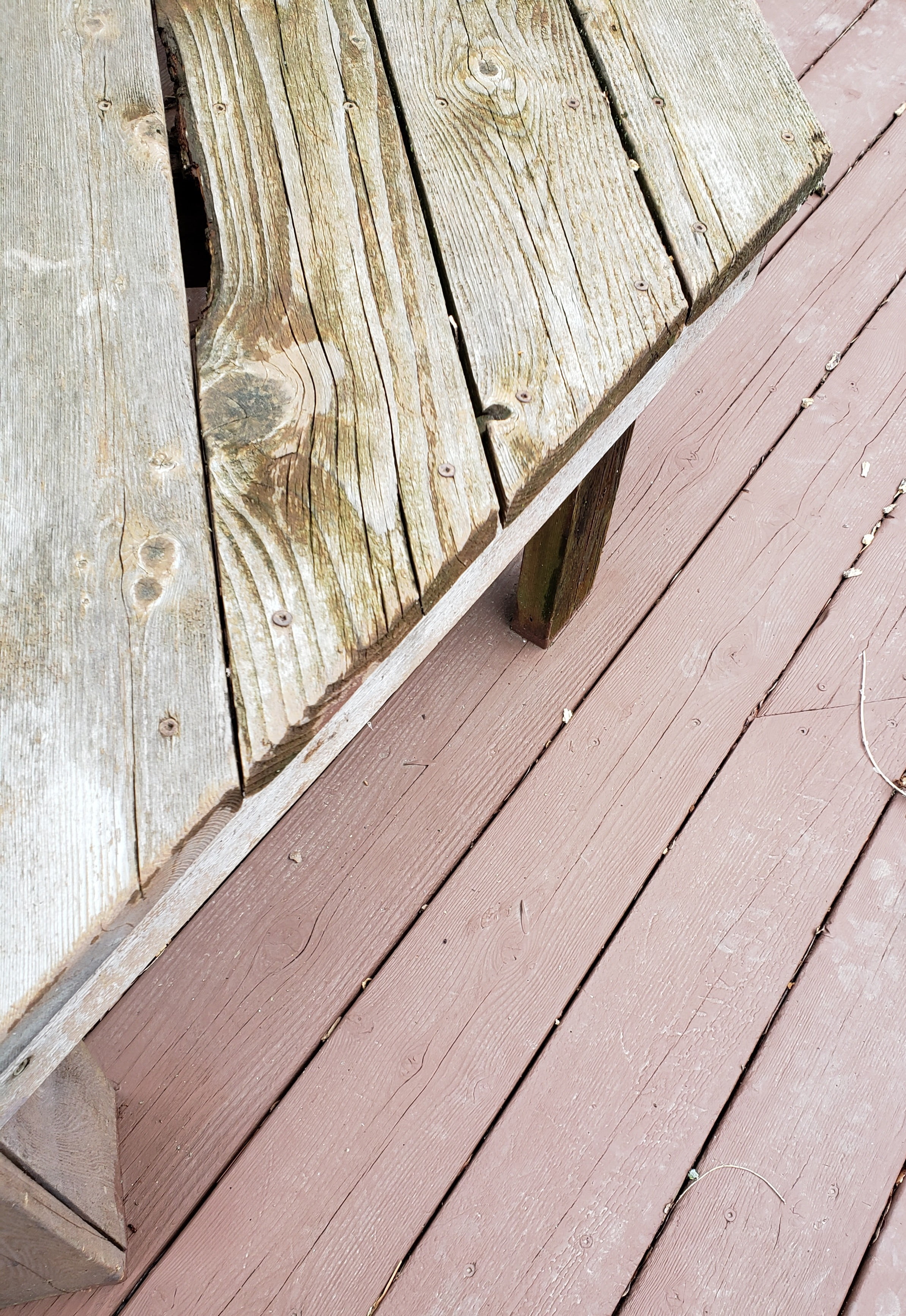

Once again, this site is unbelievable, thank you so much.
Two years ago I put Sikkens Cetol 1 RE on these raw adirondack chairs and benches. Looks awful. I am looking to restore it. I only put the Cetol 1, I did not apply a second-part of the retool system. Sikkens describes Cetol 1 as a transparent, penetrating stain (full description below). The chairs and benches sit around a fire pit in near full sun, Charlotte, NC, next to/under some trees. Two questions I was hoping you could help me with:
1) Restore: RAD stripper, RAD/Gemini Brightener?
2) Refinish: TWP 100 okay? Any other/better recommendations?
Again, thanks so much
Description: Cetol 1 RE is a transparent satin basecoat for exterior logs, siding and other vertical wood surfaces. Use with Cetol 23 Plus RE™ top coats. Available in seven rich wood hues.
Key Features:
Penetrating alkyd-oil formula, part of a 3-coat system
High-transparency transoxide pigments amplify depth of color, clarity and substrate protection
Powerful UV absorbers protect color and wood substrate
Water-repellent
Provides a mildew-resistant finish
Excellent block resistance for additional color options on windows and door frames
Billy
Billy
Reply to  Billy

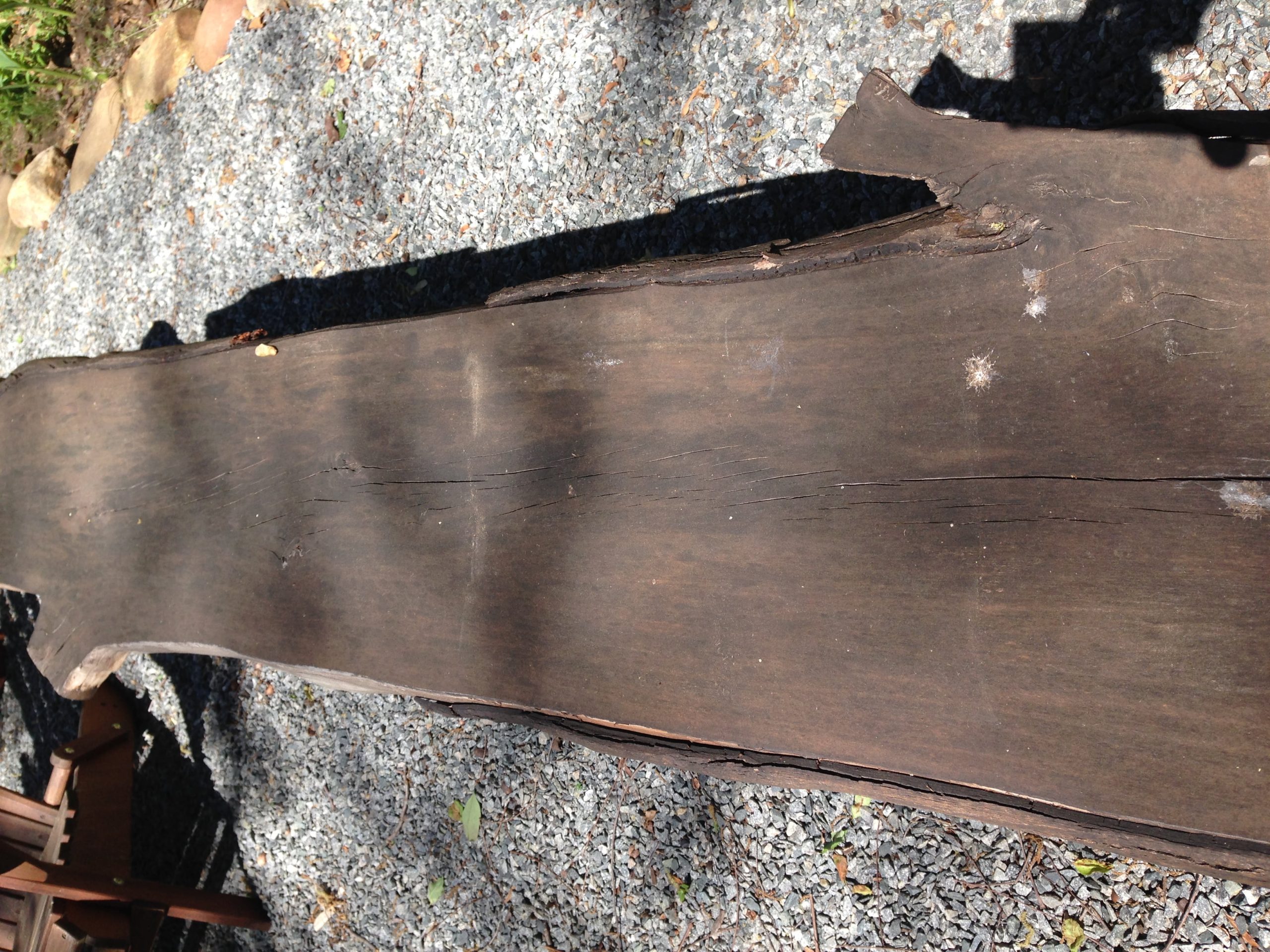

More Pics. Note: the bench is a raw slab of sweet gum wood; the chairs are super-cheap white wood (bought a cheap chair kit online).
Billy
Billy
Reply to  Billy

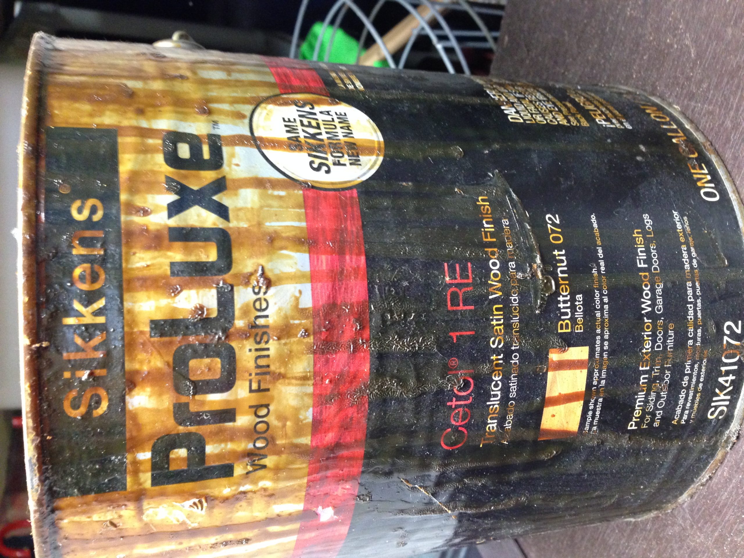

The Sikkens Cetol 1 RE

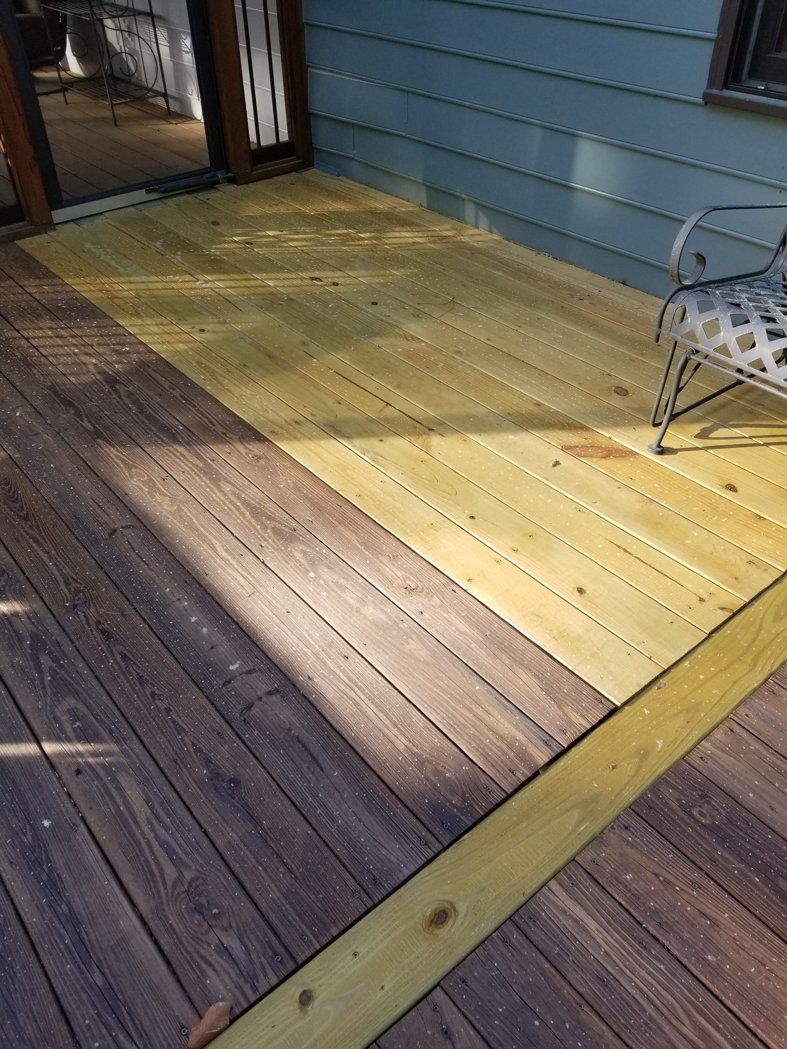

Hello, I recently had some deck boards replaced using SYP PT “with wax”, but supposedly kiln dried. The installer lightly pressure washed them and then two days later applied TWP 100 stain. The “old” deck boards were pressure washed and stained the same way. See picture for results. It is obvious from reading your “deckstainhelp” that this was not the best way to blend new boards with old boards. I’m thinking of using Restore-A-Deck Stripper on the new wood, letting it weather for 2-3 months or more, then lightly pressure wash, apply wood brightener, and then apply TWP 100. Is this a process which will achieve a more uniform finish on the new wood, better matching the old wood? If there is a better process, please describe. Thanks, Lee

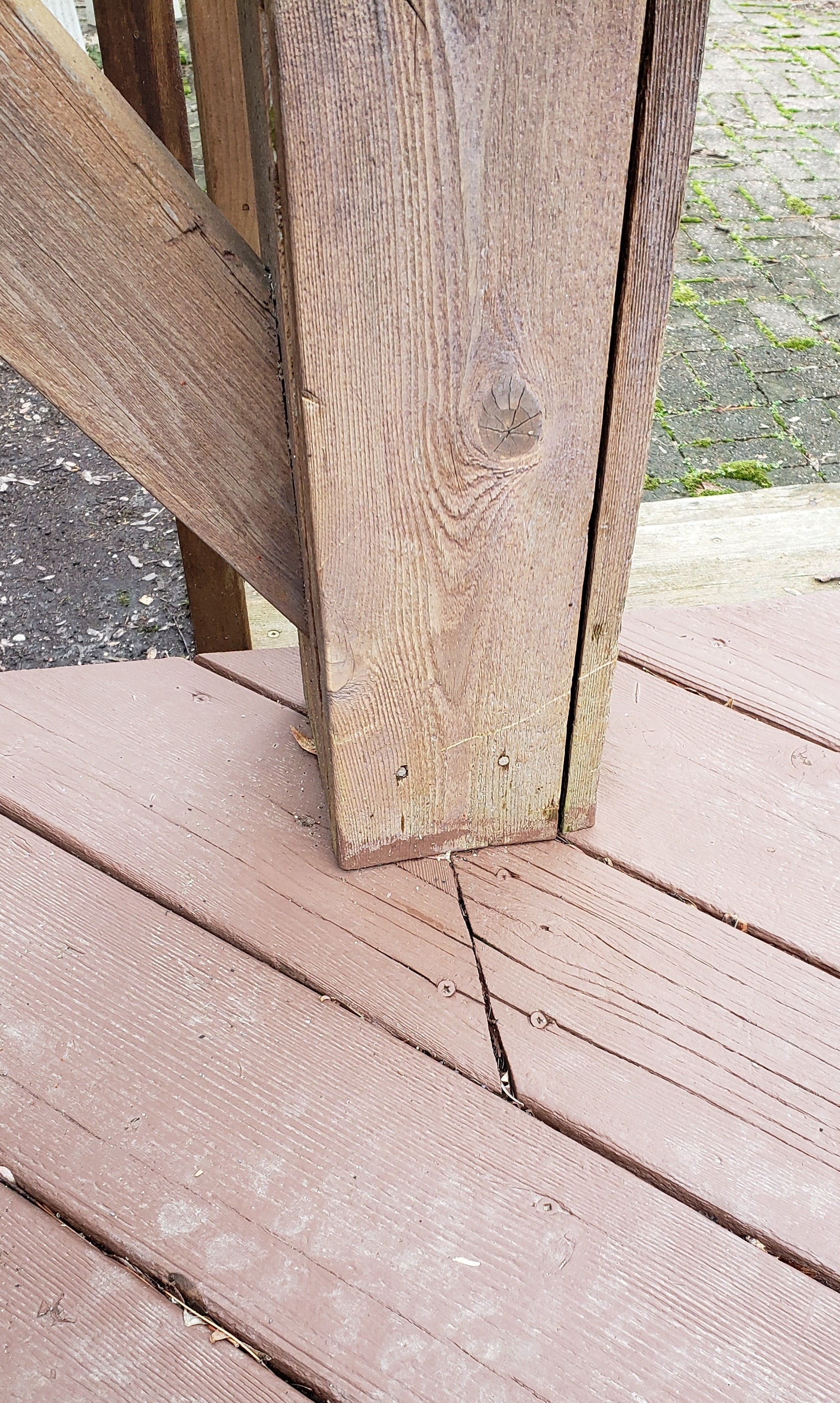

The deck has more of a reddish tone, the benches appear to be untreated, and the vertical posts seem to be stained. It’s difficult to tell the color tone of the deck in the closeup picture, but the other two pictures show it well.
My main concern is the deck itself. I’m hoping a round of stripper and brightener will take care of this, but I’m just not sure.
Any help/advice would be greatly appreciated!

I just purchased a should and want to refinish the deck. It looks like a sealer was used that is peeling in places. I can still see the wood grain through it. Will this remove the sealer? ( am I using the correct name sealer)
Brian
Brian
See attached

Good afternoon, We have a beautiful Gazebo (Redwood) that has Pinofin oil on it. Just wondering if you have a product that will help take the Pinofin oil off and then reapply a finish. I started sanding and I think it will take me forever to do this. Any help would be great.

Sorry this post disappeared when I tried to post pics so I redid whole post. Now it’s here. Oops.
Kekili
Kekili

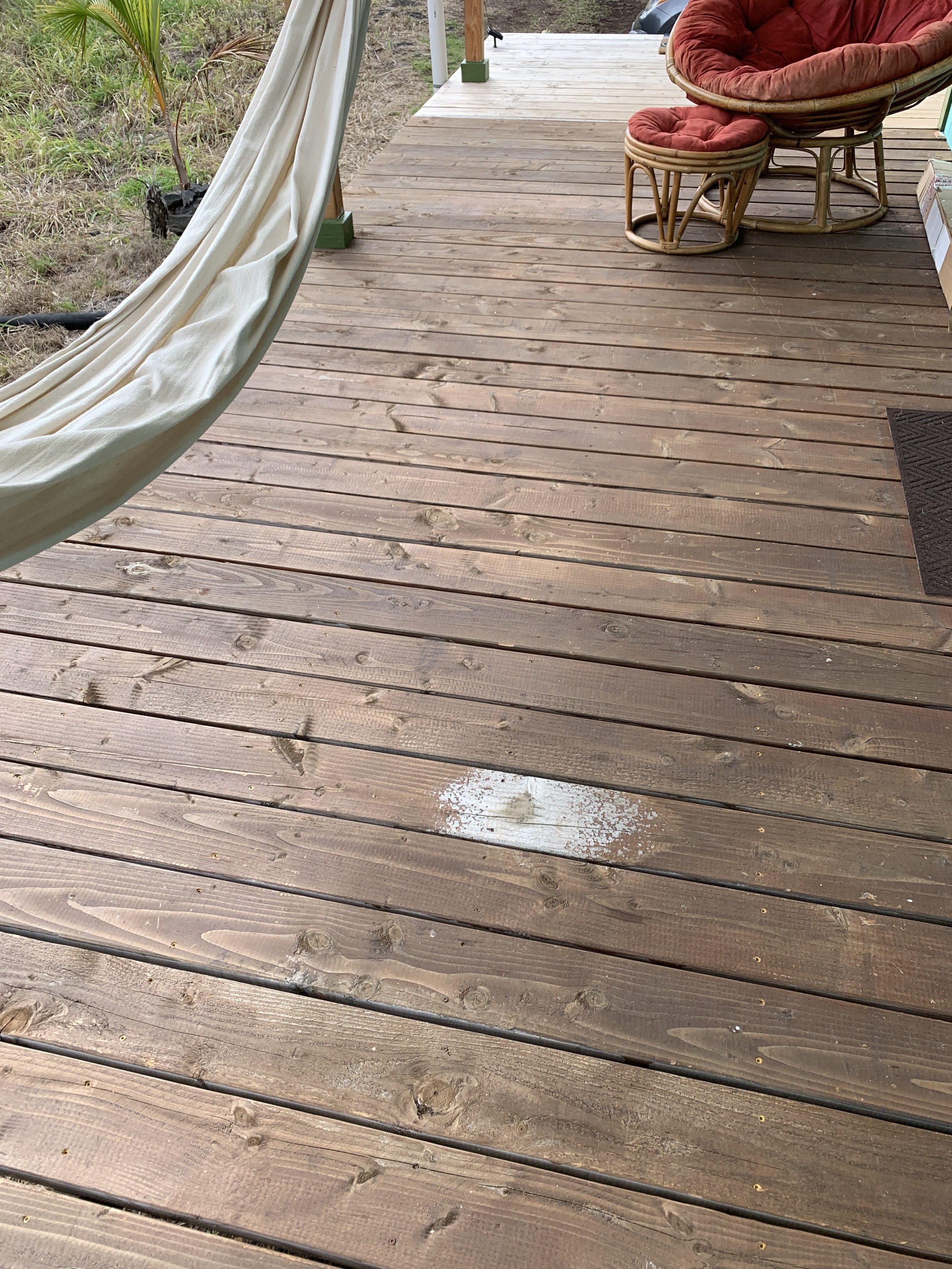

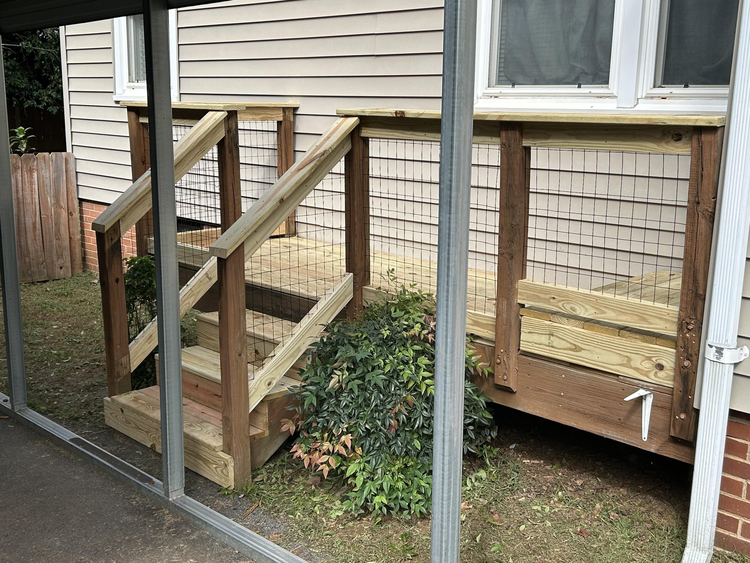

Ok, I recently bought a house with an existing deck. Looks like what is on the original decking is Olympic Elite Advanced Woodland Oil Stain & Sealant. It’s dark so I’m assuming they tinted it. I found this old half used can under the deck. Here are my questions:
1. Since newer portion of deck is 2 months old, should I wait a longer period of time or can I start the either staining the new wood same color (if I take stain to hardware to try and match) OR using stripper on older wood?
2. If I use stripper and go that way, can I use a regular cheap hand sprayer or should I use something else for application? (I recently painted the house)
3. Do I have to do or put anything on new wood before I stain if I’m able to match color of stain that’s on older deck? (Older deck not really old-under 5 years I think).
4. The older deck does have few areas where I can see wood underneath and one spot of white on it. (See pic)
5. I live in Hawaii so we have acid rain. Most of my deck is covered now. Anything about that I need to know?
6. I live off grid with a rain catchment tank for water. Can I use a regular garden hose to spray off or do I have to get s pressure washer?
7. Last question, I also put a line of rough cedar fencing up in front of my house for privacy (can’t do rest of privacy fence yet). Can I stain that now or should I wait? The frame and posts are treated lumber.
I’m not expecting perfection and that’s fine. I just want it to match and look decent. I realistically will probably put some outside rugs on in places.
I’ve attached pics. Mahalo for all your help!
Kekili
Kekili
Mahalo. Ok I lightly sanded that white spot. It’s just the stain coming off. I can see gray wood now.

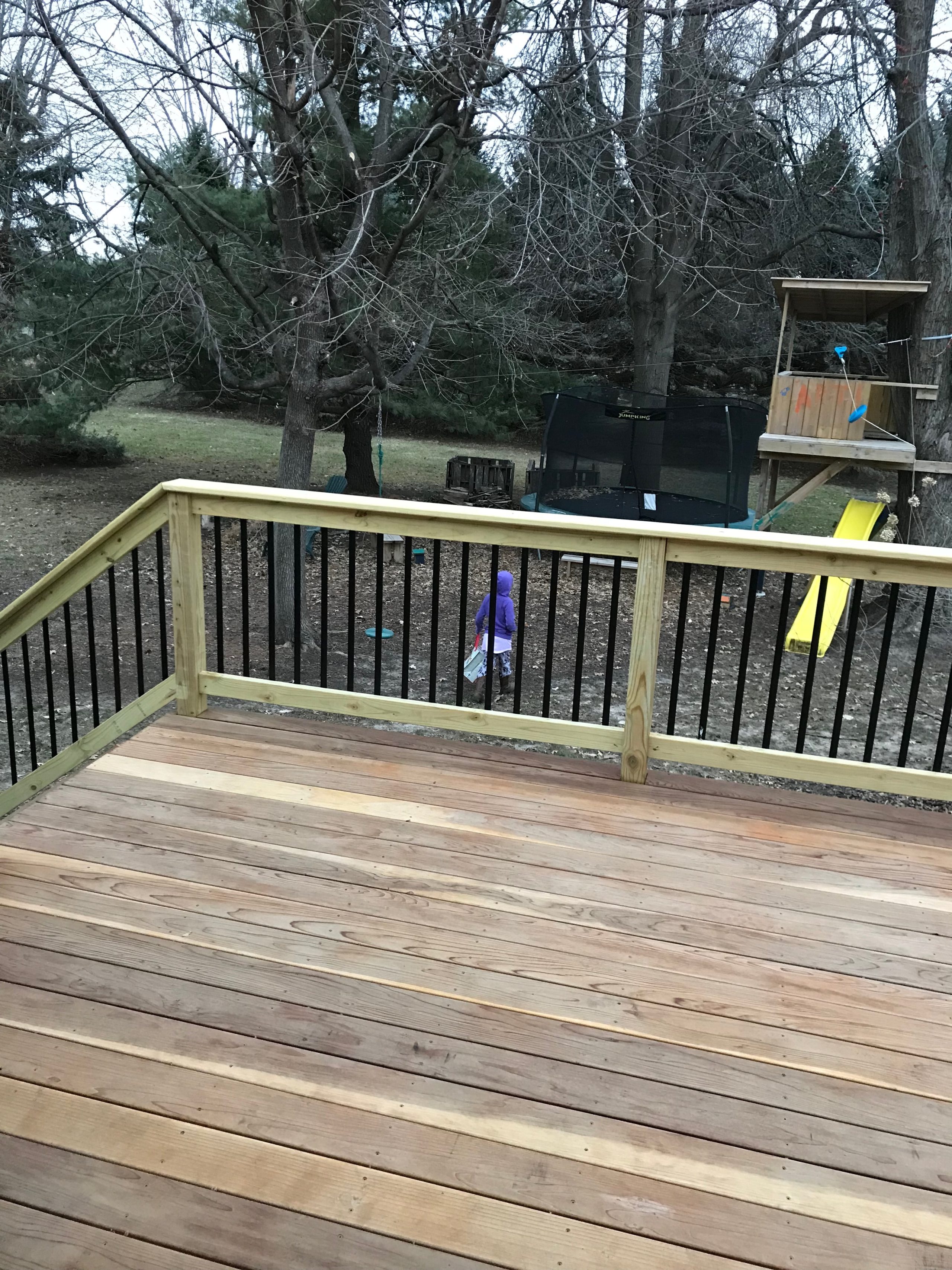

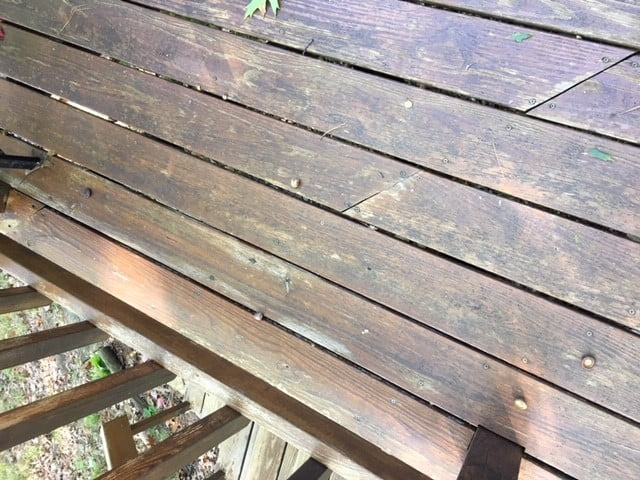

We have an old two-part redwood deck. Last fall we replaced the upper portion (due to excessive dry rot and poor construction) with boards that had been in the lumber yard for years. The lower part is very grooved and was very dry and gray. After installing the new redwood decking I stained it all with a SW stain because I assumed since it was already dry it would be okay. This year the new part turned very gray and mildewed. I realize I should have waited to stain.
Today I used the stripper and brightener on the entire surface for upper and lower and I was pleased to see much of the lovely red color come back, but there is a large area that is now black. I’m sure we applied evenly and pressure washed evenly as well, so I don’t know how to correct the problem. I redid the stripping in the blackened areas and saw no improvement.
We’re in Iowa and the deck gets midday sun. I plan to stain with TWP. We just had a week of rain but should be dry this week. How do I address the blackened area?
jdmckee
jdmckee
Should I rewet before brightening? Here’s how it looks after drying overnight. We mixed both the stripper and brightener on the weaker side and limited the time left on, but equally across the deck. I did finish with brightener and then rinsed it yesterday.
jdmckee
jdmckee
It’s much better today but I can still tell where the dark areas were. I did sprinkle a bit of water on the dark spot this morning to see if it looks different when wetted. After it’s completely dry just stain over or do I rinse the brightener off?
jdmckee
jdmckee
Thank you for walking me through this process. Here’s how it looks after rinsing the brightener off. Better but not as good as I’d like. How do I fix it? Or can I?
jdmckee
jdmckee
Thank you for walking me through the process. I’ve rinsed the whole deck down. It’s better but I can still see a darker area. What do I do now?

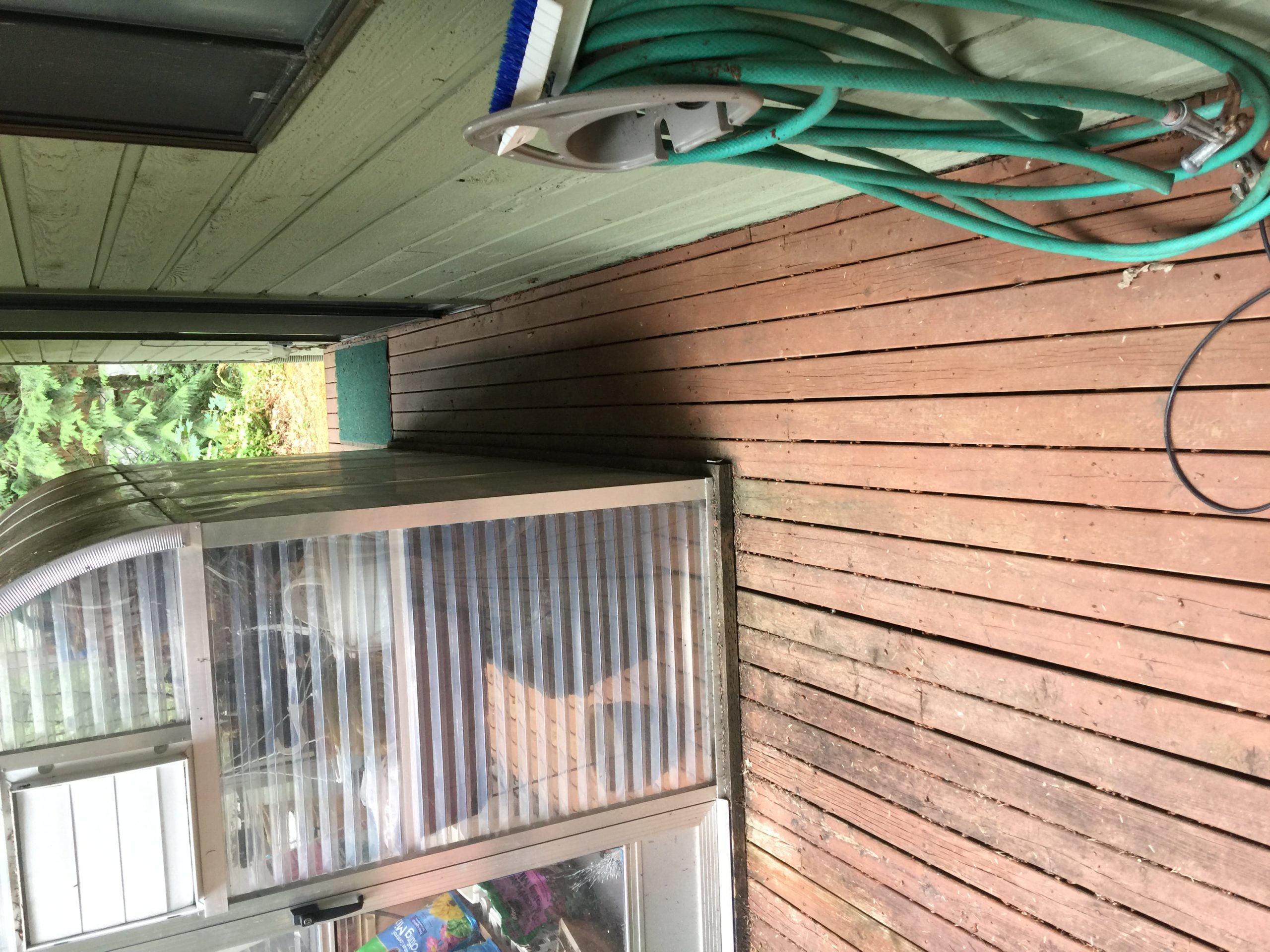

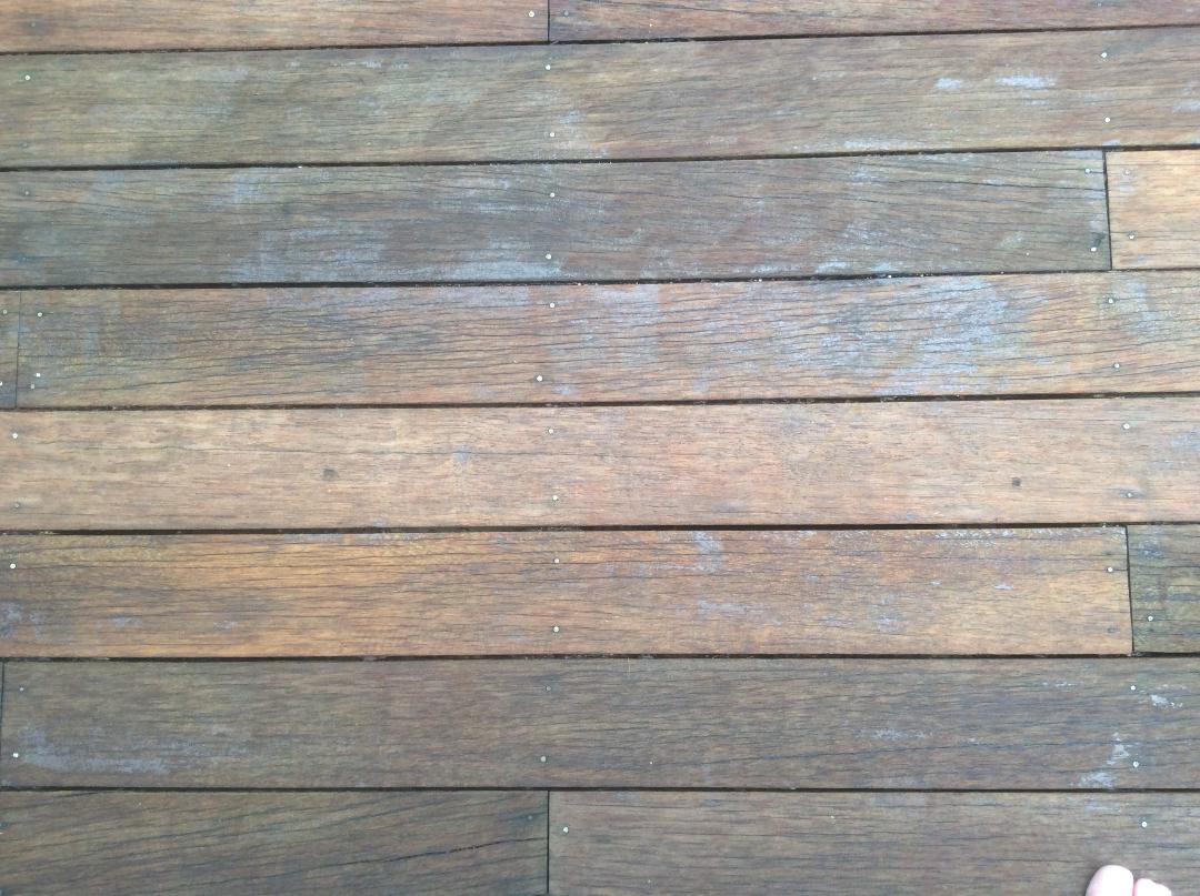

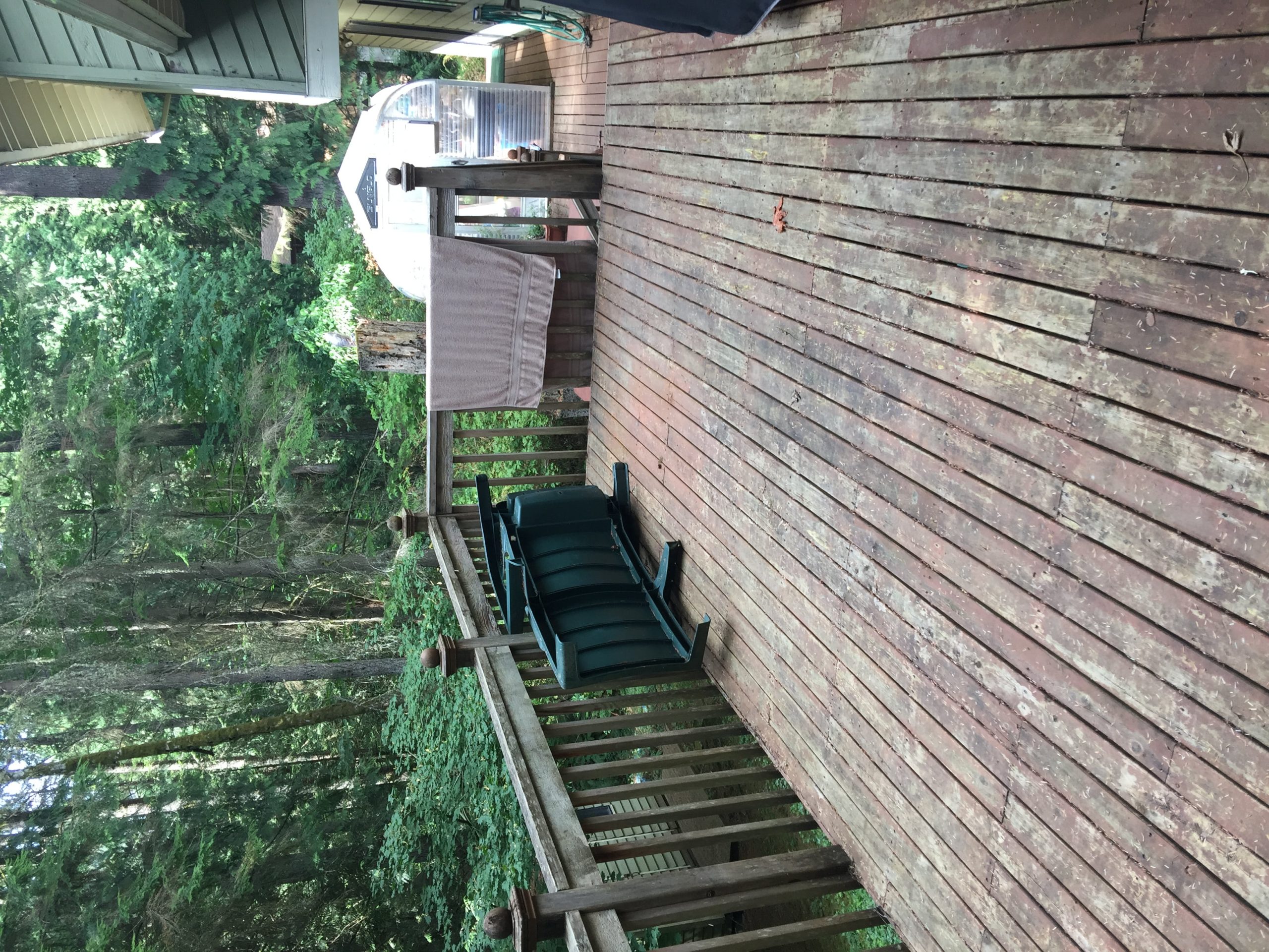

johnbilo
Forgot photos
johnbilo

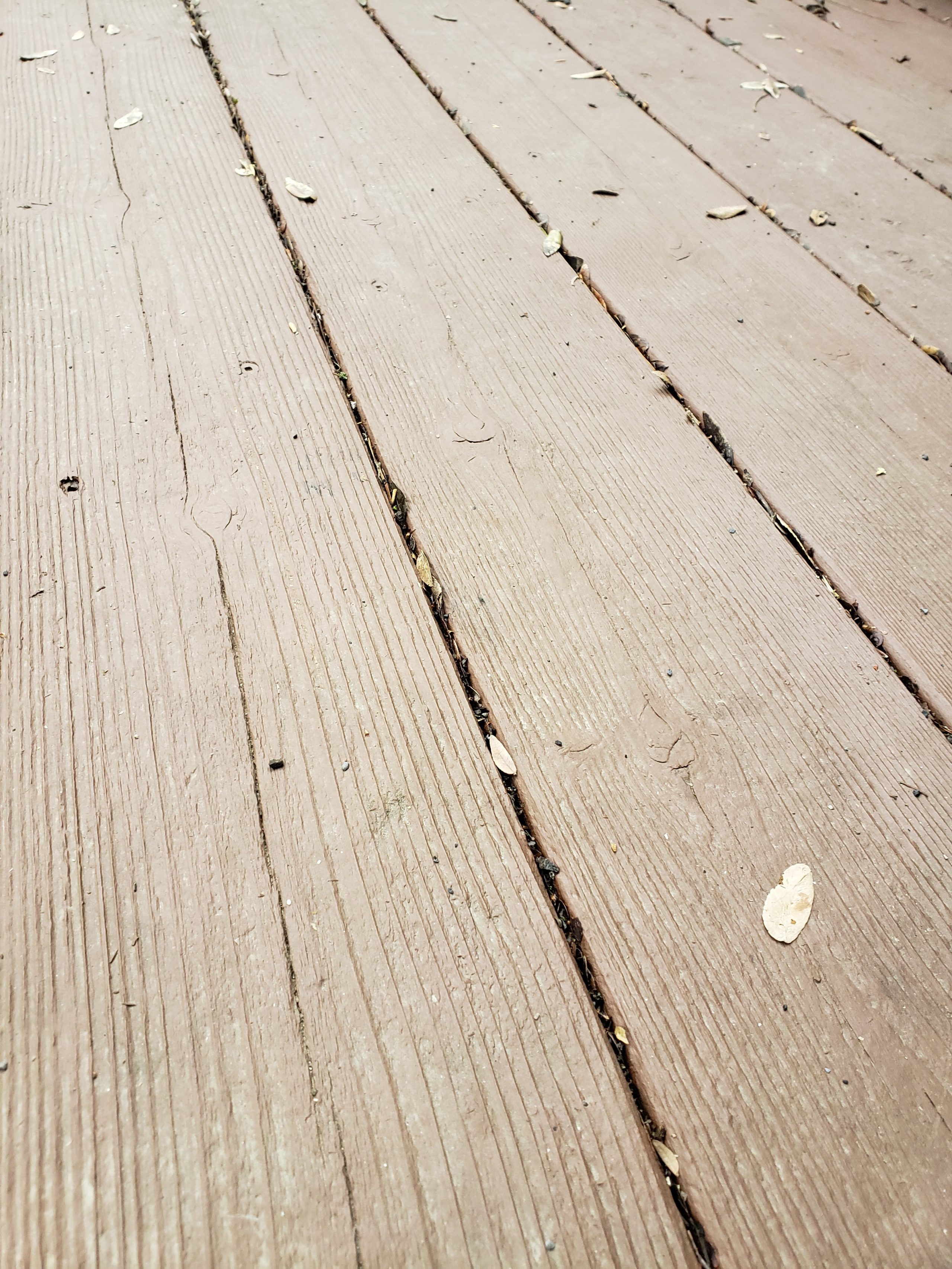

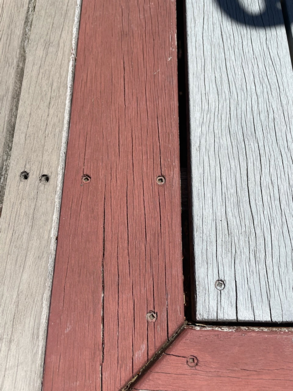

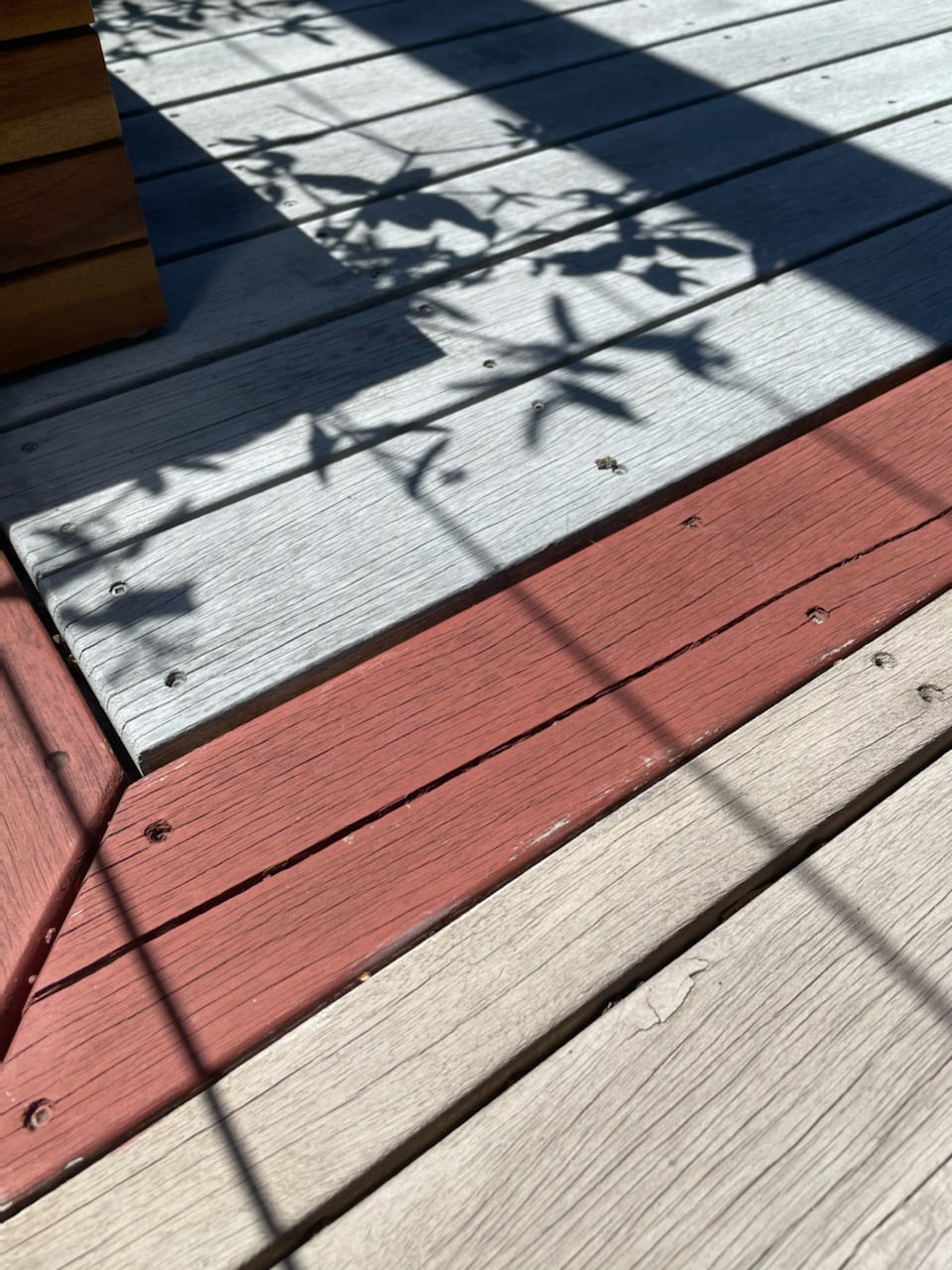

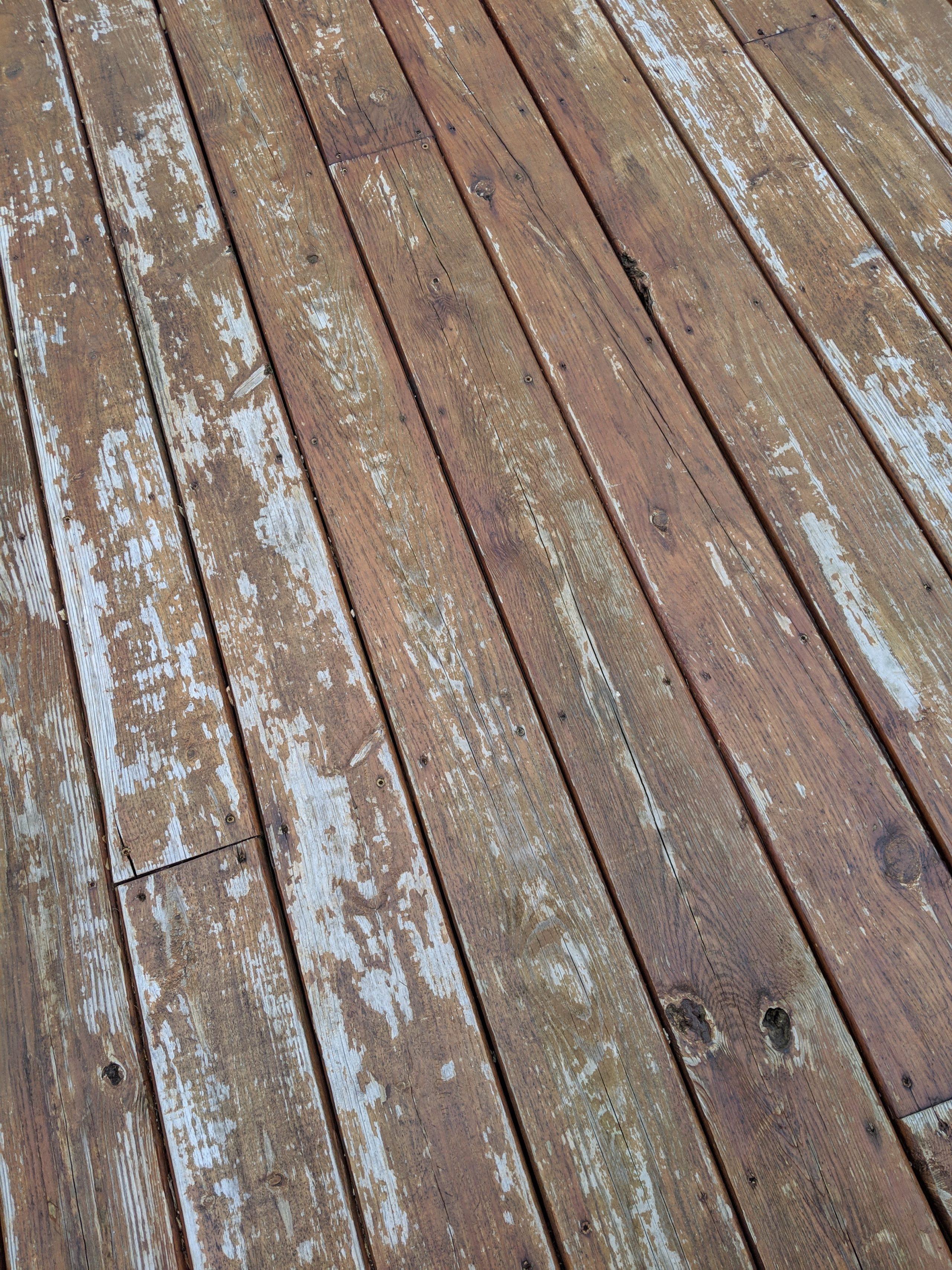

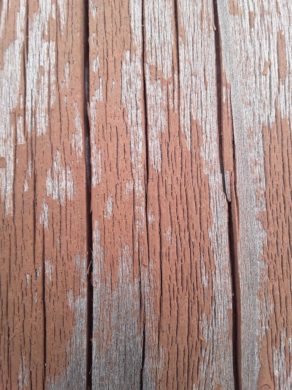

Hello-
I would appreciate any advice you can provide on this project.
Deck is in Seattle area, pretty shaded area, some direct sun but only for a couple of hours.
Unknown wood species and unknown product but I would guess Thompson. If you can tell that would be great. Is it a solid?
Any chance it would strip? Would you advise stripping and then sanding what is left?
Someone I trust advised a Messmers UV+ semi after I get it off.
Thanking you in advance.
johnbilo86@gmail.com
Thank you. I was afraid that this would be your response but I am not surprised. For 400 square feet do you think I can get this ready for coating with a full week of stripping and sanding? I ask because here in the Great Northwet the rains could be coming soon and I am wondering if I should just wait until next summer.
Any thoughts on the Messmers?
Thanks again

Will this remove Sikkens Cetol 123 from my cedar siding? This stuff is unlike the SRD varieties of stain.
