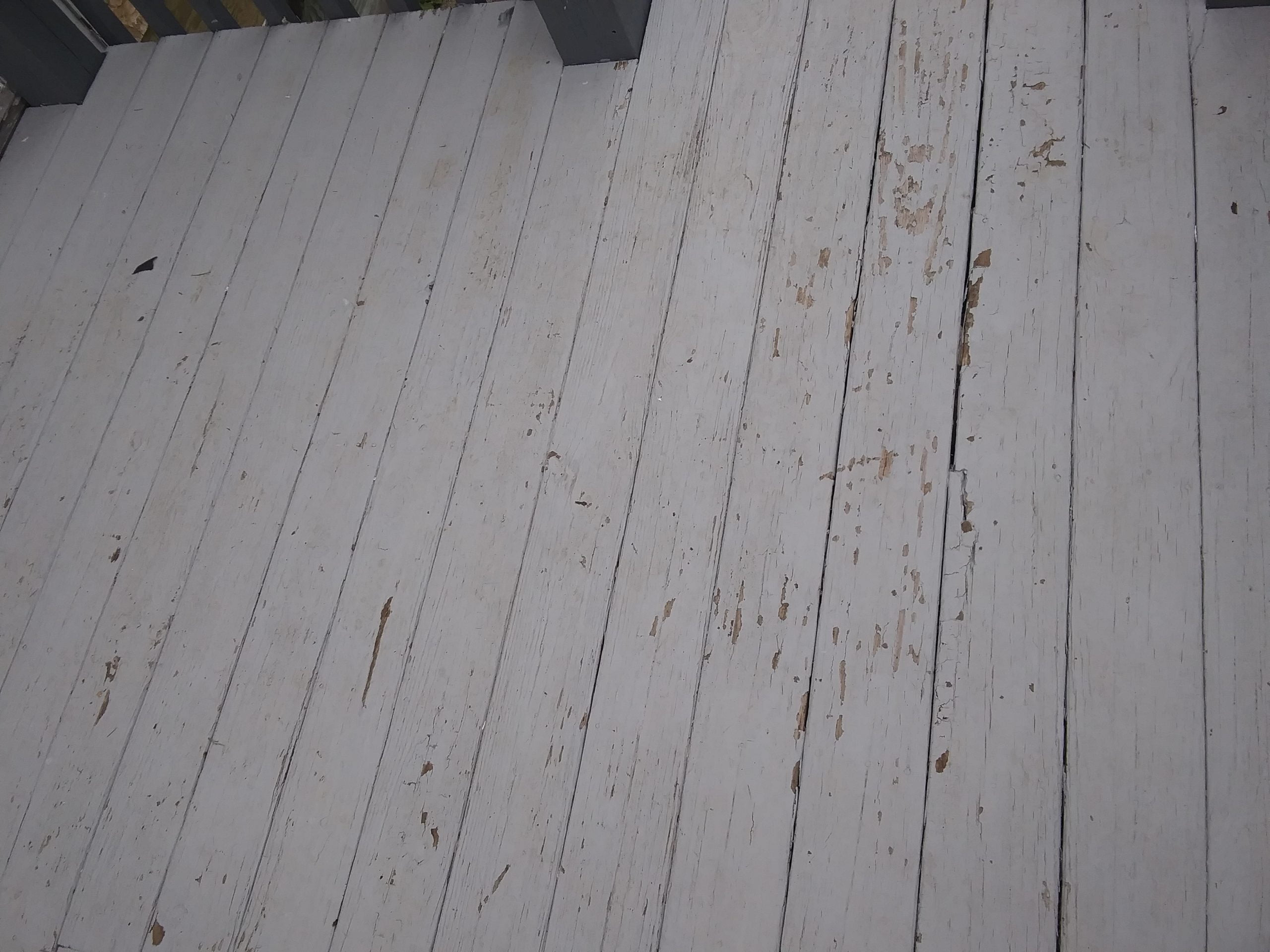

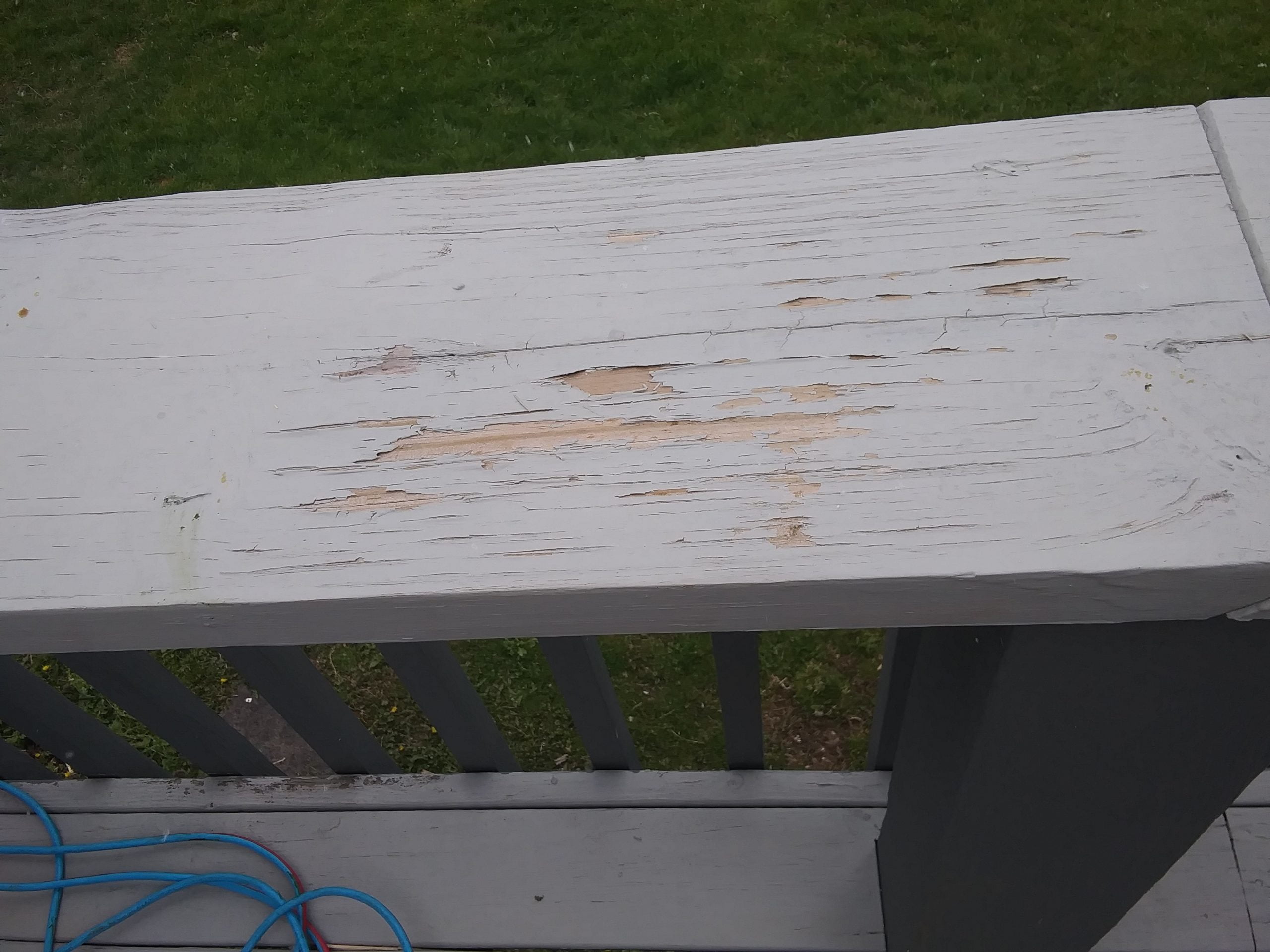

3. Wear/Tear and Peeling: 2
In my testing, RockSolid peeled the worst of all the deck resurfacer products I have tested. It started peeling within the first year on our cold-weather test deck.

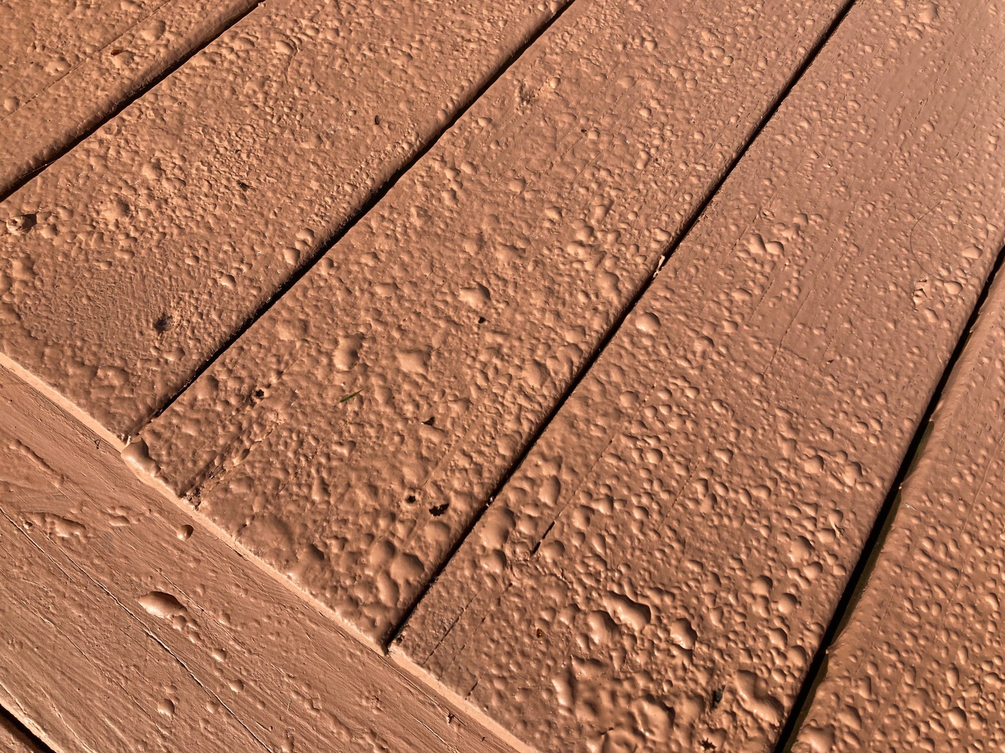

Rust-Oleum RockSolid and Restore Customer Photo Issues
Why Deck Resurfacers Fail
Deck resurfacers like RockSolid are thick, film-forming coatings. They sit on top of the wood rather than soaking in. On a horizontal deck surface, that creates several problems:
  • Wood moves; coatings do not. Deck boards swell and shrink with every change in moisture and temperature. A thick, rigid film cannot keep up, so it cracks and lets water in.
  • Trapped moisture. Water enters through cracks, end grain, and the undersides of boards, then gets trapped under the coating. That leads to bubbling, peeling, and eventually rot.
  • Freeze-thaw cycles. In cold climates, trapped water freezes and expands under the film, which accelerates peeling.
  • Foot traffic. Stairs, doorways, and walkways wear through first, leaving a patchy look that cannot be spot-repaired cleanly.
  • Prep sensitivity. Any dirt, mildew, old stain, or moisture in the wood at application time weakens adhesion.
These products can hide splinters and cracks for a season, but they do not fix worn wood. Badly damaged boards should be replaced rather than coated.

Buyer beware! Not happy at all. Followed instructions to the letter and now bubble/blister within 5 days. Started the complaint process with RockSolid and see where that goes. 450sqft deck and so far about 100sqft affected. If this is 5 days, who knows 12/24mos from now. I bought product from big box store and have a case with them as well asking for support. Not easy to apply, but with patience, it was all looking good upon completion, even the color was right on. Then 2 days later, this issue. There is water or fluid of some sort and when drys, paint becomes flaky. Its gonna be a big mess.

I started the RockSolid deck resurfacing process, then I found these reviews, now I’m having second thoughts.
The deck was installed 2 years ago and left untreated with intentions to use a sealer, stain or some kind of coating so the wood is weathered. I used a deck wash and a power washer. I removed pretty much all the dirt and mildew, the power washer roughed up the surface of the wood, which is good because I’m trying to make this a non-slip area. A couple hours after washing, I then applied the RockSolid Deck Start Wood Primer, it had a very long, soaking dry time with the humid cool night. By mid morning it was fully dry leaving a much harder surface than the bare wood. The surface was also a nice clear matte which then got me thinking….
This looks nice, I wonder if this Deck Start Primer can be used as a topcoat. Skipping the 5X topcoat?
HAS ANYONE TRIED THIS???
I’m suspecting that moisture is being trapped under the thick topcoat causing the bubbles and pealing… so if I just use this primer which is far thinner, maybe it will breathe and not bubble.
As for making it non-slip, I have a bag of RockSolid anti-slip “sand” …. if this primer can be used as a topcoat, I could mix this “sand” in with the remaining primer and give the deck a second coat. I’m sure this coat will dry quicker due to not having moisture in the wood from washing.
Thoughts?
