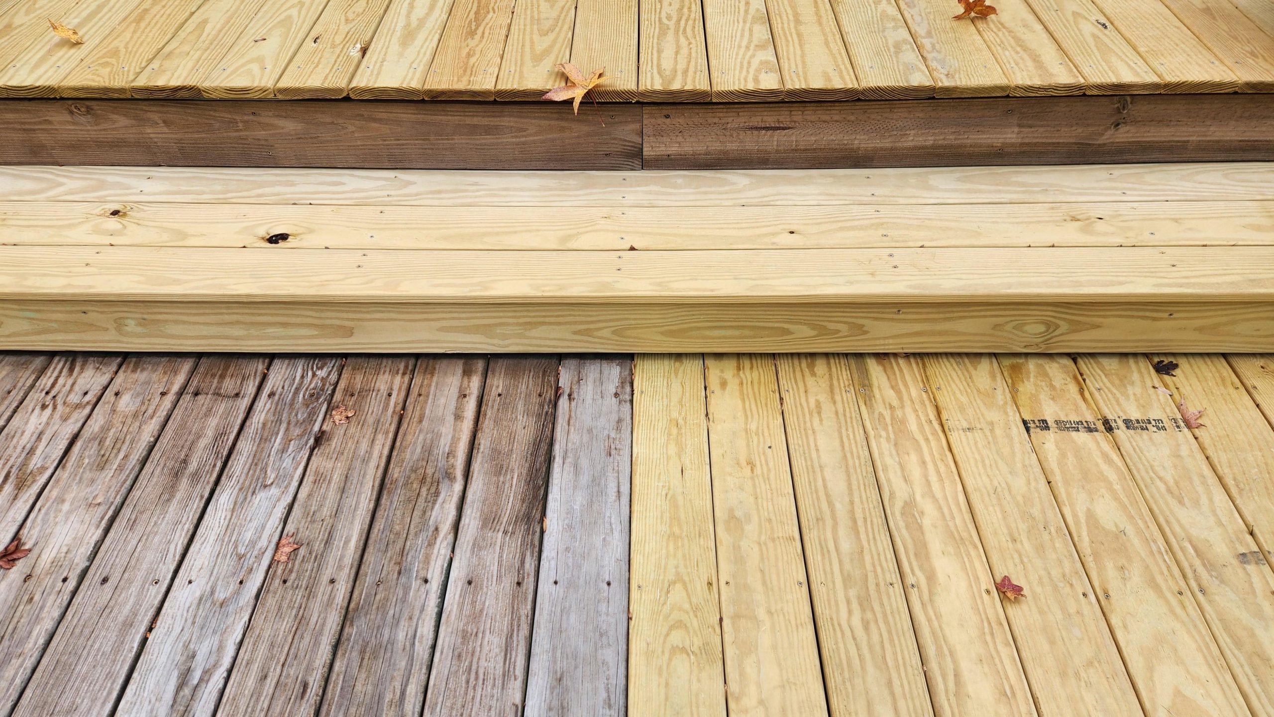

June 2016 deck construction stained with an oil based semi transparent Spring 2017. Reconstruction completed Oct 2024. Pressure washed, brushed Defy wood deck cleaner, then Defy wood brightener. Please recommend a durable semi solid that will unify color between the old & new boards.
20241107_091938
20241107_091841
20241107_091927
20241107_091845
Rick Harris
Rick Harris
Thank you, would it be better to coat the old wood before winter and coat the old and new in Spring? Which semi solid will unify the color between old and new?
Rick Harris
Rick Harris
Thank you Scott.

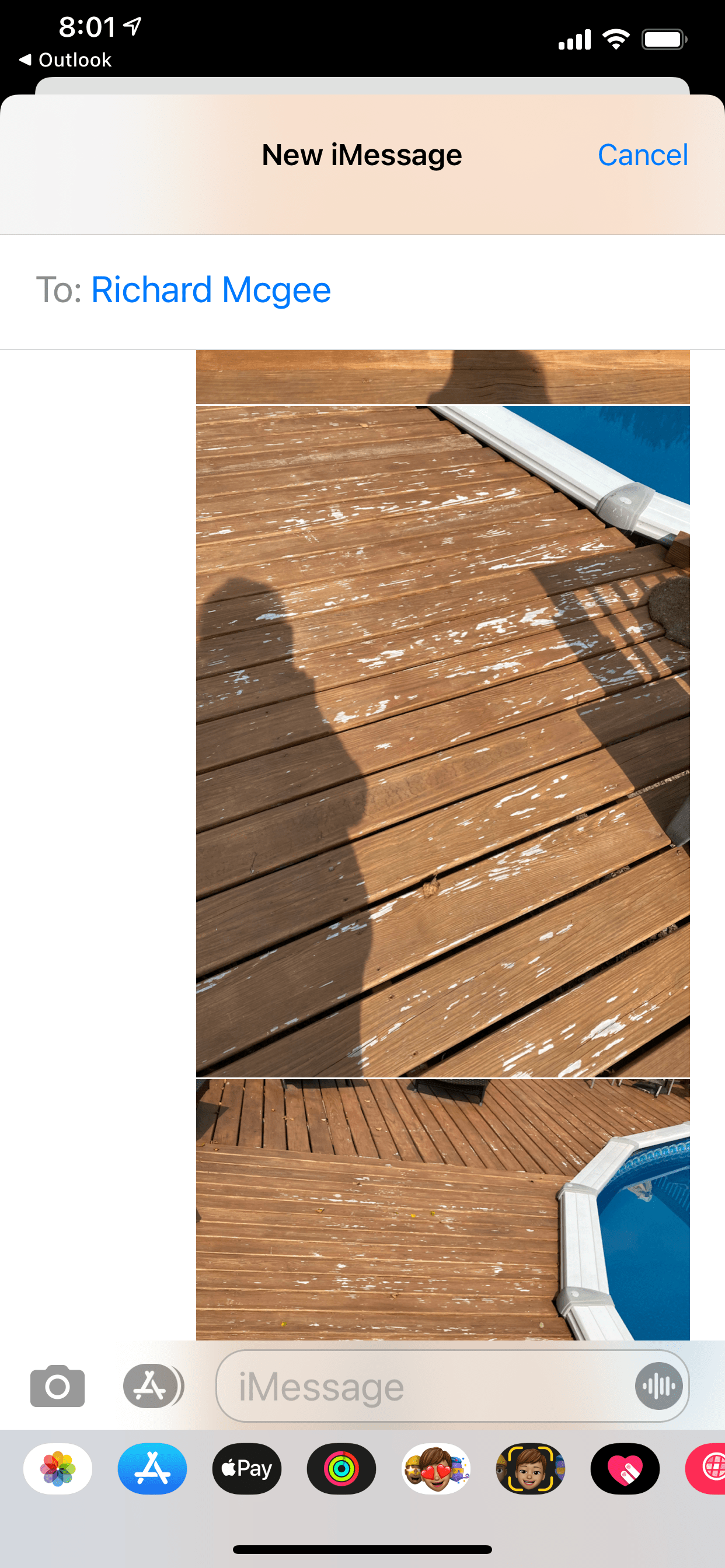

Not even one year and solid SuperDeck coming up in 3 inch patches. Starts as a pin hole and grows. I am sanding and reapplying since I paid 10,000. Class action suit against should have been paid out.
Carol
Carol
Reply to  Rachel B
Hi Rachel. Im going through a nightmare with my deck and it’s just barely at a year. Has Sherwin offered to fix your deck based on their bad product?

Stay away from the Superdeck with SW label! It’s not the same product that Duckback has been making for years and which I still purchase through other retailers, such as Ace Hardware and local lumber yards. Buy the product with the Duckback label (leaf on the can..and it does not say “Sherwin Williams”) and you won’t be disappointed. I believe SW, who purchased Duckback, put the Superdeck name onto their Deckscapes line which is tintable. Tintable seems great, but if the finish is awful, who cares how many colors they can make for me! I successfully sanded and stained with the non-SW product a few years ago. The client was extremely happy and had me back two years later for the same process. This time I grabbed the Superdeck with SW label for convenience, otherwise it was the identical product (oil based formula, semi-transparent, stock “redwood” color). The result with the SW labeled product was vastly was INFERIOR. It looked brassy and sat on top of the wood, unlike what I expect from Superdeck: a rich oil that penetrates beautifully into the wood. Same crew. Same deck. I’ve been on a mission to figure out why the difference, and eventually a SW rep told me what’s what. Stick with the Duckback label product sold OUTSIDE of SW. It’s excellent. I’m an 18-yr deck refinishing contractor and it’s our go to.
