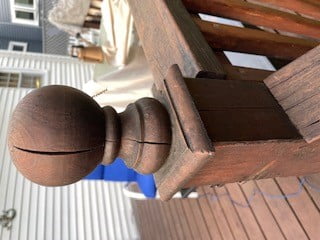

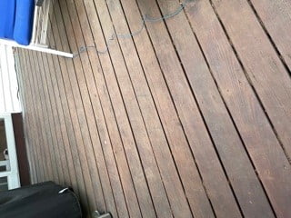

Thank you – Here are a few pics – there is some pollen on deck and furniture/grill, but the flat dull coloring and dried out wood still comes through.

West facing deck pictures.
Terry
Terry
The deck is WRC, west facing in the Seattle area.
Terry
Terry
This a second story cedar deck with a western exposure.
