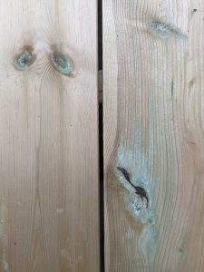

I’m looking for some advice on staining my deck. I had a Southern Yellow Pine pressure-treated deck installed on May 29, 2026, and I’m not sure if it’s ready to stain yet.
I did the water test I’ve seen people recommend, and the water seems to be soaking in.
A few questions:
* Should I use TWP 1500 Series or Cutek, or is there another product you’d recommend for this type of wood?
* Will either of those work well on new pressure-treated Southern Yellow Pine?
* Should I apply the stain with a brush or stain pad?
* Should I let the deck weather longer before doing anything?
I’m honestly just trying to make sure I do this right the first time and don’t mess up the new deck. Any advice would be appreciated!
Thank you so much!

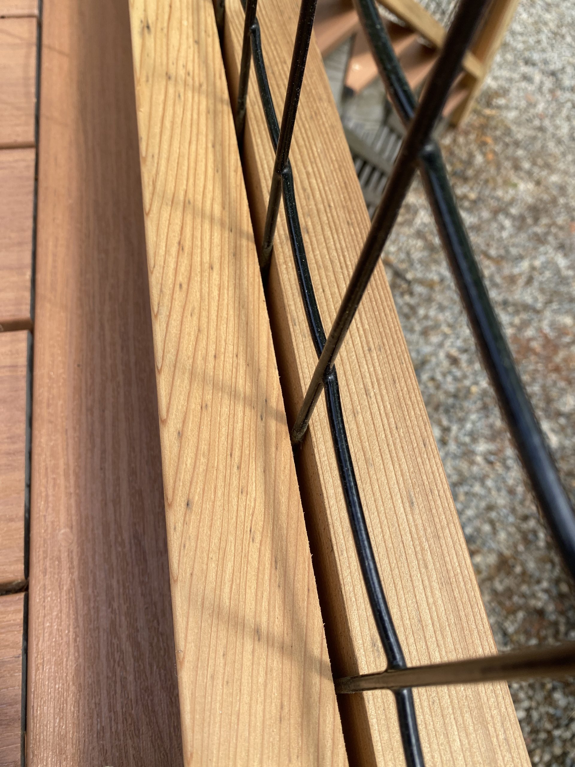

Martin
Martin
3 more pics re: previous comment
IMG_4925
IMG_4926
IMG_4928

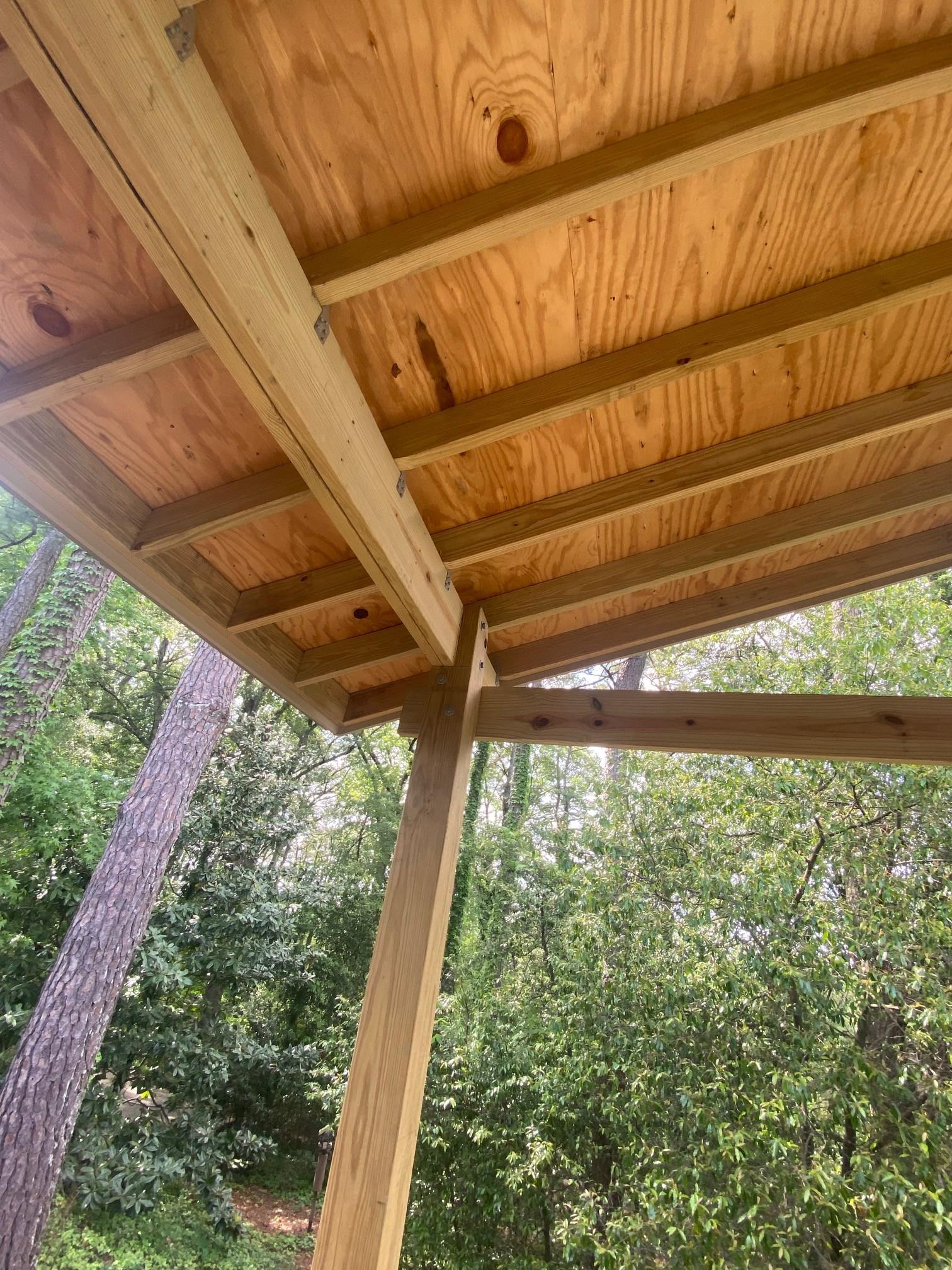

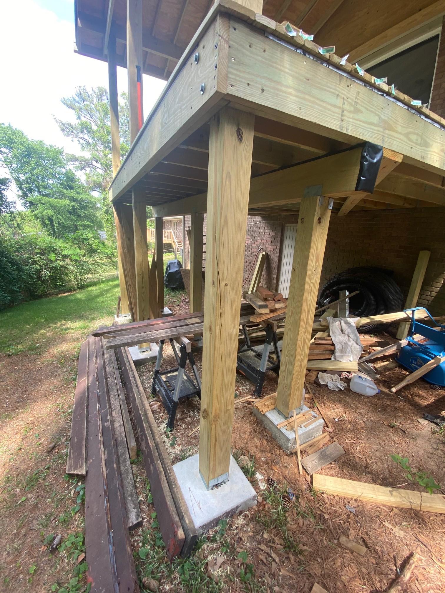

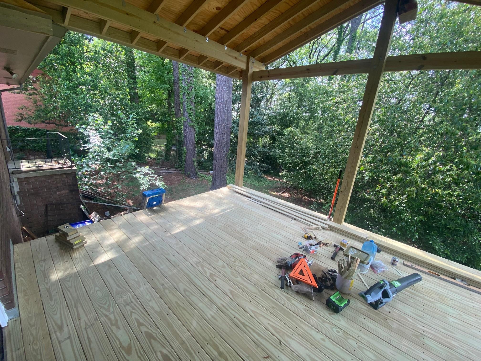

Martin
Martin

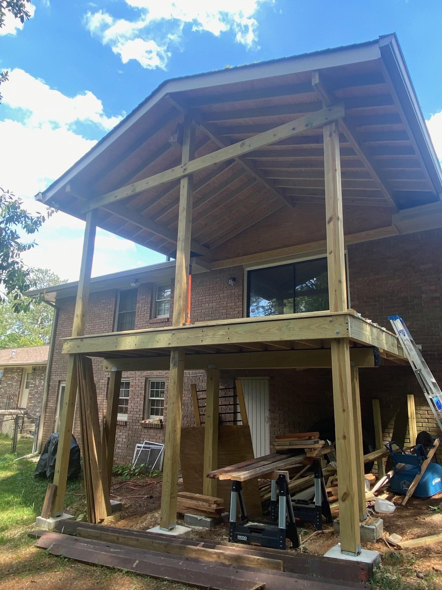

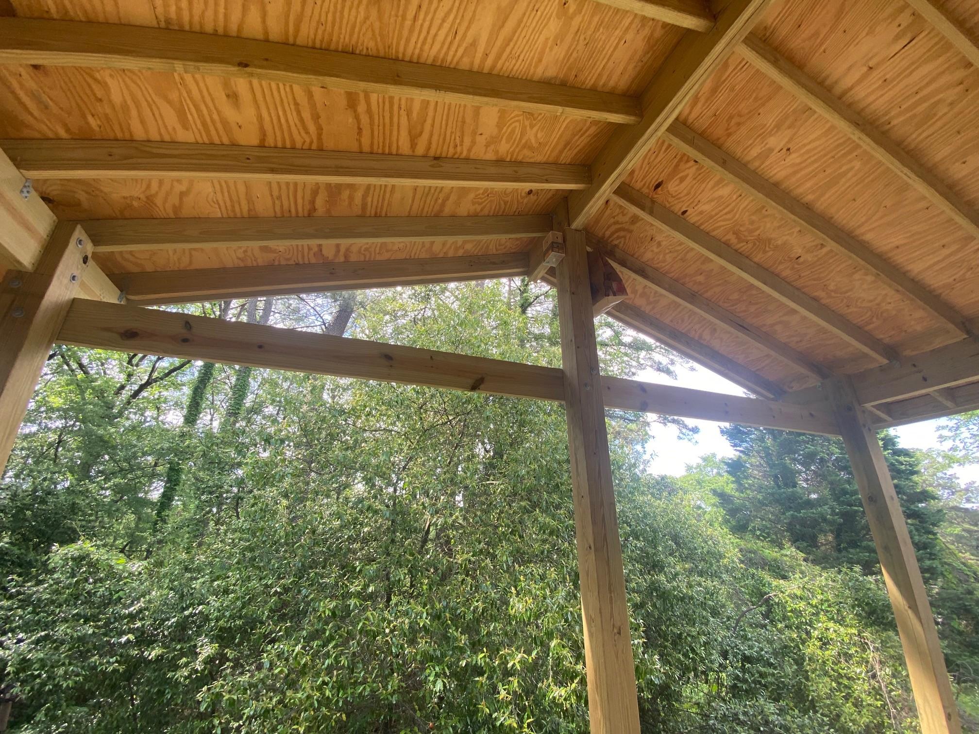

Hey Scott,
Wow, your website is a tremendous resource. Thank you for creating it and answering so many questions!
I live in Atlanta, GA.
I started my new deck with treated 6×6 posts and floor joists July 2024 (10 months ago)
Added 6×6 treated posts for deck roof Nov. 28, ’24 (5 months)
Bought 5/4 treated decking Mar. 23, ’25 and let it dry outside for 3 weeks before installation.
(5 weeks total time outside)
My friend says I need to stain before installing the railing.
I did water drop test on decking. On half of the boards the water beads, the other half, not as much.
There are manufacturer ink spots on the decking which I will remove w/ 60-80 grit sandpaper,
  as per your instruction.
The outer band boards of the roof are covered with pvc fascia all the way around.
Roof boards are 1/4” plywood(not treated). Roof joists and 3 roof beams are treated.
1. I believe I only need to stain the 6×6 posts, outer deck band, front cross member, and decking, but please let me know. Which parts of the deck need staining/sealing?
2. Do I need to clean and brighten the with “Restore-A-Deck”, or can I just go ahead and apply stain, since it’s all relatively new wood?
3.  I would like to see the grain as much as possible, and not color the deck any more than necessary. Deck has a roof, so it gets no sun the first half of the day, and maybe 15% of deck gets sun the latter half of the day. I would like to use the same stain for all, and agree with your preference for semi-transparent stain, but I think the only one you recommend for less than 2 months weathering is Woodrich Timber Oil, or maybe Armstrong. Which one(s) do you recommend?
4. I don’t think I need to stain the plywood or roof joists, but please let me know what you think.
5. There are some unused screw holes in the outer rim. What is the best way to fill them?
6. I know I’m supposed to let the boards weather more after sanding, but I want to stain soon before humidity kicks in (May 15). Is that ok?
thank you for your help!

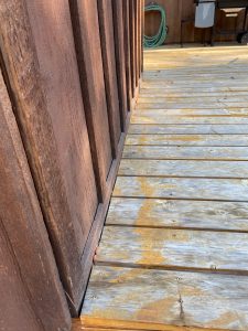

Martin
IMG_4918
IMG_4920
IMG_4921
IMG_4924

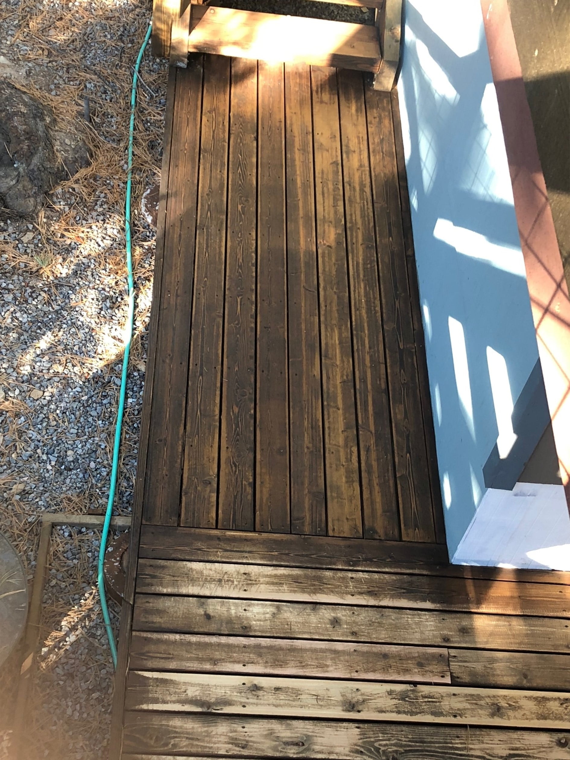

Thanks for the clarification. Here are some pics. Is it okay to skip sections, like the vertical wood slats, if they look good or is it best to just do the whole deck/stairs again?

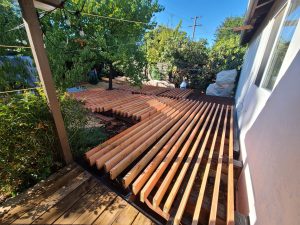

Building a new deck in Northern California using doug fir 2×6 decking. The deck is at grade, so will have minimal ventilation underneath. Is there an advantage, in this situation, to use the penetrating oil stain on the underside as well to help fend off rot?
Also, I must say it feels wrong to let the deck get rained on for months before staining. Is there a penetrating oil stain that you would recommend after weathering for 1 month?
James
James
Thanks for the quick response! So, there’s no concern about cupping with a deck that has poor ventilation underneath? People say that the top of the deck board drying faster than the bottom creates this, and I was wondering if by using penetrating oil on the bottom it might help fend off some of that underdeck moisture?
James
James
Here’s a photo, in case that helps.
Jerry
Jerry
Reply to  James
Looks like plenty of ventilation, as long as you space between each board rather than butting them tightly. We just took up all of the deck boards at the house we bought last year, because they were not spaced, and refastened with a 1/4″ space. Much better breathing!

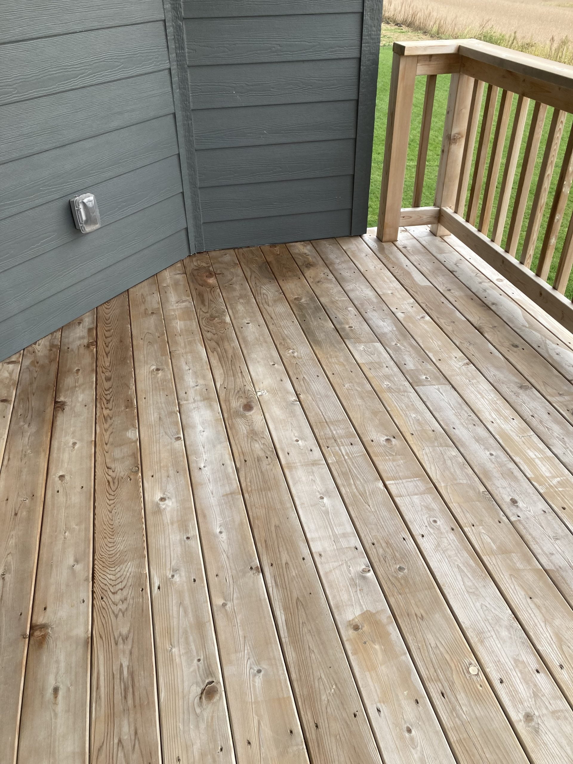

Just had porch redone late June up in northern New Jersey so it’s been about 3 months. Constructed out of WeatherShield appearance grade pressure-treated board southern yellow pine lumber (Product/Purchase tags stapled on wood stated – “weathershield premium wood products awpa u1a uc4a mca reten std 0.15”)
The samples stains we are using is Benjamin Moore’s arborcoat waterborne exterior SOLID stain.

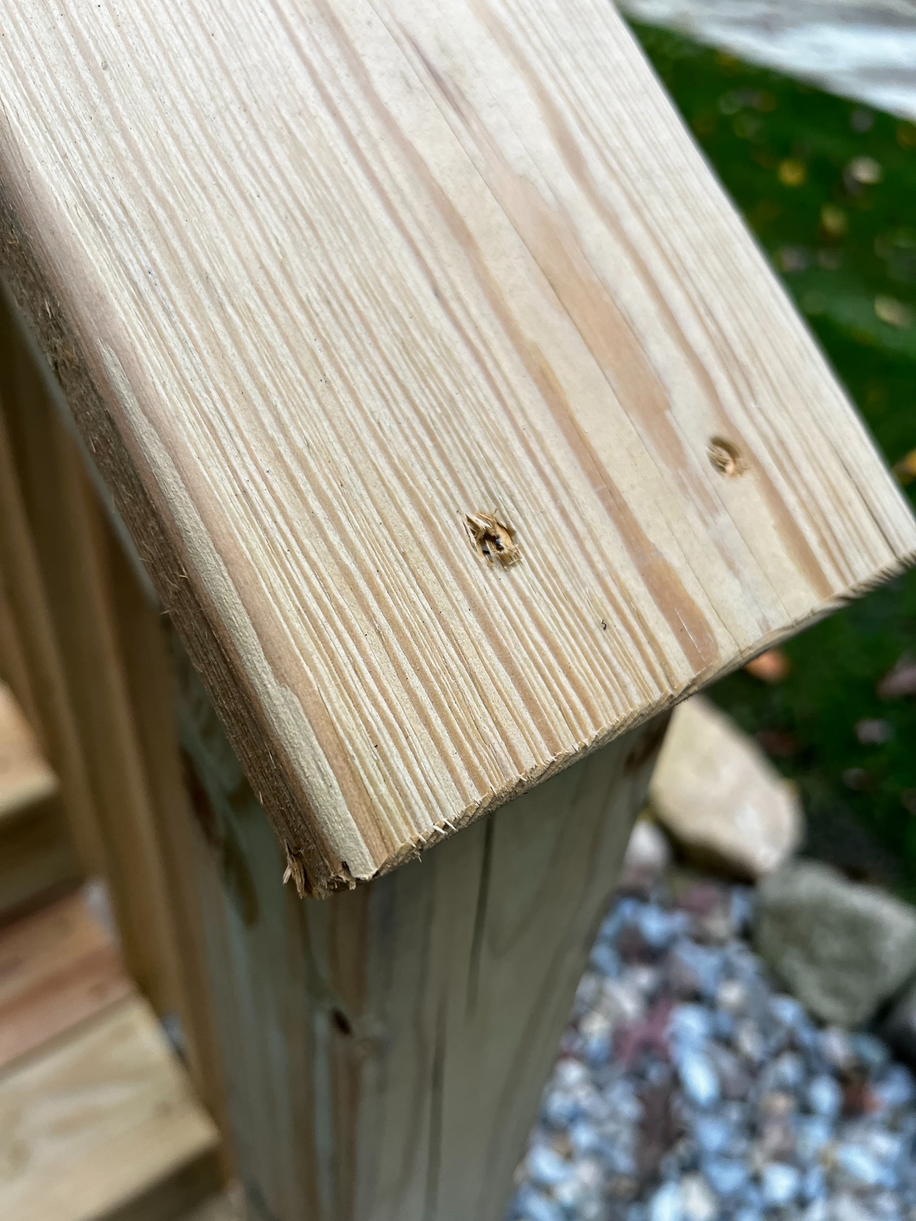

1) Is it necessary to sand/clean up in general the screw holes & other impurities before staining? If truly desired, how would I go about it – sanding?
2) Adding onto the last question their are places where the wood has yellow marks & cement dust. Is this a definite place where I would need to sand?

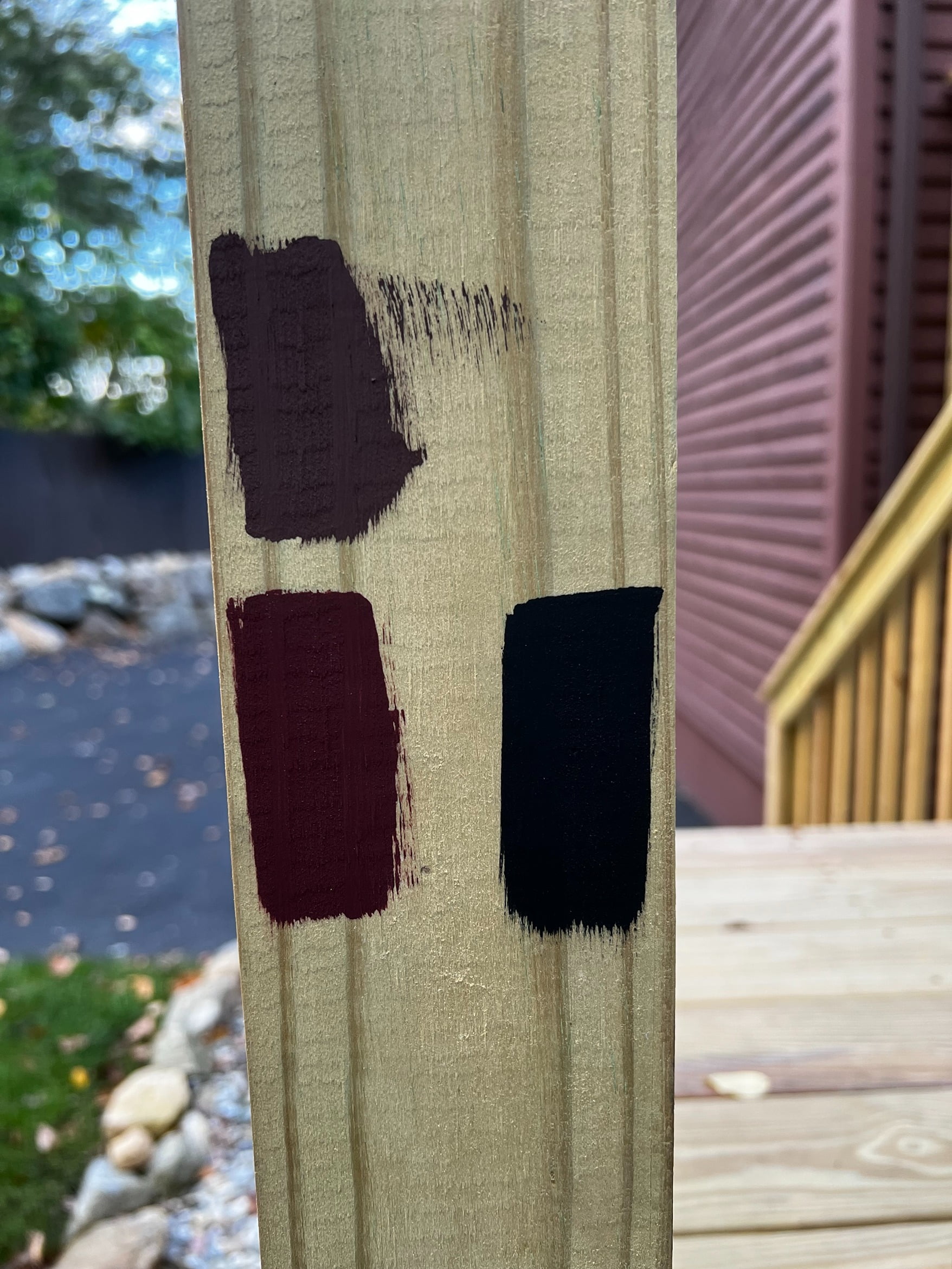

3) Adding even further to the last 2 questions, I did a stain & single paint color tests. For stains one being black & other maroon, lastly single paint test in maroon. How would I deal with cleaning this up, sand off the color? Especially before winter before it really soaks into the wood?
4) Unfortunately, the contractor left some old boards that had old paint on them – image included. In order to fix this critical error, can I just sand off the old paint and then stain?
5) Is there a specific way to protect / deal with the porch metal braces, & obviously don’t stain over them?
6) With the humidity reader set to yellow pine selection – it reads around 7% – 9%, so safely under the advised 15% marker. While doing a water drop test in several places & letting sit for 10 minutes, the water did not soak into the wood – images included (mind you this was done at 6pm). By this information is the porch ready to stain?
7) Since it’s fall, there’s going to be a lot of debris like leaves, falling onto the porch, I would like to get the porch stained in October or November before snowfall. Though perhaps overall I just need to wait till spring as the earliest to stain?
8) Lastly if I do ultimately need to wait until after winter, do I need to protect the porch with a tarp so the wood doesn’t become too weathered? Additionally, when spring does come around since the porch weathered for so long in the winter would the staining preparation process be different? Meaning, will I have to use a degreaser or borate to clean the porch first, or is it just a simple rinse before officially staining?

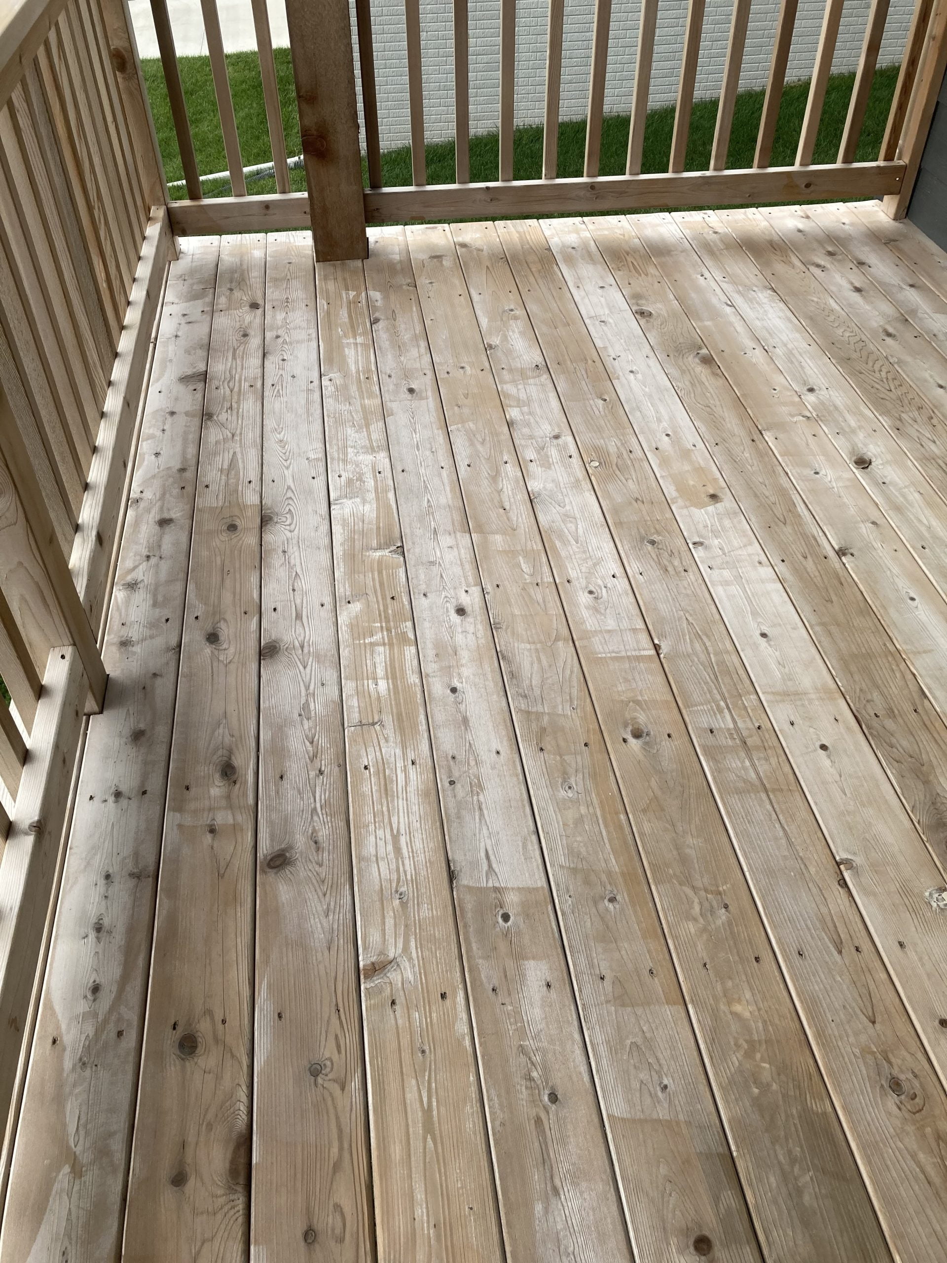

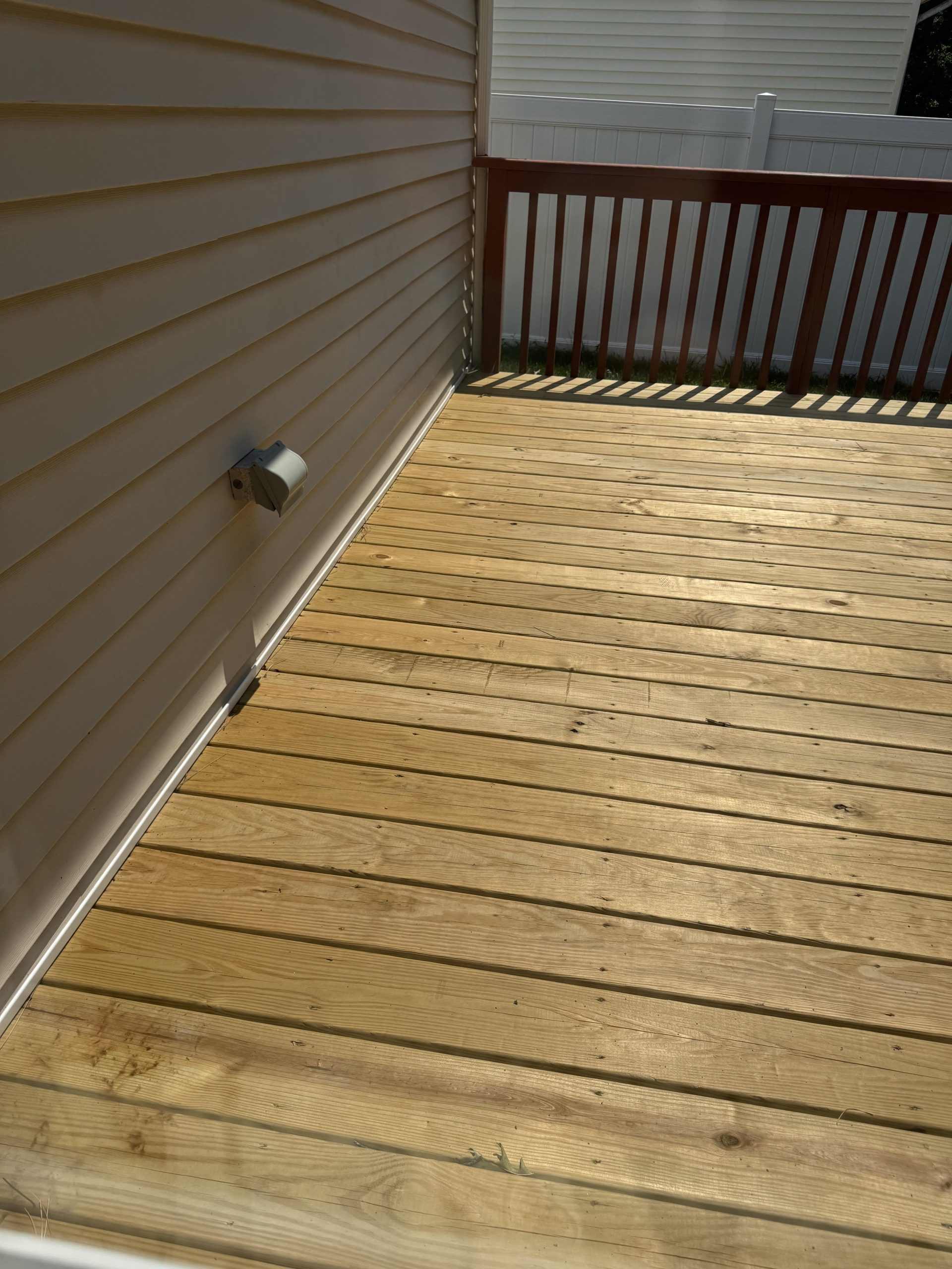

I have a new wood deck that was installed one year ago and not stained until 9/21/23. Two weeks prior the deck was pressure washed but not cleaned and brightened as you recommend. One coat of Flood pro series semi-transparent acrylic/oil stain was sprayed on. The application is very uneven darker in some areas and lighter in others. Should I have the contractor apply another spray coat and back roll or would you recommend another course of action? I am willing to wait until next year if that is best per your recommendation. I do not want peeling or make matters worse with the second coat now.

I have a home in Bend, Oregon (dry high Oregon desert). We installed a new deck in April 2022 which the contractor immediately stained when it was finished. Attached is the picture of what it looks like today 18mo later. Sure looks different! Another contractor said it needs to now be sanded down before it is re-stained. I plan to do the work this week. After watching your video, can I just use deck cleaner and then a brighter before I stain? I’d rather not sand it down. What process do you suggest? Also, what brand stain works best for the high Oregon desert? Thanks much for your advice.

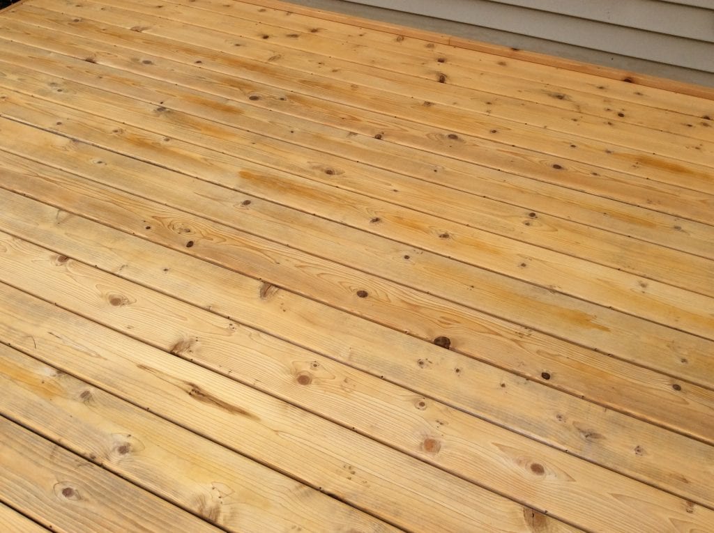

Hi, We have a new deck “Yellow Wood” Pressure treated and I was wondering when I can stain with a Semi-Transparent stain. The builder said wait 2 months which put us into late October / Early November in the Midwest. I was just told by a paint company to wait at least 6 months (even thru winter) and then stain in the spring instead of late October? Any thoughts?

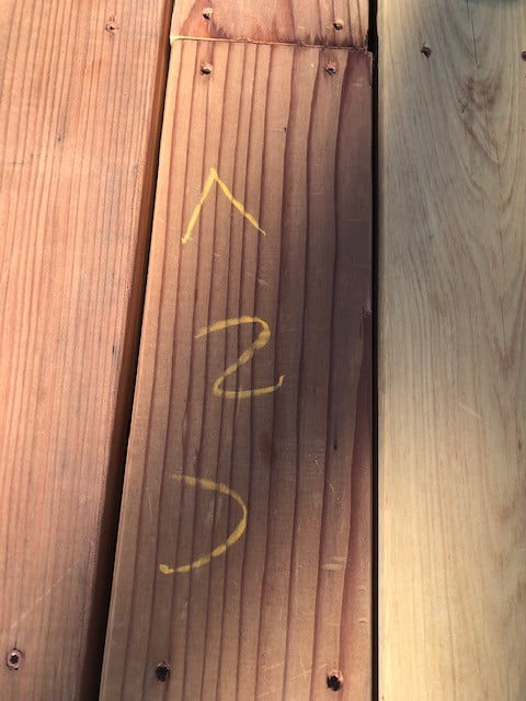

I have a new redwood deck that I’d like to stain before winter and have read so many conflicting things about sanding/staining, some say sanding opens pores others say it closes them!? As of now I’ve just cleaned it with oxiclean but there are chalk/paint like marks on some of the boards that washing did not remove I’m not sure if I should sand to get them off… Also I did sand just my top railing cap before installing it so it wouldn’t cause any splinters is this going to be an issue? I’m planning on using Ready Seal semi transparent stain. Thx!

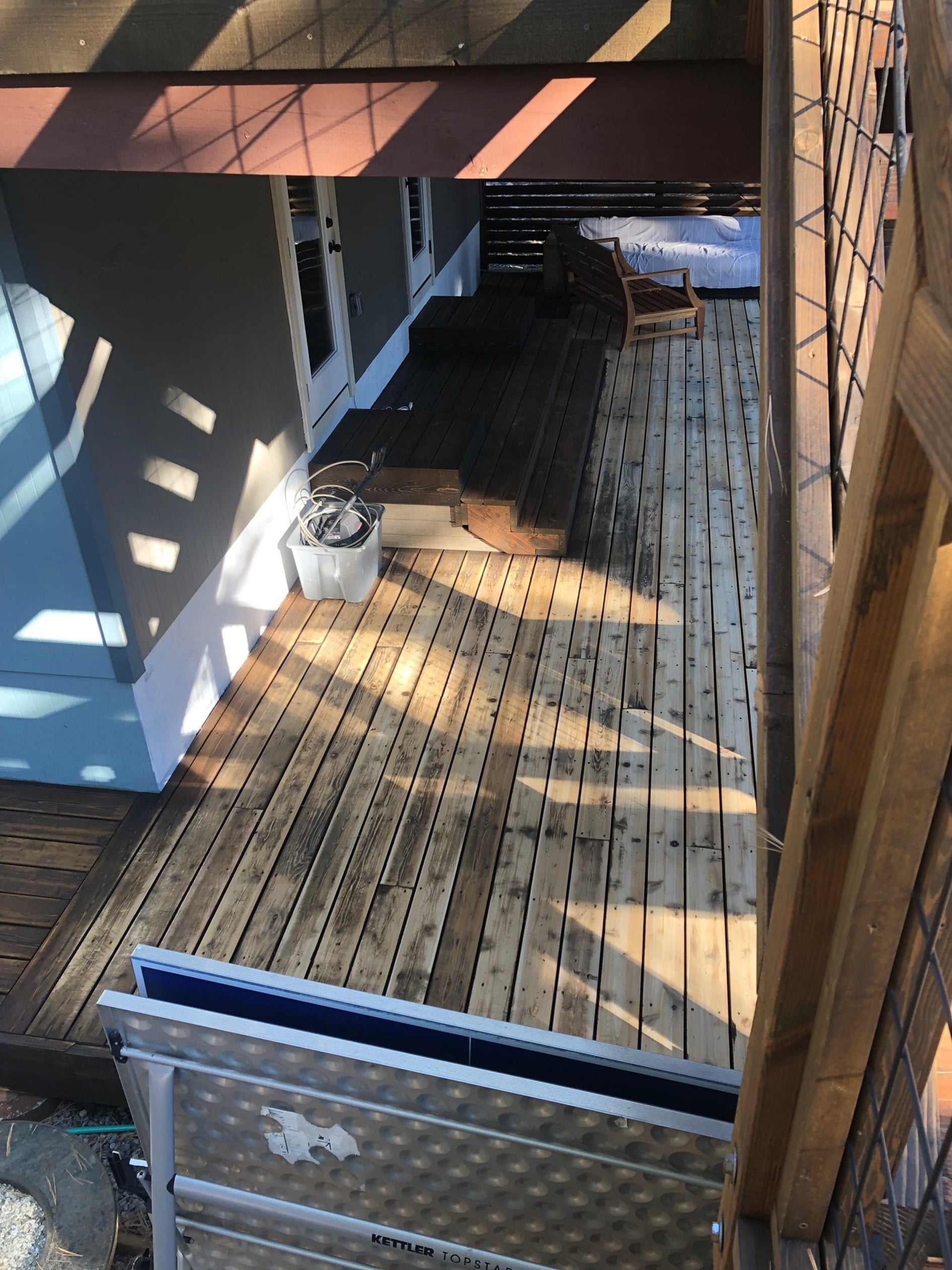

Hi Scott. We had a redwood deck built last fall in Lake Tahoe. TWP stain, dark oak, was applied in 15 degree weather after 6 weeks install, to protect wood from winter snow. At snow melt, brand new deck was very blotchy, seems stain penetrated very unevenly. Contracter sanded and powerwashed. Deck is almost free of stain but lots of little circular squiggles. Please advise on steps to get the deck to look nice again! THANK YOU!

I have a new deck of pressure treated pine, and there are some green stains around the knots as a result of the treatment . How should I handle these when it comes to staining the deck? Should I let the deck weather and hope the green stains disappear? Sand them off at the risk of removing the treatment? Hope that the stain will conceal them?
Thanks so much!

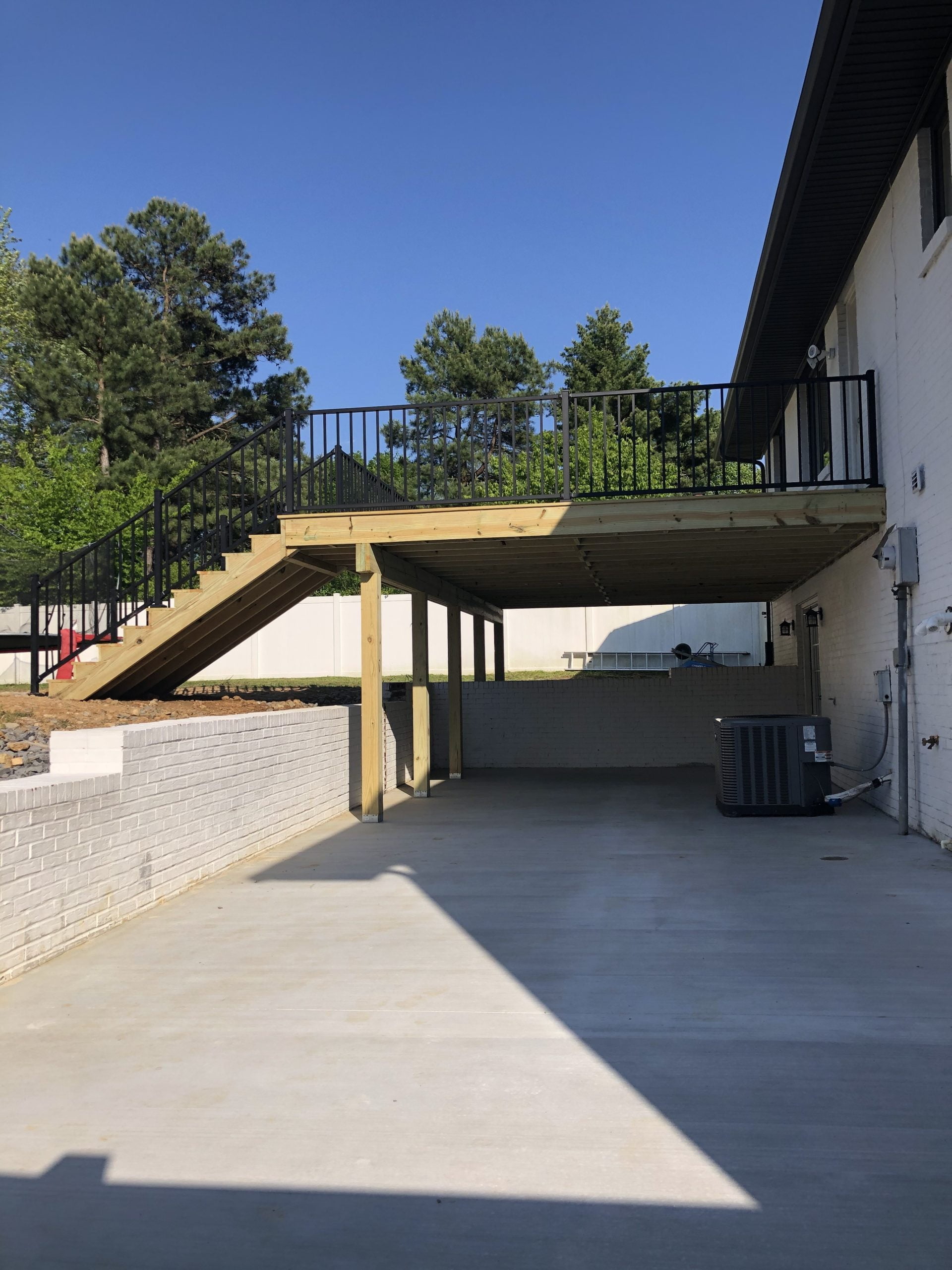

I installed a new pressure treated pine (YWood) in May, 2021. The deck was built over a brand new poured-concrete patio. I planned to seal (no stain) the decking, stairs, support posts, and exposed framing for the first time this fall. Will any of the chemicals you recommended for prep and sealing new decks damage/stain new concrete or painted brick? I’ll try to cover everything as best I can but something’s bound to splash or drip onto the concrete. I’m in Western Kentucky. Great website. Very informative. Thanks!

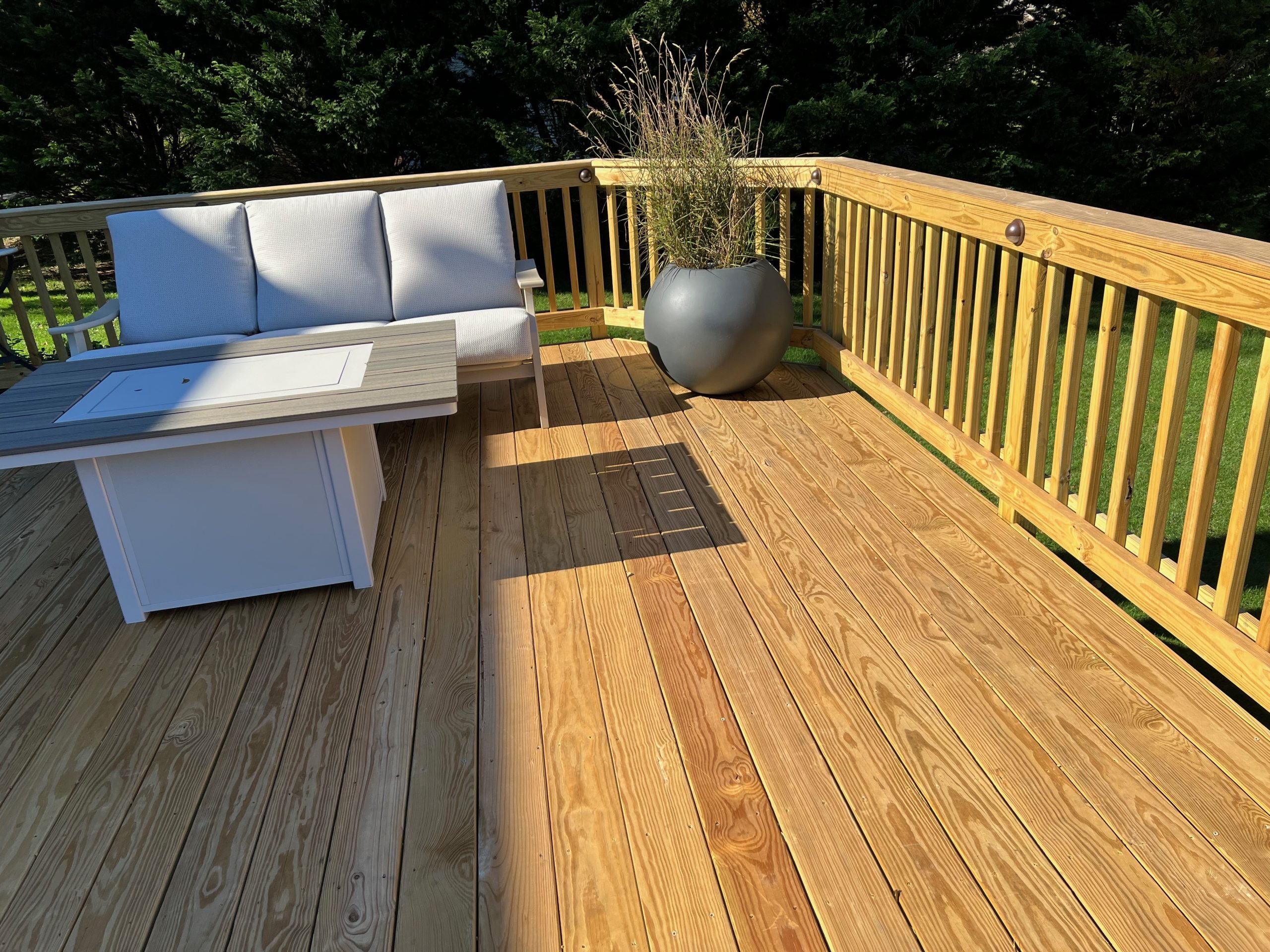

I have a new 16×20 pressure treated pine deck in Alabama which was just completed. Plan for stain at least 3 months from now (gets a lot of direct sunlight)…. after reading your website (which is fantastic!) I am concerned about my stain choice coming up. I have a smaller deck on the other side of the house that I used Cabot Australian Timber Oil – Honey Teak on about 4 months ago and we love the look of it (did it about 6 months after it was built). Seems like you’re a bigger fan of the TWP 100. Given the size of my new deck I want to get this right and make maintenance as easy as possible… and it seems like maintenance is easier with TWP 100..? We had planned to use Cabot again to match the other deck but given the time and money invested in this large deck I want to use the best product (for look, wood preserving, and maintenance) regardless.. we’re okay if the match isn’t perfect if it saves headaches every 2-3 years. I guess I am saying should I use Cabot Timber Oil to match or switch to TWP 100 Thanks for this awesome website!

I had a new covered deck built in May. The steps and 4×4 posts are ready to seal but the rest of the deck still beads water. Should I seal steps and posts now or wait till rest of deck is ready?

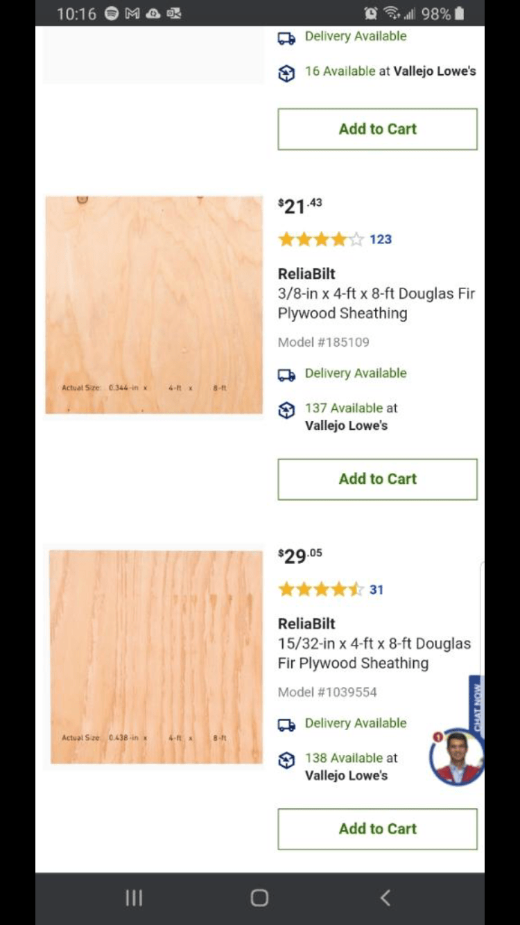

Do you have to weather Douglas Fir Plywood Sheathing? Or can you stain it immediately? Are there any special staining instructions for Plywood sheathing since we aren’t using traditional deck planks? We live by the coast.

I had a contractor install a small new redwood deck and a new gate. They chose to use miniwax stain (a non-exterior oil-based stain). And it occurred to me that they clearly didn’t know what they were doing.
This was about 3 months ago. The deck is starting to look pretty bad, it has a strange inconsistent faded color from occasional wetness and looks rather dry. Part of the gate is starting to lift up from dryness. I’m not sure what the best steps are from here. I live in Southern California.
I want to apply a new oil-based semi-transparent stain and provide some protection to the wood. Is there reason to wait further? Should I just sand the wood down a little now and leave it exposed and then wait a few months?
Any particular reason you’d recommend TWP 1500 Vs TWP 100? Where I’m located rain/cold isn’t as much of an issue as the heat/sun.
I’ve read from the TWP website that they recommend the RAD Stain Stripper for “old failed stains”, it was an oil based stain, so not topical. I’m curious should that be attempted in lieu of sanding? Then for sanding, 80 grit?
I keep reading about pressure washing as a possibility, would that work?

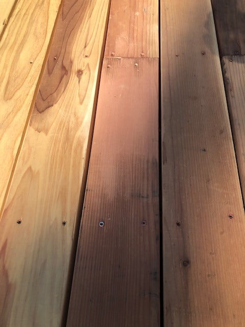

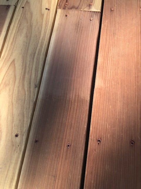

Hi – we just had a new redwood deck installed (two days ago). there are contractor crayon marks on some of the planks. He advised to sand those off before staining. I did sand two off but it has made the plank look patchy. Does this mean i have to sand the whole deck to even it out? or will the patches go after some weathering? thanks! Photos attached.
JAMES
JAMES
thank you for the quick response. Can i also ask why it goes a different shade – is there a coating on the boards as part of the lumber process that comes off when sanded?
JAMES
JAMES
thank you again for your reply – very helpful.
