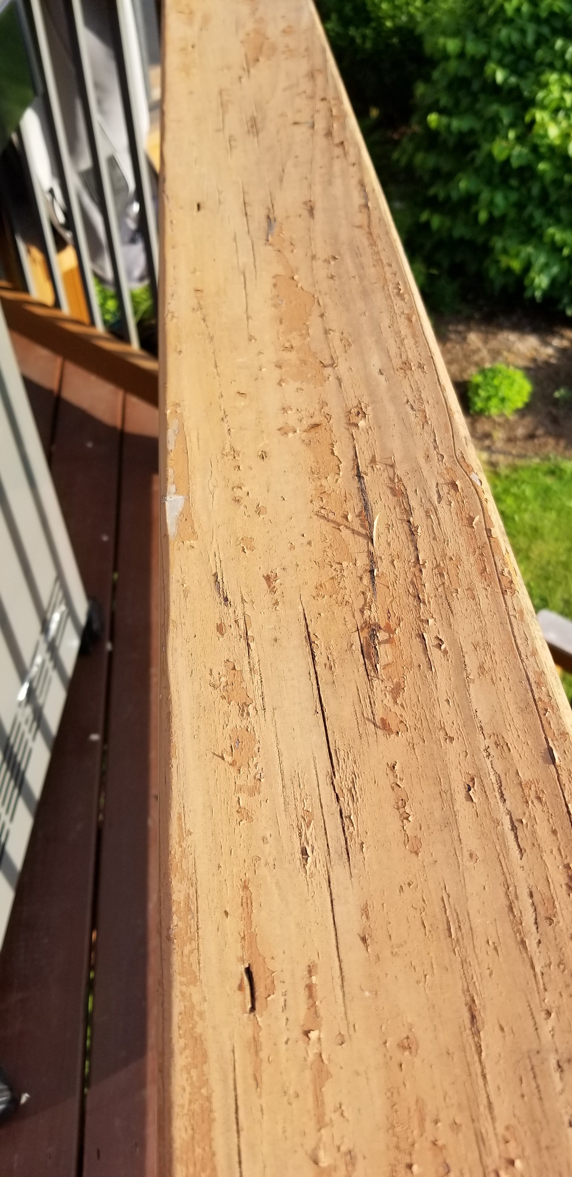

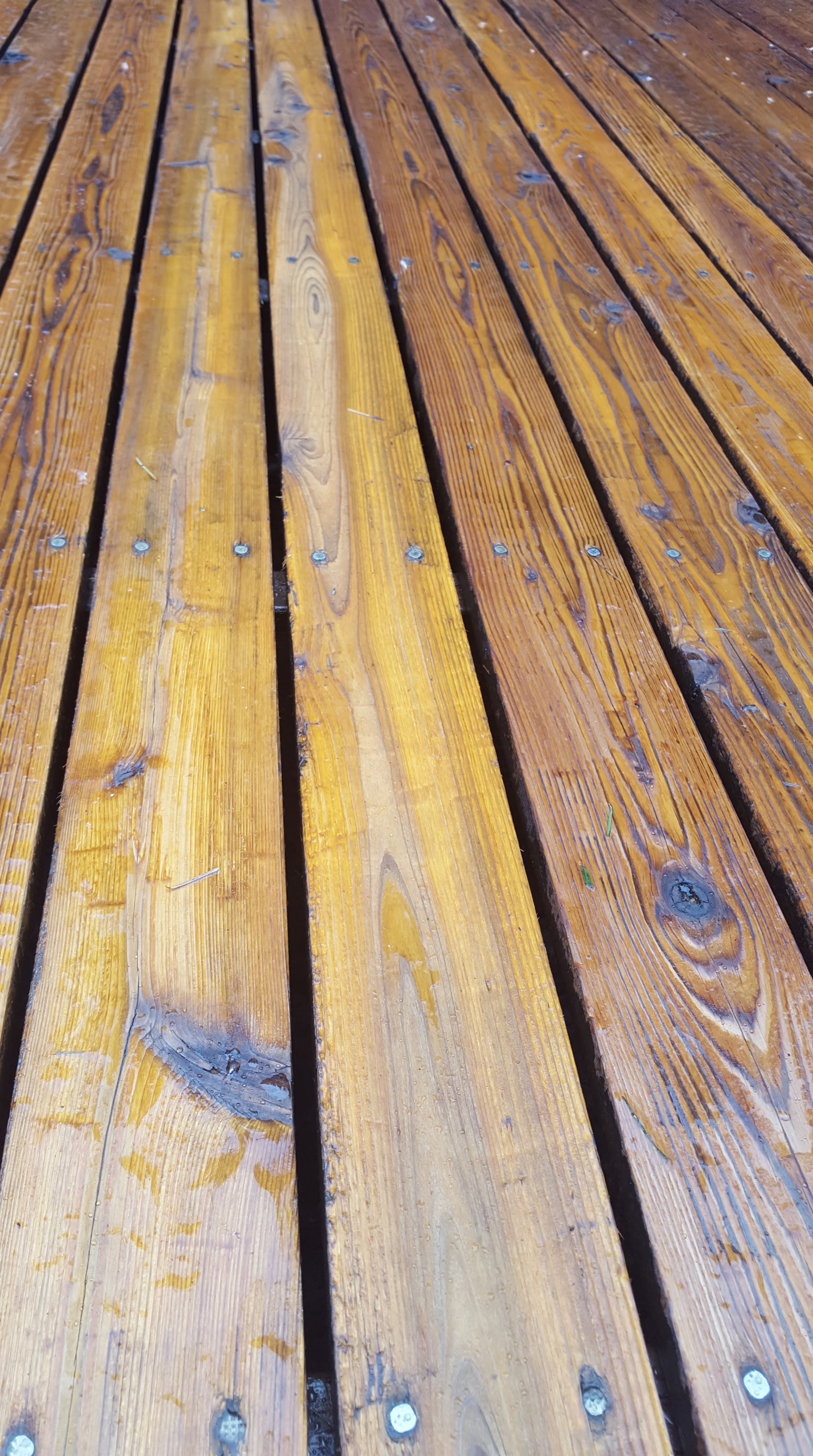

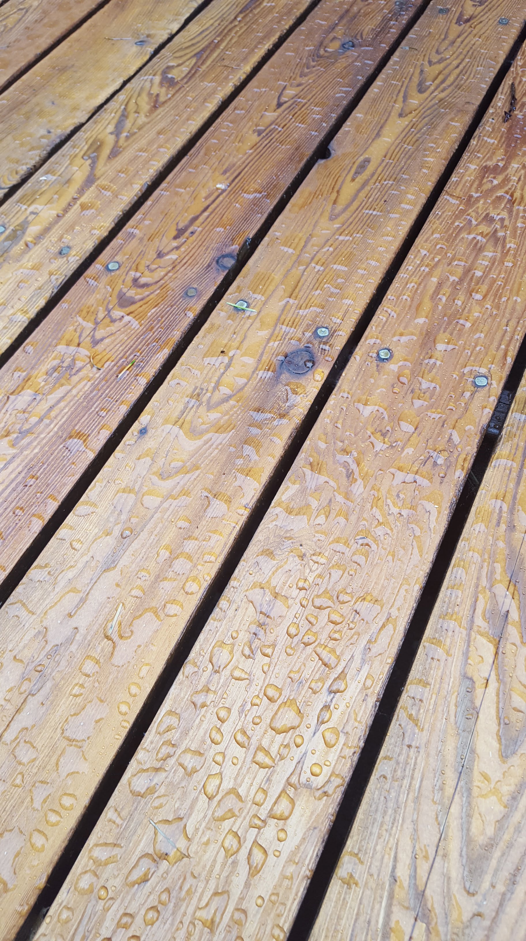

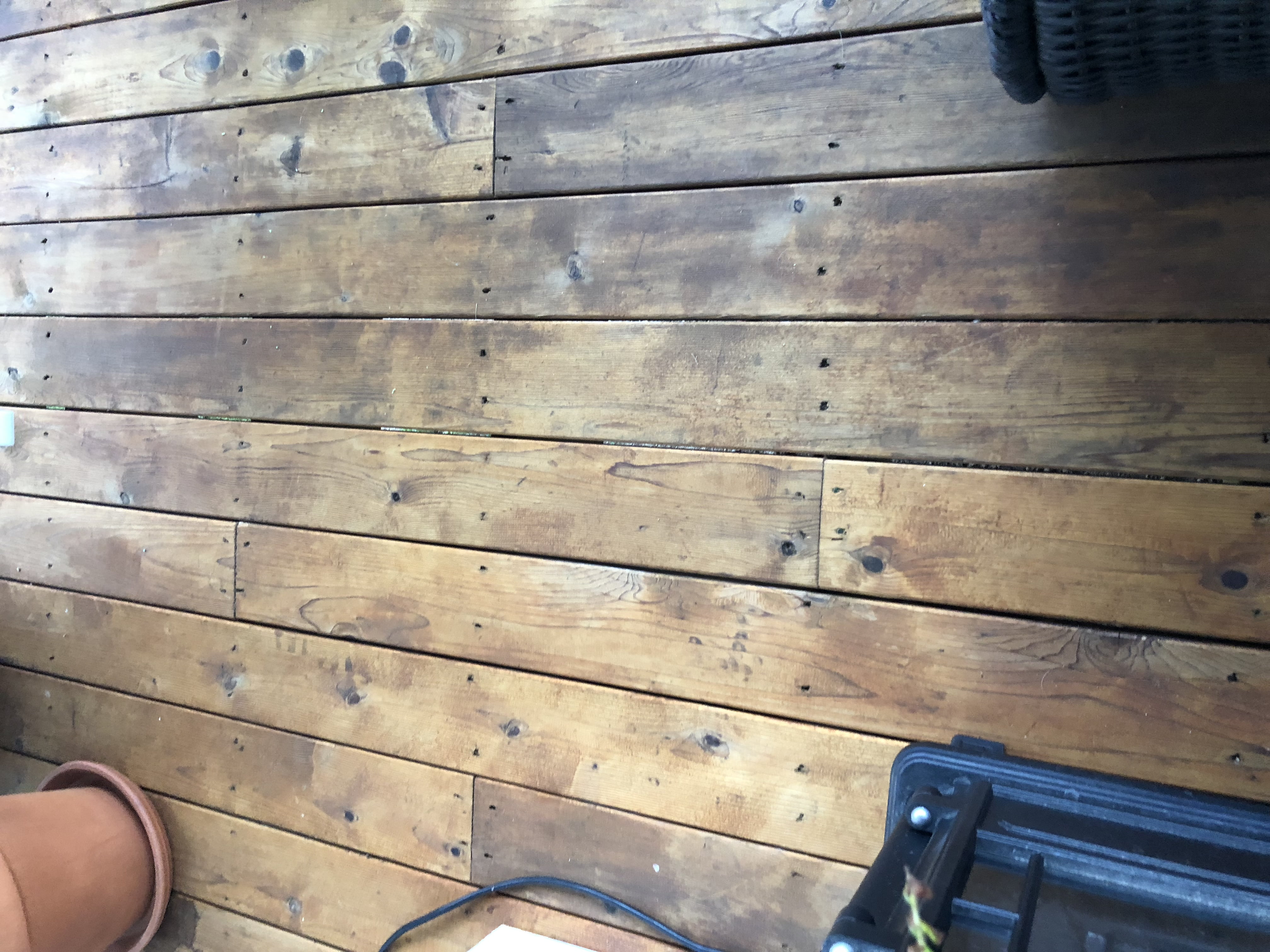

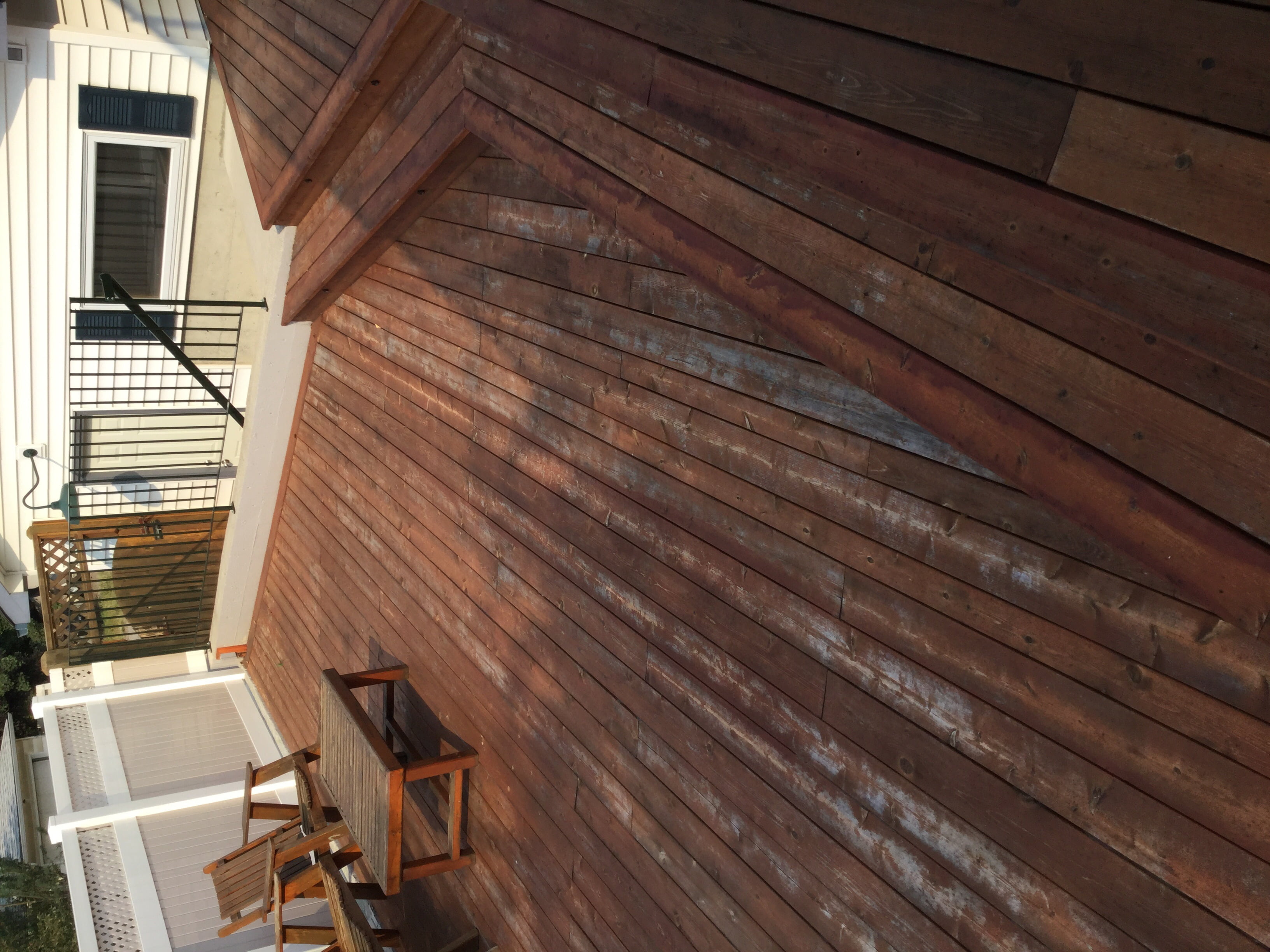

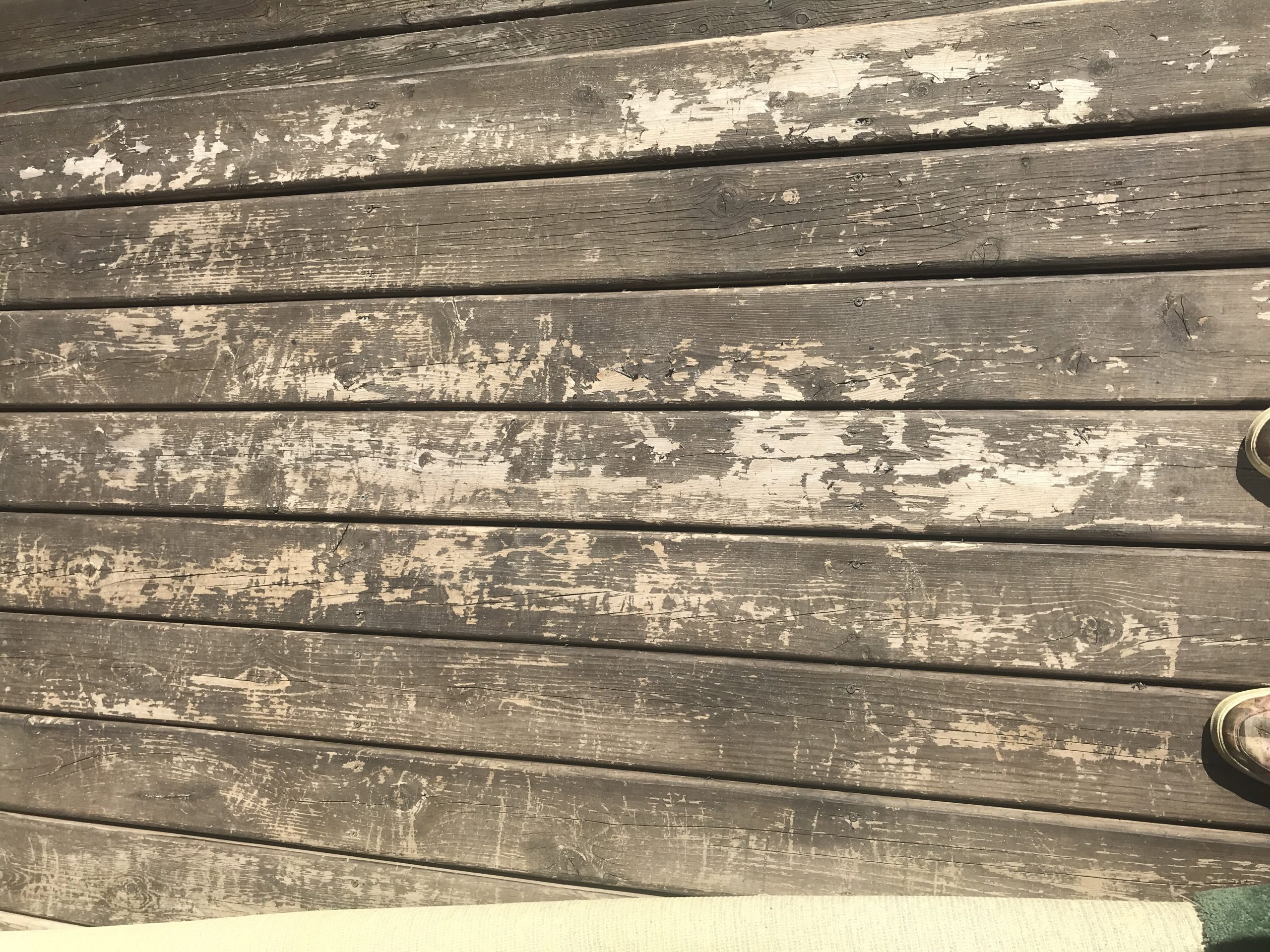

Used Sherwin Williams SuperDeck Semi Transparent Water Based Stain. Initial application failed. A second application the following year after sanding and refresher failed even worse. The product goes on like paint and has no penetration. I used this product many years ago before the initial manufacturer was bought by Sherwin Williams.

Pictures are reversed!
Jrindero
Jrindero
Found out our old stain, deckscape, was replaced by super deck. This new stain does not even come close to repelling water. Now I will have to completely redo my deck that I just refinished. Worst stain product I’ve used in years.
First picture is super deck. Second picture is deckscape. Pictures tell it all.
