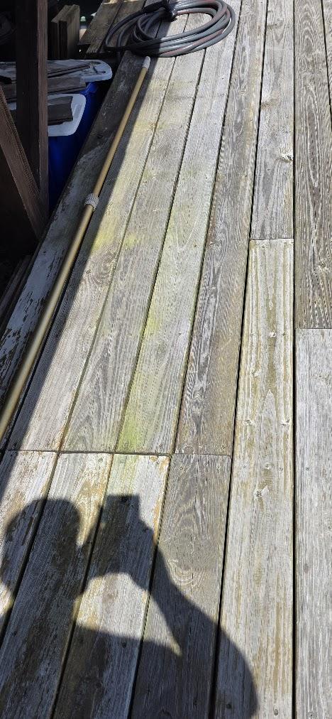

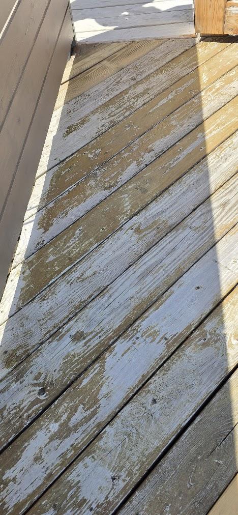

I have an old deck coated with a Behr cedar stain and sealer. It is like a film flaking now. Best stripper for this? Thanks!

3 pics attached…I think
deck1

2
deck2

No vertical surfaces. I can use the restore a deck /brightener kit and add the booster. Do this in sun or shade?
