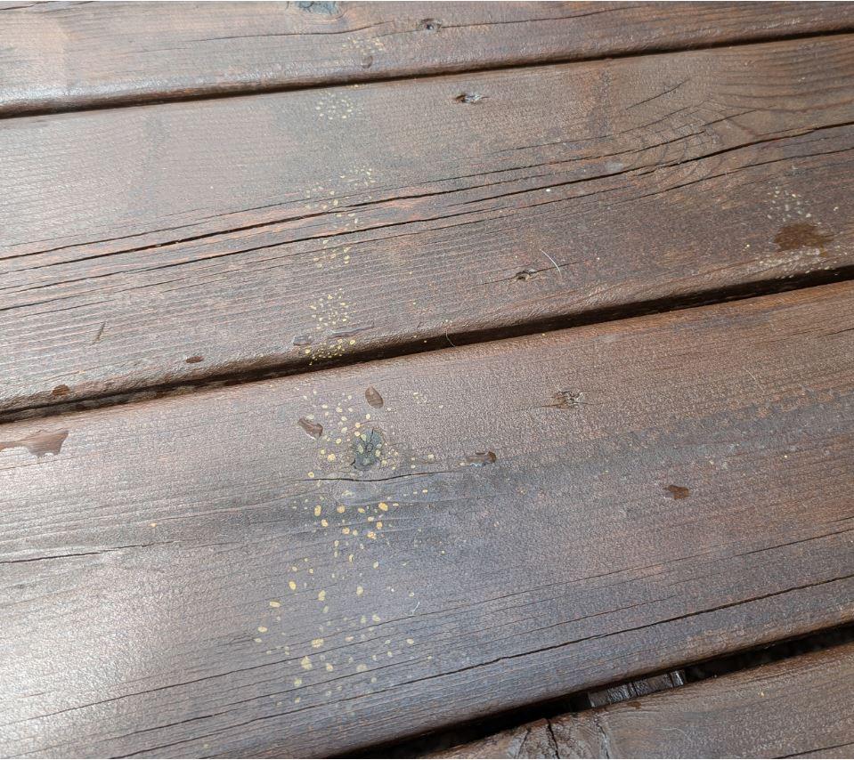

I was able to stain last Saturday, and it had more than 30 hours to dry before it rained
My wife is now (Wednesday) moving some furnitures to power wash and stain the 2nd section. But when moving some patio chairs, looks like some “rusty water” from the frame dripped on the new stained section. She tried to rinse it off asap with the garden hose, but apparently it’s still visible….Is there something specific to do? Or is it going to disappear on its own?
It should wipe off or go away. Not sure of what cleaner would remove the spots and not harm the stain.

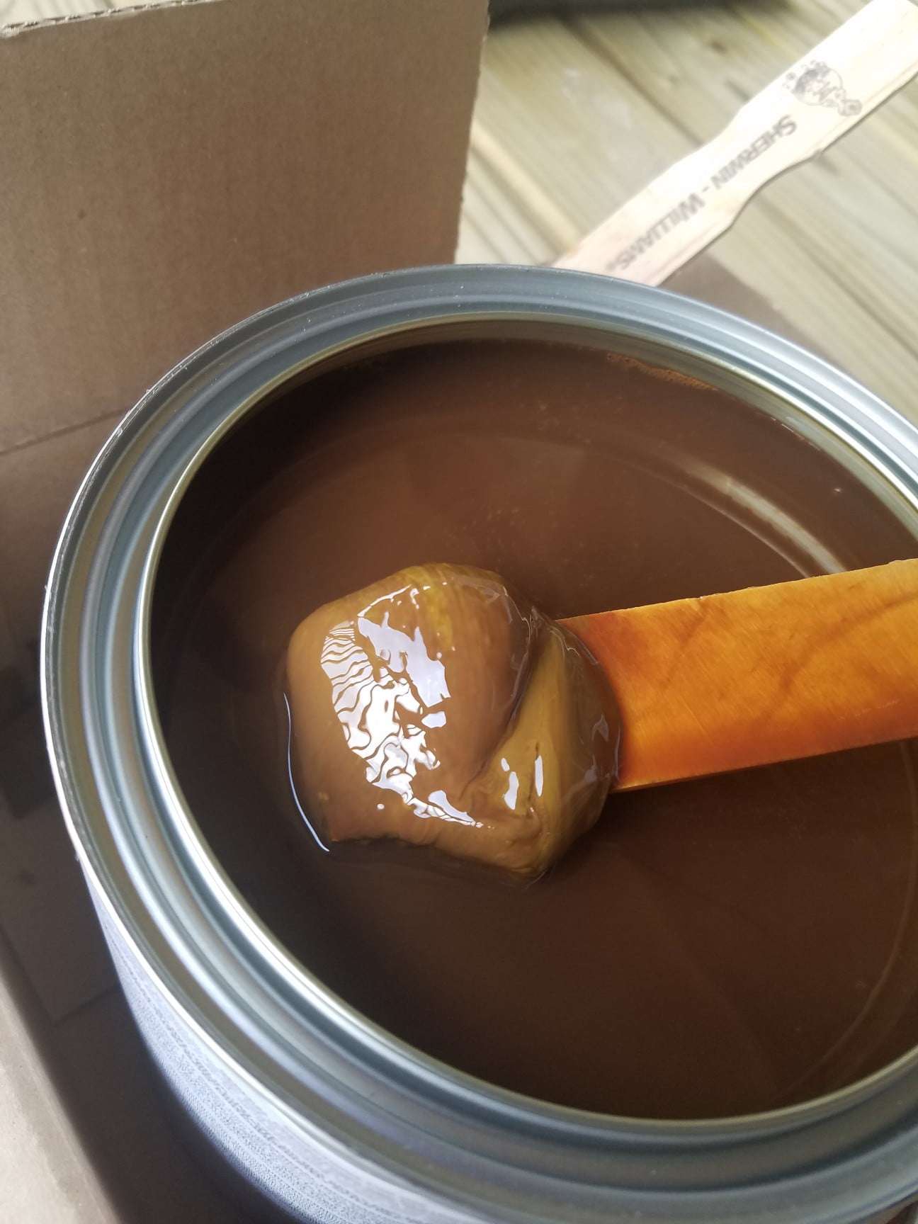

My unopened TWP 120 stain is full of clumps like this I think I got a defective batch? I tried mixing in the clumps but they won’t go away and don’t want to risk ruining my deck after all the prep work I did.
That looks like settled pigment, not a defective batch. Shake it or get a drill mixer and use that.
You were right I purchased a drill mixer, used the stain and it turned out great. Thank you for quick answer and giving me piece of mind.
Great!

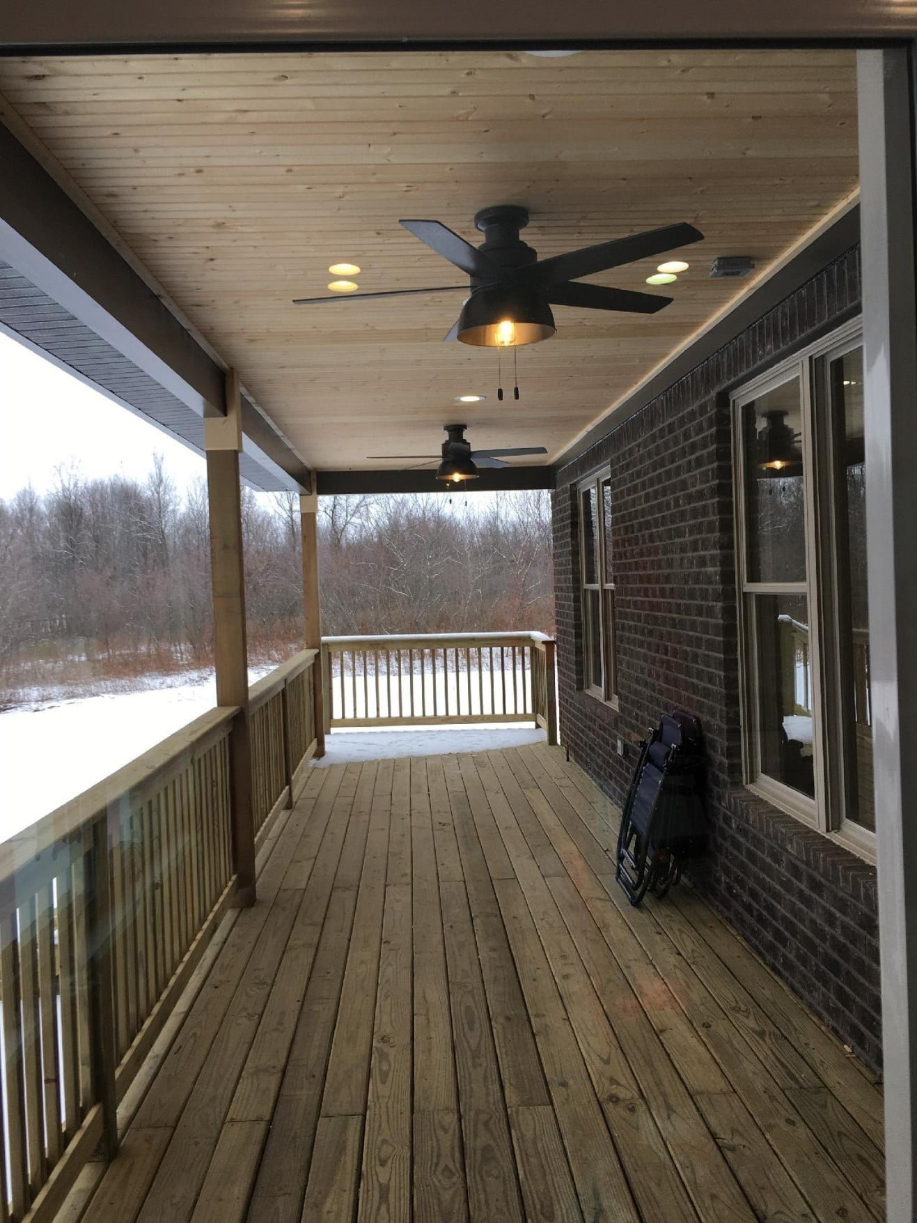

My new pressure treated covered deck is a year and has never been stained. I power washed it pretty thoroughly because it had lots of stains from everyday use and then I used a brightener and now waiting two days it to dry. Tomorrow I plan on rolling with (3/4″ nap) one coat of TWP 100 Pecon then spraying my railings.
1.) My understanding is that I should only apply one coat of stain is this correct?
2.) Should I apply a 2nd coat of stain next year or just wait until the entire deck needs to be refinished? In other words is there any advantage to staining again quickly?
3.) The deck still gets rain and snow blown on it so should I look into applying a sealer after staining for waterproofing? I’m worried about the wood expanding when it freezes and thaws.
4.) The ceiling of my deck is pine tongue and groove (shingled roof, little to no sunlight). I already sanded it with 180 grit then plan on using one coat of TWP CLEAR 120. Is this a good plan and is there anything else I should be doing to it? Will it need two coats?
5.) How good will unused stain last for in the can opened and unopened?
6.) Will rolling stain on deck and ceiling then spraying railings give me best result or is there a preferred method?

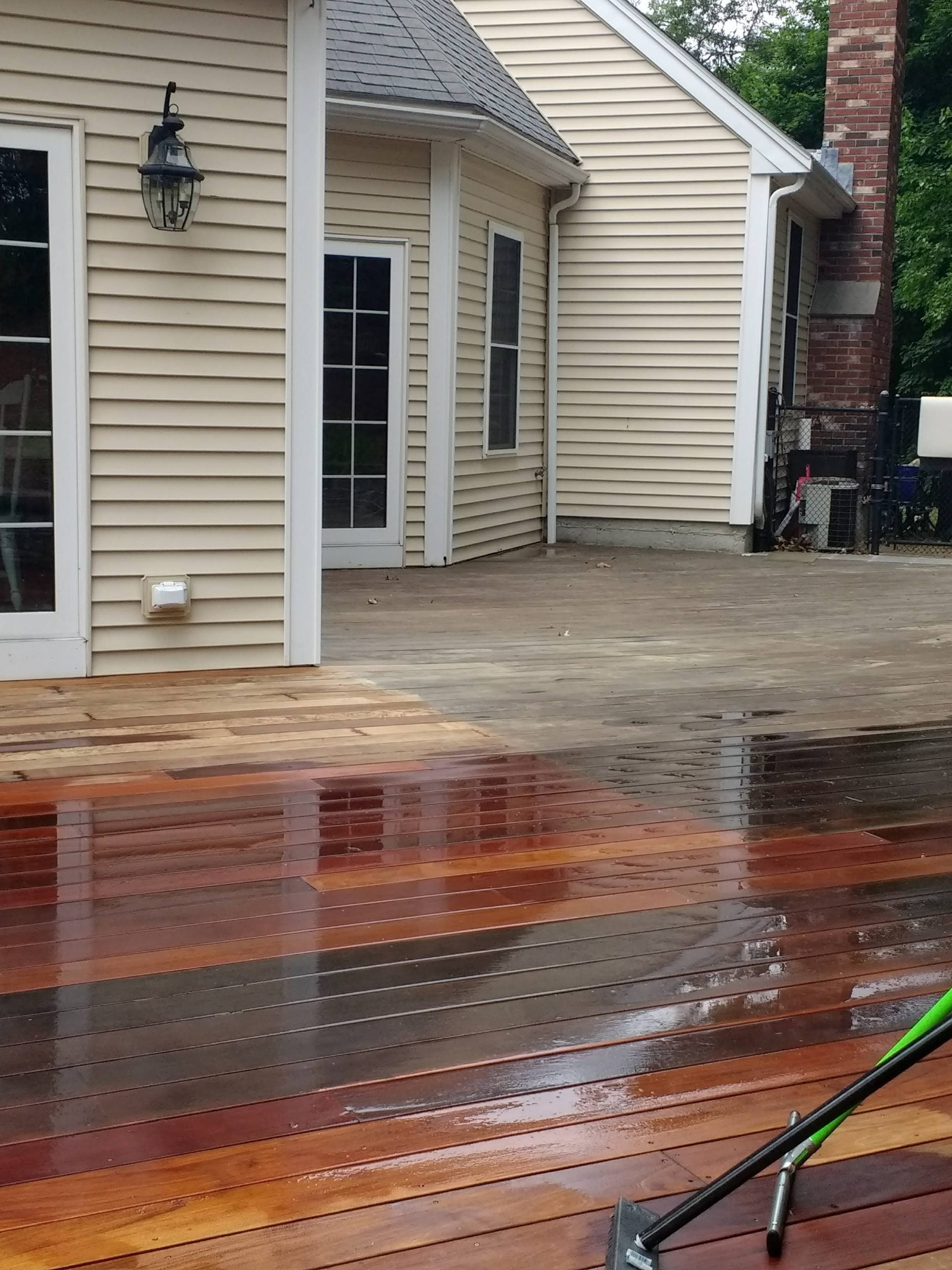

Can I use TWP on Ipe? We have a MASSIVE ipe deck, full sun and by a pool. We have tried a few different brands- I lived penofin the first year, but it seems like they changed something in formulation and it’s not as good. We did superdeck exotic as well. Nothing holds up for even a full summer. We are in Massachusetts. Debating on trying two or deckwise ipe oil- also thought about a marine grade teak oil.
Just finishing up washing it this weekend, and will need to apply a brightener(and recs for this?) Before applying a new oil.
TWP is not suggested for IPE. IPE, will require annual coatings, so best to use one that is easy to clean and re-coat.
Look at one of these brands. We like the Restore A Deck or Armstrong Clark hardwood stains: https://www.deckstainhelp.com/ipe-exotic-hardwood-stain-review/

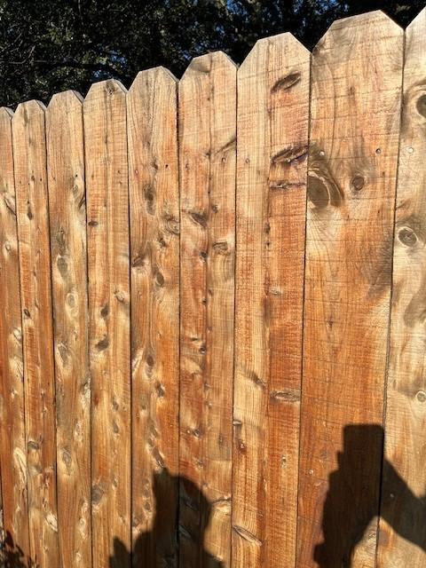

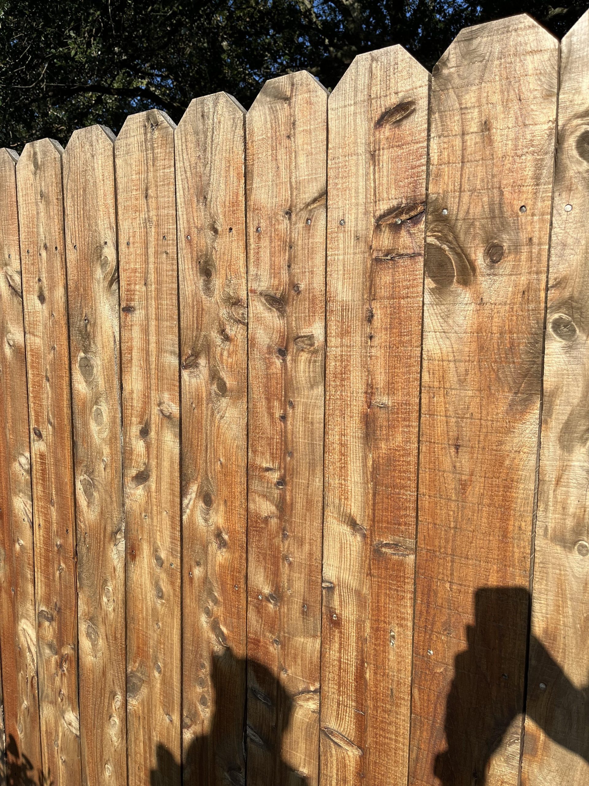

I stained my deck about 5 years ago with twp 102. I need to restain it. What do you recommend? Sand 60 than 80 grit and use Gemini cleaner and brightener after. They area covered by gazebo help up pretty good as seen in 2nd picture do I have to use a stripper for that area?
Do not sand. Use the Gemini Kit for prep. Strip for the second picture.
Ok so use the Gemini stripper and brightener for the area that held up well like in 2nd picture than do I need to rinse it off with a pressure washer? After thats done do I use Gemini restore a deck kit for entire deck?
Let it dry for minimum 48 hour than restain with twp102 2 coats wet on wet
You have to pressure wash after applying stripper, not just rinse. Do this first. Use the Gemini Cleaner on the rest of the deck. Brighten all after.

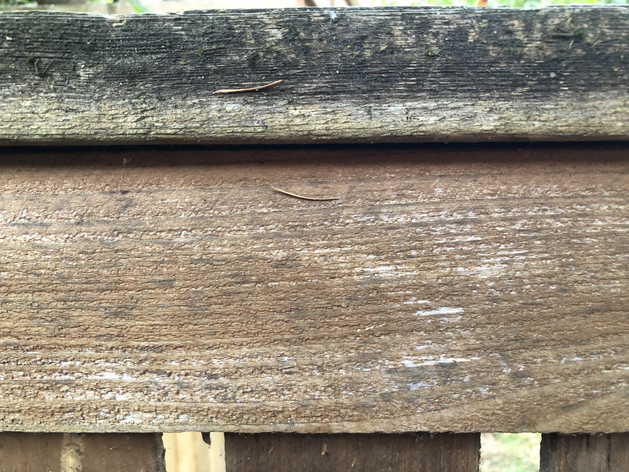

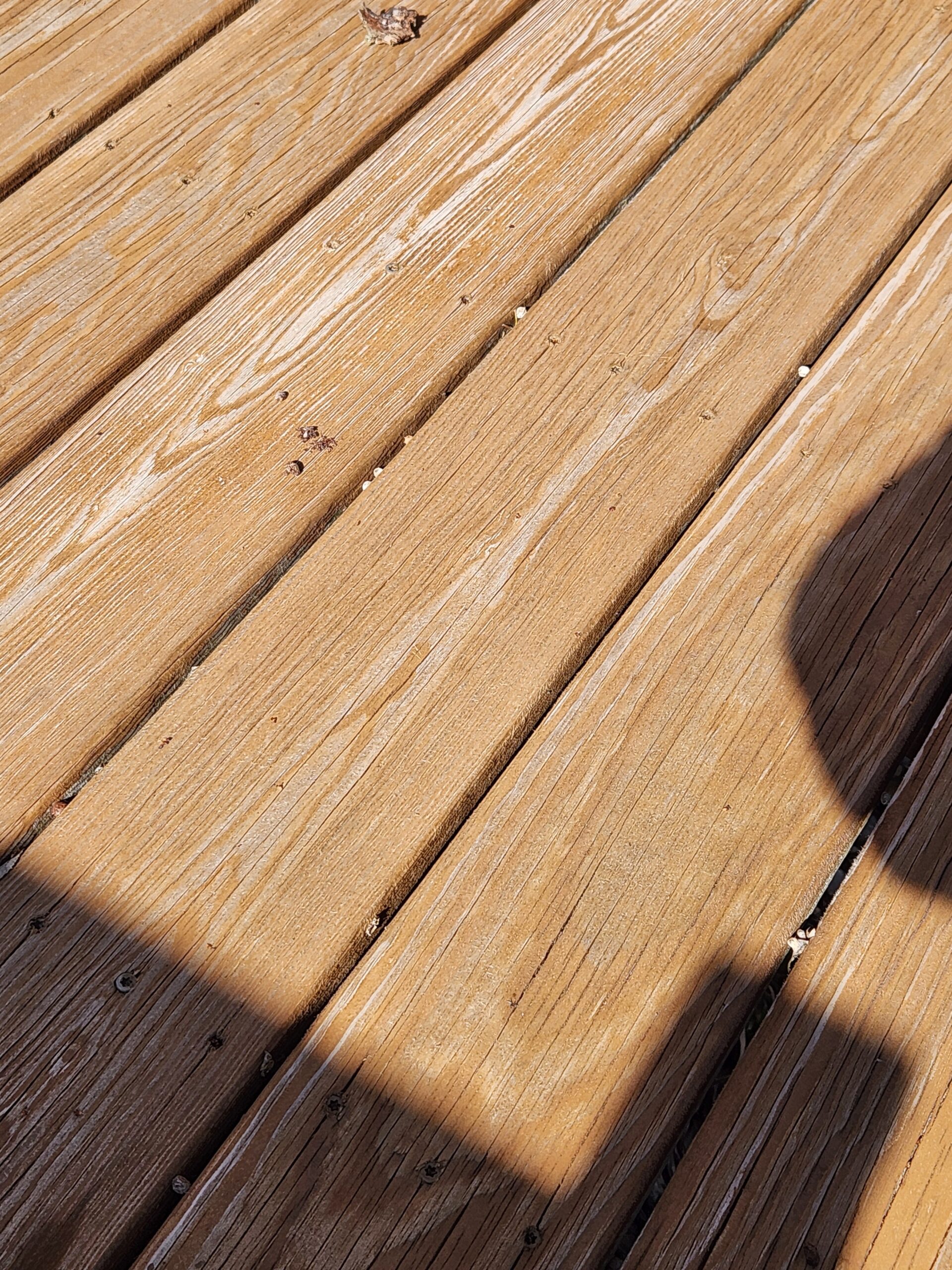

I have a 5 year old deck and stairs of pressure treated pine. First year thompson’s water seal, terrible. 2 years ago pressure washed and used WoodRX. Has not worn very well. Will pressure washing alone take this off in order to apply TWP 100? If not, what else is needed?
We would need to see pictures here in comment area for help.
Here it is
Use the Restore A Deck Stripper with both additives and then the RAD Brightener:
Thank you, so pressure washing alone will not remove residue? And what PSI on the pressure washer?
You will need stripper to remove. About 1500-2000 PSI
