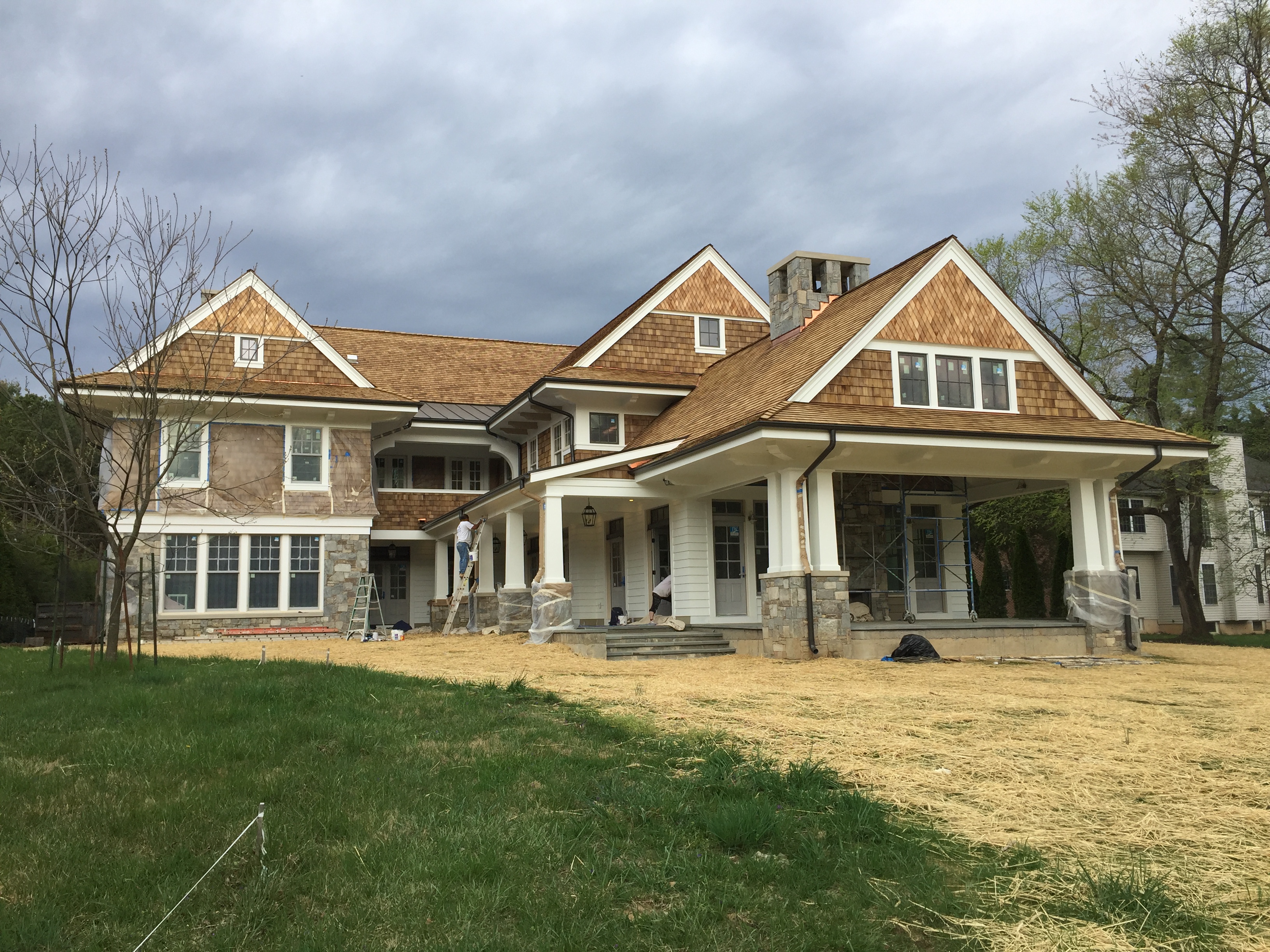

Hello, I’m a custom home builder in McLean VA who has a client who wishes to apply the TWP 1500 product to western red cedar #1 Perfection shingle siding, that is about 6 months old. Do you recommend using the Gemini Restore Kit for this application? There is little to no graying of the shingles at this time.
Are the shingles rough sawn cut? No mill glaze? Can you send a picture?
The shingles are #1 Perfection grade, so they are mostly smooth-sawn with the occasional fuzzy spot.
Lightly prep with the kit to remove the mill glaze is all you need to do.

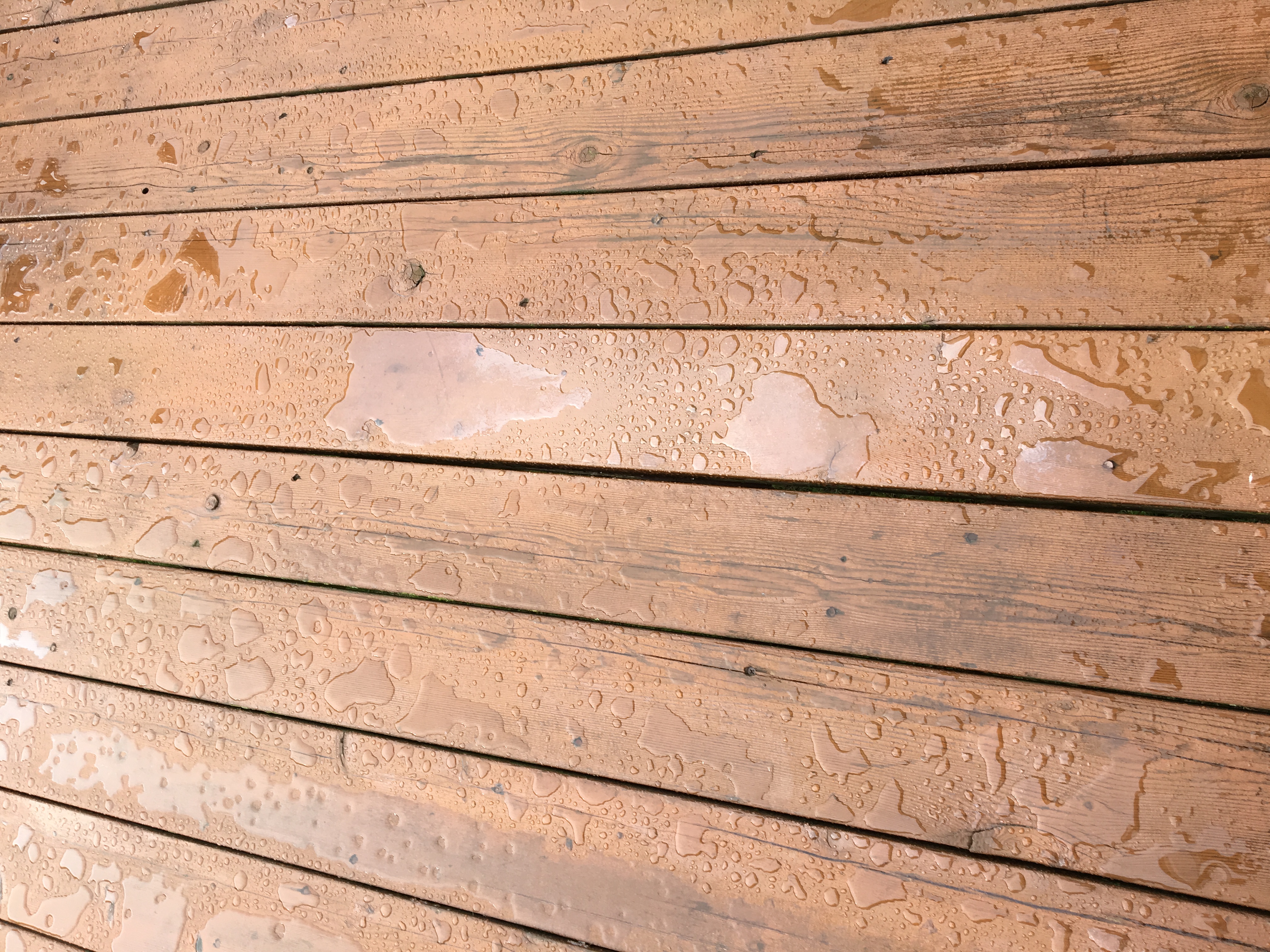

So the weather through me a curveball and now there’s a chance of rain in two days. I thought I’d try to beat it by doing my deck yesterday evening. I underestimated how long it would take to apply the first coat and ran out of daylight during the second coat. The lighting wasn’t very good from that point on and I tried my best to finish it up.
As you’d expect the second coat looks a little uneven today. I’m wondering if there’s anything I can do to fix it up since it’s already been drying for 12 hours.
No there is not really an easy fix for this 🙁

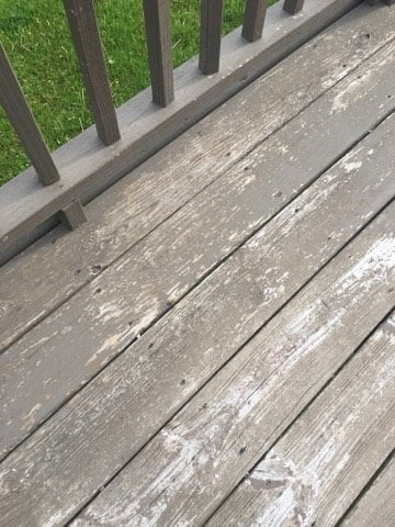

What process would you recommend here? Deck was cleaned and painted last year with Sherwin Williams Waterborne SuperDeck. Major peeling after less than a year. Was planning on sanding down and then using TWP? Would that be what you recommend?
Yes. Sand it all off first. Clean and brighten the wood after the sanding.

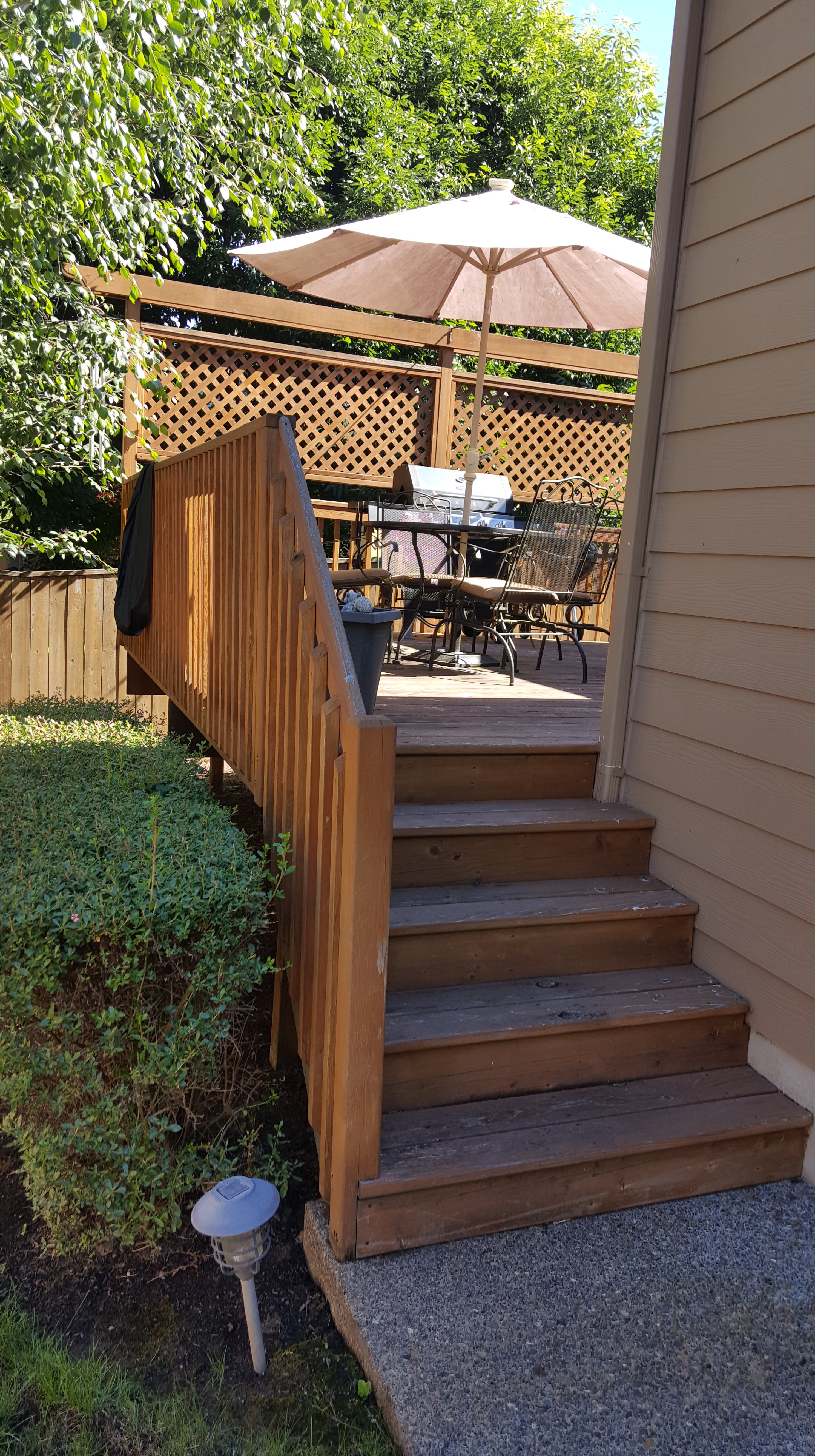

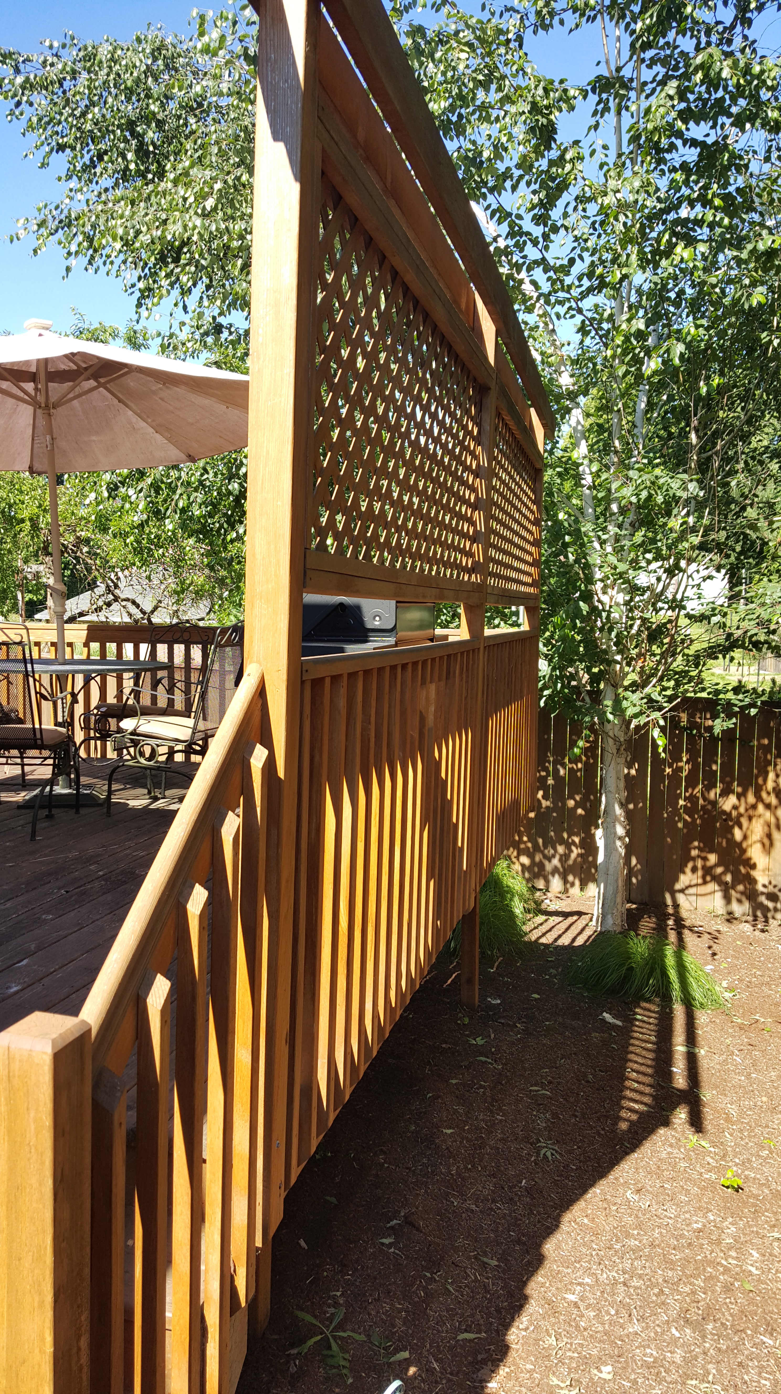

how easy is it to strip rails and lattice with the stripper? is it a one application thing, or many? All i want to do it load the sprayer and spray everything down, wait a little bit, then pressure wash it off. then come back on another day and stain it. i would like to spray the stain on the rails and lattice then use a brush to get it in the grain of the wood. walk away in two different days. 15×15 deck with lattice privacy fence and rails on 2 sides. what do you think?
How easy it is to strip depends on the stain brand and type of stain that you are trying to remove.
heres a couple of pics
Do you know the brand and type? Not all stains are created equal. Some are easily stripped and some cannot be removed at all.
I have no idea. if it cannot be stripped, then what?
You will have to sand it all off to use a product like the TWP 100 Series.
